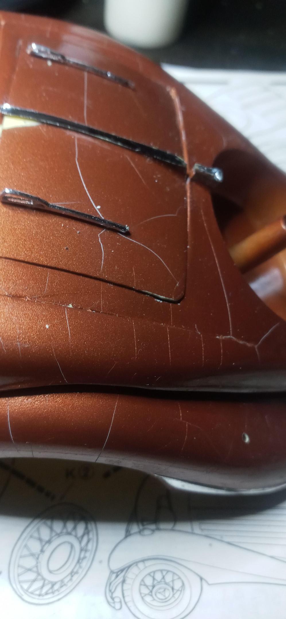

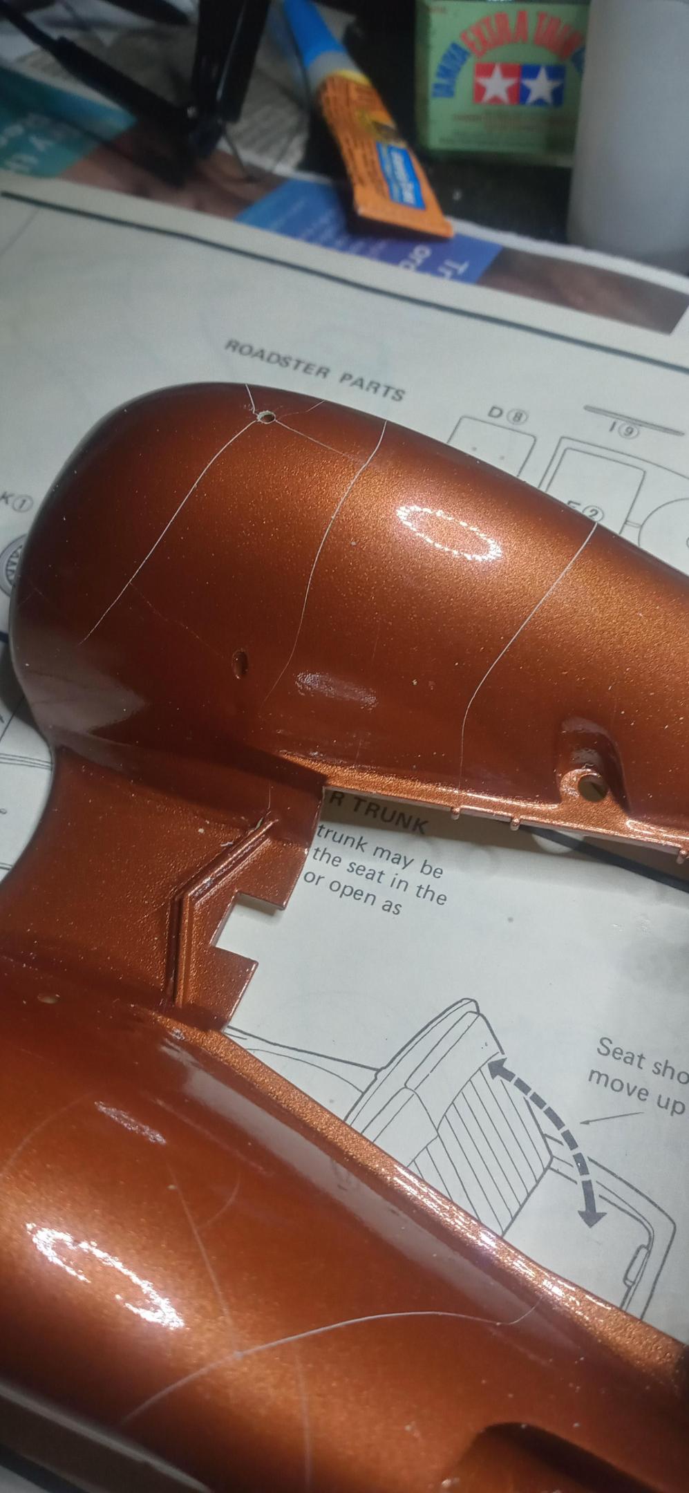

eldo60 Posted June 15, 2023 Posted June 15, 2023 this is is the result after using rustoleum primer and automotive paint. i noticed this after about a week. ive been told that maybe the primer wasn't fully dry or the wrong type of primer. since i still have enough paint left for another try, gonna strip it and try a different primer. mire be a little tough going since its been 3 years or so, really pissed so i put it aside for a while didn know it would be this long. Cadillac '69/70 firemist color on a Mercedes 500k cabriolet.
Anglia105E Posted June 15, 2023 Author Posted June 15, 2023 Sorry to hear that this has happened to your Cadillac paint on the Mercedes kit Russ . . . and here are my thoughts, based on what you have discovered. Your can of Rust-oleum primer on the left of your photo states ' Stops Rust ', so I would imagine the primer is intended for metal surfaces rather than plastic. Also, it says '2 in 1 - Filler & Sandable ', which implies this is a specialist product. Your next can to the right is an automotive basecoat, which I would guess is a kind of primer itself. I hope this might help you in some way Russ, but this is my experience of Rust-oleum products during this past week. I have applied Rust-oleum Plastic Primer White over a 60 year old Frog Ford Cortina kit body, and so far there has been no unpleasant reaction between the paint and the plastic. Having said that, I have only applied the paint a few days ago, so not one week as in your case. Also, I have applied Rust-oleum Spa Blue Gloss over the plastic primer white, and after 24 hours drying overnight I haven't noticed any odd reaction . . . The two Rust-oleum products were applied in a fine mist spray, three coats, with 5 minutes drying between each coat. I shall be getting a bit nervous by the end of this week, having seen what happened to your model car ! I have never seen that effect with the paint before . . . most odd ! Here are some photos of my efforts. David
stitchdup Posted June 15, 2023 Posted June 15, 2023 On 6/15/2023 at 12:33 PM, eldo60 said: this is is the result after using rustoleum primer and automotive paint. i noticed this after about a week. ive been told that maybe the primer wasn't fully dry or the wrong type of primer. since i still have enough paint left for another try, gonna strip it and try a different primer. mire be a little tough going since its been 3 years or so, really pissed so i put it aside for a while didn know it would be this long. Cadillac '69/70 firemist color on a Mercedes 500k cabriolet. Expand did you key the primer before the colour coats went on? i've had this happen when i skipped that step on filler primers. its like the colour coat shrinks as it dries as it has nothing to hold onto.
stitchdup Posted June 15, 2023 Posted June 15, 2023 On 6/15/2023 at 2:04 PM, Anglia105E said: Sorry to hear that this has happened to your Cadillac paint on the Mercedes kit Russ . . . and here are my thoughts, based on what you have discovered. Your can of Rust-oleum primer on the left of your photo states ' Stops Rust ', so I would imagine the primer is intended for metal surfaces rather than plastic. Also, it says '2 in 1 - Filler & Sandable ', which implies this is a specialist product. Your next can to the right is an automotive basecoat, which I would guess is a kind of primer itself. Expand base coat just means the colour needs a clear to shine, its sometimes called 2 part on this side of the pond

eldo60 Posted June 15, 2023 Posted June 15, 2023 thanks I'll have to try some of that i like to use automotive colors, especially metallics. duplicolor from now on.
