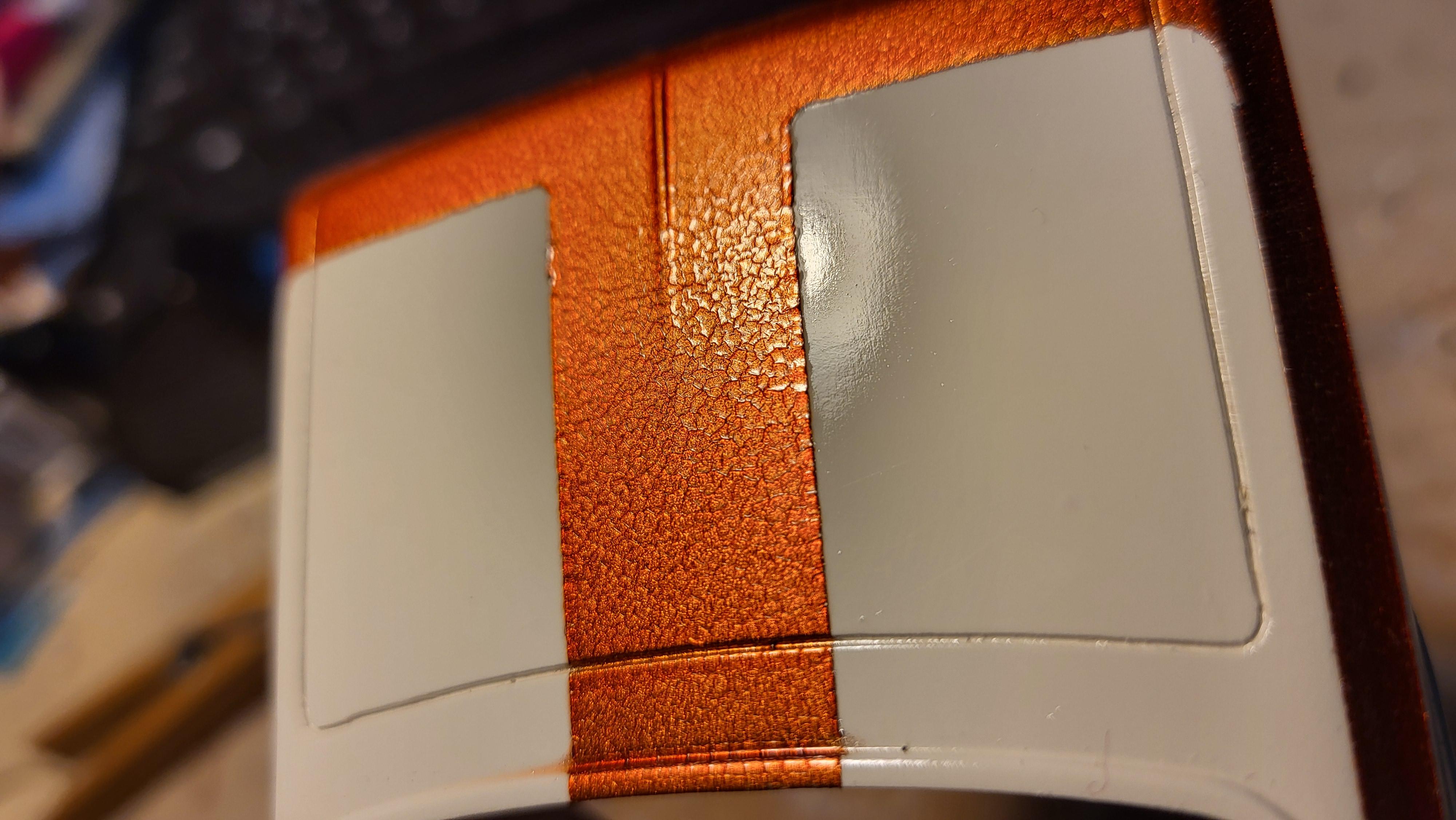

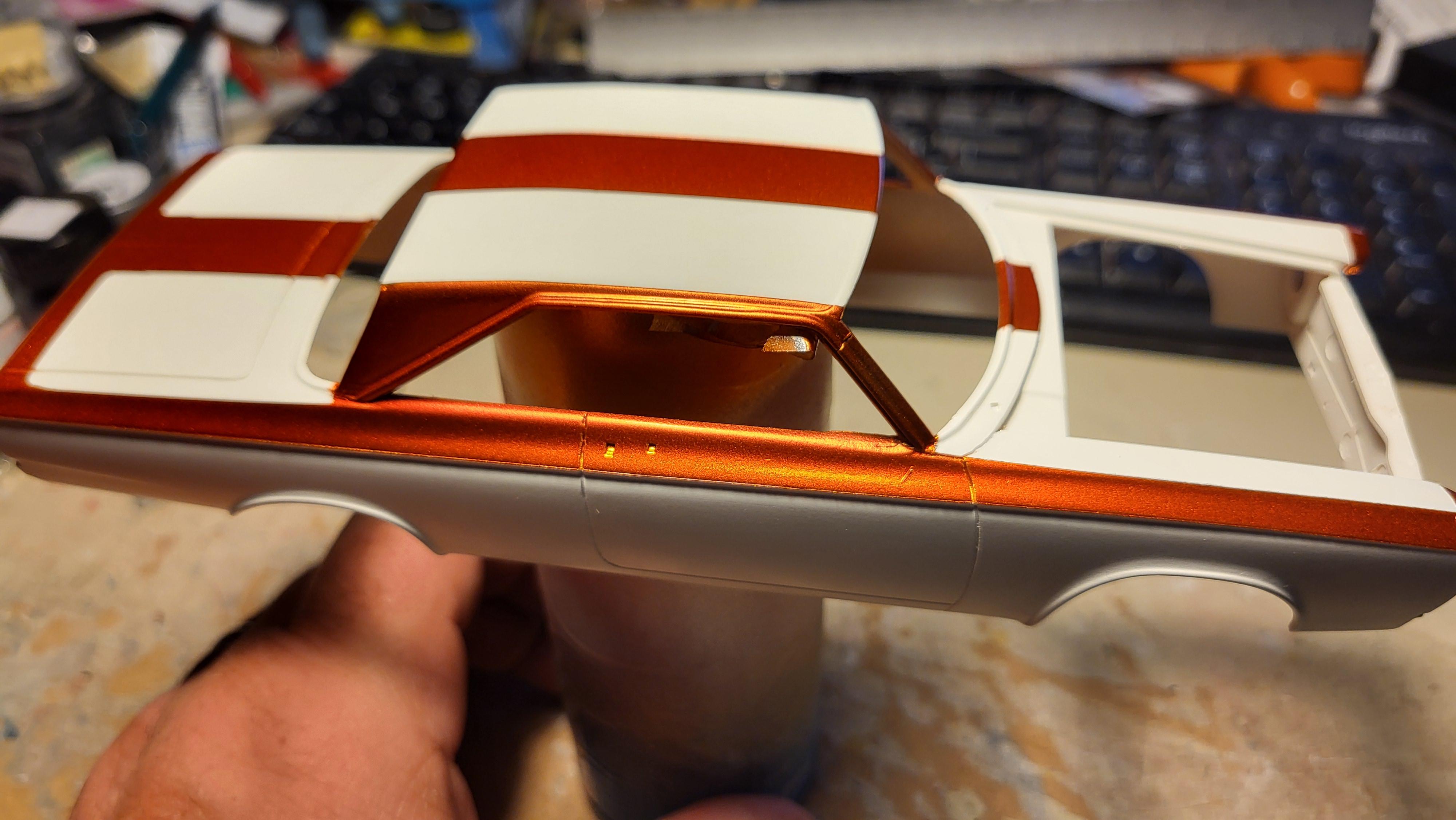

jjsipes Posted September 3, 2024 Posted September 3, 2024 Never tried this before, have had these House of Kolors bottles for close 20 years. Got them back at Walmart years ago and thought this would be a good candidate to try them out. Started with ScaleFinishes White Superprimer since I believed the HOK paints were alittle hotter. Then sprayed Automotive White, taped and sprayed Automotive Silver for a base. Mixed up the HOK Tangerine and airbrushed over the Silver. Looked great. Left dry for 4 days and sprayed Tamiya Clear over figuring it would be ok. Guess it wasn't ok. Does anyone have any experience with the line of HOK paints? 1
Mike 1017 Posted September 3, 2024 Posted September 3, 2024 I have used 10 year old HOK. I never encountered anything like this. The clear was the last step so it maybe the culprit. The paint on the trunk is way too thick. And could be the reason the clear reacted badly. Everything else looks OK. It will be interesting to see what others think. Good luck Mike

Ace-Garageguy Posted September 3, 2024 Posted September 3, 2024 This is the reason we constantly harp on TEST FIRST ON THE SAME PLASTIC YOUR MODEL IS MADE FROM, BEFORE YOU PAINT THE MODEL, with any product or combination of products you're not intimately familiar with. NEVER ASSUME PRODUCTS FROM DIFFERENT MANUFACTURERS OR EVEN DIFFERENT PRODUCT LINES FROM THE SAME MANUFACTURER ARE COMPATIBLE. TEST FIRST. 2
Ace-Garageguy Posted September 3, 2024 Posted September 3, 2024 (edited) 1 hour ago, Mike 1017 said: Yes, the Kustom Kolors line of House of Kolor paints is acrylic enamel. And if true, that right there answers the OP's question. You can NOT topcoat acrylic enamel with lacquer (which is what the Tamiya clear must be in this case) without risking exactly what happened to the OP. EDIT: Bob Downie, aka Zoom Zoom, is one of the most accomplished and knowledgeable car modelers on the planet. I've seen a lot of his work up-close-and-personal, it's absolutely top quality, he's been published in the model mags frequently, and I'd tend to take his word on just about anything paint-related as gospel. Edited September 3, 2024 by Ace-Garageguy 2

Skip Posted September 4, 2024 Posted September 4, 2024 Bob is correct, the HOK Acrylic Enamels should only be covered with (preferably) HOK Acrylic Enamel Clear or acrylic enamel compatible clear. Along with using a Lacquer based clear over an enamel, you may also be encountering a reaction between the primers as well, especially if they were not allowed to off gas completely. It is not a good idea to mix and match different manufacturers paints, they have already spent a ton of time and money on product Engineering, R & D, they know their system works. Automotive Primer is about the only thing that can be mixed and matched, even then it’s problematic as some manufacturers color coats are hotter than others Doing sign work and automotive graphic work, I’ve used those same Wal Mart HOK acrylic enamels I have covered them successfully with One Shot Enamel Clear, both flat and gloss, I always use a few drops of One Shot hardener both to speed things up and so I don’t encounter any reaction between the two different formulas. I also test my paint method, over the same substrate that will go on the finished (sign) work, so I am aware of what will or will not work before clearing a piece. 3

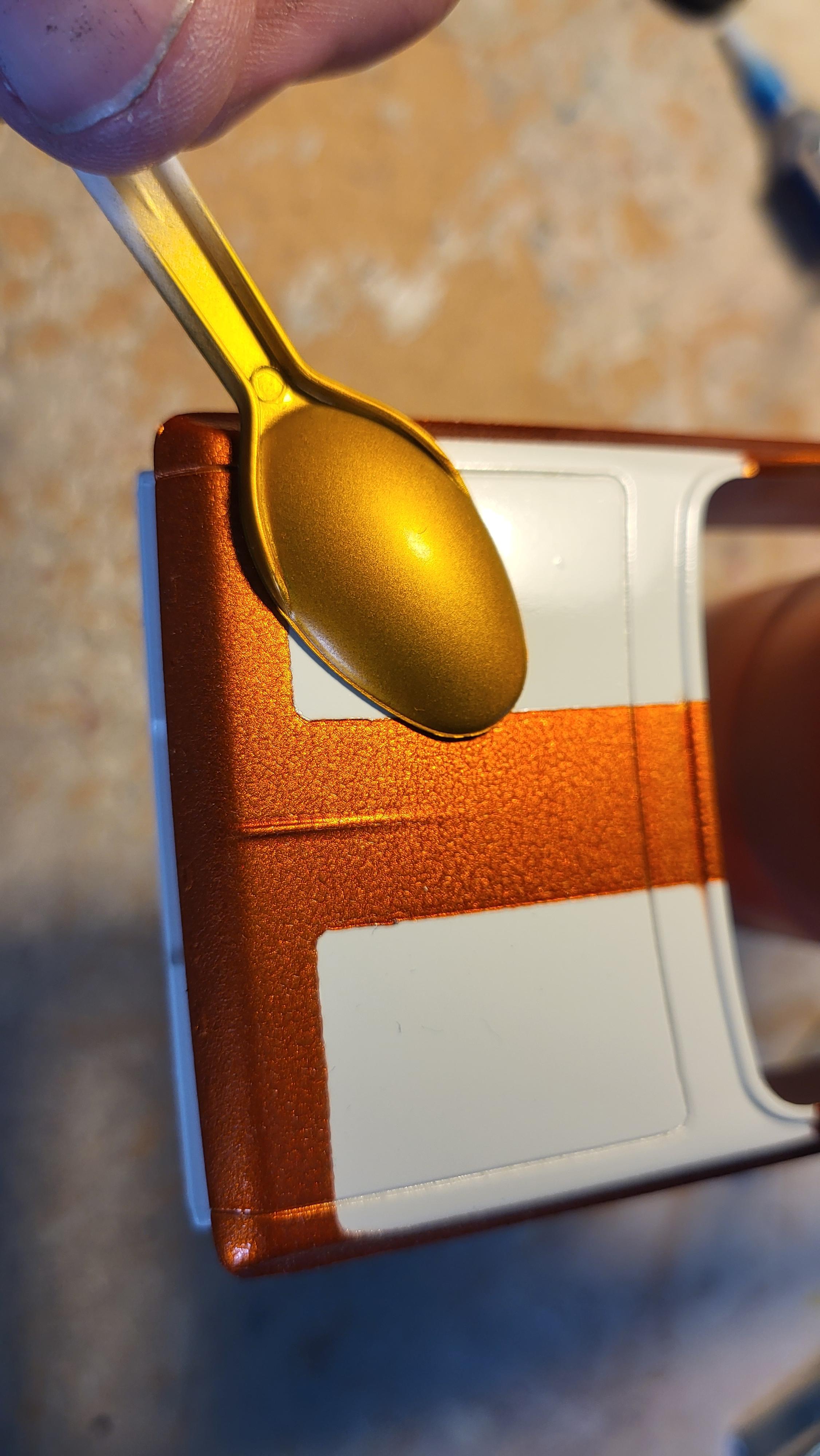

jjsipes Posted September 5, 2024 Author Posted September 5, 2024 3 hours ago, Ace-Garageguy said: It may have been mentioned before, but Tamiya has several nice silver lacquers for a base, and transparent orange, red, and yellow lacquers that should get you to "tangerine" with some experimentation. I thought as well so, I grabbed my Gold, Clear Orange and a spoon and tried that. That didn't work. I'll have to get some Silver to try. 1

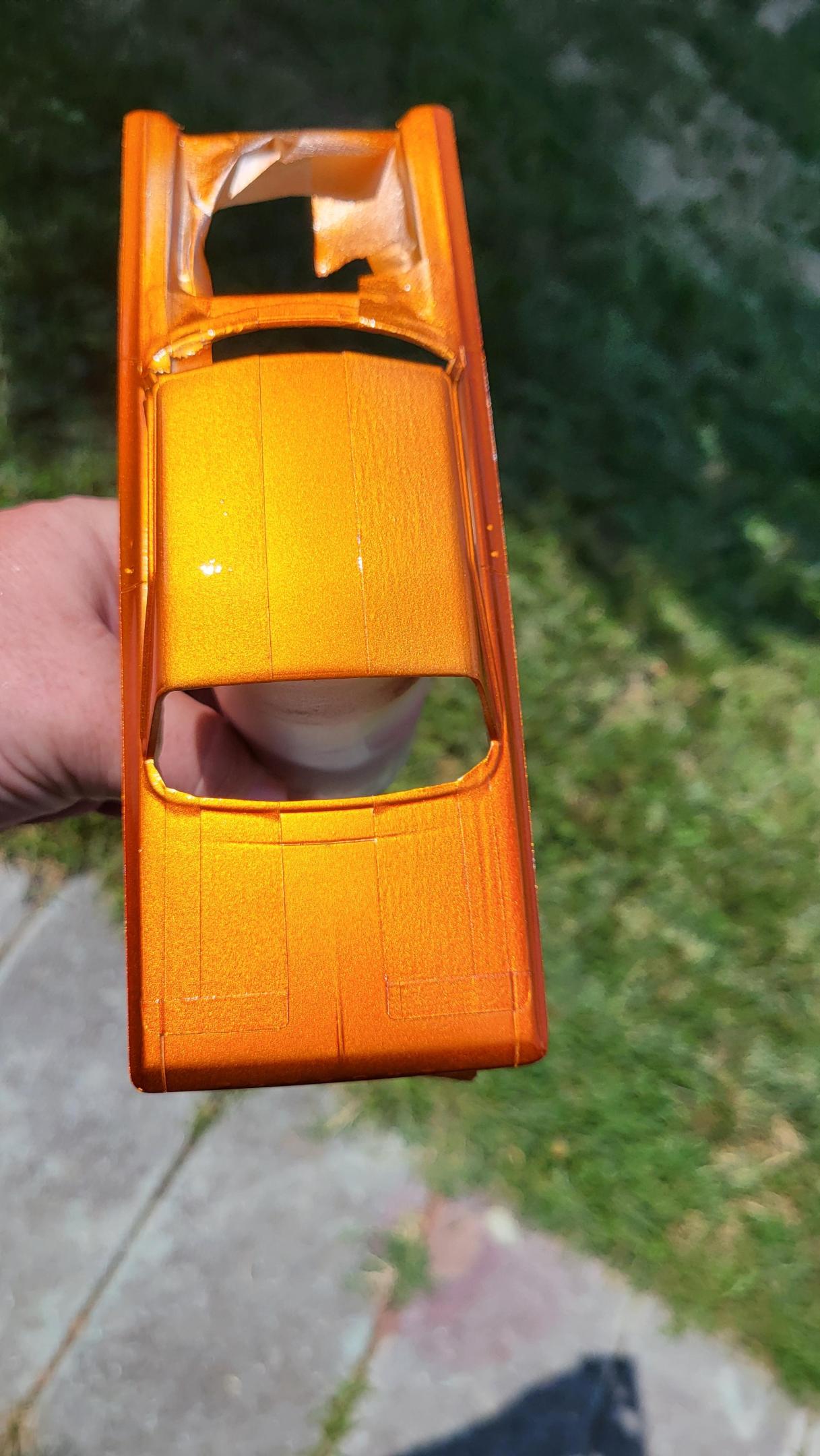

peteski Posted September 5, 2024 Posted September 5, 2024 I have feeling that if you took some Tamiya clear red and mixed it with clear orange, you could get a color which is close to your original failed paint. To me it looks like it needs to be more red. Silver base coat will make the orange paler than a gold base coat. 2
