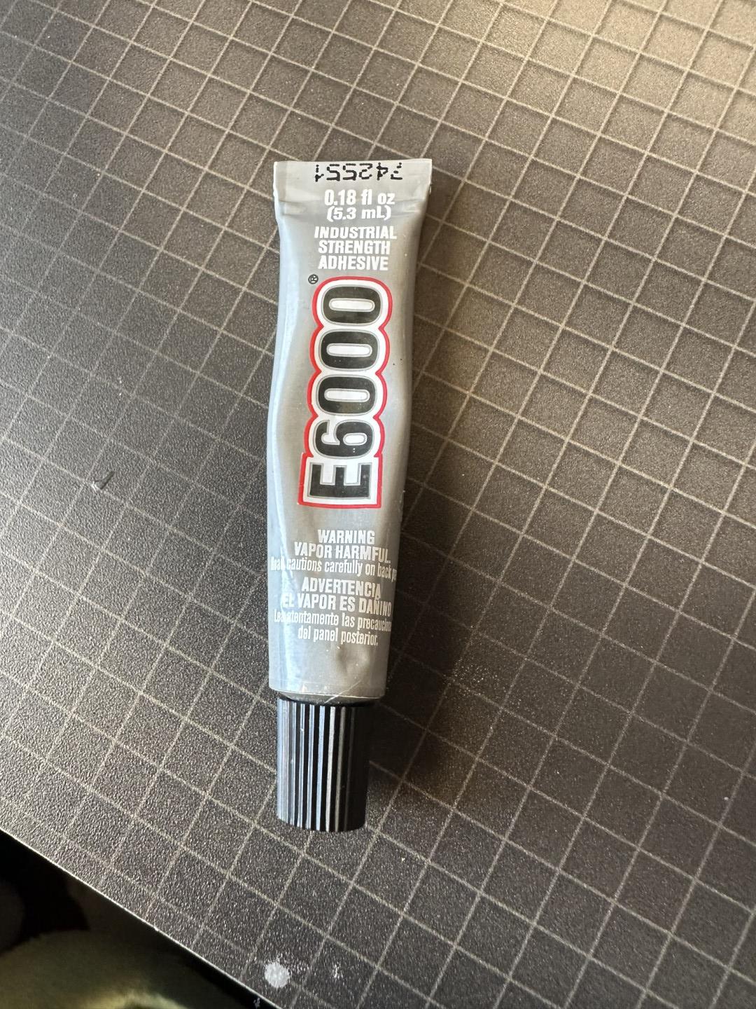

hedotwo Posted May 6 Author Posted May 6 I put a bit of this Clear Grip on a piece of styrene and an old junk windshield to see what might happen. 24 hrs later I saw no fogging or discoloration around the sample spots. I was able to remove one of each by pulling on it with a tweezers and it came off kind of like gum, but I wouldn't say it pulled off easily. Underneath you can see it was biting into both the clear and the white sheet. Not bad, but it was there. I also did a test with E6000 clear adhesive (from Hobby Lobby) and the results were similar. 1 1
