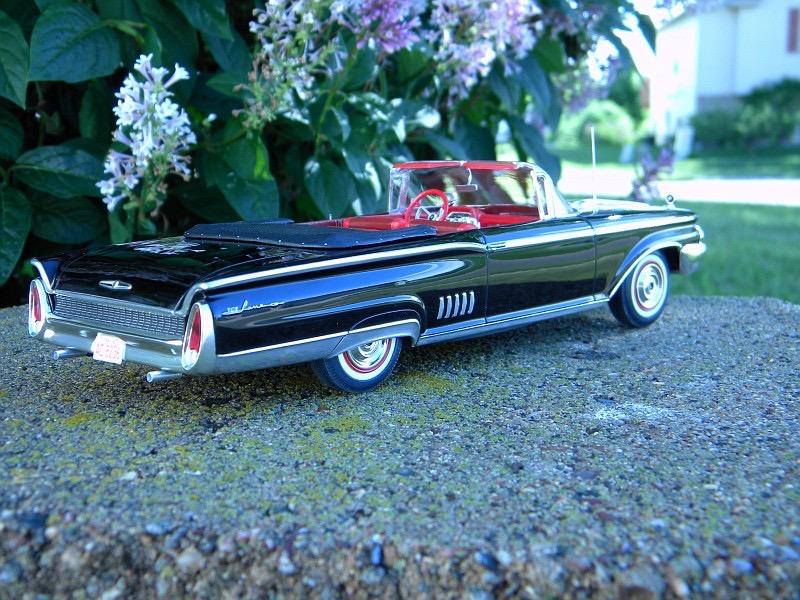

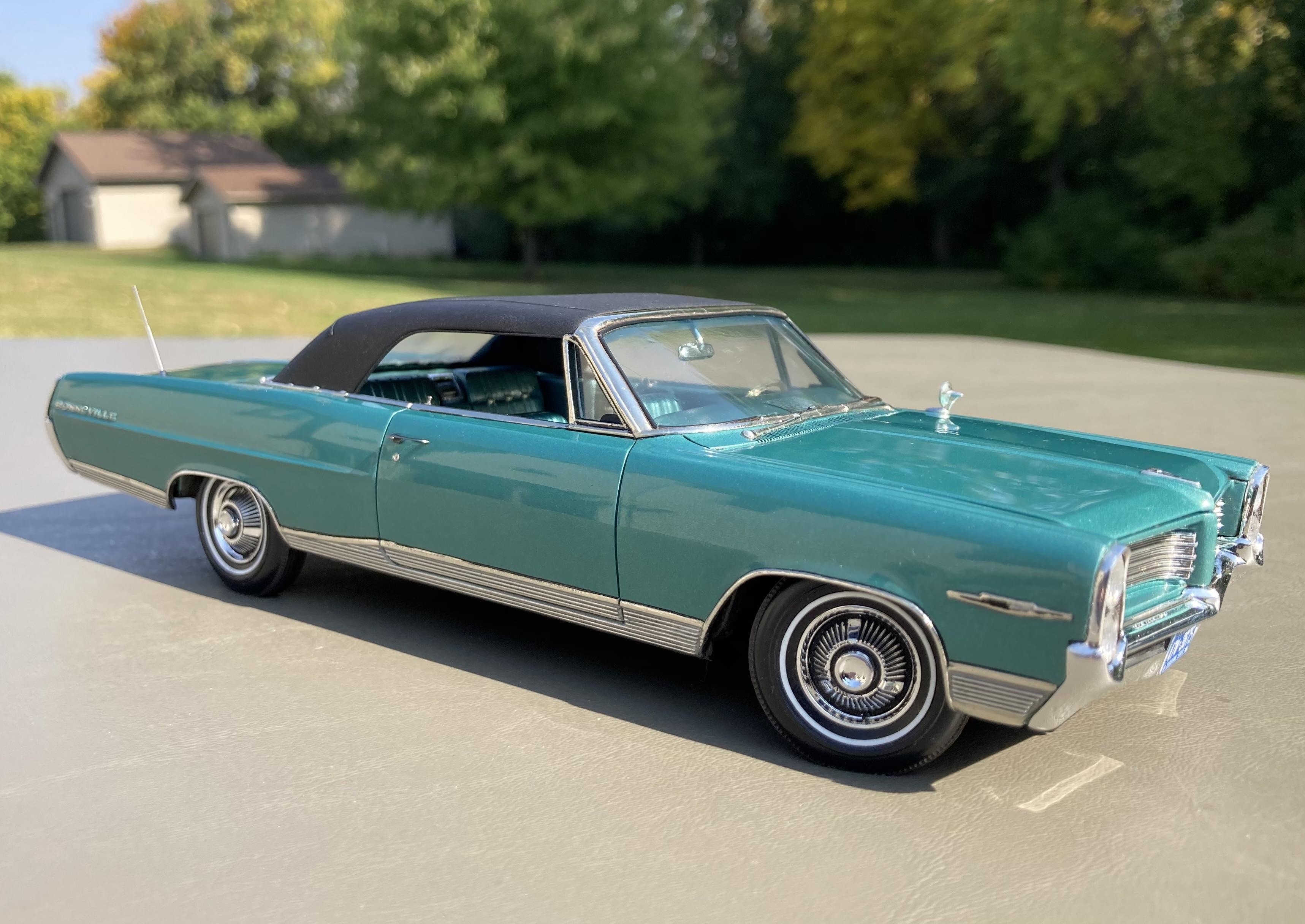

StevenGuthmiller Posted May 18 Posted May 18 I made the decision to use automotive type lacquers many years ago for a number of reasons, and as any color that you can imagine is available in pre-mixed, ready to airbrush jars through after market providers such as MCW and Scale Finishes, I can find no reason to use anything else. Lacquers such as this are easy to work with, spray beautifully, lay down super thin and smooth, dry and cure extremely quickly, and as they’re lacquers, there’s never any of the unnecessary drama of finding what clear will work over it, and what won’t. There are vast advantages over most enamels, such as a much reduced tendency for runs, sags, fish eyes, detail hide, pooling and draw away from ridges. Not to mention the often extremely long drying and curing times and finicky re-coat recommendations. If you’re main objective is something that you can slap on fast in one or two coats, enamel might be your choice, but if you want a truly high end, professional paint finish without a lot of rigmarole, lacquer is the only choice in my opinion. I use a multiple coat system consisting of a number of coats each of lacquer primer, color and clear, followed by cutting and polishing, and I’m very rarely disappointed, and almost never required to remove the paint to start over. Steve 3
