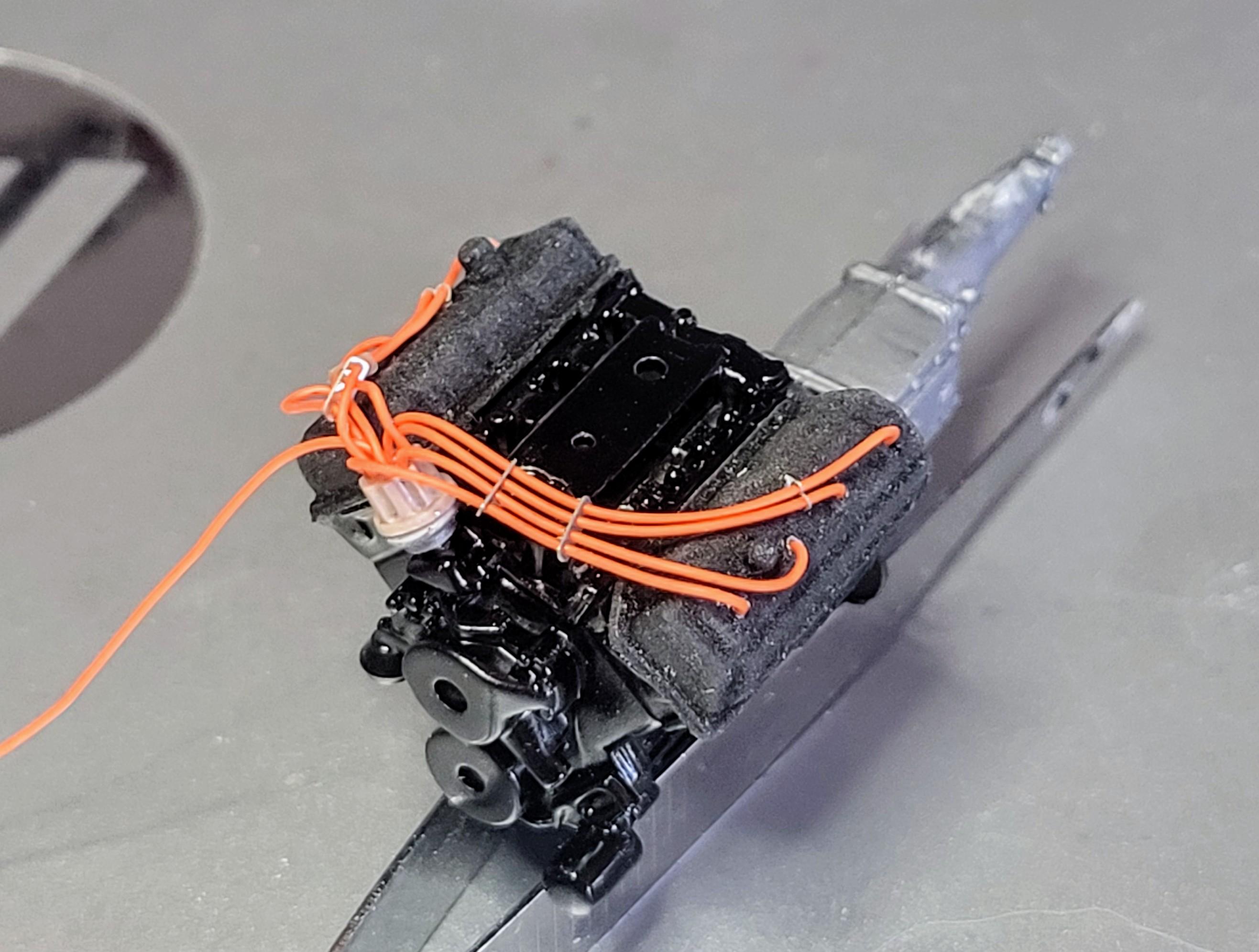

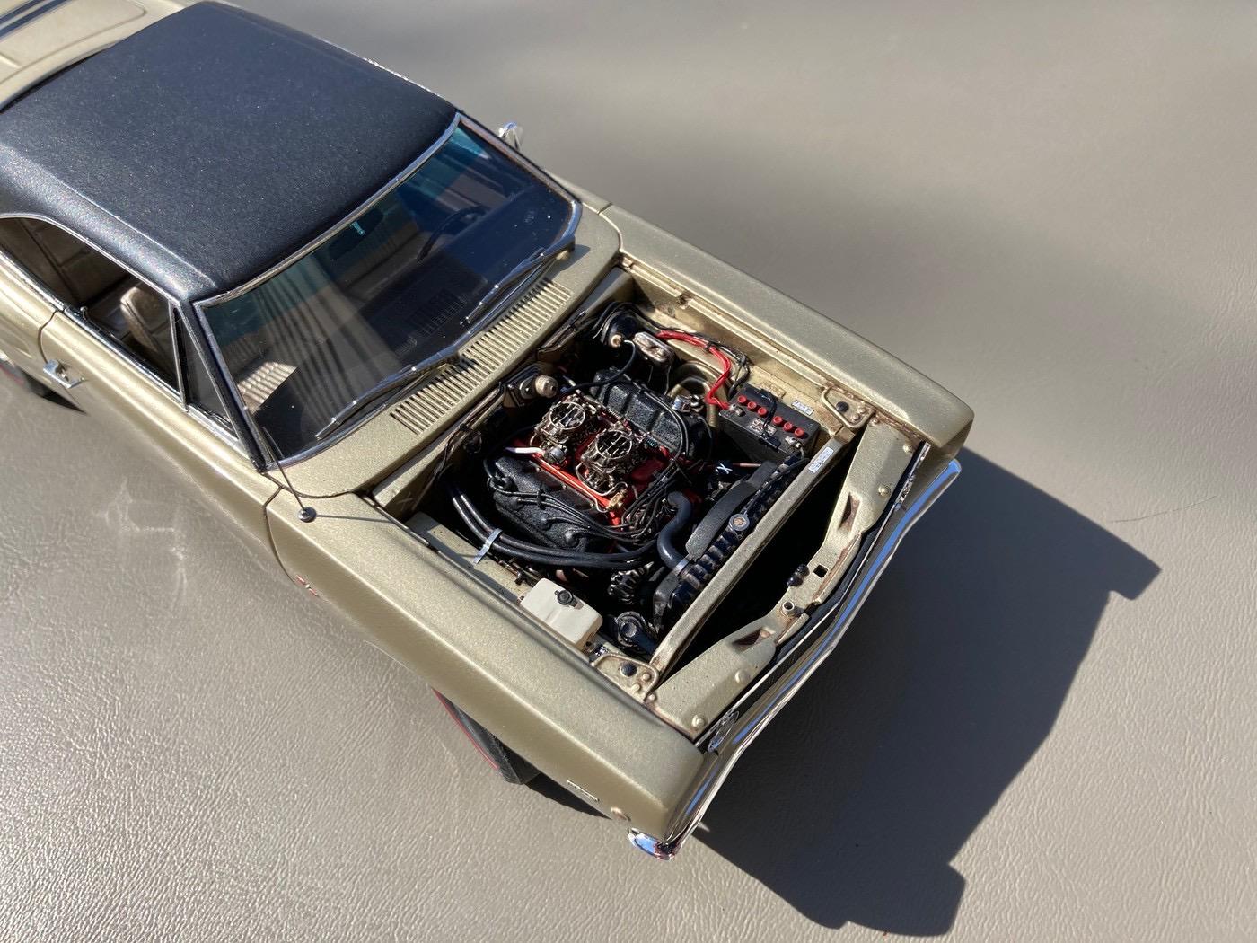

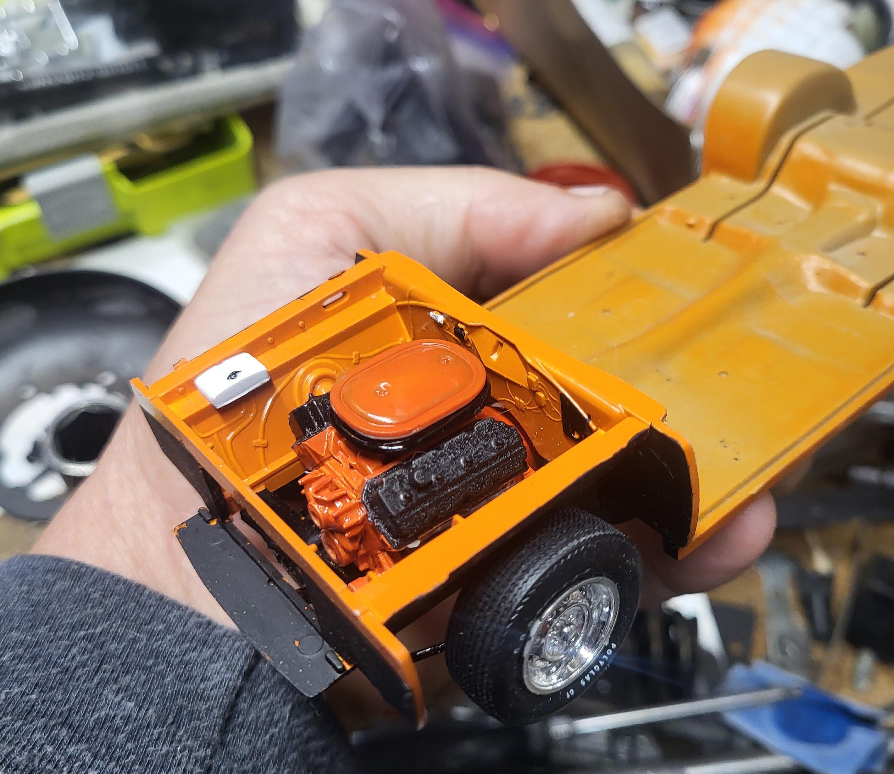

I would think that just a light dusting of paint from a couple of feet away would create enough of the basic affect that you’re looking for.
I’m not sure of the Ferrari finish that you’re trying to replicate, but the “dusting” technique looked satisfactory to me for the Hemi valve covers in my ‘68 Coronet.
698439B3-399A-4FCC-A931-9142FC778830.jpeg.39cd5567dec57f4dee6d52e0437e0bbb.jpeg120DA6C1-7B83-468D-A9C7-F4E29B49B89E.jpeg.8fda253f845db49502a7c416d9a1459b.jpeg
Steve
*SWOONNNN!!* 😍😍

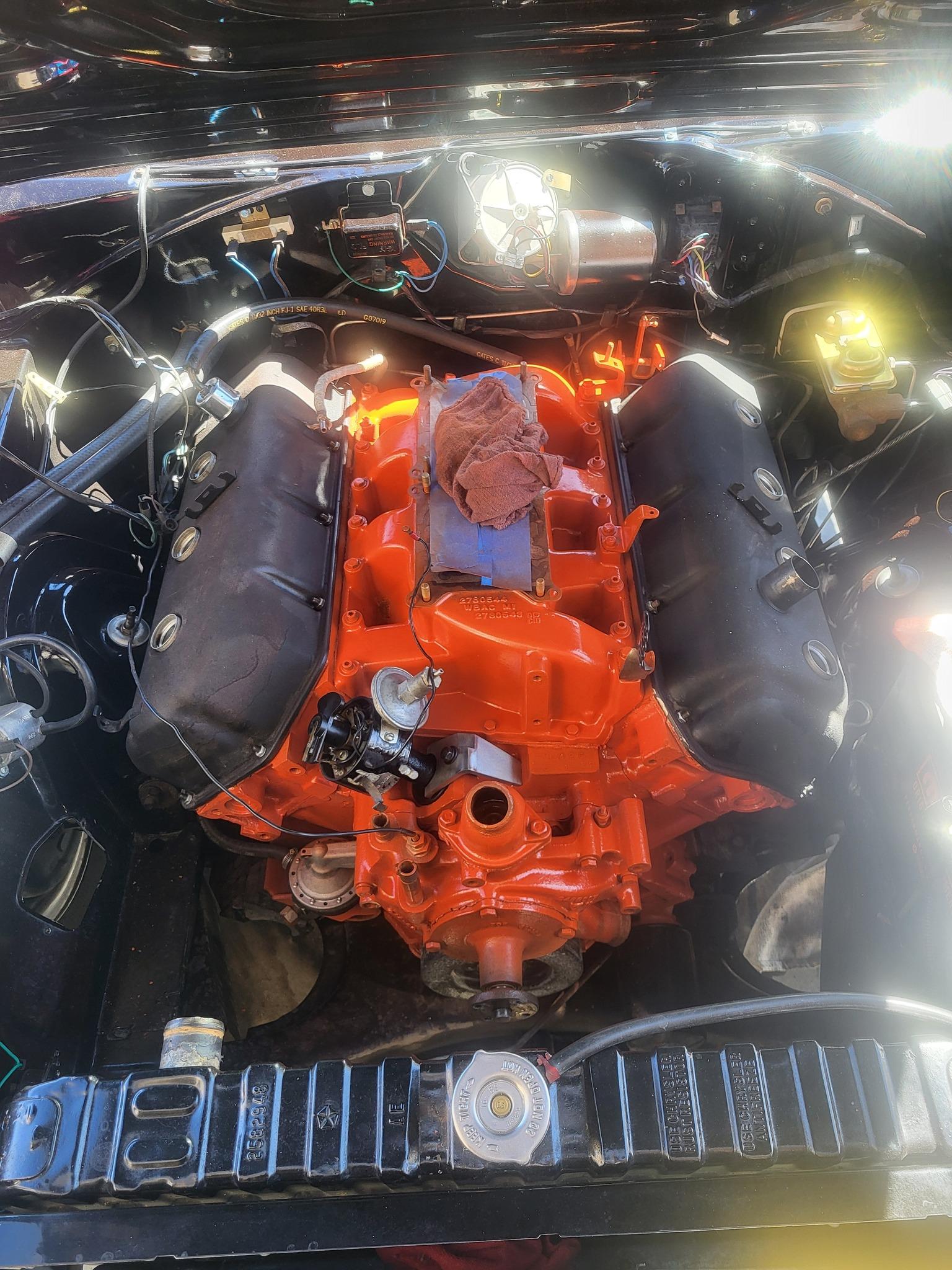

I'll add a picture of the actual hemi valve cover Im trying to replicate

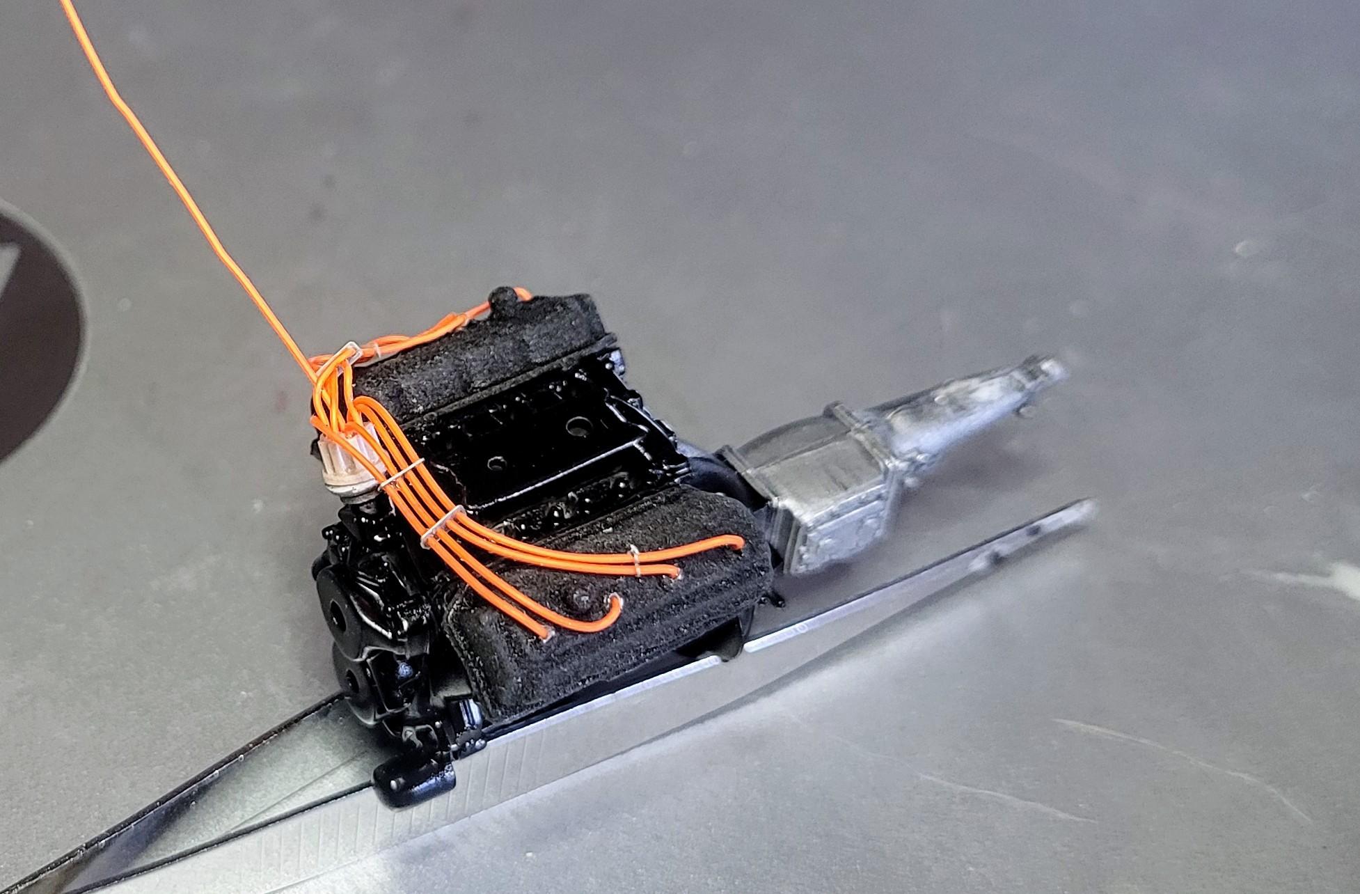

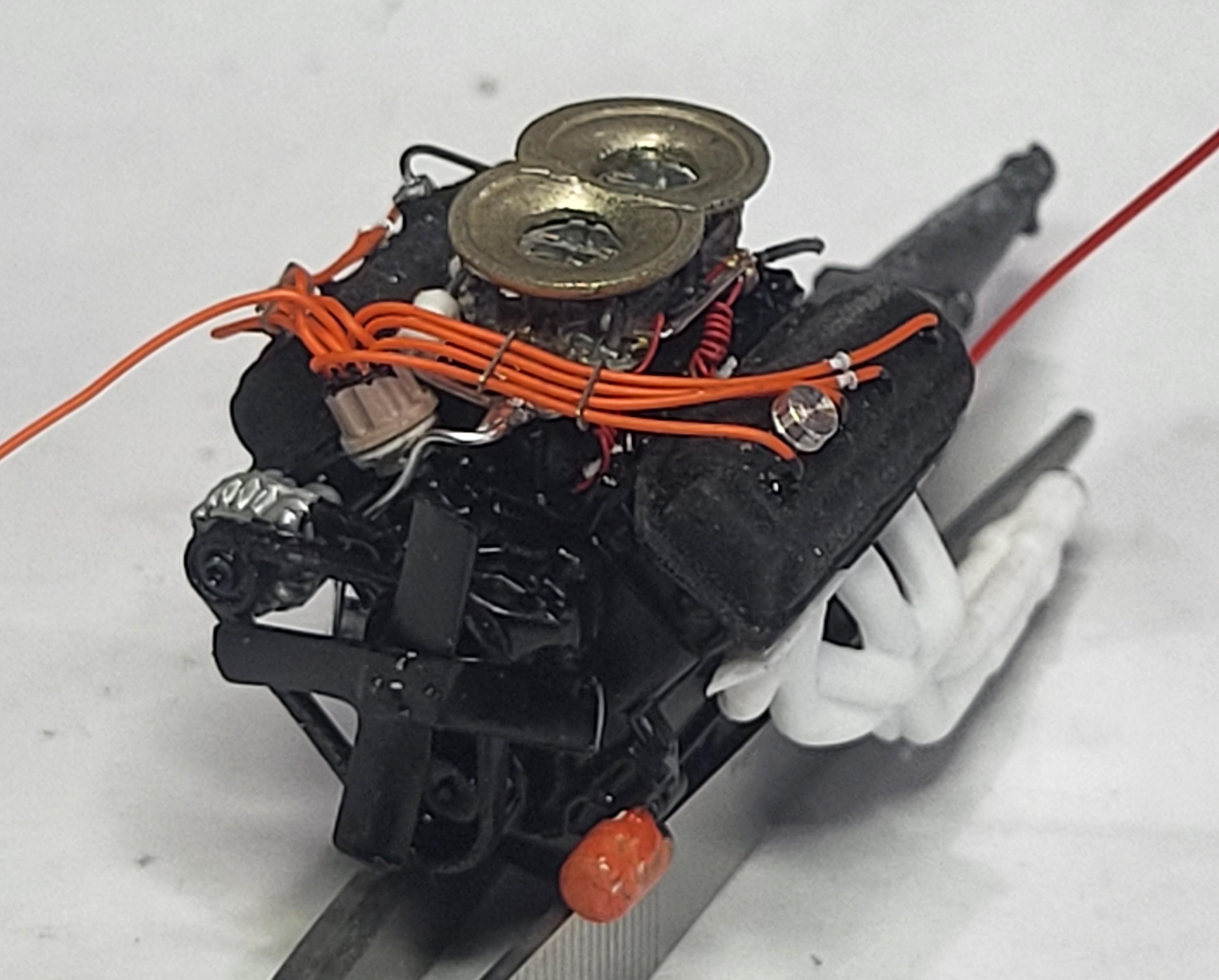

I still think the “paint from a distance” technique looks just as good as anything else, and it has the added benefit of not requiring any special materials be purchased or any new techniques or equipment is needed.
Pretty much exactly the same process I use for vinyl tops.
Sometimes basic and simple can get you where you want to go without overthinking the subject.
Just my opinion.
IMG_3605.jpeg.e400f3d4f77425060f75381de5db7fae.jpeg120DA6C1-7B83-468D-A9C7-F4E29B49B89E.jpeg.026c3f14b3d3260e6e20c9f7d548b45e.jpeg
Steve
  • Like 3

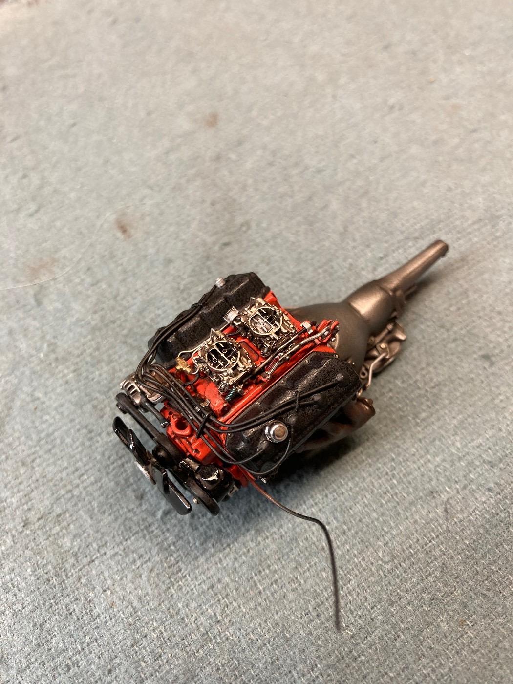

Since I am in a bit of a building slump right now…I did a quick test. The bottom piece of Evergreen is blasted with crushed glass which is way too aggressive, but it’s what is in my cabinet. The top one is sanded fairly smooth with 800 grit. The blasted one is sprayed with slightly thinned Tamiya LP-21 Italian Red. The smooth one is sprayed with un-thinned LP-21 from a distance of about 8-10”. I think even blasting with a finer grit could possibly damage or obliterate the raised lettering on the cover.
