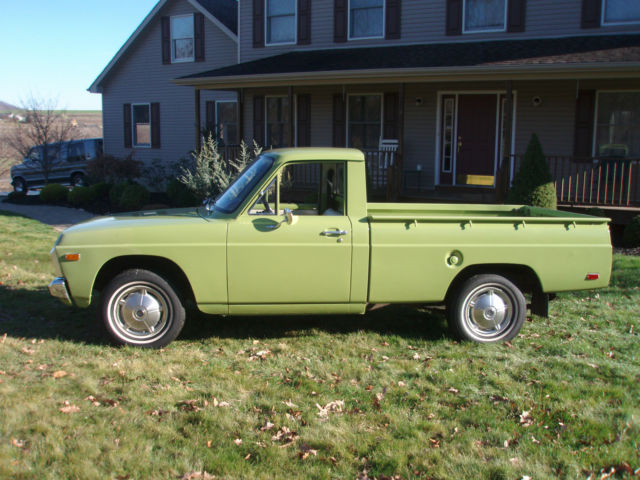

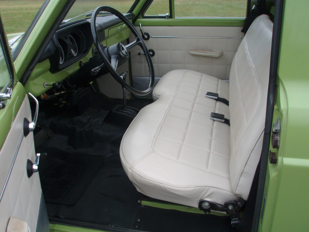

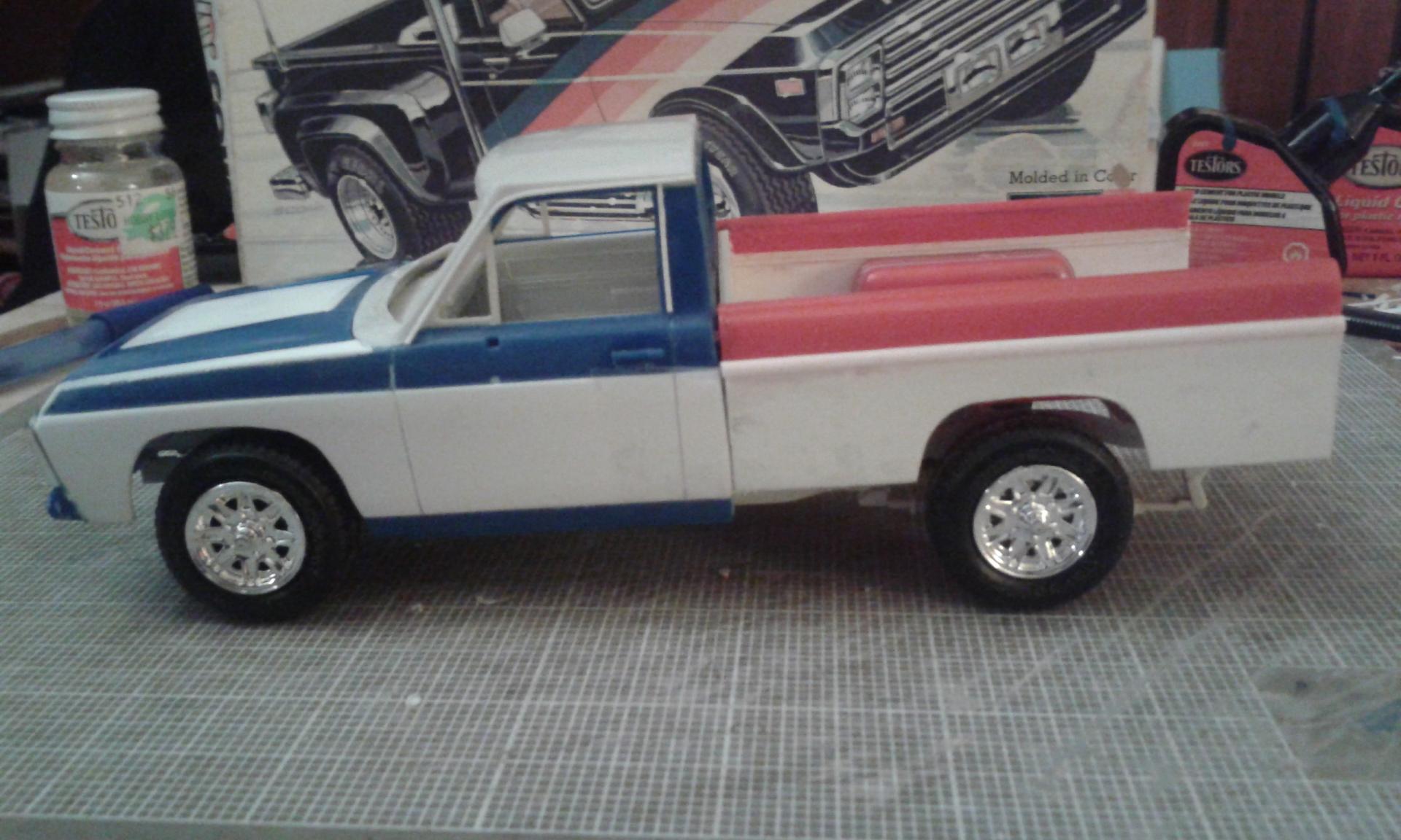

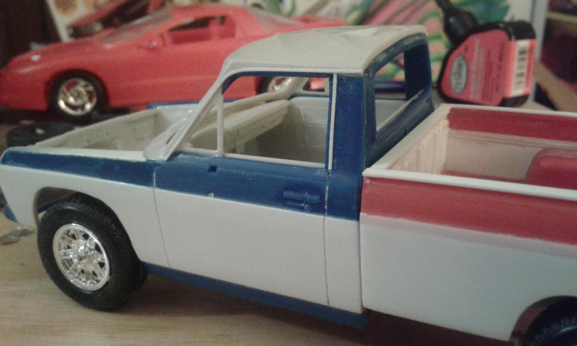

Fred, compare the cab of the Revell Courier to the photo of the real truck. Look at the windshield and vent window area. The roof is clearly more upright on the real truck. Besides, the box even says their kit is chopped. Use the AMT Courier for your chassis and interior, it's clearly the best and most correct example available. Mazda didn't change the truck much under the skin. Even though the body looks newer, closer look shows the update was just cosmetic and not structural. I've wanted to make a stock Courier forever and once I discovered the cab detail facts, I was off and running. Good luck with your build. This is the truck that inspired the bed. It's someone else's pic I found online. Even though the creases don't line up, and the bed as a whole is incorrect, the curve of the top of the side panels matches the cab, and the inside of the bed is right, so that was my basis. -

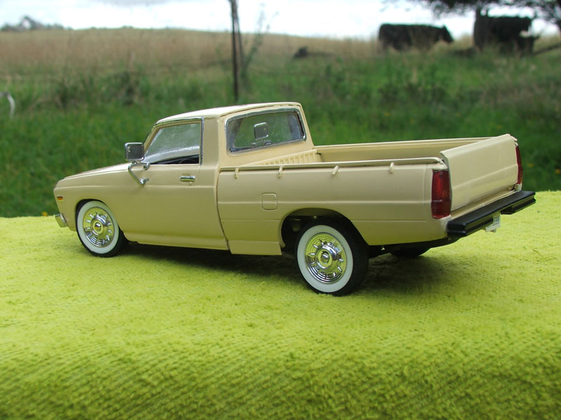

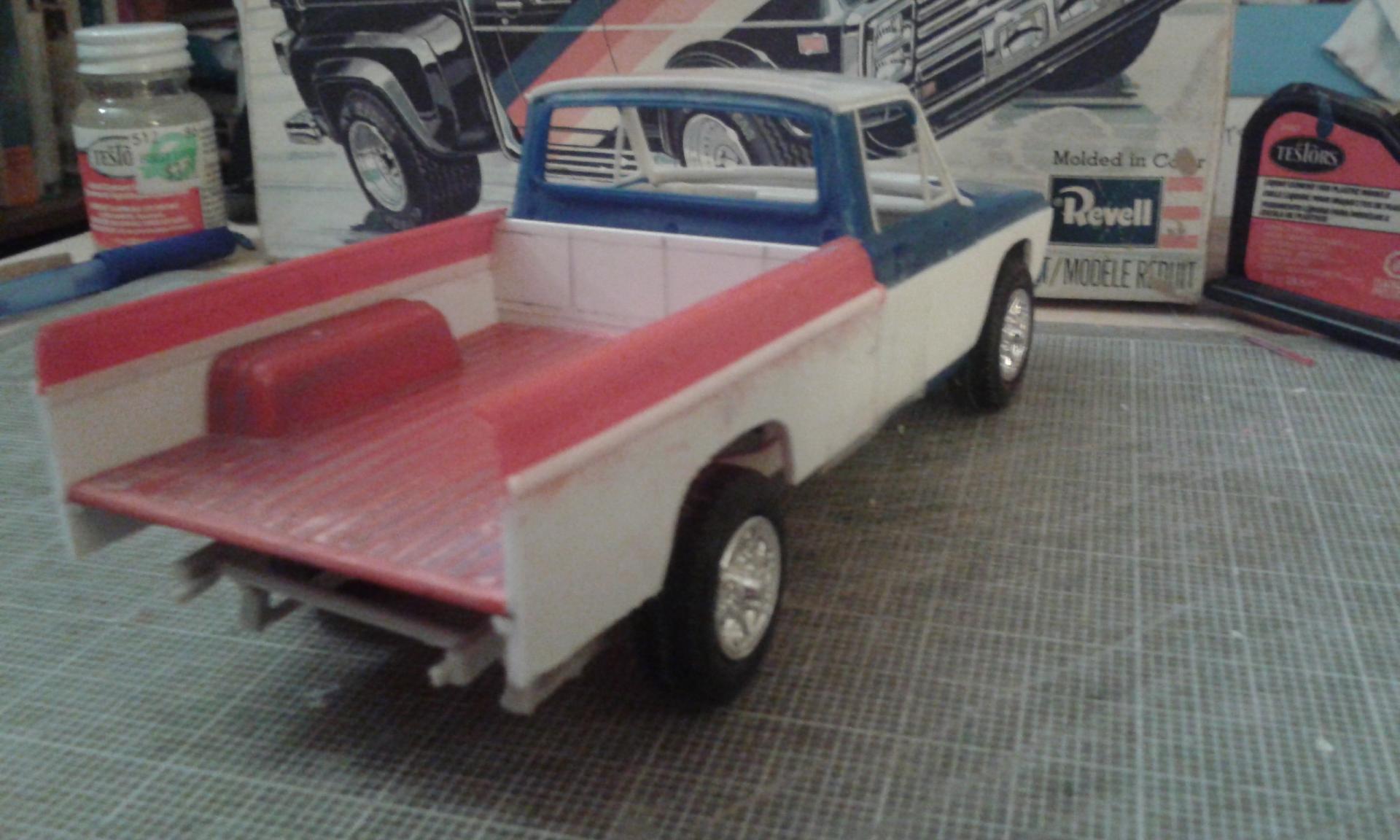

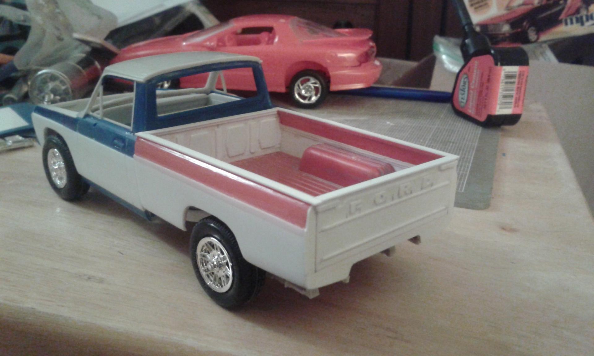

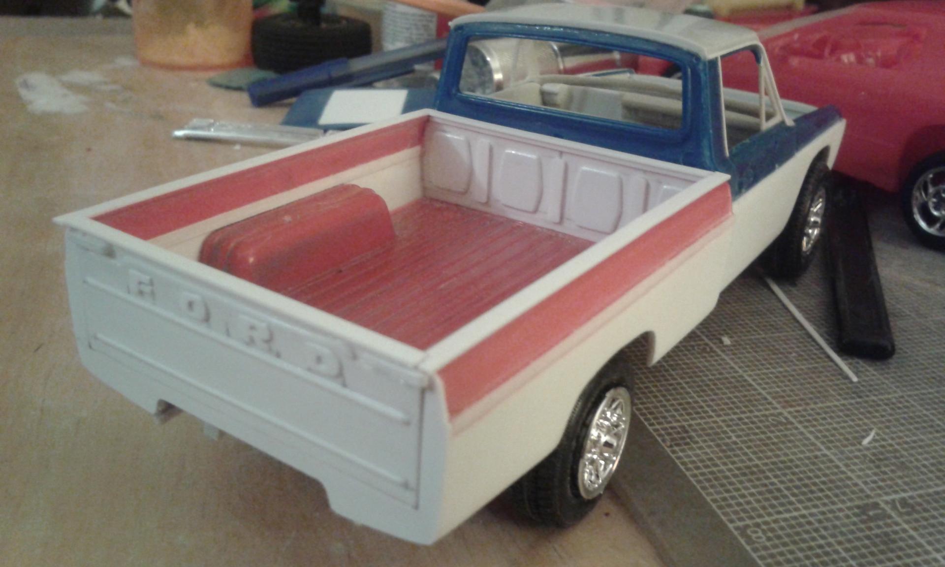

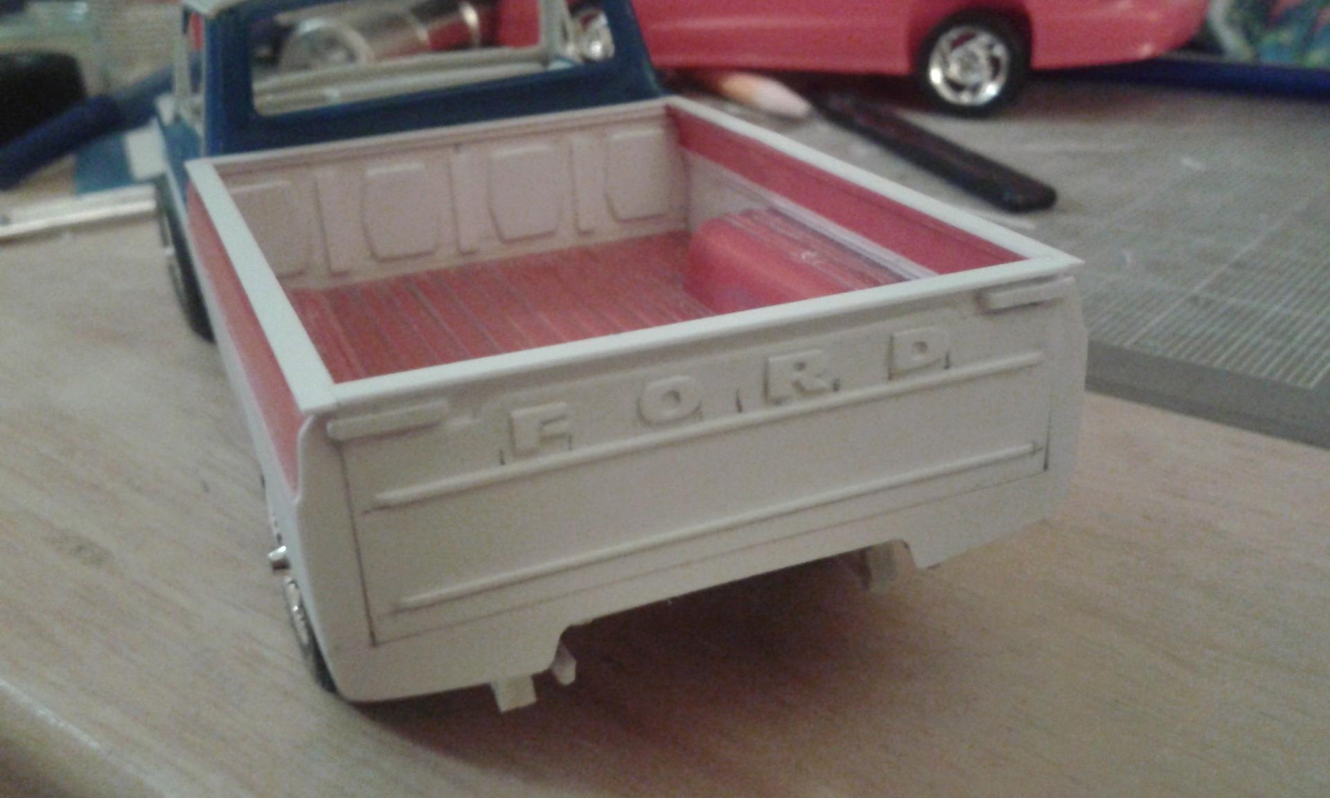

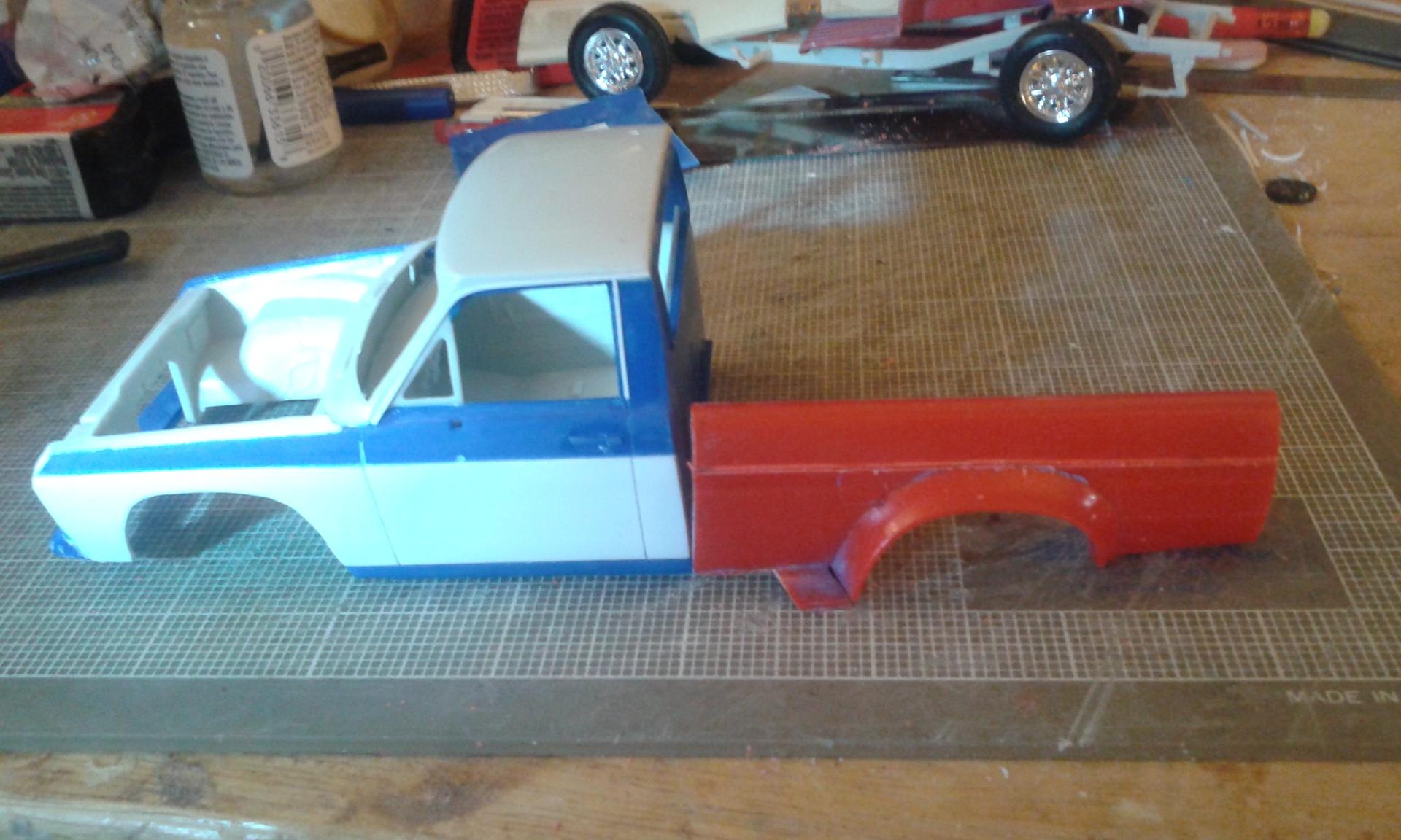

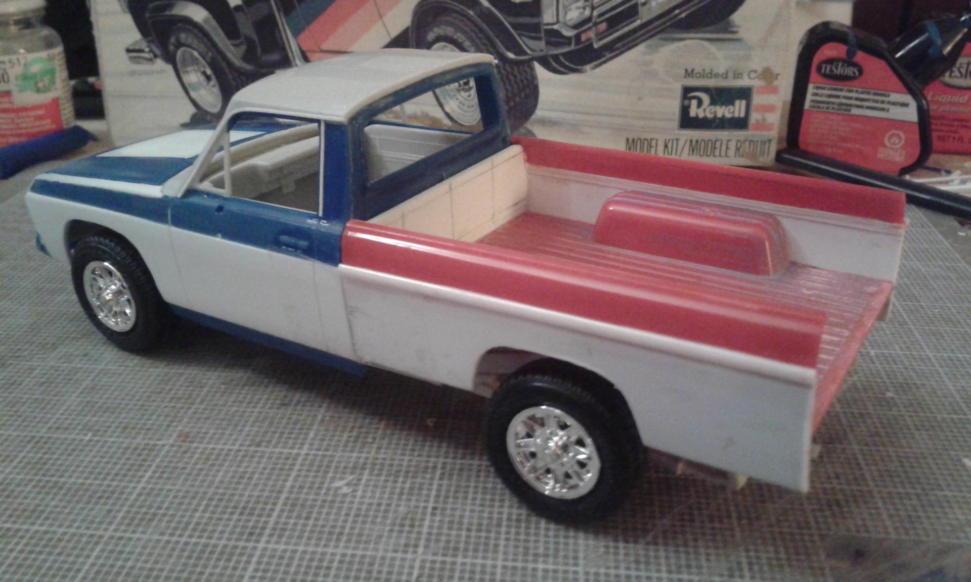

Next up was figuring out how to make the stock fleetside bed. Which alluded me until I happened to find a Dodge D50 box laying around. I sized it up and found it had the perfect curve to the back of the cab, and the bed floor. I used more sheet plastic to finish the sides, tailgate and bulkhead. The red areas are from the D50. I had to cut the hexagon shapes on the bulkhead and the FORD letters on the tailgate from scratch. Color may end up mustard yellow, pastel blue or olive green - all stock colors, I haven't decided yet. Comments? -

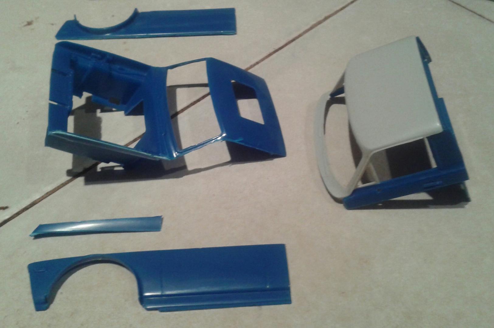

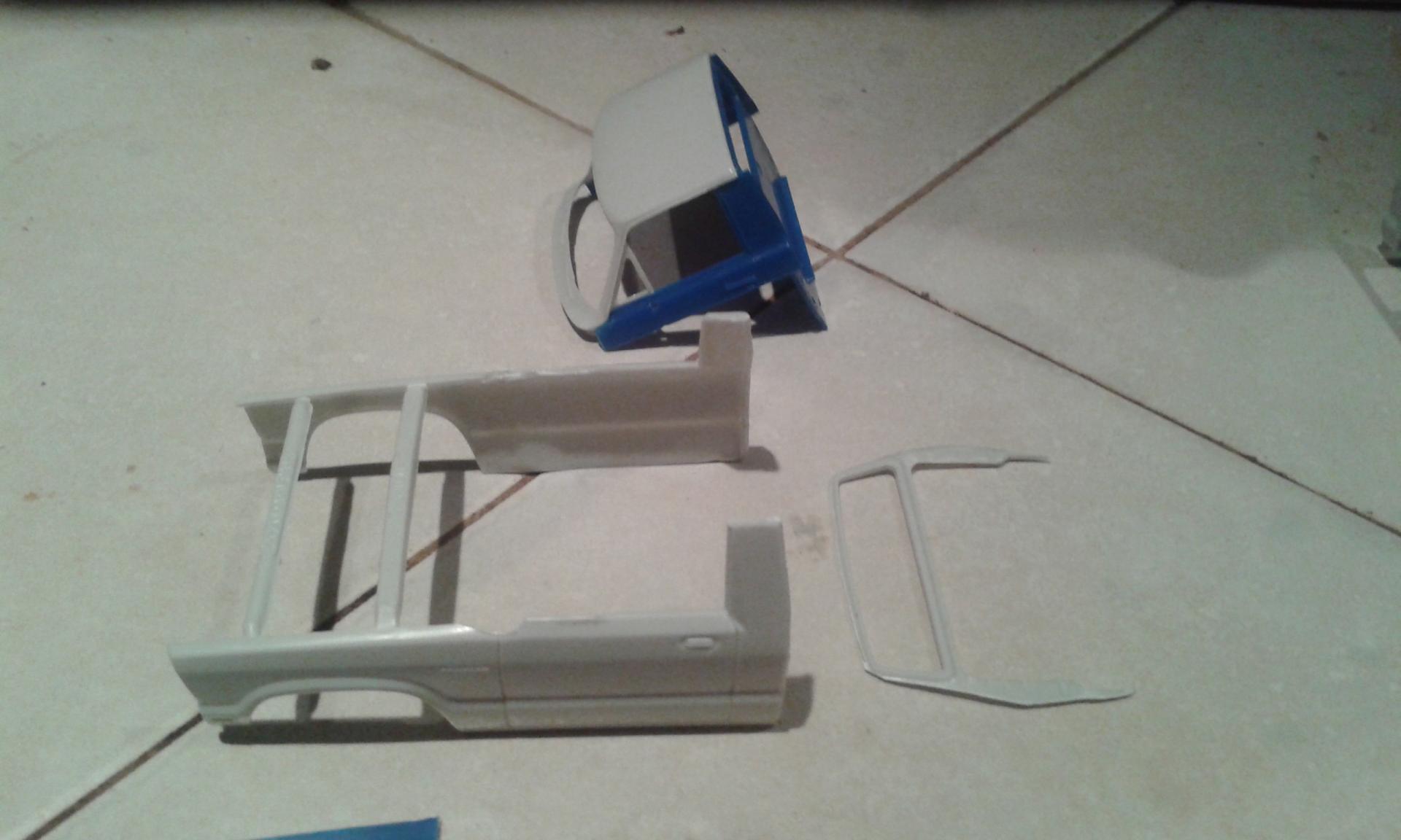

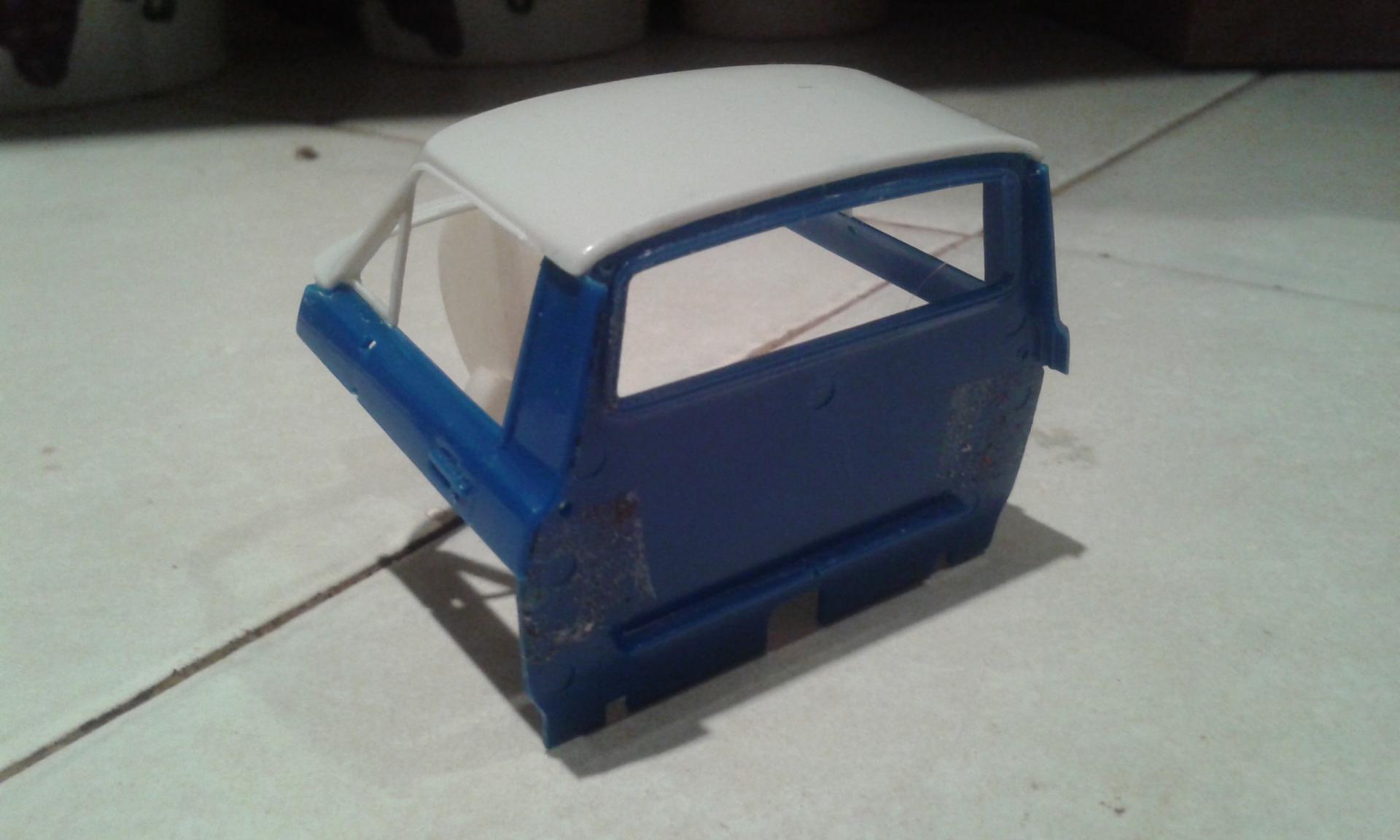

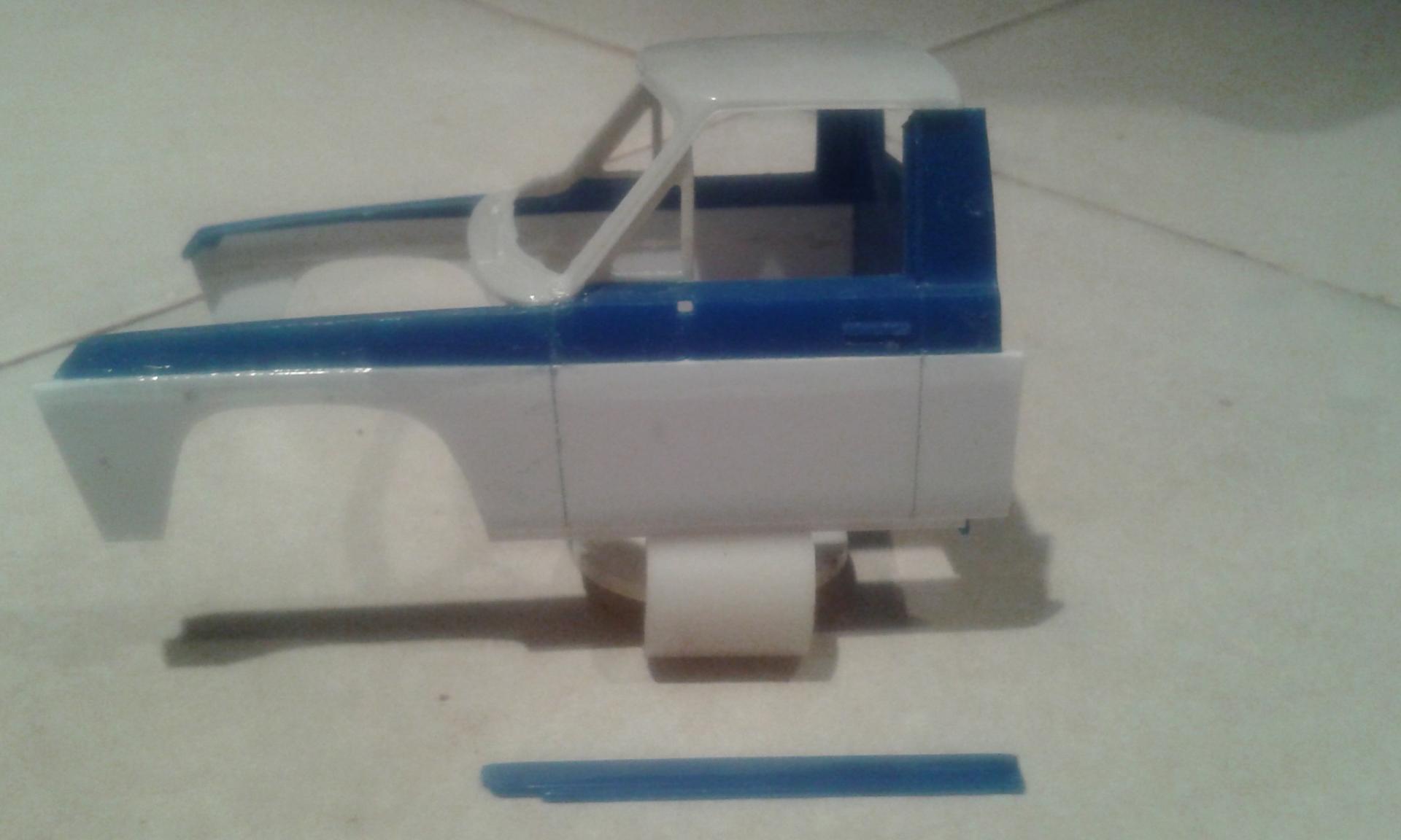

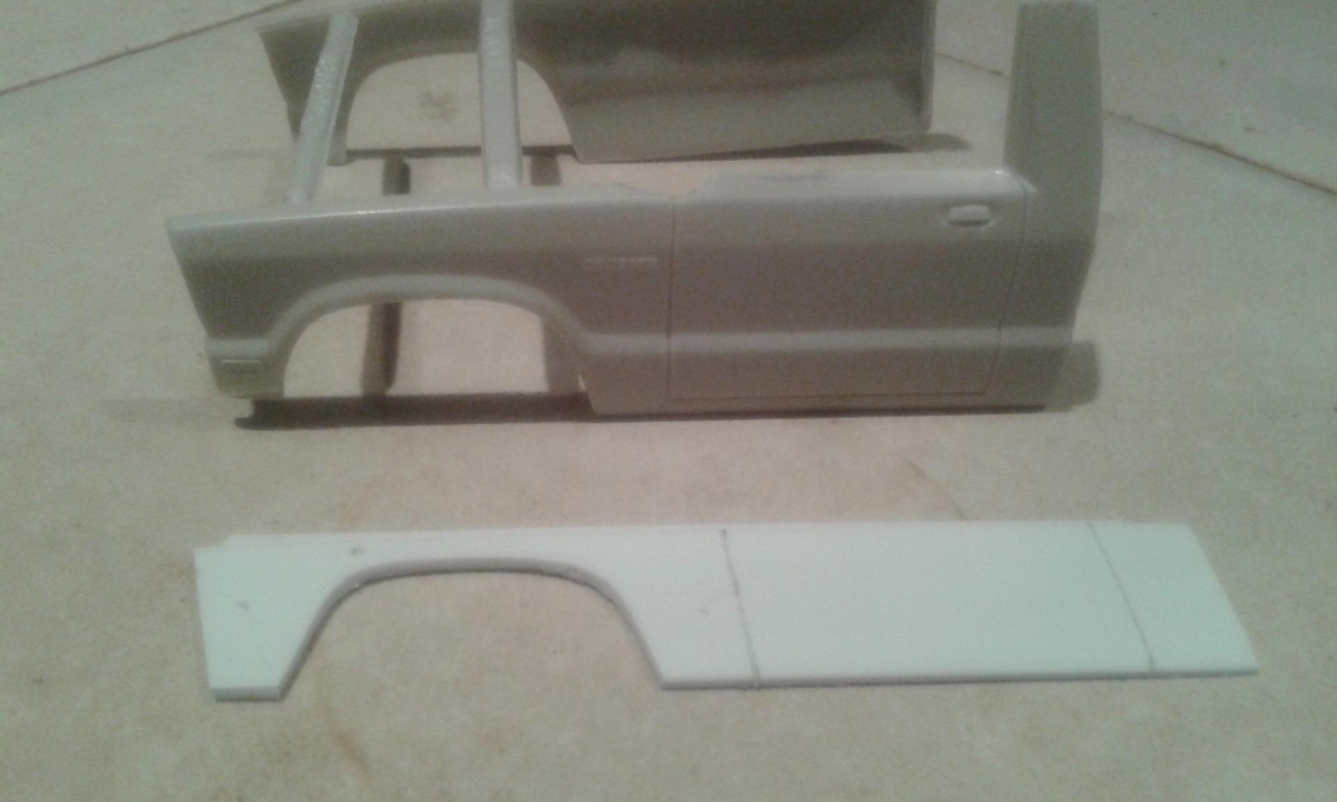

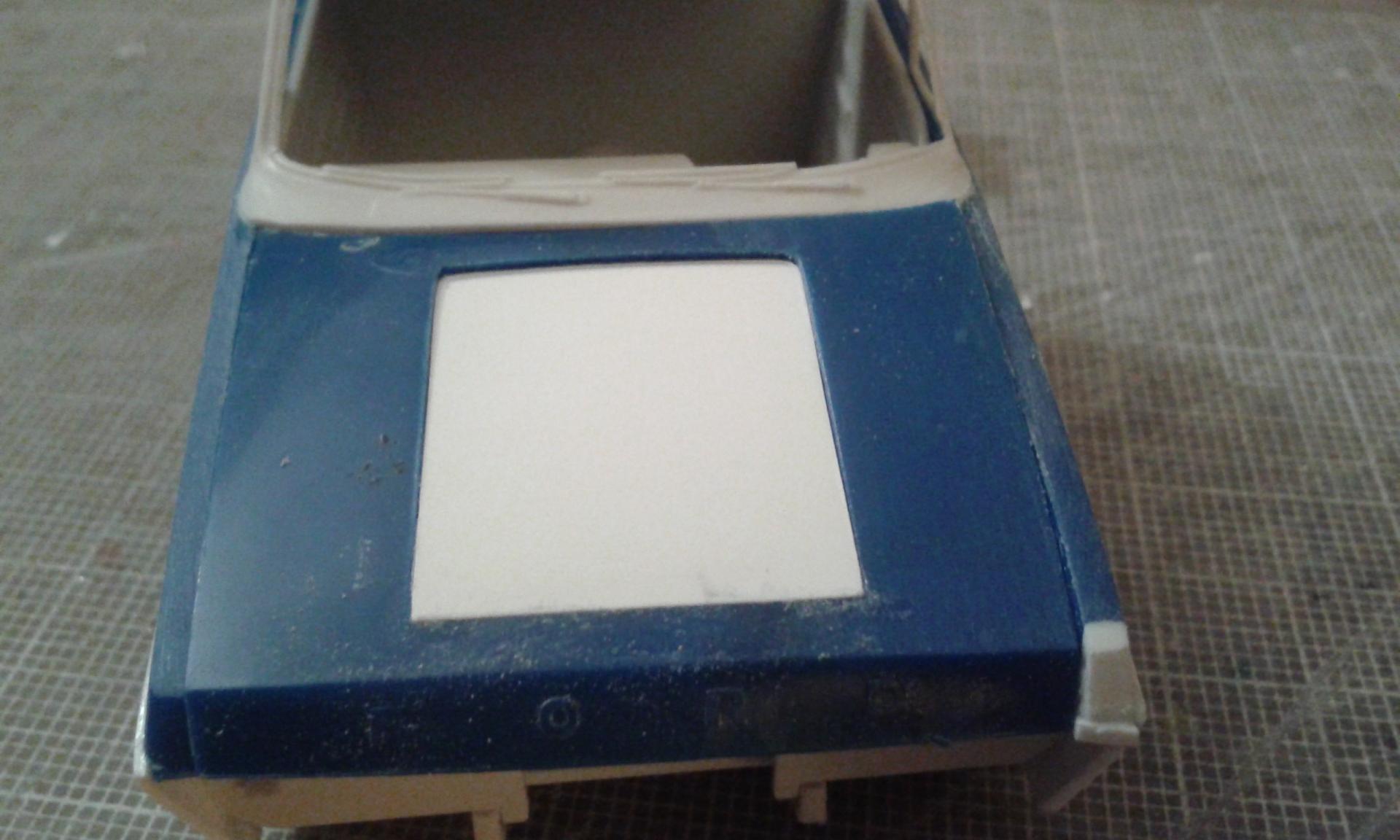

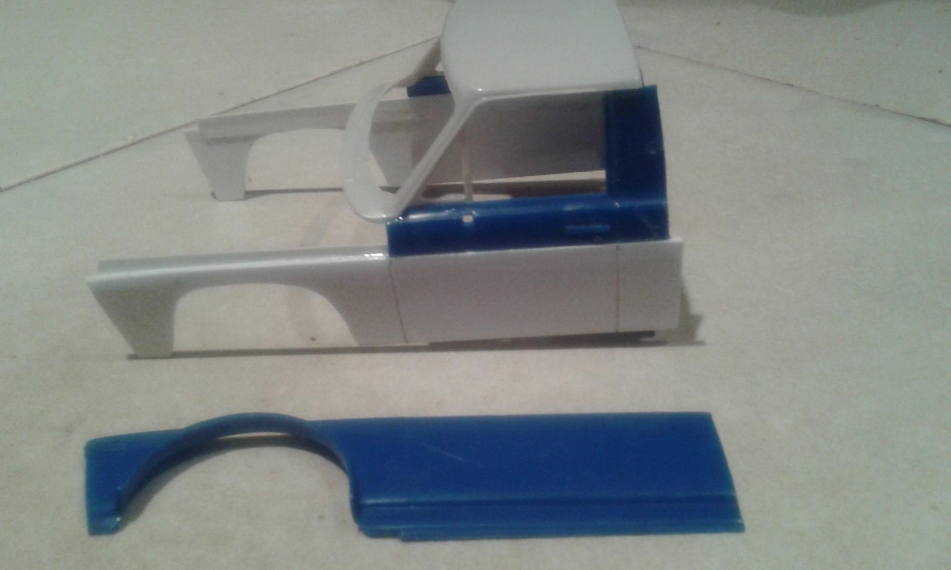

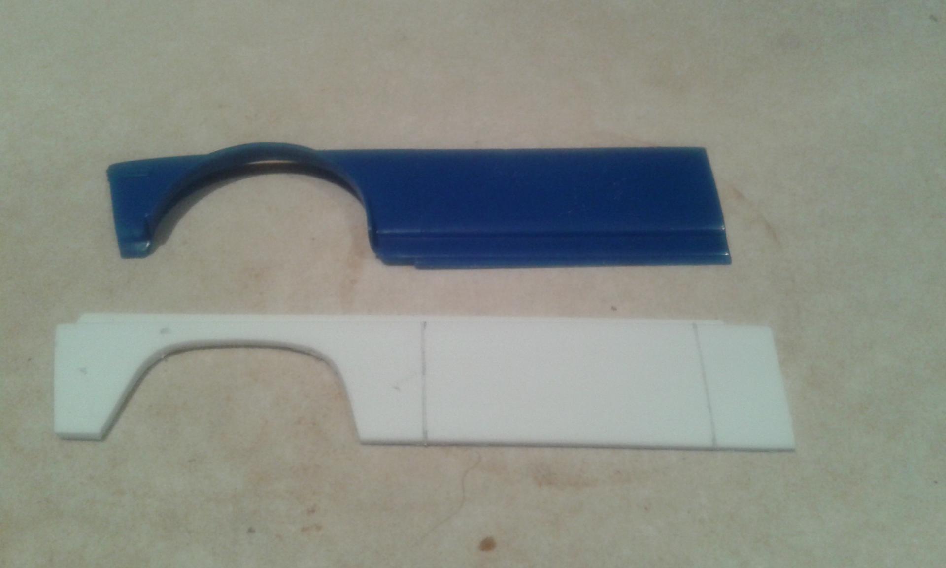

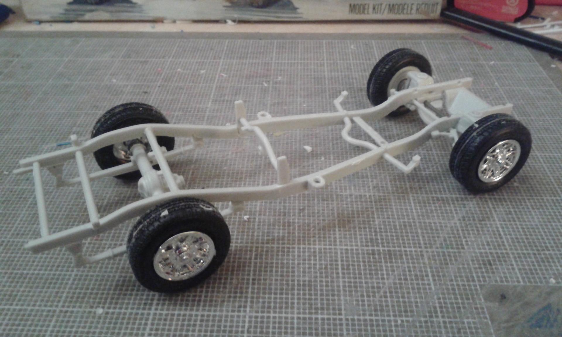

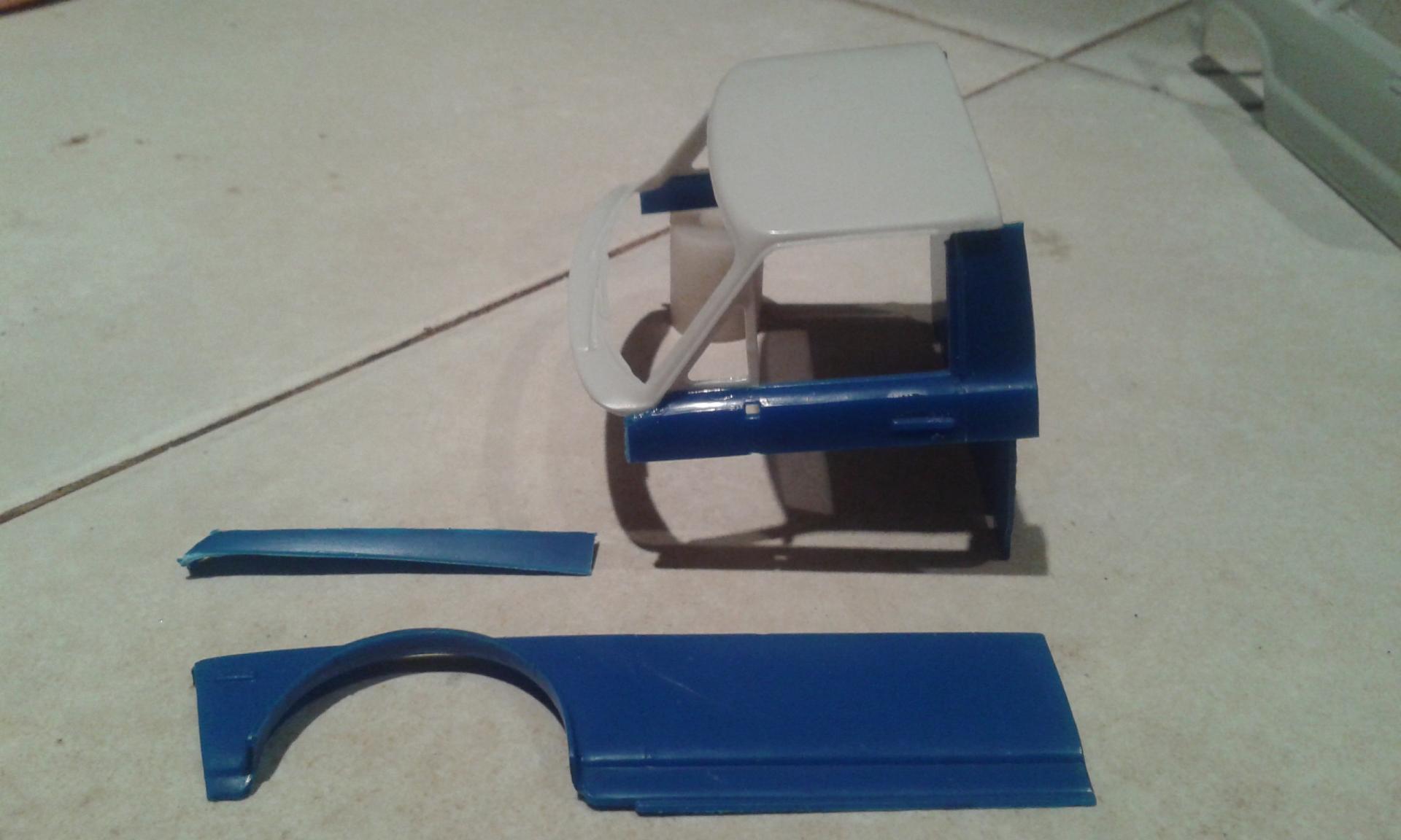

I've been piddling around with this idea for a while. I've always wanted to make the Revell "Fun Truckin'" Courier stock, but the chopped cab had me stumped. Until I realized the 79 cab still had the stock windshield and basic dimensions. I also figured out that both cabs can be combined to complete the look I want, sooo..... The side panels are simply made from sheet plastic, as it's easier to cut simple rectangles from that, than to try to fix the kit pieces. I used the wheelwell from the AMT Courier as a template for the wheel opening. Blue parts are the Revell kit, grey parts are the AMT kit and white parts are sheet plastic. Then I cut out the hood scoop area and replaced it with sheet plastic. I built up the stock frame from the AMT kit and used the well under the hood for detail and to align the chassis. Notice how the AMT interior is a perfect fit for the new cab. And it pretty much represents the stock interior of the real truck too.
