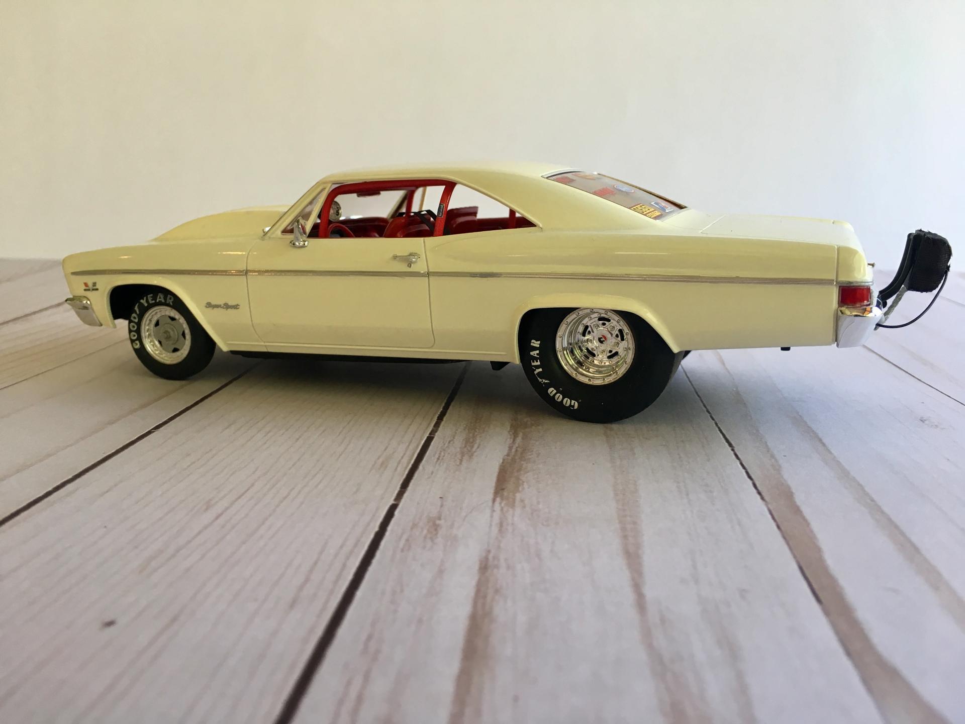

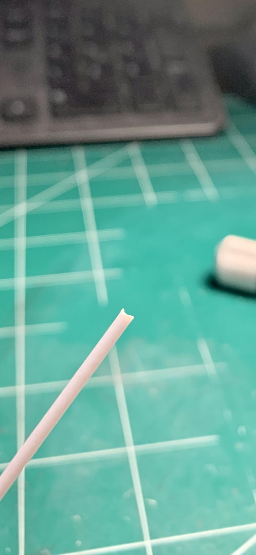

Brutalform Posted November 16, 2021 Author Posted November 16, 2021 Later on I’ll add some aluminum tube to the headers, just like this 66 Impala has. 1

Scott8950 Posted November 17, 2021 Posted November 17, 2021 On 11/16/2021 at 12:16 PM, Brutalform said: Later on I’ll add some aluminum tube to the headers, just like this 66 Impala has. You should post some pictures of that impala. 1

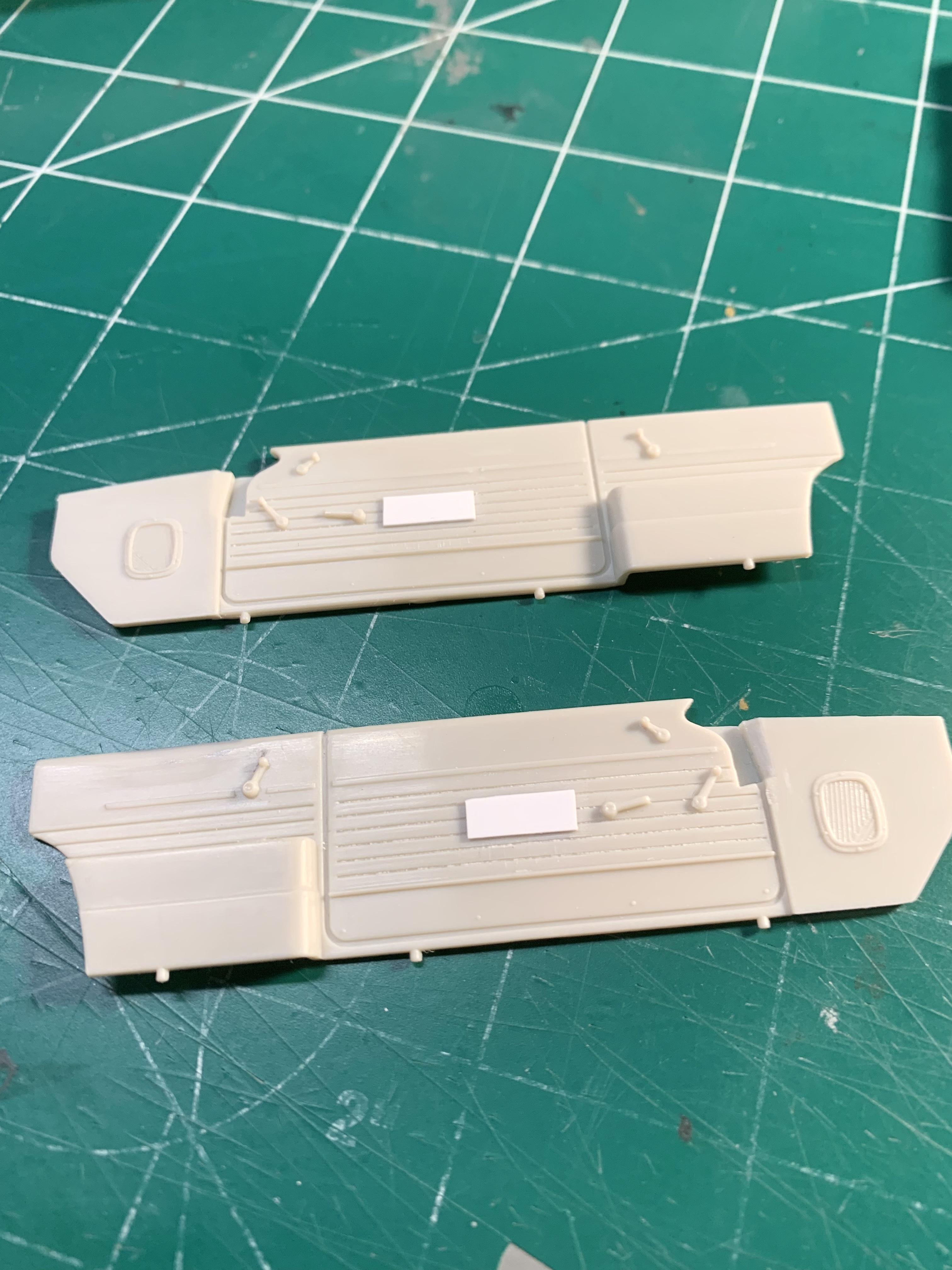

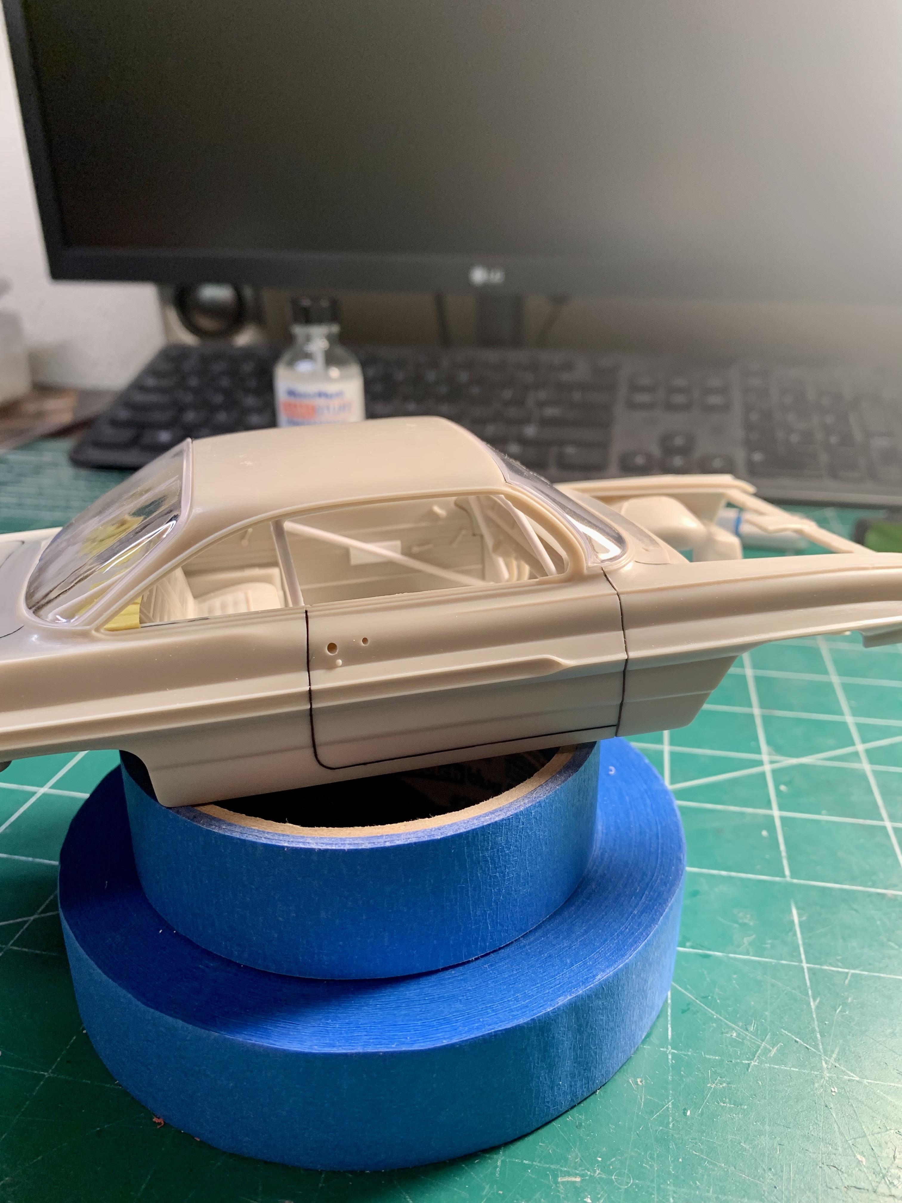

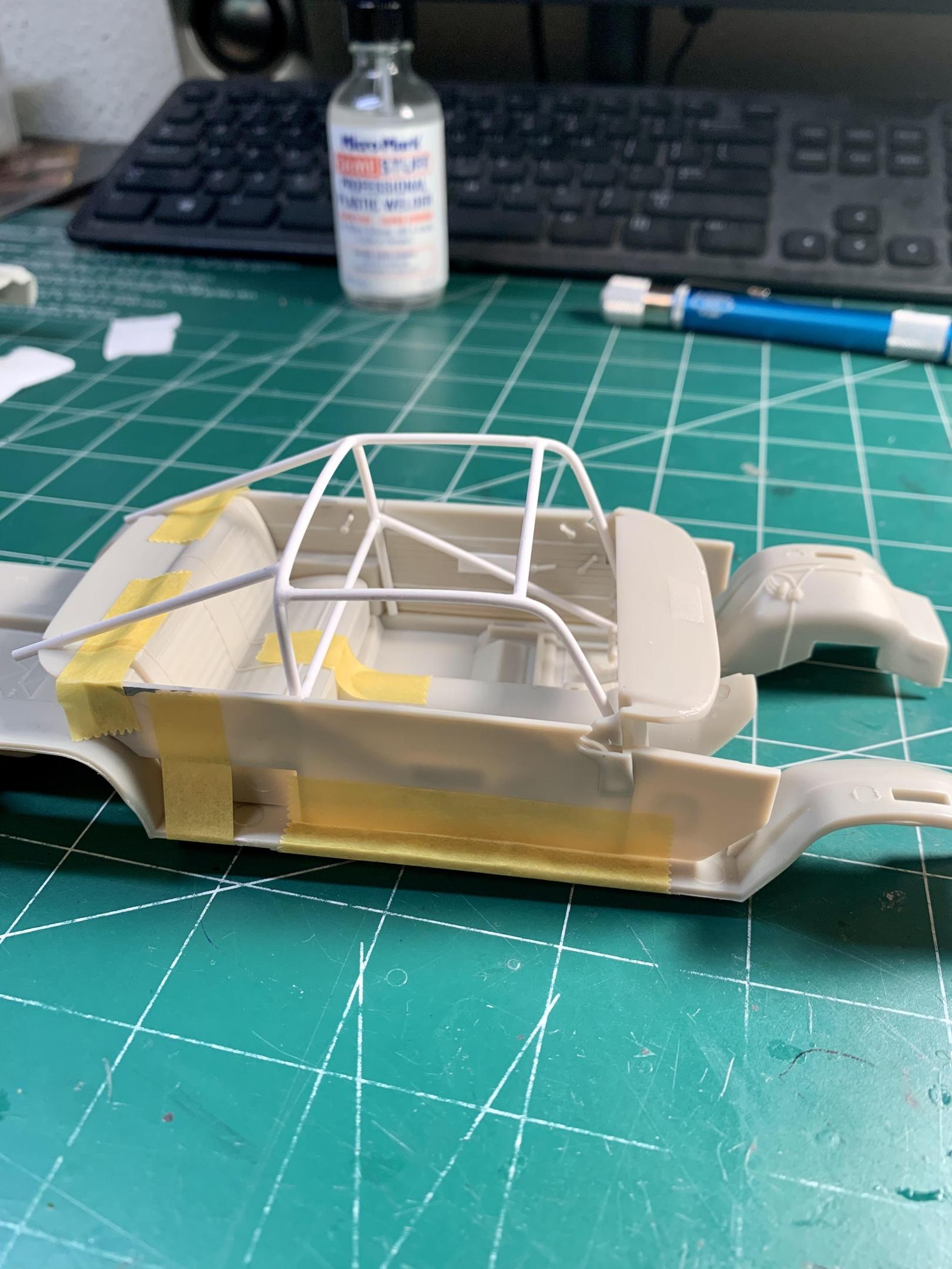

Brutalform Posted December 12, 2021 Author Posted December 12, 2021 Thanks for the replies everyone. Scott, I’ll get a few pics of the Impala posted up later on. We had a death in the family on my wife’s side, so with all that going on, and the estate, we’ve been busy lately. But I did manage to start on the roll bar, using some Evergreen .062 diameter styrene rod. I have it all figured out with the floor pan, and all. I filed all the joints with needle files, to get a nice fit. 1

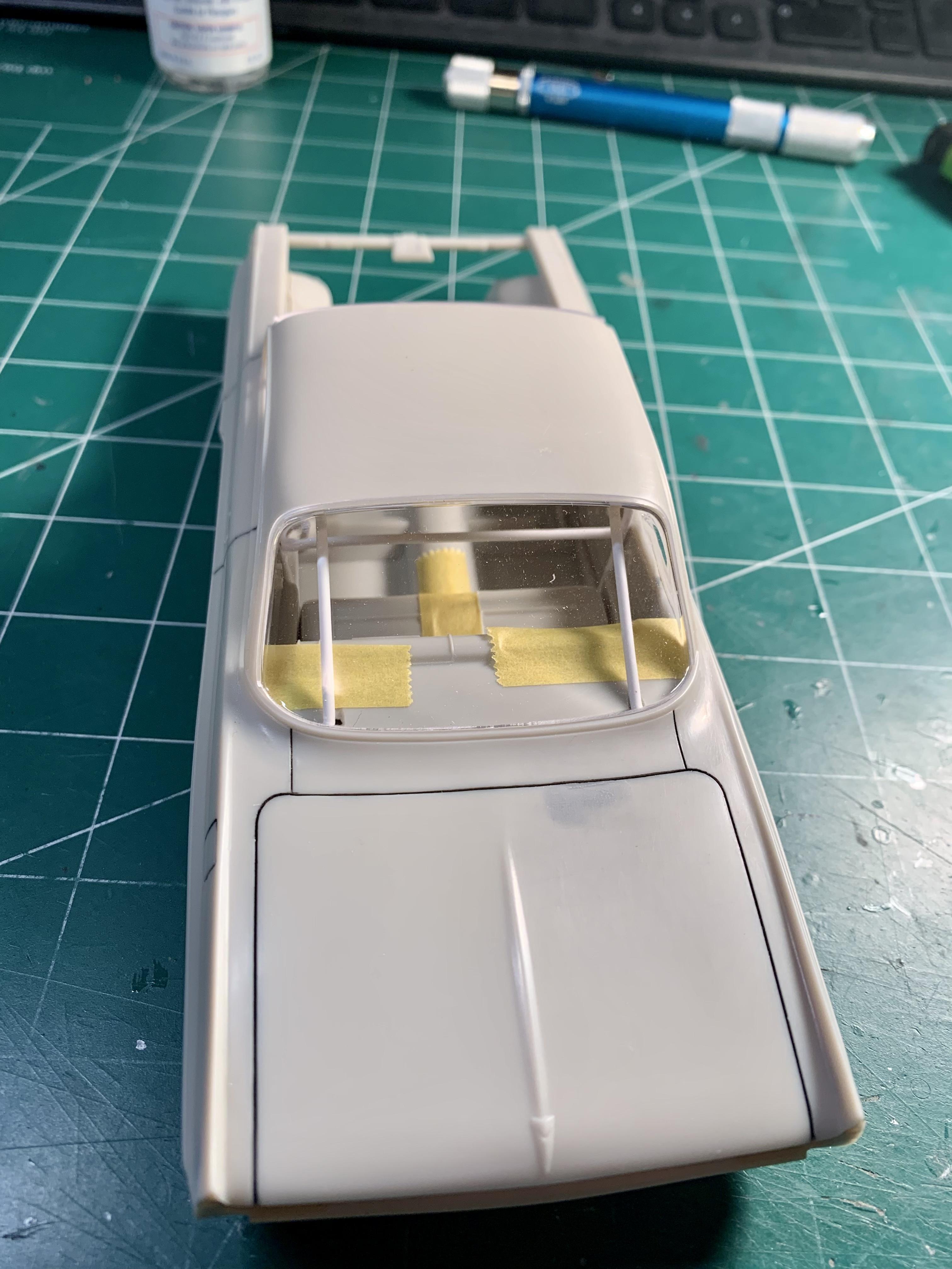

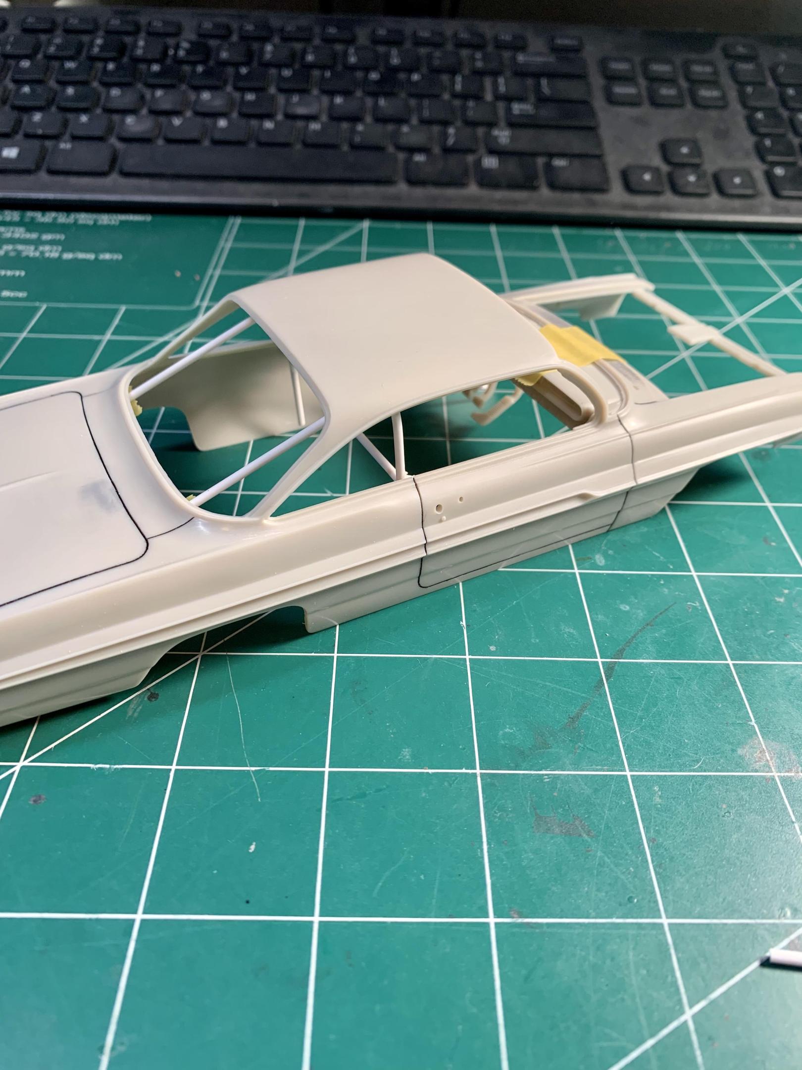

Brutalform Posted December 12, 2021 Author Posted December 12, 2021 Taped the dash in so I know the bars are not going to interfere with it. Also notched the rear package tray to allow the bars to pass through. With the side bars, the armrests had to be removed from the door panels. 1

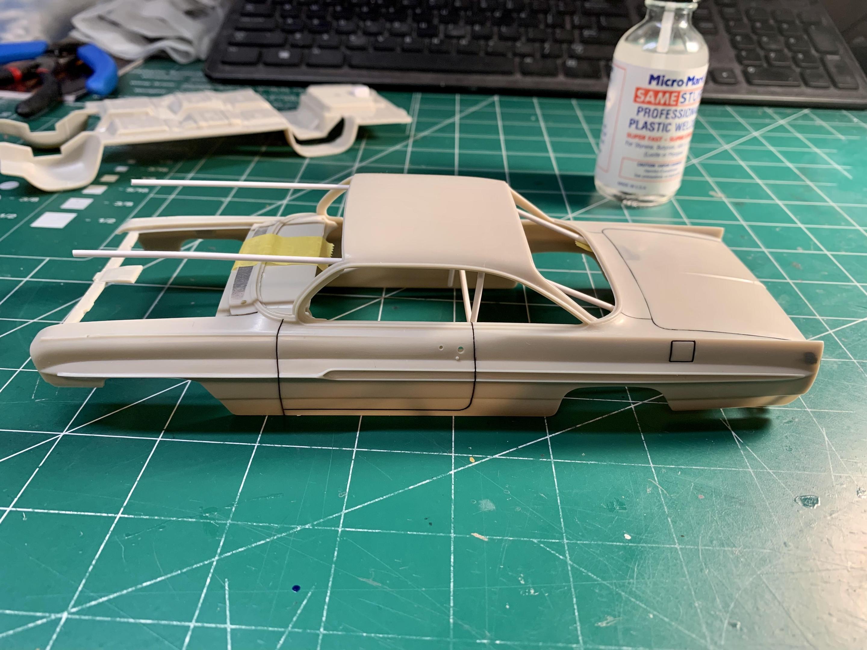

Brutalform Posted December 12, 2021 Author Posted December 12, 2021 Whenever I’m using any kind of plastic welder, I like to slip something between the work area and the roof panel, to avoid any drips ruining the plastic. Now after these are fully dried, I’ll bend the bars to fit along windshield pillars, and around the dash. A little cleaning up around the joints will be done right before primer. 1

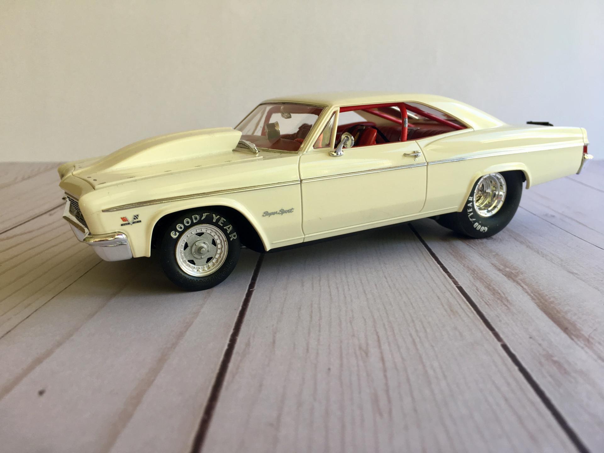

Brutalform Posted December 12, 2021 Author Posted December 12, 2021 On 11/16/2021 at 12:16 PM, Brutalform said: Later on I’ll add some aluminum tube to the headers, just like this 66 Impala has. 1

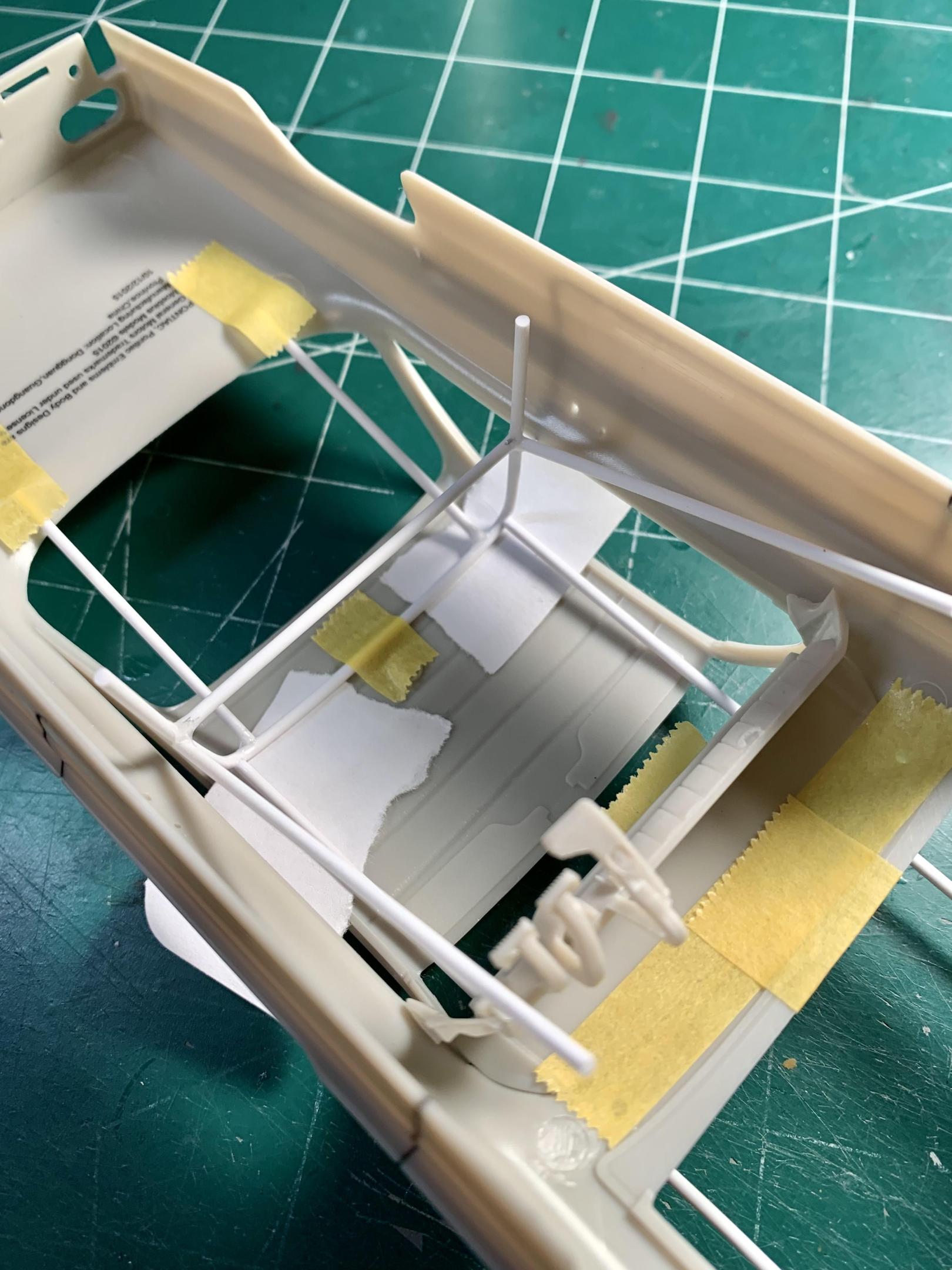

Brutalform Posted December 16, 2021 Author Posted December 16, 2021 On 12/14/2021 at 8:44 AM, afx said: Interesting technique on the cage fabrication Tom - might have to try it out. Thanks JC, but stick to your technique that you posted on your tutorial on how you make your cages. It works much better than what I was trying to do. I ended up removing the two top bars, and bending them before mounting them to the side bars. I really should have just done that from the start. What was I thinking? I’m just glad the windows, dash, package tray, and door panels all fit nice and tight. 2
