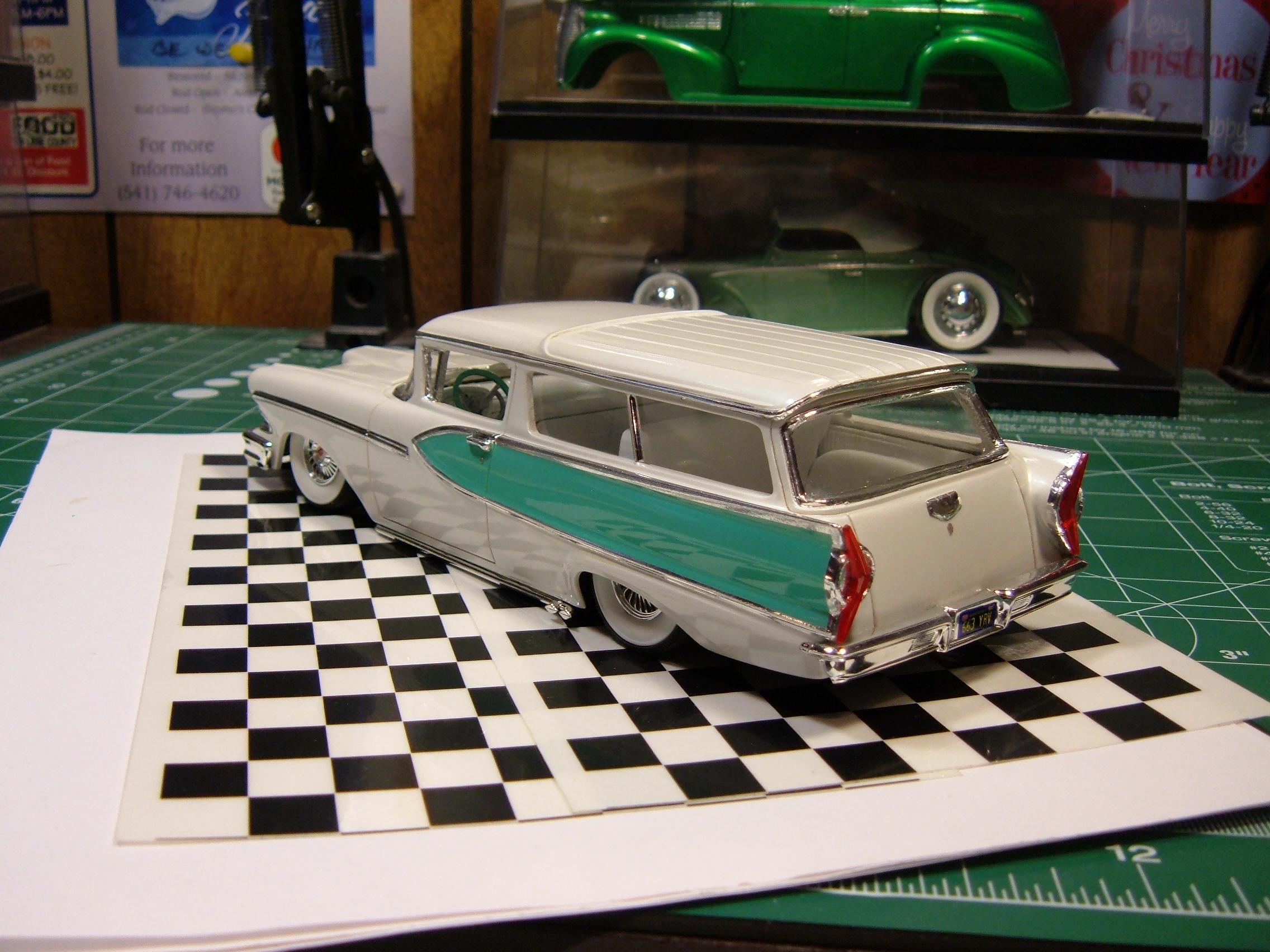

carbuilder1950 Posted November 6, 2021 Share Posted November 6, 2021 (edited) I agree with everything said here because like many said here, there are so many variables. What kind of paint are you using? What brand of paint are you using? Will you be using a clear coat, and most importantly for me, do you have a simple repeatable formula for the basics that you can use to work from. Like 3 coats of color starting with a light coat, then a medium coat and then a wet coat. Which in most every case depends on the car you are painting and the details it has that you don't want to bury in paint. Every paint job will have it's challenges, so there's times when trying out your painting technique on a spare body or scrap of plastic will come in handy. As many have said here, painting is part skill, art, and science. So practice, practice, practice, is my motto. Once you have a basic painting formula your comfortable using, then you'll start finding the freedom to experiment with other styles of paint like urethane auto paints, like House of Color paints candies and flakes and pearls, not to mention how you prepare your car for a paint job and the primer you use. It's all part of a personal process that can take most of us years to work out to our satisfaction. I like this one especially. Edited November 6, 2021 by carbuilder1950 Quote Link to comment Share on other sites More sharing options...
TransAmMike Posted November 6, 2021 Author Share Posted November 6, 2021 Realy like that job on the Edsel David , looks like a pearl white. You use what I call high end paint and I'm sure a lot more guys' do also. I'm just a cheapskate acrylic paint user. Most expensive I use is the Createx. I just wonder really how much of a difference it makes with inexpensive (note I didn't say cheap😄) versus pricy stuff. Me, I think it just comes down to the process. Quote Link to comment Share on other sites More sharing options...
carbuilder1950 Posted November 6, 2021 Share Posted November 6, 2021 24 minutes ago, TransAmMike said: Realy like that job on the Edsel David , looks like a pearl white. You use what I call high end paint and I'm sure a lot more guys' do also. I'm just a cheapskate acrylic paint user. Most expensive I use is the Createx. I just wonder really how much of a difference it makes with inexpensive (note I didn't say cheap😄) versus pricy stuff. Me, I think it just comes down to the process. You know @TransAmMike my friend, It all depends on what makes you satisfied and happy with how you enjoy the hobby. Sometimes I use really inexpensive paints myself, like Krylon spray enamels, because I love the color, and I have learned over time how to use a lacquer clear coat over it, and get the final finish I want. Some of my models I share here, have very inexpensive rattle can paint jobs, but because I have spent years practicing painting and knowing the chemical make up of paints, the conditions I should paint in, and what to use for that final polishing, and when to do it, they usually come out pretty fair, but don't forget, it took me years to make my paintings look simple. Dave Quote Link to comment Share on other sites More sharing options...
TransAmMike Posted November 7, 2021 Author Share Posted November 7, 2021 1 hour ago, carbuilder1950 said: You know @TransAmMike my friend, It all depends on what makes you satisfied and happy with how you enjoy the hobby. Sometimes I use really inexpensive paints myself, like Krylon spray enamels, because I love the color, and I have learned over time how to use a lacquer clear coat over it, and get the final finish I want. Some of my models I share here, have very inexpensive rattle can paint jobs, but because I have spent years practicing painting and knowing the chemical make up of paints, the conditions I should paint in, and what to use for that final polishing, and when to do it, they usually come out pretty fair, but don't forget, it took me years to make my paintings look simple. Dave Well David, I started with rattle cans and got some pretty good results and without clear. I decided I wanted to try airbrushing. Started with model car enamels, really only Testors, and I struggled to get acceptable results. Used the Badger 200 and just could not get it to work right. Also, just did not like having to use thinner for clean-up. Just too messy and smelly for me. So I tried craft paint after watching a lot of Dr.Cranky's videos. I still had problems with the Badger but I was able to at least get some decent results. After buying the Mr. Hobby Proton trigger brush my results with the acrylics have definately been better. Love the brush by the way. I stepped up to Createx for the pearl effects and I'm determined for it to be my go-too paint. Now, the clearing is still an issue. I discovered the Rust Crystal Clear Acrylic Lacquer and like it but recently I'm having a checking issue even tho it's the same Createx I've been using. Other than Future, it's the only other clear I have ever used. Quote Link to comment Share on other sites More sharing options...
carbuilder1950 Posted November 7, 2021 Share Posted November 7, 2021 1 hour ago, TransAmMike said: Well David, I started with rattle cans and got some pretty good results and without clear. I decided I wanted to try airbrushing. Started with model car enamels, really only Testors, and I struggled to get acceptable results. Used the Badger 200 and just could not get it to work right. Also, just did not like having to use thinner for clean-up. Just too messy and smelly for me. So I tried craft paint after watching a lot of Dr.Cranky's videos. I still had problems with the Badger but I was able to at least get some decent results. After buying the Mr. Hobby Proton trigger brush my results with the acrylics have definately been better. Love the brush by the way. I stepped up to Createx for the pearl effects and I'm determined for it to be my go-too paint. Now, the clearing is still an issue. I discovered the Rust Crystal Clear Acrylic Lacquer and like it but recently I'm having a checking issue even tho it's the same Createx I've been using. Other than Future, it's the only other clear I have ever used. @TransAmMike Yeah, that's one of the love/hate parts of model building, is those times we continue to struggle until we finally get things right. I haven't stripped a bad paint job of mine for a long time, but it took me an equally long time to get there. Painting is definetly not plug -n-play, but I love the challenge presented to get it right, by everything done in the past brought to mind, and checking to see if I have done everything my best again, before I begin - And then I just go for it full steam ahead with no doubts, because I prayed first - ALWAYS. Quote Link to comment Share on other sites More sharing options...
