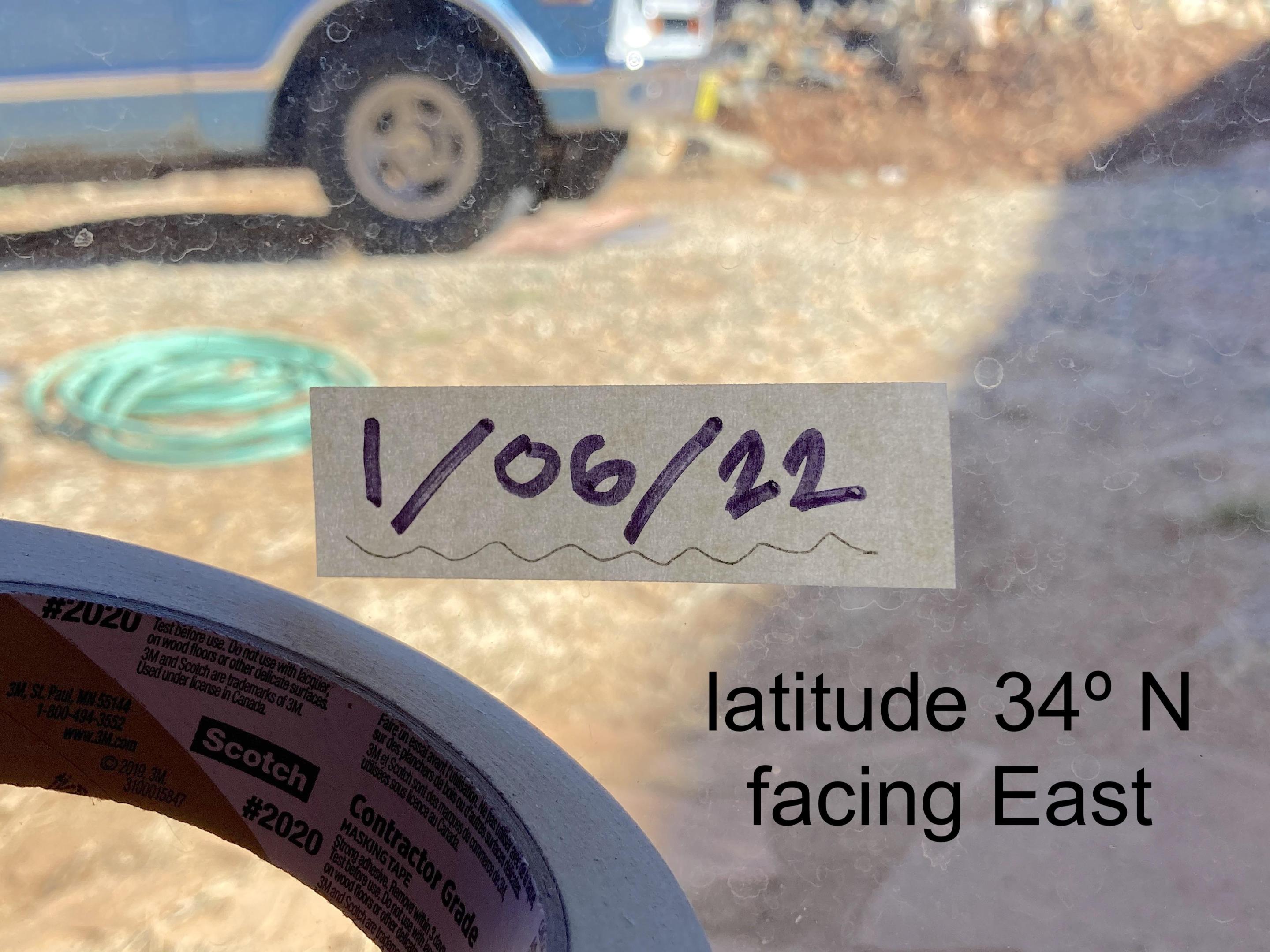

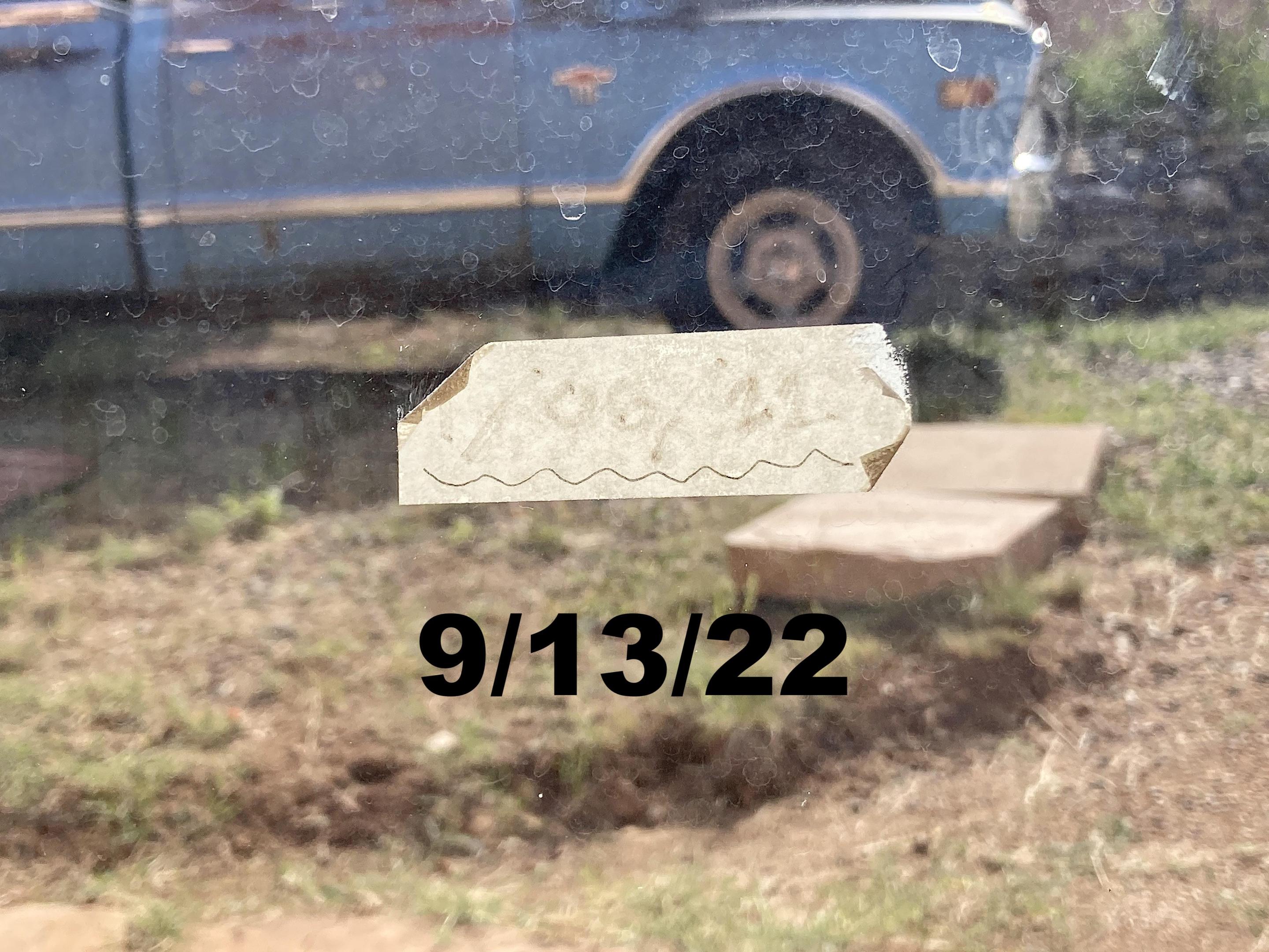

89AKurt Posted January 7, 2022 Share Posted January 7, 2022 I have been seeing suggestions for using masking tape, as the material, for vinyl tops, and seat upholstery (for example), besides the normal use of masking for painting. I know from experience that it has a short life (considering how old I am, let's say less than a normal lifetime), it loses the adhesive first, then it becomes brittle and crinkly, gets yellow, then it falls off or stays on the surface requiring a razor blade to remove. If one keeps their model in an airtight box in the basement, it could be safe. So I'm going to do an experiment, and I would like others to try it too, because a viable study requires multiple experiments, done by others who are better to be skeptics to prove me wrong. I remember seeing paint test panels below billboards in Phoenix, Arizona, which is obviously a harsh climate, where the Sun's Ultra Violet rays trash paint, rubber and plastic in no time flat. So this is an accelerated test. I wrote the date with a Sharpie pen, which will also be tested against the UV rays because I know that fades, also did a squiggle with a Pigma Micron pen for my own edification. In my case, it's on an east facing window (inside), it gets hot during summer mornings, but south and west should be just as good, but not north. Tell us your latitude too, solar insolation is a huge factor depending on location. I also have the brand of tape in the picture. I would think humidity is a factor, but I don't care to go that overboard. This should be as exciting as watching paint dry! 😆 Quote Link to comment Share on other sites More sharing options...
89AKurt Posted September 17, 2022 Author Share Posted September 17, 2022 I was getting annoyed with looking at the tape on my door. It's been 9 months. The adhesive is still holding, but it's about to start flaking. The Sharpie pen ink has almost disappeared. The other pen ink has held up well. The last stage of masking tape degradation is to become brittle and actually break when you remove it. I just wanted to show how it's not a good idea to use masking tape for a finish product on models, and Sharpie pen is affected by UV rays. Due to nobody else doing this test, I will conclude this is 100% proof. 🙄 Quote Link to comment Share on other sites More sharing options...

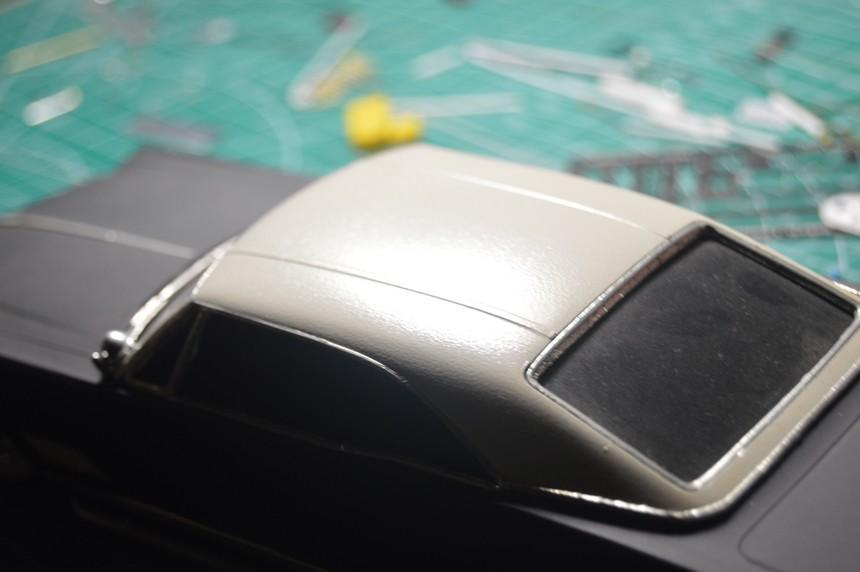

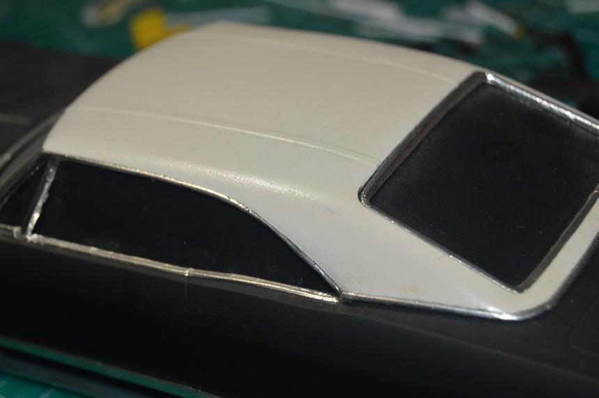

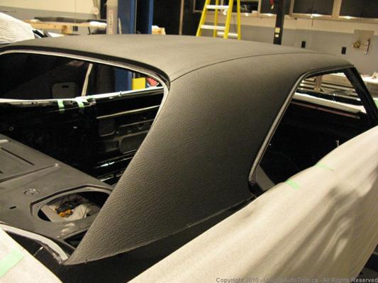

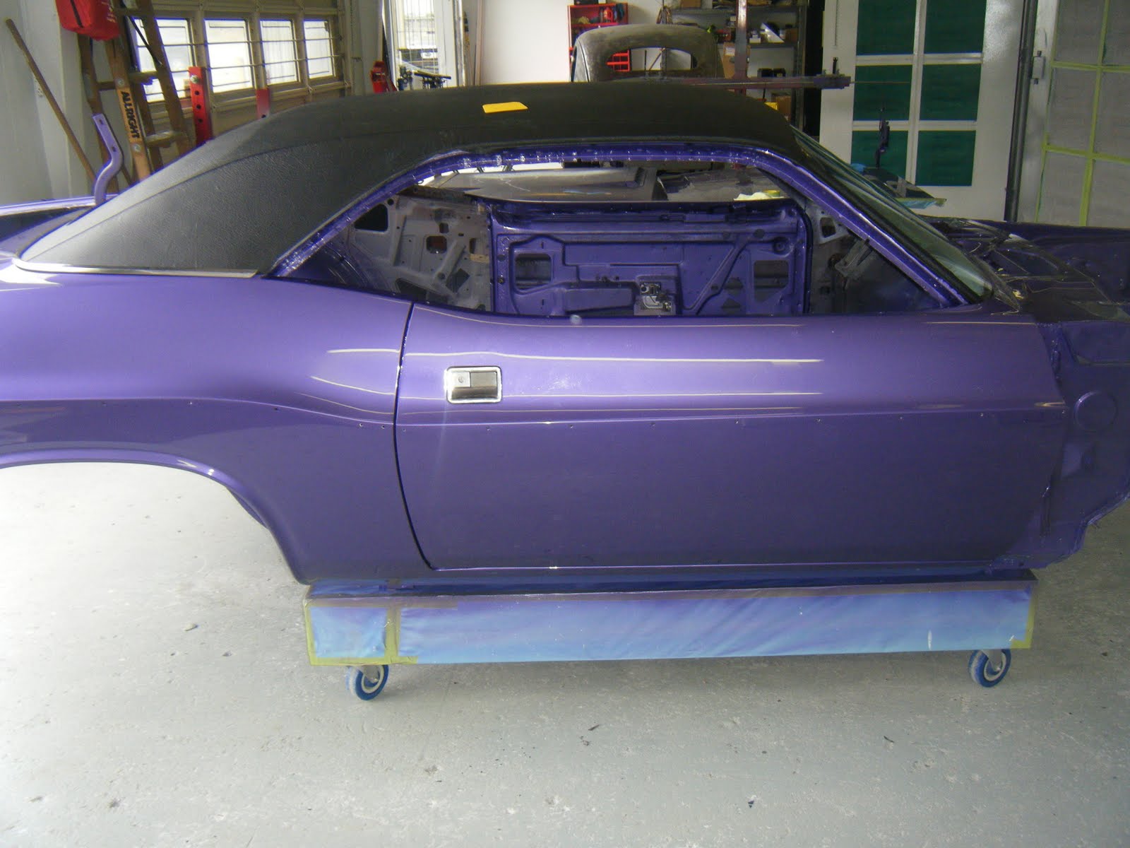

StevenGuthmiller Posted September 17, 2022 Share Posted September 17, 2022 (edited) Honestly, I never really understood the masking tape vinyl top thing anyway. For anyone who has ever had a vinyl top on a car, you know that the grain on the vinyl is pretty fine. It's designed to replicate the grain of real leather. Reduce that grain to 1/25th scale, and masking tape texture would probably equate to a cow about 100 feet long and 50 feet high! Masking tape texture is no where near close to being in scale for a 1/25th scale vinyl top. Here are a couple of photos, (relatively close up ones at that) of 1:1 vinyl tops. Even this close up, it's hard to see any sort of texture at all. Reduce that 25 times, and you don't get this. Looks closer to the 1:1 texture than 1/25th scale IMHO. Steve Edited September 17, 2022 by StevenGuthmiller 1 Quote Link to comment Share on other sites More sharing options...

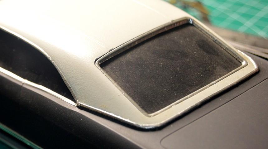

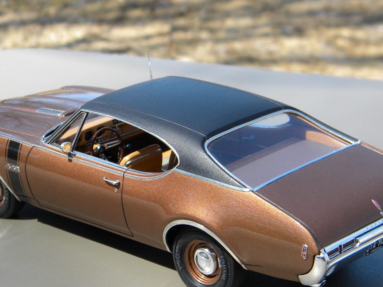

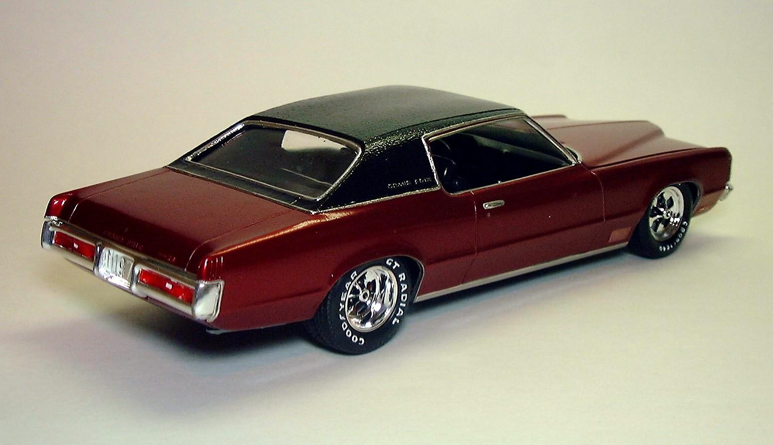

Straightliner59 Posted September 18, 2022 Share Posted September 18, 2022 Here's the one I did, with light "overspray". The rest of it's down and dirty, as I really just wanted to try it out. Usually, I would have taped off the trim, and shaped the seams. This is a slammer I did using the Hasegawa Buick. I used a spray bomb, to do this one. I would guess that even finer grain could be achieved, experimenting with an airbrush. 1 Quote Link to comment Share on other sites More sharing options...

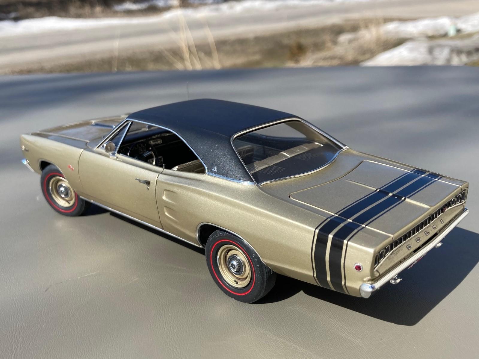

StevenGuthmiller Posted September 18, 2022 Share Posted September 18, 2022 These are a couple that I did using nothing more than black primer shot from a distance and rubbed out. Steve 4 Quote Link to comment Share on other sites More sharing options...
