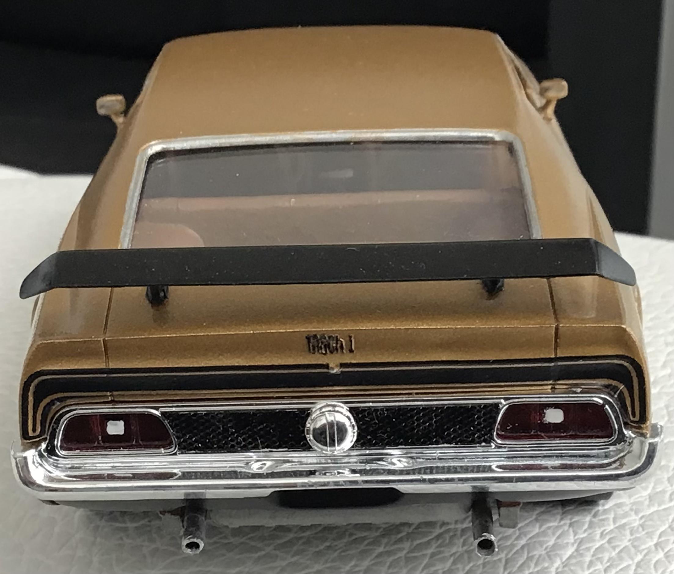

Here is my latest completion - an AMT 1/25 scale 1971 Mustang Mach 1. This was put together using 2 kits from the 1970's that I had built as a teenager. I included a photo of the original cars. The bright green one supplied most of the parts, but the silver one did donate some parts that were broken or missing on the green one. I used some aluminum tubing for the exhausts. Chrome trim is hand painted.
The color is Tamiya TS35 Park Green. I designed the decals myself and had them printed on a laser printed at the local Fed Ex Office store.
Thanks for looking!

Very nice work. Great color and contrasting white interior. Hopefully you can build a second one with the other one.   I’ve built a few of the MPC and AMT kits over the years. 😉

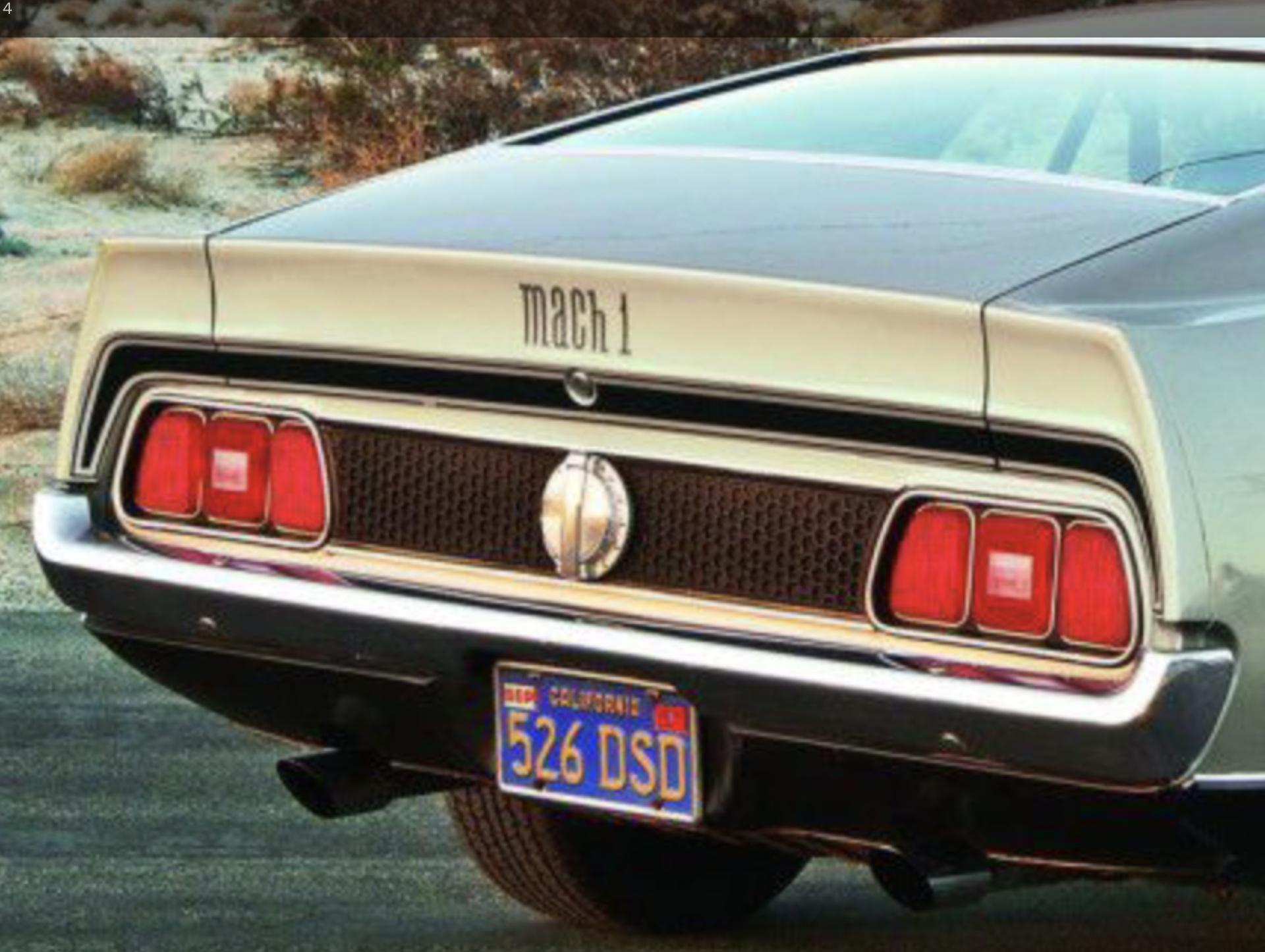

Great idea and a great way to get decals you want at a very low cost.  One thing I did notice was the stripe below the trunk goes down to the bottom of the end caps.  The ones on one of my builds isn’t correct either as it narrows to much at the bottom and is too wide where it begins to curve down.  I think they were old Fred Cady decals but I’m not sure.  Anyway, these pictures should show what I’m trying to say.  I know I probably sound picky but when you own the real car you tend to notice these things more than usual.
Link to comment
That's cool that you own a real one! I am jealous!
You are right that the stripes under the trunk do not go down far enough. Also the one on the left side under the trunk (not visible in my photos) has a more correct curve at the top corner to my eyes. The one on the right is a bit more angular at the corner. I remember that I had to make each of those corner strips using 3 different components - some of it Photoshop and some in PowerPoint. I am also not convinced that the proportions on the AMT kit in several places were a 100% match to the real thing.
And I can also be a critic of my own work - as you will now see:
1) The stripes on the side of the real car appear to be thicker in height towards the front and become slimmer as they work towards the rear. Mine are uniform in height all the way.
2) The stripe on the front fender that drops down was also a pain. The side marker lights on the AMT model didn't look to be as wide as they are on the real car, so I had to alter those stripes to be about the width of the marker light on the model.
3) You'll also notice that the stripe doesn't extend below the marker light on the front fender; that was going to way too small of a decal to work with. When you print your own, you have to cut the decal extremely close to the size of the actual decal shape. Remember that the entire 8 x 10 sheet is just one single, giant decal!
Finally, I don't think the proportions of / details on the AMT body are all 100% accurate. That makes it hard to shrink an image of stripes for a real car down for a model that may be off in some places.
But, I am very happen with the overall model the way it turned out and most people wouldn't pick up on some the inaccuracies that exist with the decals.
Thanks,
Bart
  • Like 1
Link to comment

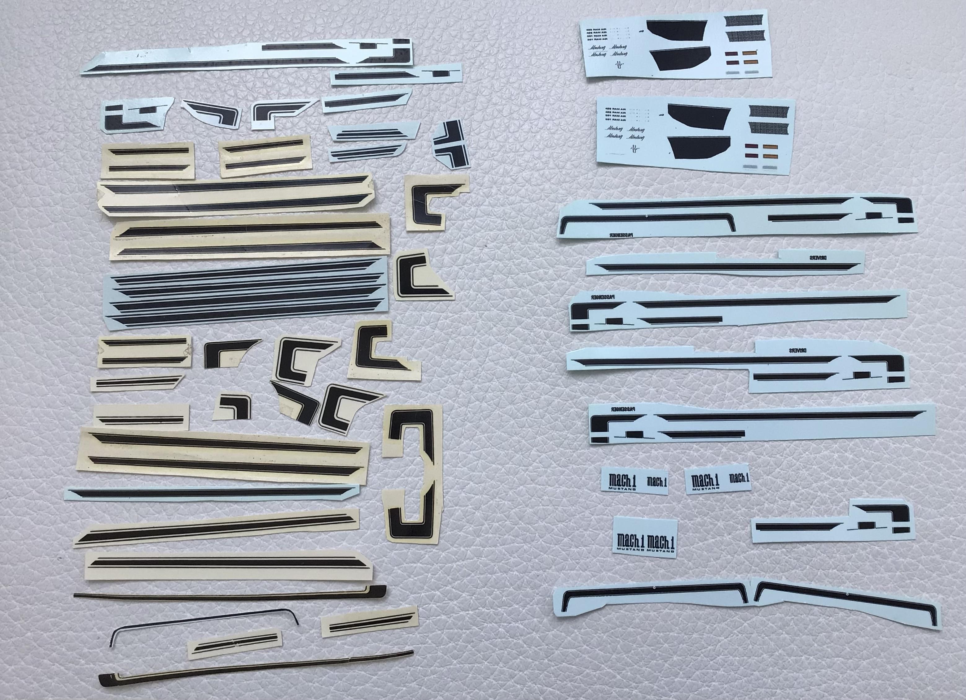

You summed this up very well.  The kits (MPC and AMT) have their flaws for sure.  I think I have the most sets of decals possible for these kits (Marks, Cady, Round2, ARII/Doyshua, original AMT/MPC, Rays kits and one other custom made set.). I’ll post some pictures later of the various sets for comparison purposes.

It’s looks like Round2 made a pretty good set of accurate decals compared to the original issue kits and the Fred Cady decals.  Keith Marks and Rays are a good alternative to buying the entire new kit which is really an MPC kit under AMT branding.
