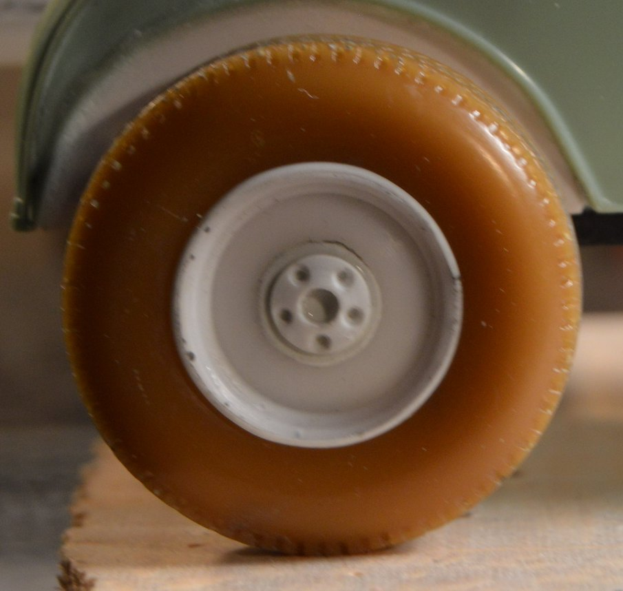

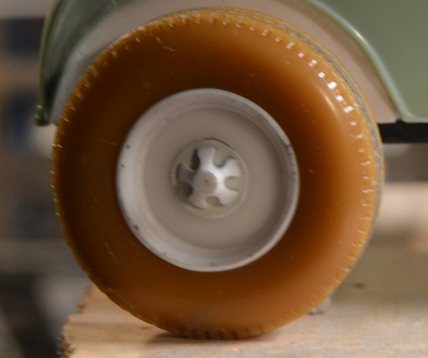

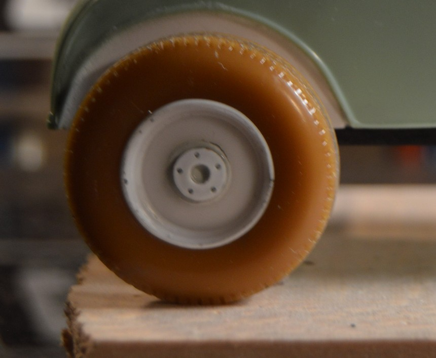

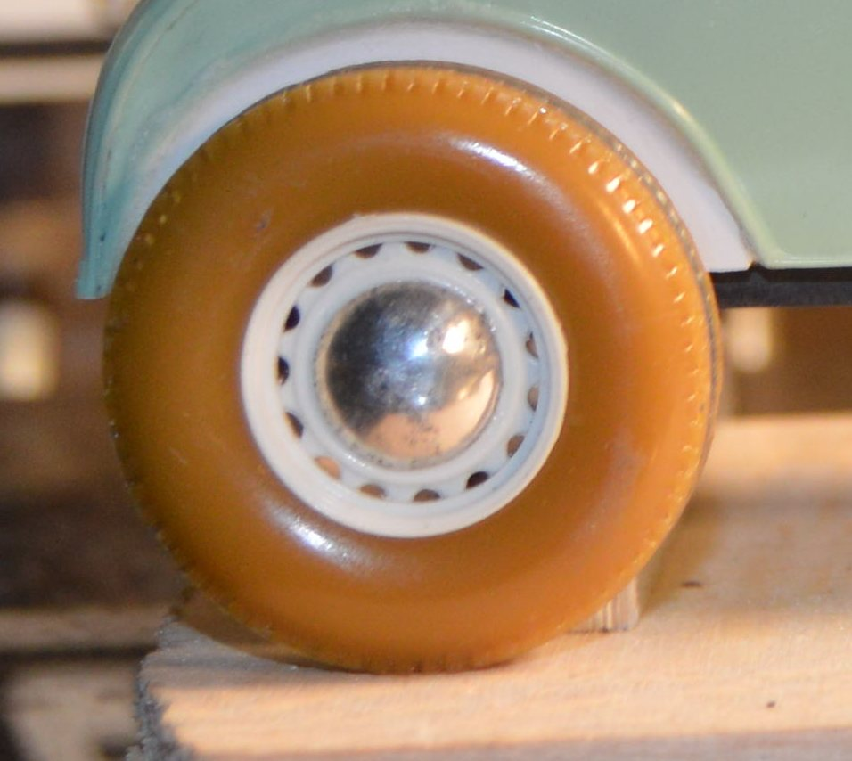

Thanks, David. Glad you're enjoying the thread. I am, indeed using the truck wheels with the baby moons on the rear. Once I made the "moons" from tooling aluminum, I knew that's what I would use. They just looked too good! Thanks, so much, Tom! You know, I was worried that I might be illegal, as a TROG racer, but, at a glance, my equipment all might be old enough. Thanks for the link! When I get home from work, I will have a more in-depth look at your album, because I might be able to whack two project birds with one rock!

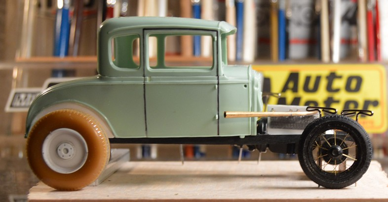

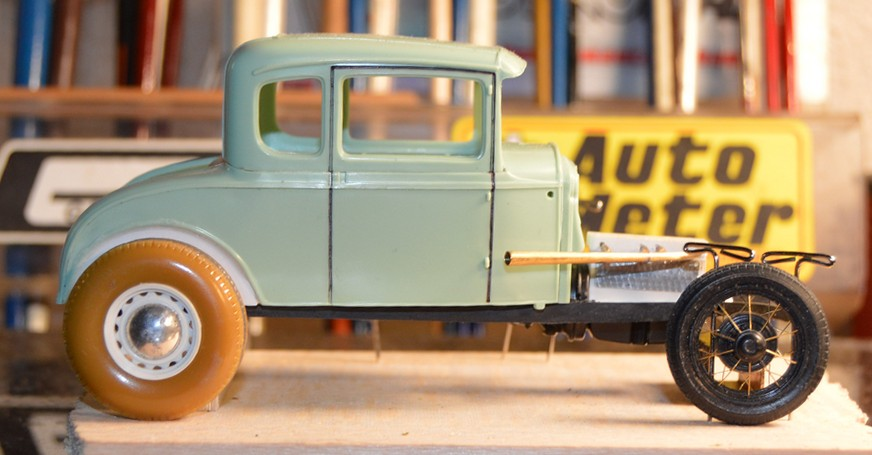

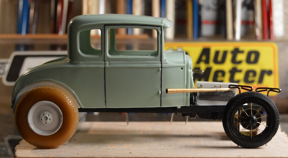

It's on the wheels! I've included a shot of the new trunk lid. I think next up will be the front motor mount.

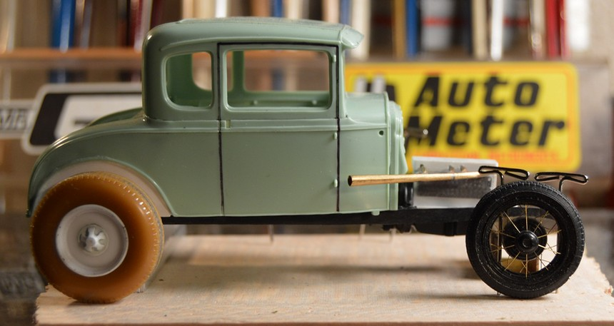

I've got a few more things done. I got the trunk lid cemented into place. The spindles are built. If I can get the front axle remounted before I go to bed, I can get it on the wheels! Always a big step! As always, questionsm comments and critiques are welcome.
