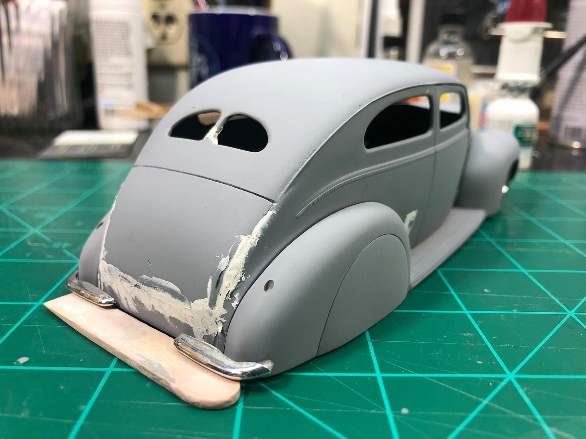

Thx Bob, normally I wouldn't gouge the surface like this but this was a real glue bomb when I started. I guess the easiest answer would be I use a couple deferent sand papers. The courses being 220 and work up to a 400. Then I like to use an automotive filler primer lightly sprayed. I will sand that almost completely off and then start the process over again until I am satisficed. Usually there are spots that need more attention but I work on them individually just re-priming where needed. After that I'll wet sand the entire body and then prime it with Tamiya primer in very light coats. If you do this make the two primers are compatible. There's hundreds of ways of doing it but this works best for me.

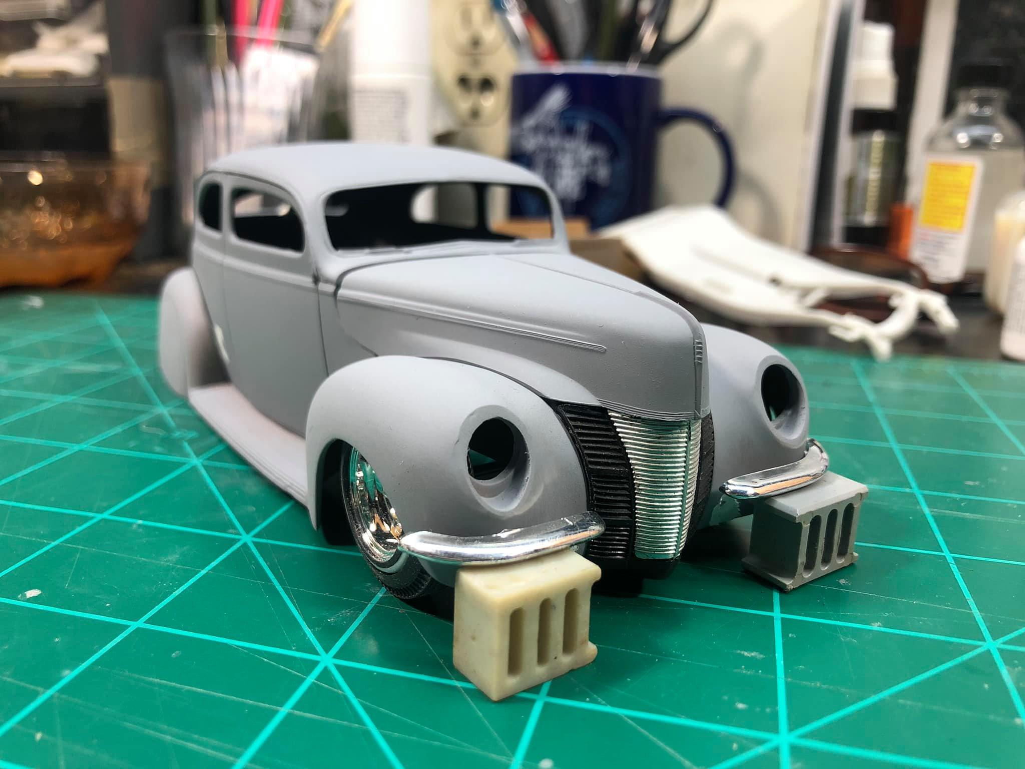

I never was able to get that bench time I thought I would, bur life has slowed and Fall/Winter is approaching. I found enough time to clear the bench and finally get some filler primer on this Sedan. That solid gray, even as light as it is, really helps these tired eyes to see what areas need attention. I'm happy with the chop so far and will be smoothing things out and adding the scribe lines for the trunk. Also, I mocked up some Bumper'ettes too...

Fitment! Cleaning things up little by little. The other fender assembly was cracked so I started another. Flush skirts are glued in place and I’m scribing in the connection point for definition. I’m somewhat surprised at pulling off this chop.
