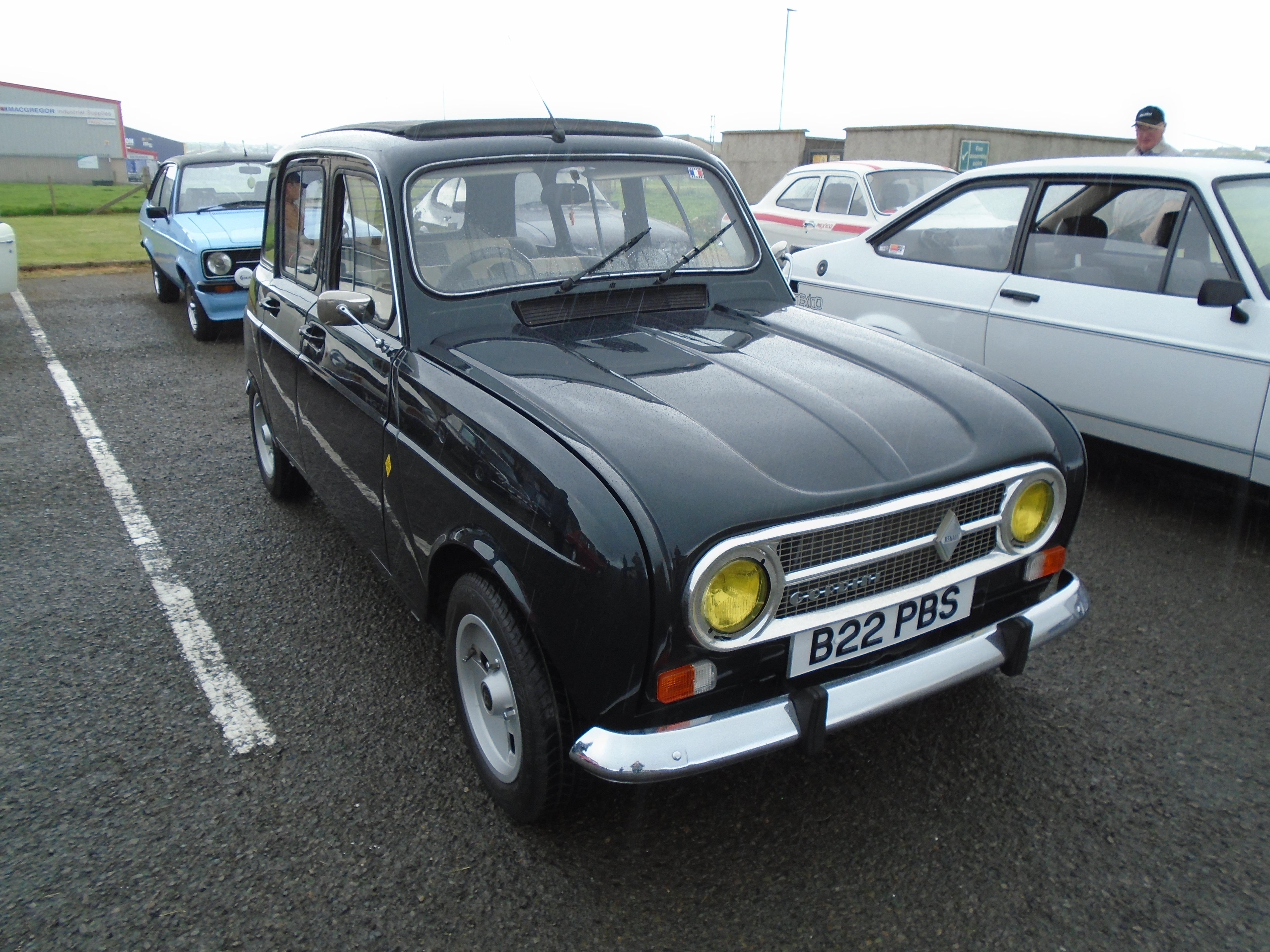

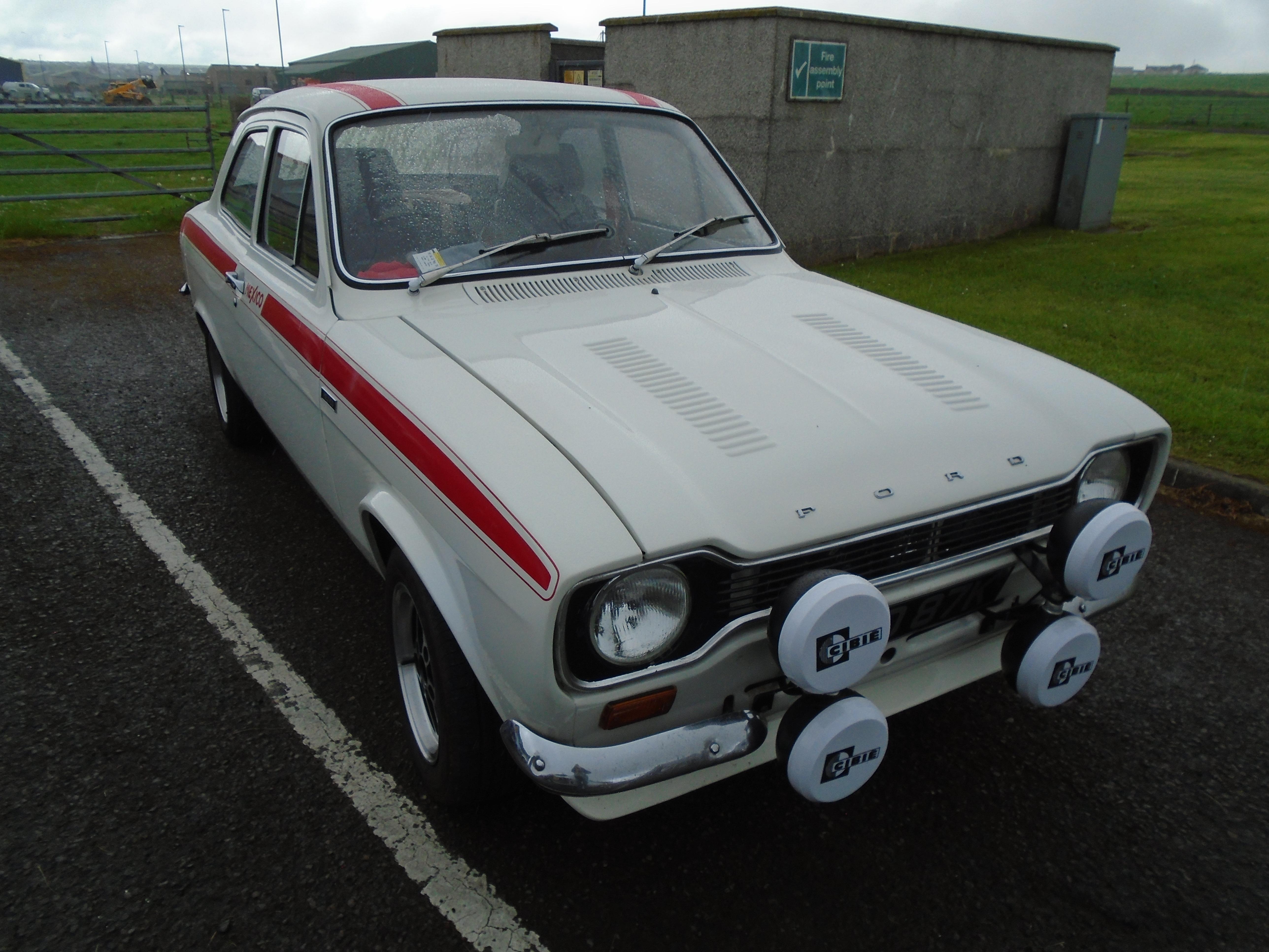

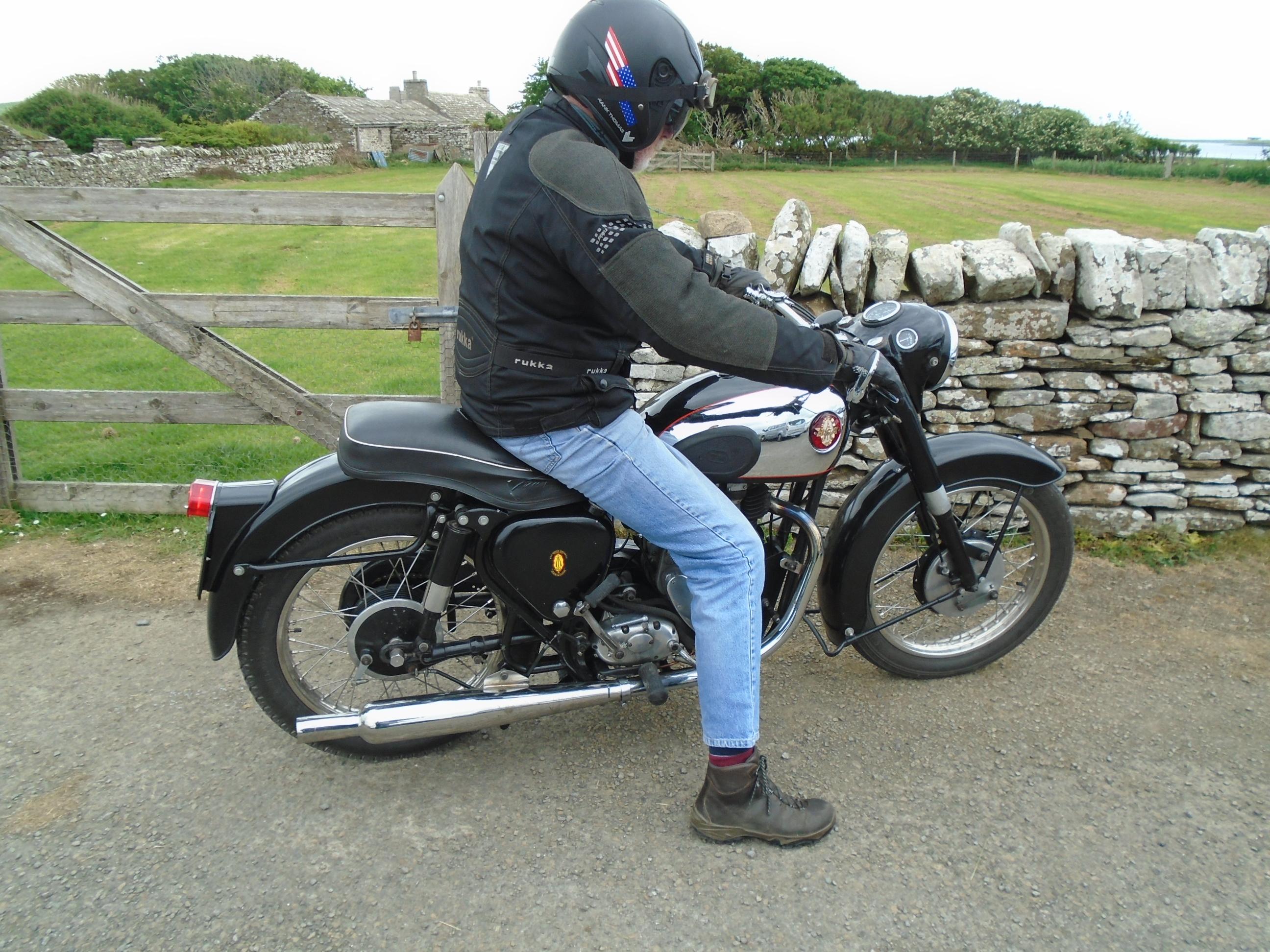

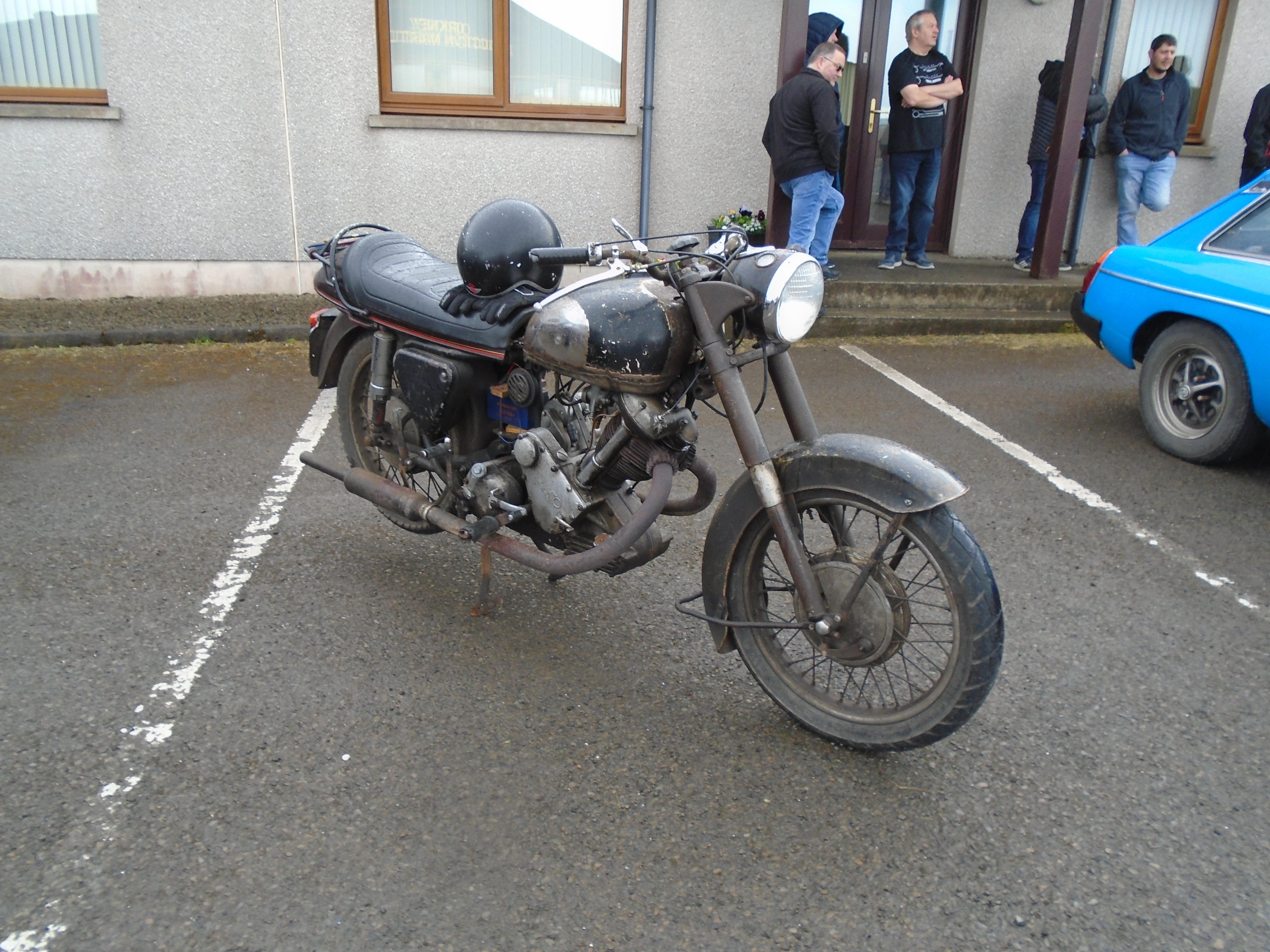

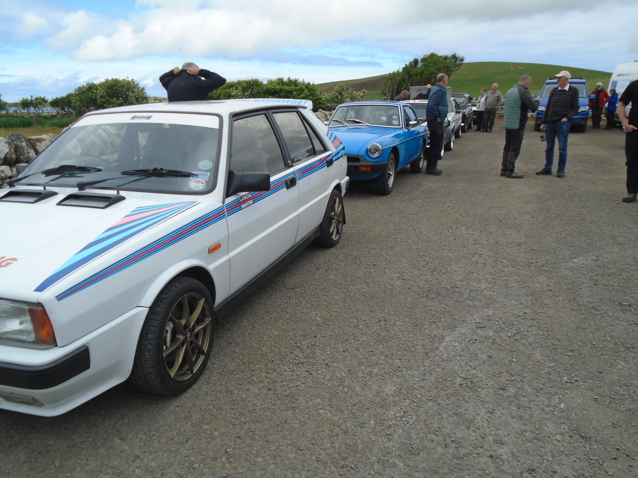

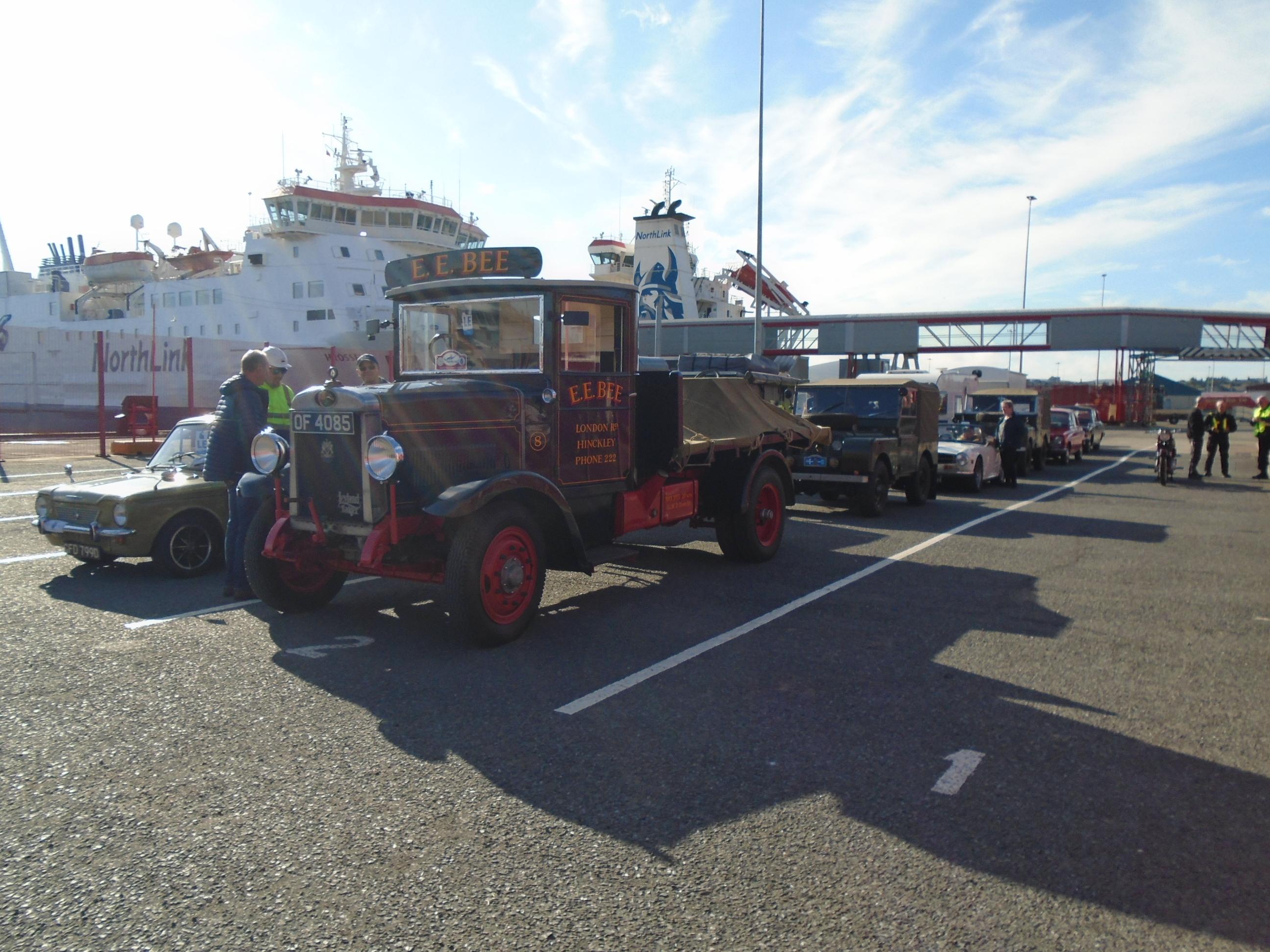

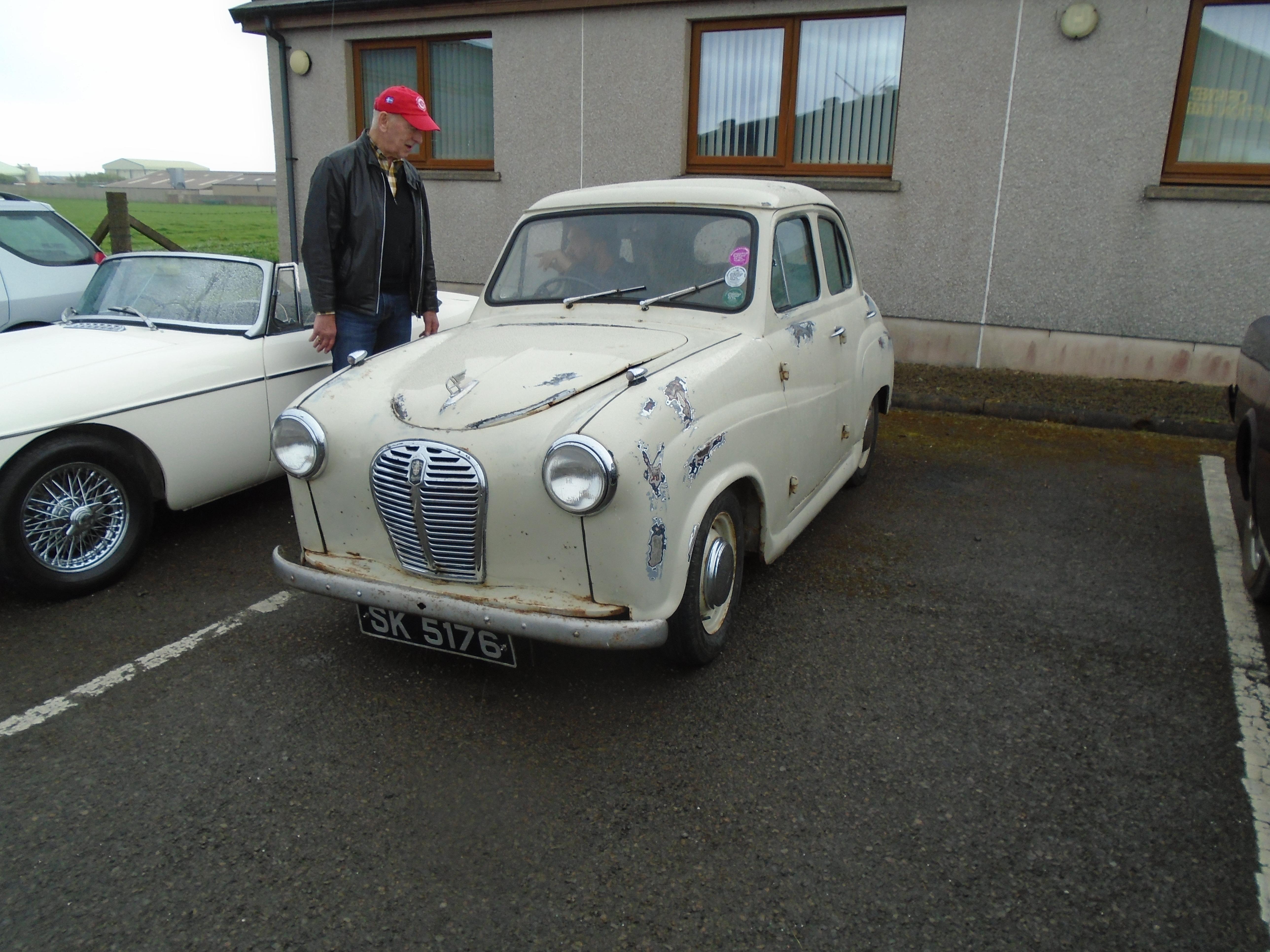

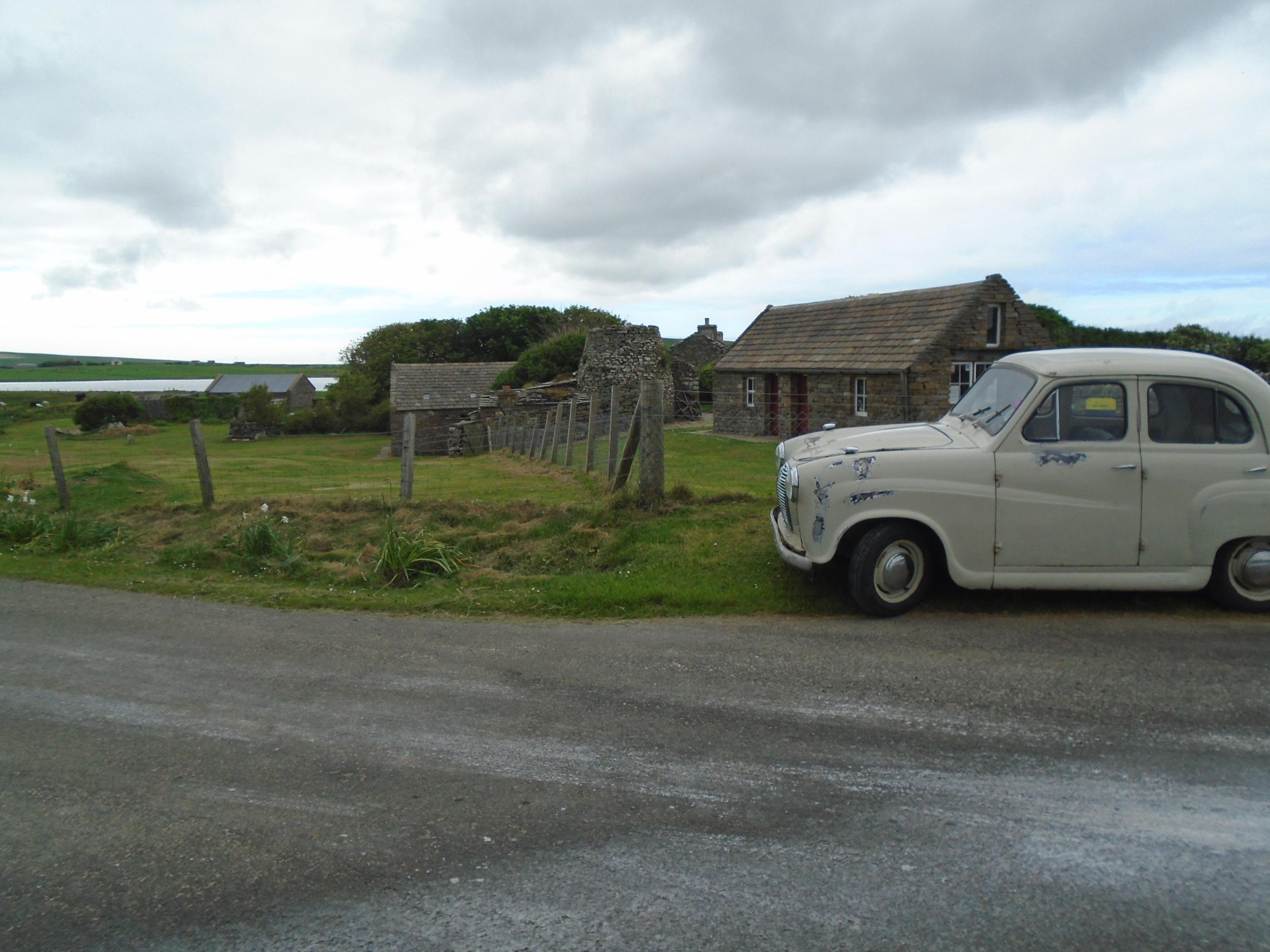

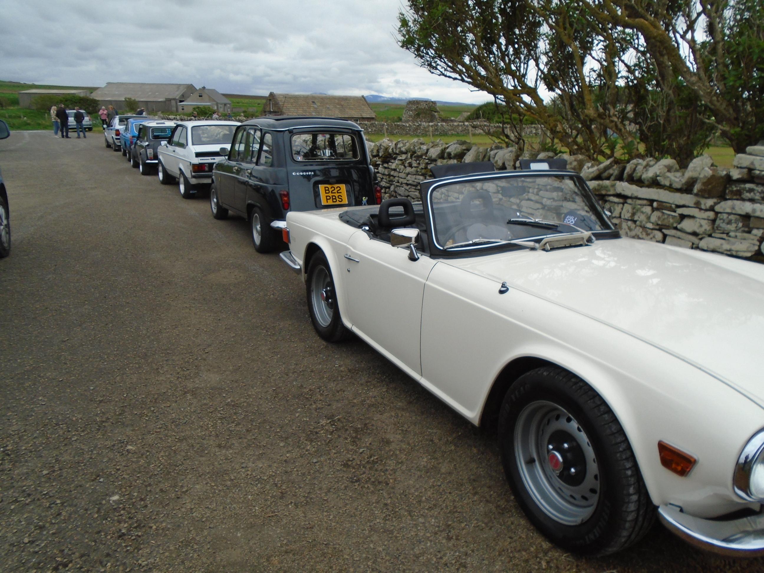

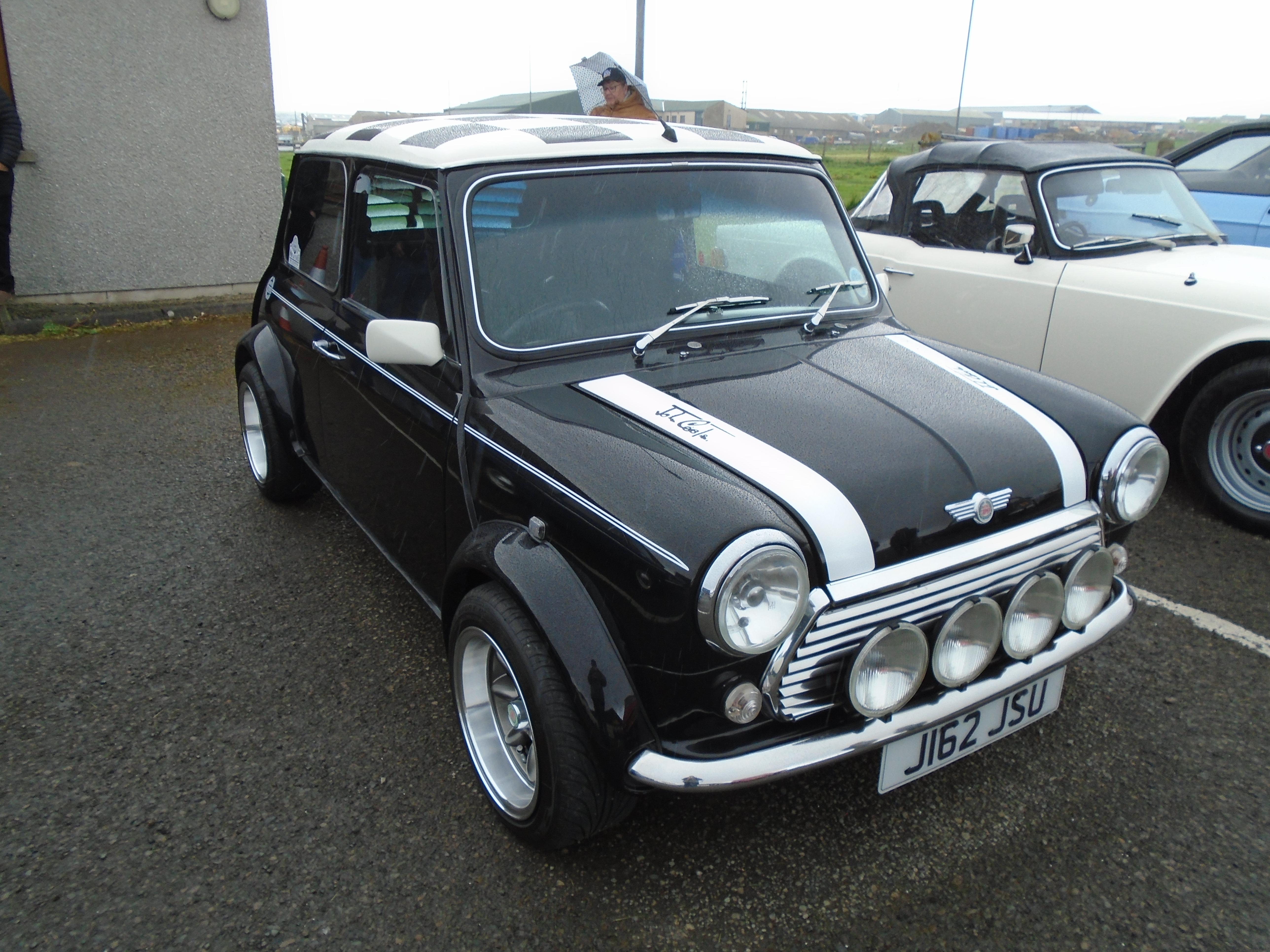

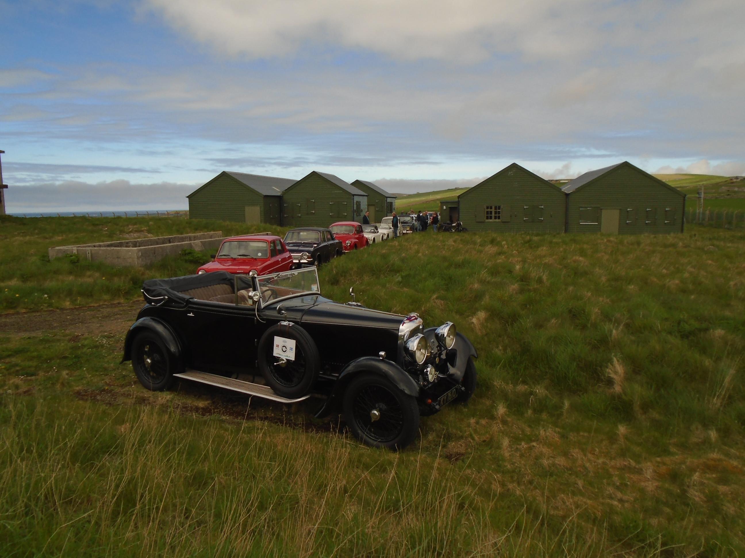

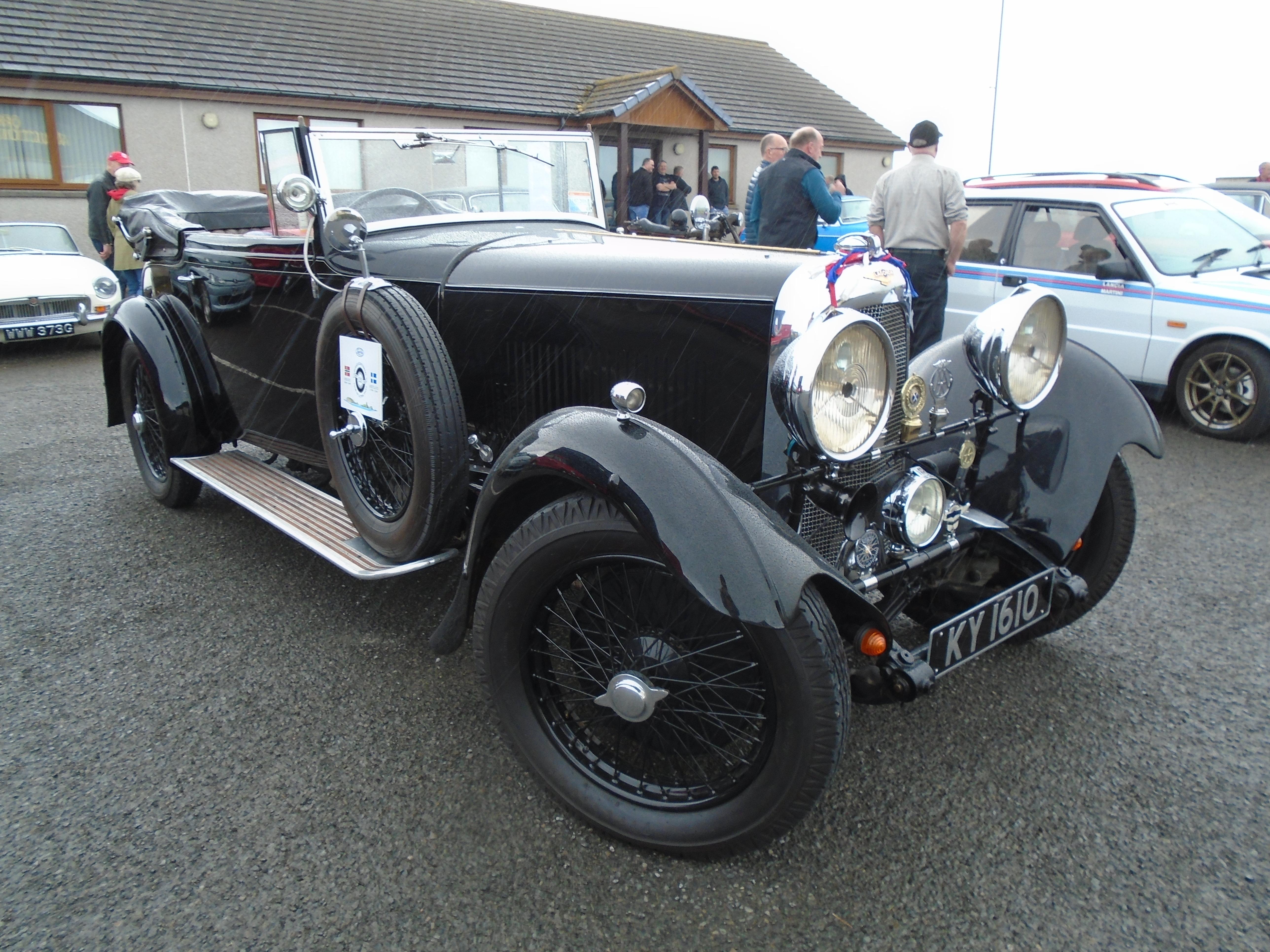

What is your Favourite Classic Car?
stitchdup replied to Falcon Ranchero's topic in General Automotive Talk (Trucks and Cars)
not sleeping again
