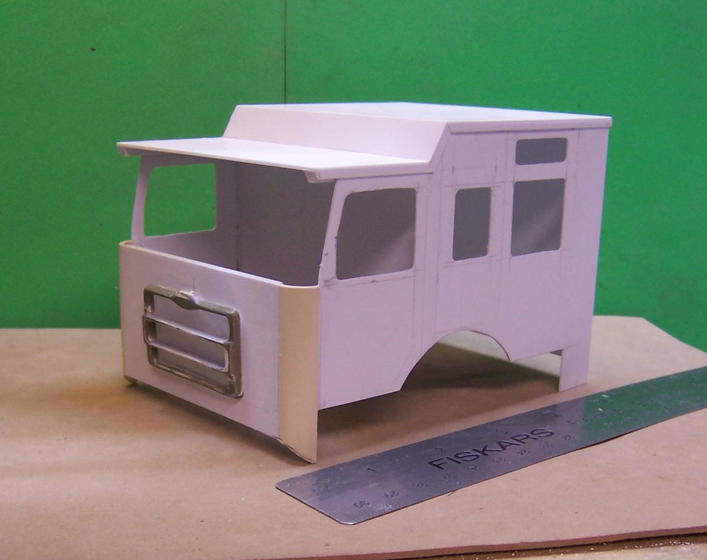

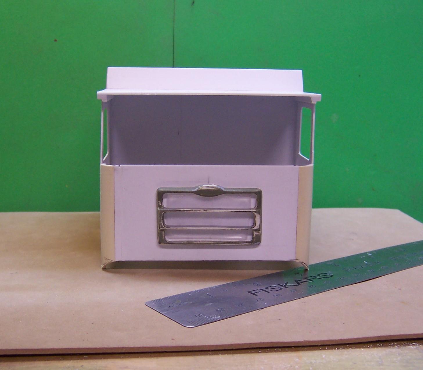

Been working on the interior panels for the sides of the cab. Pierce MFG has some great photos of the interiors of their apparatus. And you can do a virtual walk around of the entire inside with just a move of the mouse. It's been a blessing to pick up on some of the details that will go into the model. Using that information here is where we are with the interior panels. I used some brushed aluminum for the lower panels, painted the rest with a gray primer and then used a black felt marker to darken in the edges of window openings. The same will be done with the exterior window openings on the cab. Clear sheet stock will be locked in place between the sides of the cab and the interior panels. The Trumpeter kit has door latches that were meant for the outside but they nearly are the exact match for the ones that are used on the inside of the Pierce. The outside ones will have to be made special as they are a unique feature not like any other door handles. The aluminum panels are held in place with CA behind but to be sure they don't come apart (aluminum does not really like CA for the long haul) they have been pinned at each corner. Pins were glued from the back, cut off and the ends sanded smooth with the back of the plastic panel. Still to be made in the two panels are holes for the door latches and some window cranks. The yellow bands represent the reflective safety striping for visibility when the doors are open. The pull handles are made from the same soft bright aluminum wire as the window cranks. They are bent "z" shaped and then the ends are squeezed to flatten them out. Holes are drilled in each end and through the aluminum panels and plastic backing sheet. As with the other parts,, they are pinned and glued in from behind and then filed smooth.

Just a couple more photos of work that has been done recently. Yesterday I was able to get a bit done with it raining steady outside all day. We are in drought conditions here in the NE so it was good to have it for once. The interior tub is about done with the exception of two braces that go from frame to roof in back of the AC unit. I have to bend up some tubing for the installation. And I got the AC unit mounted inside the cab and the hole cut in the front where the grill will go.
Moving right along, I spent some time with the interior tub. With some photos of the actual truck I put together some pieces that would resemble the inside of the cab. The seats came from the Trumpeter ALF. Some minor modifications will make them look more like Pierce work. The ALF dash was too far away from the Pierce dash so I looked into my stash of older kits and found a KW gage cluster that was close. I also took one of the 1/32 scale Monogram Macks and from a kit I had already cut up took the additional dash controls and butterfly switch cluster. I cut them apart and relocated them to the Pierce dash. There was also some room for decal work that imitate the additional controls and AC unit. The yellow tubing is the first of 5 SCBA bottles that will fit in the open back seats. Not a good photo but on the dash you can see the Mack gages; one small one just to the left of the steering wheel and one up on the console. To the rear of the cab are two seats with an open netting type storage compartment with a hinged top. The back wall of the cab will be right behind the seats and compartment. I also did some work on the front axle. The wheels are now permanent with tires mounted. I made the tie rod out of 1/16" diameter brass tubing with the next size up for the ends. I cut a notch lengthwise in this piece and drilled it out for the bolt and nut. An additional bracket was made for the wheel back where another piece of 1/16" tubing was soldered on. The end was pinched and drilled for the bolt. I soldered the tie rod end only on end to start. On the other wheel I mounted the tie rod end and inserted the tie rod. Using a long ruler I lined up both axles so that they were straight. It was only then that the second tie rod end was soldered to lock it in place. The bolts are #90 frorm the LHS. They will be cut off and the nuts secured from loosening up. On the bottom of the axle is a piece of strip stock. I had to cut the axle in half and shorten it some so that the tires would be under the wheel well flairs. The strip just adds some stiffness to the axle. There is also a piece on top but it well hidden. Finally I gave the cab a coat of flat black paint inside and then masked off the windshield and side windows and gave the outside a first coat of gray primer. Door lines have been scribed and after each coat they need to be opened up again so that the lines are not lost. The flaws now show up and will have to be fixed before moving on. Next up is to cut the hole in the front panel for the grill. A radiator will be installed behind the photoetch mesh but there won't be any engine in this one that you can see. The oil pan is there but that is all. Another Trumpeter peculiarity. No engine!
