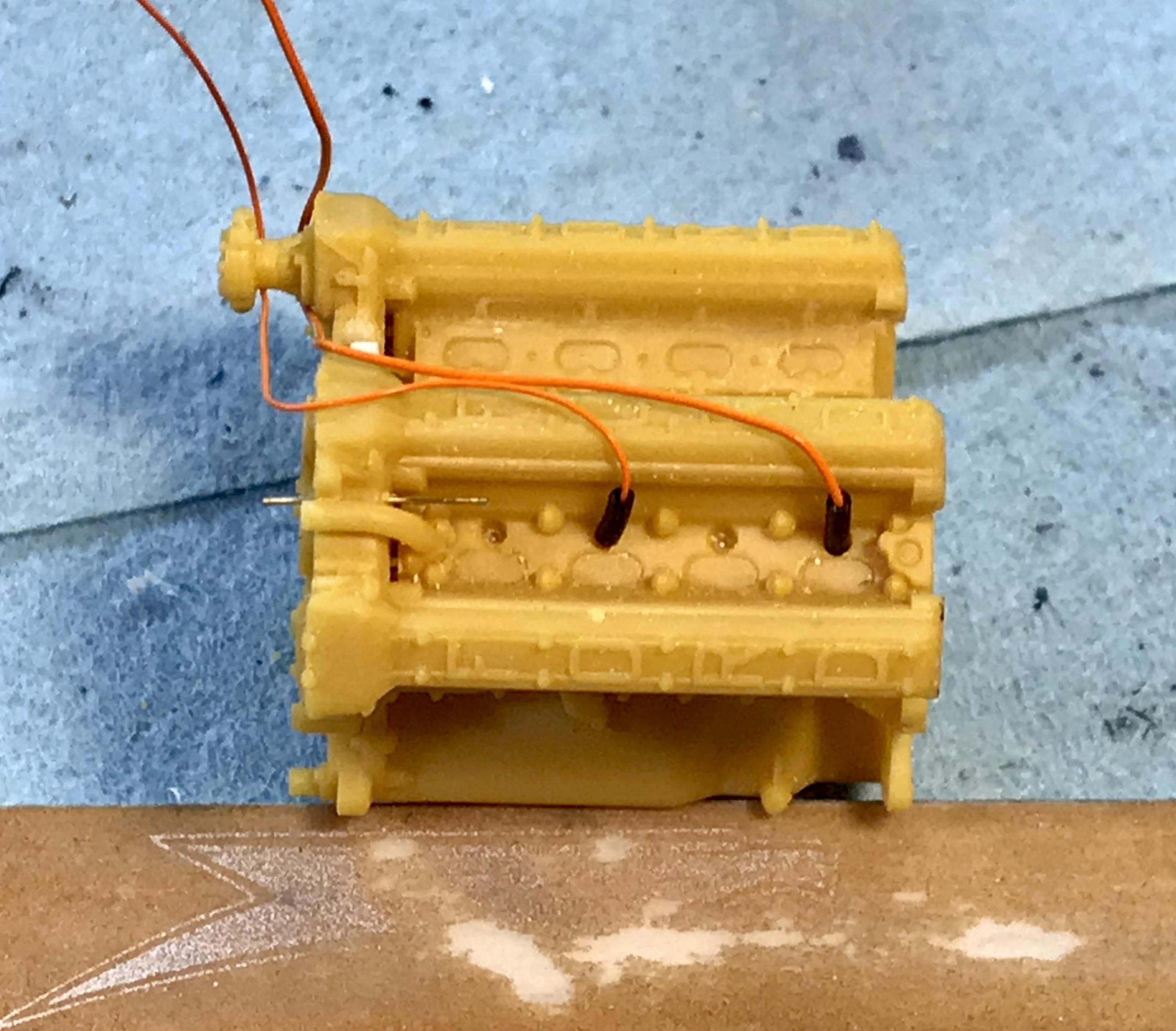

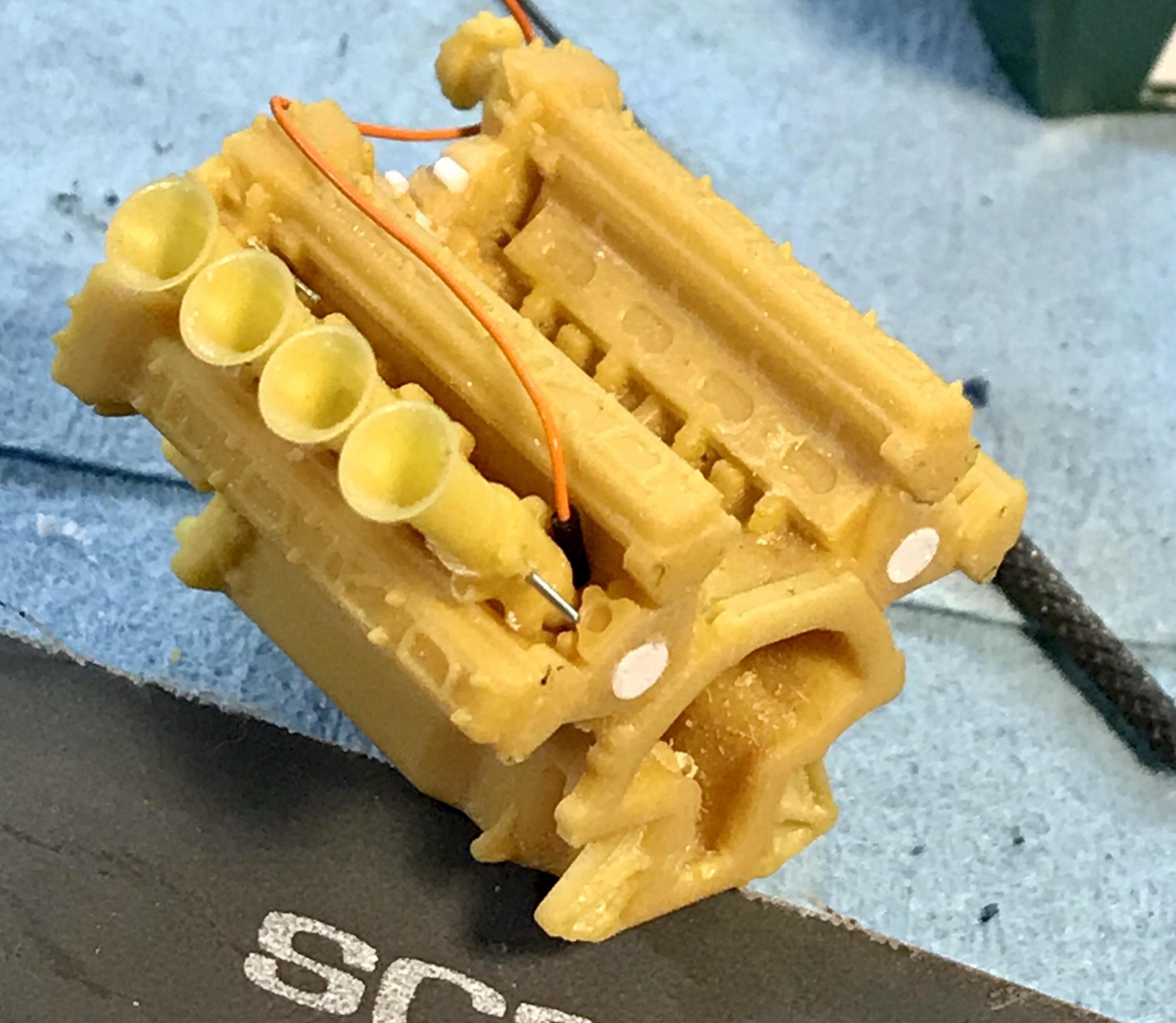

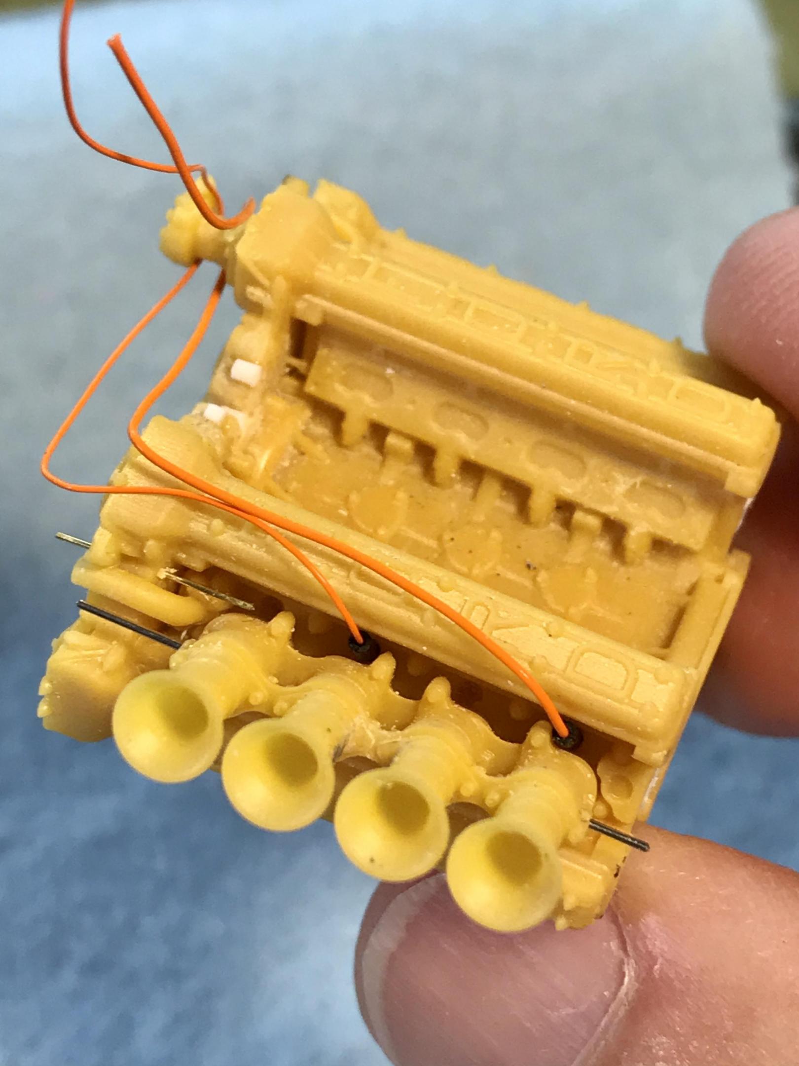

Just ordered mine. Was not aware of the reprint. Thanks again Some slow going. Removed some of the valve cover bolts and drilled .0125 holes for some .012 nickel rod- then cut and drilled .015 by .040 evergreen strip these will Serve as the bases for the plug looms - which are on their way from detail master. Also placed some .047 plastic plugs into the cylinder head to hold the base of the carbs and you’ll notice from the mock up shot the stagger of the cylinder heads. Not sure that the Gurney Eagle kit got this right. - will check

You win ! I did some web snooping this afternoon. Some pages of the ‘65 Ford performance Pamphlet for this engine have crept onto the internet and it is pretty clear from the drawings that the smaller wire size will better. Mad; do you have that pamphlet ??
Alrighty then... detail master sells .013 and .016 orange plug wire ... the perfect size would be .014. - oh well - I’m leaning towards using .013. Inviting your votes ... rules. Any forum member is eligible to vote - regardless of party affiliation - one vote per member - but you can change your mind as many times as you want - I’ve changed my mind three times already this morning ...

I forgot about the rev’s display engine! Revs is about 110 miles west of me across “alligator alley”. Don’t ask ... of course it is closed now. But I plan to go back there when it reopens - maybe Junewhoknows ... couple more Q’s ... the plug wires - yours look perfect - I’m uncertain whether to use.013 or .016 for these. What did you use in 8th scale - I’ll try to do the math. I like your paint on the 1/8 The engine block looks like it is a mix of gun metal and something else silver - and are the valve covers flat black with a little something? Maybe some grey or gum metal ? the links and the fuel line fittings are driving me nuts. Gonna have to machine some elbow fittings and draw out the links. And no, Randy - the linkage will not be functional . I am not THAT functional ... and thanks again ... your humble obsessive whatever ...

The fuel distribution blocks straddle the bracket in the center of the valve train cover. Made from evergreen bar and drilled for the fuel lines and adjustment screws . Have to make part that suspends the linkage rod - this will be brass or nickel ... probably paint the fuel blocks a shade of anodized blue - as per the 8th scale prototype - I think that is correct ...
another question for mad ... the diameter of the linkage cross bar - appears close to 1/2 inch and the diameter of the steel fuel line - appears slightly more than 1/2 inch nominal outside dia - 5/8 ??? just made the forward facing fuel distribution block ... thanks in advance
