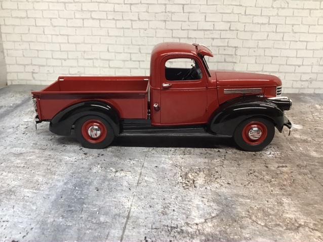

  3. I made a new floor pan and firewall since the diecast didn’t really have them. This will also give me a base to add some cab mounts to.
  4. I wasn’t happy with the rear window groove I made, so filled it in with Milliput and made a new flange to fit inside the opening. The groove was ragged, and the window was starting to look a little larger than it should be. I then made a new window “gasket” from .040 half round I did the same with the windshield, after glueing a lip of styrene inside the opening. It looks much better I think than the “Buddy Holly” look I had with the prototype.

  16. I made a windshield “gasket” out of some thin styrene to get an Idea of how it will look. I want to file a small recess all around the opening to set the gasket into, but I’m afraid I may destroy it. I tried doing one on the rear window with my dremel and it wasn’t easy...especially where it transitions from die-cast to Milliput. I am going to try to cast this first and then maybe experiment on the casting.
  17. I think this pickup cab was derived from a wagon which would maybe account for the lower roof profile? So I was all set to start sketching out new profiles for the roof mods when I had a revelation. Why not take photos of my actual truck and resize them. Once the photos spanned the drip rails of the diecast nicely, I made templates out of them. I then slathered on the miliput . I couldn’t get the cowl shape quite right since it should start sloping up to the windshield sooner whereas the die-cast has that area pretty flat. so I wound up filing the vent lid off and making a new one from .030 styrene. I also re-shaped the front edge of the fenders and rounded the sides a little. And I added the ribs on the back of the cab. I also filed off the trim on the lower edge of the hood and side of the cab.
