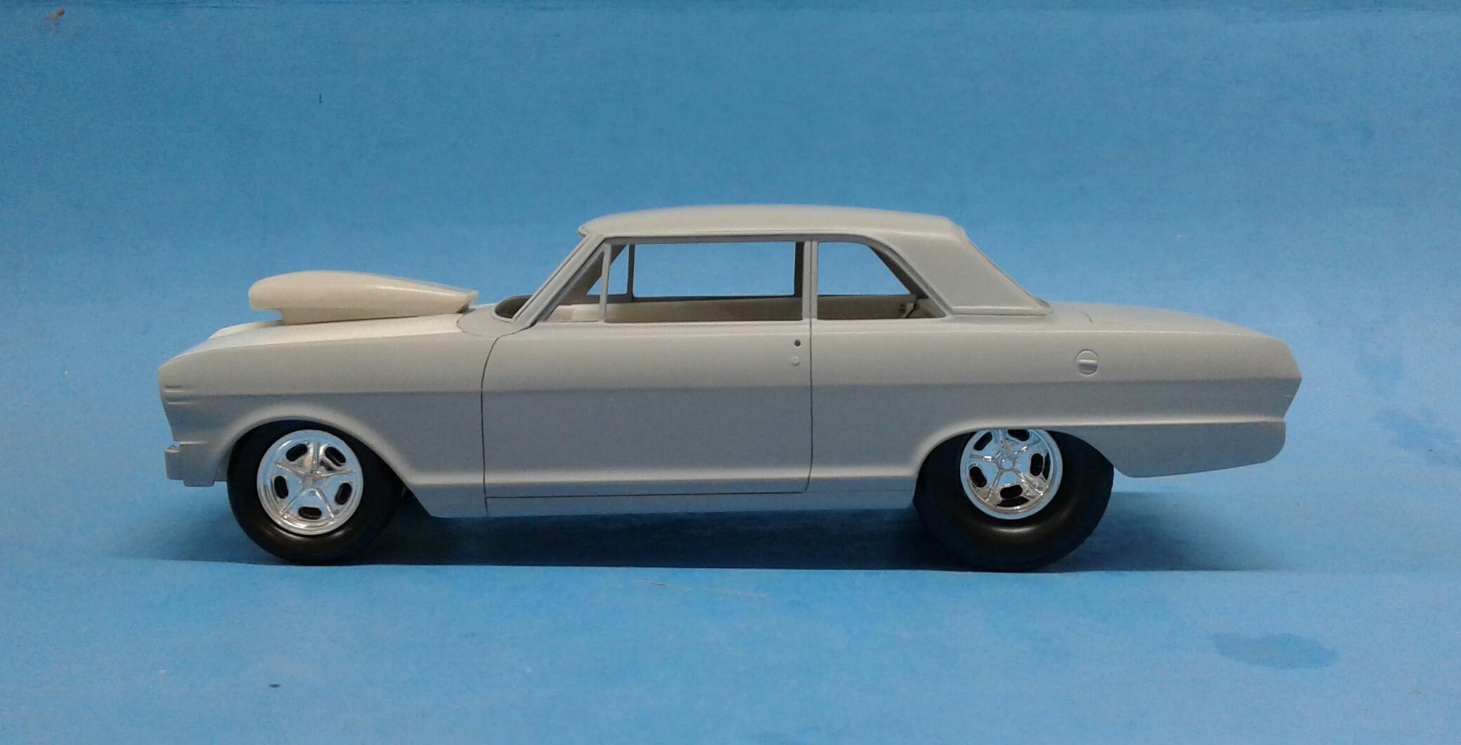

I got the suspension glued together enough to do a stance check. I flipped the front spindles to lower the front a little. I found a set of wheels from the Revell Rat Roaster. I like them. But, the rear wheels look so tiny in those big meats. I may need to go to a smaller tire. Or, I may need to find a bigger wheel or add a beadlock to the rear wheels. I think these wheels will go well with the colors I have planned. Something odd with this chassis is how the rear springs hang out past the rear crossmember. I remember it being quite thick as I've cut it down a time or two and built the first issue. Now, it's so thin it won't catch the springs. This chassis is is from the Boyd's edition. So, I wonder if they changed it for this kit and the later issues are like this also. I have a newer one molded in blue that I can check. Looks like I'm going to have to fix it on this one or shorten the springs. -

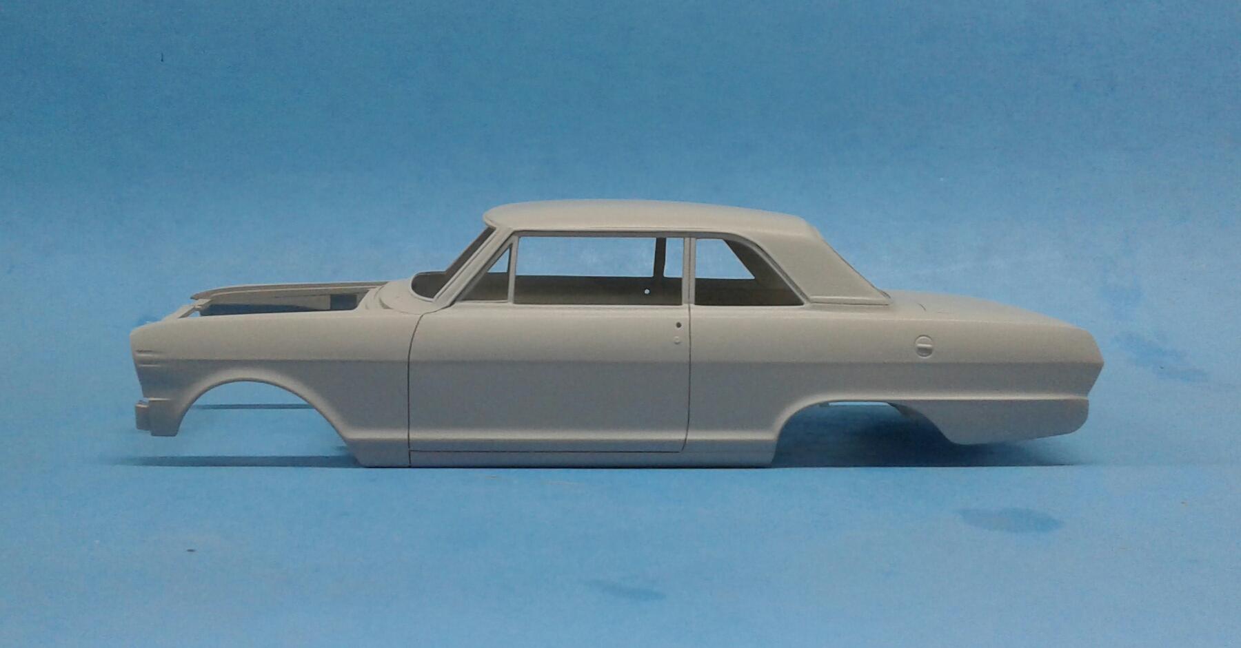

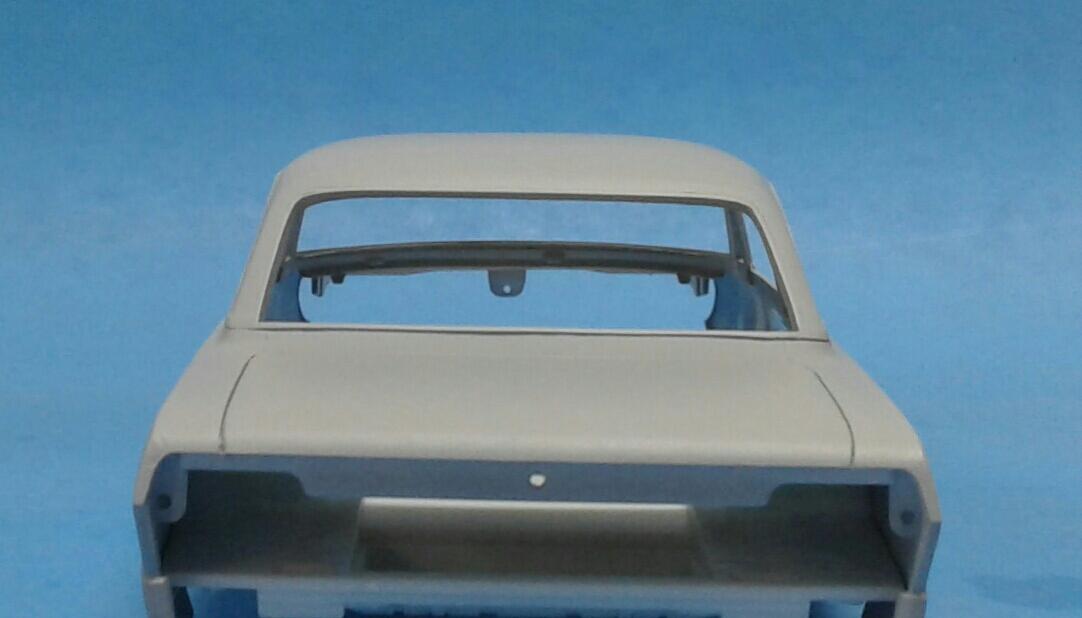

Thanx Dennis! I saw the roof issues as soon as I pulled it out of the box. Once I saw the overhead view, I saw I was in for some serious work. I'm hoping the two tone paint job will help disguise the slight chop it has. Thanx for the offer on the supercharger! But, I really want the Weiand supercharger from the Rat Roaster. I really like the way it looks. -

Thanx Steve! Be glad you got the '64. Moebius butchered the roof on this kit. I have many hours getting the roof and body back into shape! -

Not sure on the engine. I was kinda thinking about using the 327 from the '66 kit. I also have most of a Rat Roaster engine laying around. No blower for it though. I'll cobble something together. -

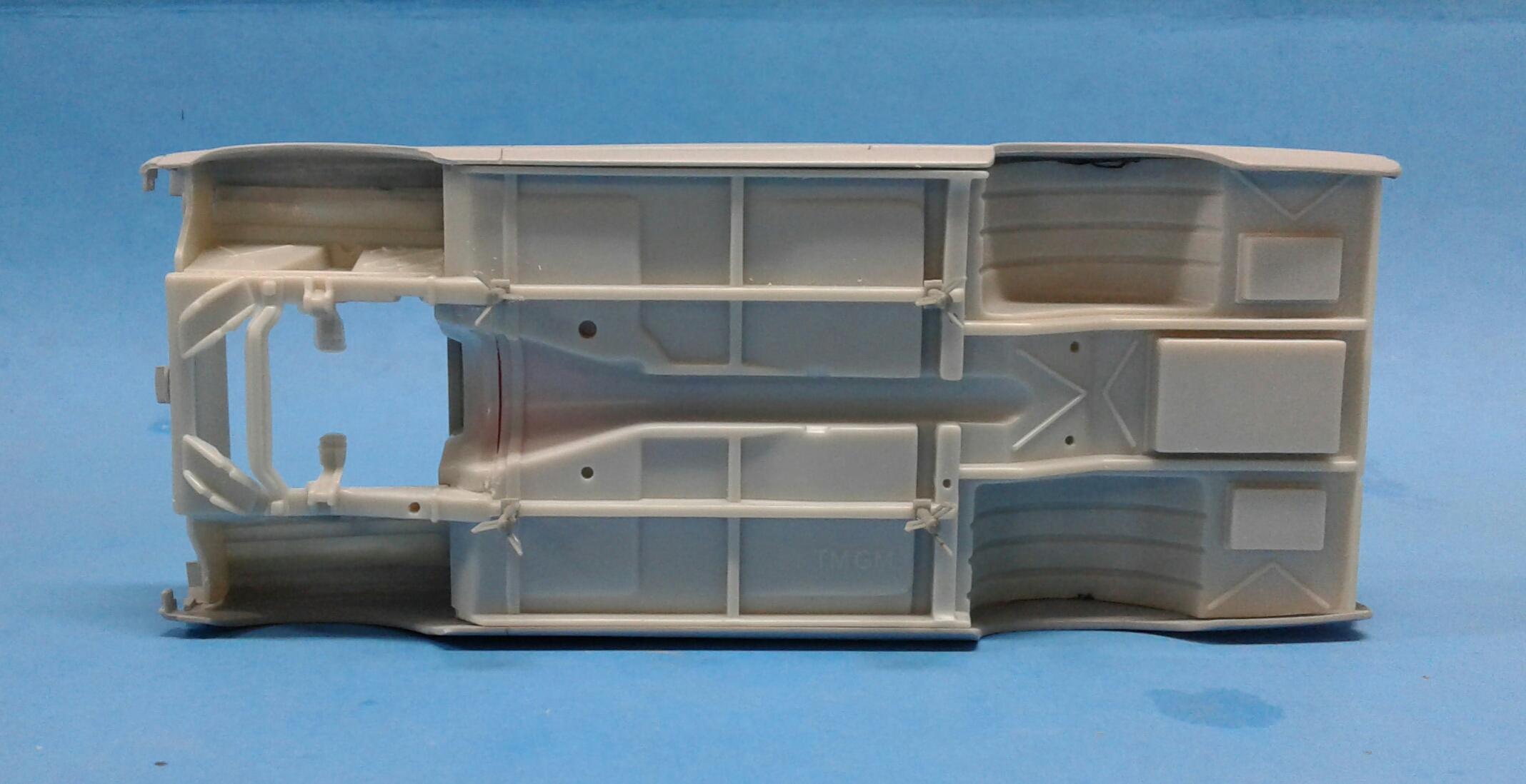

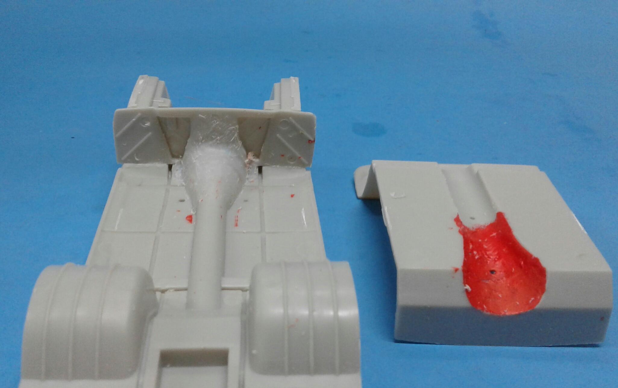

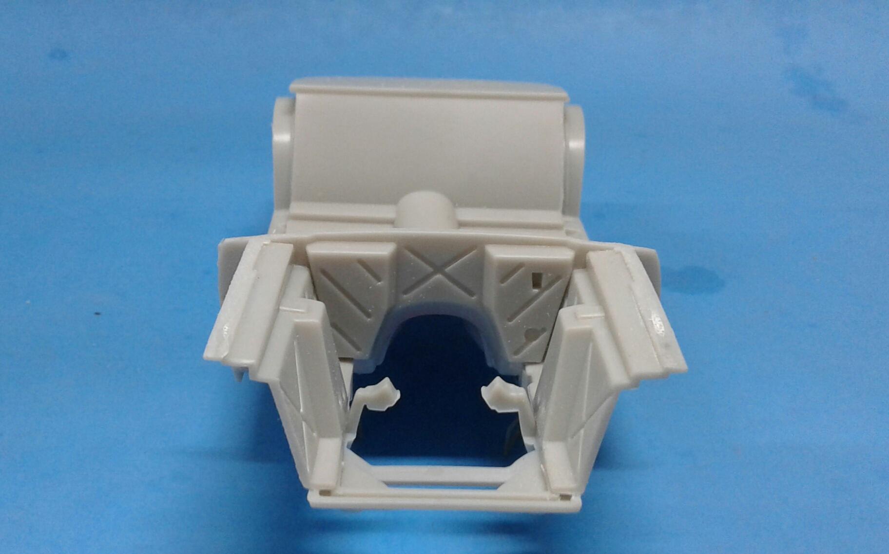

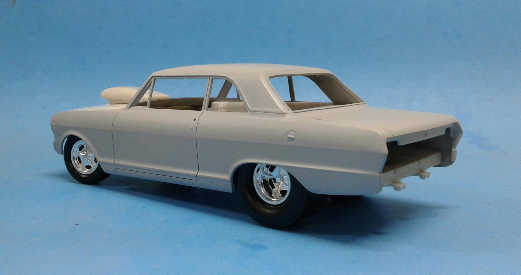

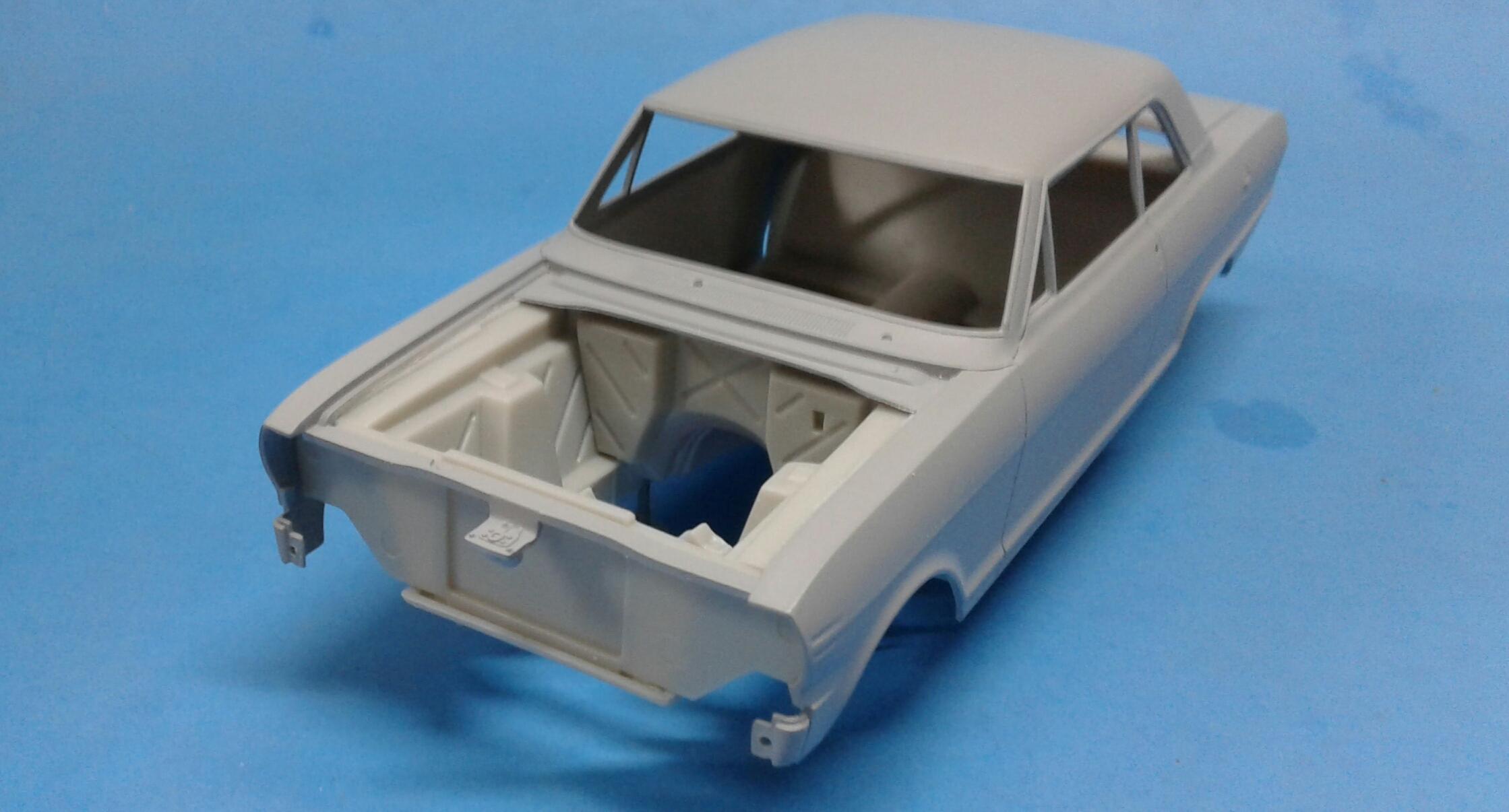

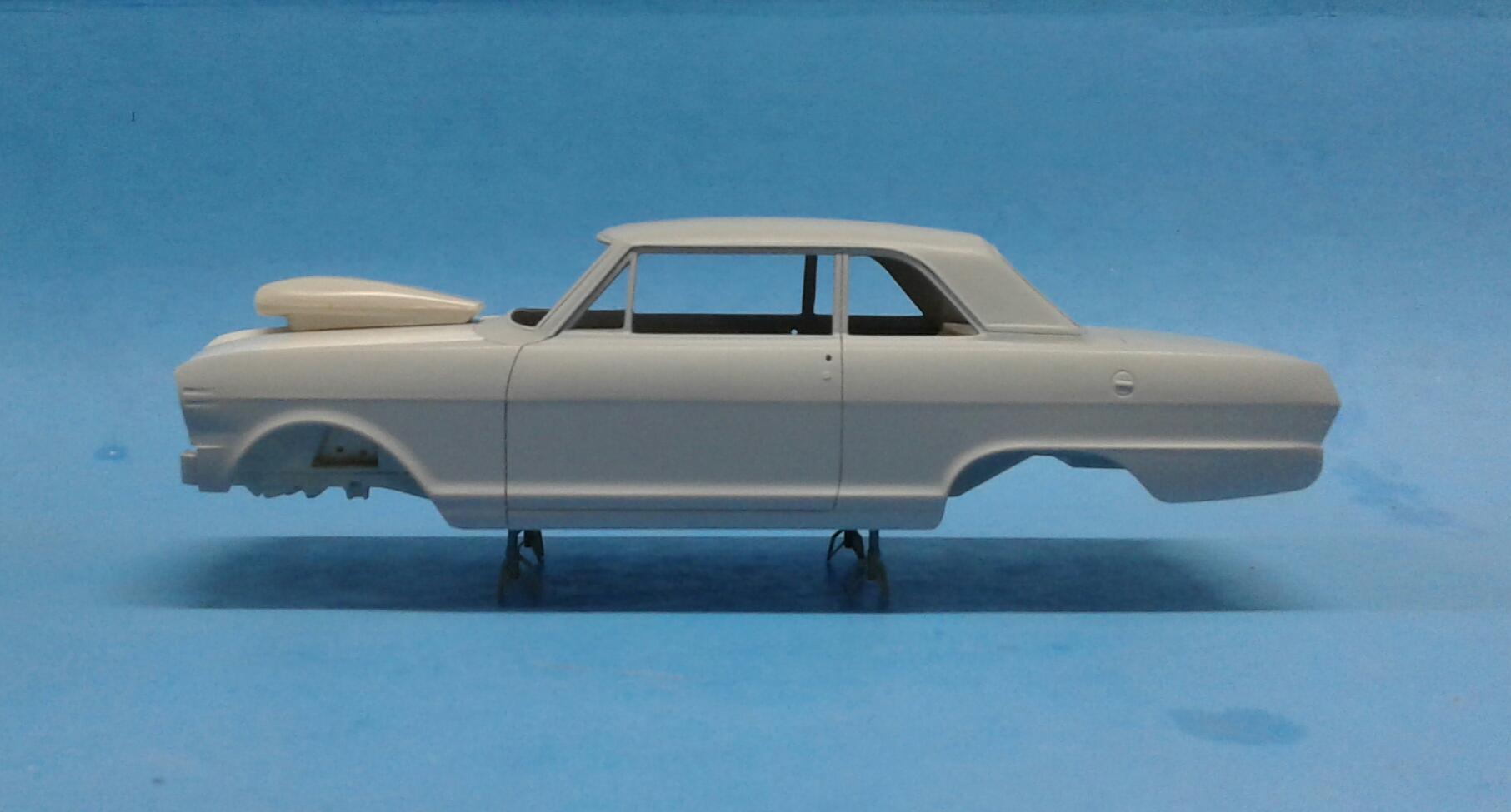

After finally getting this body into decent shape, I decided to go ahead and build it. I'm not a fan of gassers. So, the decision to build it as a pro street was easy. Especially, since the chassis from the '66 fits so easily. It just takes some minor trimming on the top of the wheel tubs and behind them. The first thing I did was glue the firewall and inner fenderwells to the chassis. It takes a bit of filing and sanding to get them to fit well to the firewall and chassis. It makes it a pain to paint. But, I'll get a cleaner look with no gaps. There's a fitment issue between the chassis and floorpan at the transmission tunnel. The floorpan won't go all the way down and will rock back and forth side to side. I first ground out what I could on the floorpan. Then I did some grinding on the transmission tunnel on the chassis. Still didn't fit! To find where the issues were, I brushed a thick coat of red enamel on the transmission tunnel on the floorpan. I placed it on the chassis and wherever the red paint was, I ground it away until it fit like it should. Then it was time to get the body and chassis to fit together. I cut away most of the flanges on the front fenders and did some trimming on the firewall and got them fitting together quite well. I need to trim the flange on the cowl back some so that it doesn't hang over so much. I can't wait to get the suspension together to see how the stance is going to be and how the big tires out back are going to look! I'm not sure what wheels I'm going to use yet. I do have a color in mind. I'm thinking Tamiya Gray Green with maybe a Racing White roof. But, that's not in stone yet. I may find another color I like better when the time comes.

Thanx Carl! I've took this thing about as far as my abilities and patience will allow. I have a few little nit picky things to take care of and it should be ready for final primer and paint. One of the nit picky things is the gas cap. It's crooked! So, I'm going to eliminate it since I plan on building it as a pro street. It's still not what I would call accurate. But, it's a lot closer than it was!
