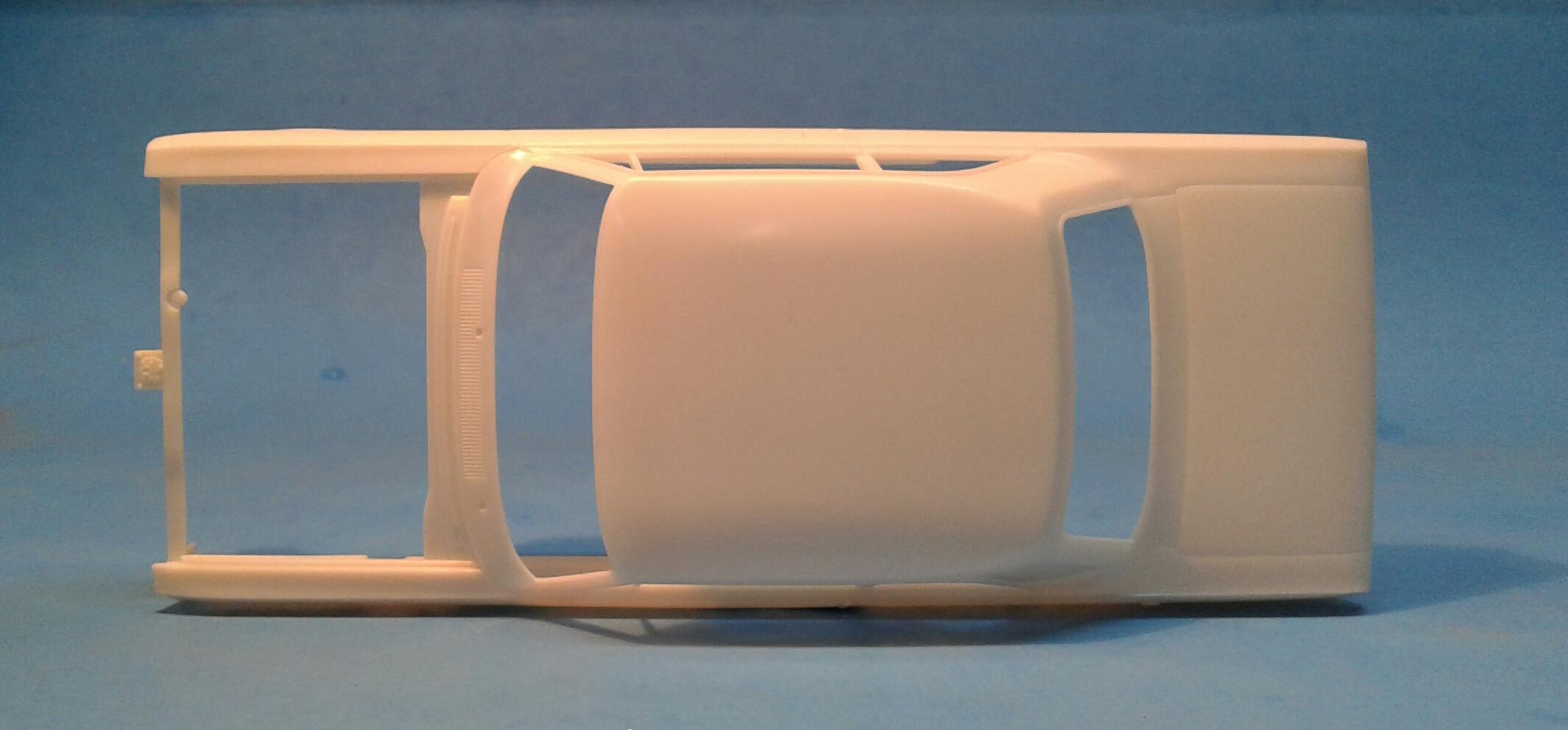

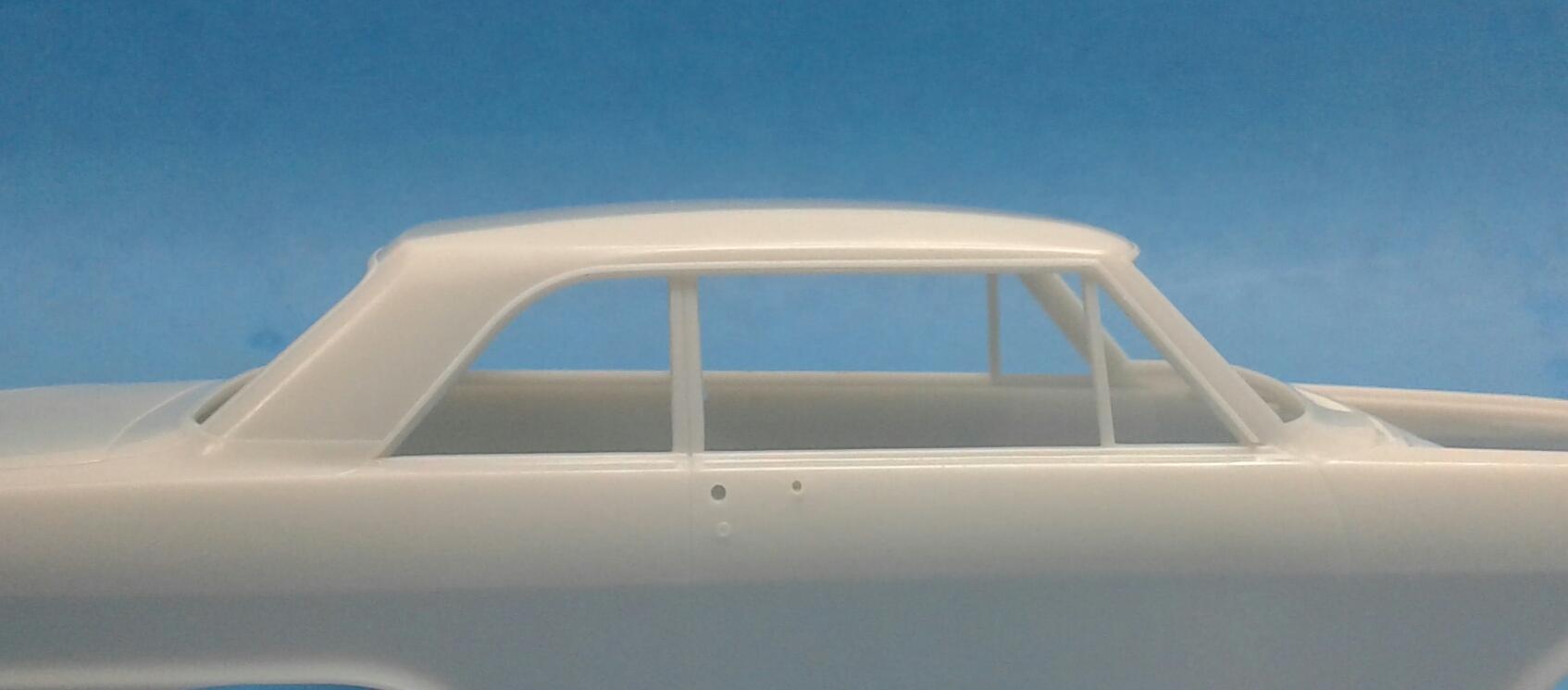

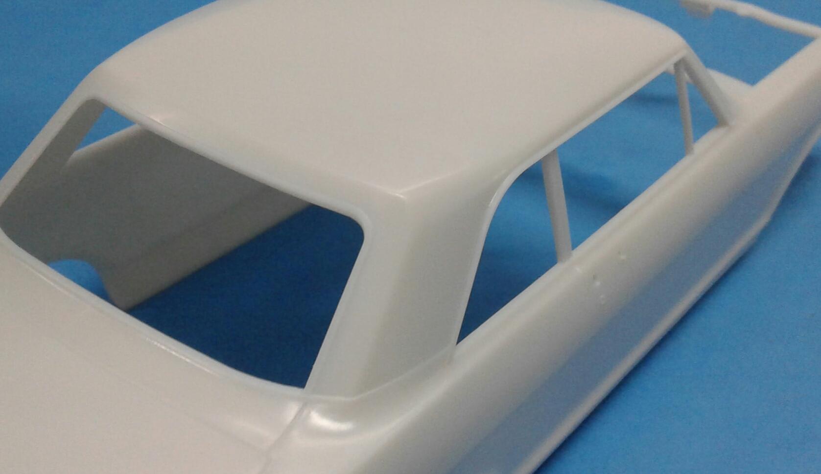

  4. I have to respectfully disagree Tim. There was no excess material at the top of the door panels. Please look at the photos that J C and I posted. Making the DLO the right height ruined the top of the door panels as well as the framing at the quarter windows and door. The framing under the drip rail is barely there. There's no denying it. The roof height is wrong. Measurements prove it. The AMT '63 Nova wagon has the correct roof height. It measures .6755 from the beltline to the bottom of the drip rail. The Moebius '65 Nova measures .6175. That's a difference of 1.45 scale inches. The backlight measures 1.8665 inches. That scales out to 46.6625 inches. It should be 55 inches. That's a difference of 8.3375 inches. How can anyone explain that away? I'm going to attempt to fix it and have began the process. It probably won't be 100% correct. But, it will be way better than it is out of the box.

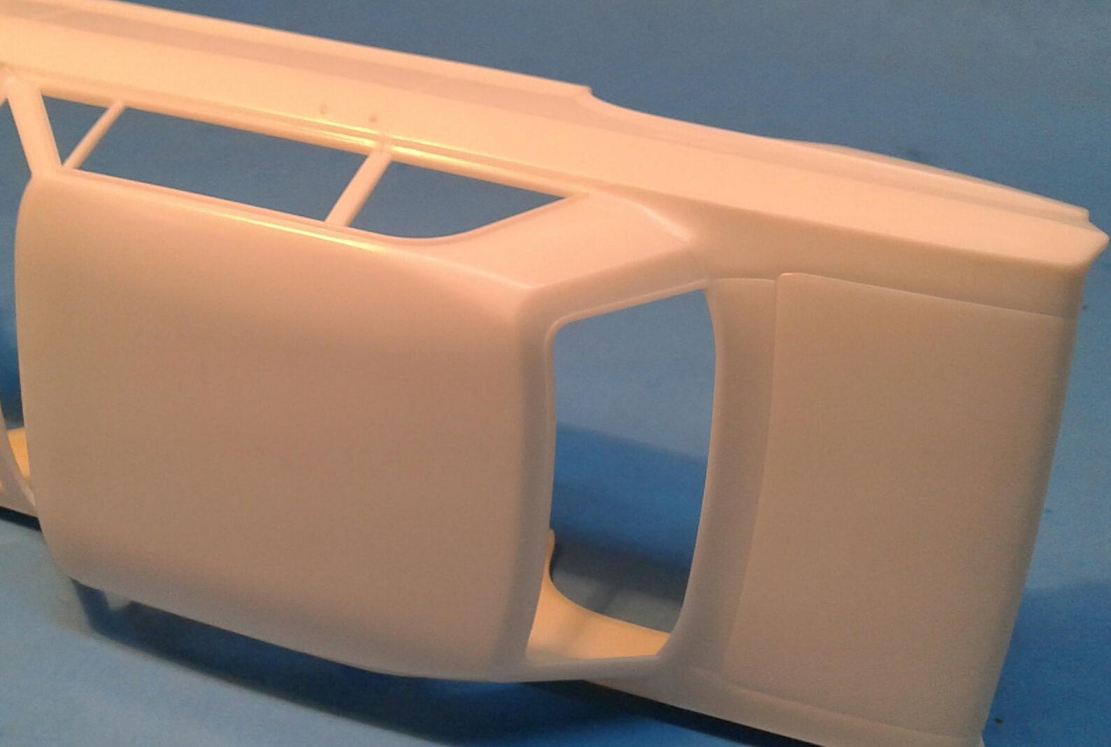

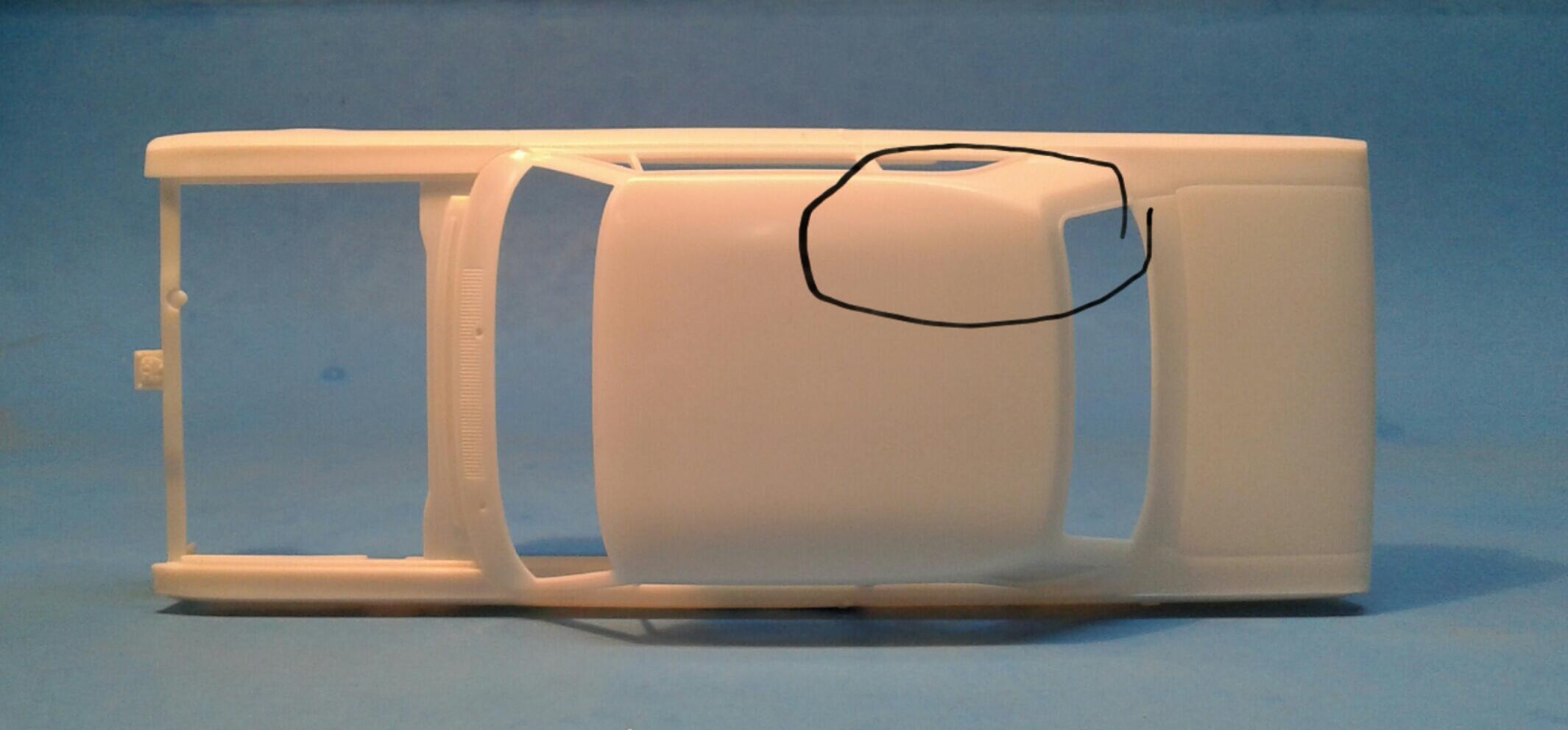

  9. I noticed it. But, for myself, I see it as an advantage. Does the stock '64 have the same floorpan?
  10. That's the reason we get kits like this. As long as builders accept mediocre kits, the kit companies will keep pumping them out.

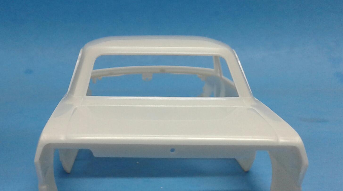

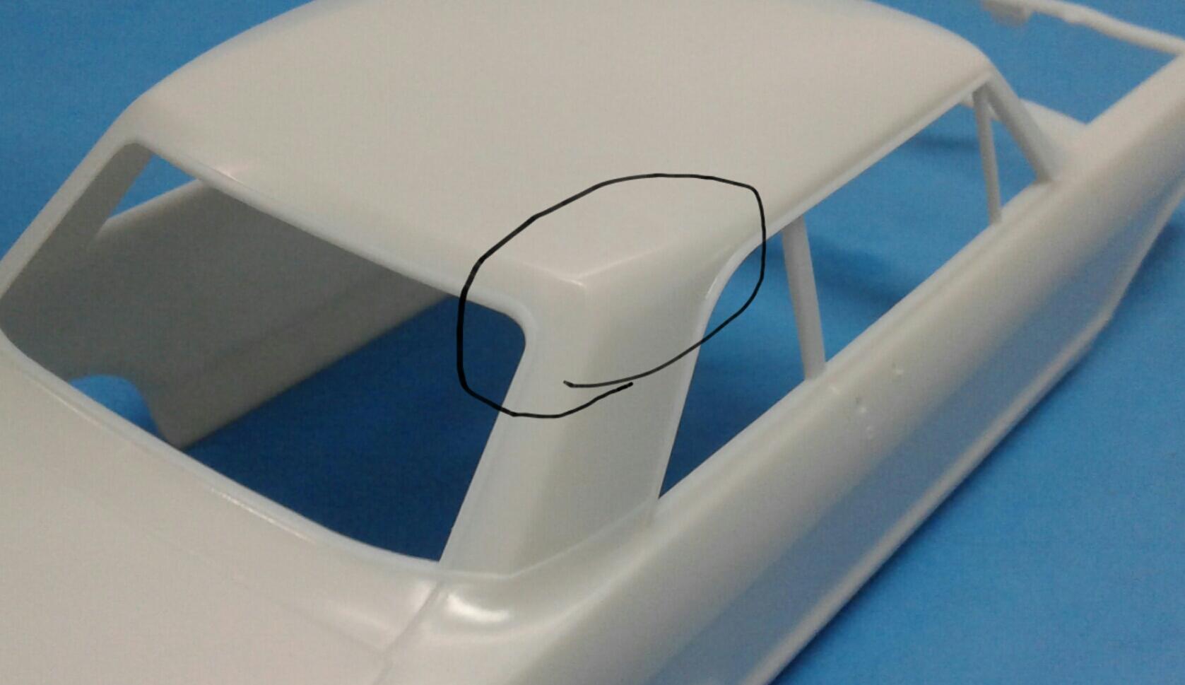

  12. A lot. The first thing I noticed out of the box was the huge flat spot at the top of the C pillar. Another angle. When viewed from above, you can see how much the rear of the roof tapers off. That taper causes a huge problem with the backlight. It measures 1.8665 inches which scales out to 46.6625 inches. Per the Nova Resource website, it should be 55 inches. That's a huge difference. But, it explains the overly tapered issue and the angled tulip panel lines. Then there's the two crowns that run the length of the roof. Those can be sanded away if the styrene is thick enough. Then, there's the roof height. I did comparative measurements with the AMT '63 Nova wagon. Most of the measurements were fairly close. Until I measured from the beltline to the bottom of the drip rail. The wagon measured .6755. The sedan measured .6175. Scaled out, there's a difference of 1.45 scale inches. The DLO openings were almost identical. But, that came at the expense of the frame of the door and quarter window and the lip at the bottom of the DLO. Both are almost gone. The frame at the top of the door only measures 1/2 mm. If there was a panel line between the frame and drip rail, it would be even less. This photo shows how the door and quarter frames should look quite well. This photo shows how the bottom of the backlight and the DLO are the exact same plane. It also shows that the lip above the beltline is pretty substantial. So, no, I wouldn't say it's accurate at all.

  18. Just got mine a couple of days ago. My plan was to stick a '66 Nova pro street chassis under it. Here's a few photos of the body.
