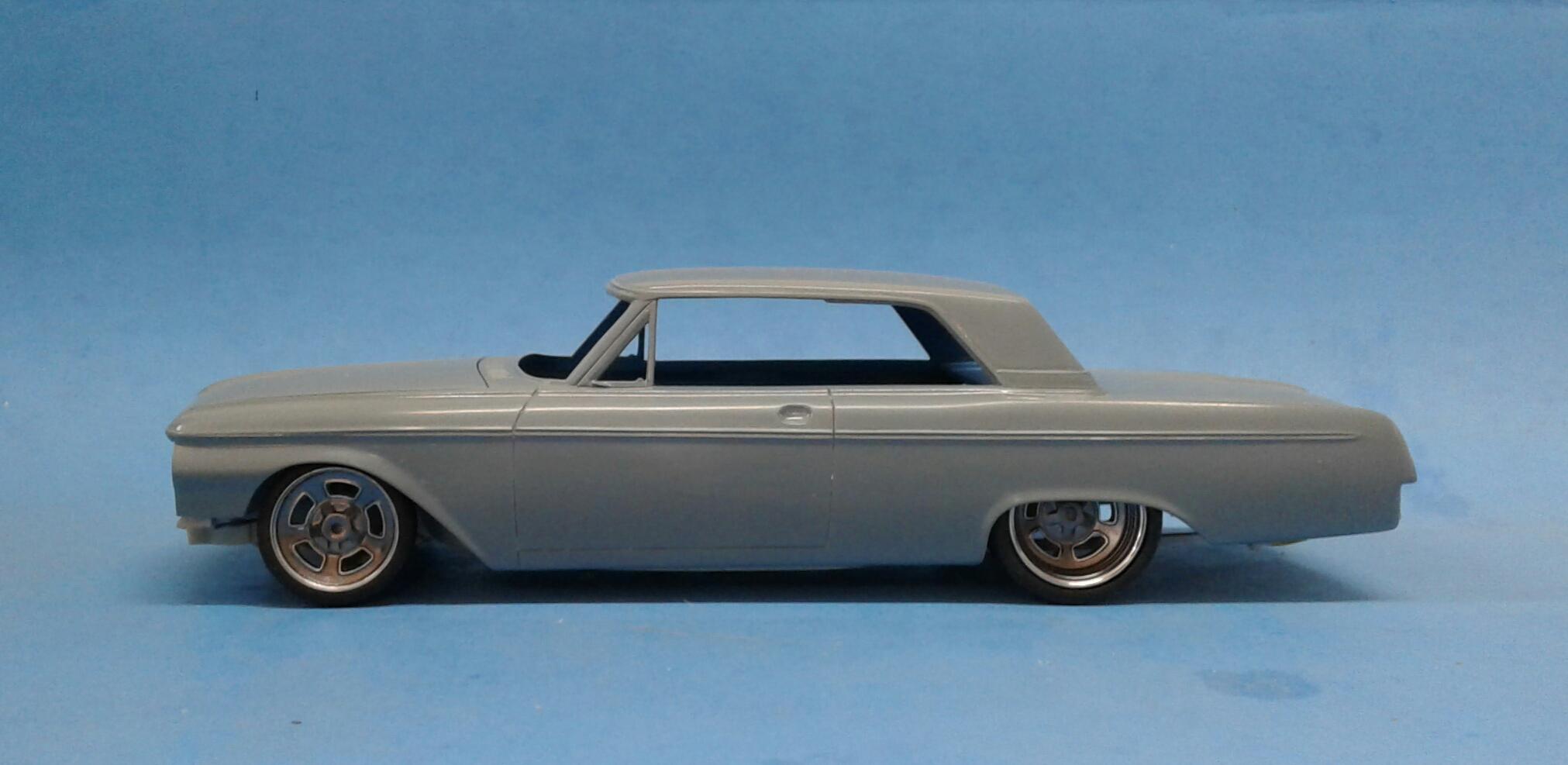

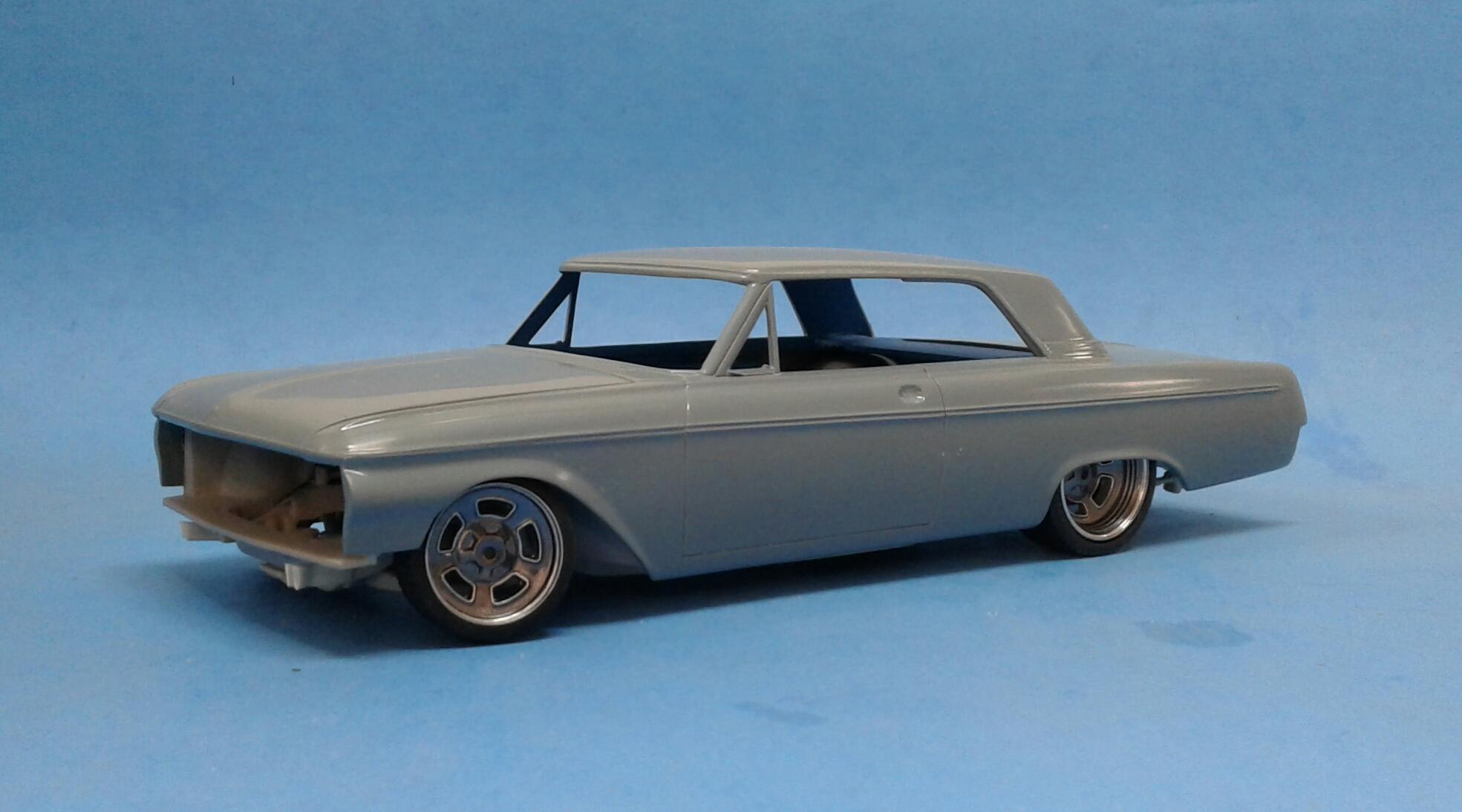

'62 Ford Galaxie 500 Update! 12/23/22 Finally Done! Pic pg. 7
Plowboy replied to Plowboy's topic in WIP: Model Cars
Thanx David! My wife doesn’t like like the "new" gray. She says it looks like primer. But, I like the way it looks on newer cars and trucks. I've been wanting to try it for a while and thought it would suit this model. I have the clear all sprayed and sanded ready to polish. I also got the wheels painted. I tried satin clear first. That wasn't it. Then I tried the Ghost Grey. That wasn't it either. Then I tried Gun Metal. That was what I was looking for! When I get the knock offs installed on them, I think they'll really pop! I couldn't wait to see what they would look like together with the body. So, I did another quick mockup. I think it's gonna be pretty sharp once it all comes together. -
