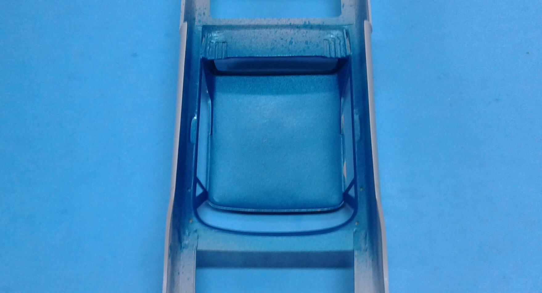

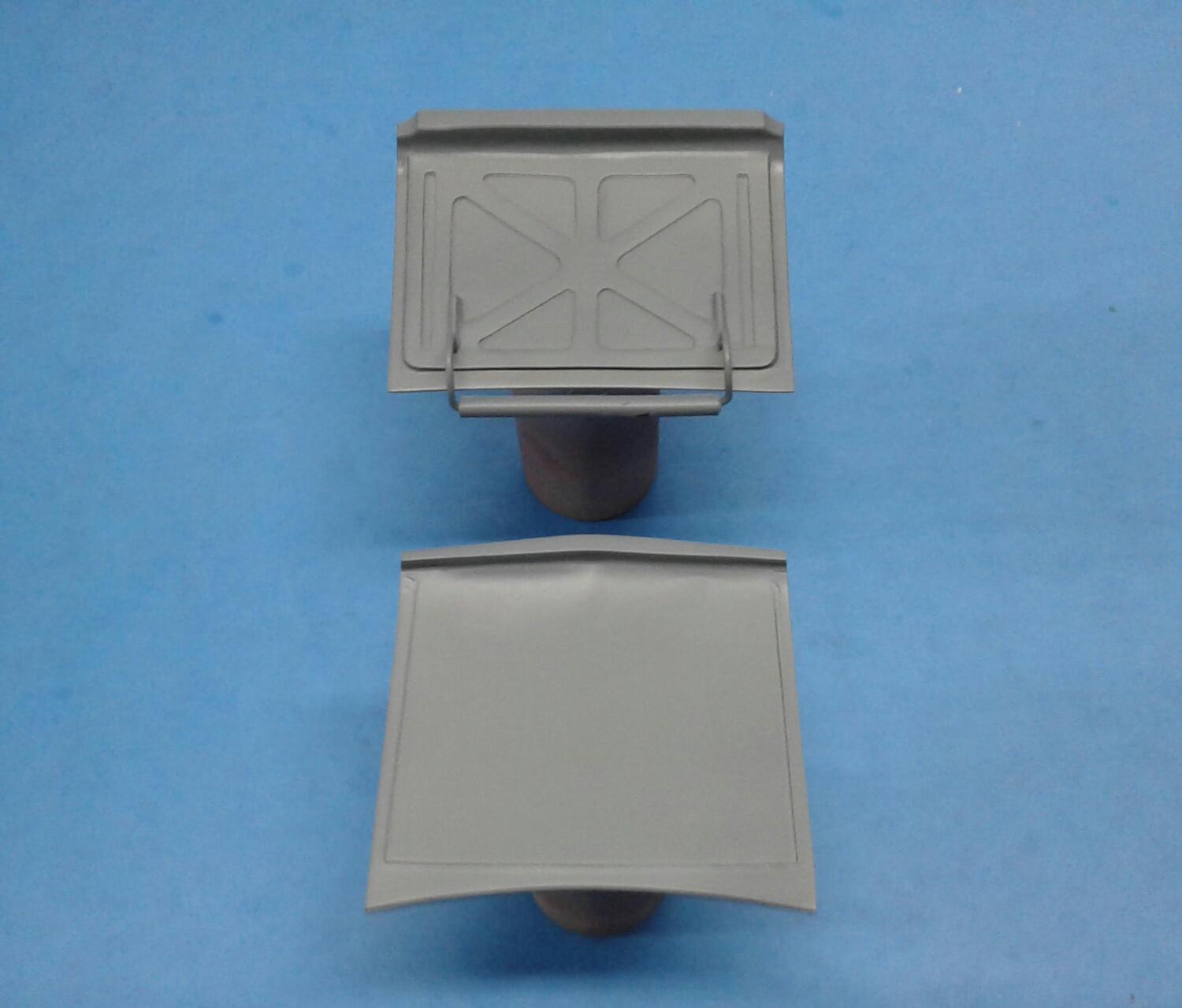

Thanx for the feedback guys, I appreciate it! First squirts of paint! The headliner is painted with Dupli Color Bahama Blue. Still needs Tamiya Flat sprayed on. I couldn't wait to see what the Haze Grey was going to look like. So, I sprayed some on the underside of the hood and trunk over barely dry primer. I'll sand and shoot them over later. I really like the shade of it! Not sure if I'll spray clear pearl over it or not. I know there will be those that say, "it looks like primer". But, it's quite different and has a very slight tinge of blue to it. You can see the difference in this photo. I'm thinking I'll paint the chassis and drivetrain with the Bahama Blue also. It'll make a nice contrast under the hood and against the floorpan. I'm going to hit the wheels with Satin Clear to see what they'll look like. If I don't like it, I'll paint them with Mica Silver and highlight the openings and rims with a Molotow pen like I did on my '69 Firebird. -

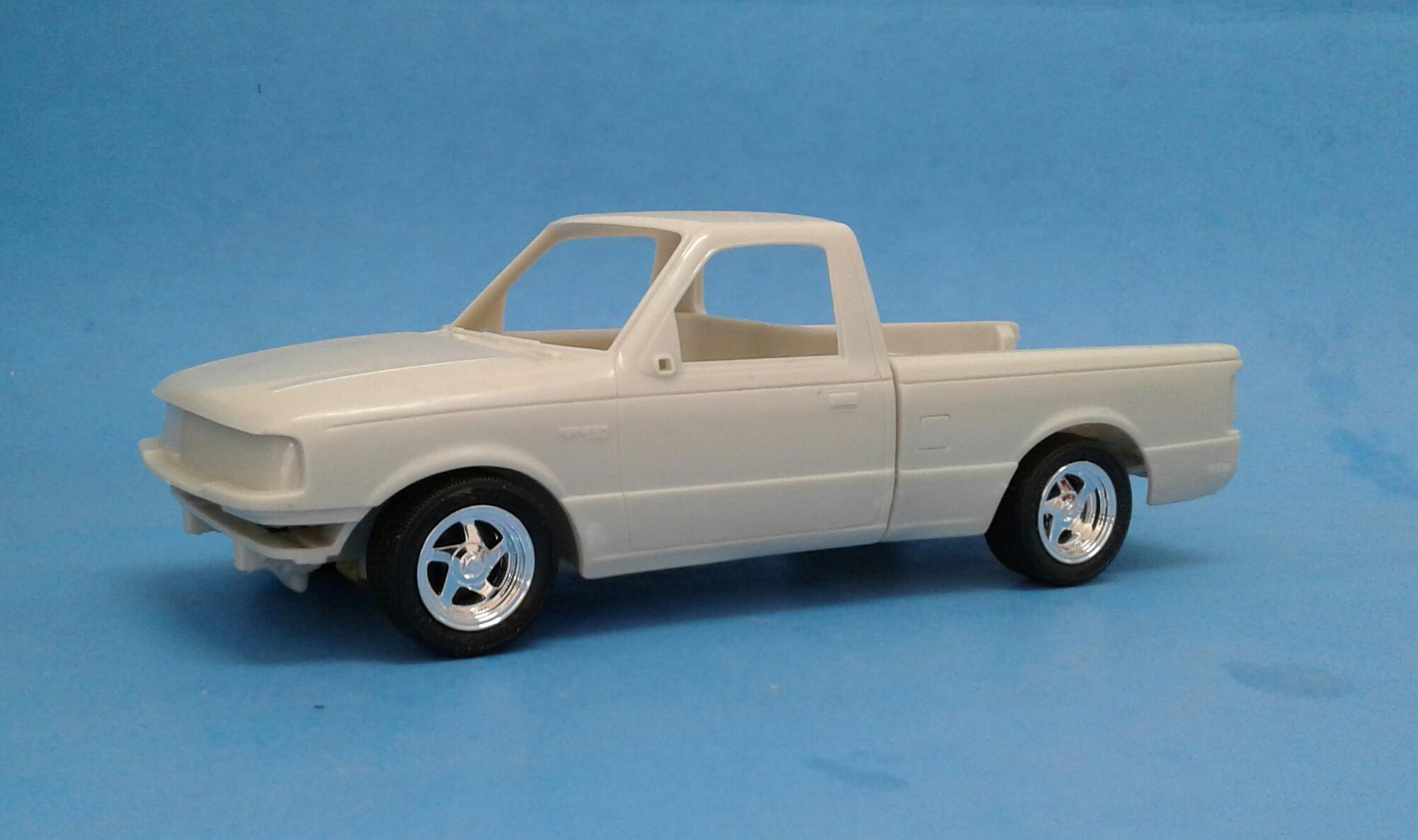

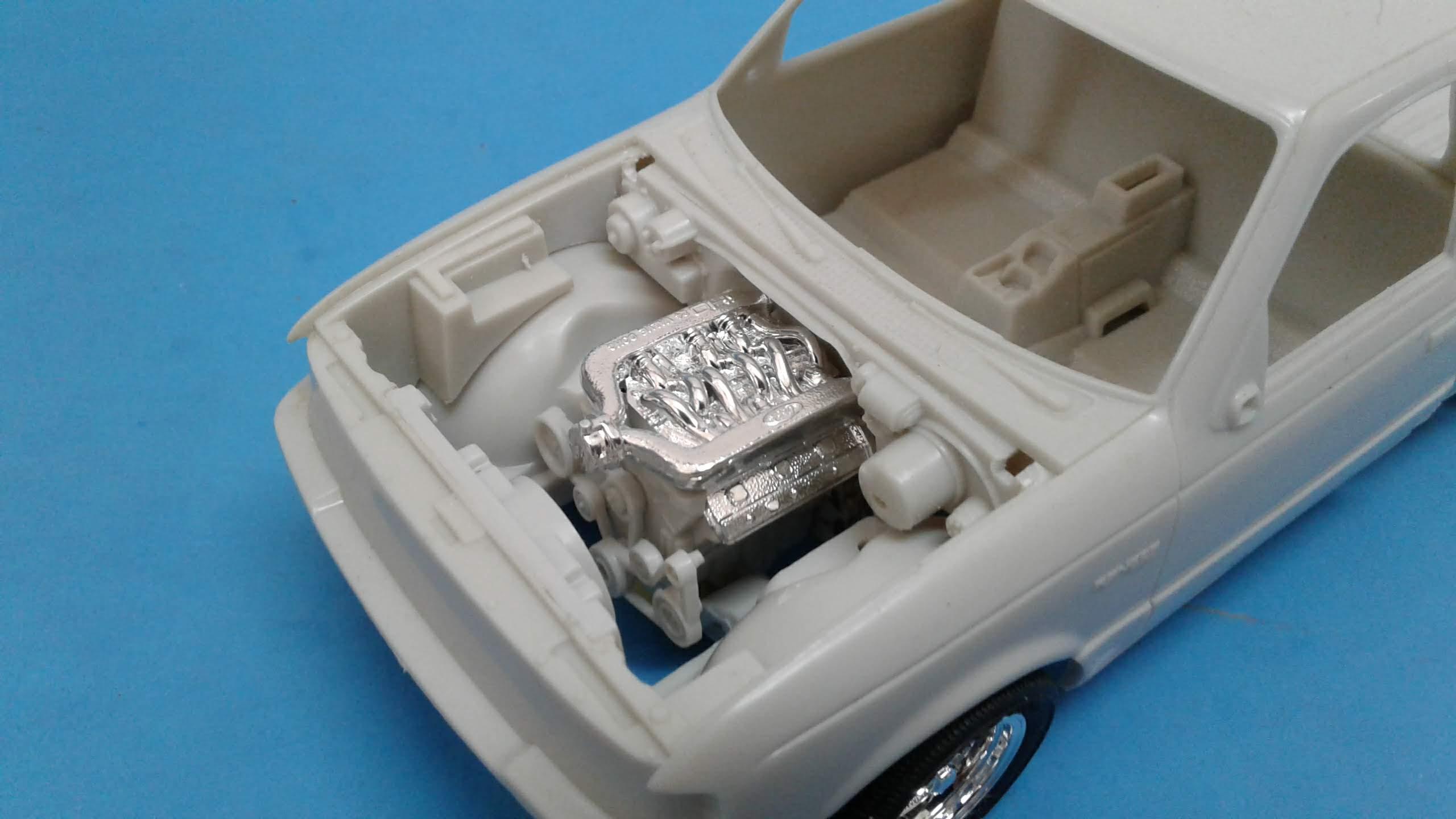

I've been piddling around with this little truck for a bit. A while back, I ended up with the 3.0 DOHC V-6 from a 1990 Taurus SHO. Not wanting to let the little engine go to waste, I decided to stick it into this Ranger. I first mated the engine to the 5 speed from the Ranger. Stuck it in and saw right away that I was going to have to do some hacking. I first moved the firewall back as far as possible. I cut out the radiator and replaced it with the one from the Taurus mounting it as far forward as possible. The oil pan had to be notched. The rear intake crossover pipe had to be shortened. After all of that, it slides right in! My first thought was to make it a sleeper using the stock steel wheels and downgrading it to an XL. But, it just looked too plain. Then I temp glued the ground effects on it. That was too much. Now, I'm thinking I'll just make it a nice looking little truck with a bit more punch under the hood. The wheels are from an AMT '93 F-150. Don't know if I'll keep them as they're a directional wheel and the spokes are all the same direction on all four wheels. There should be a pair of lefts and a pair of rights.

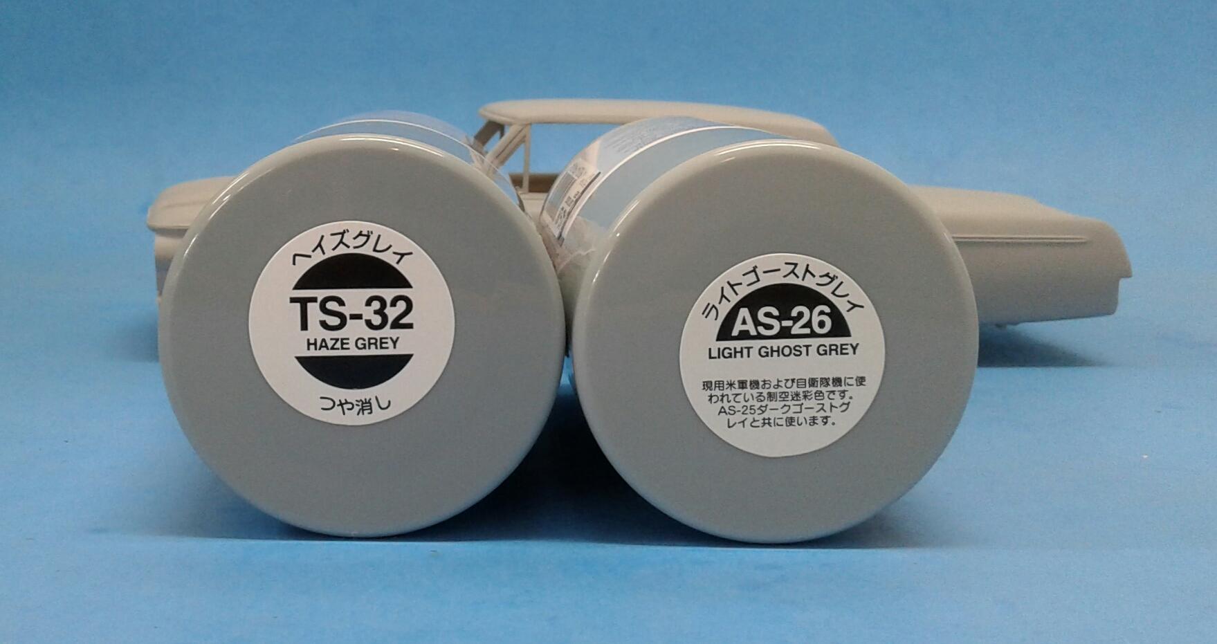

Lucky day! The Haze Grey and Light Ghost Grey arrived by UPS! When I first saw them, I thought they didn't look much different than the primer on it. There's only a shade difference between the two colors. But, both are quite different than the primer. Looking at the two together, it looks like the Haze Grey will be the winner on this project. It has just a tinge of a bluish shade to it. So, it should go well with the Bahama Blue interior. I can't wait to get some color shot on it to see what it's going to look like! Plus, it'll help me make up my mind about the wheels. Now, I'll just have to come up with a project for that Light Ghost Grey! -

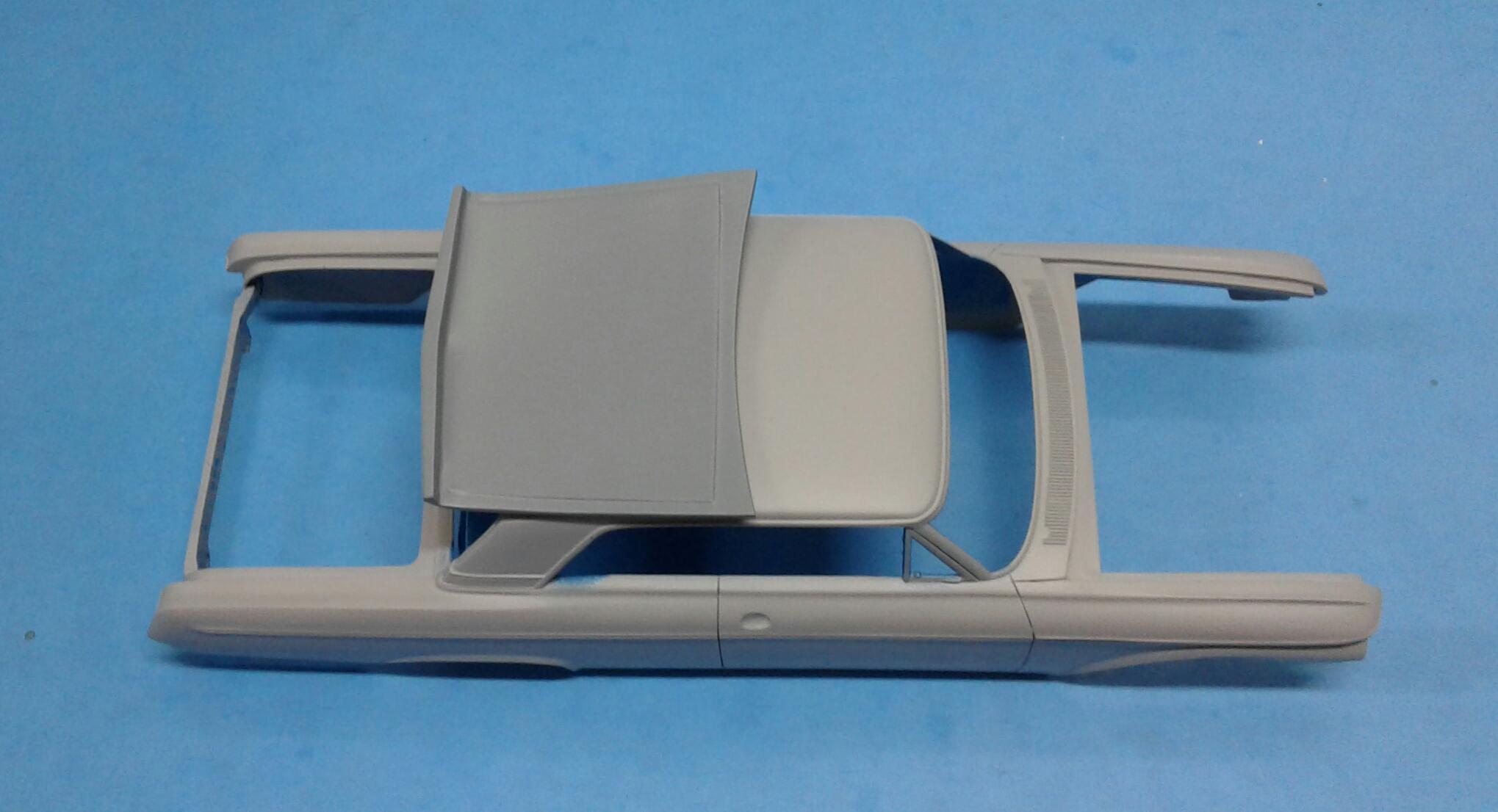

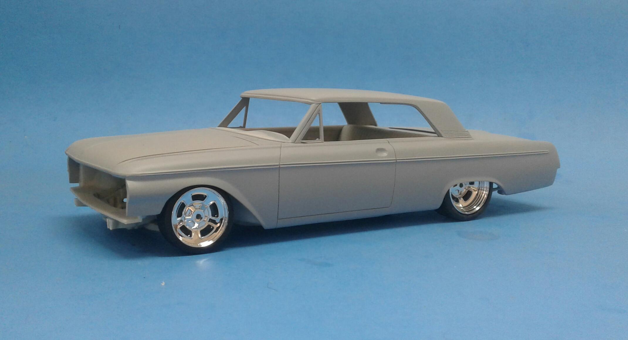

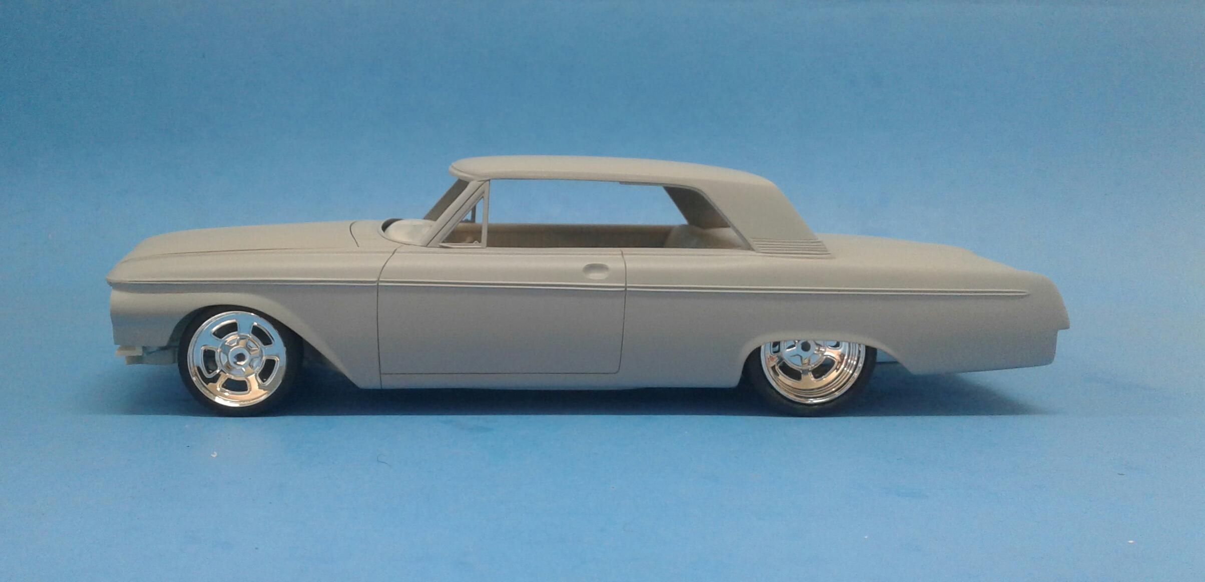

Thanx for the feedback guys, I appreciate it! I finally got the first coat of primer on. I made a couple of changes to the body. I added the quarter window detail using a strip of .020 styrene. I mulled over that for a while! It looks odd to me. But, that's how it is on the full scale. I may add the quarter glass to it so that it doesn't look out of place. After seeing Ray's Galaxie without the fender ornaments, I decided to get rid of them on mine also. Looks much cleaner without them! I have the body color narrowed down to two choices. It'll either be Tamiya Haze Grey or Light Ghost Grey. I want something similar to the grays you see on modern cars. I may shoot a coat of pearl over it, may not. Have see once I have the paint in hand. I haven't decided on painting the wheels or just shooting them with a coat of satin clear. Still plenty of time to sort that out. -
