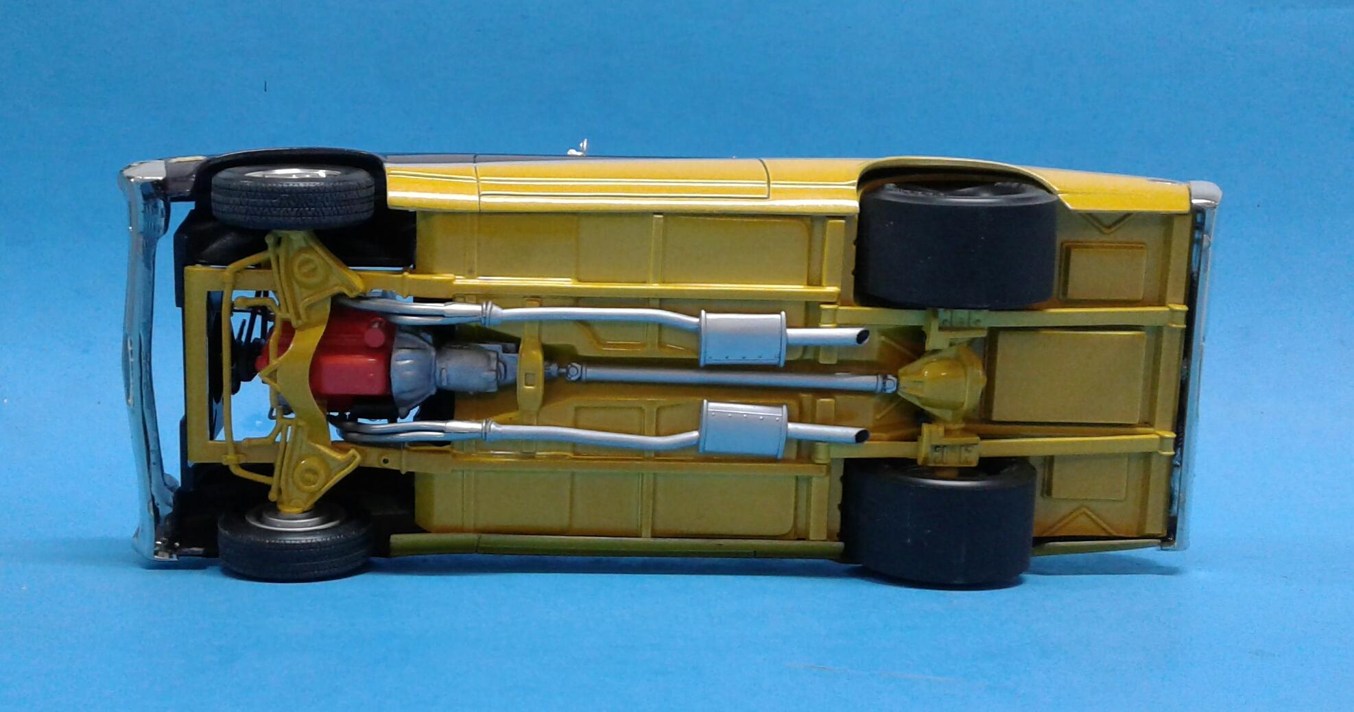

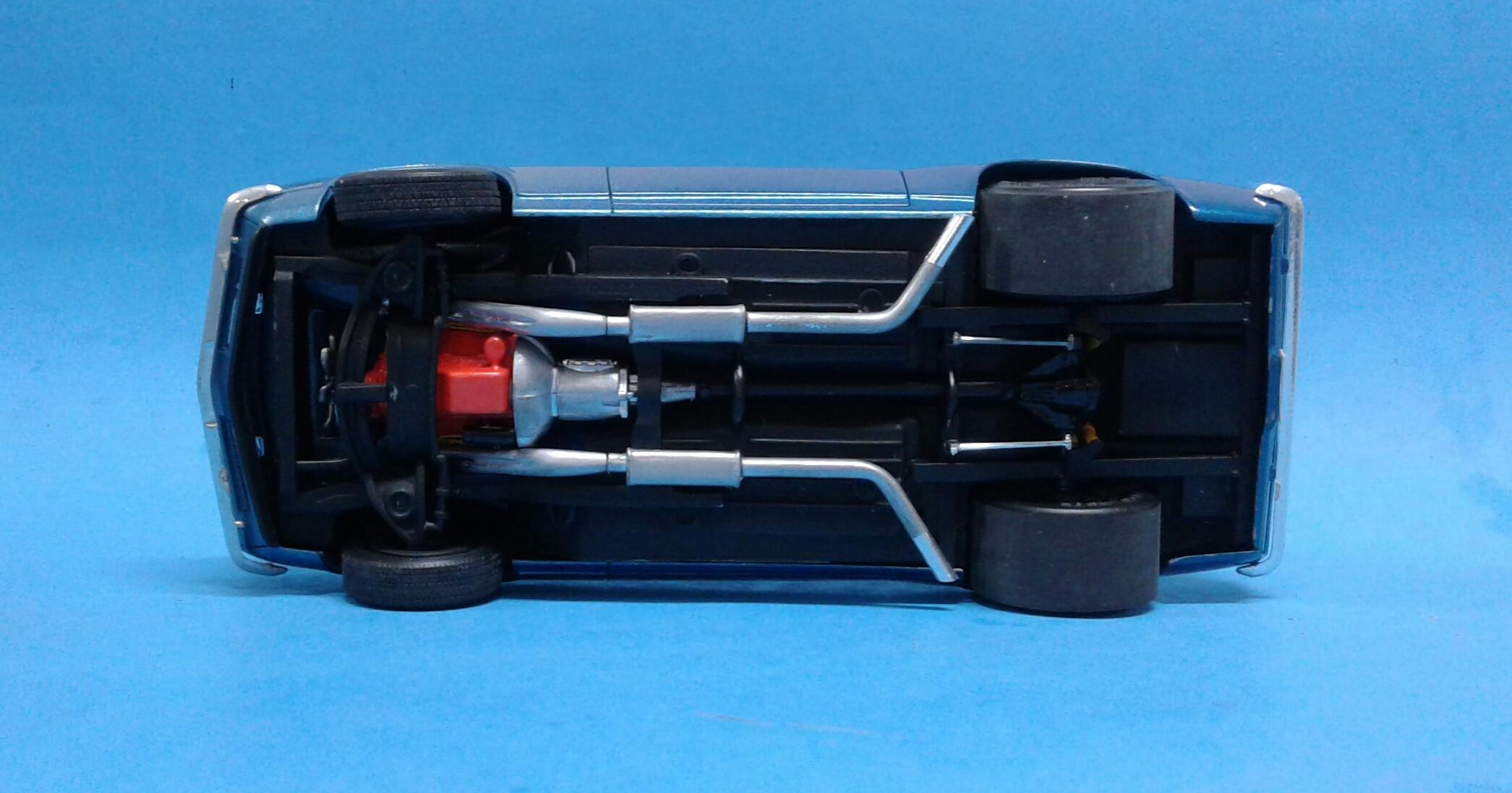

Here's pix of the three I've done with the Nova chassis. I was incorrect on the '66 Fairlane. I tubbed the kit chassis on it. The Nova chassis also fits under the Trumpeter Falcons. I've only got as far as checking the fit on that project. -

I'll have to get pix Bob. But, I've used it under a '72 Nova, '66 Mustang and Fairlane. I think a couple of others. The process is simple. Just cut the tubbed Nova chassis just in front of the cross member that the springs rest on. Cut your stock chassis just in front of the wheel wells. Place it in the body, place the tubs on top, mark it, cut and glue together. Trim to fit if necessary. Another way to do it is use the Nova tubs/ floorpan and graft the frame clip from your kit to it. I used the entire chassis under the '72. Can't remember if I changed the front suspension or not. -

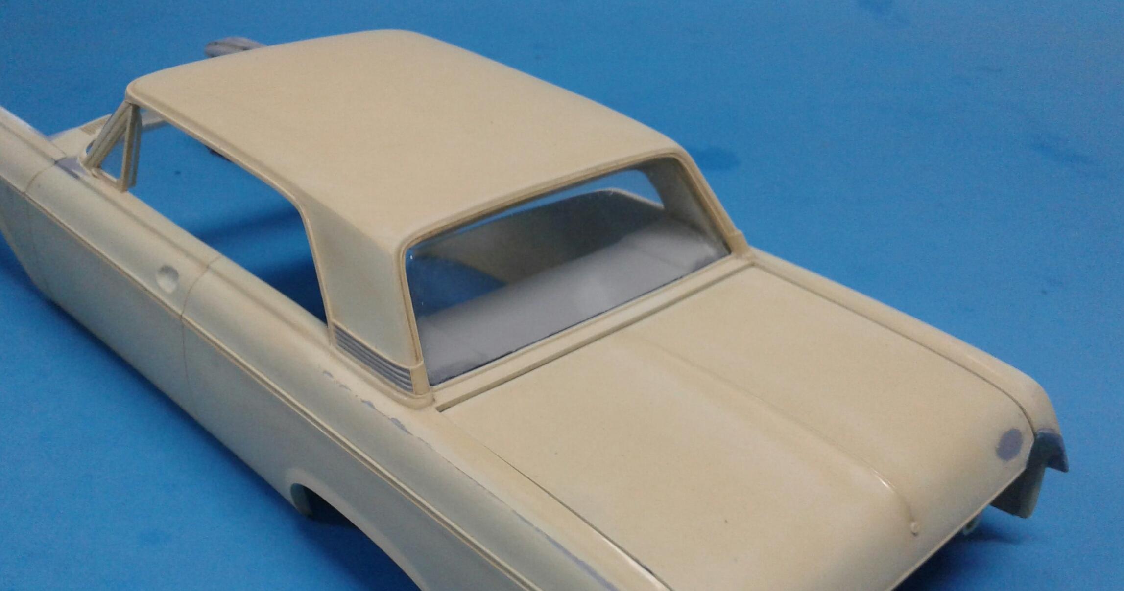

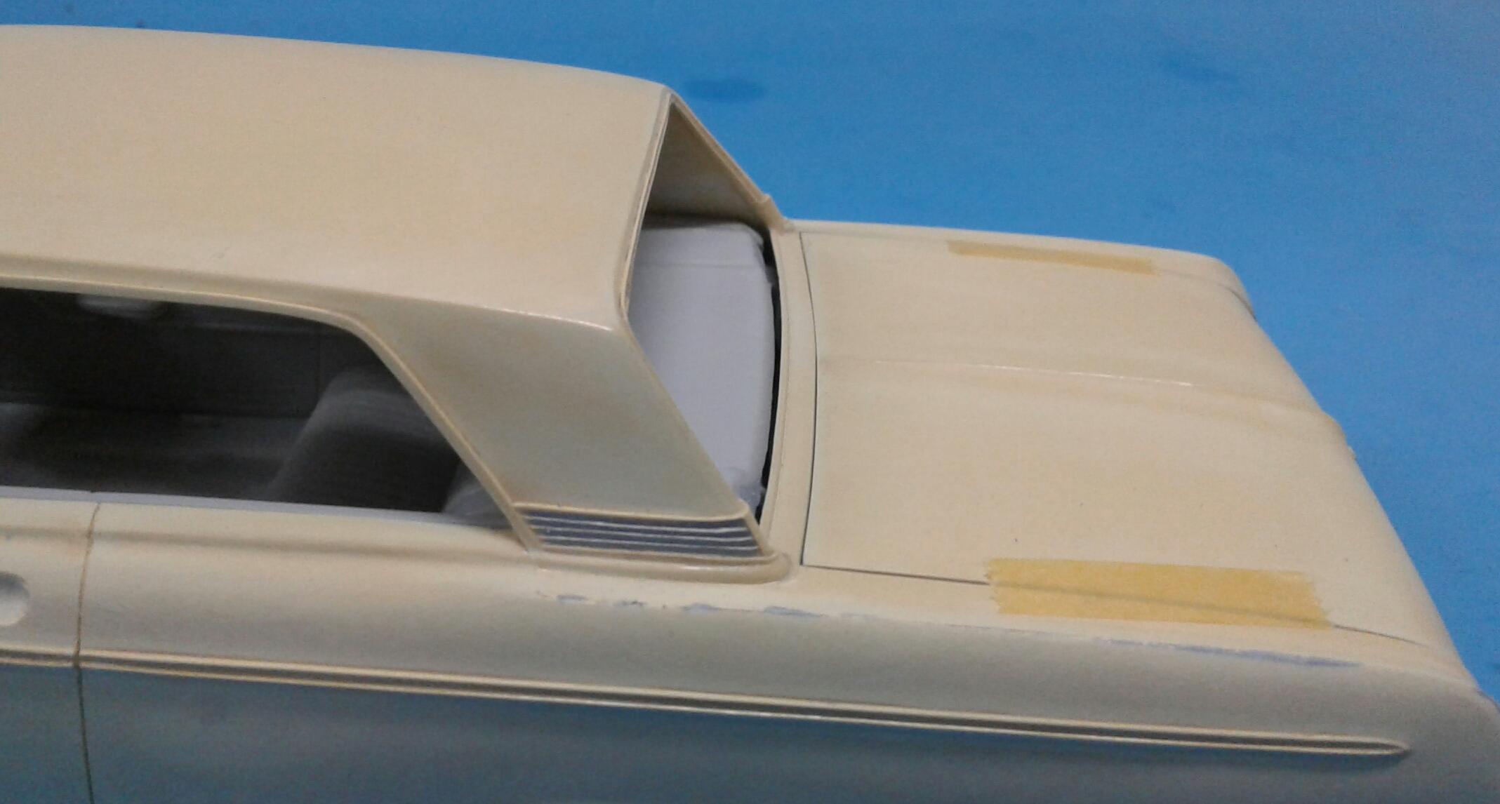

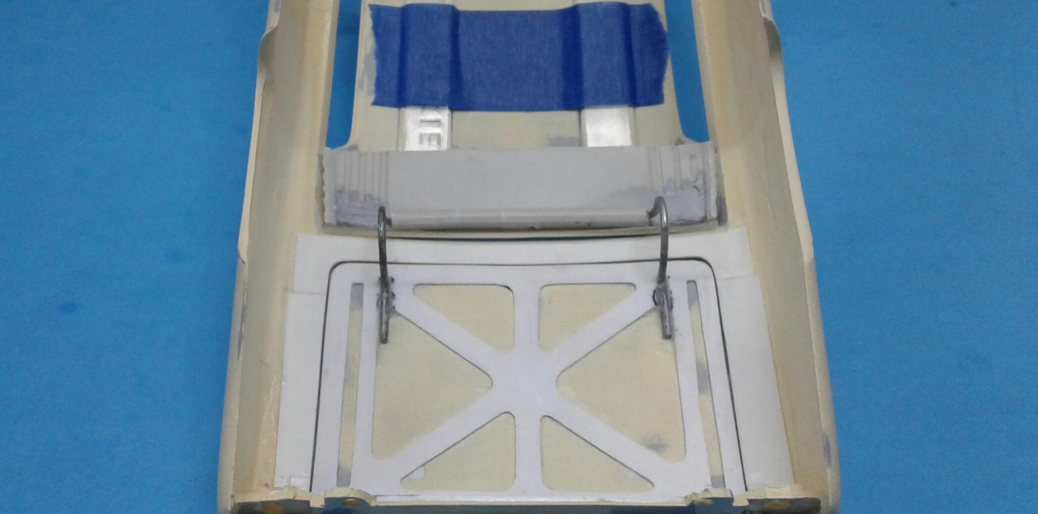

Thanx guys, I appreciate the feedback! Bench time has been almost non existent lately. But, I am able to get a little time in here and there. A little progress is better than no progress. As stated earlier, I was able to come up with a solution for my trunk hinge. The first thing I did was separate the package tray from the rear seat. With the glass installed, I then glued the package tray to the body. Now I have a solid mounting point for the hinge that allows it to swing properly. The glass simply slides back out. The rear of the seat meets up nicely and gives a true separation line. Another angle. About all that's left to do on the body is scribing in the lines around the remaining chrome trim and some minor touch ups. I haven't been able to pick a color for the body yet. I'm kinda thinking Pearl White. Also thinking Deep Blue Metallic and Light Gun Metal. I want something different than the typical color. But, so far, the vision for the color hasn't come to me. -
