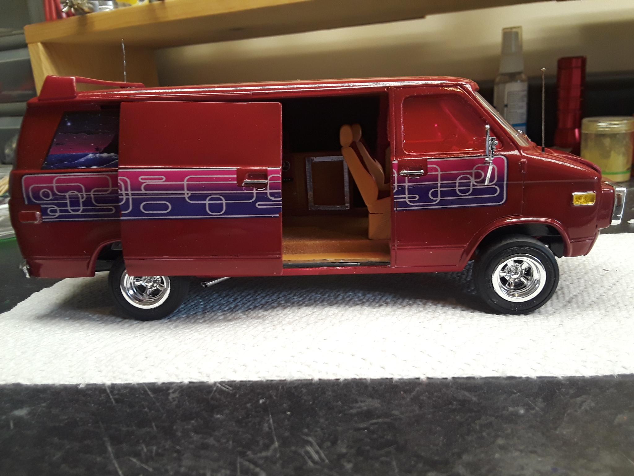

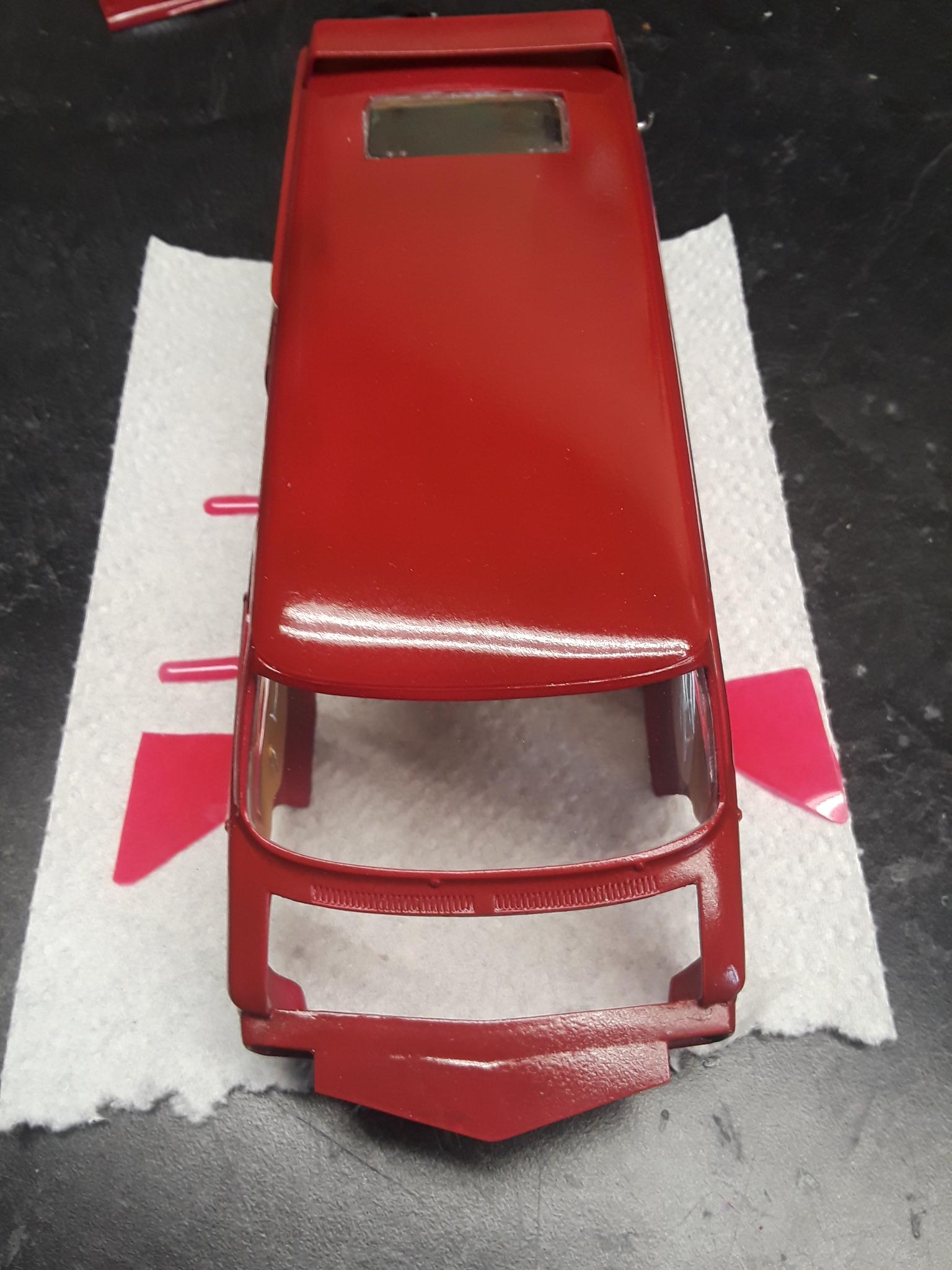

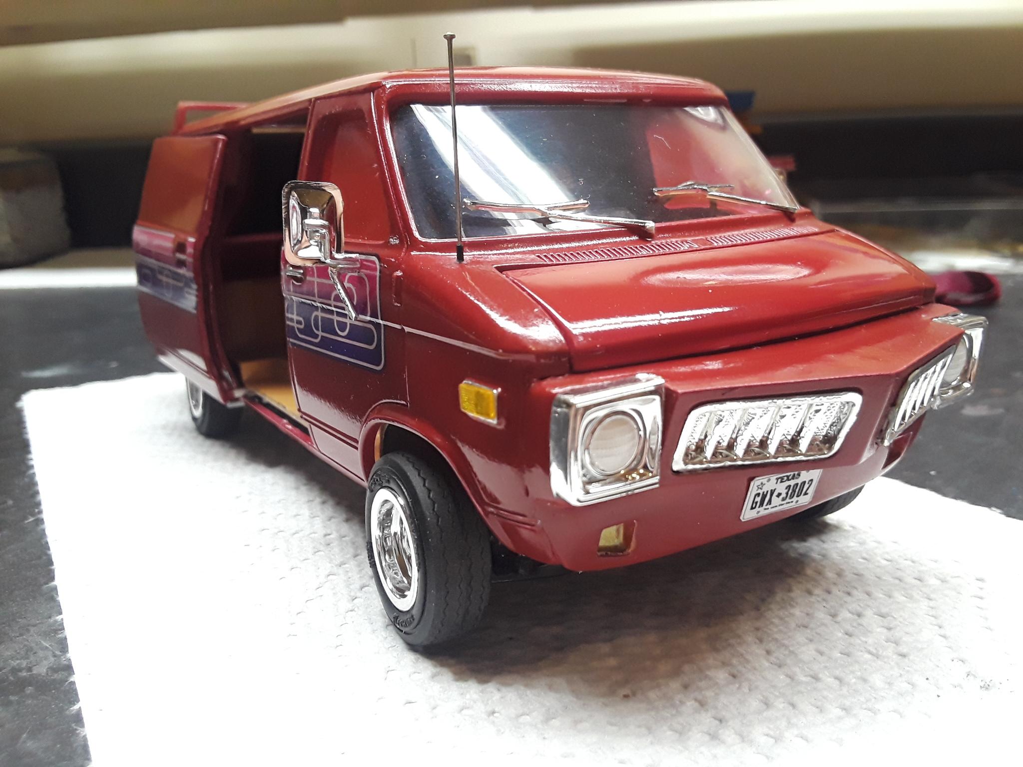

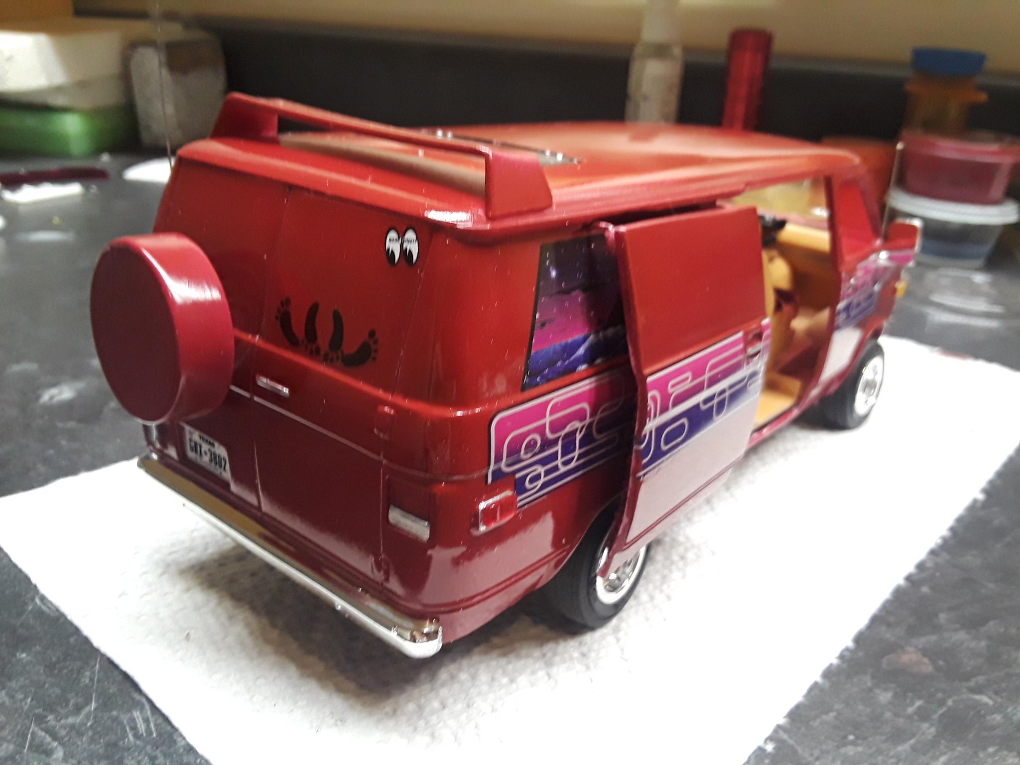

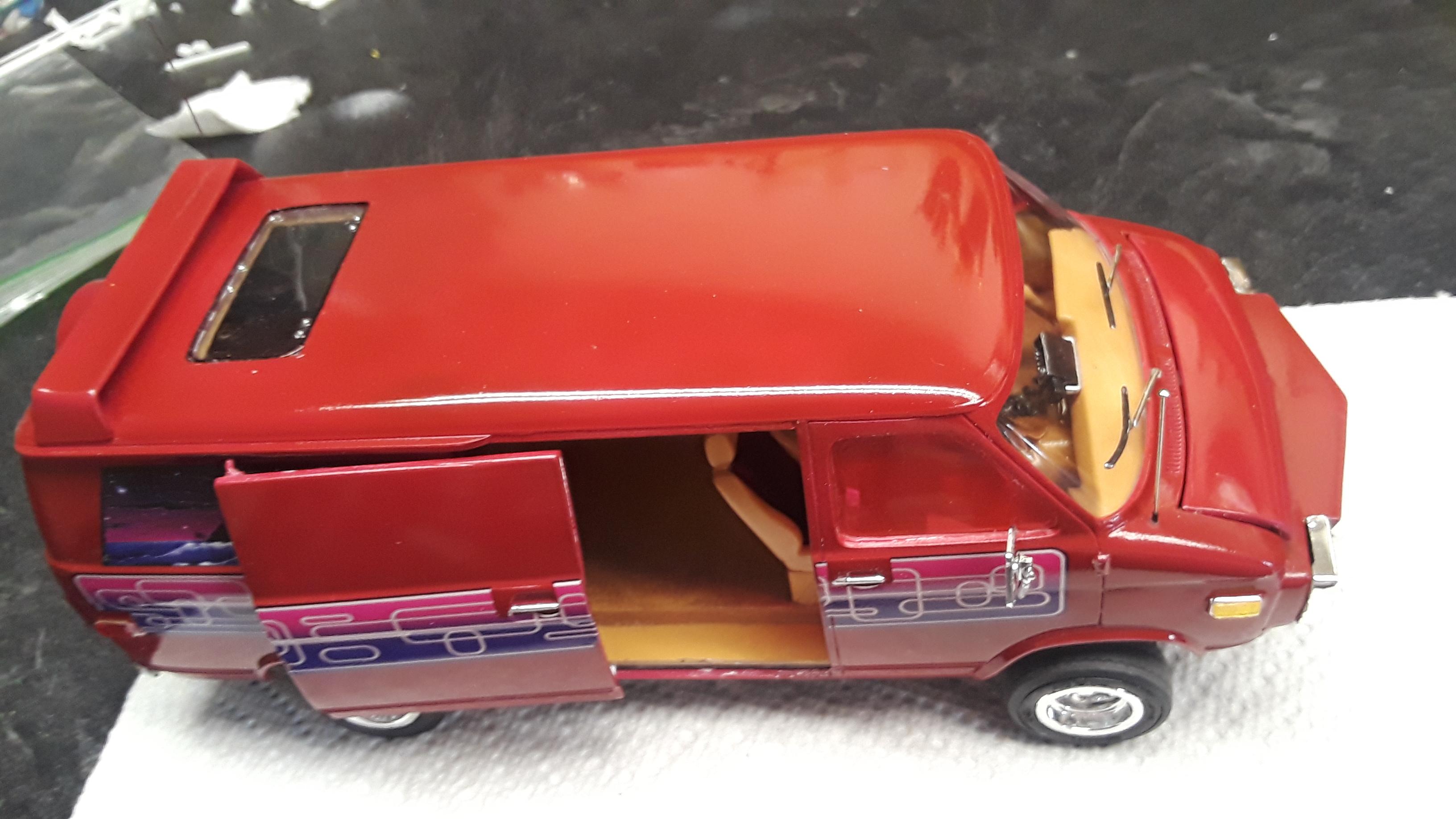

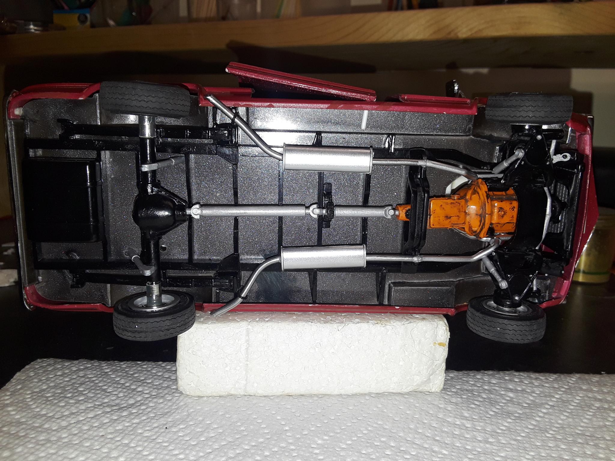

75 Chevy Street Van
Leica007 replied to Leica007's topic in Model Trucks: Pickups, Vans, SUVs, Light Commercial

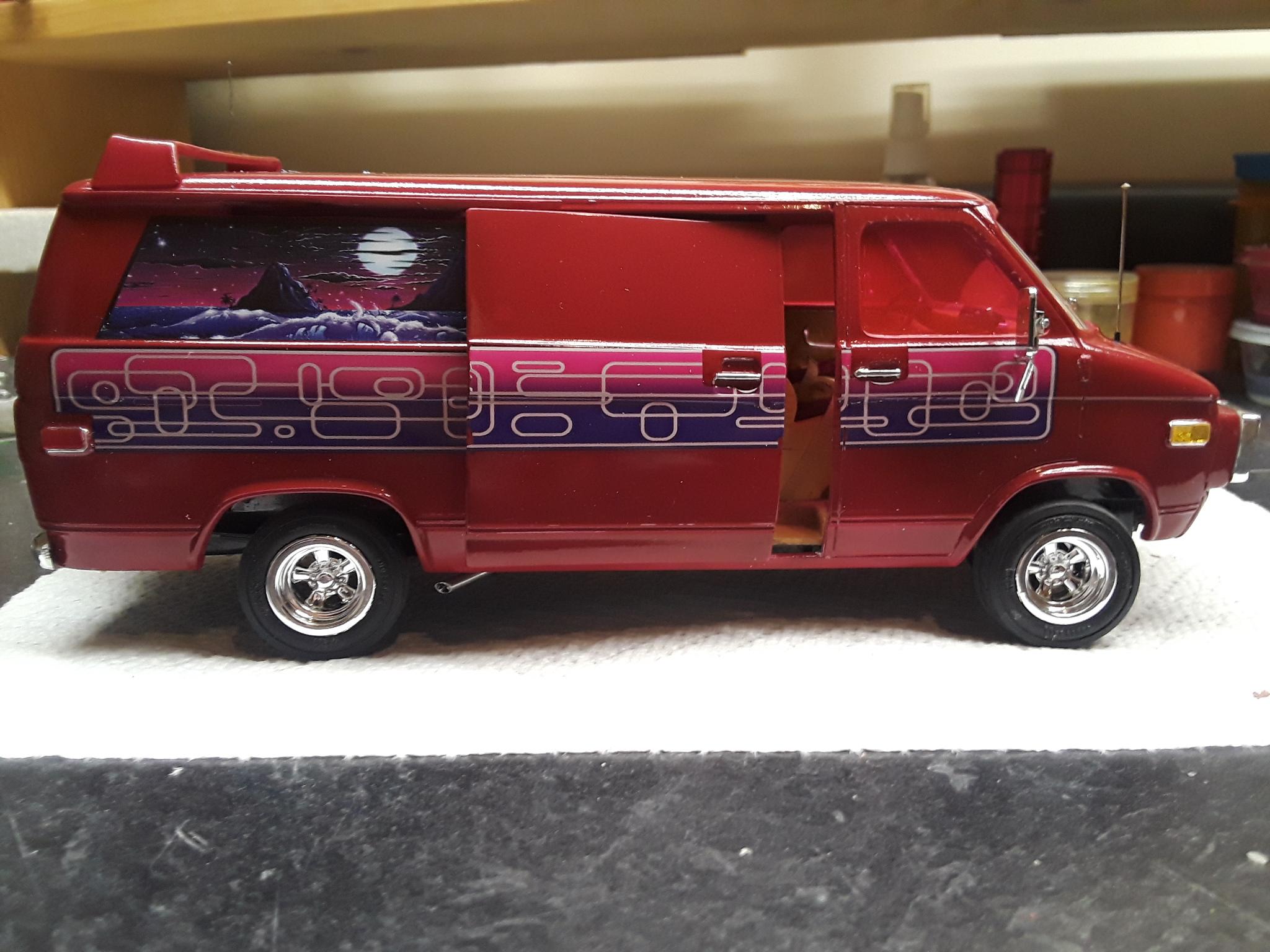

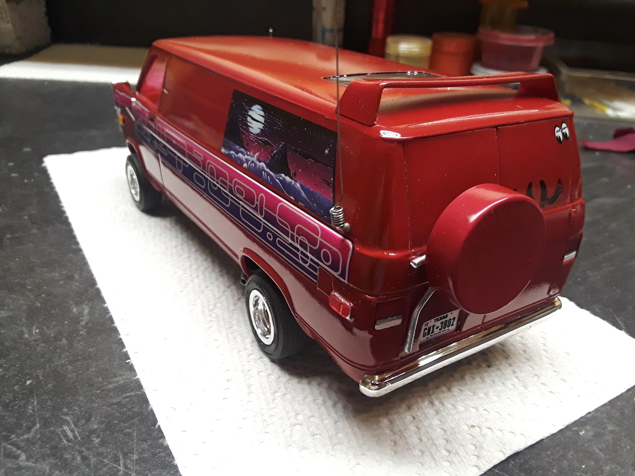

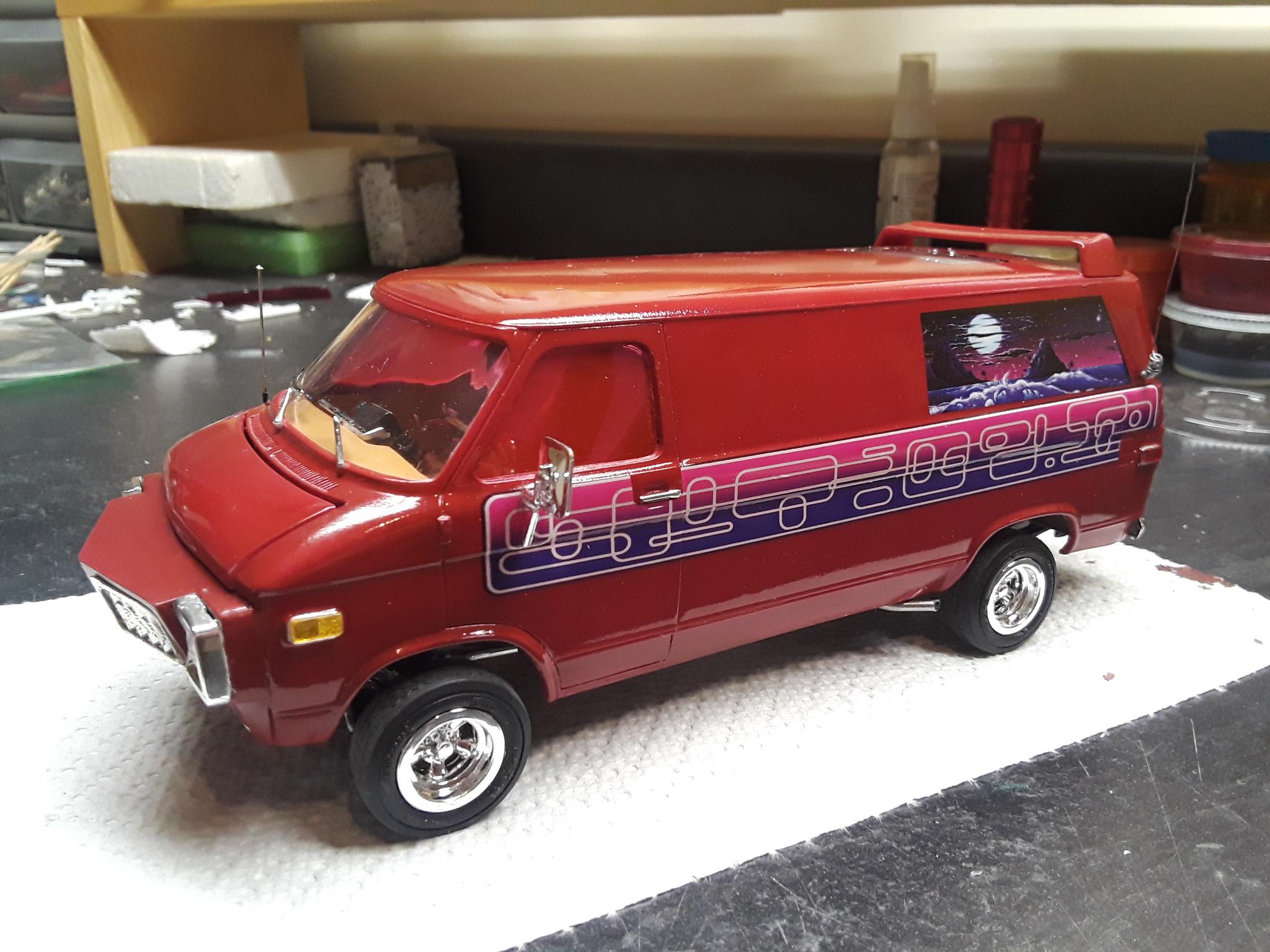

Thank you Carl, Chris, and Doyle, appreciate your taking the time to give feedback on my van. -

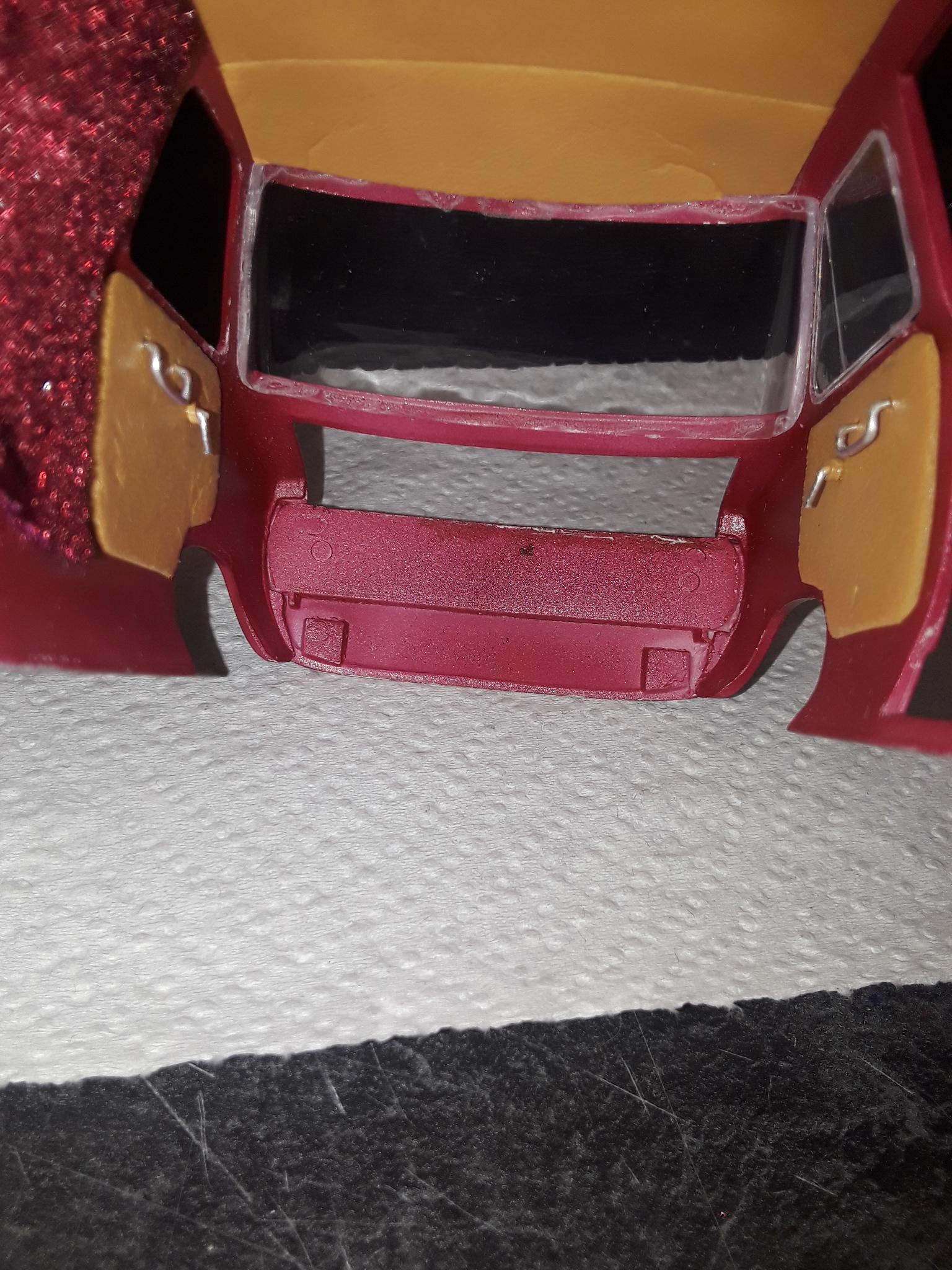

Installing clear parts without fogging: How!
Leica007 replied to conchan's topic in Model Building Questions and Answers
I used to try super glue, but the fogging stopped that quick. One thing I did learn was a q-tip lightly soaked in alcohol would clean most or all the fog off the glass without harming it, then I used another q=tip to apply Novus clean & shine. Looked pretty good. Now I use plati-weld to tack in place and then canopy glue. -

75 Chevy Street Van
thanks John, the WIP does show several shots of the interior. -
