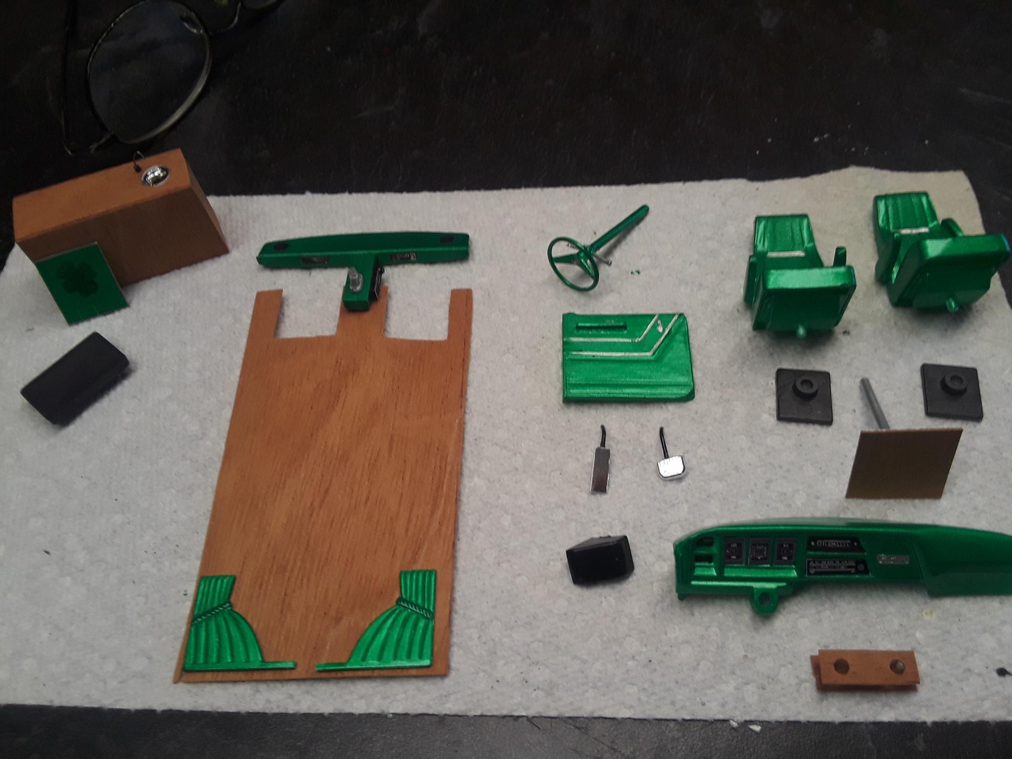

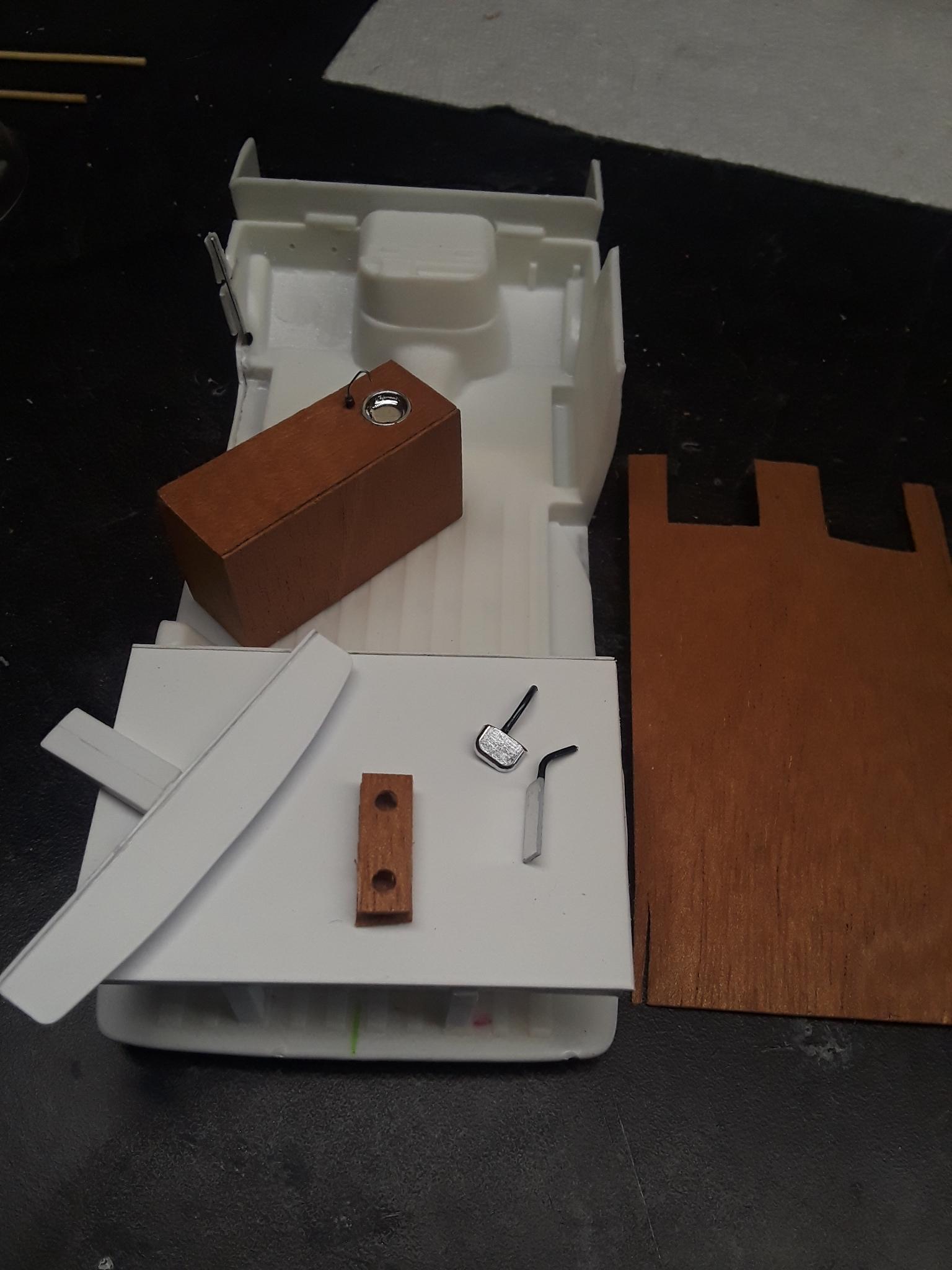

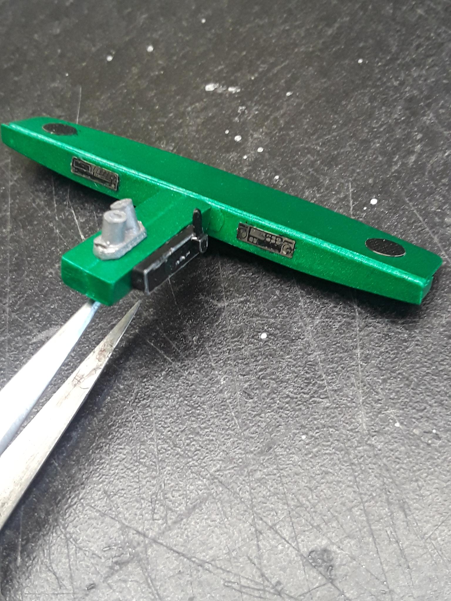

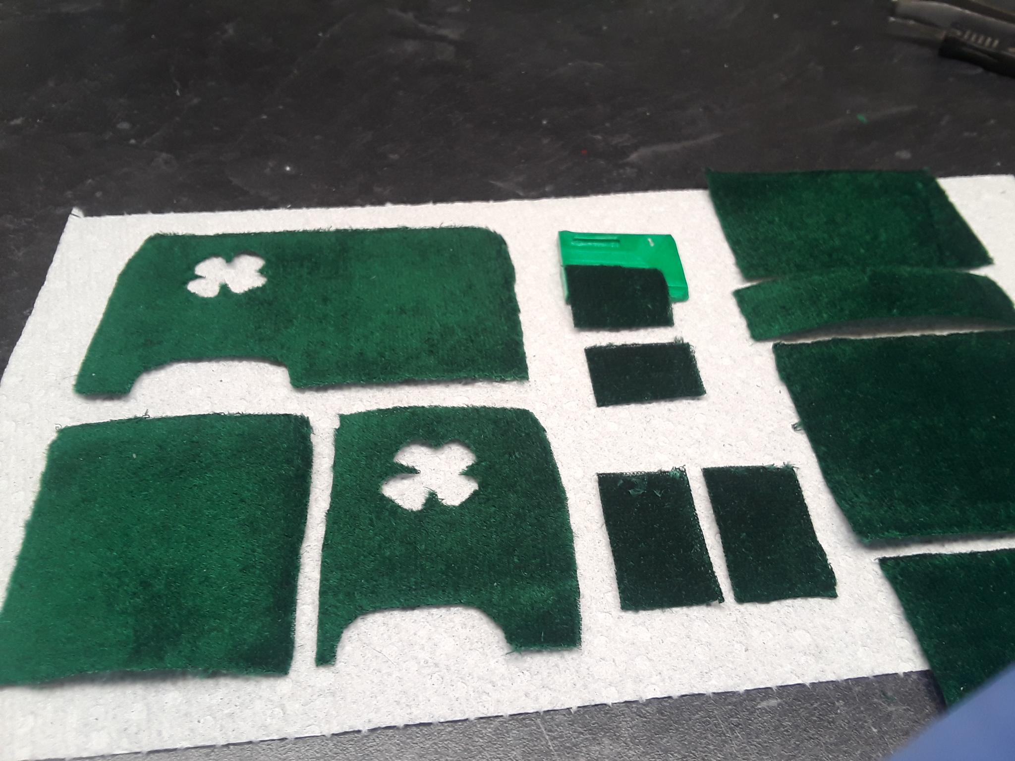

Here's pic's of interior work while waiting for paint to dry/cure. Most of the accessories are hand made based on what was in the 1:1. The sink is an old hubcap, the faucet is wire. The T shaped overhead console is sheet plastic with CB, cassette and cd players, equalizer & speakers (from Detail Masters) and homemade aircraft o/h lites. The rear window curtains from the Bad Company kit. Gas/brake pedals made to hang off the floor. I also follow others and added to the door arm rests. A hand made cup holder for the dog house and small table than can be put between the seats. I didn't do a lot of detailing the engine, since you can't see much of it. The other big project was cutting all the carpeting sections for the walls, floor, and doors. I made a template to use for the panel patterns. About ready to clear coat tomorrow, then wait for curing so I can apply the graphics. Did get the Testors smoke window tint done today, pretty good I think. Will post more as the inside comes together. Thanks for looking. -

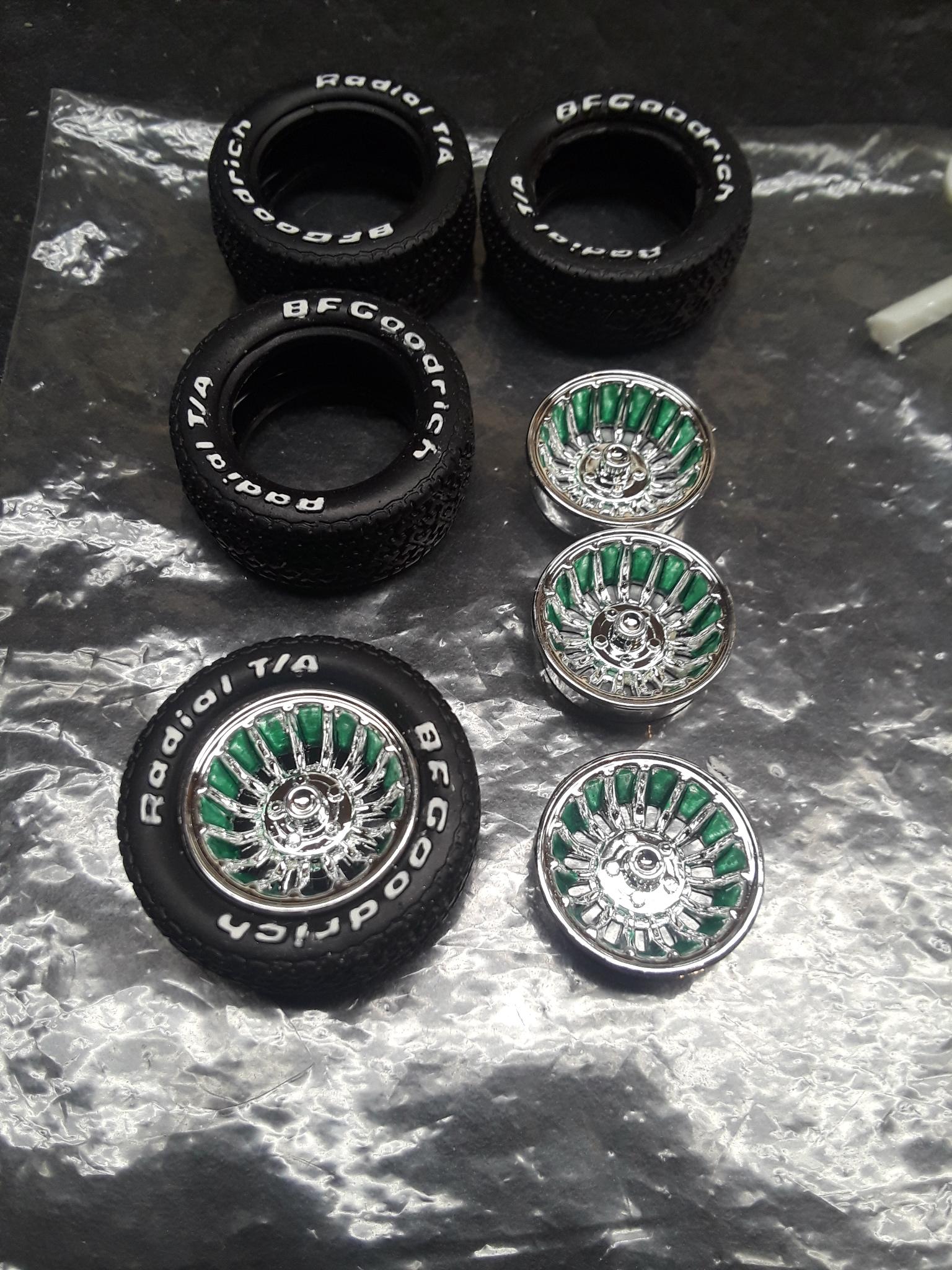

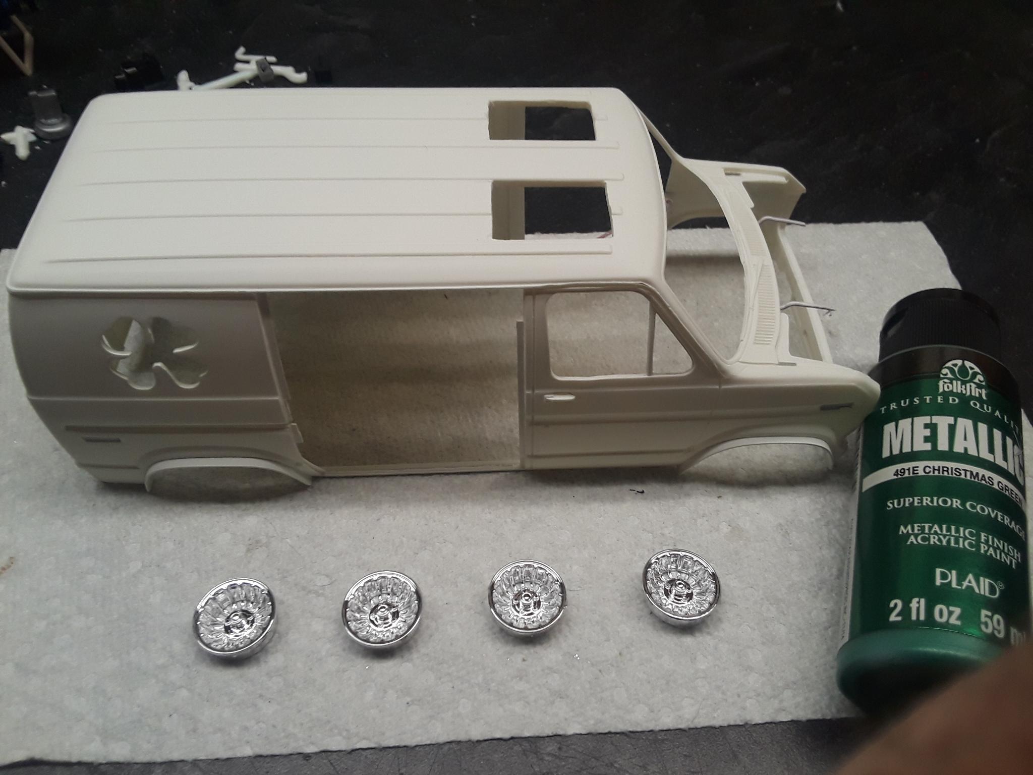

Got the body primed with Rustolem 2x primer and painted with FolkArt metallic Christmas Green. Changed my airbrush tip/needle to .08 and worked a lot easier. While waiting for drying and curing, worked on tires and wheels, engine, interior parts. Used gel pen to do the tires and brush painted the green on the wheels. M -

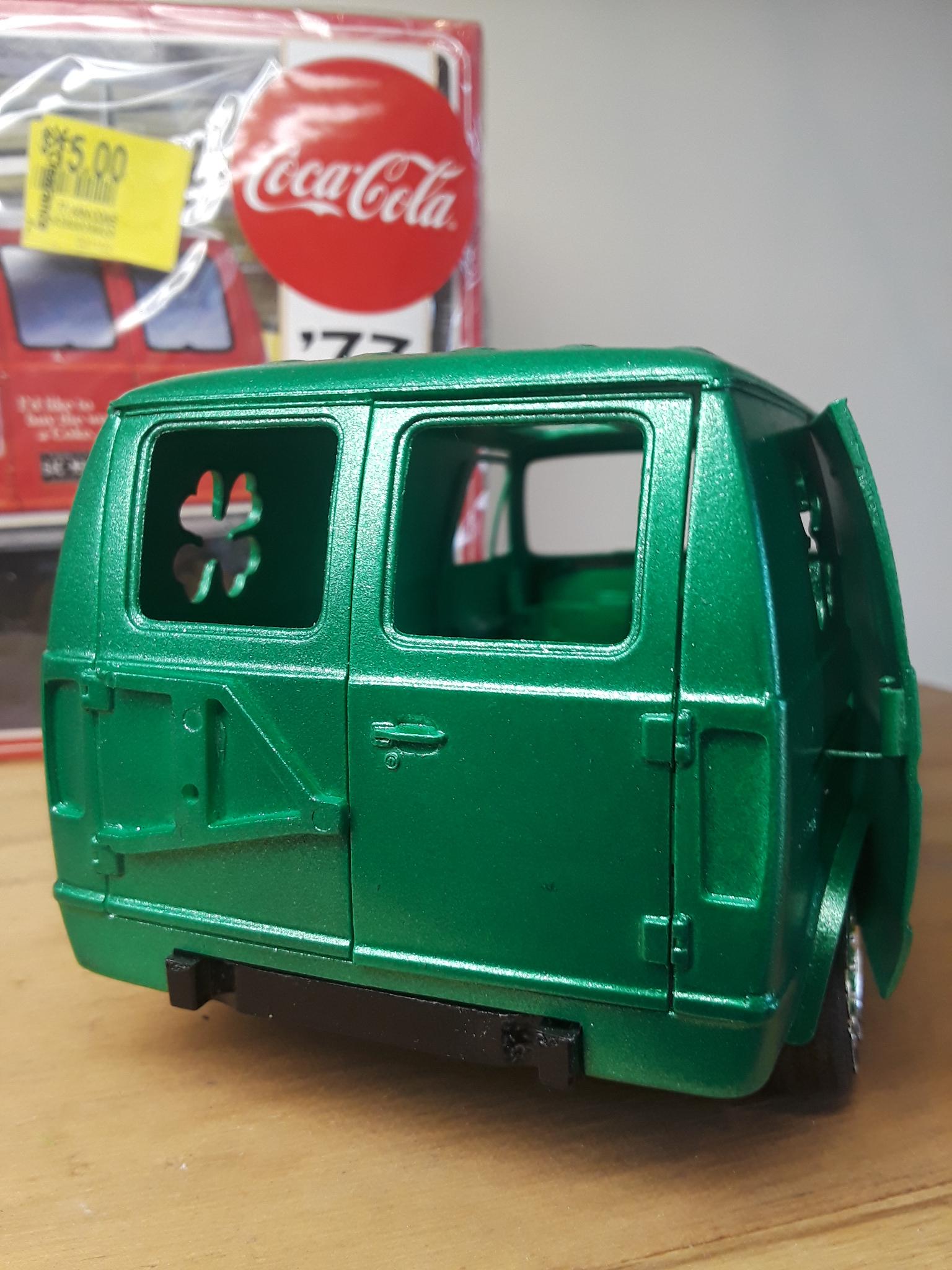

Glad you like it, always enjoy meeting another vanner. I have an older variable speed Dremel with an engraving tip that I have learned to use for a lot of my work. Took me a while to get up the nerve, but now it's my go to tool. Thanks for looking and hope you enjoy. -

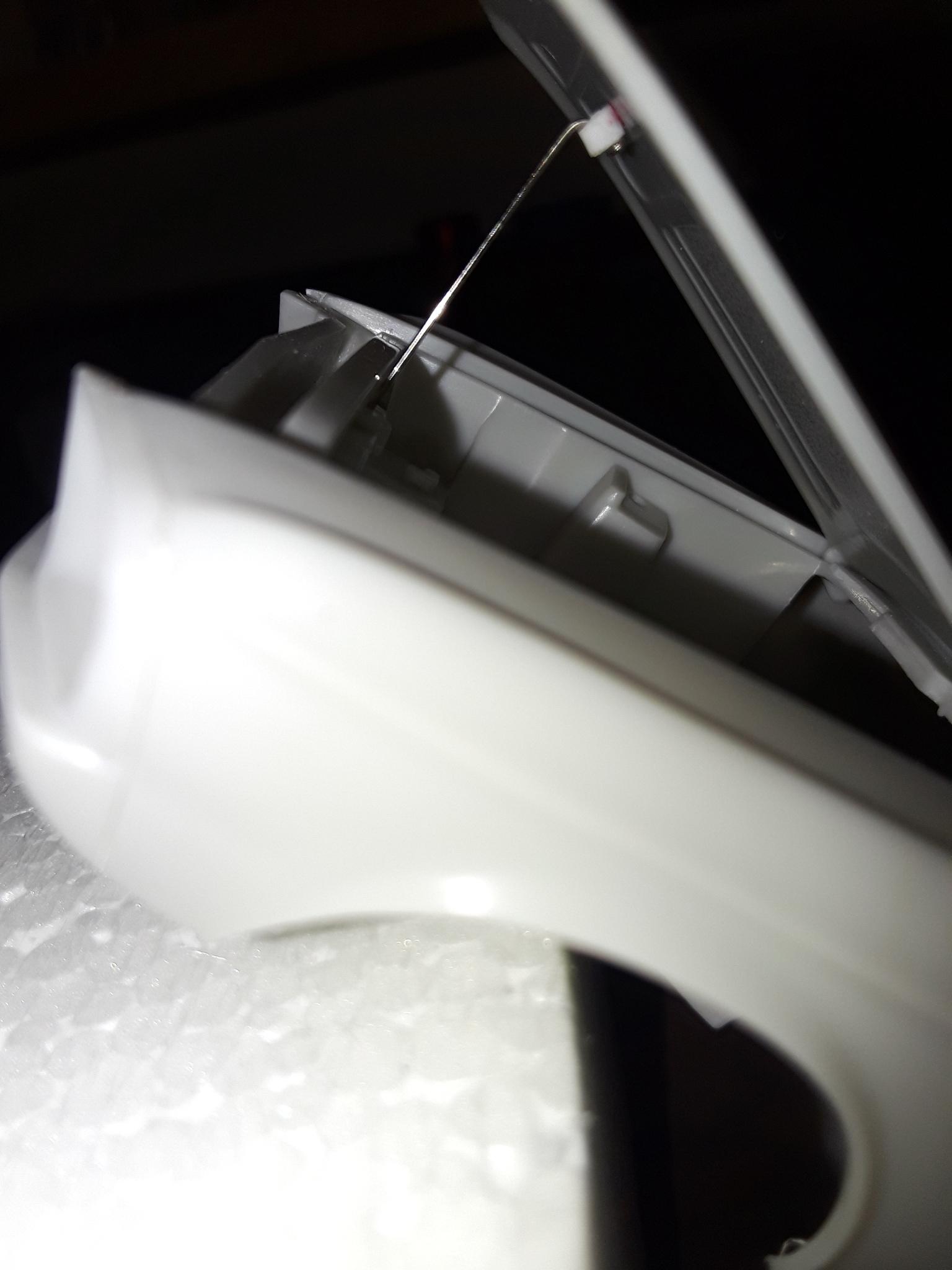

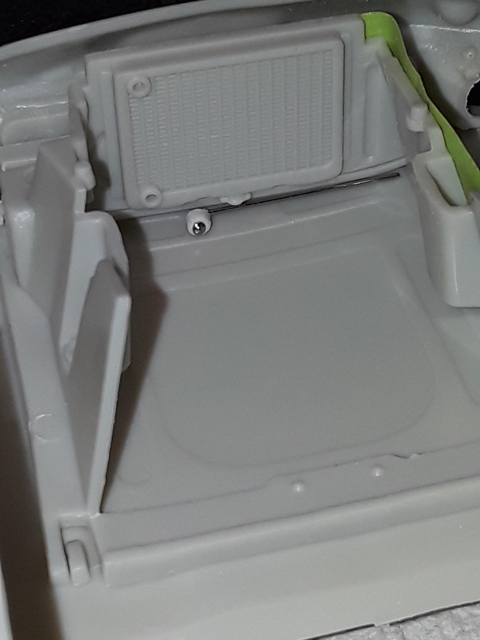

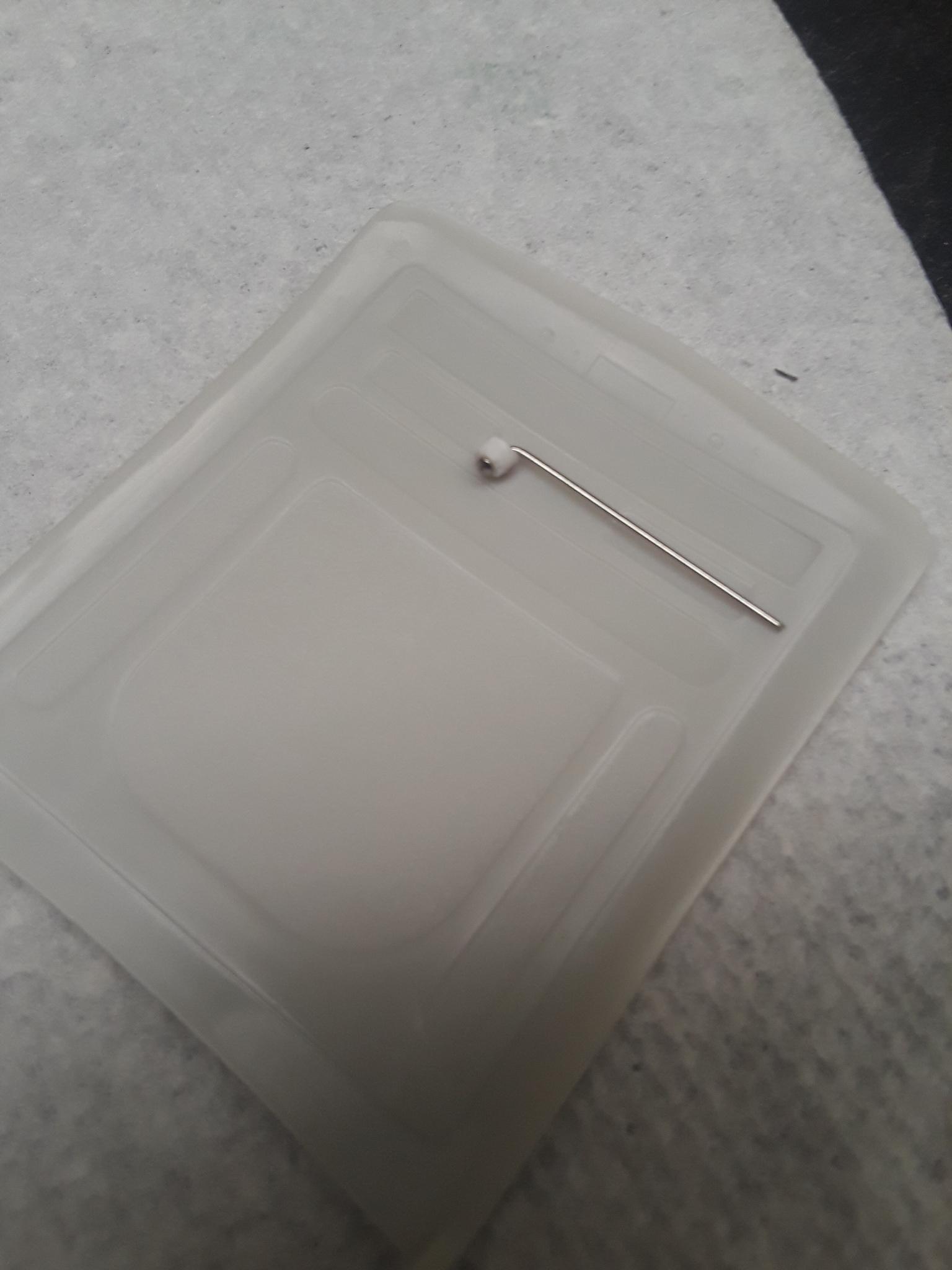

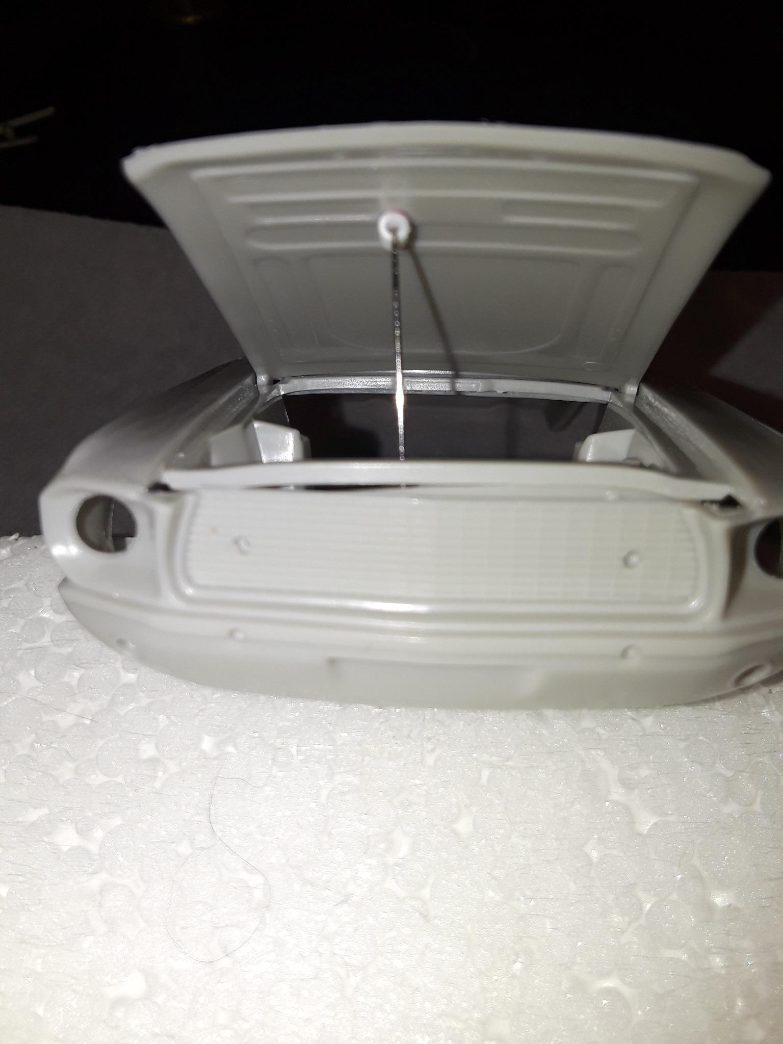

Did this on a 67 Mustang without hinges, but it should work if you have hinged your hood but it won't stay open. Used 1/32 tube from Evergreen and a sewing straight pin with the point cut off. I positioned the tube close to center and made sure the pin cleared everything. The nice thing is when you raise the hood, the pin drops into place on the radiator support. Hope someone can use this.

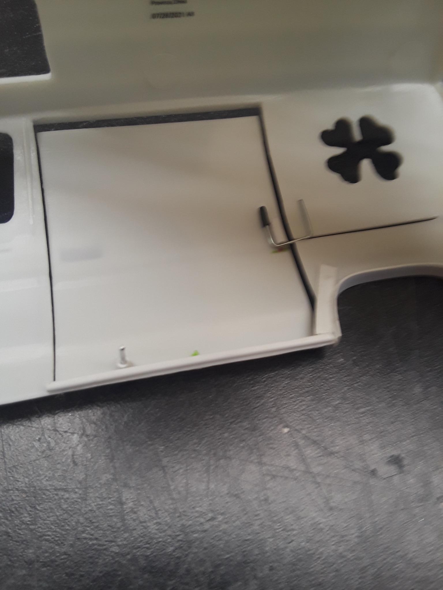

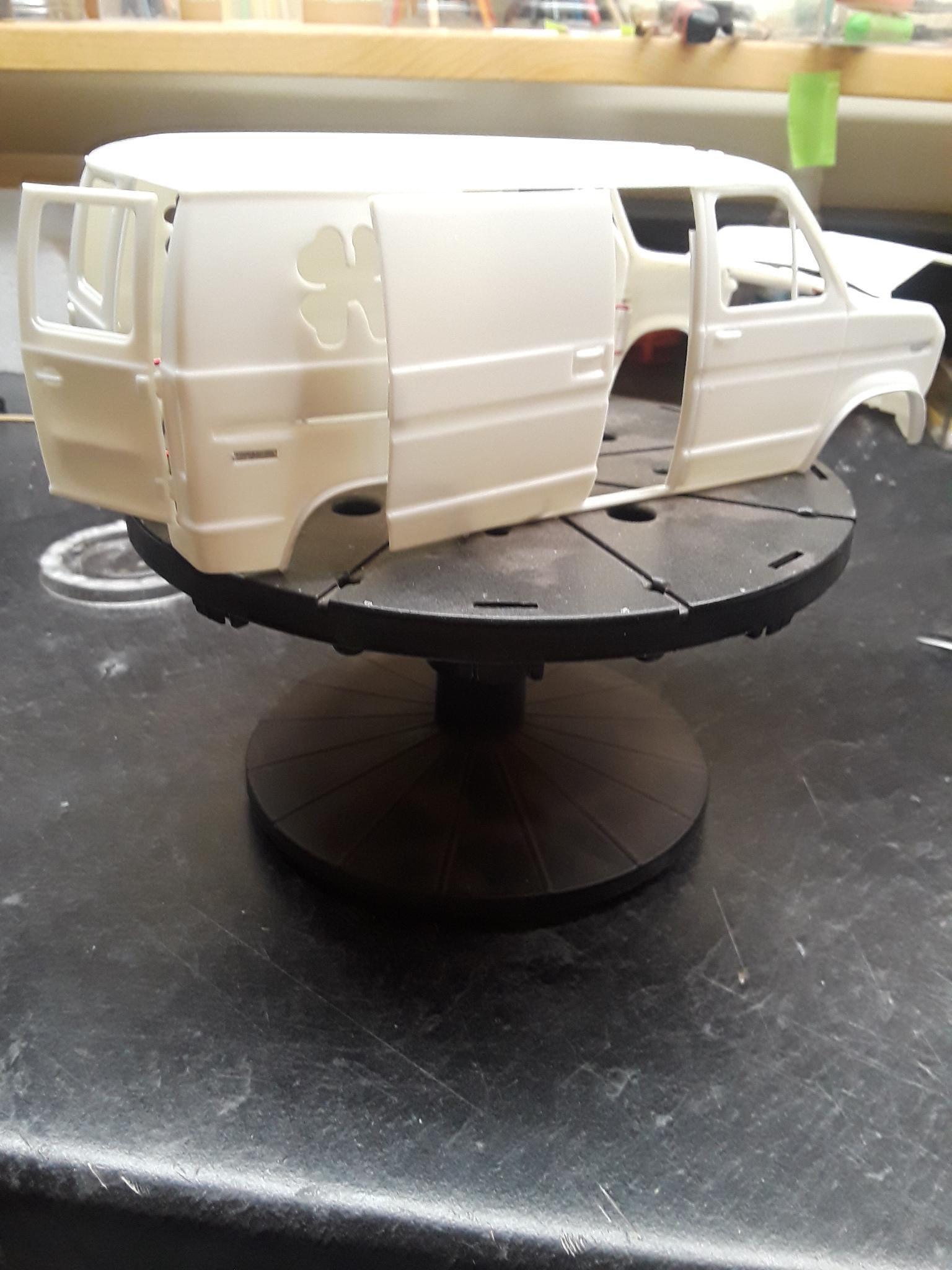

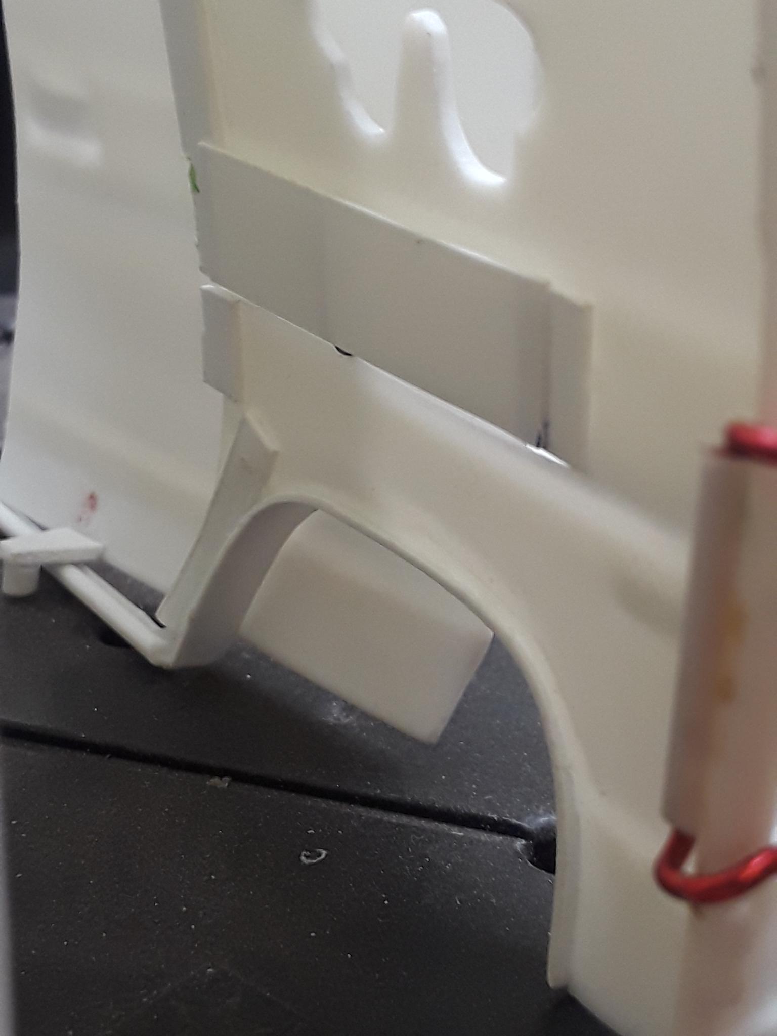

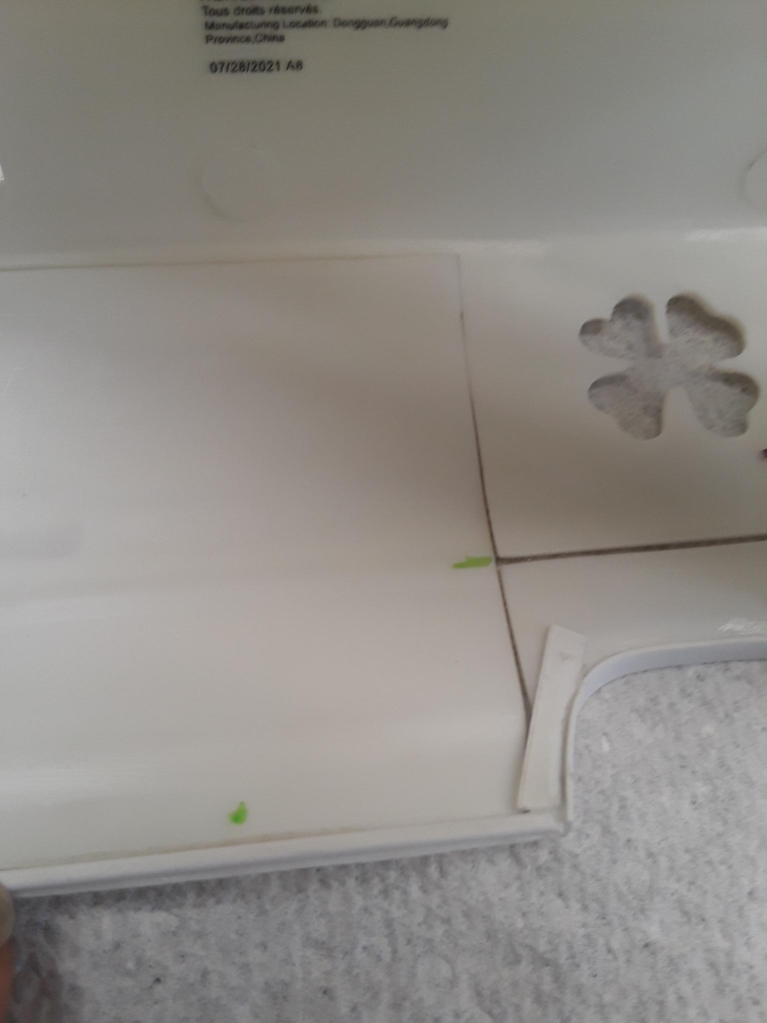

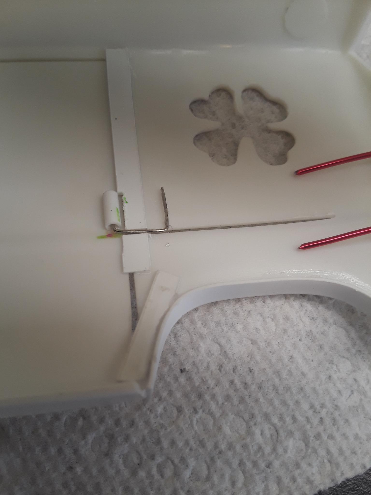

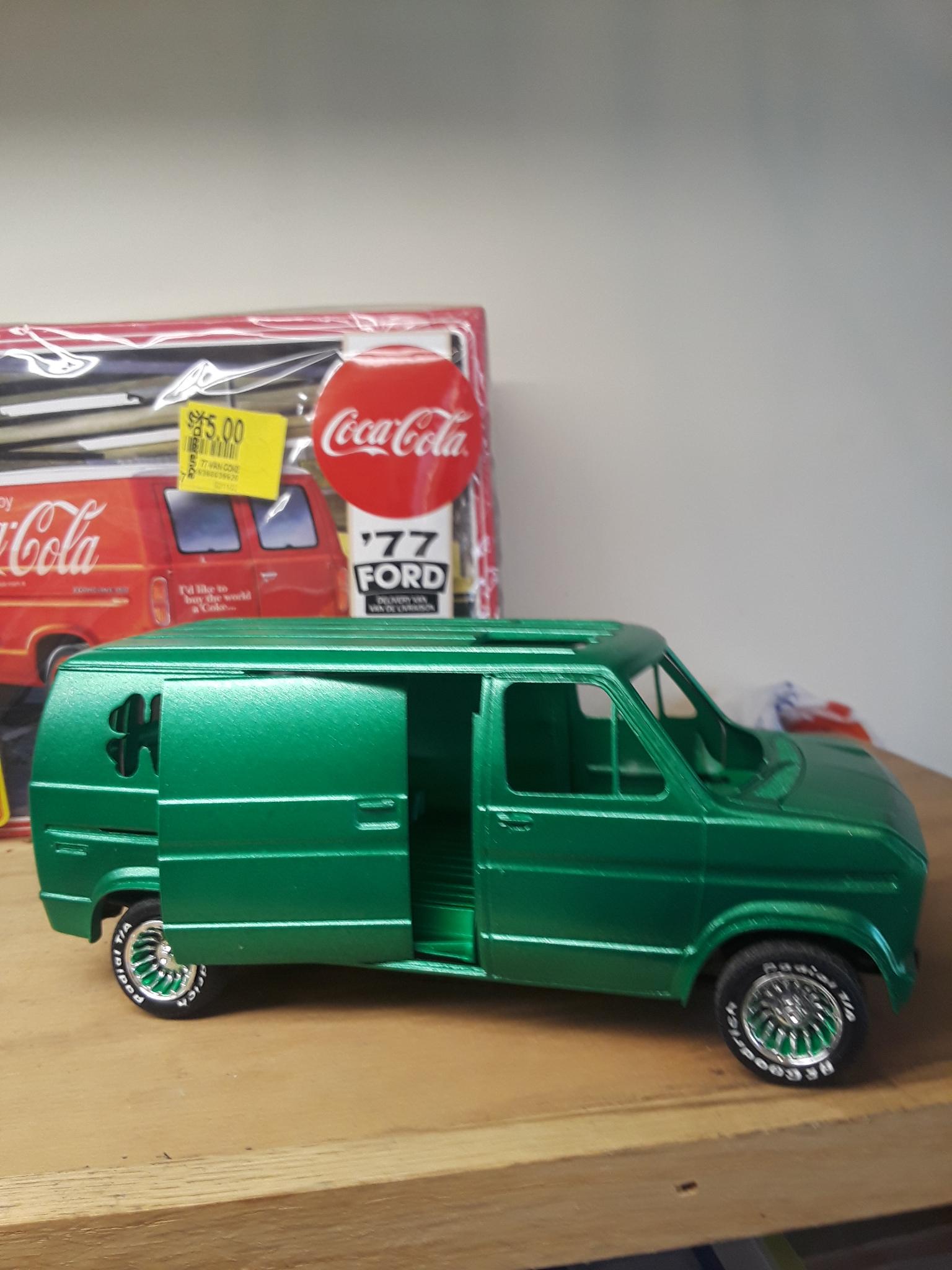

TC, appreciate the closeup pictures. Here's photos of the sliding setup I came up with, I started with 18 ga craft wire, but tried and changed to a sewing straight pin (the head fit perfectly for 1/32 tubing). I folded into U shape with 5mm legs which allows the open door to clear the flares. I did change the lower guide, I'll include pictures in a later post. Hope this explains how it works, the door will slide. -

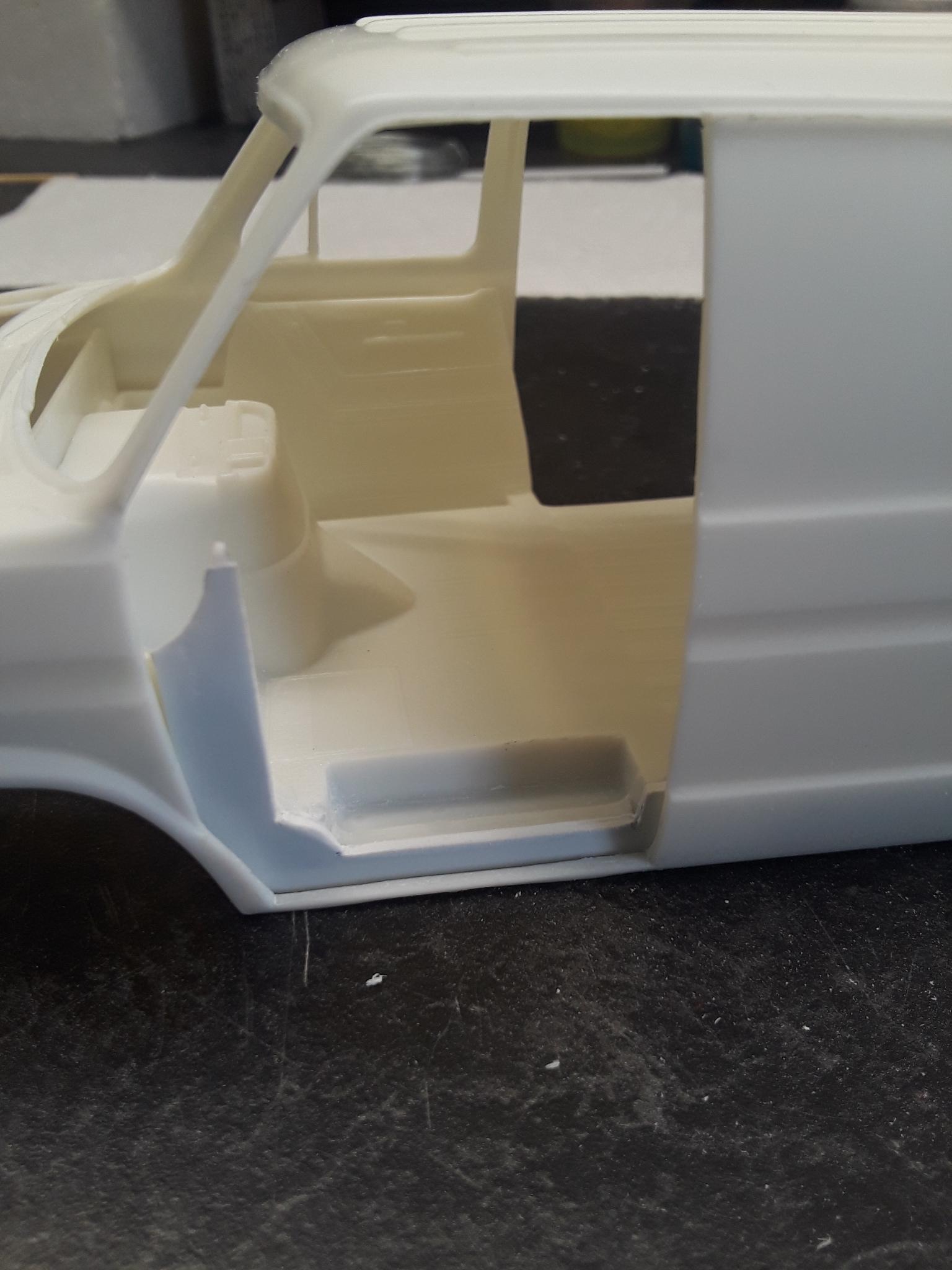

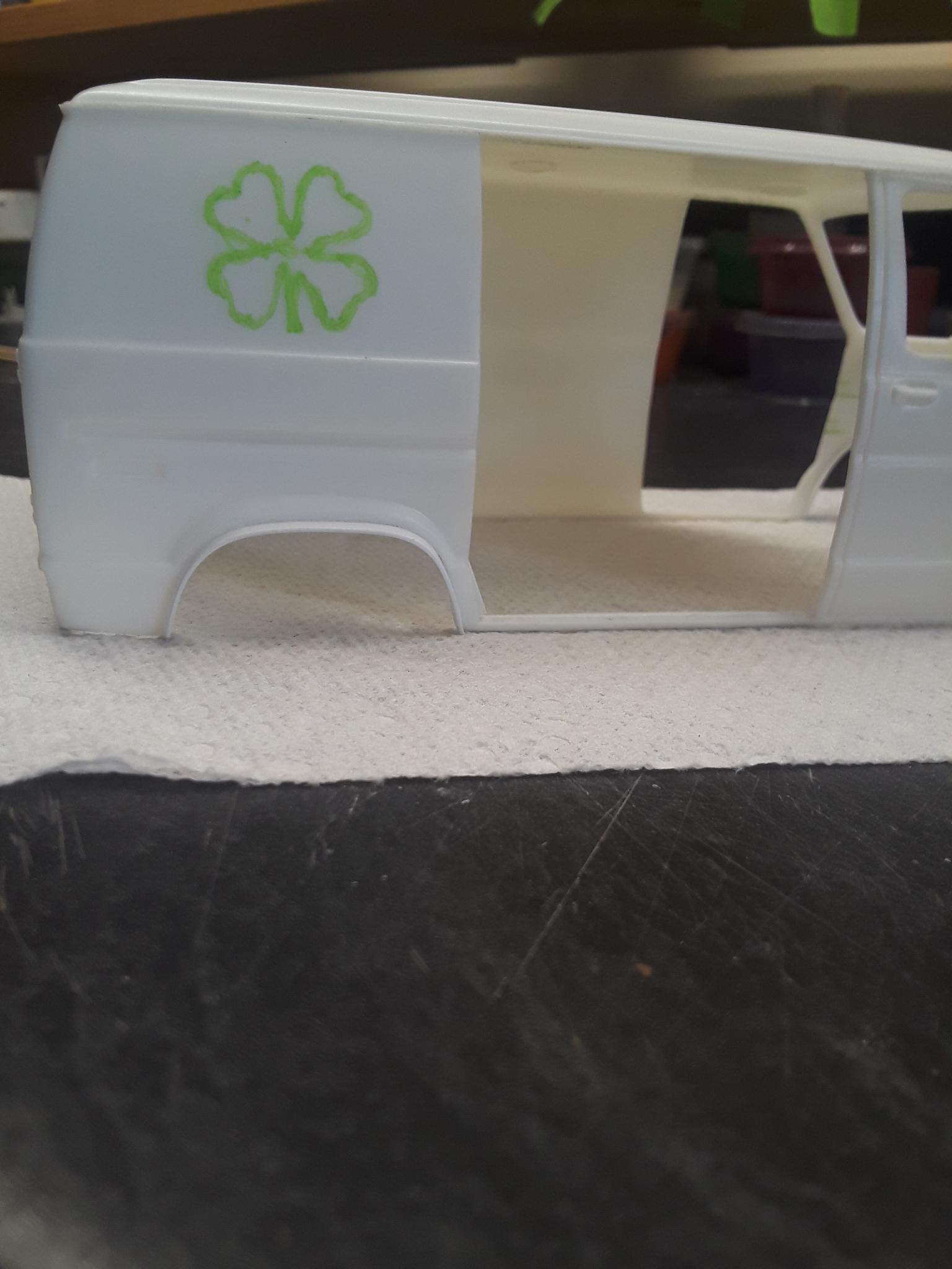

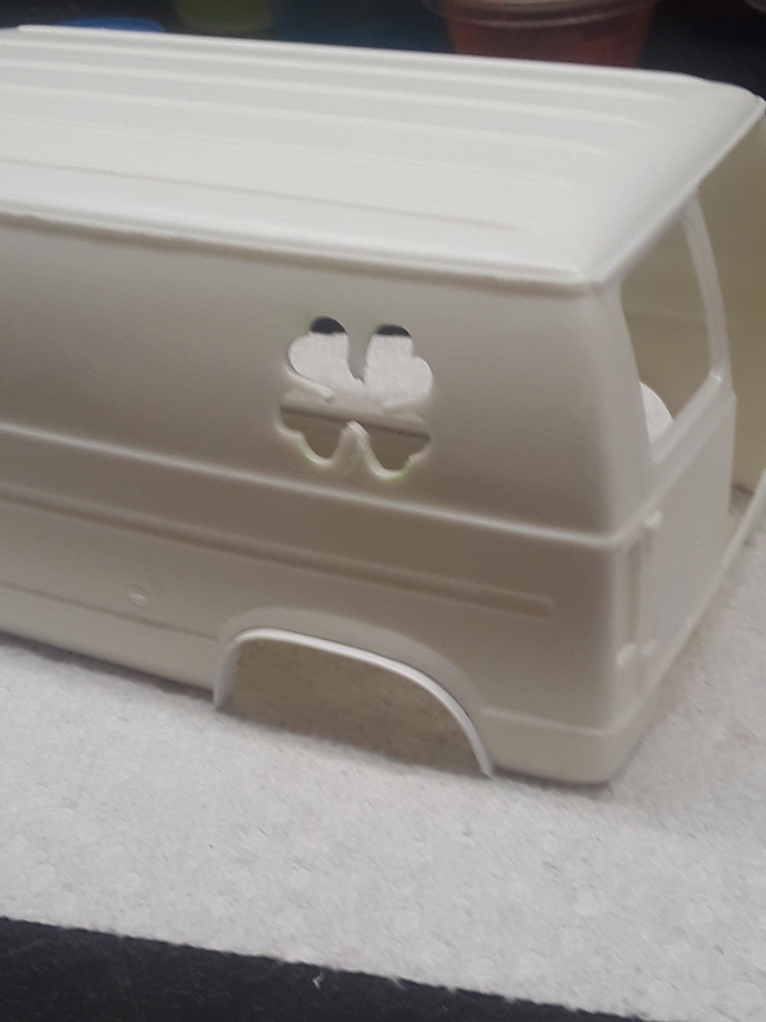

Seeing several vans lately in the forum gave me the incentive to tackle a Coke van I got on clearance at WM; making a newer version of my 1:1 Ford built back in the mid 70's. I've got 2 of the 1/20 MPC kits to try to recreate a model of the original, just not quite ready to tackle that yet. I want to pay tribute to the original by staying close, but some things are going to be different. It's going to be fun and bring back fond memories of a great time in my life; building my own creation, Truck-ins (partying), Desert Kara Vans & Sun City Vans clubs (El Paso, Tx), competing in shows in the States and Europe, and a really great wife. I guess I'm still a vanner at heart. I,m going to use Testors laquer for the interior, and craft acrylics for the body, both in metallic greens, with green carpet on the inside. I'll try to explain and give good info, and will be glad to answer questions. First item was to lower the stance. I took advice from Fat Brian, cut the coils and drilled the upper arms to lower 2mm. Then modified the I-beam axle mounts to fit and keep wheels level. I also switched to BFG T/A to get lower profile. Next came the fun part, body work. Started by cutting shamrock side windows in the rear sides, then cut two sunroof window openings in the front of roof (the windows will be gull wing, like the 1:1). I added small flares to the wheel wells, and cut the driver side door, one back door, and the sliding side door. Also removed badging and filled in the rear license mount. Here's the beginning photos. Hope you enjoy the build and comments/suggestion are welcome. Next post will cover hinging the doors and hood and some of the interior items I've made. Thanks for looking, comments welcome.
