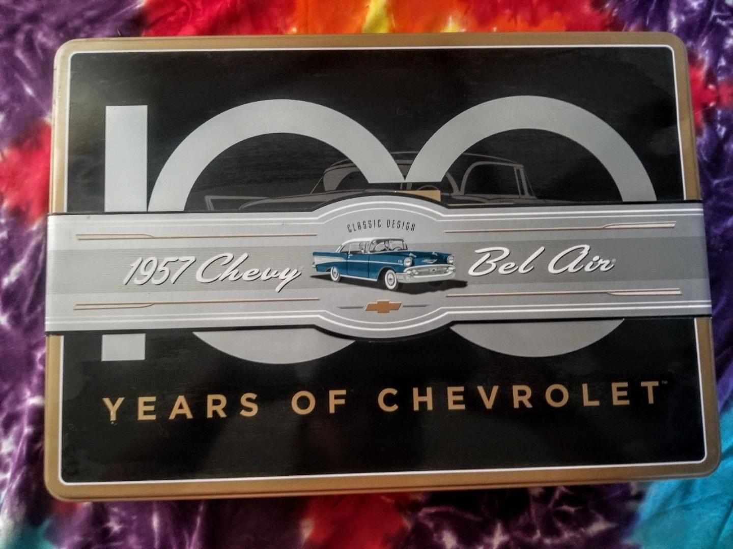

amt's tin box version of the 57 chevy
Casey replied to MachinistMark's topic in Car Kit News & Reviews
It is a reissue of AMT's "Pro Shop" '57. No idea if the wiring and p/e parts were included with the Pro Shop release or not, though. -
