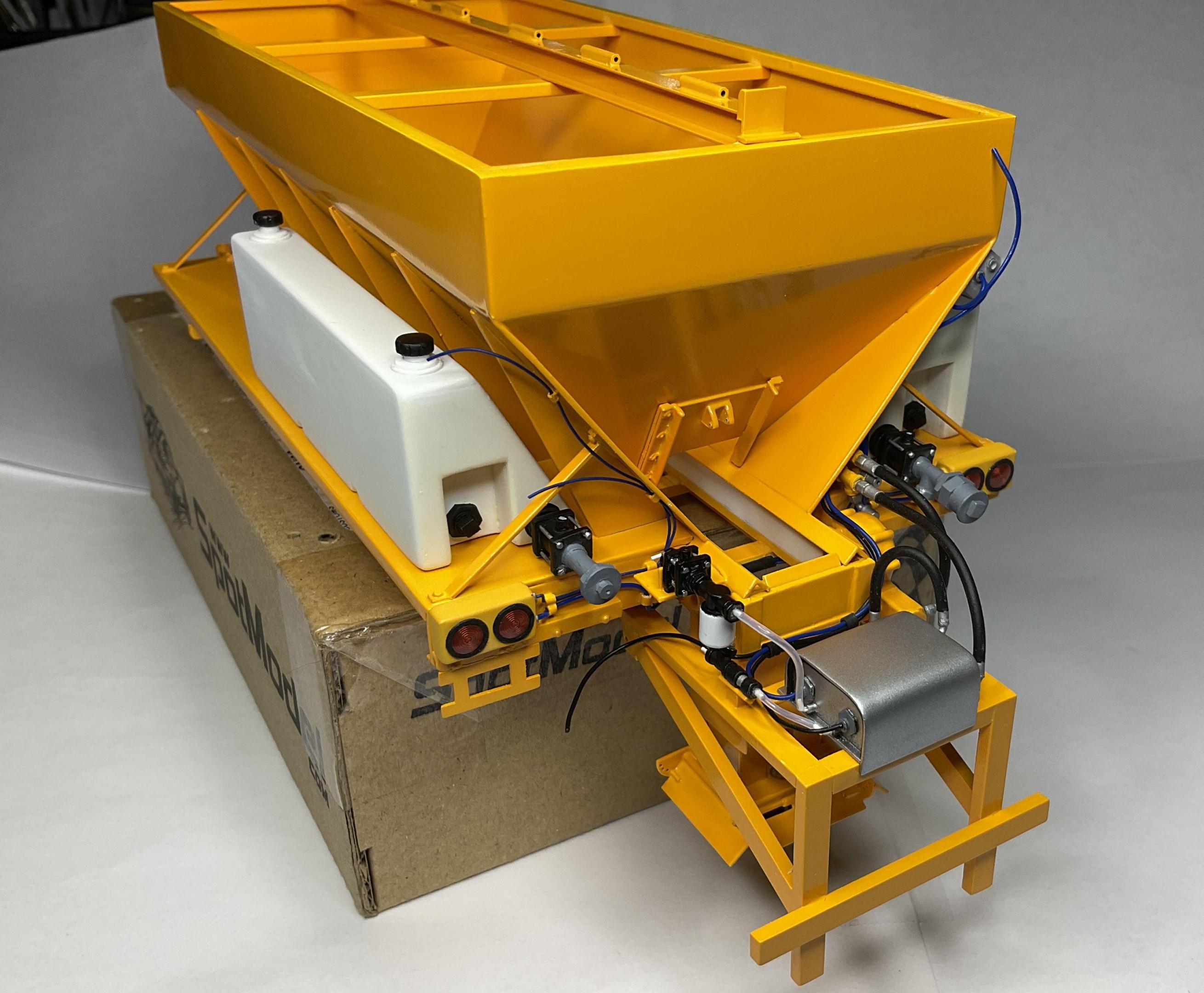

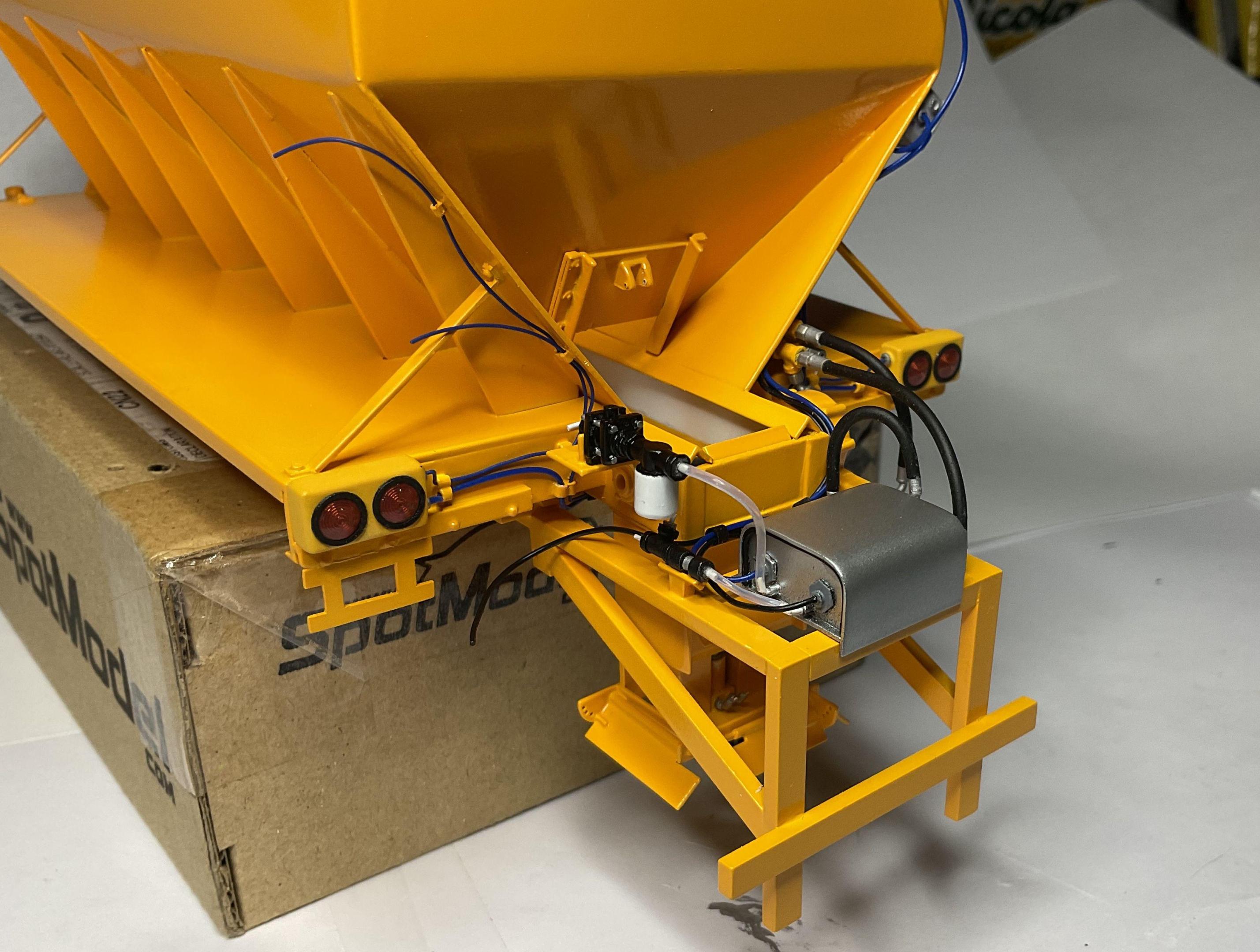

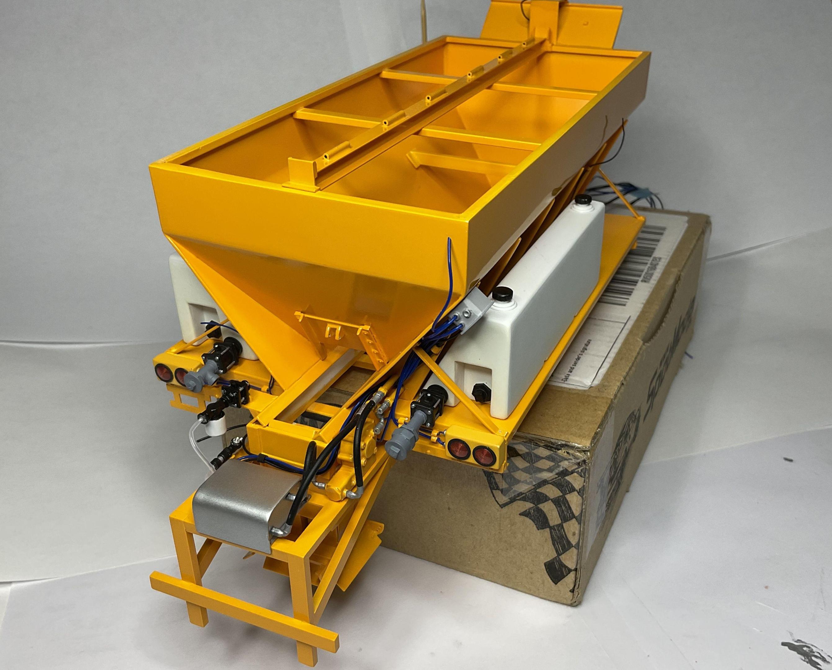

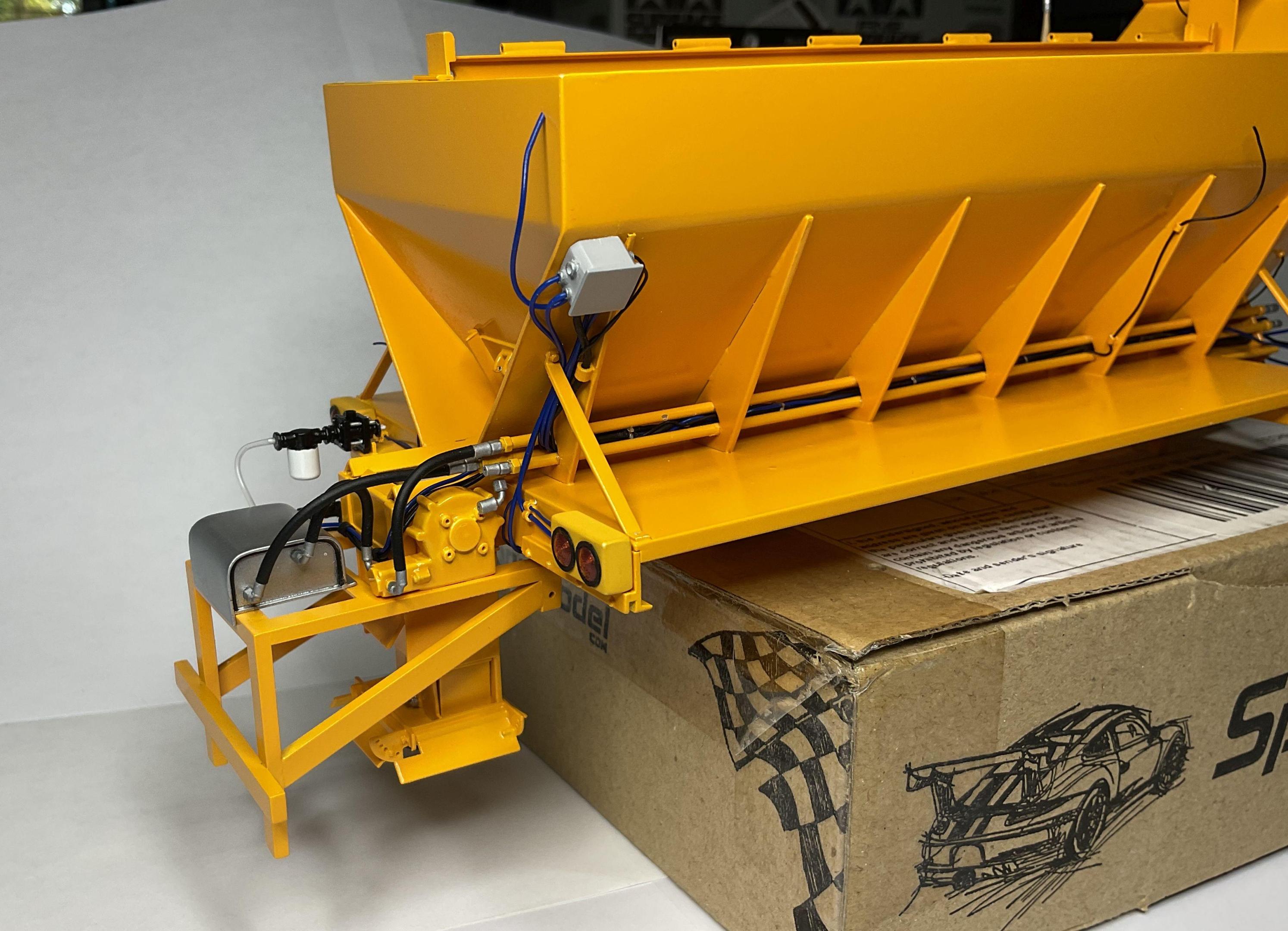

Been saying for a few posts that I would be getting to the hydraulic hoses at the back end of the sander. Managed to do most of them this afternoon - only have the two lines (pressure and return) to the sander spinner to connect. Need to still do a bit of fabrication at the back end, wire in the speed sensor, add some decals (when they're ready), more lights and finally the sand conveyor. Anyway (you guessed it!), more sander pics . . . Line run to sand conveyor hydraulic motor and in turn, through the aluminum housing for the pre-wet pump motor, and back out again to the return hard line. Still need to hook up hydraulic motor for sand chute spinner Control wiring run to pre-wet unit; clear lines run from filter to inlet of pre-wet pump and back out again to "T" fitting - I still need to build the spray nozzle fittings that apply liquid to the sand falling into the spinner chute A couple pics of side tanks temporarily in place More to come next week - thanks for the comments along the way! -
