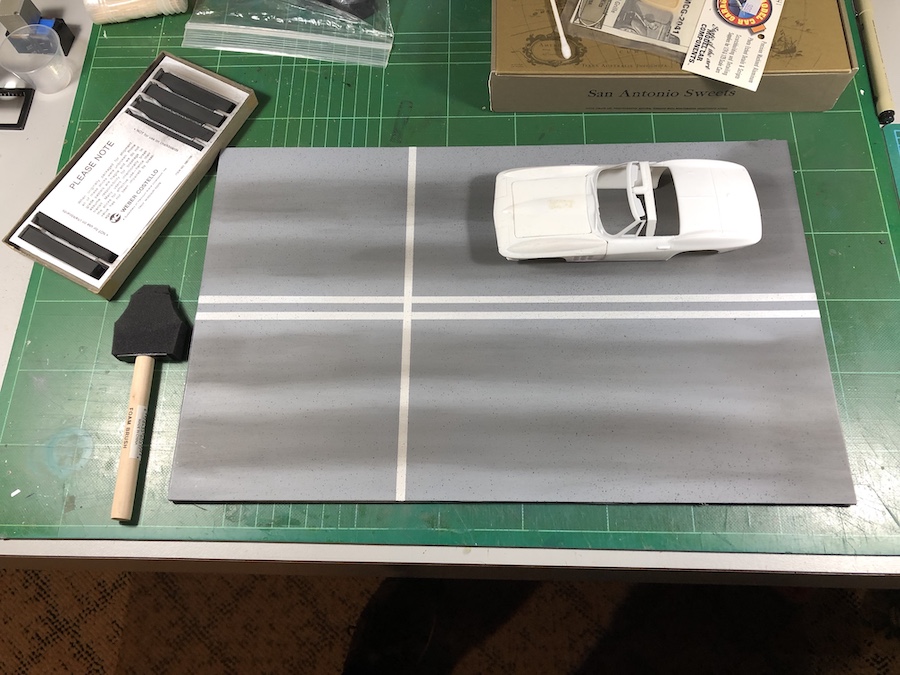

  2. Looking good! Tighten the screw a bit to make the stripe tighter. Clean the compass point after each tire. I prefer using flats. Looks more realistic and doesn’t tend to run! Keep practicing! You are just about there. However, looking great!!!

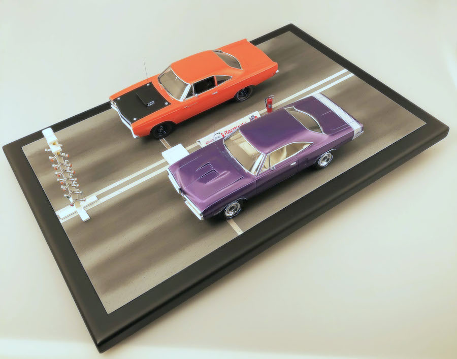

  5. Tom.... PM me with what you are looking for...
  6. Lookin’ good, Tom!

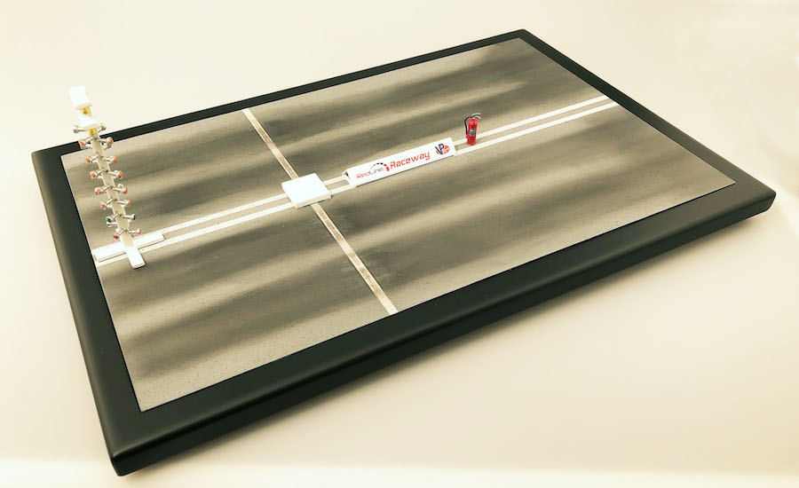

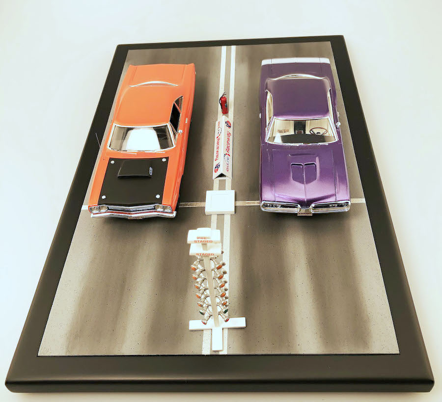

  9. I use artist charcoal. The can of air gets the excess off my work surface. When I’m done, I clear it with dullcote. I’ll see what pics I have to reduce. I’m hope to do an article in my column this week!
  10. Wrapped things up today... Two of my ancient magazine builds!

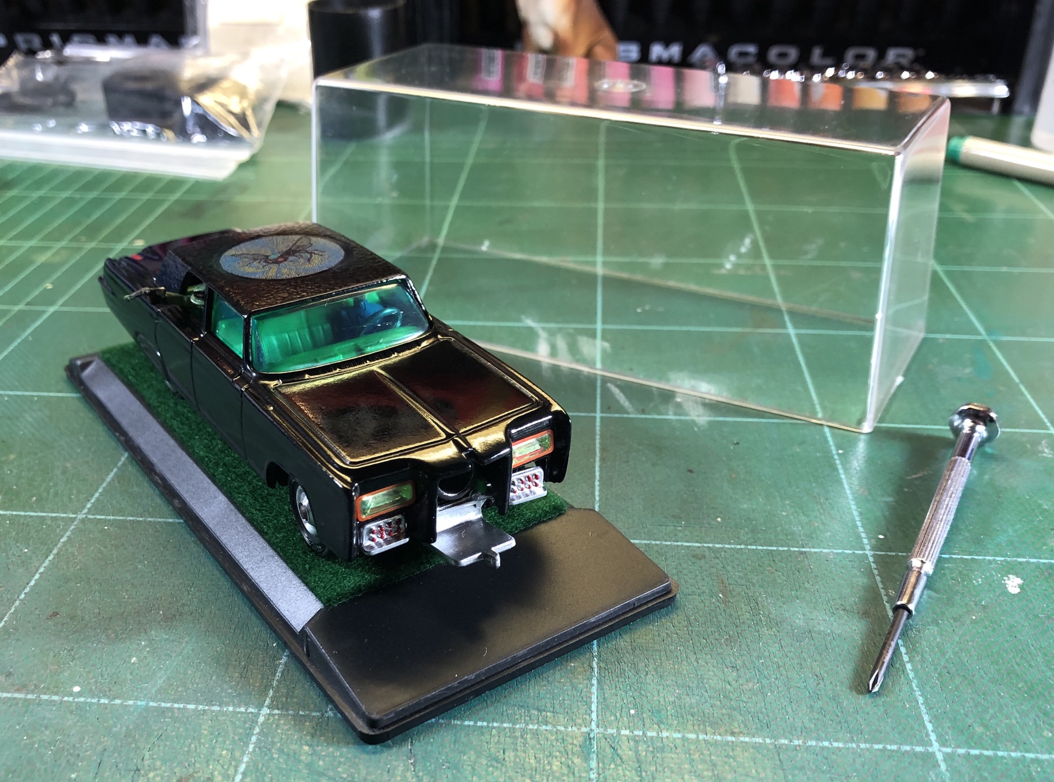

    may I ask what your issue is with Greg?
