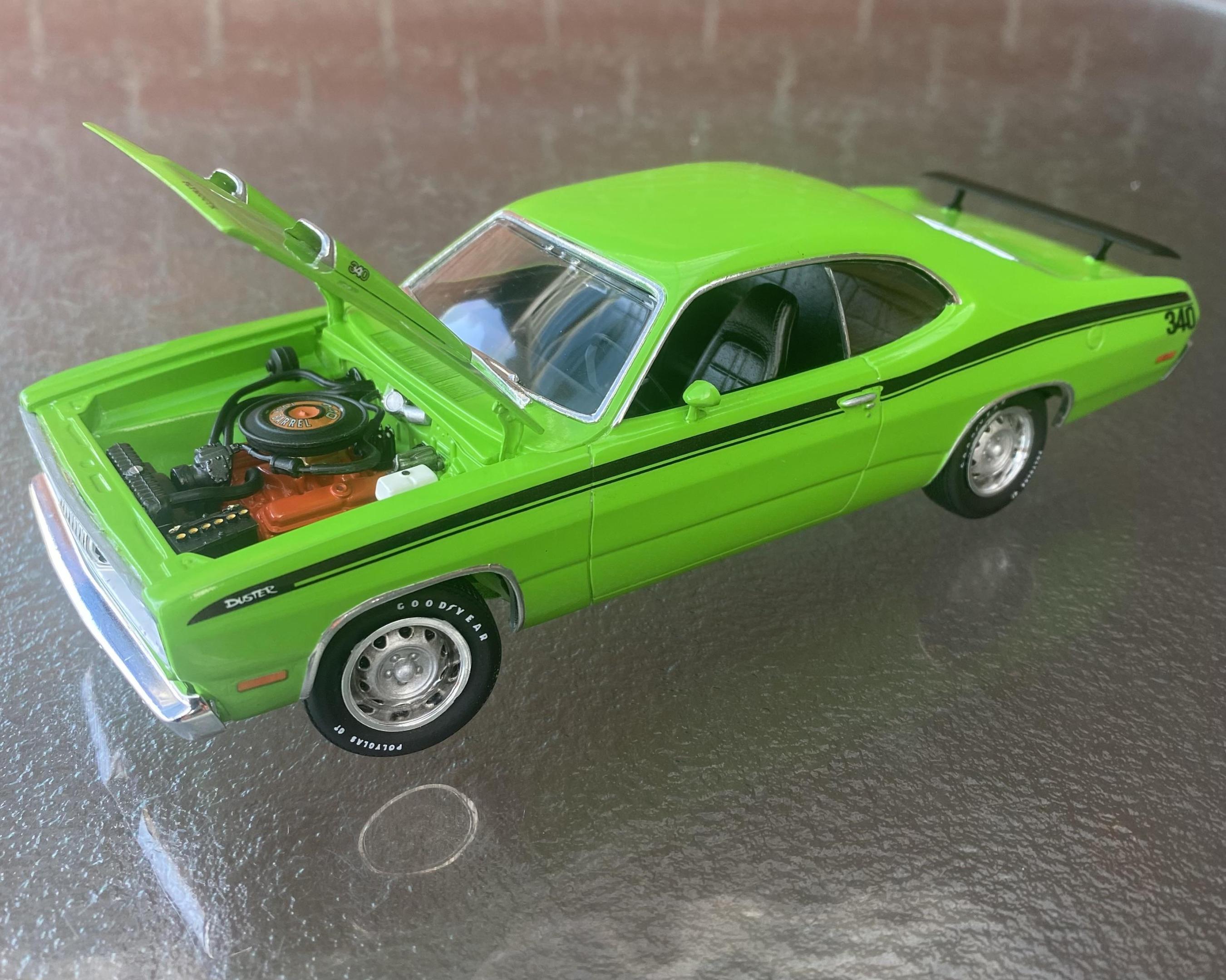

G’day Steve. I usually pop the can of TS-13 in some warm water for a few minutes and spray a light coat, wait around 20-30 minutes before applying another light coat, another 20 minutes and then apply a wetter final coat then l usually leave the body for around 2-4 weeks before polishing out with various grades of micro mesh cloth. Solid colours won’t really need TS-13, but metallics will benefit from it. If I’m using it over decals then I apply a slight ghost of a coat wait 2-3 weeks before applying another light mist coat wait 2-3 weeks then another slightly heavier coat building up to a final wet coat.The stripes on my 71 Duster were cleared with TS-13 using this method. It takes a lot of waiting between coats, but it will eat decals if applied too much and too soon, so being extra cautious is the key. I’m pretty comfortable using TS-13 now. Hope this helps you.??
