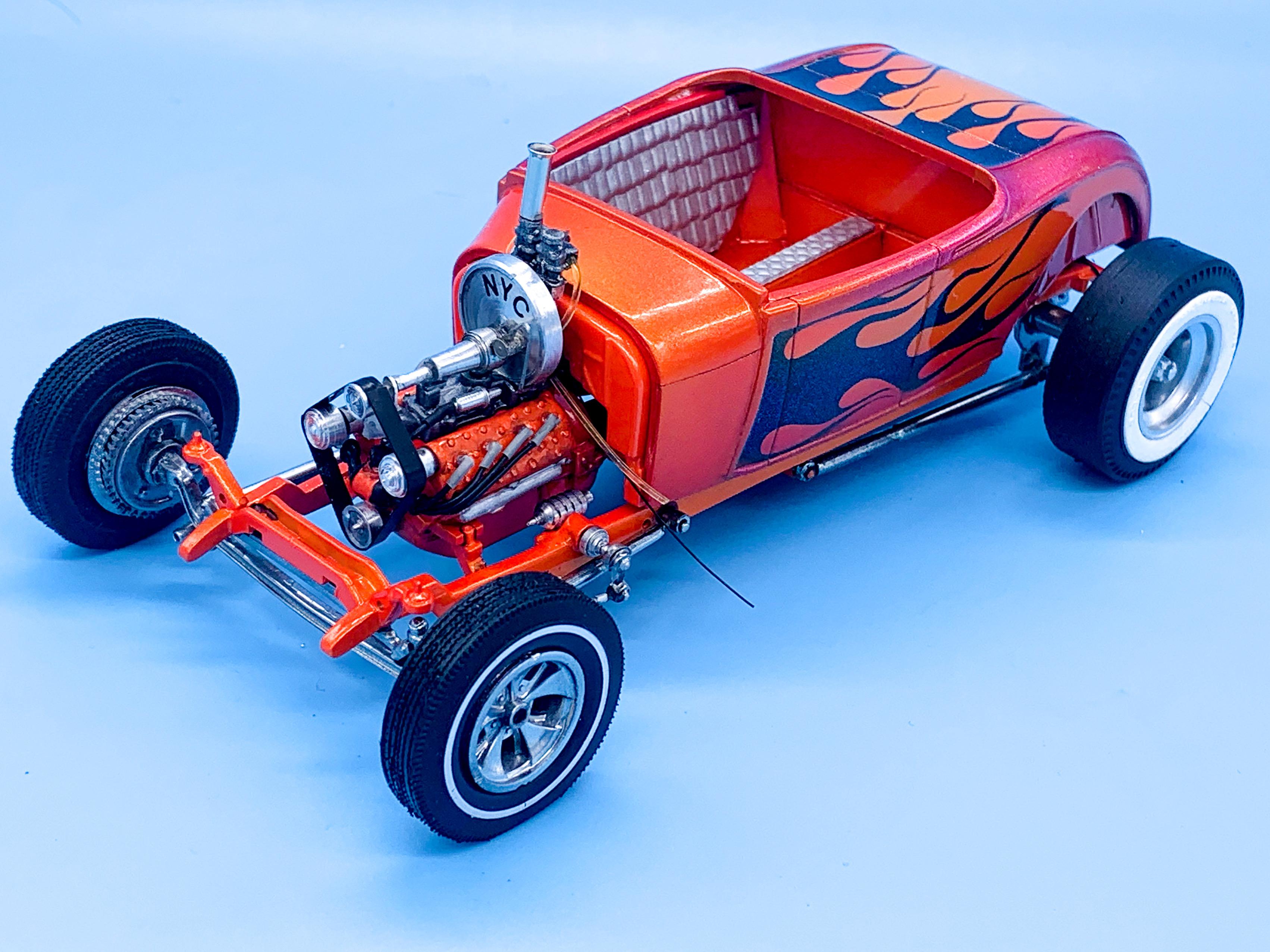

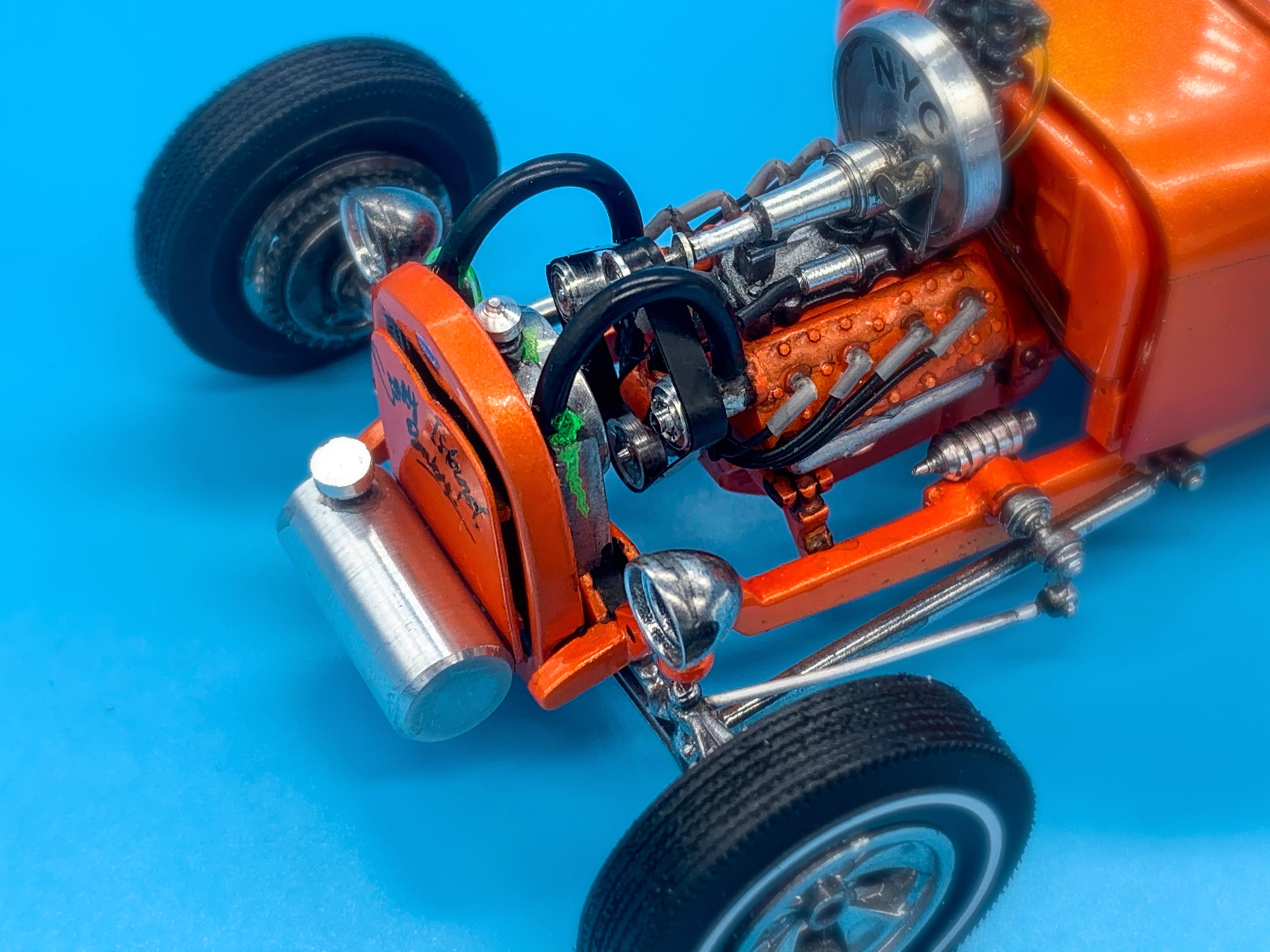

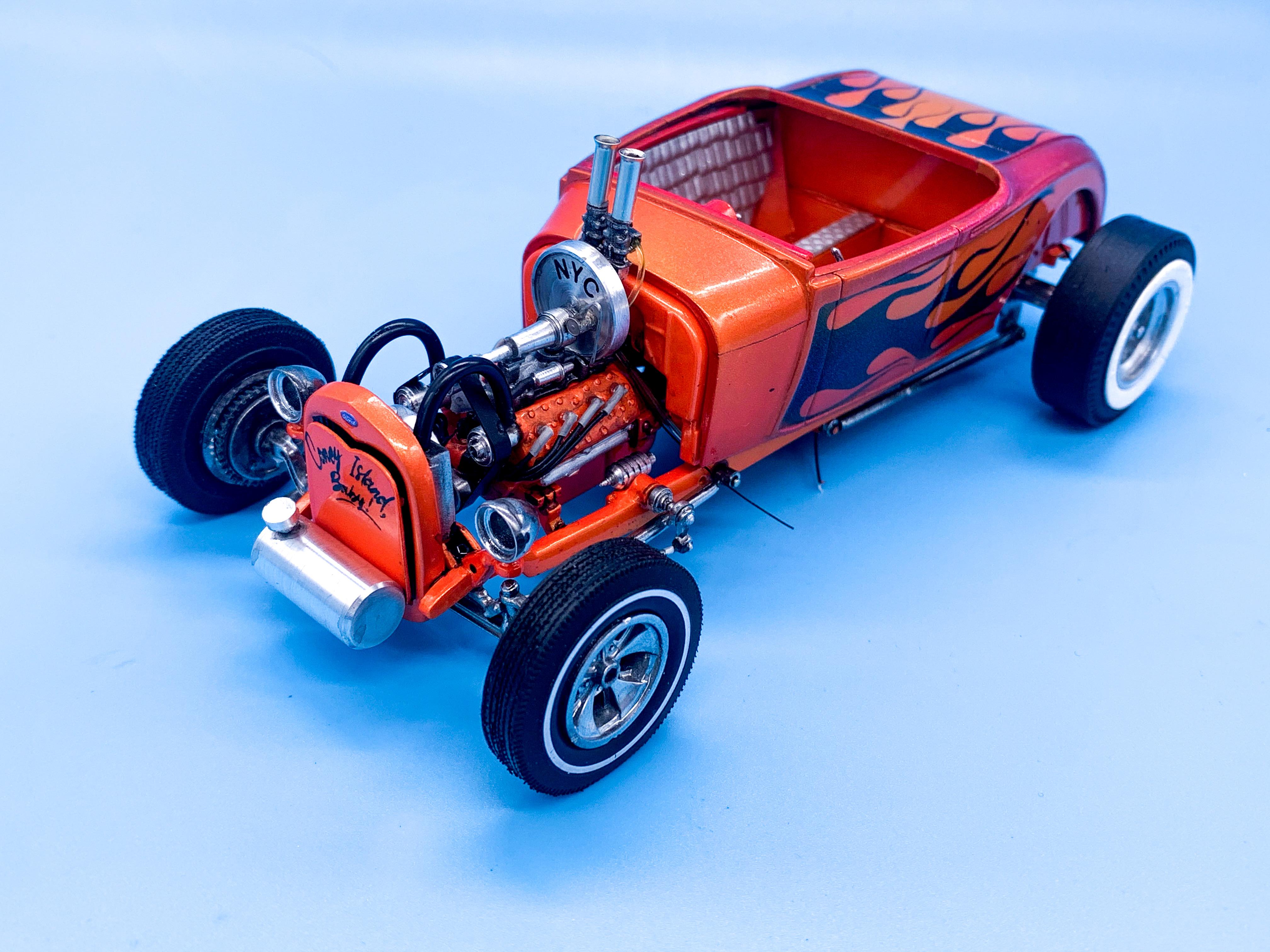

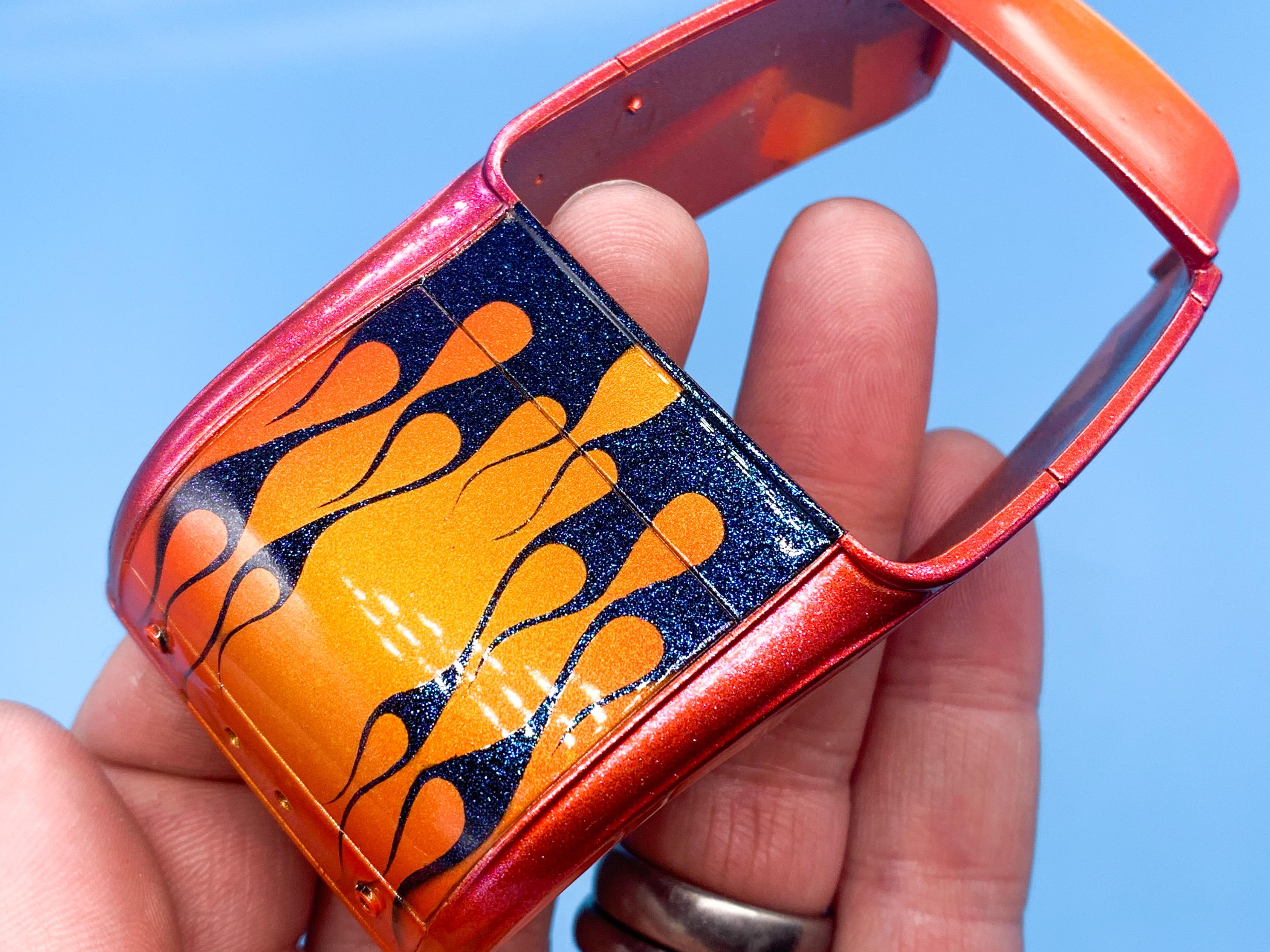

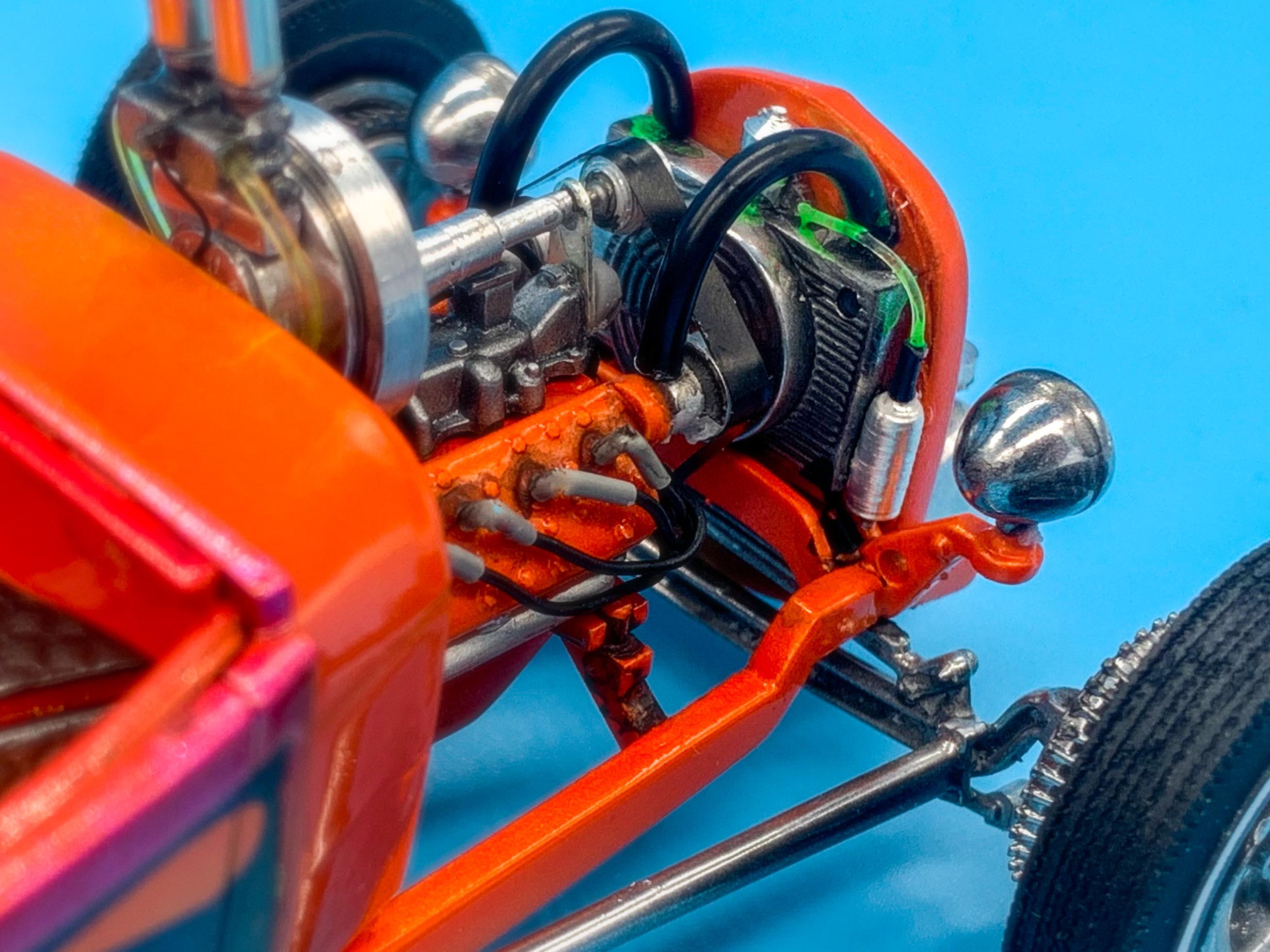

  1. Thanks fellas! Appreciate the nice words! I airbrushed it right on there! A little drop of thinners and blasted it on - I was worried it would be fragile or chip off easily but it seems fine! A little update on this one - got the body on the frame, and the wheels and tires on: And got the tank mounted to the grill, along with the little mini radiator I found in my spares box and got that mounted too: Made a little catch-can for the radiator, seeing as this thing would almost certainly overheat easily with that Flathead and a covered-over grill shell and a tiny radiator, and mixed up some translucent neon paint to represent a little anti-freeze overflow: Looks like it got hot enough to leak some out of the hoses too: Stupid impractical hot rods, always overheating... More soon!

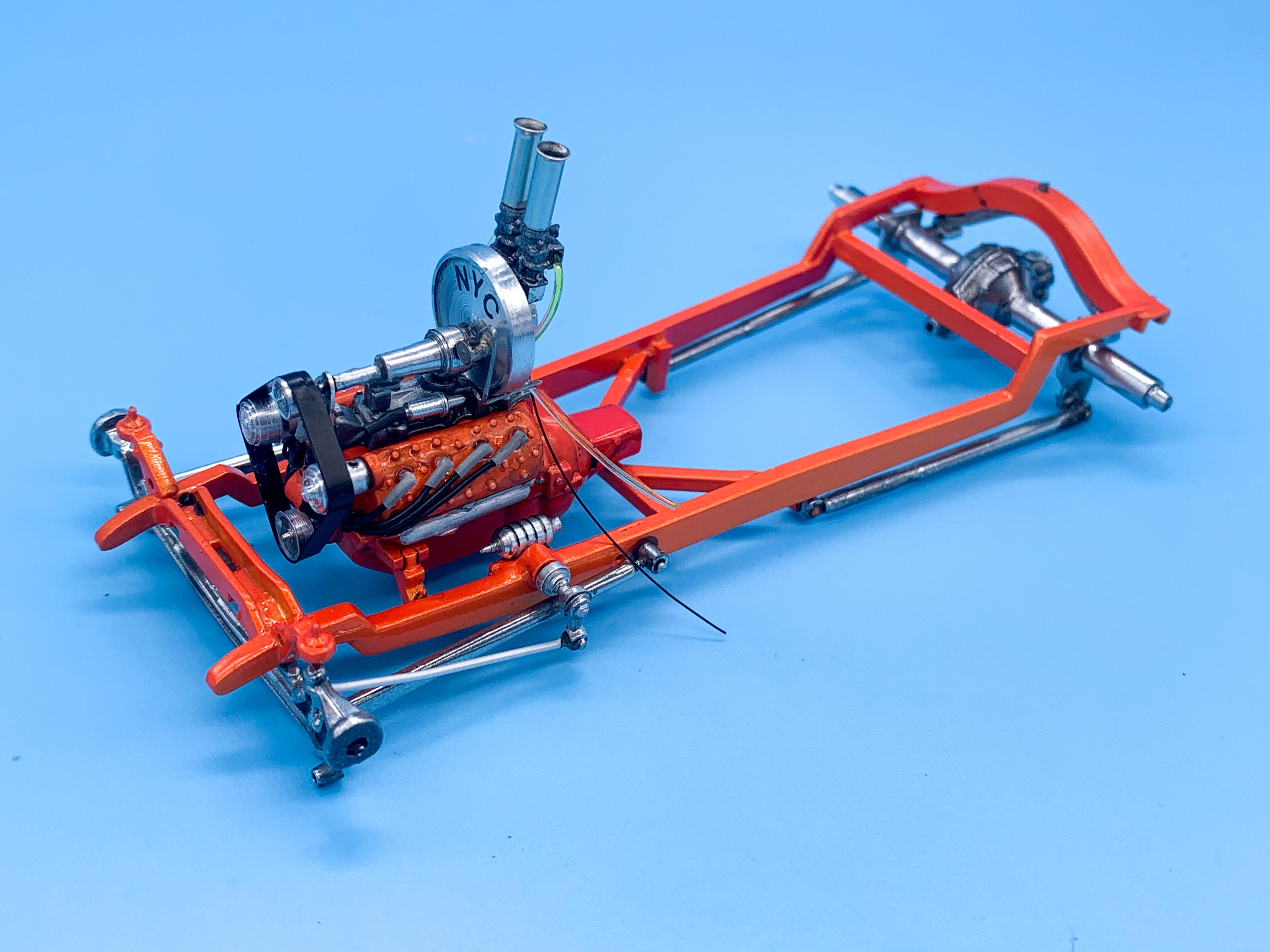

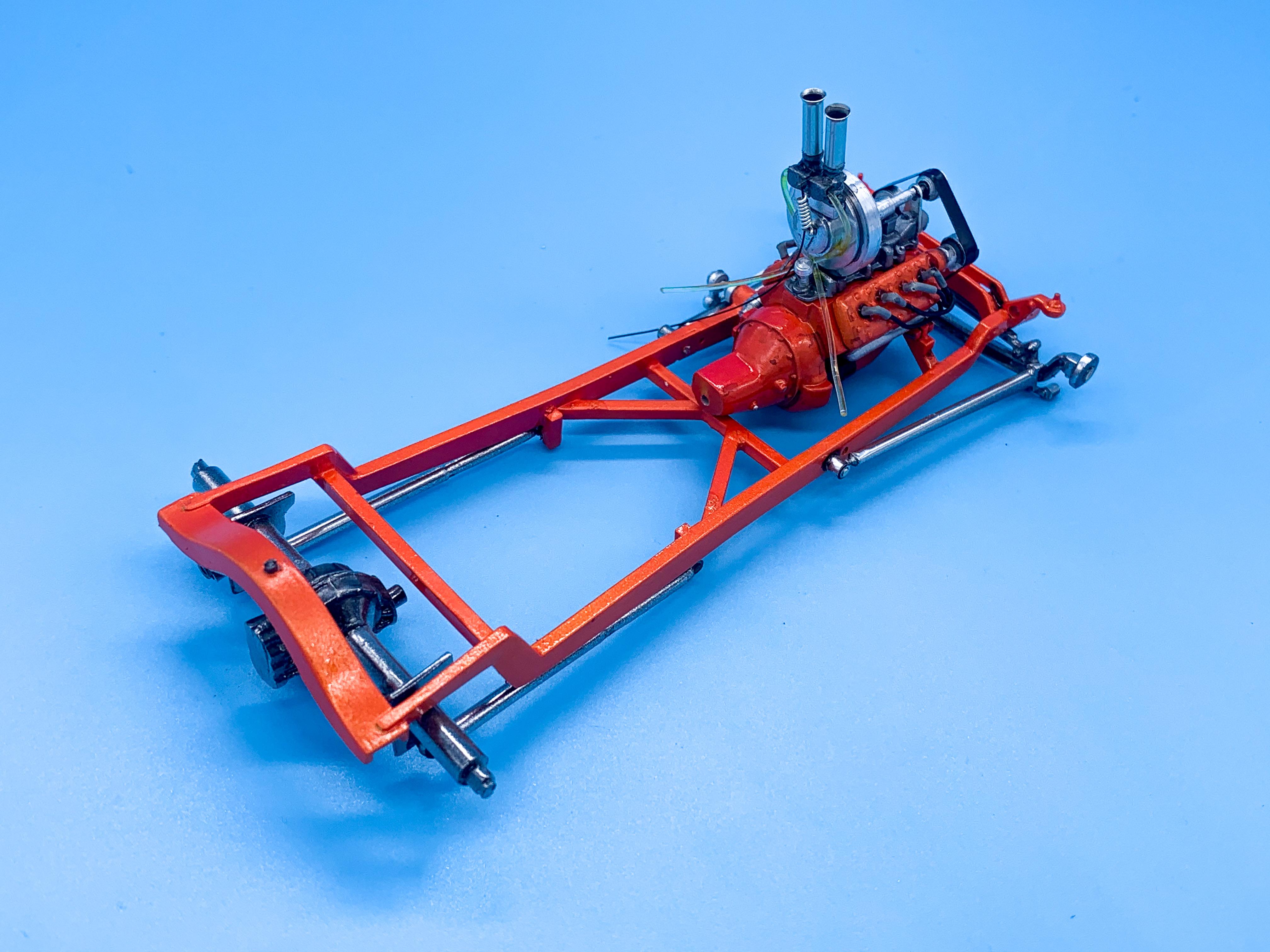

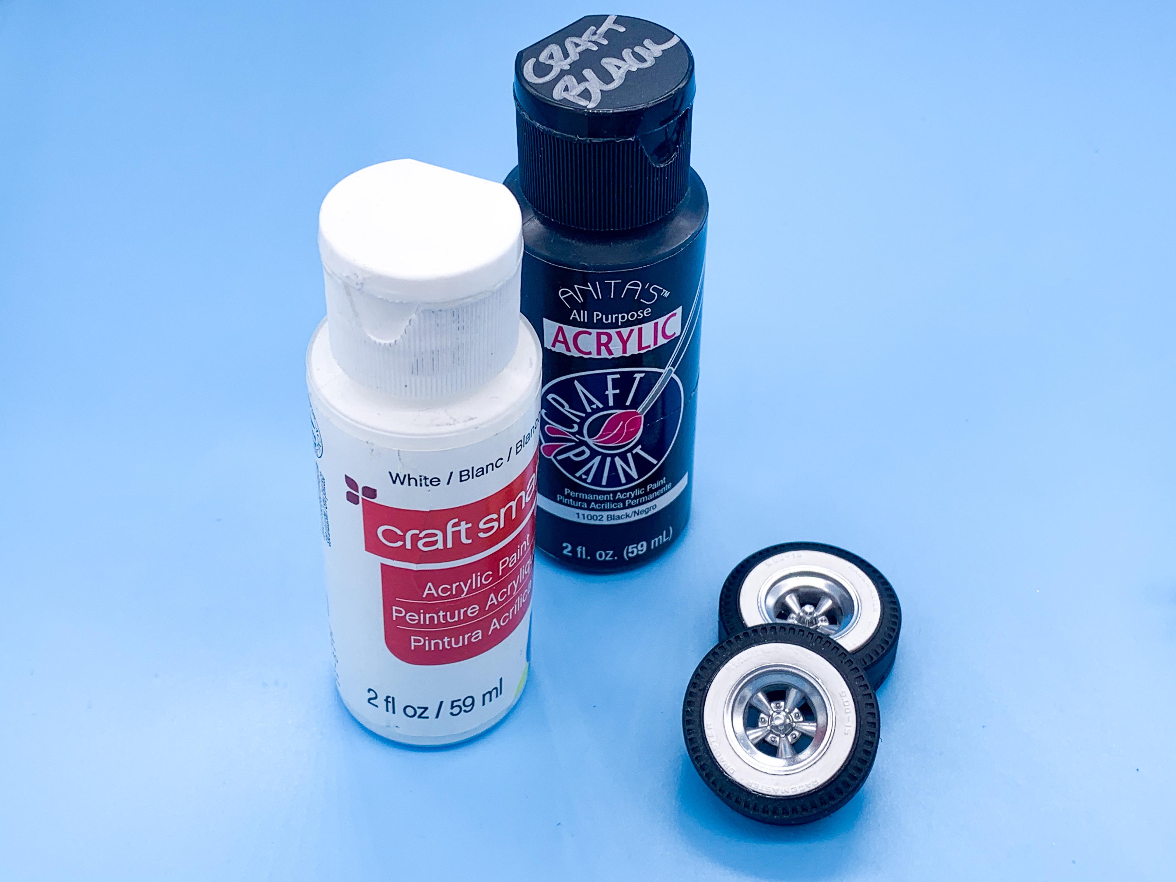

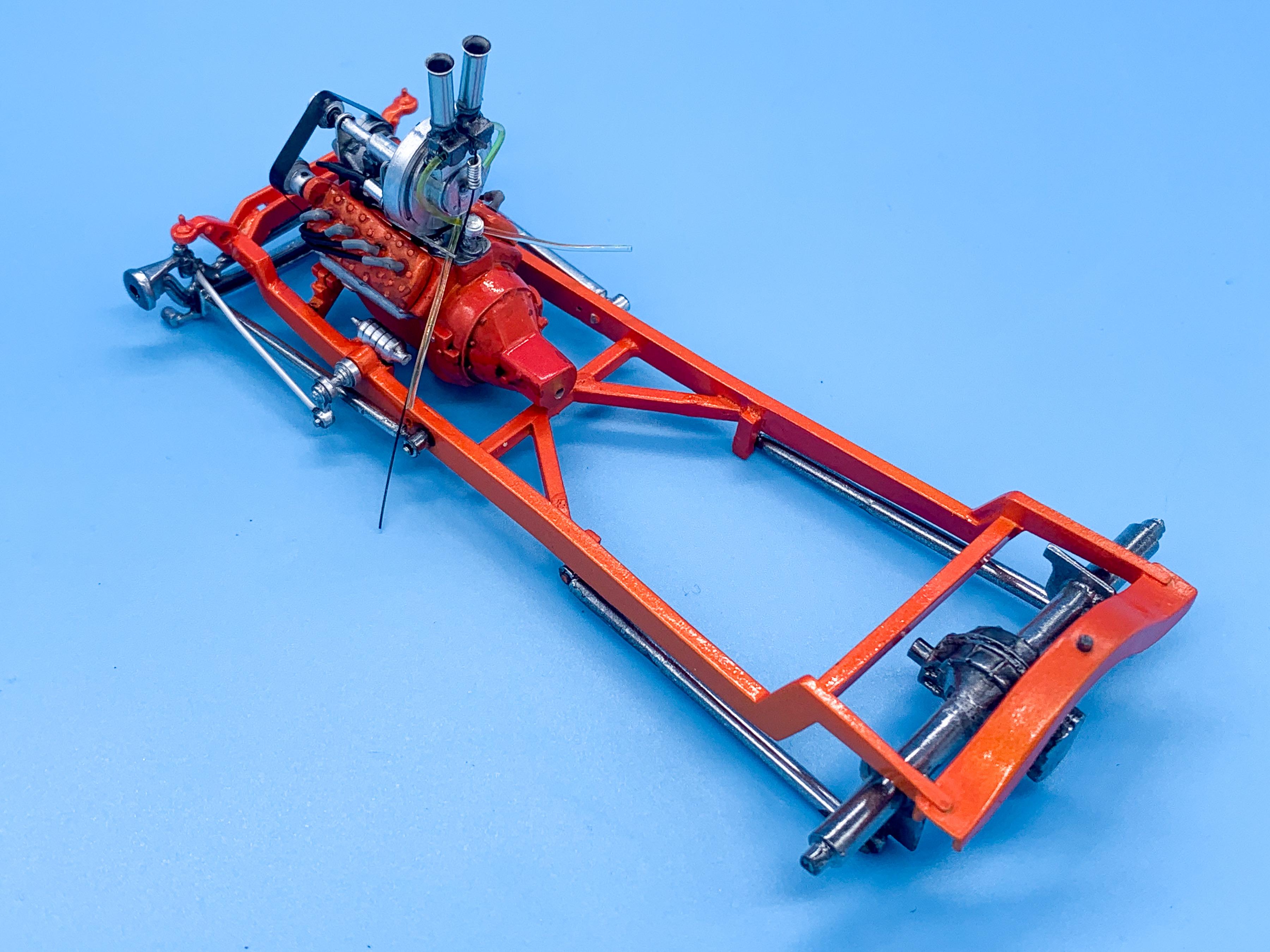

  5. Chassis assembly day! Some of it anyway - got the axles and linkages in place, along with the machined bits I made for the steering, and dropped the engine in there just to see how it’ll all look together: Need to do some plumbing and wiring before the engine can go in for good, but it’s a fun looking frame I think! And, borrowing a trick from John Teresi, painted the tires with some craft paint to give them a more realistic look - got some more detailing to do, but I like the effect of the craft paint compared to plain old vinyl tires! Just a mini update - more soon!

  7. I’ve been thinking about tires a lot this week - I saw these two images of an entirely computer-rendered car, and I was really impressed with the detail in the tires: The slight scuffs and grit on the sidewall, the lighter grey on the radius of the tire versus the darker grey on the edge...I’d like to try airbrushing a vinyl kit tire with some similar shades and see how much realism it adds and how it looks! I know this isn’t a model OR a real car - but it’s done by an artist trying to do the same as we are, just in the digital realm, and it looks good to me!

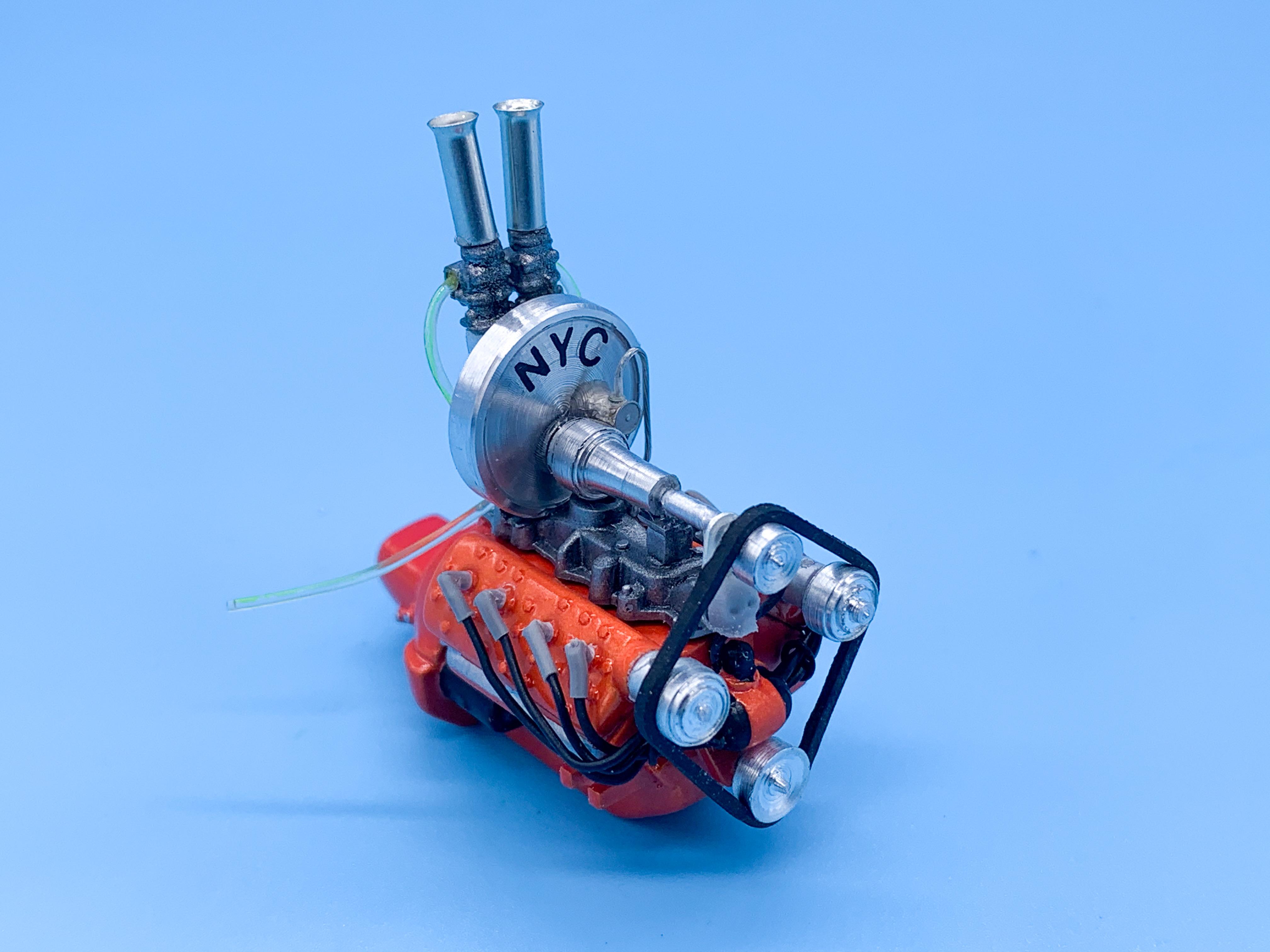

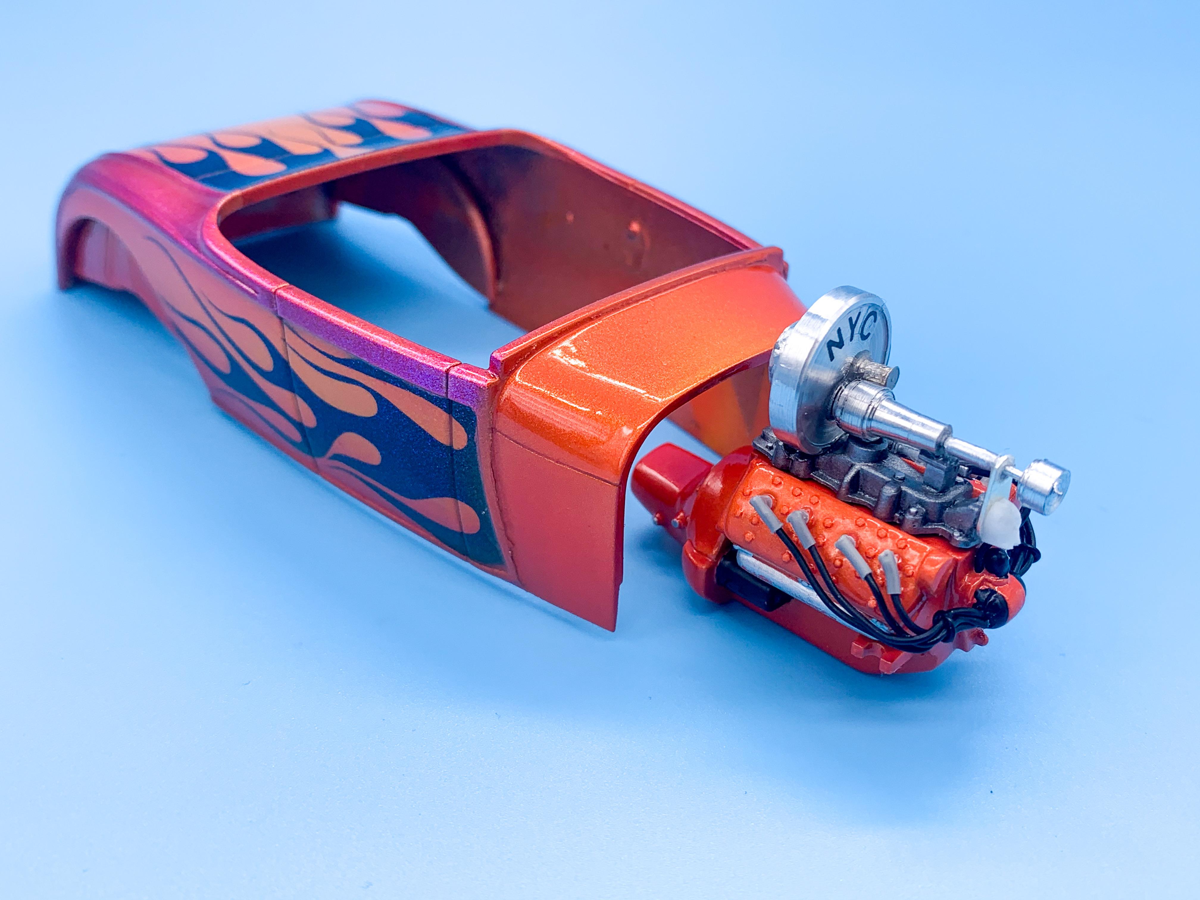

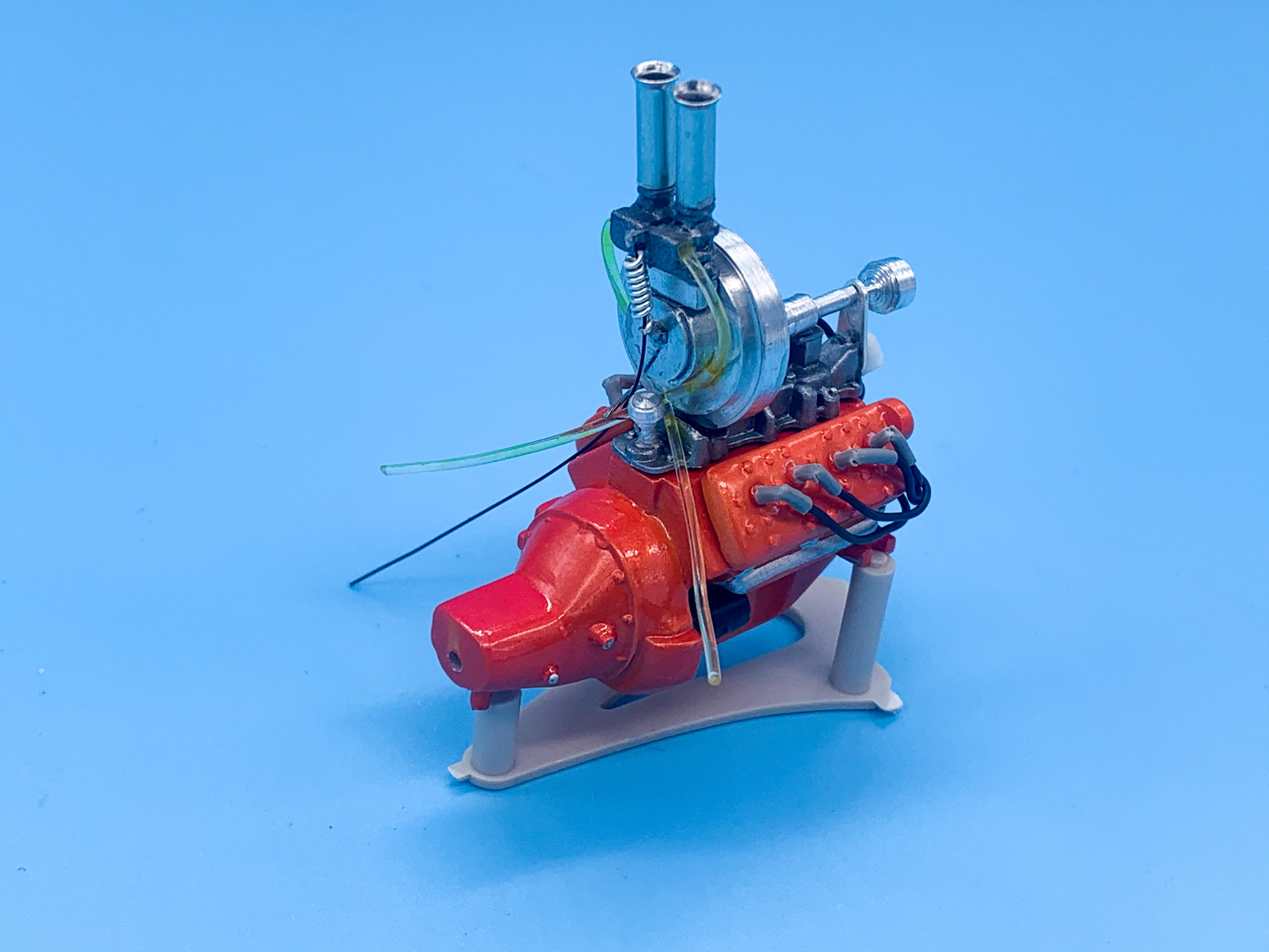

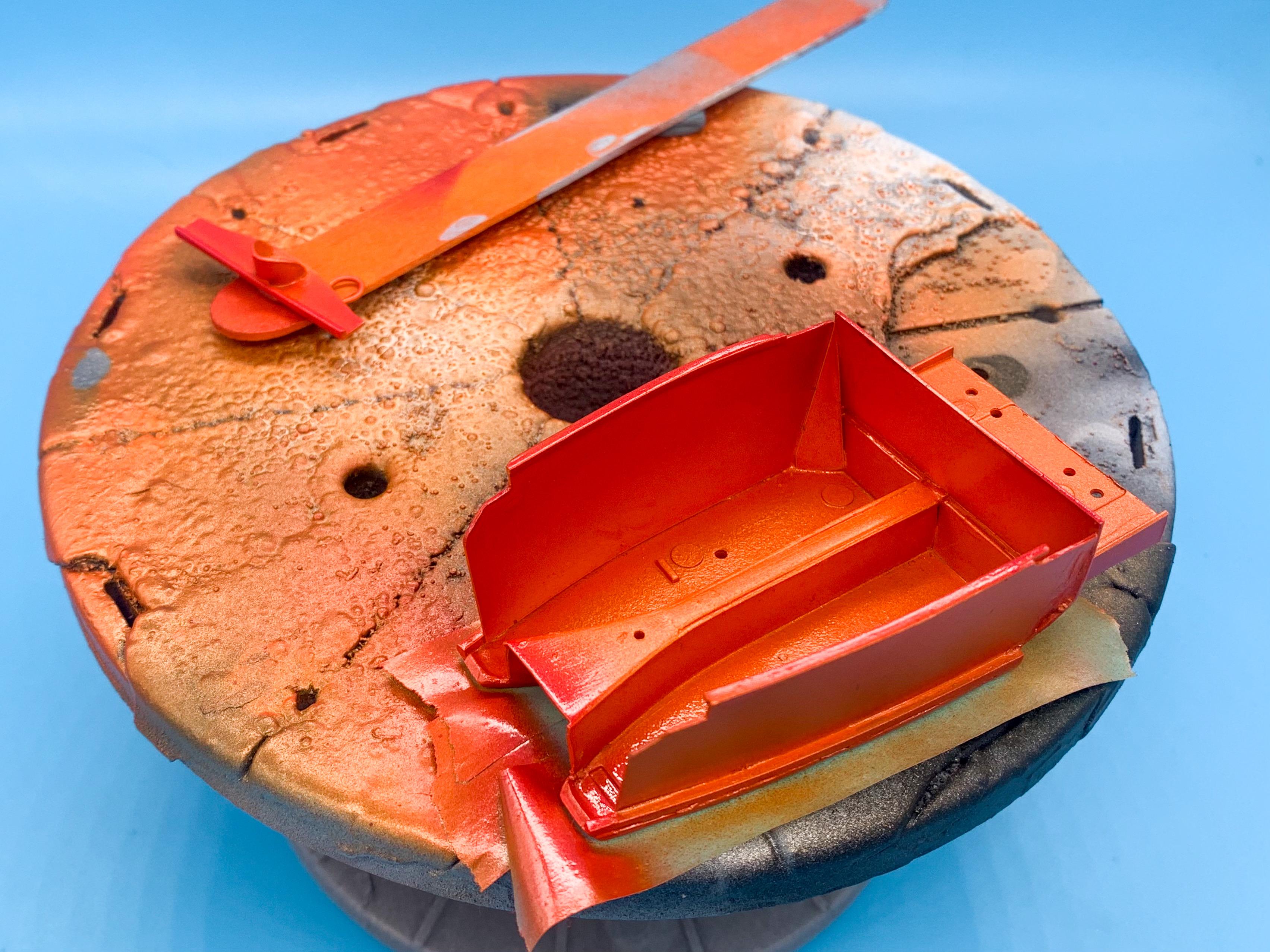

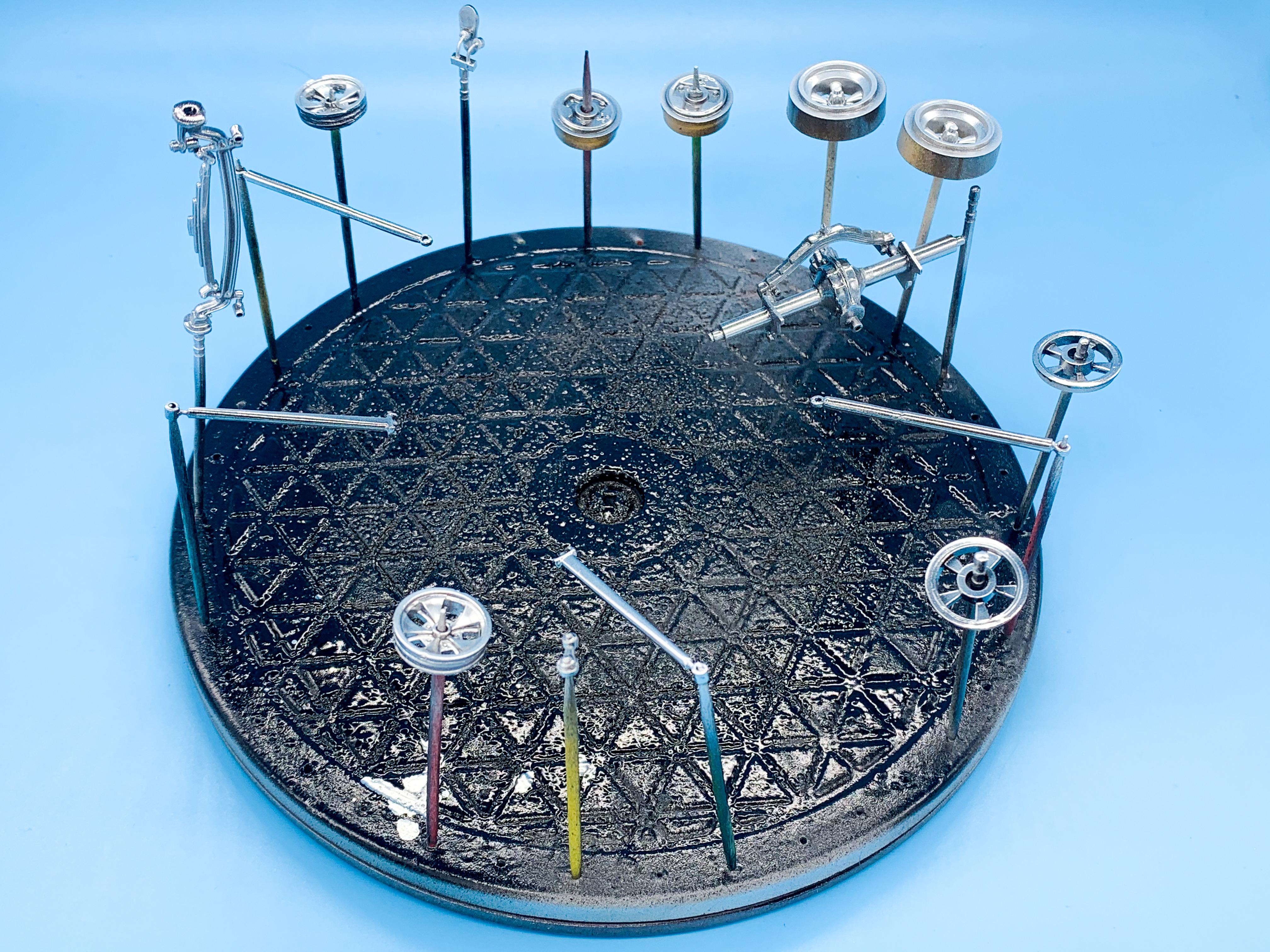

  8. Thanks buddy! A little more progress this past week - not as much as I’d like, as usual but I got a bunch of clean-up and little jobs done at least. Got the carbs painted and fuel lines in place: Machined a set of pulleys: That belt is too big, but I wanted to try it anyway - I’ll make another out of something more in-scale... Cleaned up and prepped a bunch of chassis parts for chrome: Then chromed them! ? And got some more of that Createx orange and Testors Hot Pink on the interior tub and dash so I can start assembling and detailing them: Got plenty to paint still - if it’s not chrome or real metal...it’ll be candy or flake or both! More soon!

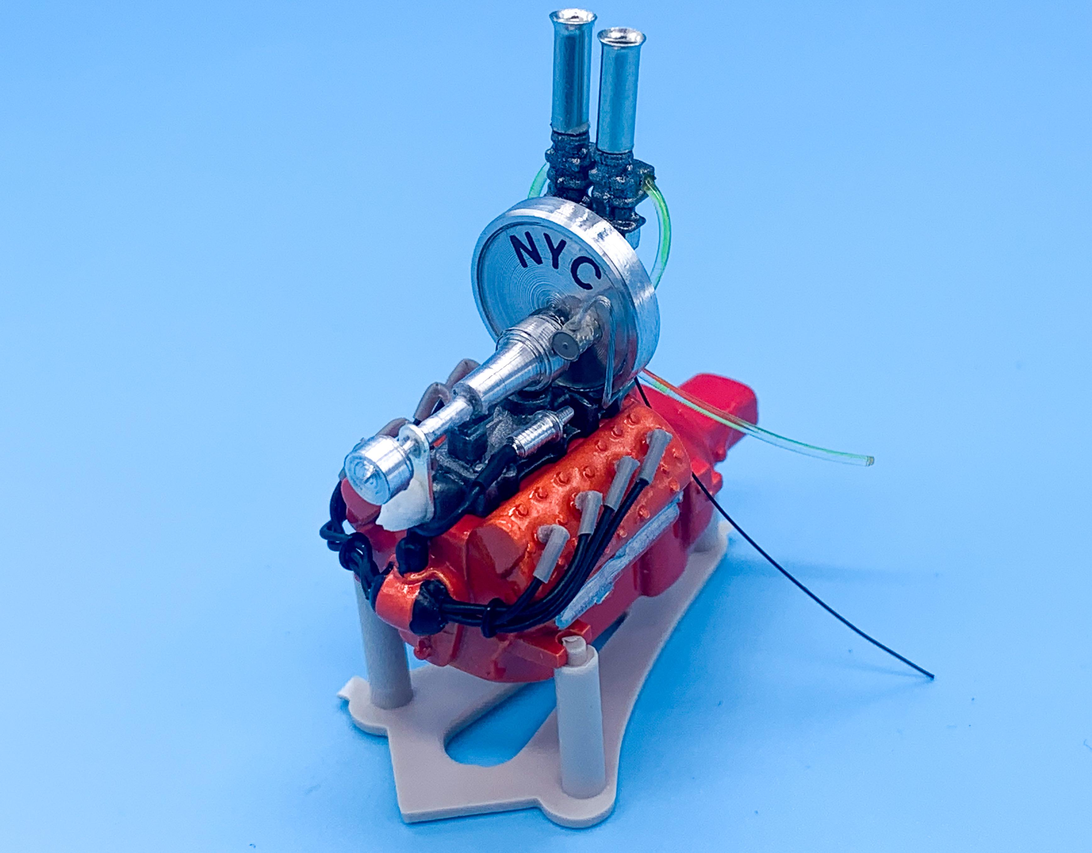

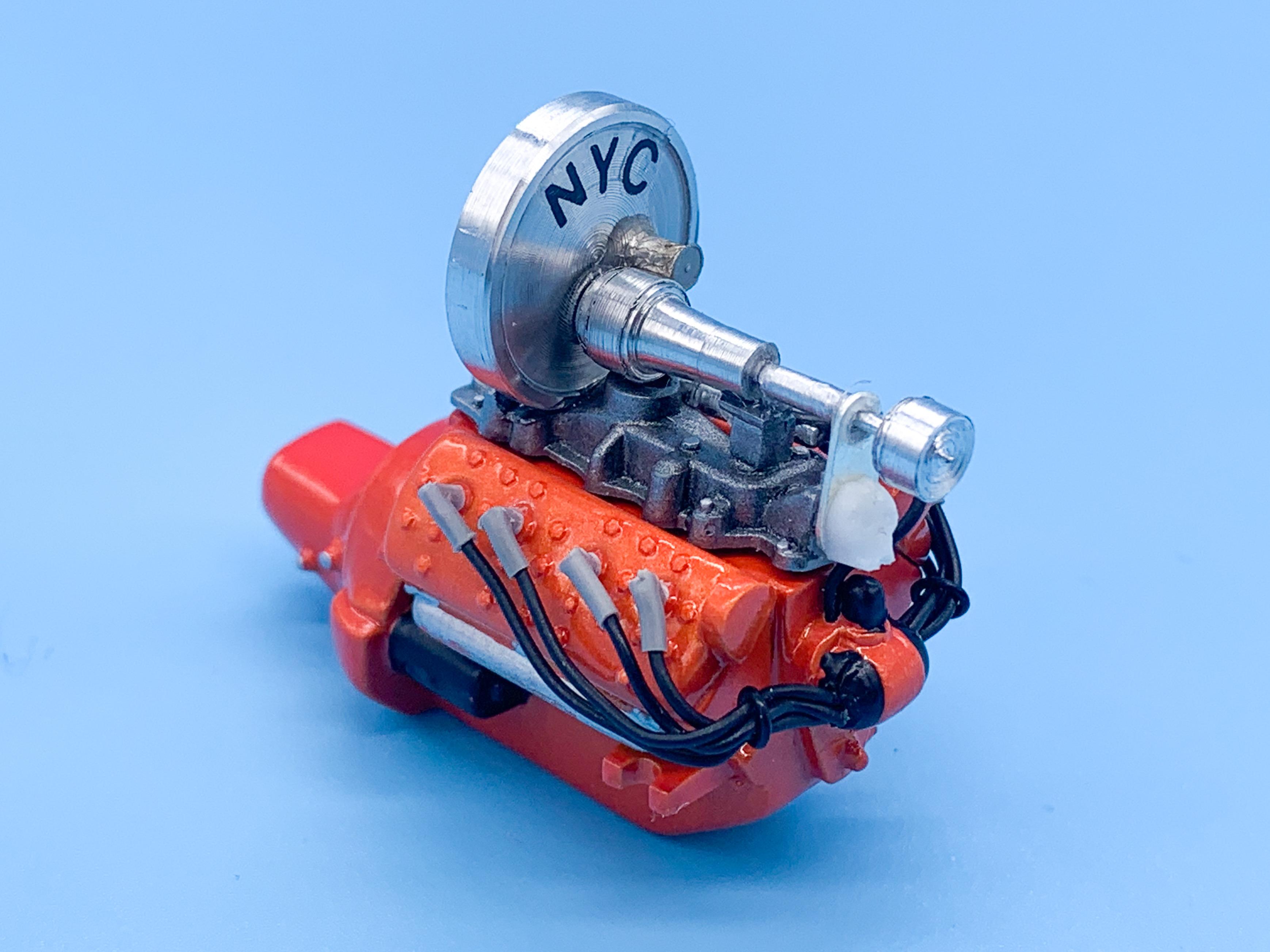

  17. I always enjoyed his work too - hope he's doing ok!

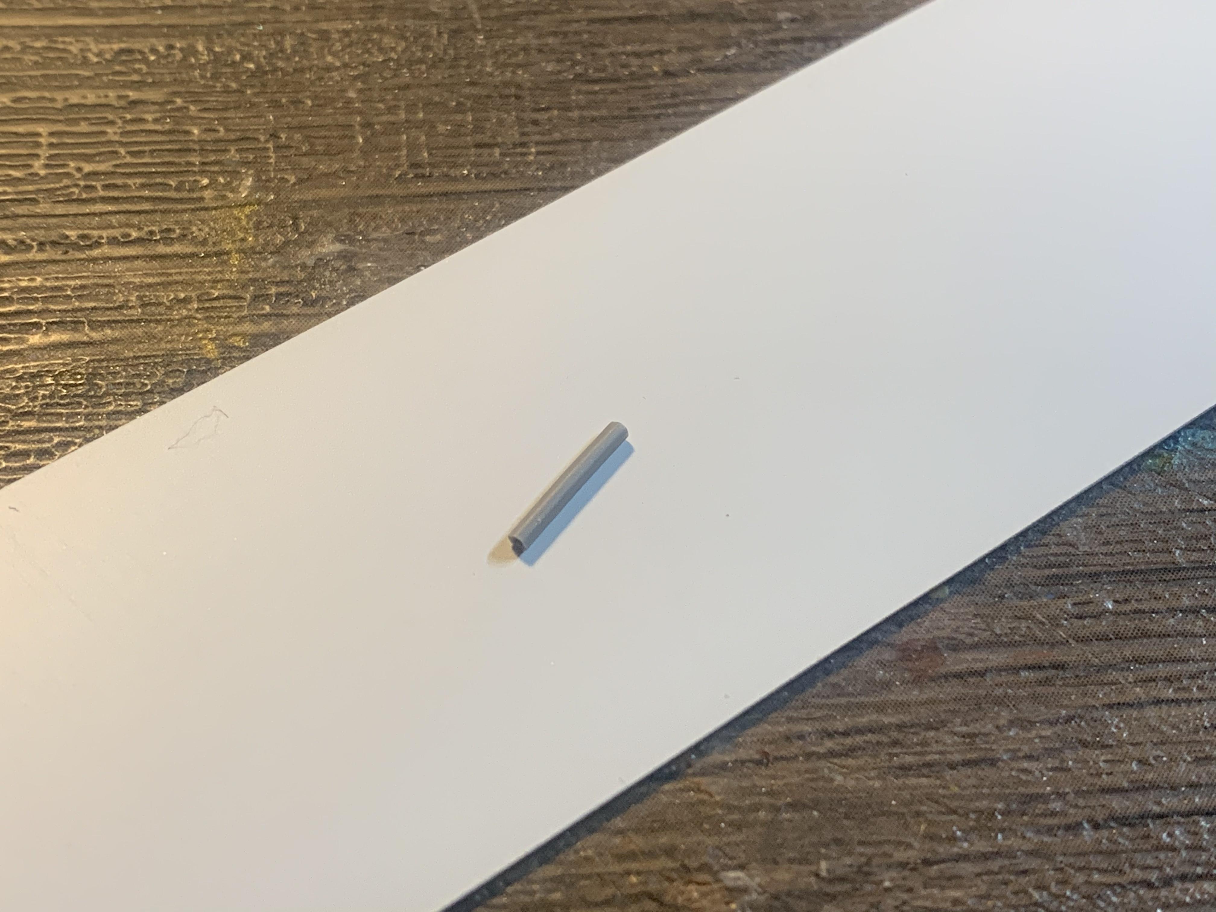

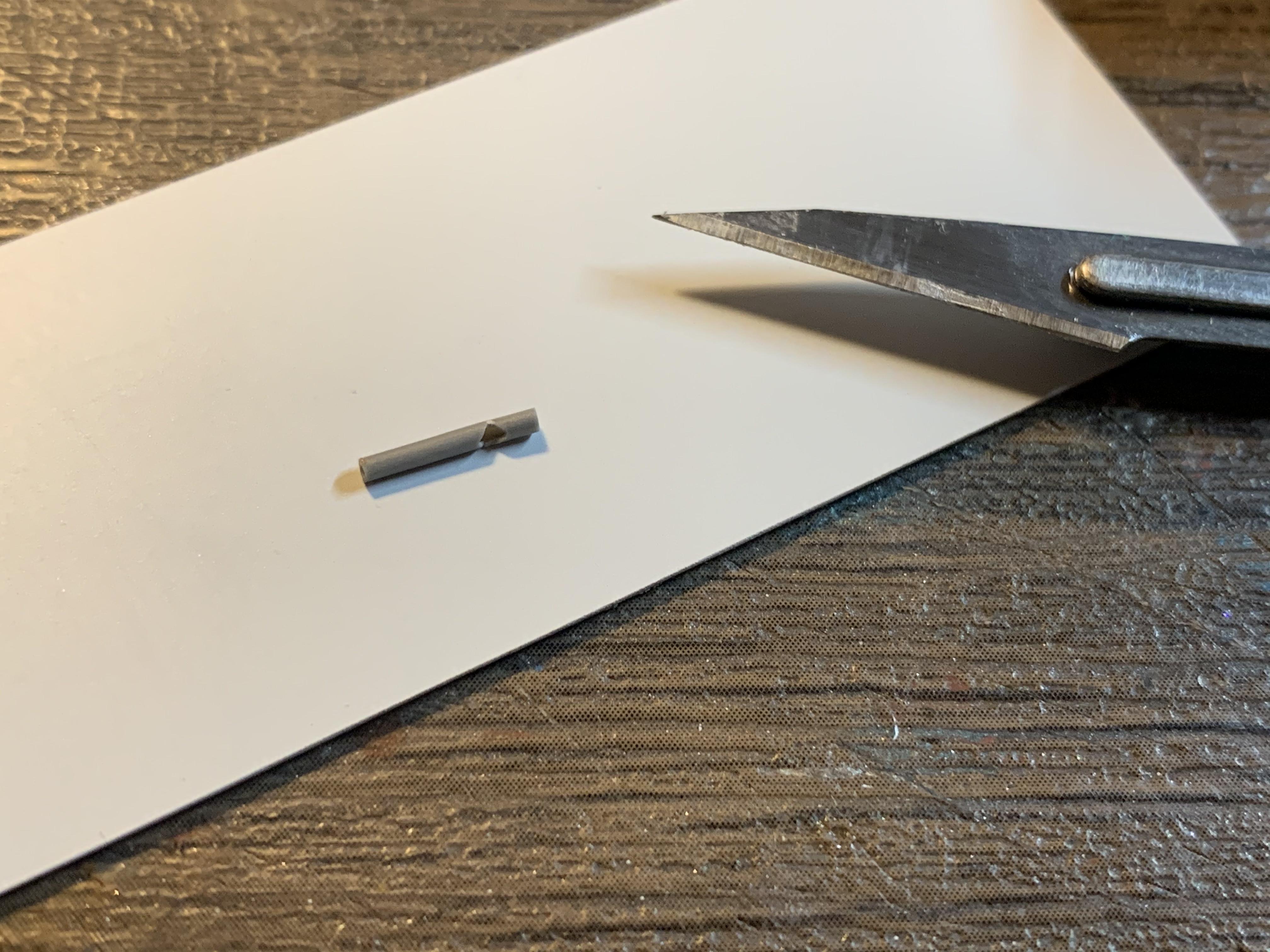

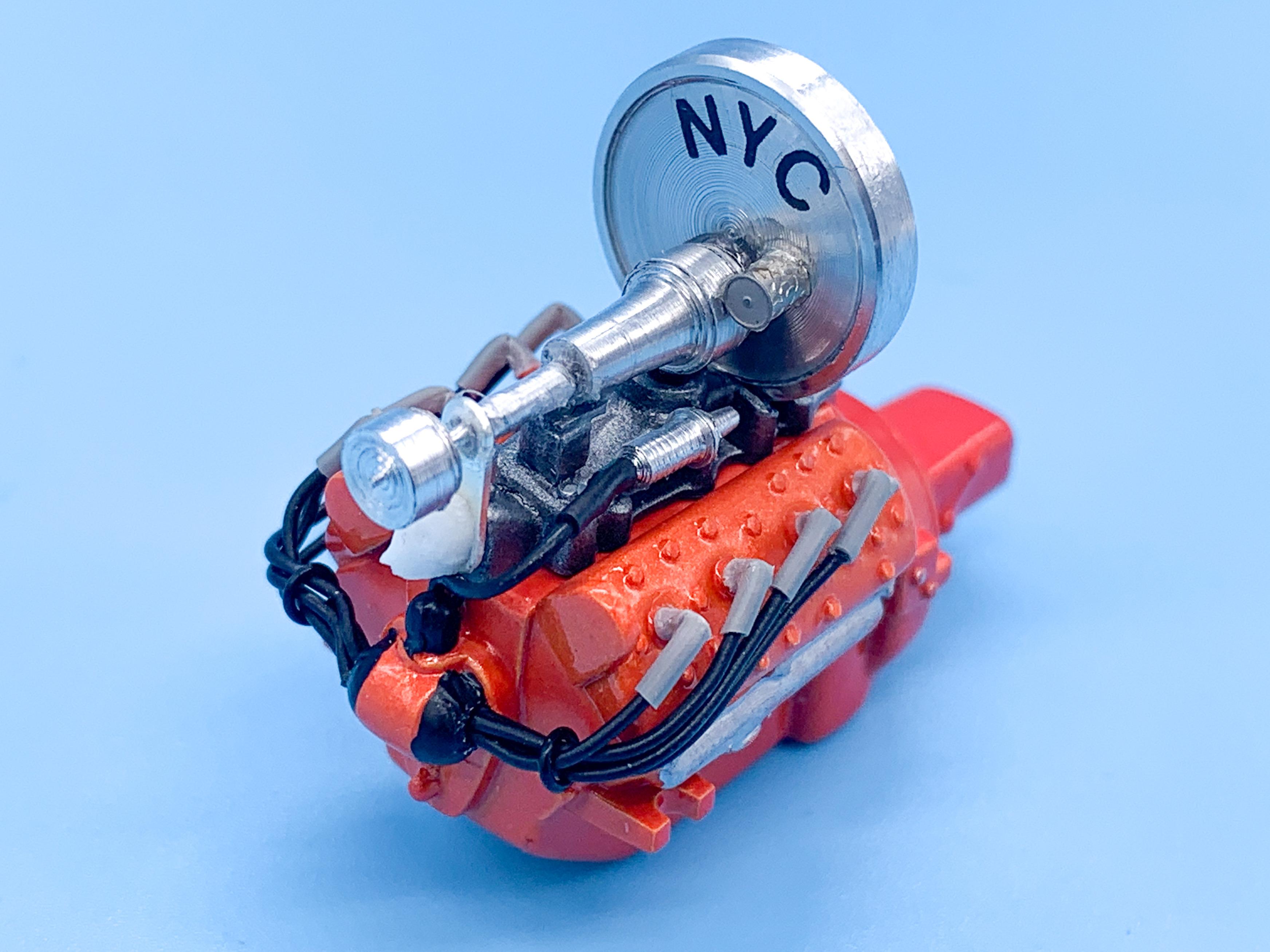

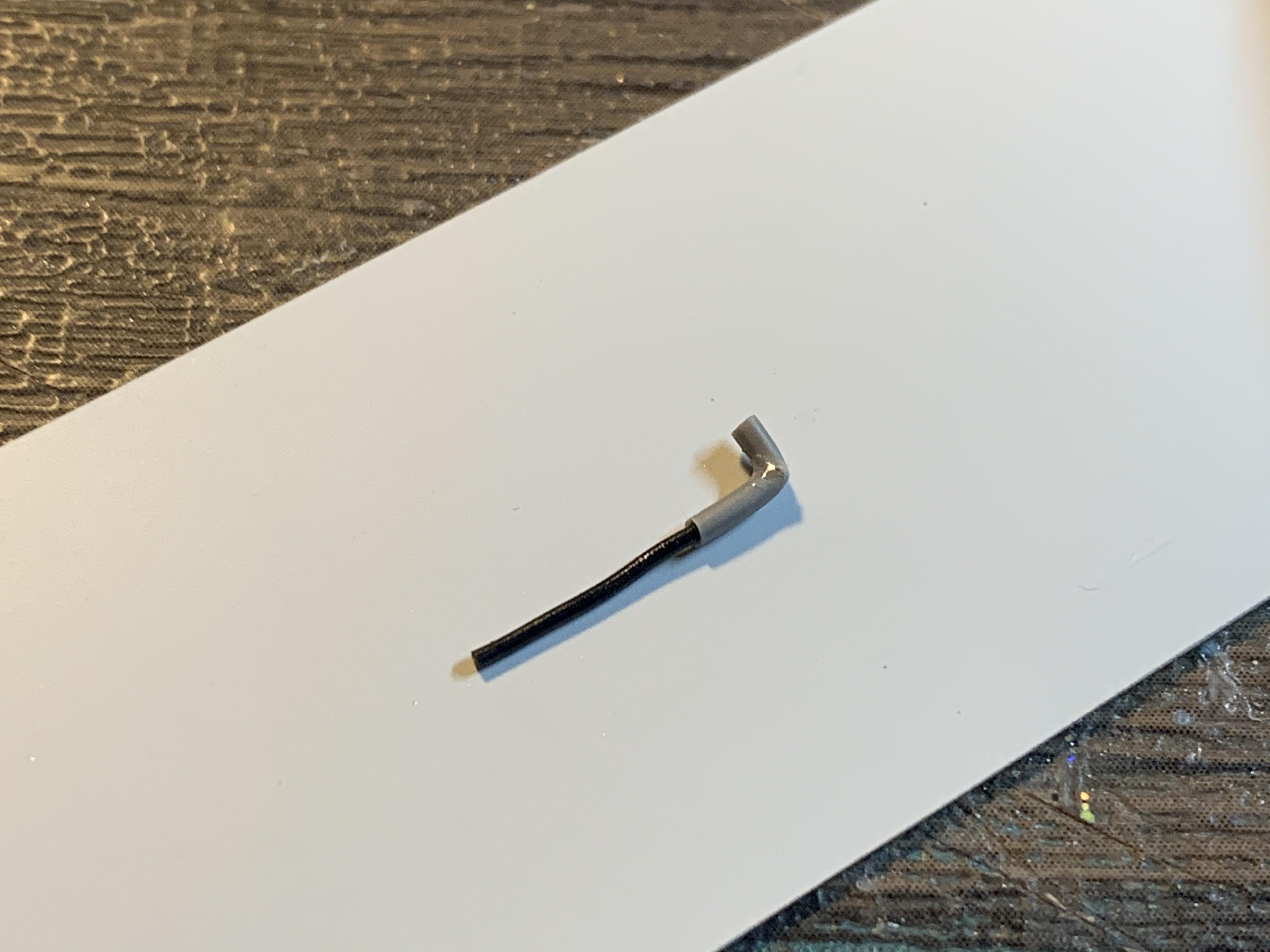

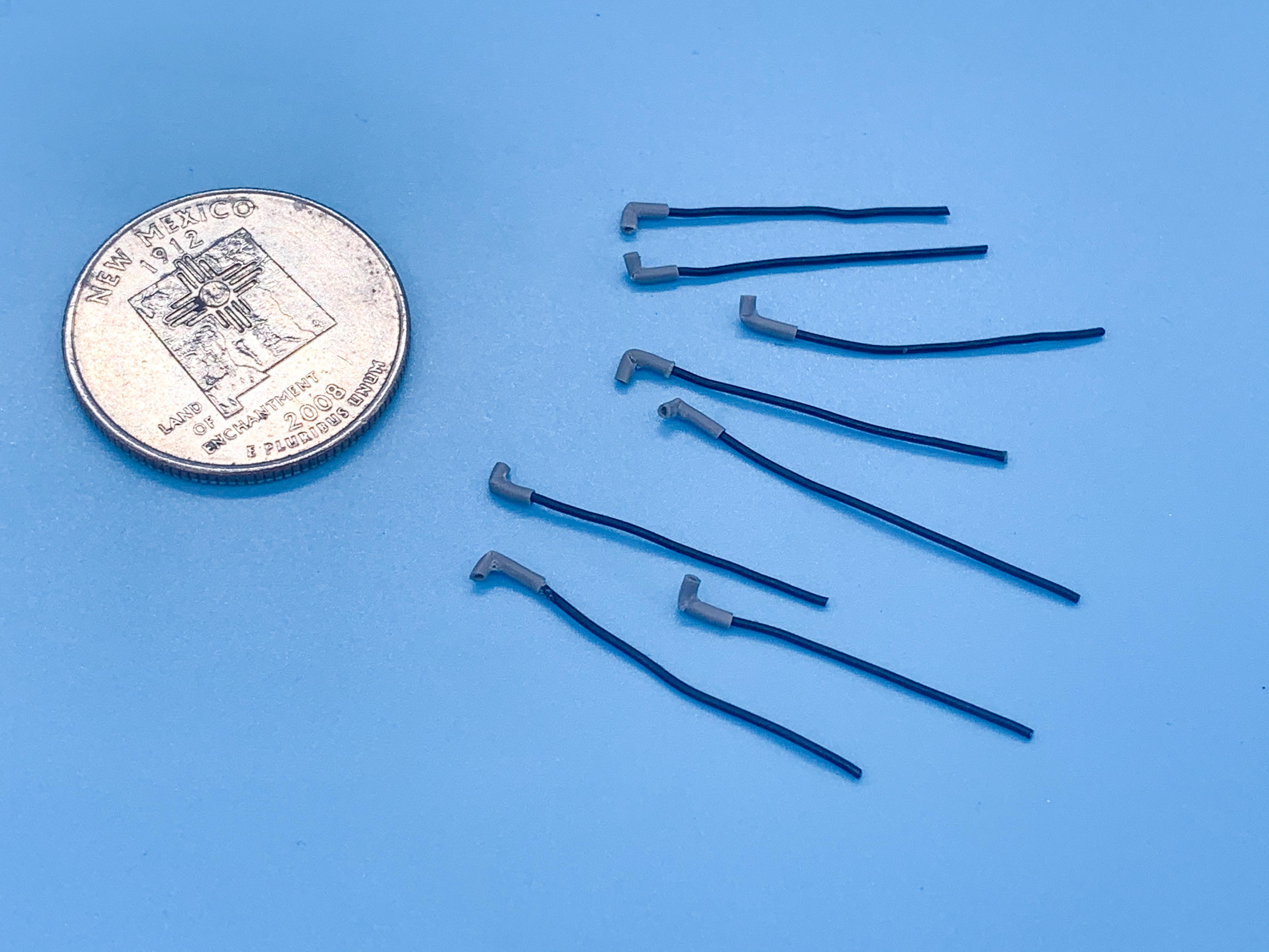

  20. Mini update (and mini angled-plug-boot-making tutorial seeing as a couple of people asked for it...) I wanted to take a little more time and effort on the wiring of this engine - the detail isn’t incredible on the old AMT block I’m using so I’m making up for it with some other little bits and pieces. So, here goes making angled plug boots the best way I've figured out so far. You’ll need some wire that’s a larger diameter than your plug wires - I have a stash of old charger leads and headphones and junk that I’ve saved for exactly that. Just pull the actual wire out of the sleeve and you’ll be left with this: Then, slice a couple of angled cuts into, but not all the way through, the sleeve to remove a little diamond shape: Next, dip your plug wire into your superglue of choice, and slide it into the longer end (it’s easier to do the next step if you do that first, seeing as we’re working with some tiny fiddly little parts here). Then, you need a little dab’l-do-ya of superglue in the cut out, and fold the sleeve in on itself to make an angled boot: Then repeat as many times as necessary until you’ve got a set you’re happy with: Tada! I still want to perfect this process some more, but it’s a start! With those made (plus a few redos, until I ran out of the grey wire I was using) I could do a little assembly and wiring on the engine: Driver’s going to have a pretty wild view...bet it would sound pretty good too! Pretty pleased with how the clear laid down on this one too - might be my best result yet. A little gloss REALLY brought out the sparkles and flake!! More soon, thanks for looking!
