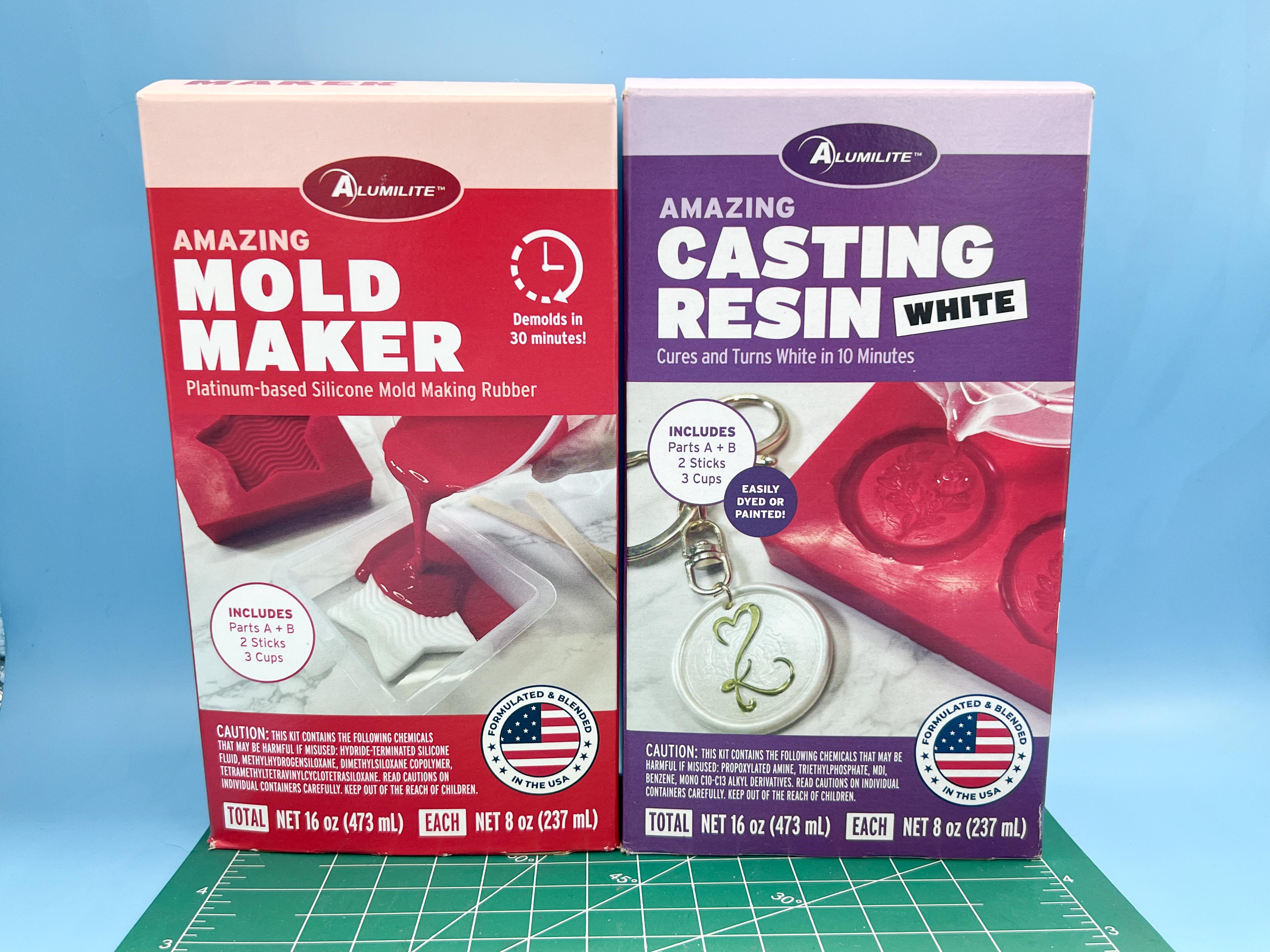

  8. My wife ran to Michael’s today and brought these back for me - they were $2 each on clearance: The fact that my wife knows enough about my hobby to know that I have a use for these AND the fact that she tried to pick colors that would be useful for car builds tells me I lucked into a pretty good wife…
