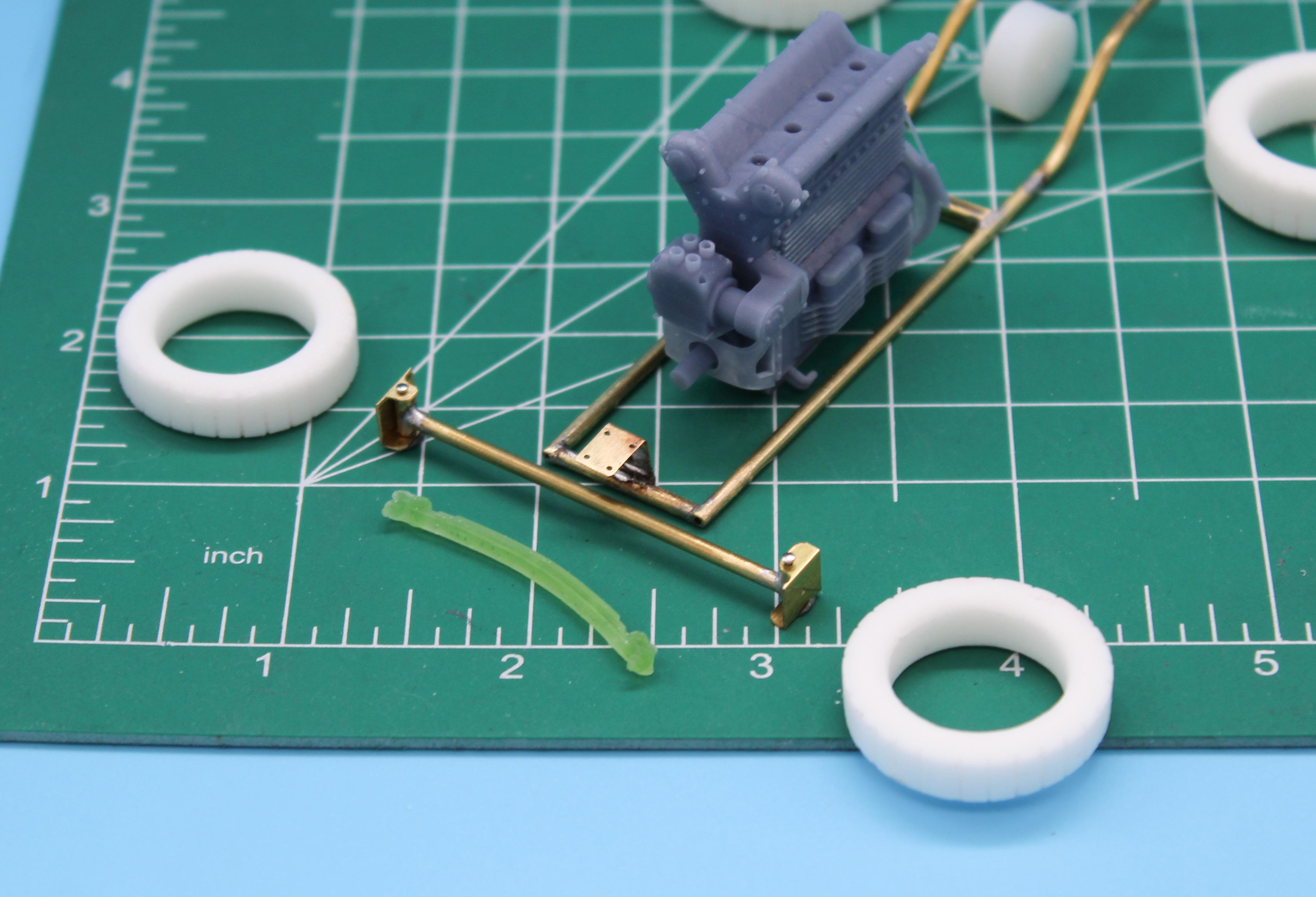

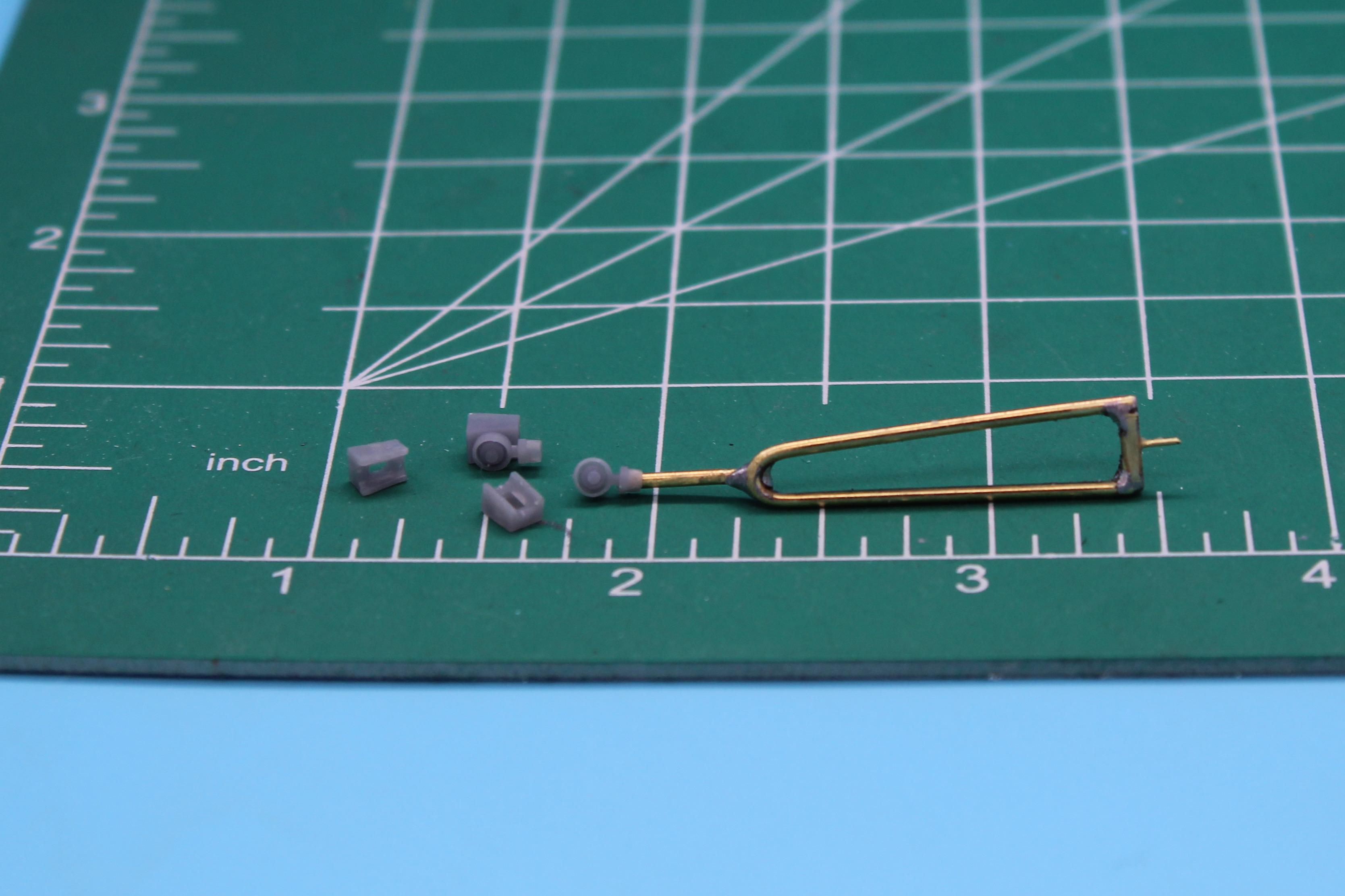

Pffttt, I’m a real hack compared to you…but thank you! A little more hackery today… Printed up a master cylinder, and made a linkage to the hand lever: Now, reference pics of the master cylinder placement and type for a 1952 Midget are hard to come by, and this almost certainly isn’t accurate…but I think it COULD work and was the easiest way for it TO work, so I’m relatively happy. Luckily, it’s almost completely hidden under the seat anyway, but I don’t want to have brake lines running to nowhere… With that completed, the only major component left to test fit was the rear nerf bar. I mocked up the kit piece and really couldn’t find much reason to completely remake it (for once - ha!) so I cleaned it up, drilled it for some pins to make final assembly easier and called it done: Actually, that part caused me to do some deep thinking…really this part SHOULDN’T mount to the body, and wouldn’t on the real car…but my goal with this build was to build the best version of Monogram’s first car kit and not to build a perfect Kurtis Kraft Midget. I said in my first post I wanted to keep the essence of this kit, and I really didn’t want to spoil the pretty simple lines of the body by hacking away at a bunch of it to allow for mounts and brackets and stuff that WOULD be on a real car, but that would detract somewhat from this recognizably being a Monogram Midget. This is a tribute to that early 50s car kit, and I’m allowing some intentional inaccuracies as compromises to achieve that. Same thing with the frame - it’s not a perfect replica of a real one, but it’s the right style and fits around the constraints of the kit parts. So, sticking to my original plan, we’re going to pretend that the nerf bar runs through the body to some hidden mounts on the frame that don’t interfere with the overall look of the car and still allow it’s clean lines. I can live with that 🤷♂️ And, with that, time to strip it all down and REALLY get to work…time to start paint prep - the brass parts need a bath in a solution to stop the solder flux eventually ruining the paint and I started with the frame this evening: Also started a little prep on the bodywork to get that in primer and see what all it will need…I’m basically at the stage now where I’m opening the box of this kit I’ve made, and now I need to see what prep and detail work the manufacturer (me) left for me! Thanks for looking - more soon, soon as I’ve done more!

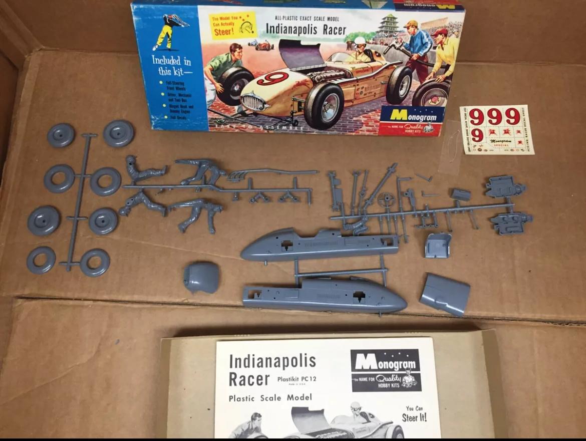

This info is REALLY helpful - thank you Mark! There are a decent amount of pics online of the slot version, but finding good reference pics of what the plastic kit version were like is tough…REALLY appreciate it!!
Do you have one of the plastic kits Mark? Would love to see a pic, if you do! And thanks for the info!

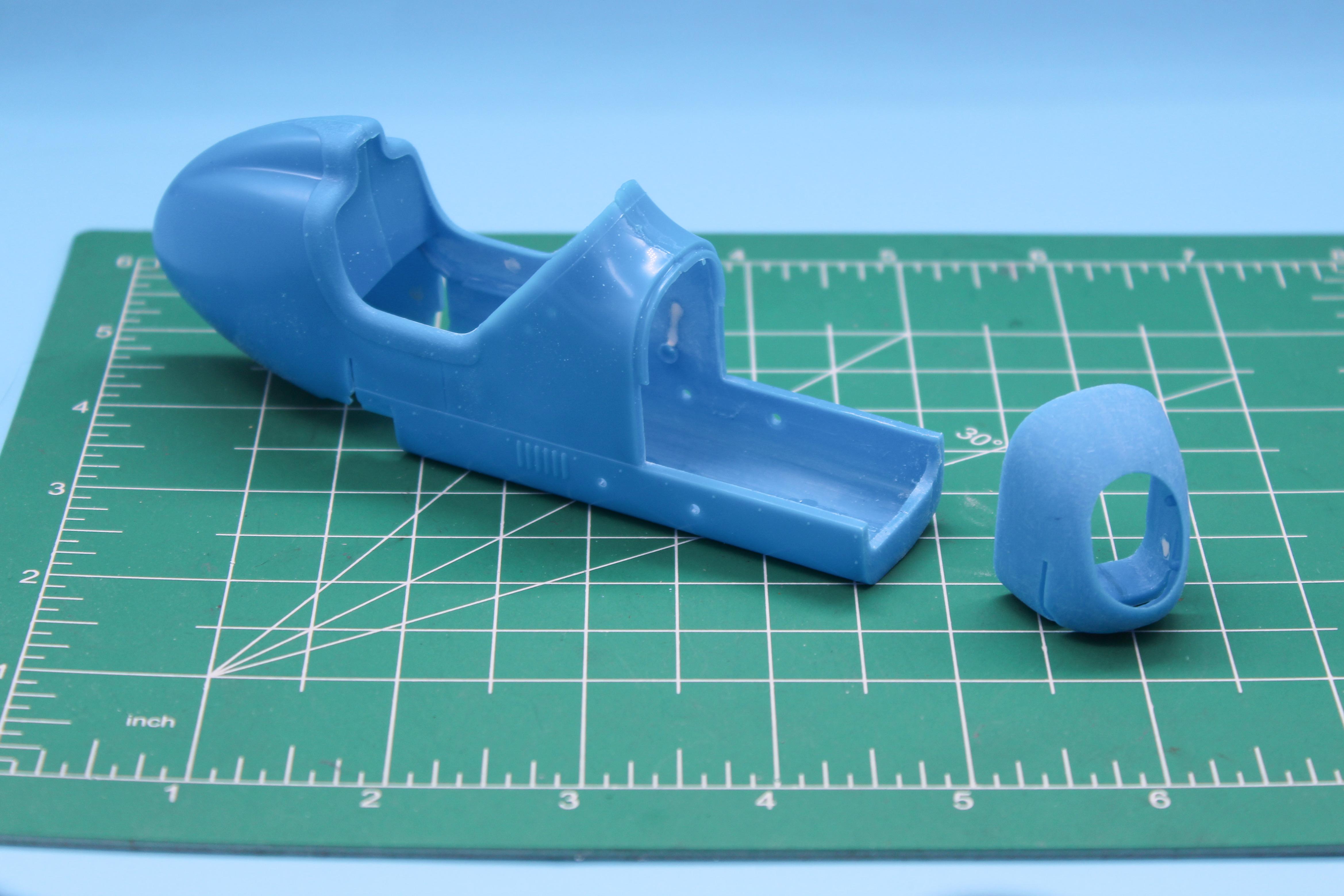

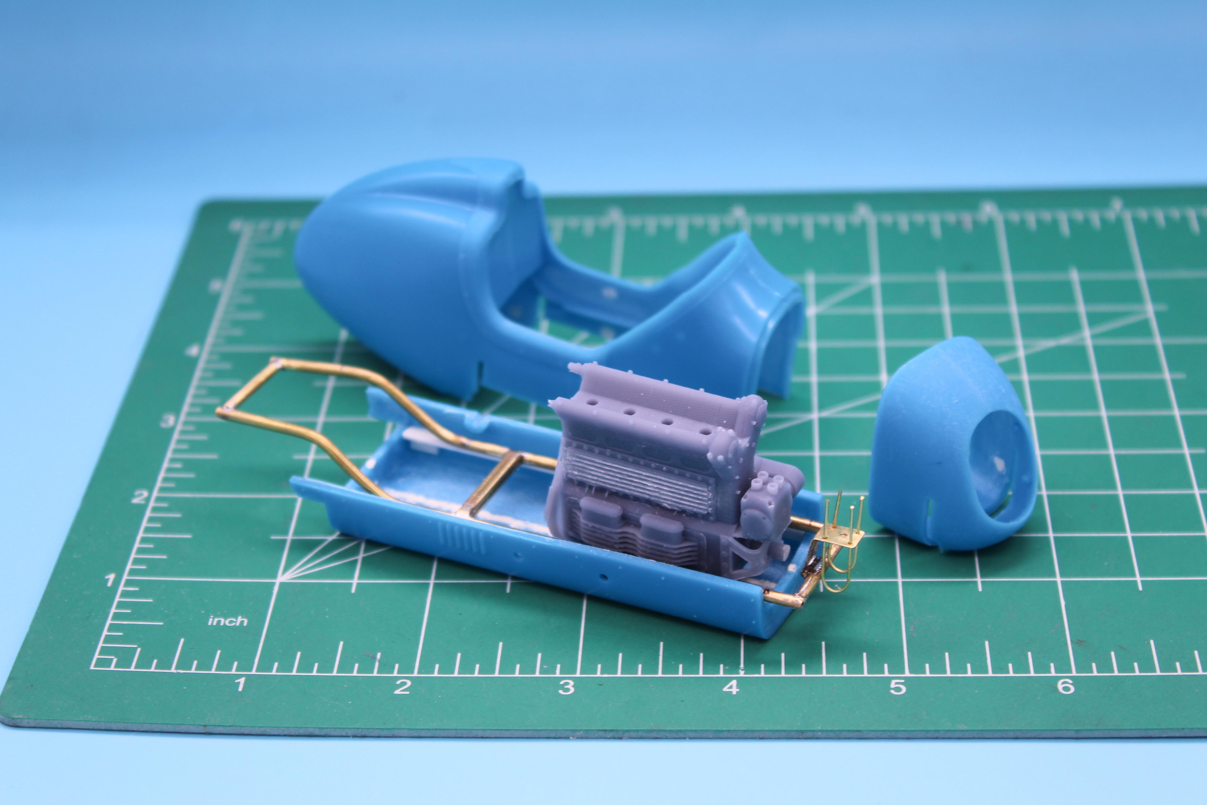

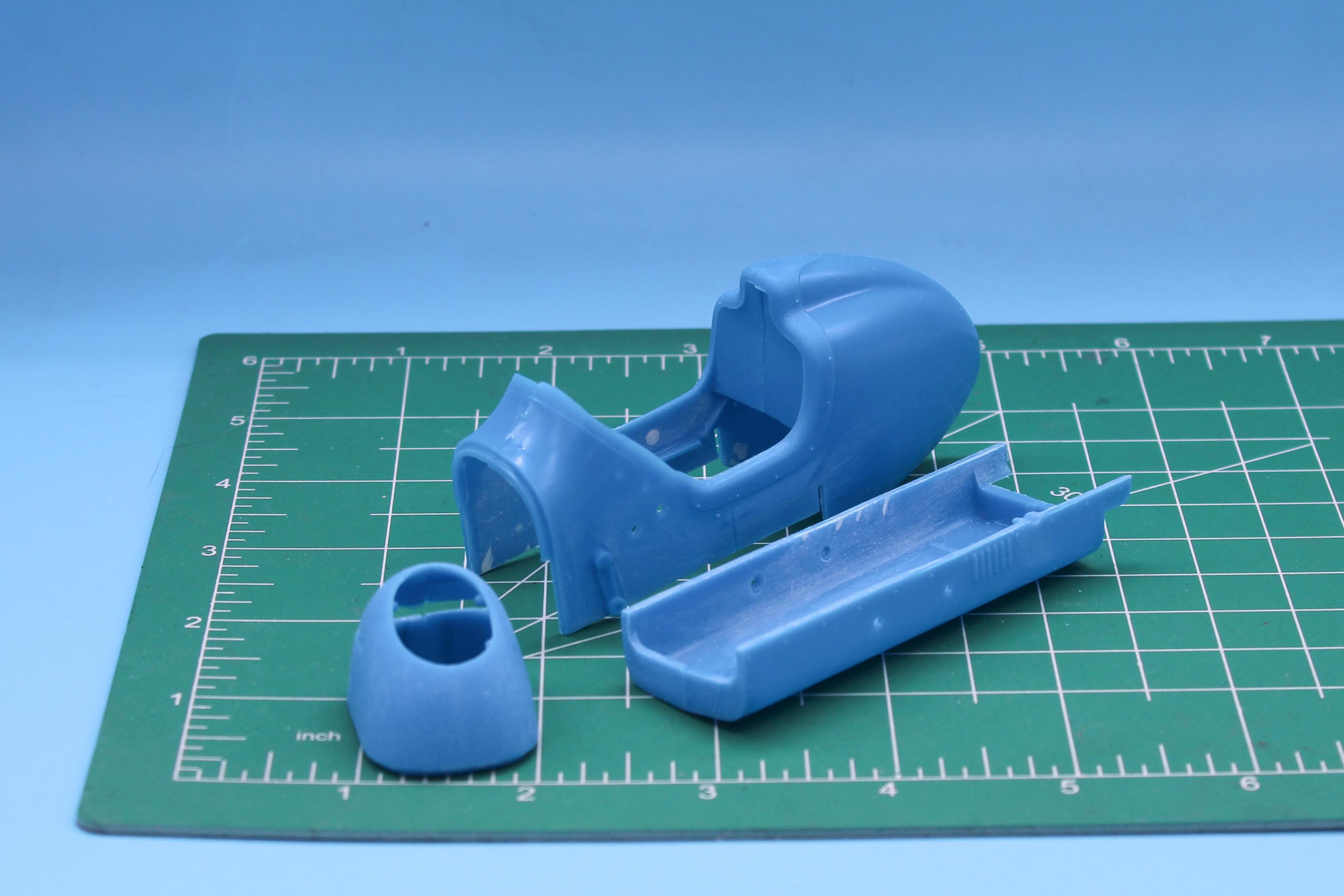

Been working through printing up this 3D file that is a (somewhat) replica of the 1:24 Revell Hot Shot Midget kit from the 60s: The file isn’t great - it’s taking a lot of work to get parts close to print-ready (and I had a ‘short shot’ on the print on one corner, hence the little pink repair piece) but I’m pretty pleased with them so far and excited to get the rest of the parts printed so I can start painting them both

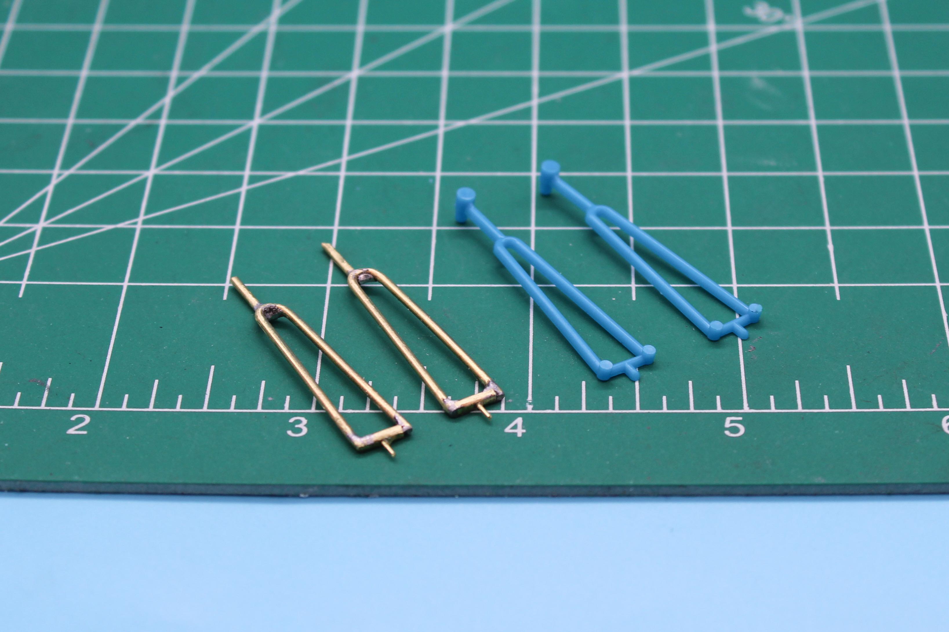

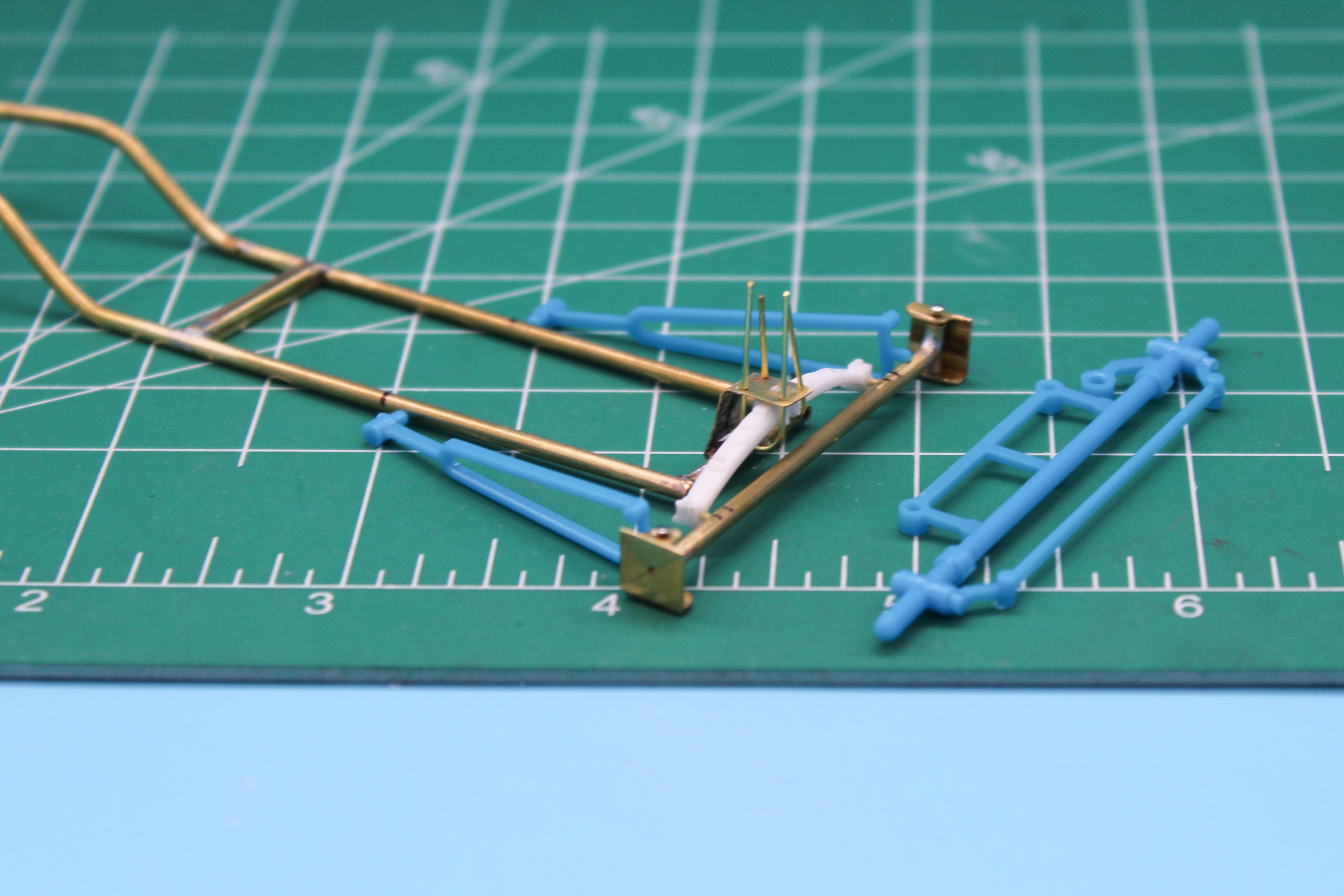

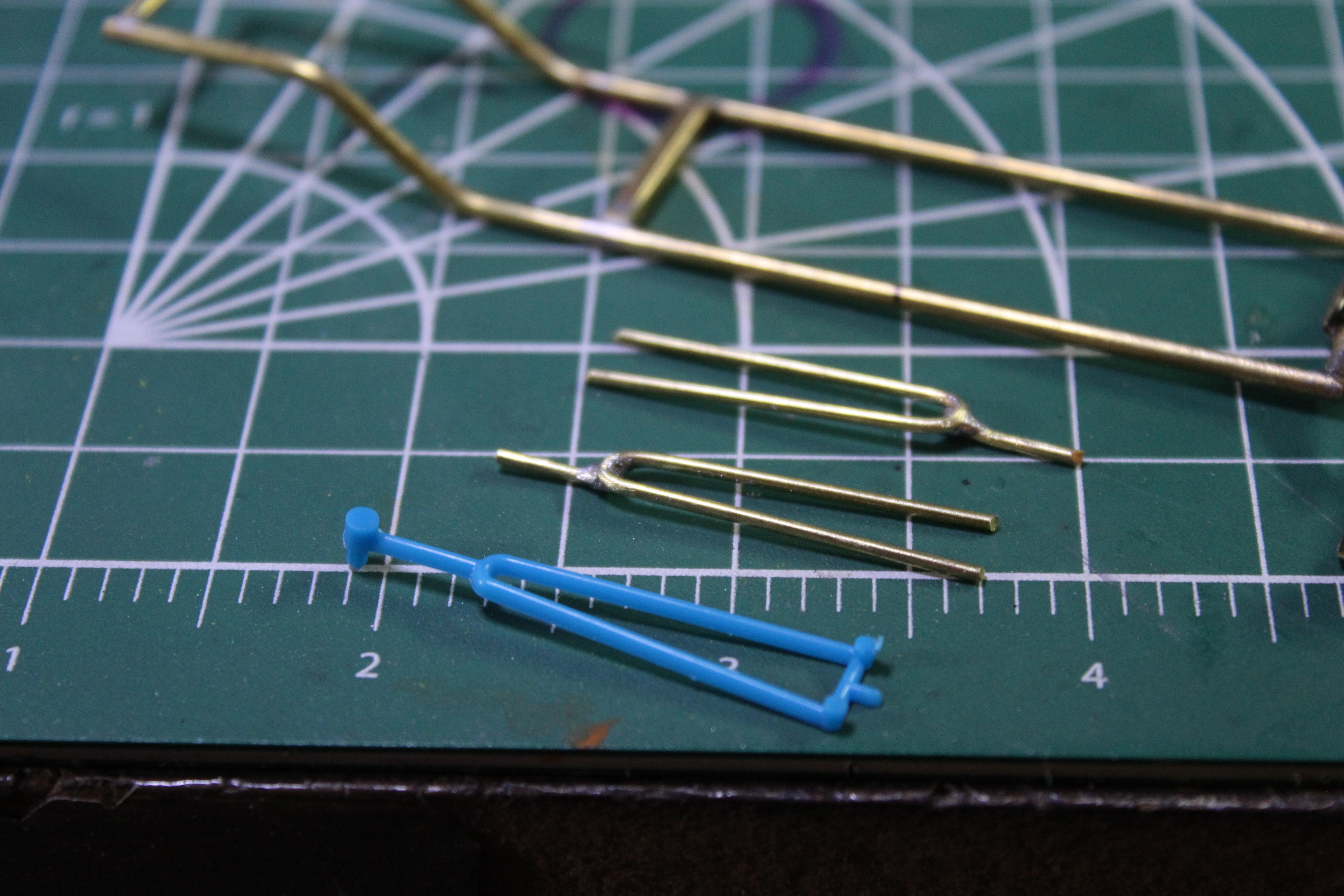

Next couple of bits of progress on my Midget build… I’m getting the last bits of construction done on the frame so I can get it cleaned up and prepped for paint, but I hadn’t figured out the little ‘luggage rack’ that holds the gas tank. Why this little rack is used rather than bolting the tank direct to the frame, I’m not sure…protect the tank from damage and vibration maybe? Regardless, here’s a 1:1 example, albeit on a pretty dirty and beaten up frame: I tried bending up a brass wire version but it was tough…tried a few techniques, and I got a couple where the shape was good, but getting a tiny solder joint and smoothing it out nicely on in-scale wire was beyond my current skills… So, I printed one…it’s REALLY delicate but it was the second best solution I could figure out: I think that 1:1 frame in my reference pic has been lengthened a little in the back compared to the plans I have - my tank overhangs the back of the frame more, but it fits inside the body A-OK and looks about right to me…couldn’t find good measurements for these tanks so I’m eyeball-engineering a lot of this to get as close as I can… In other news, I had already figured out the brakes once and resin cast some disks for all four corners, but when I was inspecting the original kit wheels the rears look like they have molded in drums…they could’ve easily made them look like disks if that’s what they were representing, but I think they’re drums. So, I pulled some pre-printed early-Ford drums (to match the early-Ford axle) and tweaked them to fit, and had my first chance at actually seeing this thing on all four of it’s wheels at the same time: Actually, I didn’t fully re-assemble the front end for this pic, so it’s raked low in front, but it was exciting to see this cute little frame kinda-together! Next job is brake master cylinder…need to figure out where IT should live and how it interfaces with the brake lever (remember, no brake pedal on this one)…and whilst I’ve been working on this I’ve been slowly printing parts for my (kinda) replica of the 60s 1:24 Revell Hot Shot…gonna build a couple of these at some point: Soon as I learn some figure painting skills anyway… Thanks for looking - more soon!

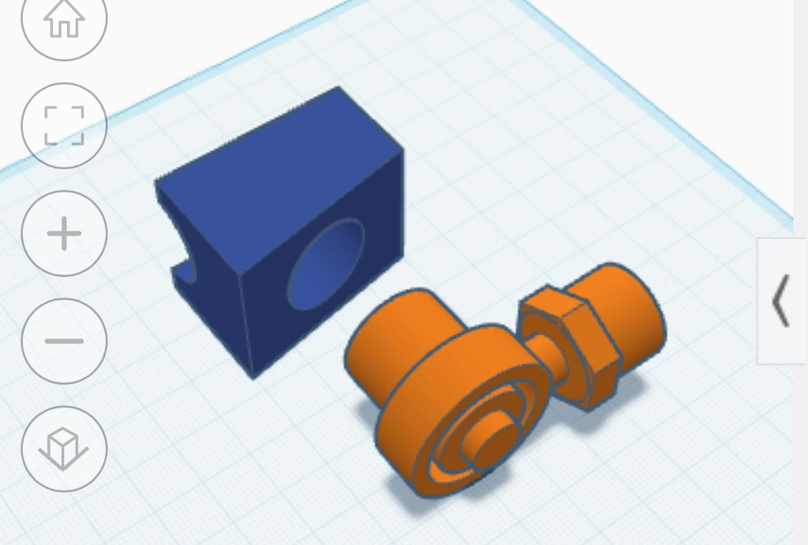

Thank you!! Did a serious spring clean of my shop today, so a little less progress than normal for a weekend, but a little anyway… Today’s project was the steering box - not super exciting, but I scratchbuilt one to replicate an Evans Denver setup, which was one of the hot tickets for this era of Midget, apparently. It’ll be completely hidden under the dash though when the body is in place so I didn’t go nuts with it…it’s basically there to hold the wheel in place - ha! The steering wheel itself though, IS very much visible, and the kit part is actually nicely done…so obviously I went looking for ways to improve upon it and ended up making my own. Main thing I would change if I had my way would be to make the rim and center separate for easier painting, so that’s just what I did… Rim: Center: Center snaps right into the rim: And looks like this in the car: Little side project I’m working on also, that is mostly relevant to this thread, is a printed copy of the Revell Hot Shot, which was a 60s 1/24 Midget kit that was released as a somewhat successor to this one. Actually, it was a slotcar, then a really simple curbside-type static kit, and actually is probably even simpler than this earlier kit that I’m building…figured it would be nice to have one of those on the shelf too, even if the print file I found is going to need some work to make a decent replica of the styrene kit it’s modeled on. Just a fun simple project to mess with while I’m working on this more involved build: Thanks for looking - more soon, soon as I’ve done more!
