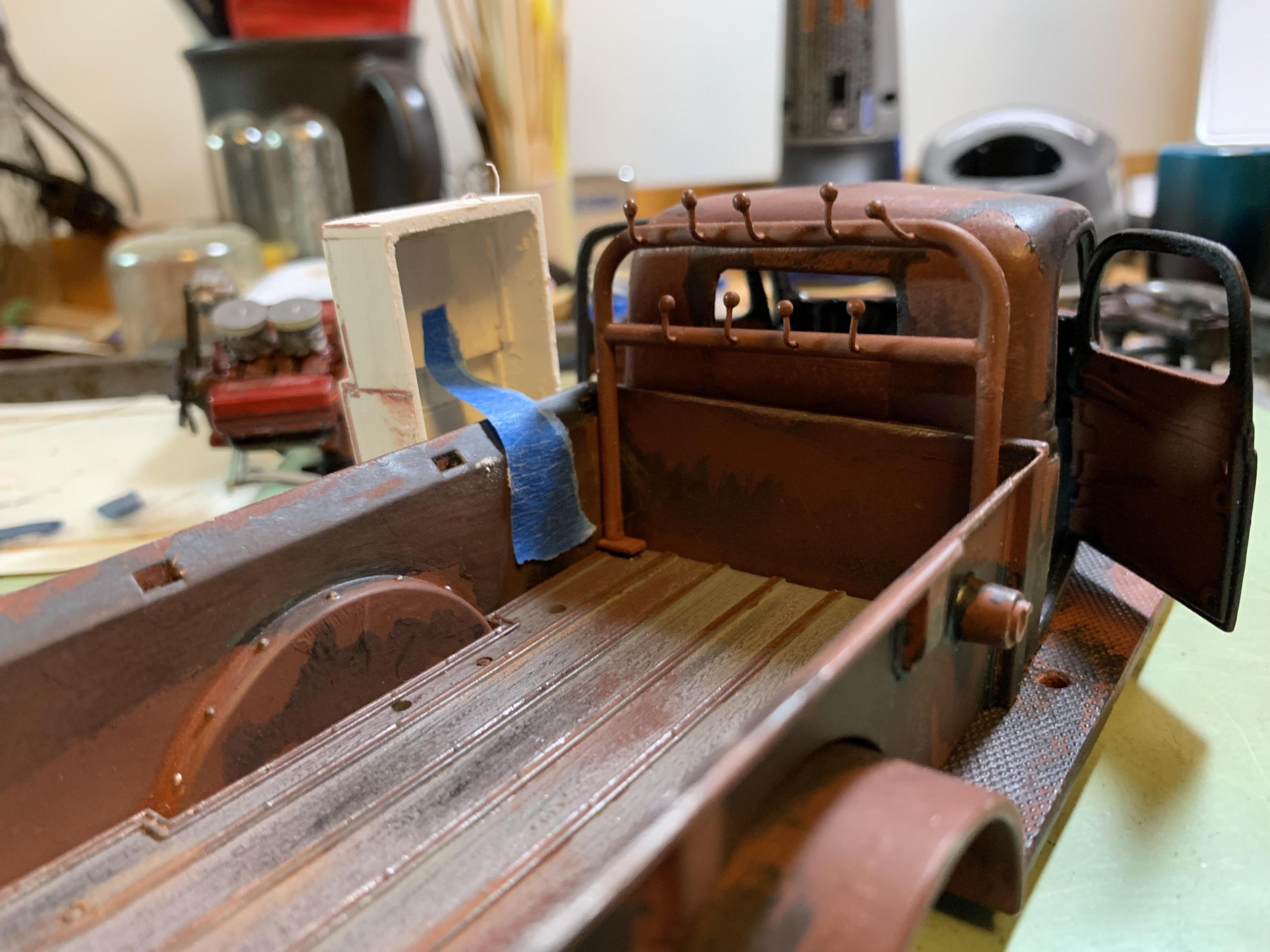

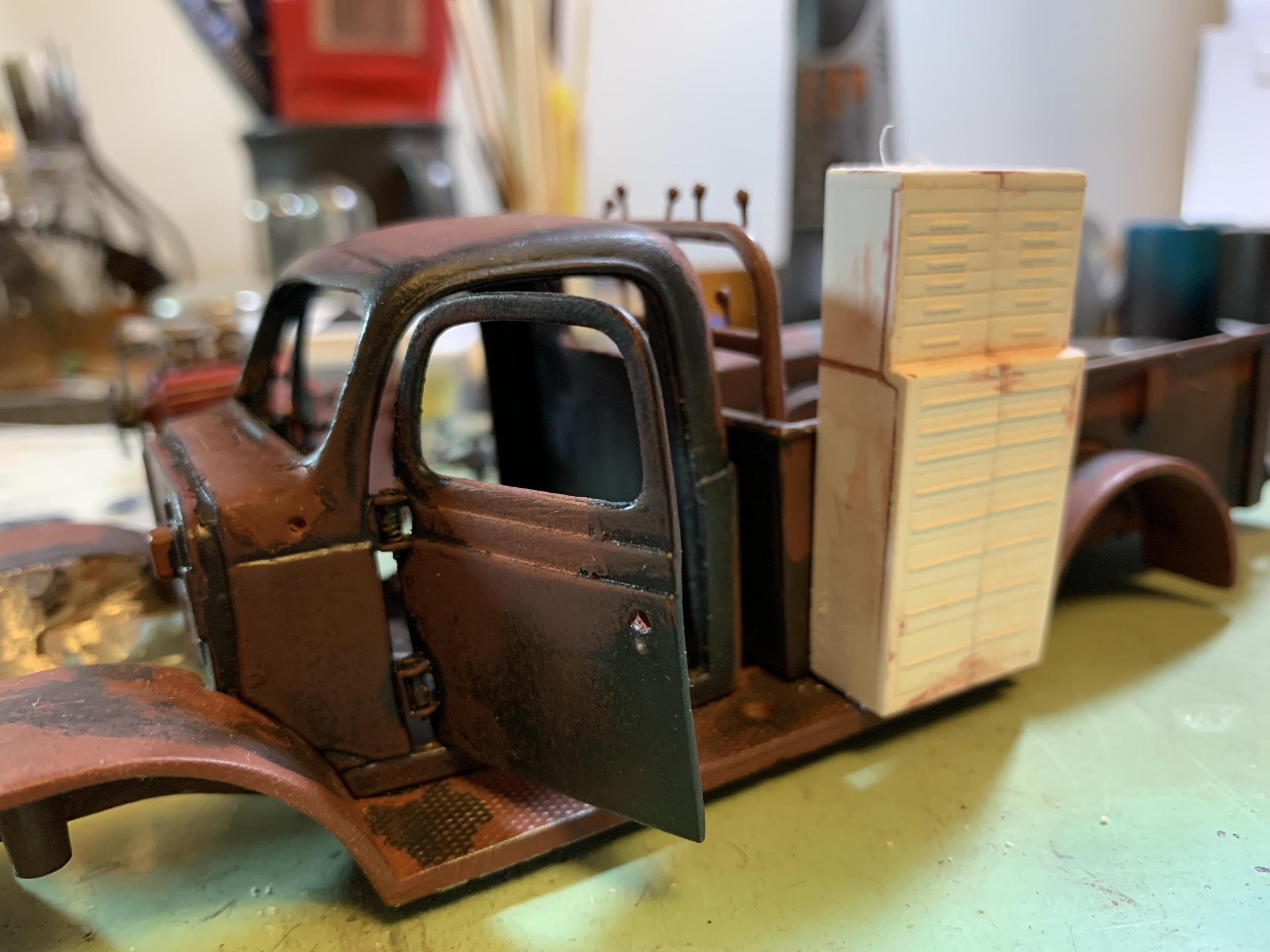

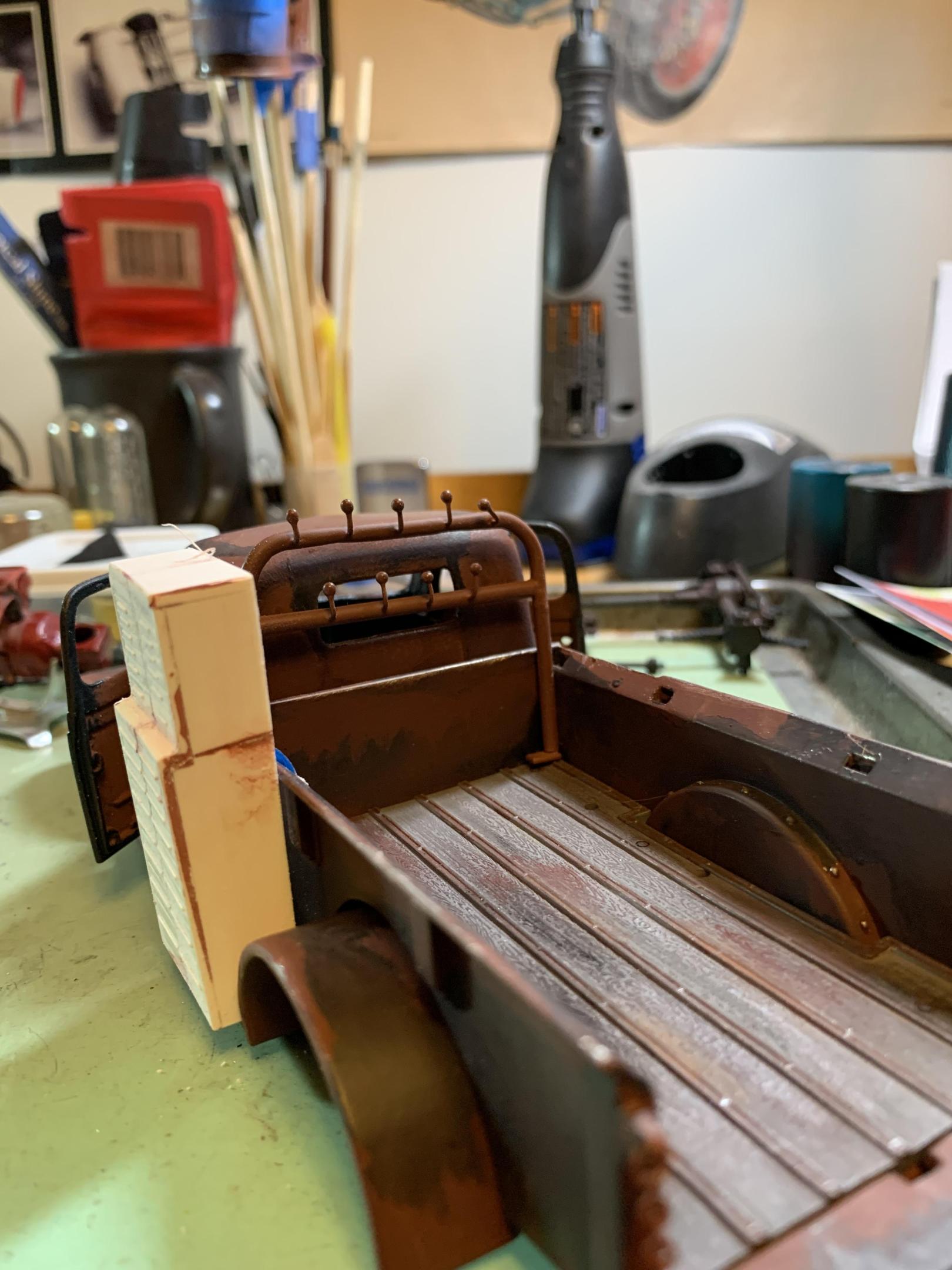

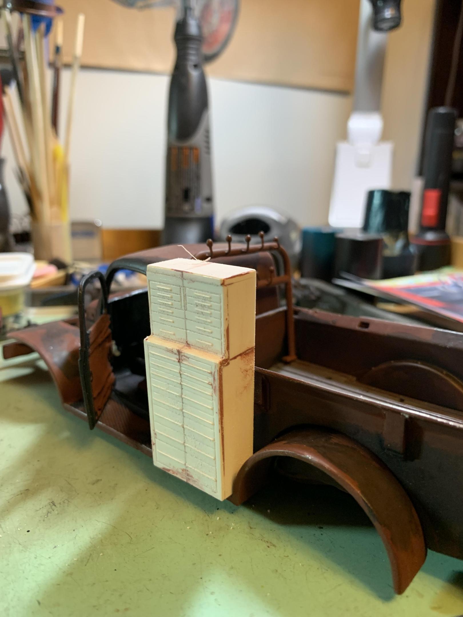

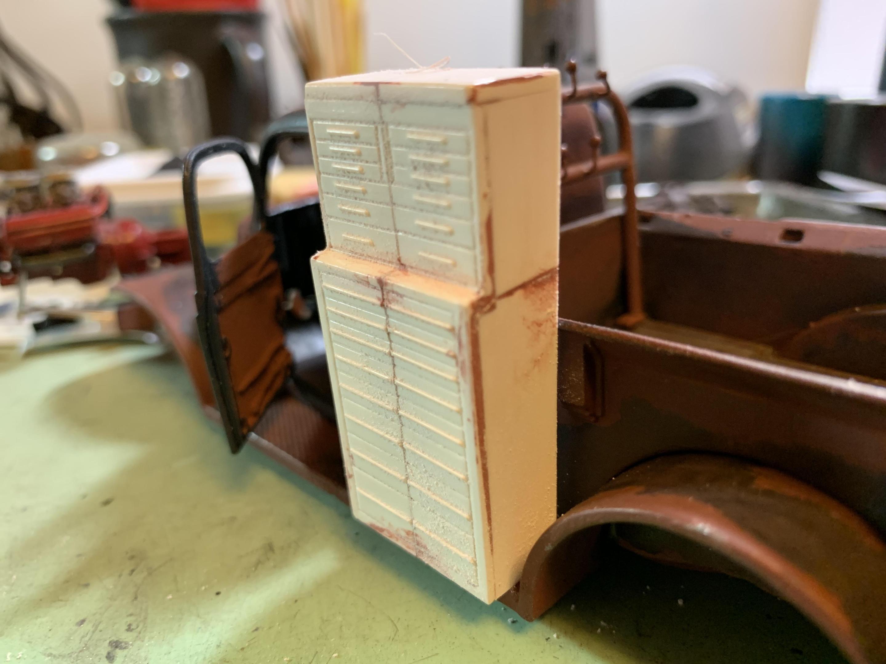

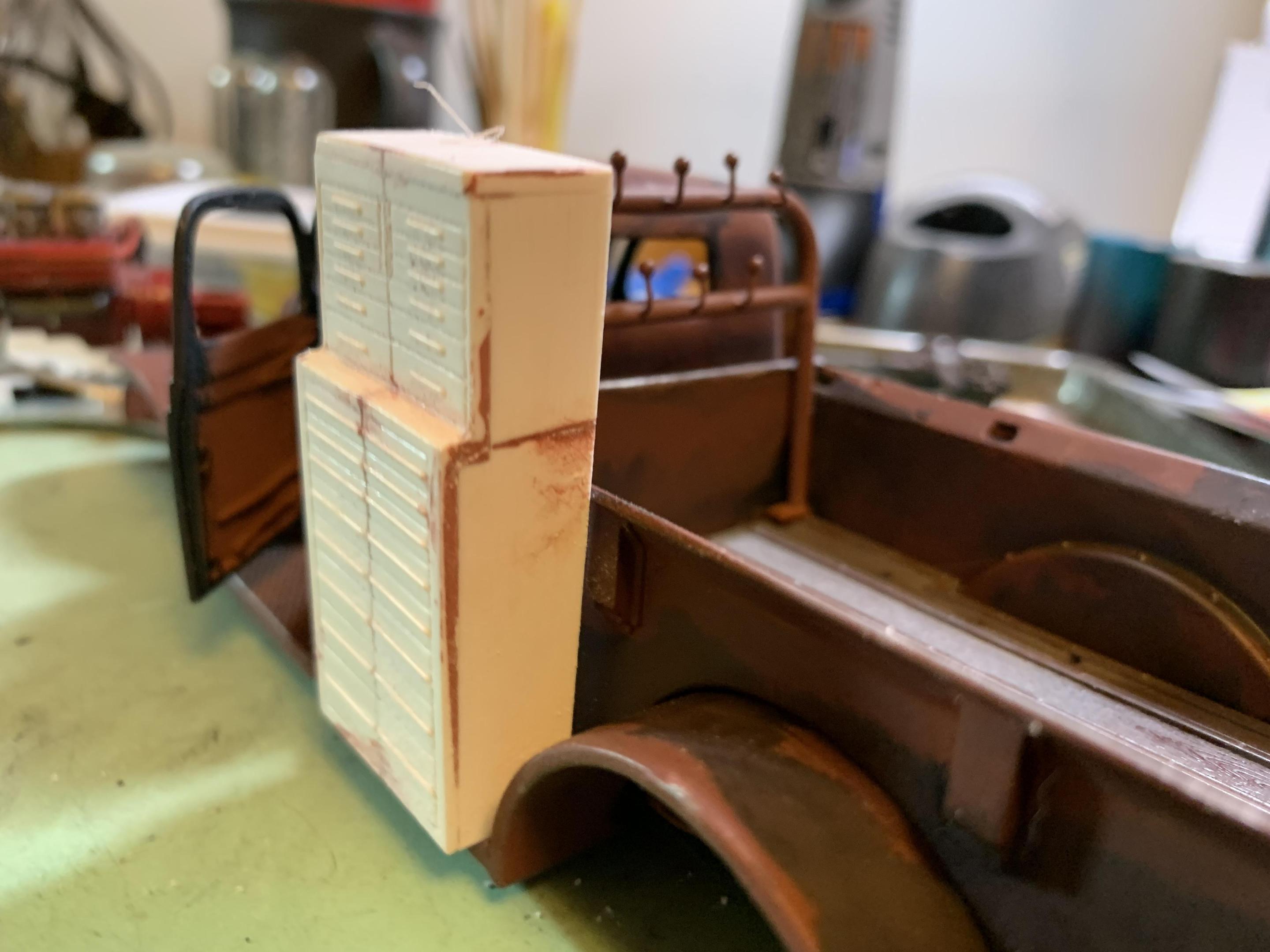

Got a lot done on the Power Wagon- rehung the doors (still don't quite close, but better), added the mirrors which actually can swivel on their brackets, detailed and installed the dash, and scratch built a transfer case cover and operating levers to replace the klunky original. Also bent up new exhaust pipes to fit the hemi exhaust manifolds. They clear all the drivetrain and take off cases and shafts. They will connect to the vertical stacks. Weathered the tool box for the running board. Next big mini project will be hinging the hood sides- first idea using tape didn't work, needs more thought. -

More progress- some of it pretty major- cut the hood sides from the rest of the hood using a jewelers saw I haven't used in years- my razor saw was too dull to cut this diecasting metal- especially tough in the hood, and when I removed the original paint a very different color from the rest of the parts- those were silvery while the hood pieces were almost a golden color and very shiny- and hard as steel! I had cut the wheels and tires off to weather them- decided it was time to reattach them- made short pins from sprue with a concave end going into the (brake drum?)- the hidden brake drum face was bored out with a conical depression and everything superglued together- we shall see if it stands up to the weight of all that metal! The hood sides will be attached to the hood top with two layers of transparent packing tape acting as a hinge, not quite reaching the front and back. This will leave small areas where I can glue over strips of styrene for reinforcing. We shall see! -

It's going to be a very weathered but very hard working truck. Named Babe after Paul Bunyan's blue ox. Made a headache rack from a roll bar. Cut down a tool box from the Nascar kits to fit on the running board. Dual vertical exhaust stacks through the running boards behind the cab. Cranked out windshield. And the hemi. Lots of chains, shackles, and tow hooks. And a trailer hitch. More pix when I get more done. BTW, looking through the post it looks like something got out of order. -

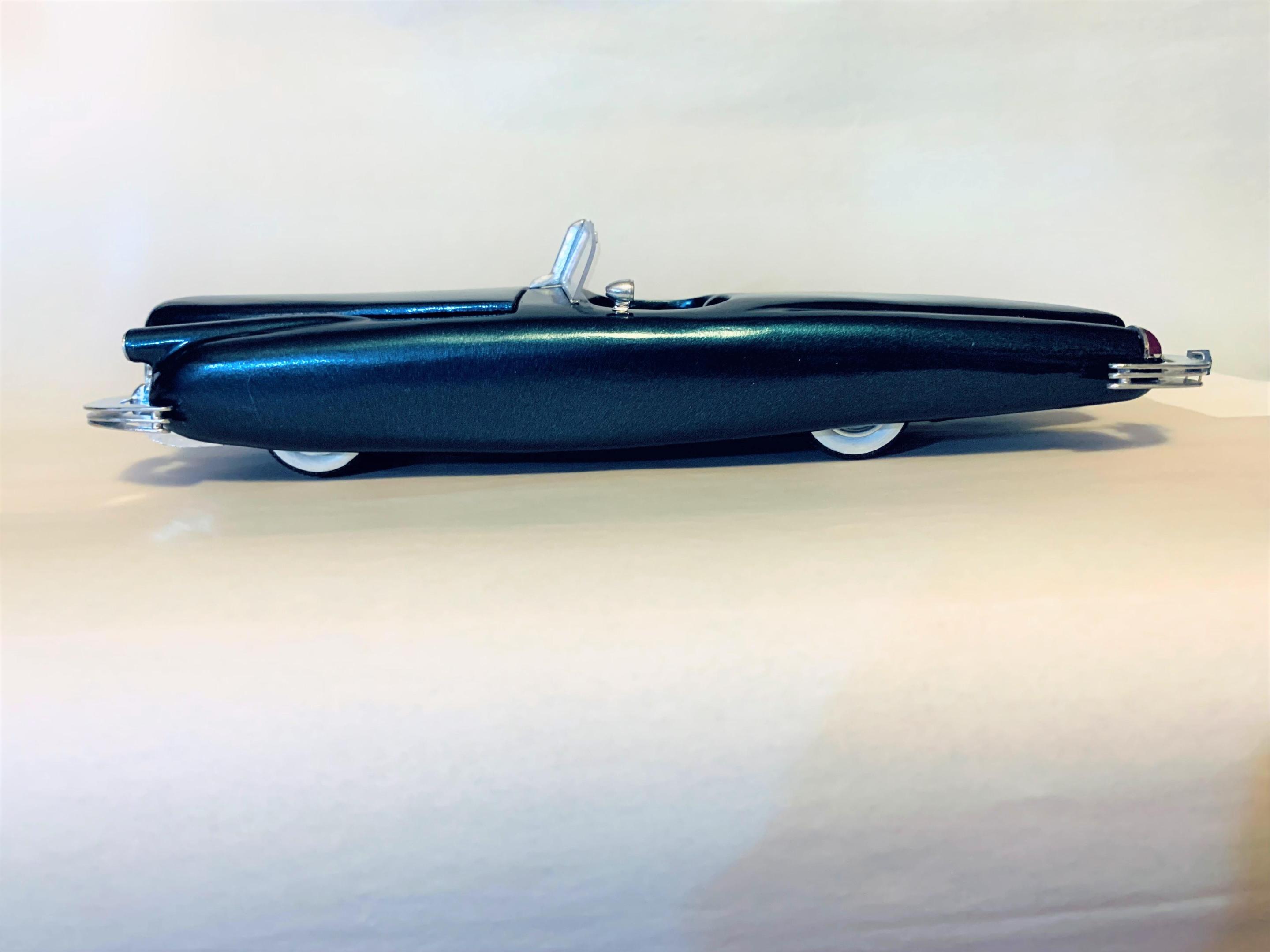

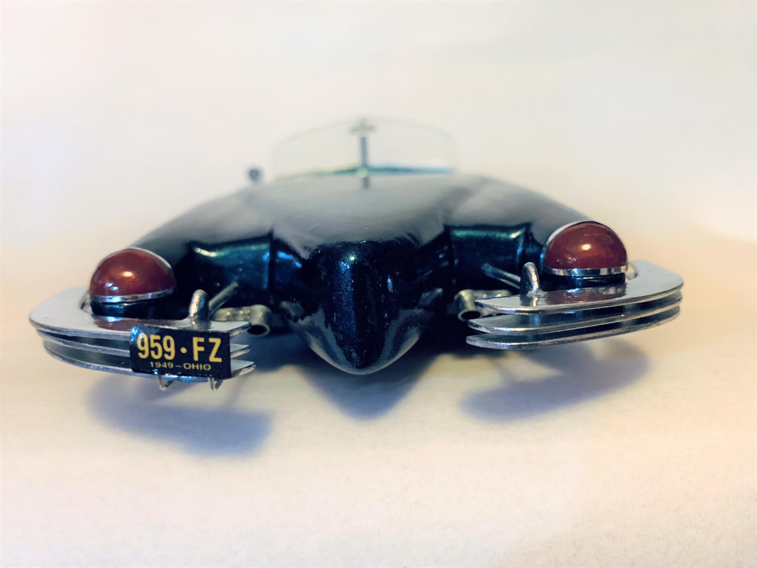

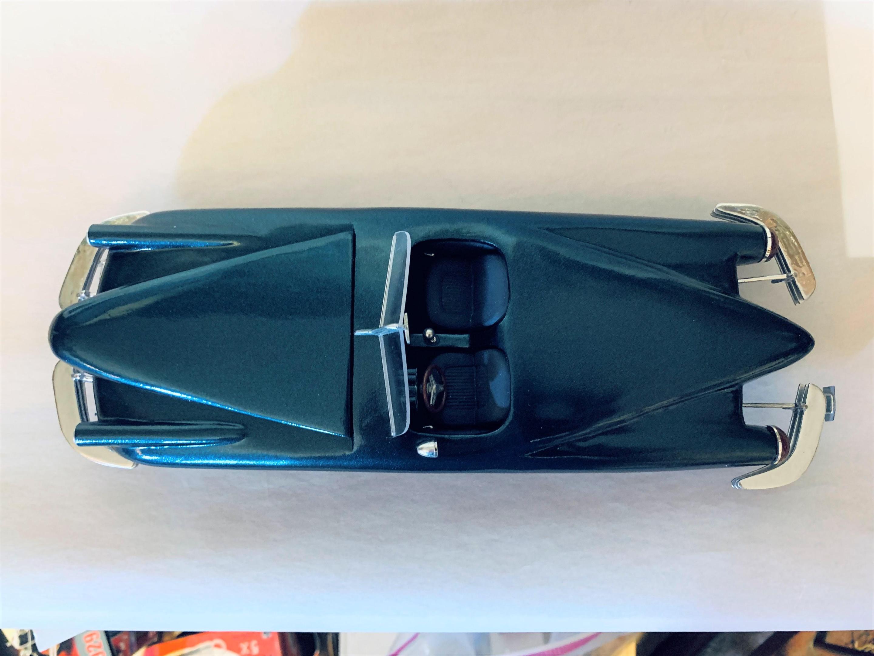

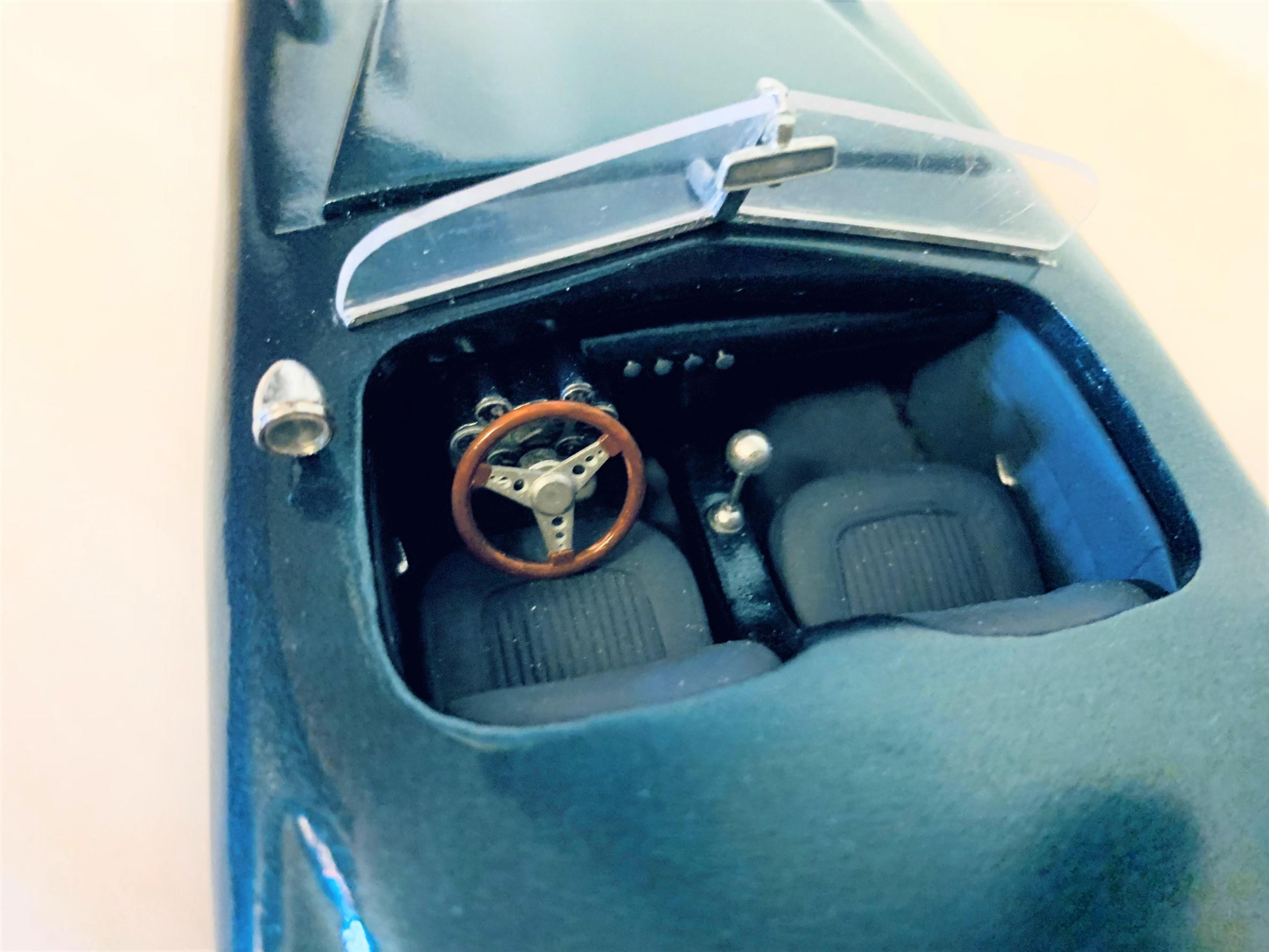

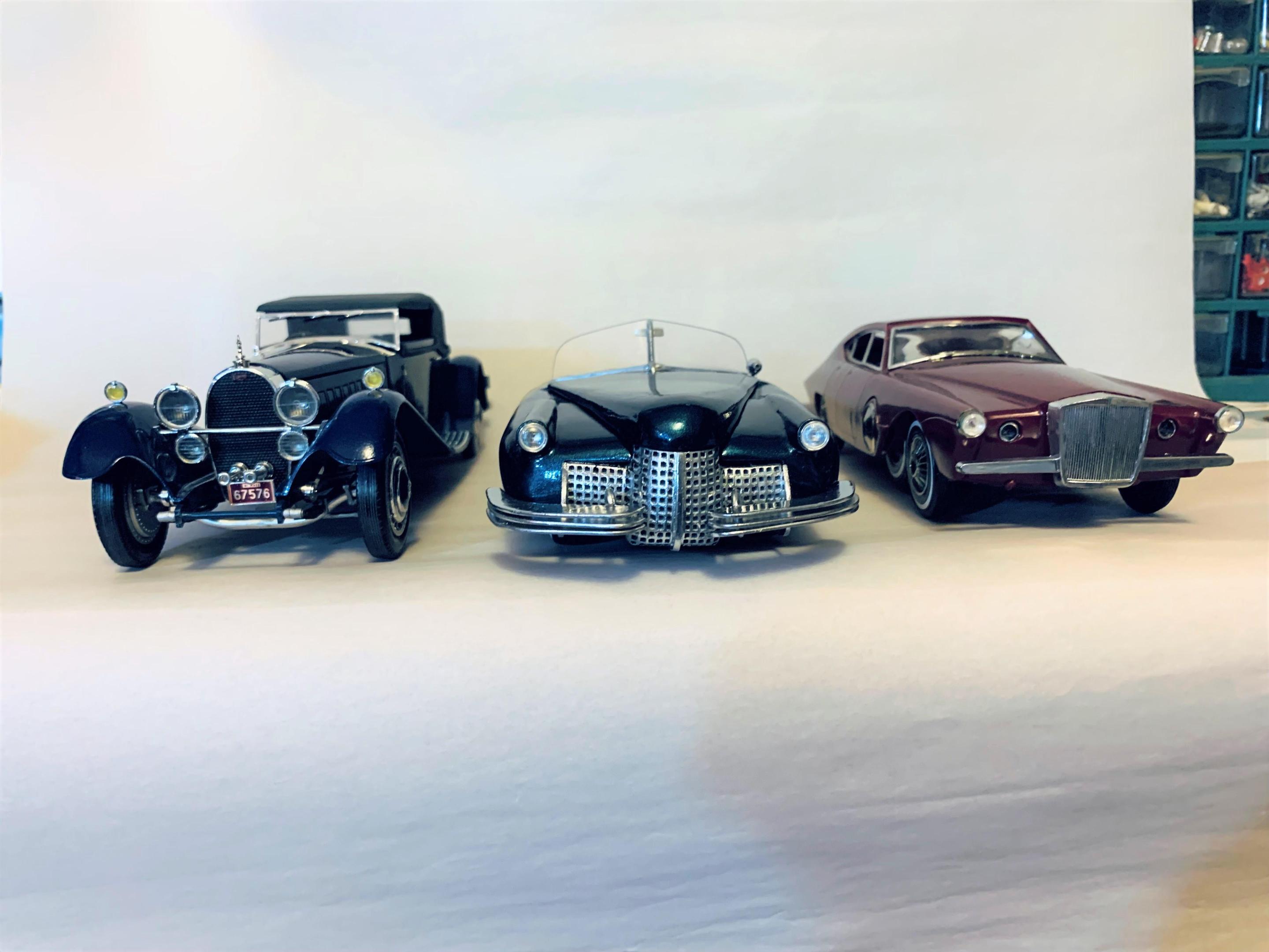

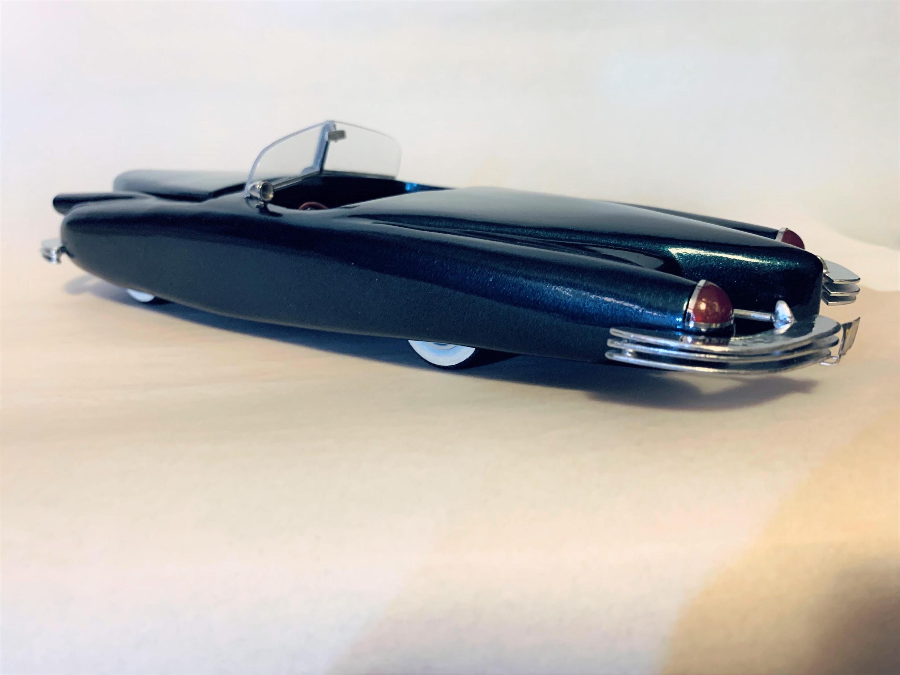

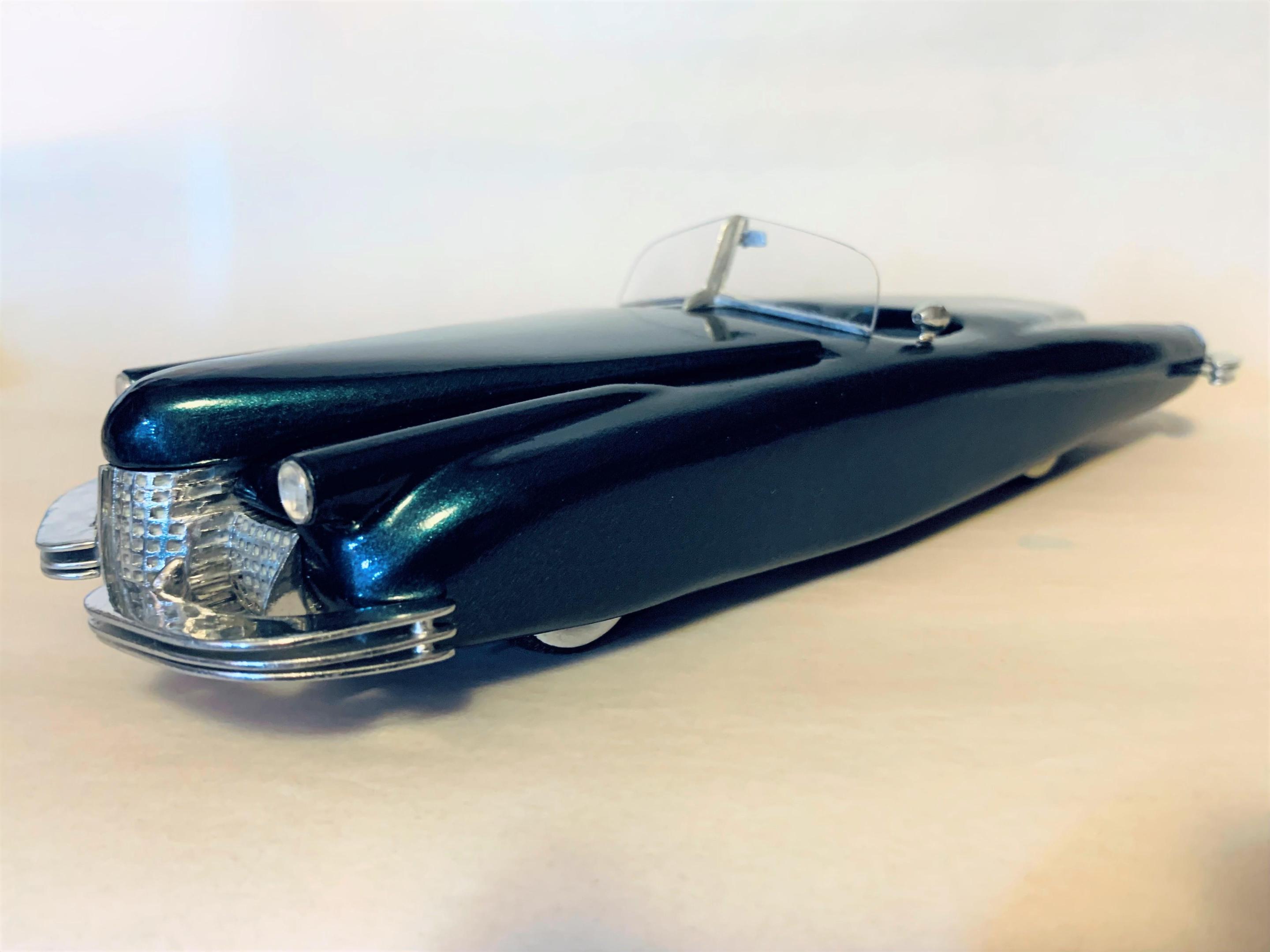

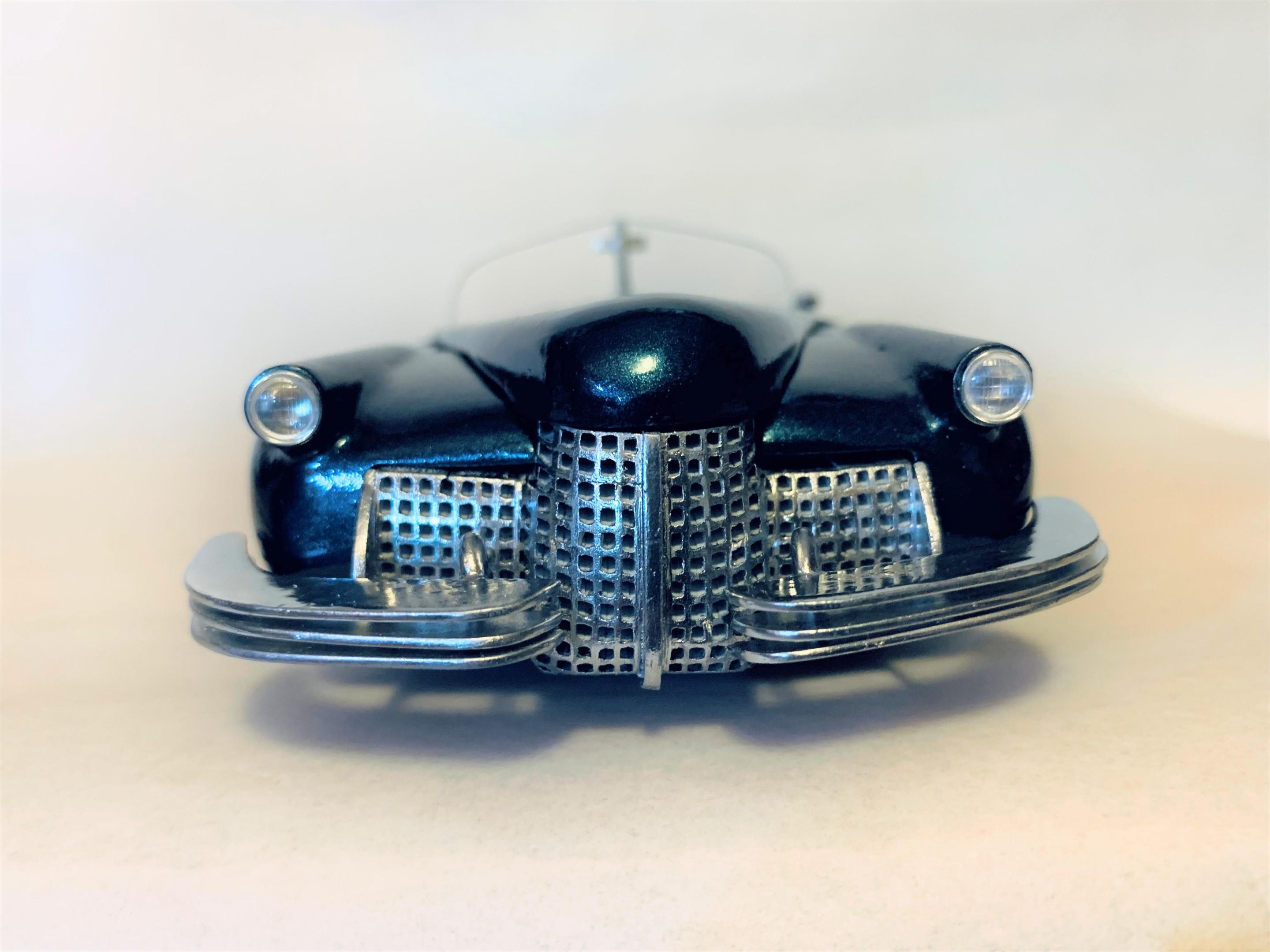

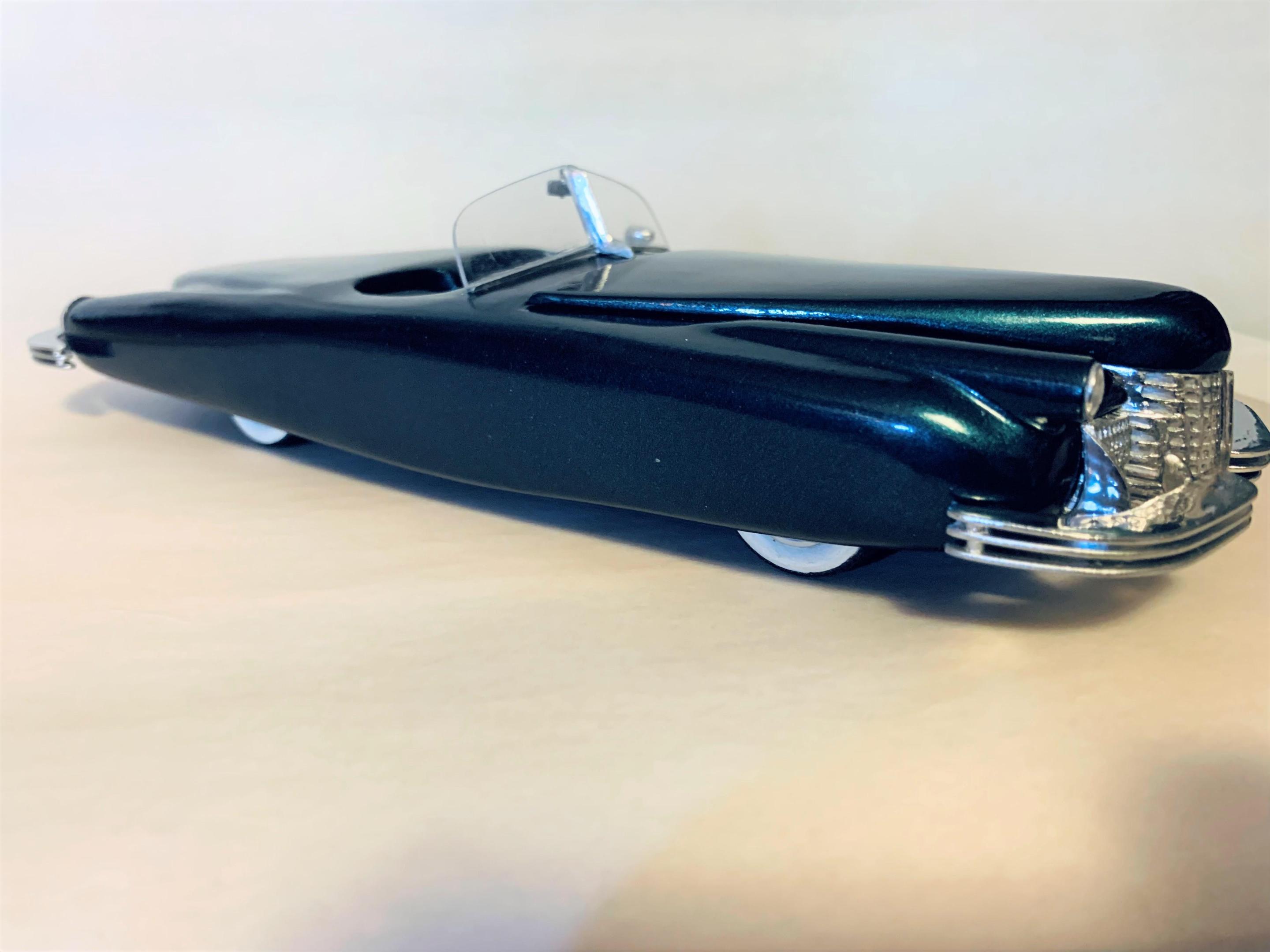

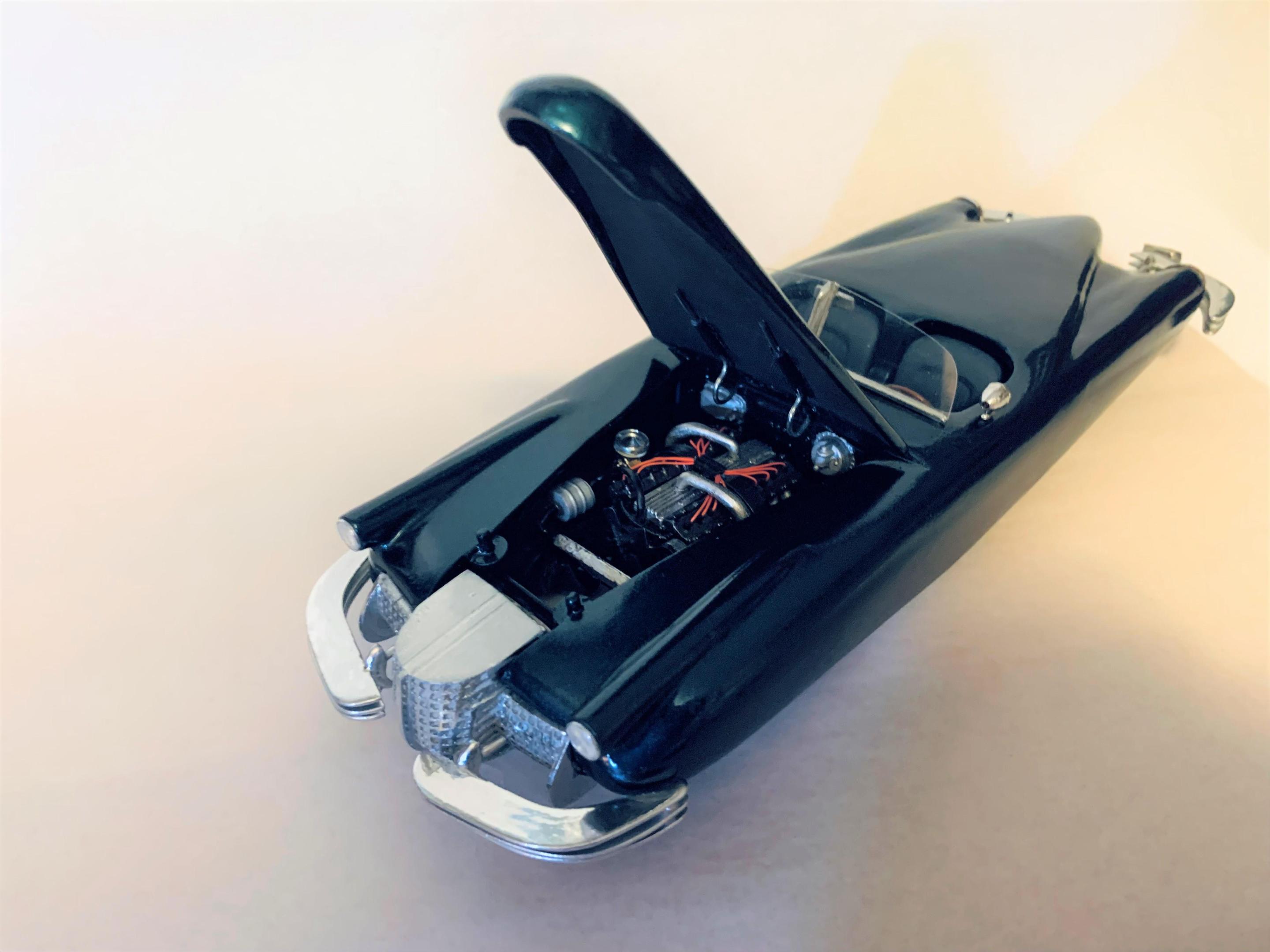

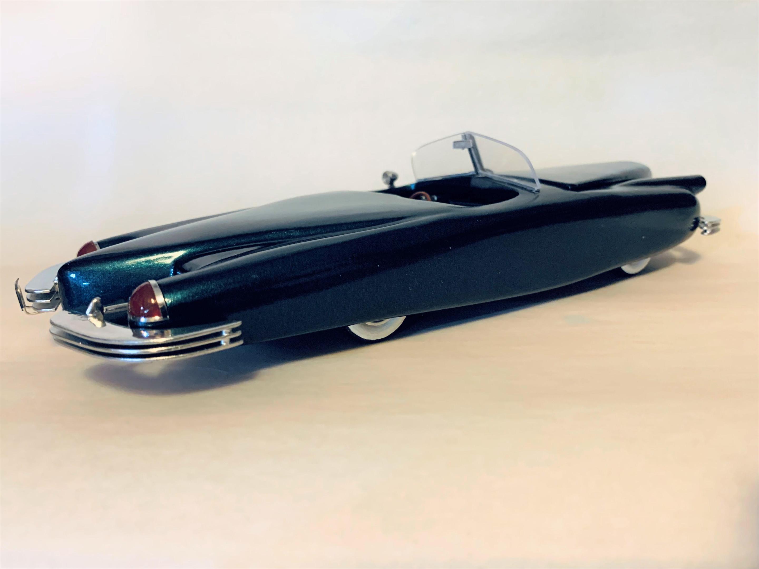

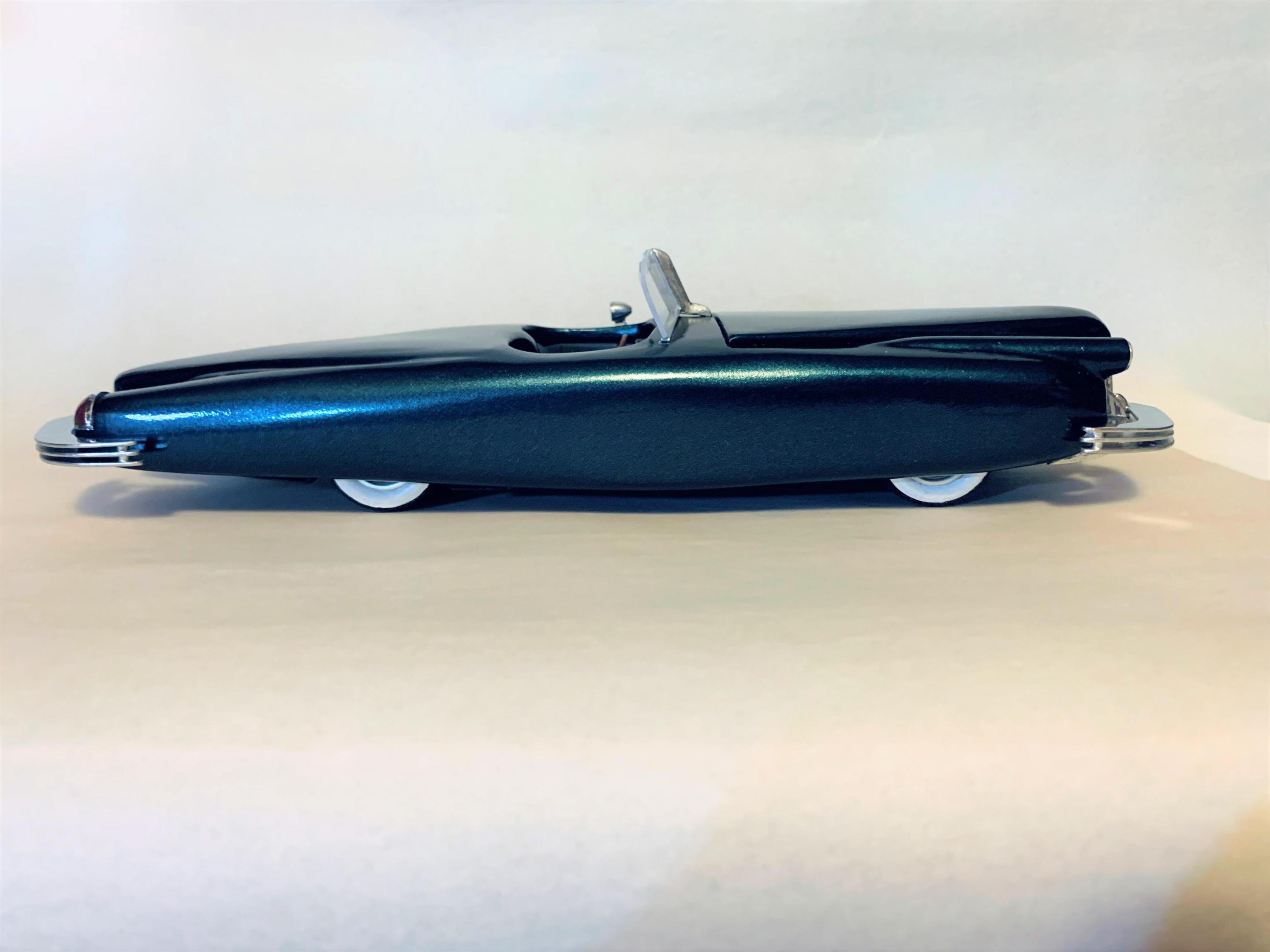

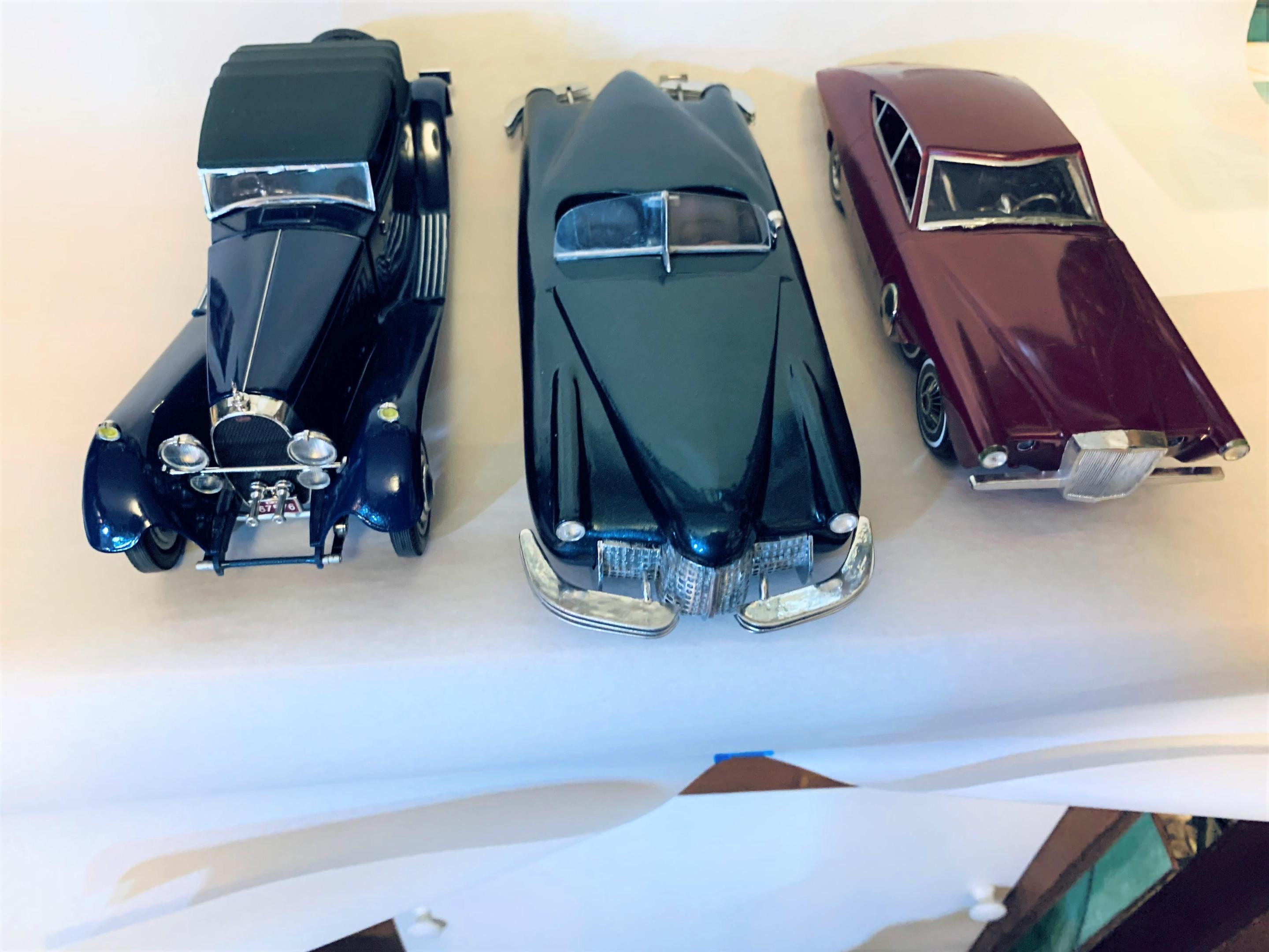

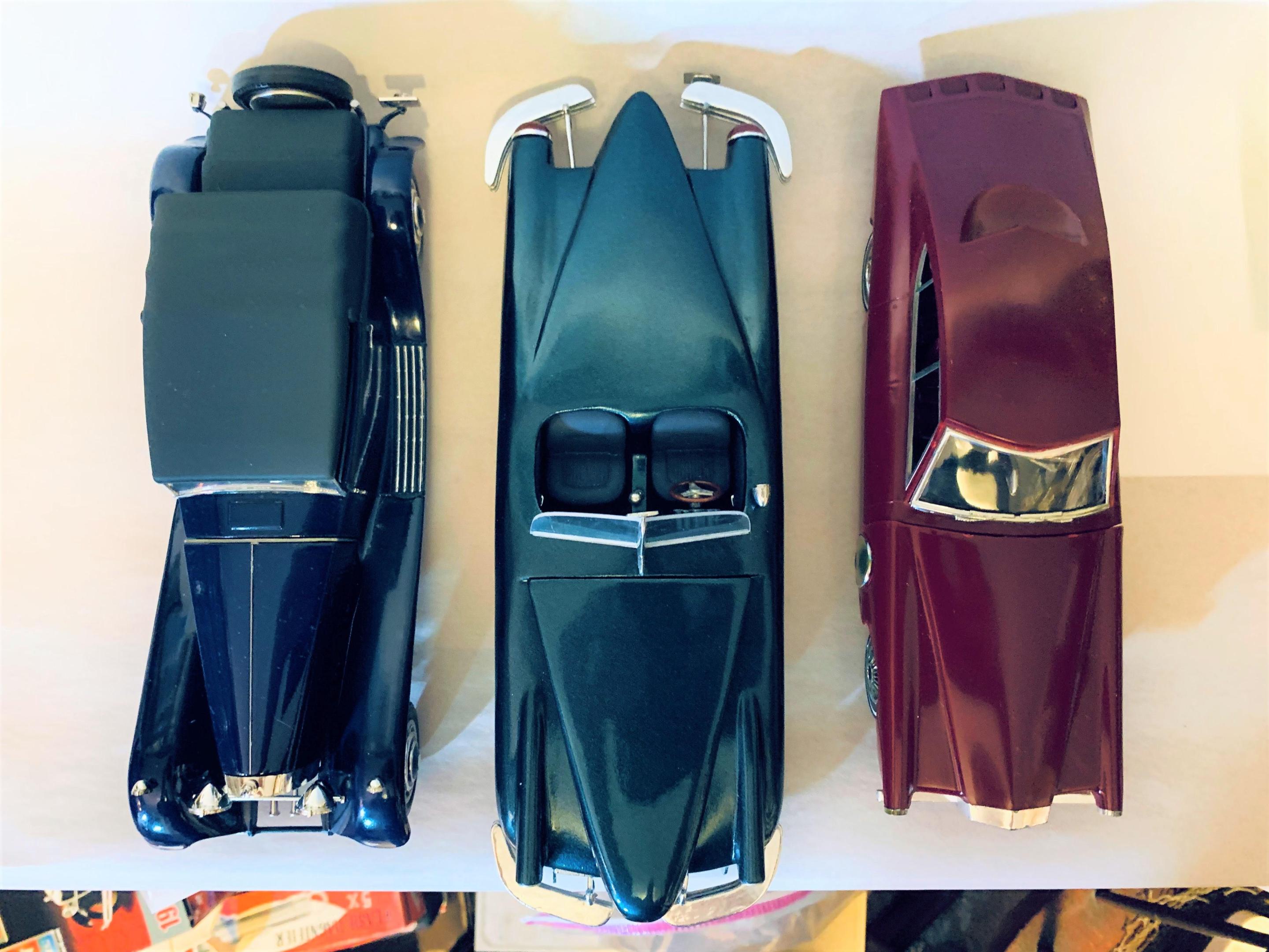

New for 1949! Introducing the Hurricane Typhoon! Two passenger luxury roadster! Boat tail styling inspired by the classics! Blade bumpers inspired by the Phantom Corsair! 800 cubic inch V-16 with dual overhead cams, and two centrifugal superchargers! 2000 horsepower! Six speed manual transmission with overdrive and two speed rear axle! 200 miles per hour! Nothing else like it on Planet Earth! Sorry, I couldn't resist- after all it was made from junk! Now for some pix. I decided that a couple of comparison shots with the Bugatti Royale and 1966 Pierce Arrow would give a good idea of just how large this 1/25th scale model is.
