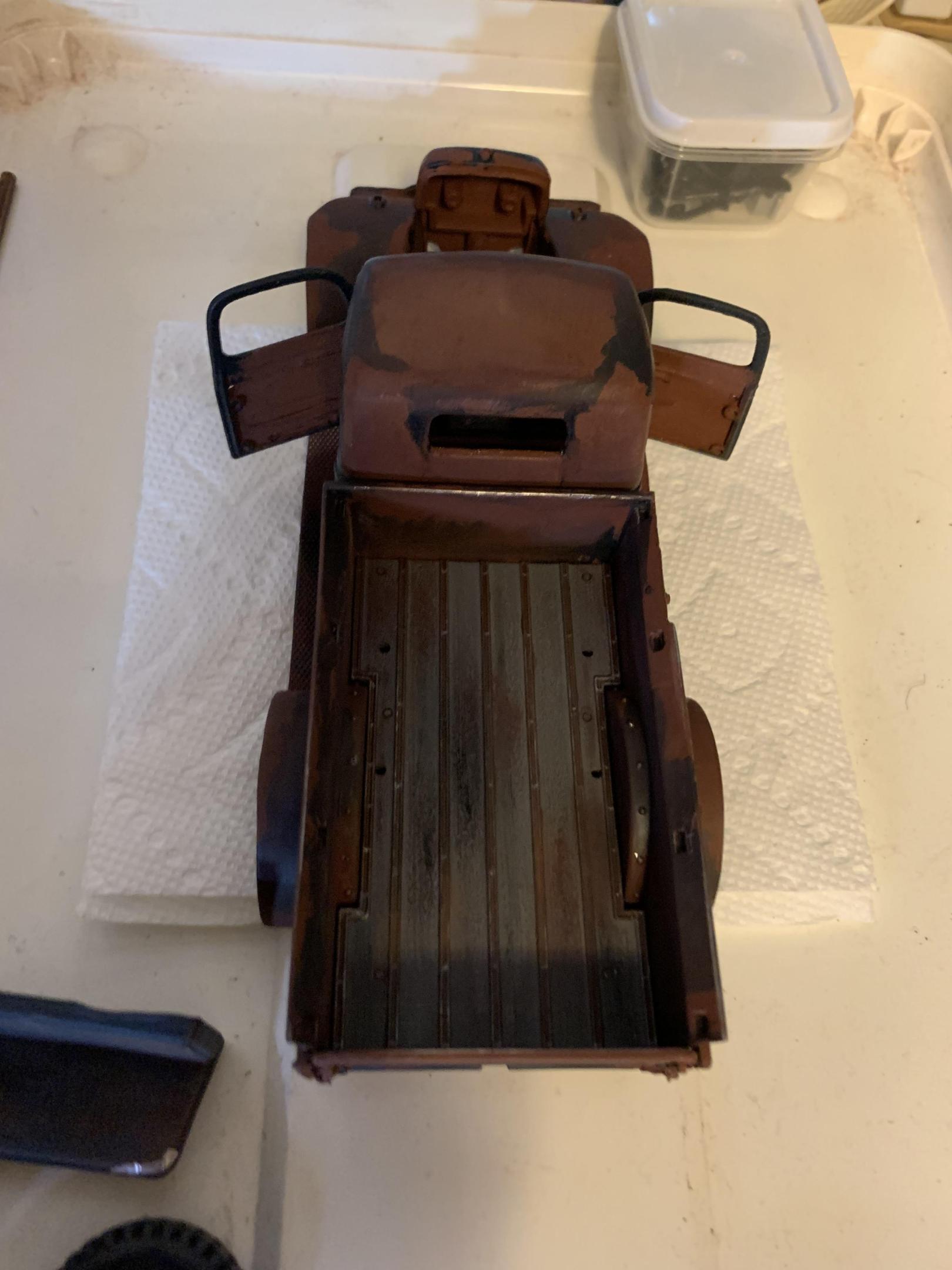

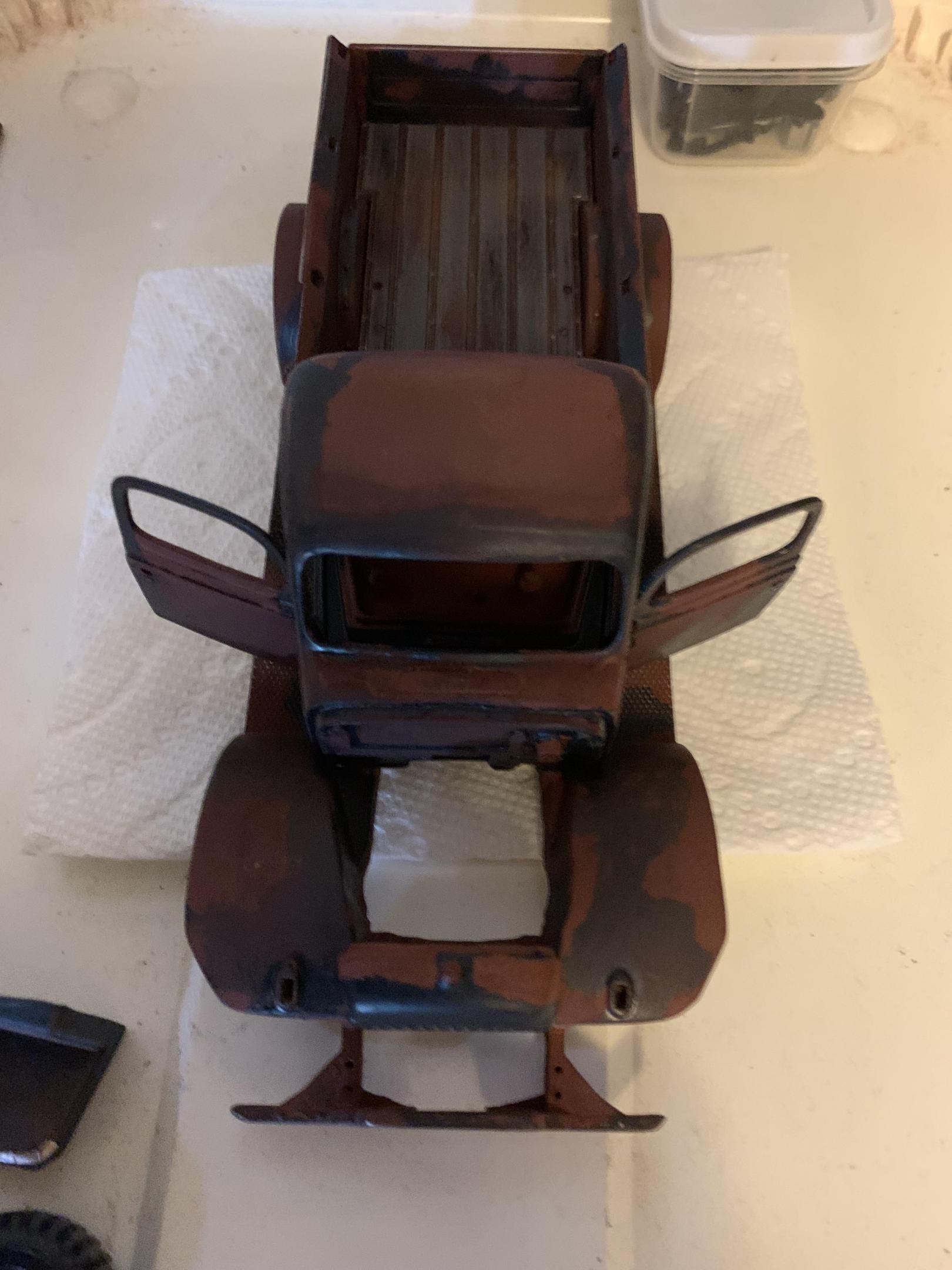

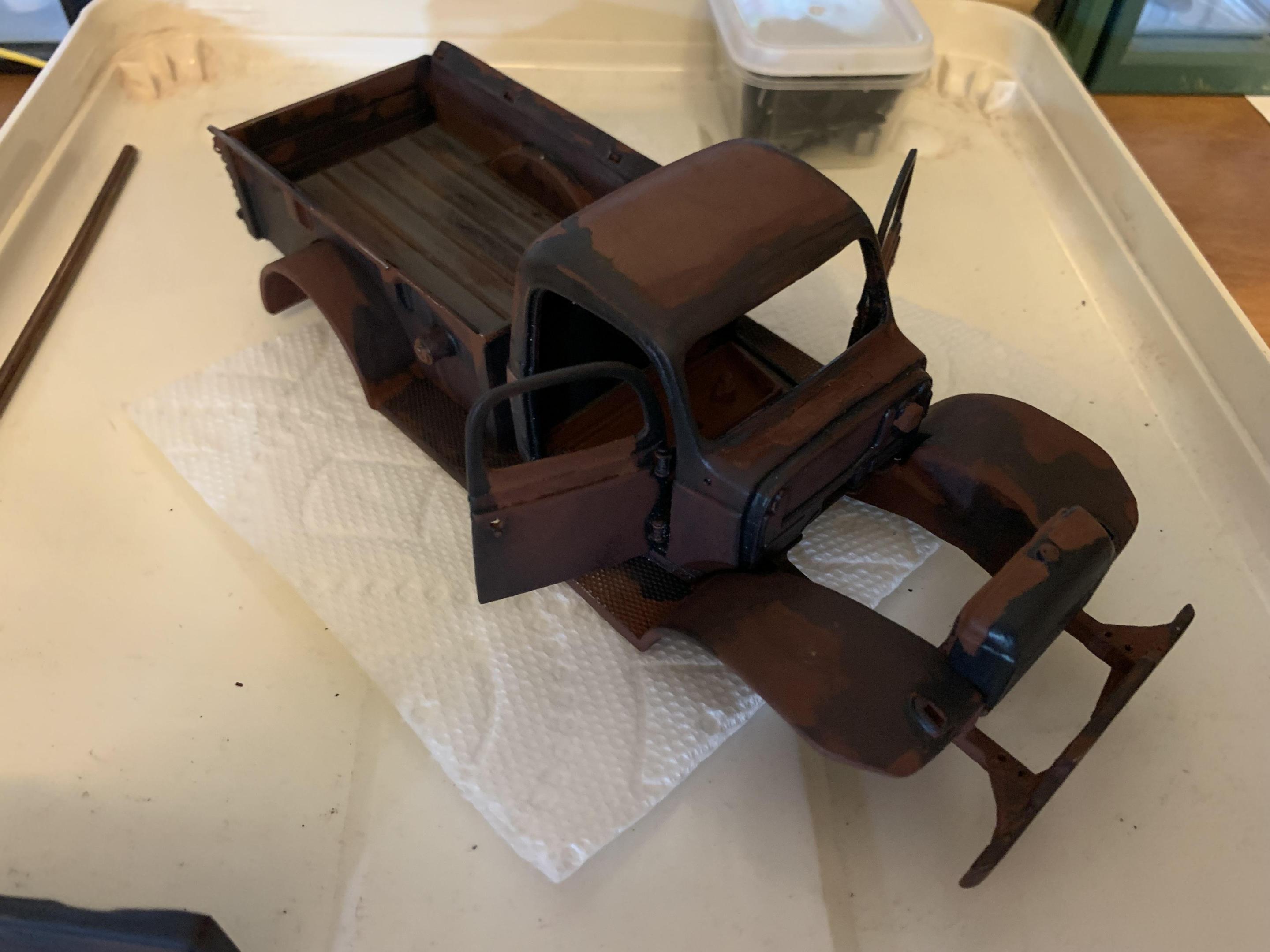

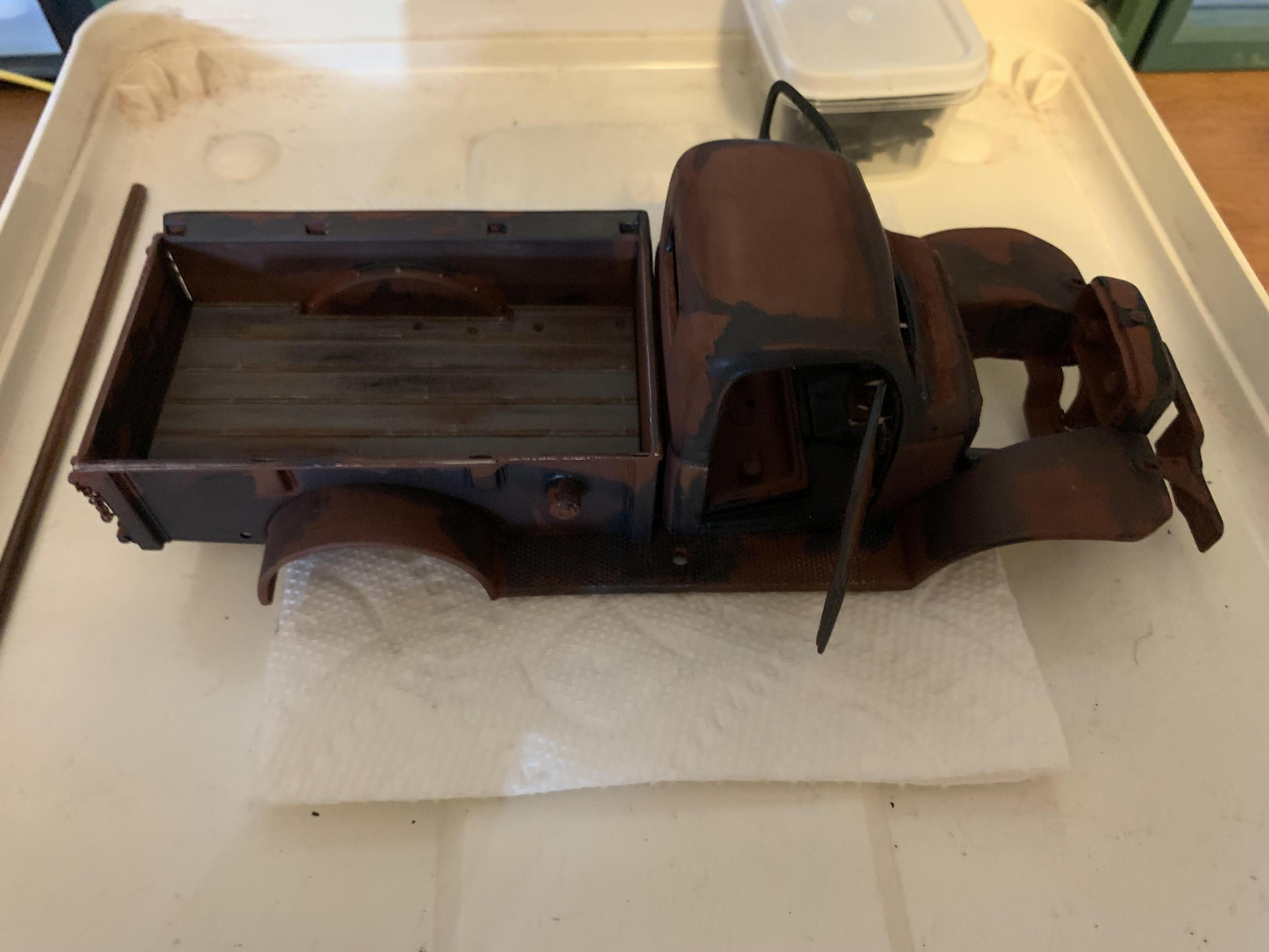

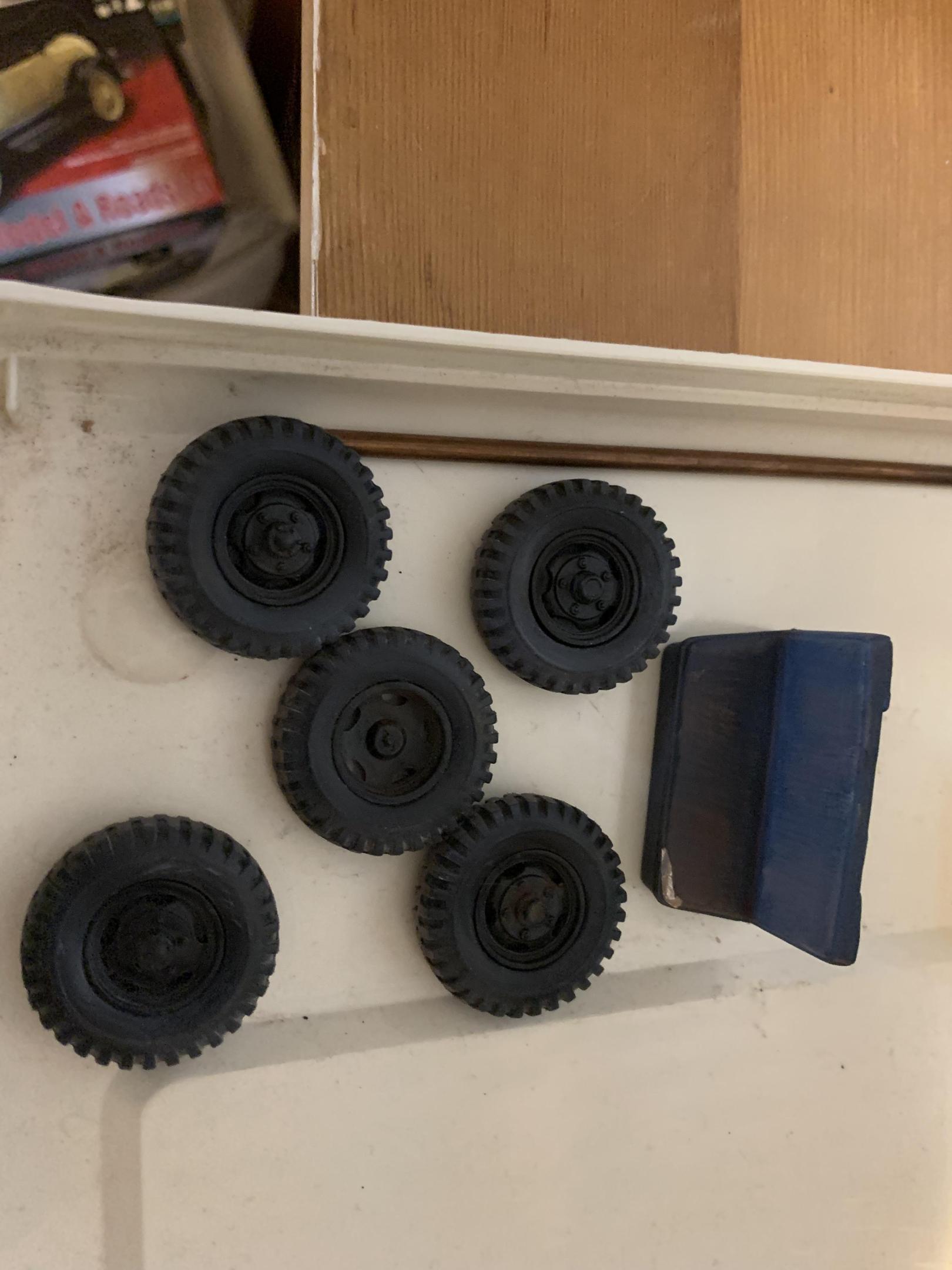

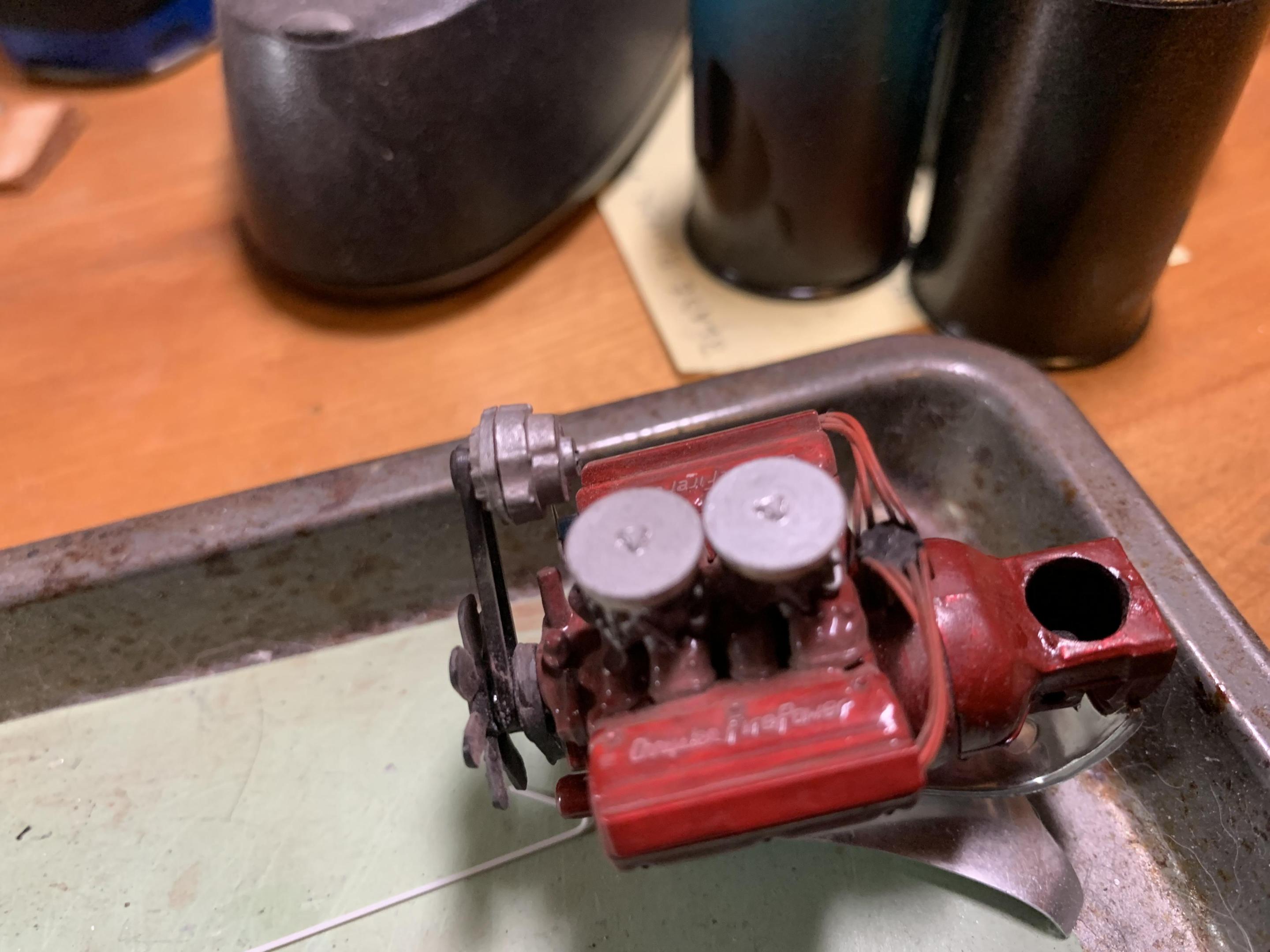

Got a lot of weathering done- still more to do, of course. Will need to grind more in the engine compartment to make the hemi fit, and also grind inside the grille to adjust the radiator fit (too close to the engine). Used white pastel to weather the tires and did more on the seat. Mostly done with pastel rubbed on the area then worked with my finger (best) or a q-tip (doesn't stick as well). -

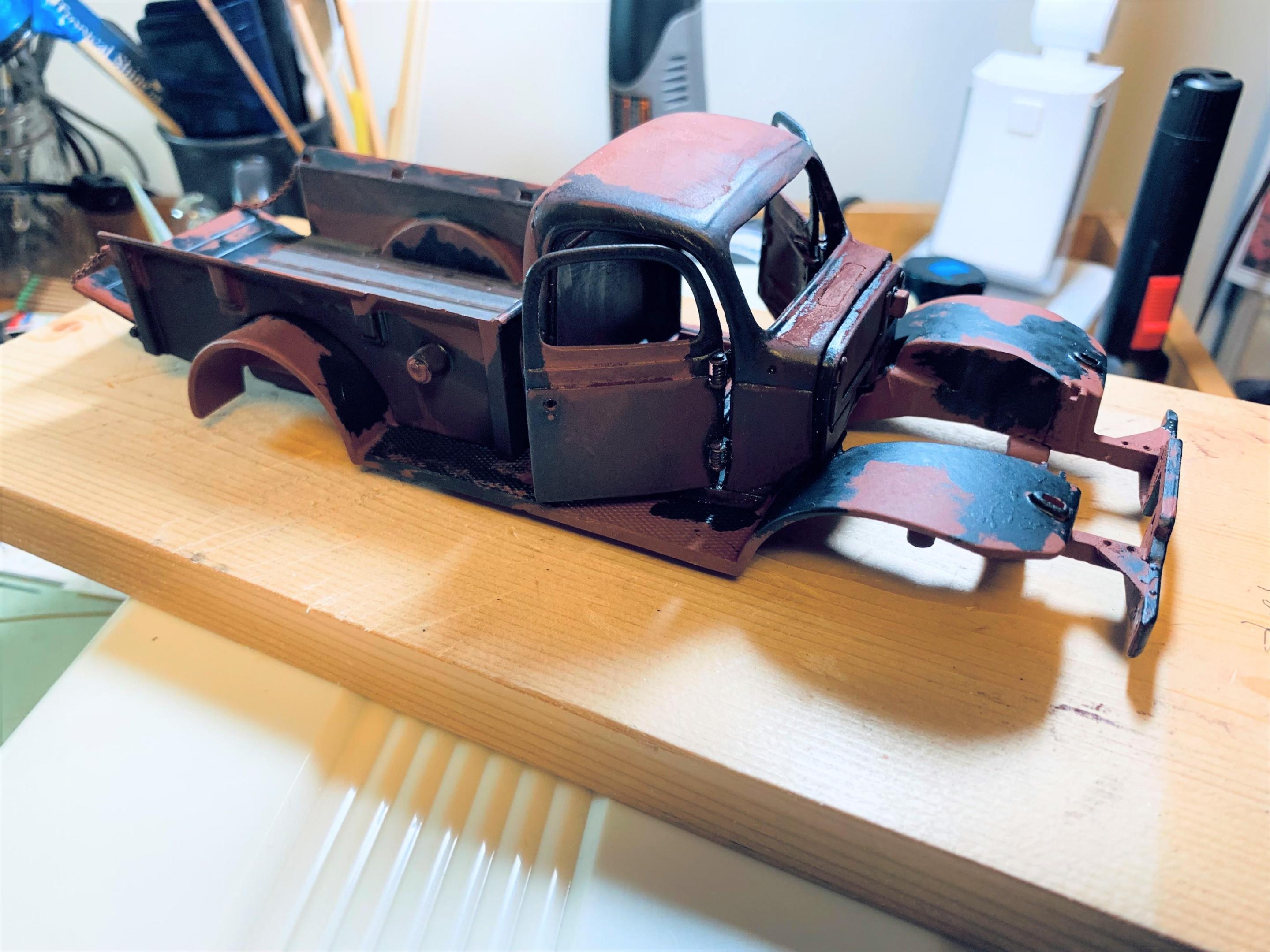

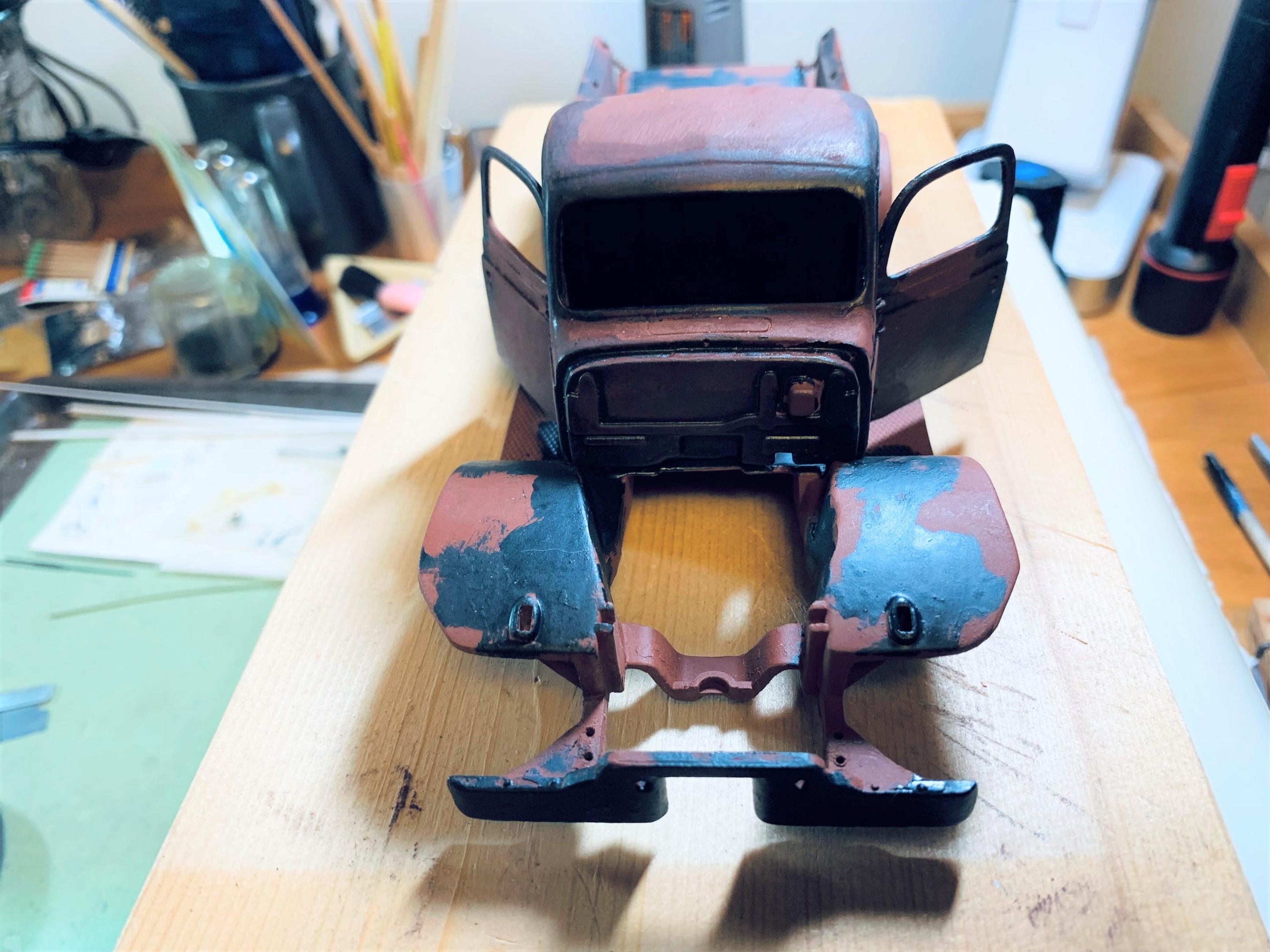

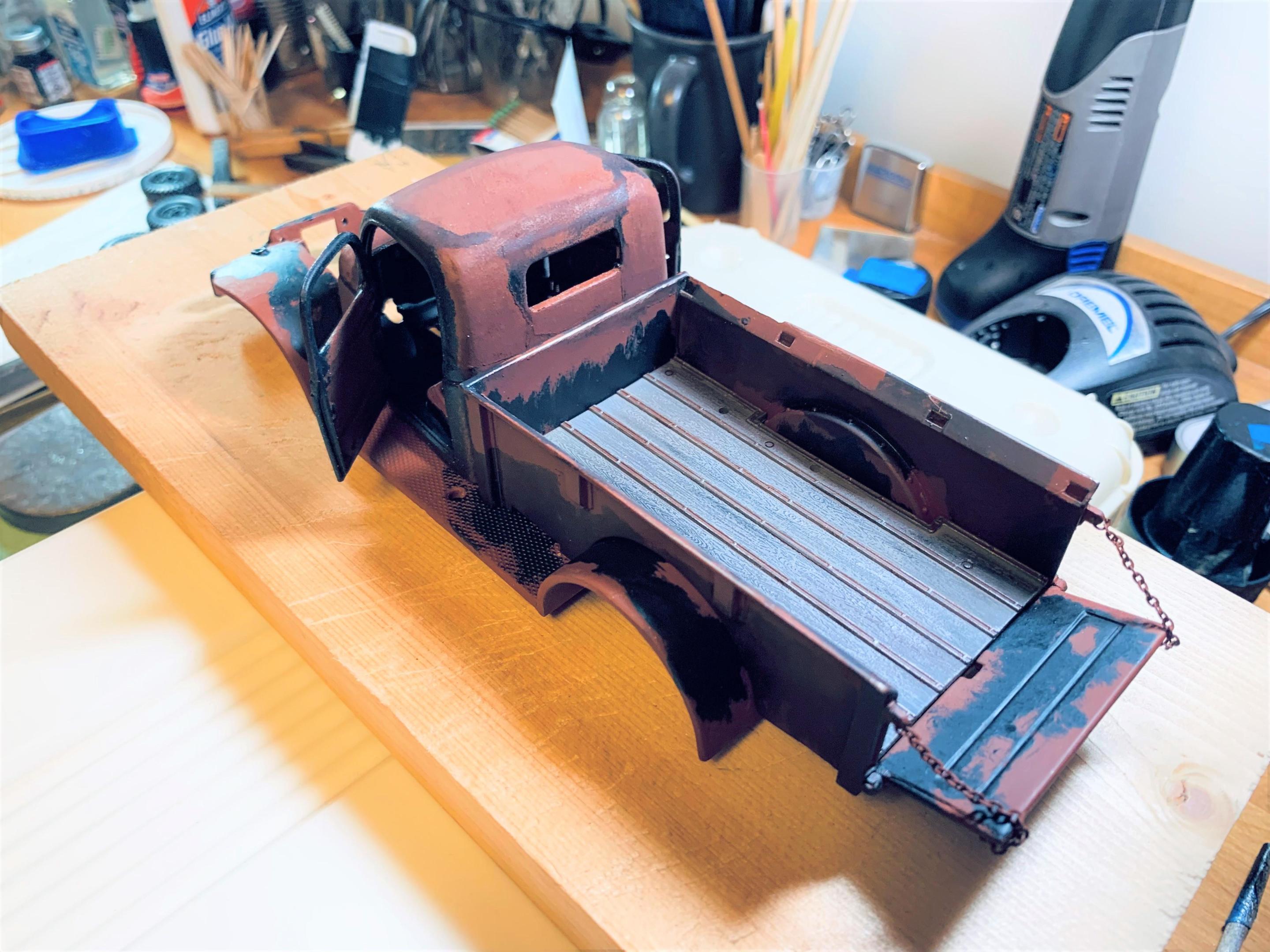

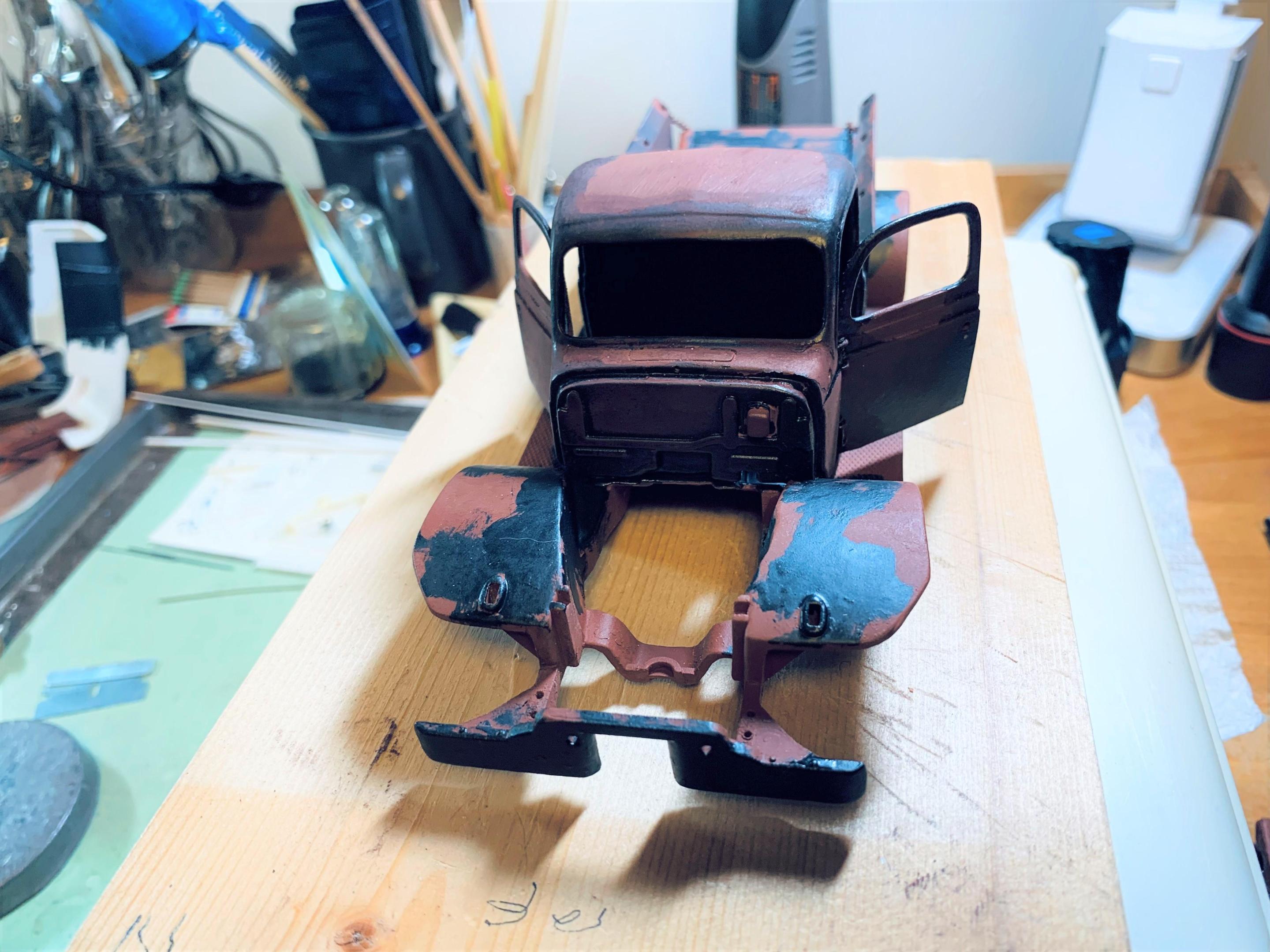

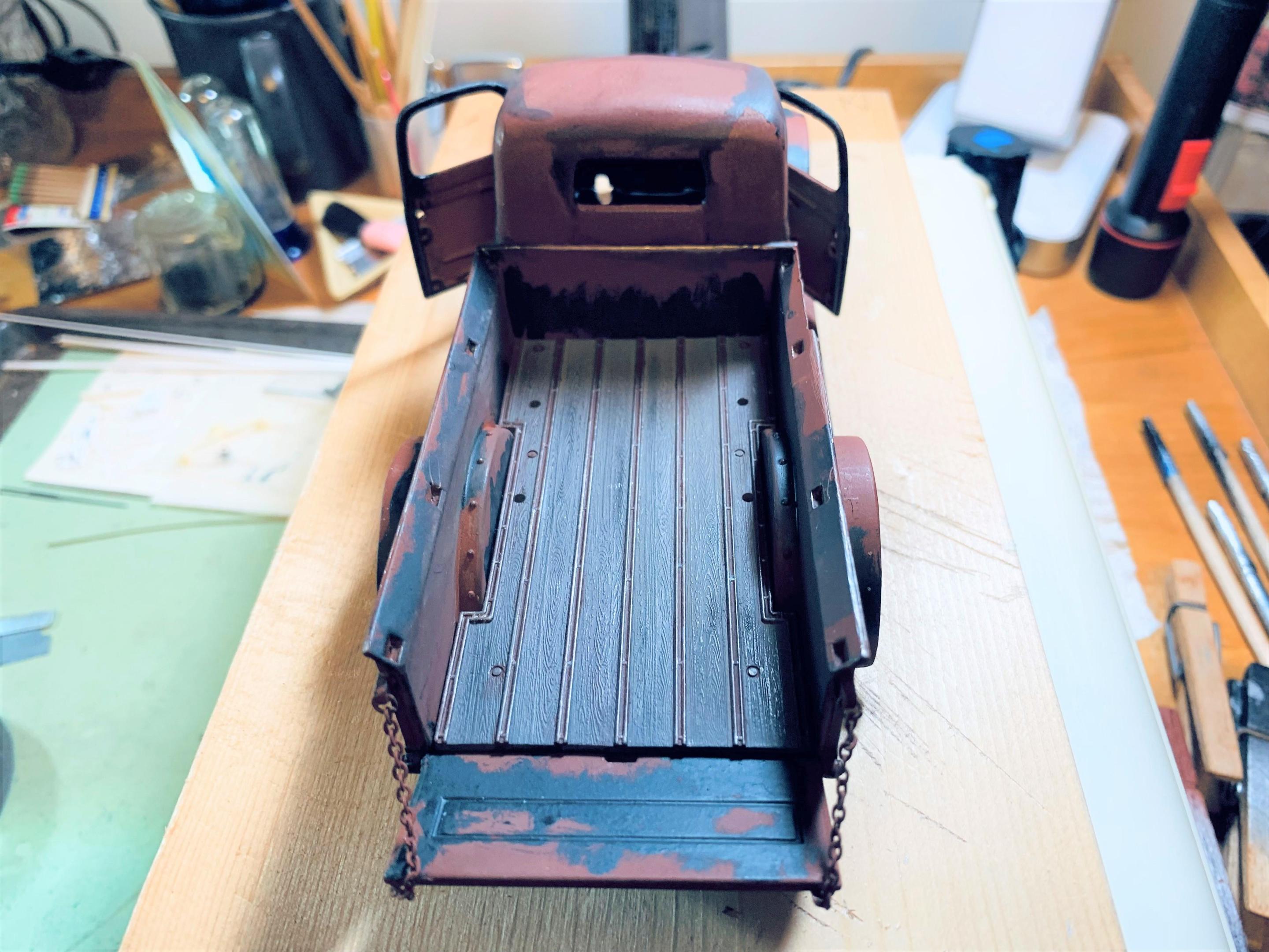

Although I am still finishing up another project, I decided to start weathering the Power Wagon. Initially I had decided on a lighter blue, but started to really like the darker blue of Testors gunmetal- this is a deep slatey blue somewhat like gun bluing. I had started by priming with red oxide primer (good old hot rod red), then masked off some areas with the torn edges of the masking tape defining the rust and paint line. Then I brushed on the blue and peeled off the tape. Eventually I just began to freehand the blue, with about the same result. I tried some sanding as well as leaving the blue alone. Then I started rubbing on some pastels right from the stick (an old set Betsy gave me). My skin oil helped the pastel to sink in, as well as the porosity of the paint. The bed was molded in black plastic with decent wood grain, so I painted it flat grey. I used some pastel and dry brushed steel and some wash from Testors rust and rubber mixed together. Lots more to do, but getting the feel of different things- tried brushing some powdered pastel with a brush on the engine but nothing much stuck. I will try a Q-tip rubbed on my nose for a little oil, then pick up the pastel powder and try it again. Please feel free to comment and make suggestions- this one is wide open as a grungy muscular old workhorse can be! -
Looking very good- looking forward to seeing it finished.
