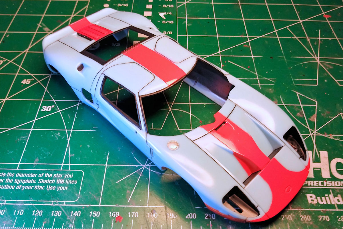

  5. Thank you all for your input, I gained quite a bit of knowledge from the responses I received. It seems to me that this issue was most likely a combination of some crazing of the plastic and me applying too thick of a coat with some possible interaction with the Novus polish. I've decided that rather than risk any more issues, I'm just going to repair the finish on the nose clip as best I can and proceed with final assembly. Thanks again, David G.

  18. Thanks for the input Peter. Given my prior experiences and what you're telling me here, I tend to agree that the clear coat may be crazing the plastic. If that's the case then I think it's best that I don't make any further attempts with the Tamiya TS-13. The model looks pretty good now and I'd rather not take a chance at ruining it this close to completion. But in the future, I'll certainly adhere to your recommendation for relying on the more traditional cleaning method. You just can't go wrong with good ol' soap and water. I do have a bottle of Pledge acrylic that I could try, I've had good luck with that in the past. But at this point I'm just inclined to remove the masking, clean up the nose clip in a few days after it cures and push toward the finish line. Thanks again, David G.

  20. Miles and Tom, thanks for your response. The only paint on the part in question is the orange, Tamiya TS-12. The blue is actually the color molded plastic. All of it, including the test pieces, were cleaned with Novus. I even did a test on a scrap body using the exact process I planned for the Ford. I washed the scrap body with dish soap and running water, allowed it to dry, then cleaned it with Novus and buffed it, When I sprayed it with the clear coat, it first showed a little unevenness which leveled out in about 20 minutes. Aside from the scratches and other flaws in the plastic itself, smooth and shiny. Which is why I'm so dumbfounded. Hi Claude. I thought about washing it again but I am a little concerned about what may happen to the decals if they get wet. Regarding the multiple coats, they were all laid down within about an hour and a half so they should have bonded well with each other. Thanks for all the responses. I'm still not sure what path I'll take with this yet but I sure don't want to take a chance at ruining it at this late stage. It won't do any harm to let sit with overnight with the masking while I sleep on it and see what other suggestions I receive. Thanks again, David G.
  21. I'm also posting this in the build thread to increase the odds of getting an answer. OK, I have a bit of a problem. In anticipation of applying a clear coat to this model I masked off all the flat black trim. I did a test on a couple of the smaller parts to check compatibility and it looked great. So I thought I was good to go and decided to start with the smaller nose clip and this happened. The coat (Tamiya TS-13) laid down unevenly with a couple of rough patches. I applied two or three more coats and things improved a little but not by much. I don't use clear coat often but I have used it before. I know that sometimes it will lay down looking like it has soft fisheyes but will almost always even itself out in about 10 or 20 minutes. This one didn't. And the rough patch; there were two, one on each of the two blue areas. The one on the right smoothed out after a couple of coats but the left side one stayed rough. Prior to painting, I cleaned the entire car in the same manner using Novus Plastic Clean and Shine. Followed of course, by a thorough buffing with a soft polishing cloth. I've never had any problem painting over Novus polish until now. I think I can smooth and polish the nose piece after it cures but I'm understandably reluctant to shoot the body. So it's masked... and waiting. Waiting until I find a solution to whatever this problem is or I decide to unmask it and proceed to final assembly. So, um... Help? I would appreciate any observations or suggestions. Thanks so much, David G.
  22. OK, I now have a bit of a problem. I'm also posting this in the Model Building Questions and Answers section where it may be a little more likely to be seen. (This problem has been addressed. I received some solid tips and advice from the duplicate posting in the Model Building Questions and Answers section. Thank You.) In anticipation of applying a clear coat to this model I masked off all the flat black trim. I did a test on a couple of the smaller parts to check compatibility and it looked great. So I thought I was good to go and decided to start with the smaller nose clip and this happened. The coat (Tamiya TS-13) laid down unevenly with a couple of rough patches. I applied two or three more coats and things improved a little but not by much. I don't use clear coat often but I have used it before. I know that sometimes it will lay down looking like it has soft fisheyes but will almost always even itself out in about 10 or 20 minutes. This one didn't. And the rough patch; there were two, one on each of the two blue areas. The one on the right smoothed out after a couple of coats but the left side one stayed rough. Prior to painting, I cleaned the entire car in the same manner using Novus Plastic Clean and Shine. Followed of course, by a thorough buffing with a soft polishing cloth. I've never had any problem painting over Novus polish until now. I think I can smooth and polish the nose piece after it cures but I'm understandably reluctant to shoot the body. So it's masked... and waiting. Waiting until I find a solution to whatever this problem is or I decide to unmask it and proceed to final assembly. So, um... Help? I would appreciate any observations or suggestions. Thanks so much, David G.
