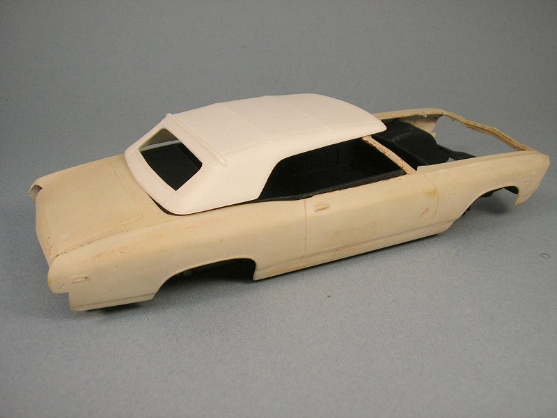

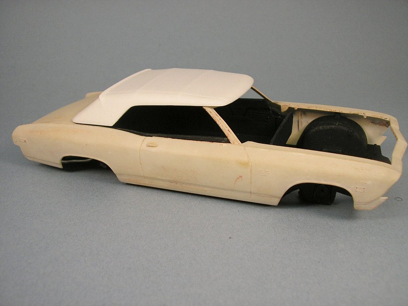

	This came up as a subject on another thread, and I thought someone said that the kit doesn't have the correct dash for a '68. It uses the '69 dash and they are different. I have this kit (buried) and while I've never put one together, being that it's typical Monogram for the era, the parts count is low and shouldn't be terribly difficult to get together. I do know that there is no stock hood.......you'll have to fill in the hole or perhaps use a hood off of a '69. That's all I pretty much know-----I bought basically a started kit with intentions to turn it into a convertible someday.

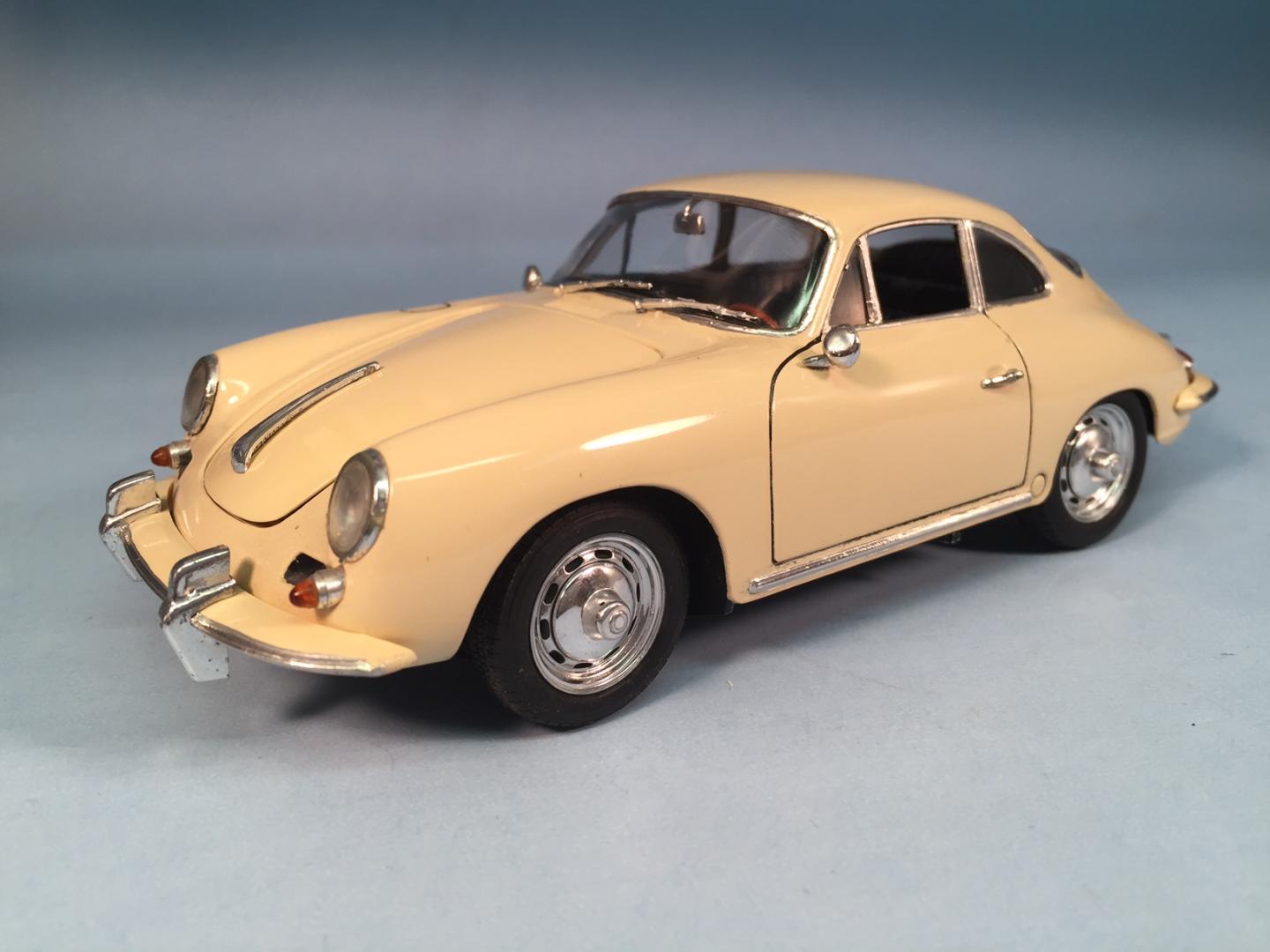

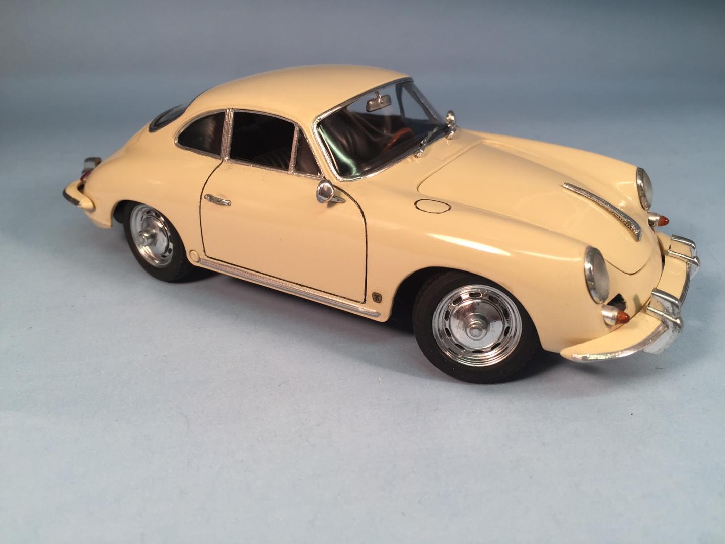

	A Porsche I restored (my own from the '80's) and the wheels and mirrors redone with the pens.................. To echo what Tom said, if you want to do the side trim you'll still need to mask off and trim the tape, then use the pen. To me that seems like extra work............better to get proficient with the BMF. As the old saying goes..............."Practice makes Perfect"!
