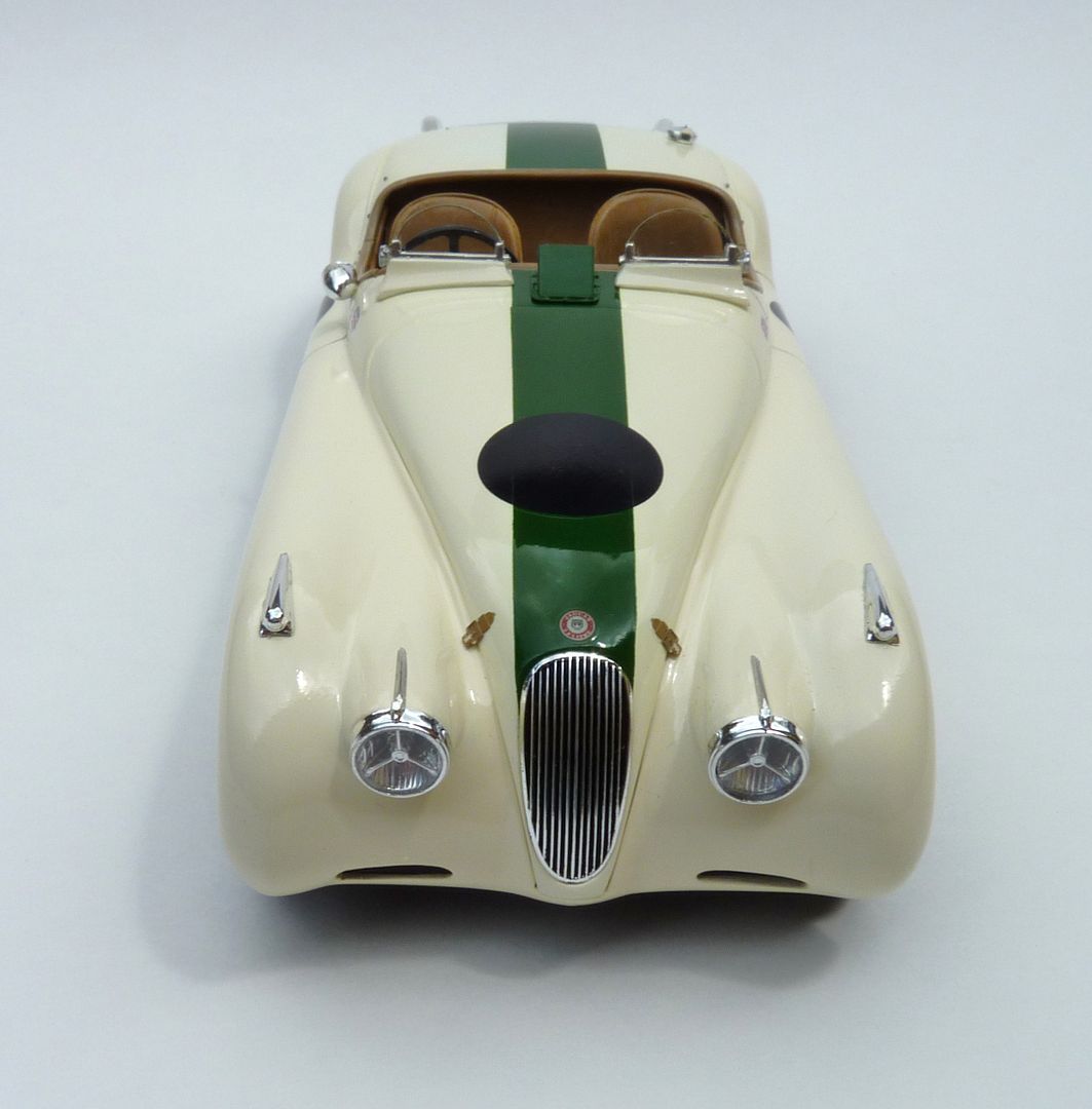

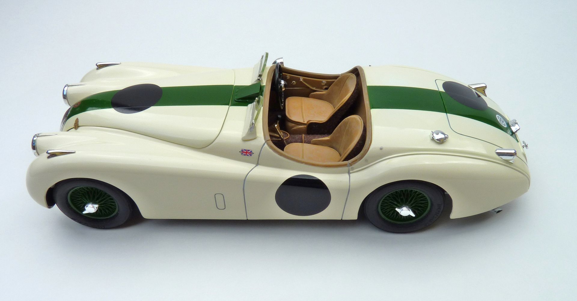

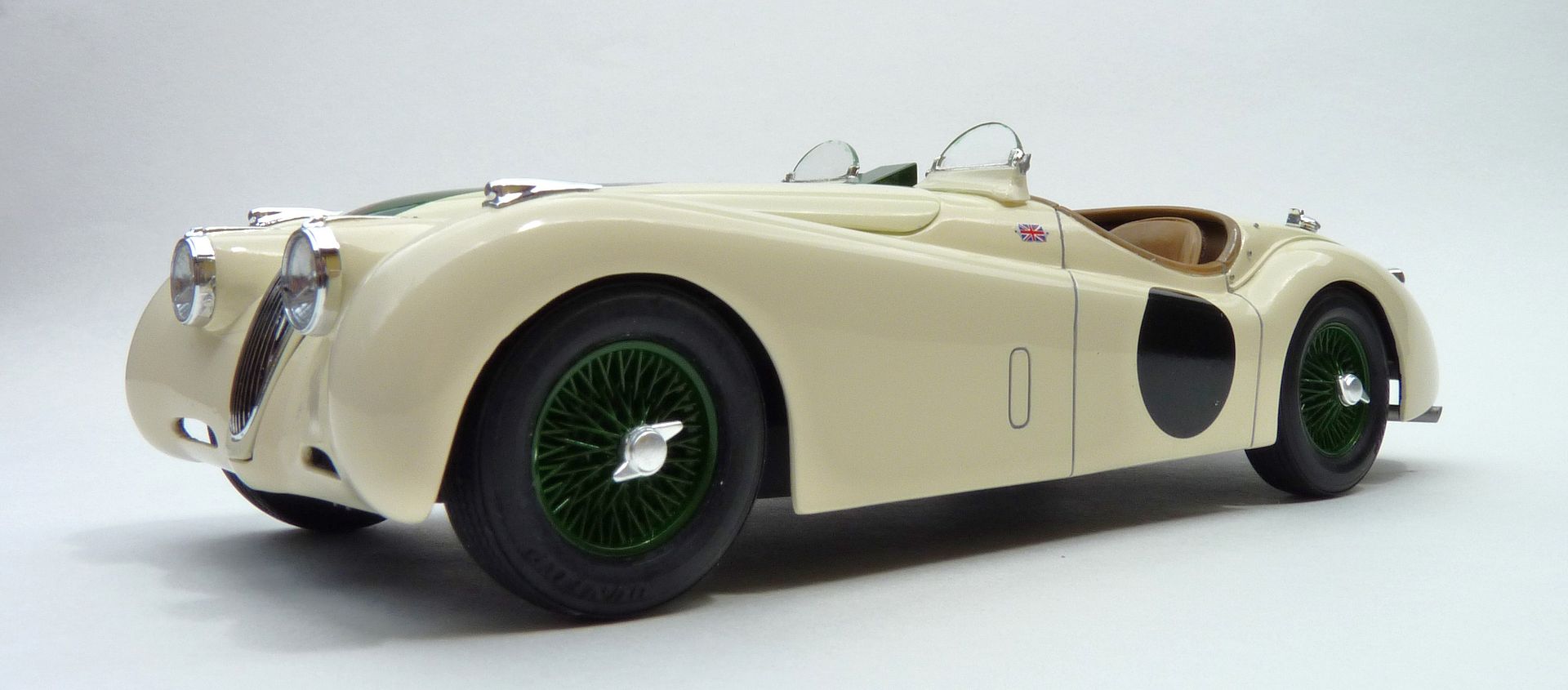

This is Revell Germany's Jaguar XK120. The kit is a plastic-body reissue of the old Monogram metal-body kit from the late '70s. I decided to build it as a period-appropriate gentleman's toy... the sort of thing to drive to the track, thrash some punters in MGs, and motor home in after. I made several alterations to the kit- the biggest of which was to modify some Monogram Cobra seats to represent XK120c racing buckets. I raised the rear suspension by a scale 3" and lowered the front by roughly the same amount to give it a nice rake and make it look a little meaner. Wheels and tires (tyres?) are Tamiya Jaguar mkII units. Paint is Tamiya Racing White with Racing green wheels and stripe. No clear coat and polishing was done with Meguiar's Ultimate compound and polish. The roundels, flags, and country ID plaque are from a VRM decal sheet. I like the blank roundel look, but might put numbers on them at some point.

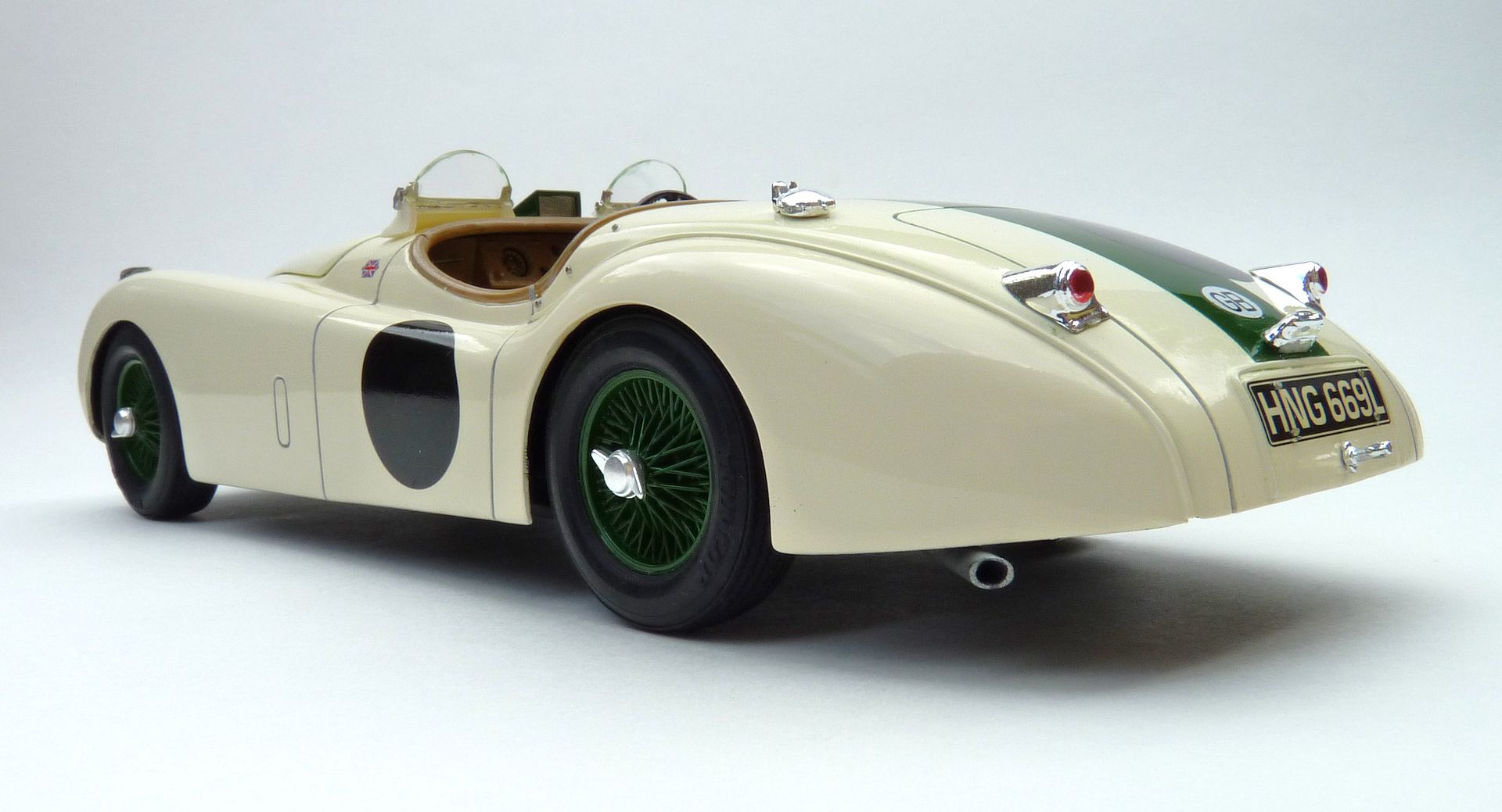

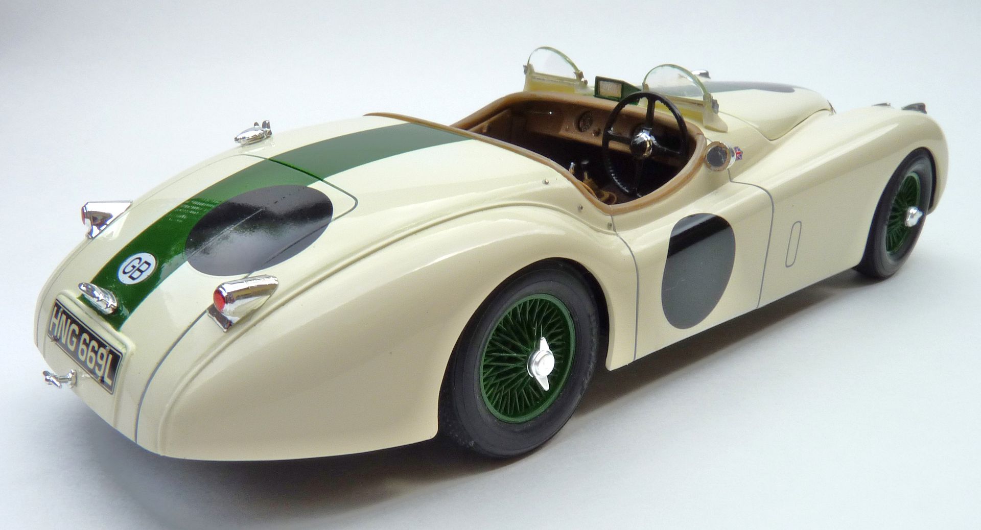

I'm still contemplating installing driving lights up front, but I don't know if I want to clutter up the design. Holes for front and rear bumpers were filled with styrene rod. PE hood straps were left over from a Ferrari 250 Testa Rossa detail set.

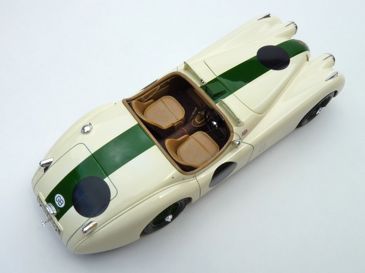

External fuel filler is a parts box piece.

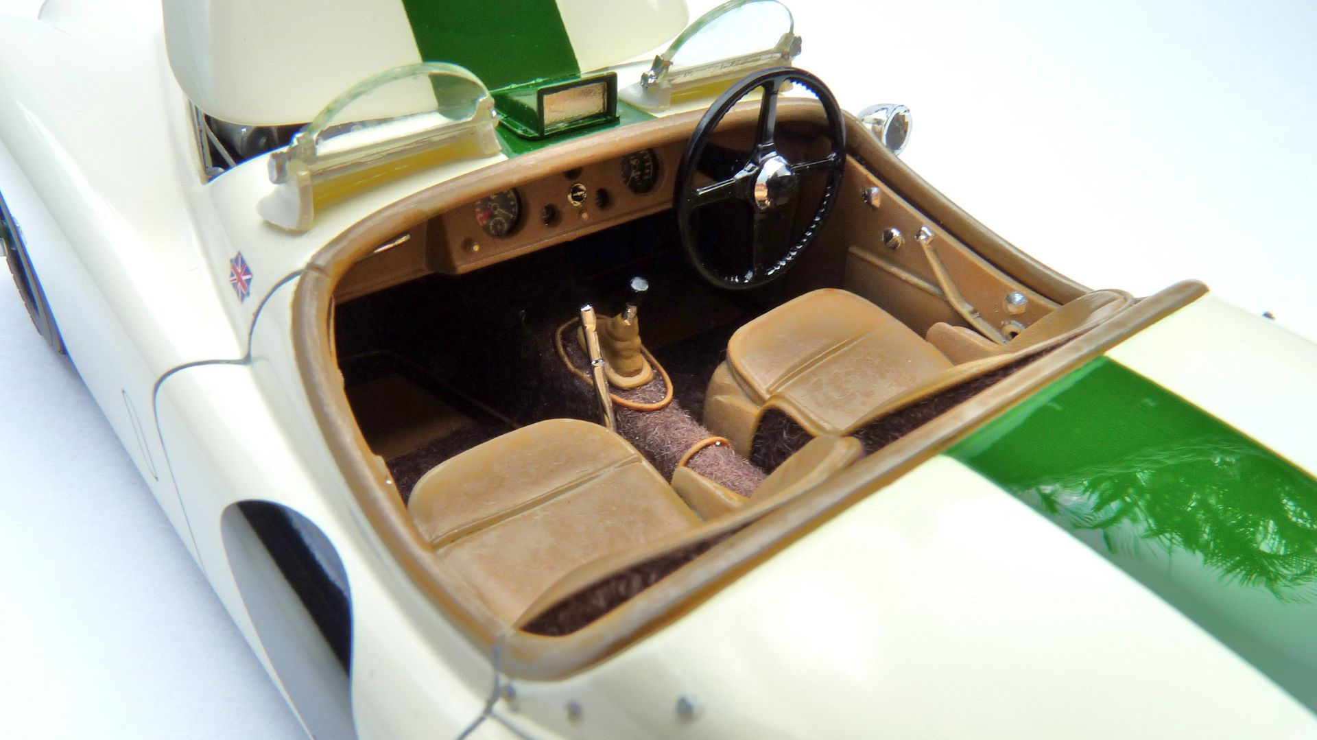

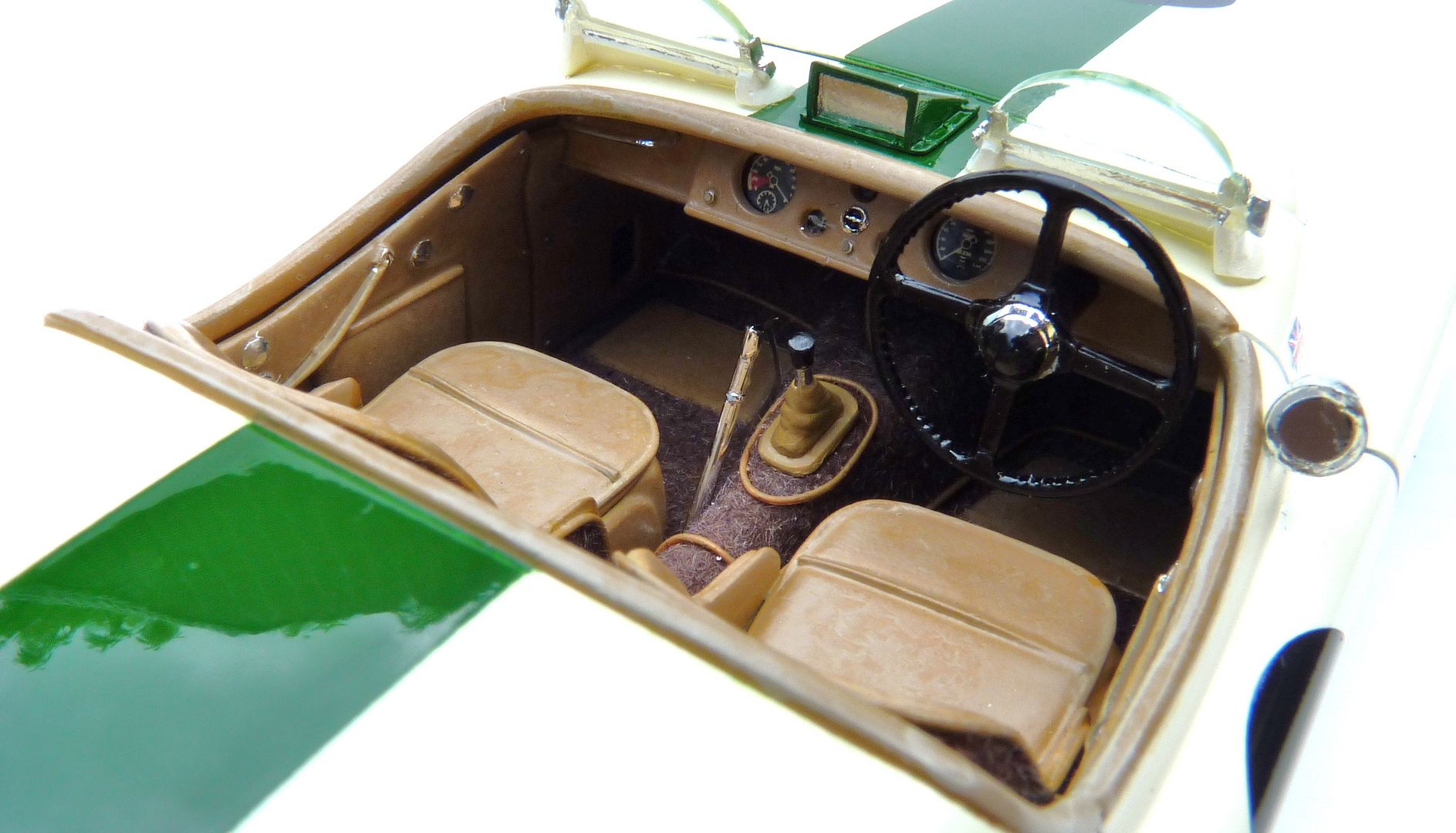

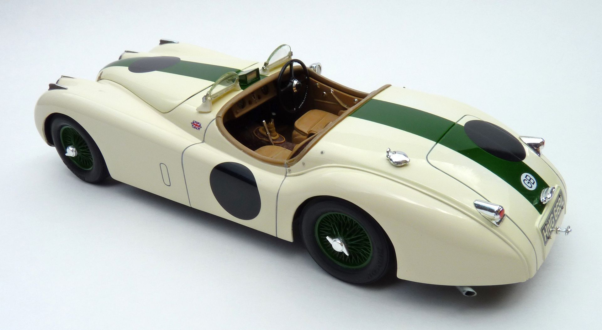

Here the heavily-modified Cobra seats are visible. I drilled out the instrument panel for the gauges and mounted the kit decals behind clear acetate. Dark brown flocking adds a nice contrast to the weathered biscuit "leather". The kit offers a choice of right or left hand drive, as well as a choice of the "Brooklands" windscreens I used versus the standard windscreen, The aero rear- view mirror between the windscreens, a staple of XK racers, was scratchbuilt from sheet styrene and PE rivets.

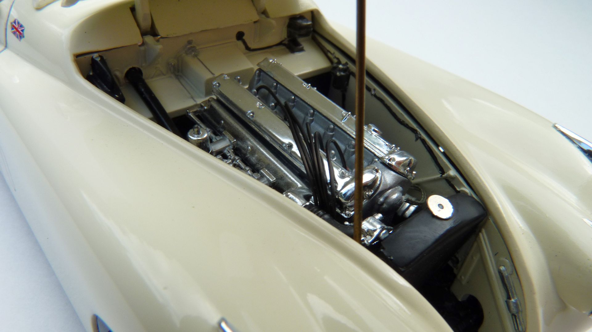

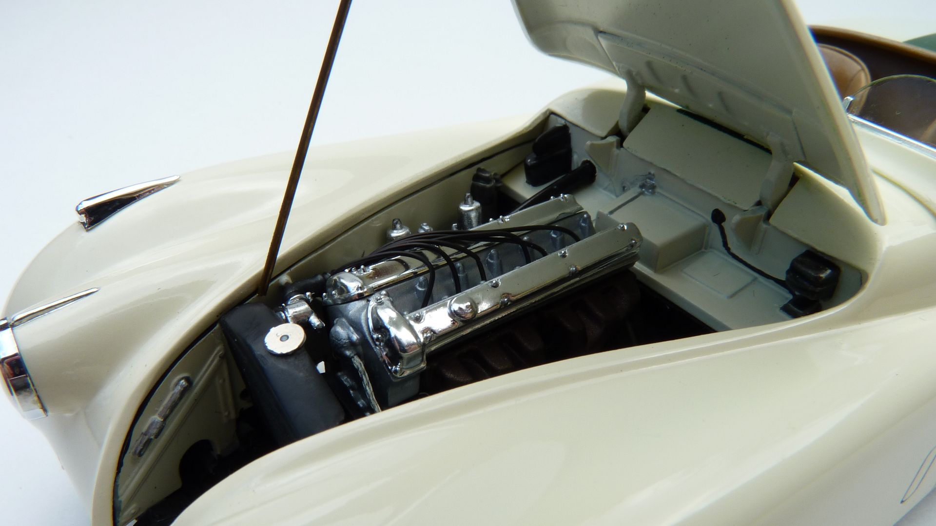

I'm less than thrilled with the under hood presentation... the somewhat eccentric design of the kit, with full-length side panels that go from the interior through the engine compartment, led to some gaps between the body and engine compartment sides. If I build another one, I'll cut the engine compartment sides out and mold them to the body shell. fortunately this car looks so good with the hood closed...

Thanks all. The wire wheels are the nicely detailed plastic units from the Tamiya Jaguar Mark II. I stripped the chrome and painted the Racing Green over the bare plastic to keep the paint buildup down. The Tamiya paint came straight from the rattle can and just required some light polishing with compounds to smooth out the light orange peel. I have a Morgan and the Gunze Triumph TR3 in the stash to go with this one!

Just the way you've managed to get the hood to fit so well is a real achievement!

One thing and this is more on observation and certainly not a criticism the number plate/licence plate the "L" suffix you have used, would date the car to 1972. If you wanted a plate for say 1948 it would read perhaps read 544 LCV which would be a car registered in Cornwall UK in 1948.
Just an example and If it doesnt bother you I understand. but brilliant work on this Brit classic mate.
