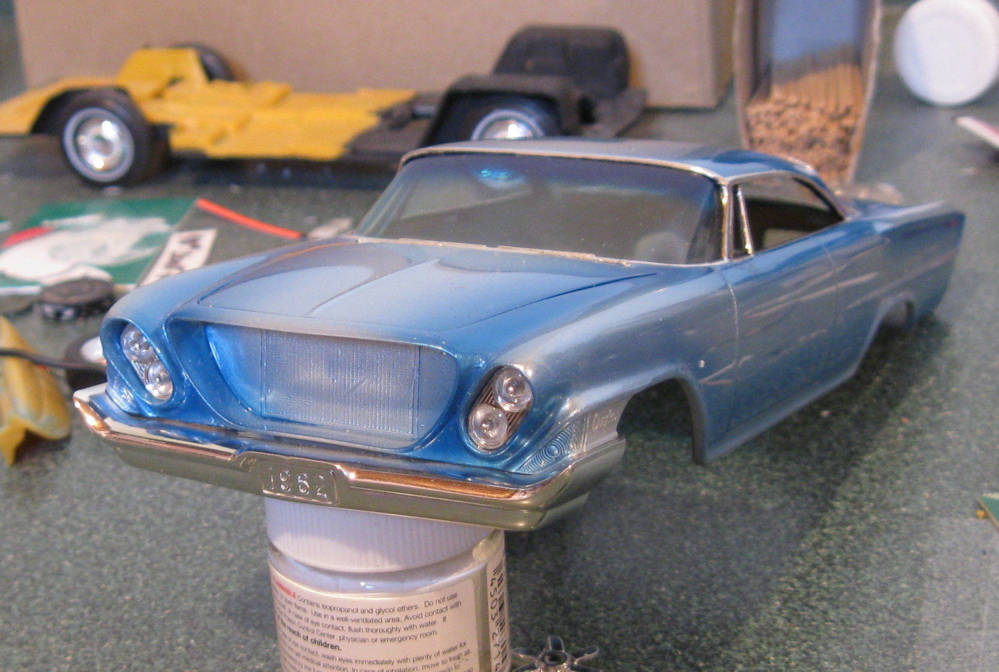

Can-Con Posted January 5, 2020 Author Posted January 5, 2020 So, Finished up the T-bird so back on this one. Did up the headlights. The bezels are from a Revell '59 Chevy with Lucas lenses. I've also been working on the custom interior between other things over the last few months. The seat inserts aren't quite there yet but they're coming along.
Claude Thibodeau Posted January 6, 2020 Posted January 6, 2020 Hi! Very unique project. These kits are rare and difficult to get. And if you find one, a second loan on the home is ofen needed $$$. Your shaded paint job is very nice. And to say that back then, when the car came out, journalists critiqued that it was just a "carry-over" of the previous design, barring the fins. Notheless, I find it very appealing! CT
Can-Con Posted January 18, 2020 Author Posted January 18, 2020 Worked on my grille today. 19 strips of sheet plastic in 2 thicknesses stacked on top of each other and sanded to shape. Needs to be cleaned up a bit more and painted.

Can-Con Posted January 27, 2020 Author Posted January 27, 2020 The grille is finished and I'm working on the under hood area and interior. The long ram intake manifolds were in a junk box I bought at a show for $5. and the valley cover is foil cast from one in another junk box. I'm smoothing out the inner fenders and will I try to match the fade on the body. The interior is almost ready for some paint. I see a couple spots that need a touch more filler.

Can-Con Posted February 24, 2020 Author Posted February 24, 2020 Finished up the firewall. Kit part with the molded wireing smoothed off, painted to match the rest and "chromed" the master cylinder and heater box with a molotow pen. And have the interior about 1/2 done. The pleated inserts will stay pearl white and the rest will be blue. This is my first time trying to do pipeing on the seats.
