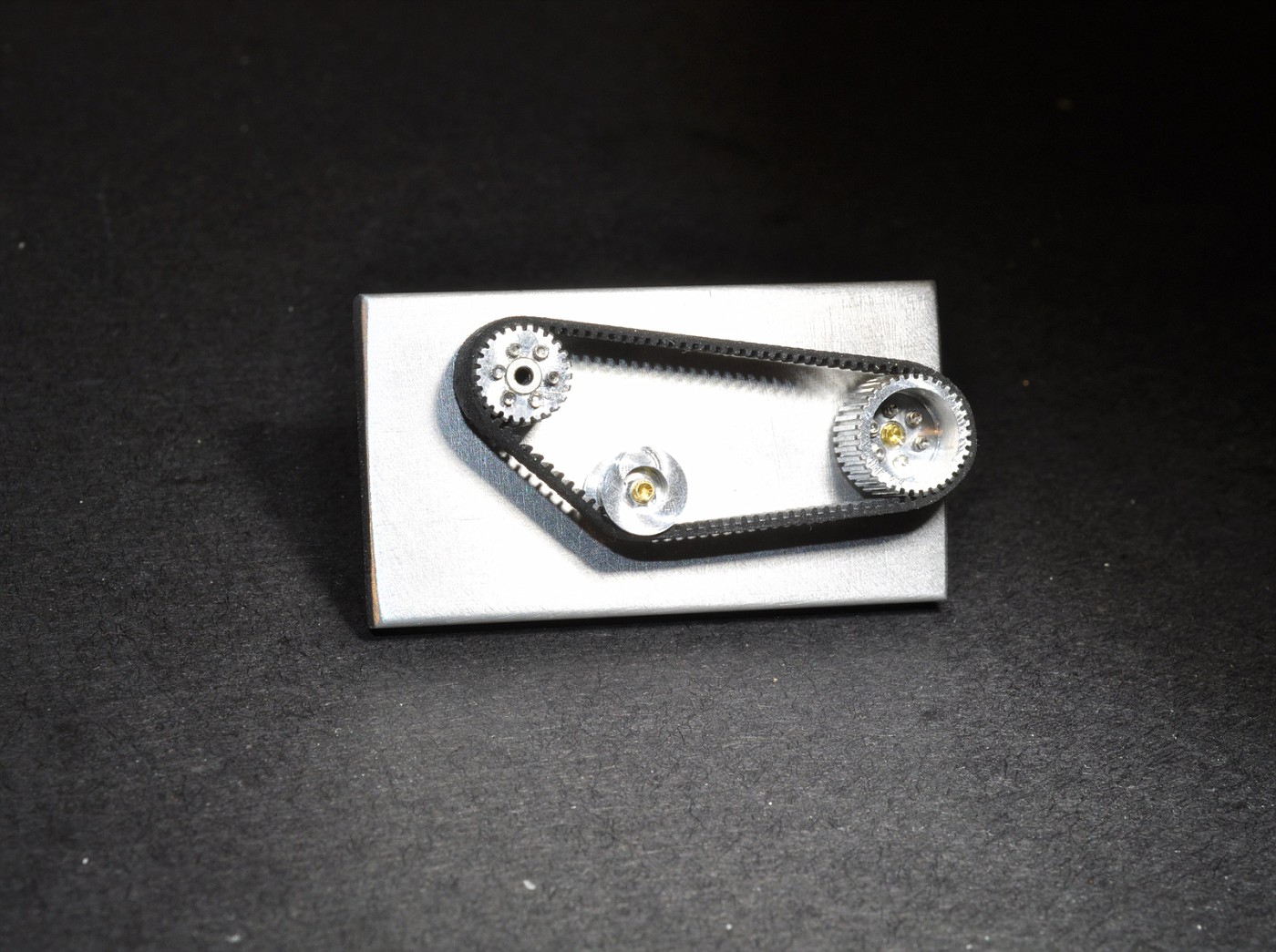

Codi Posted December 6, 2016 Author Posted December 6, 2016 Thanks Pete. I DID chuckle btw. Paul, glad to hear you like what you see so far. I wasn't aware of your background. I think the rest of the build should be of interest then. Today I got the crank pulley finished and the idler pulley. Blower is last. Hope to get it done by Thursday. cheers everyone! Got some machinist blue to clean out in the corner of the pulley as you can see.

Codi Posted December 15, 2016 Author Posted December 15, 2016 Thanks again fellas. I've been a little slow getting back to this as I had finger surgery last Friday. Same operation as before (my 8th one) and I could finally get back to the bench. Completed the pulleys. The toothed belt is an M.A.S. blower belt that I skived down about 1/3 to thin it up. I drilled a plate to mock them up so the idler pulley is a little higher than it will be on the car. I did this as the belt had a little too much tension on it so I wanted to store it this way to give the rubber some "memory" and to loosen it up a bit for final assembly. Cheers, tim

progplastic Posted December 16, 2016 Posted December 16, 2016 amazing stuff.. i been fallowing this build for some time, i wish i had the skill to build at that level. one question, is the belt on the correct side of the idler pulley.?
Mooneyzs Posted December 16, 2016 Posted December 16, 2016 Tim... That is some freaking Amazing work my Friend!!! I will take one for wall Art Please!! . Those Pulleys are gorgeous and wow that Belt is just killer. I couldn't imagine how much time it took to trim the belt down in thickness. You did one heck of a job!!
Codi Posted December 16, 2016 Author Posted December 16, 2016 Thanks guys and I want to answer some of your questions. Bob, shaving the belt was easy actually. I stretched it teeth down onto an oversized piece of alum. Chucked it in the lathe and used a sanding file and took it down gradually. About a minute and it was done. Pete, appreciated. I do have to agree that it helps if you have done some machining to understand what goes into it. I like the challenge in trying to figure out how to make something and then going about doing it. My biggest fault is that I do something that can be made easier and quicker but my lack of experience leads me down the harder path. But I'm learning it as I go along and it's fun. Wait till you see the steering box & dual remote oil filter bracket that I want to attempt. I hope. Thank you Art & Joe. Paul, not jewelry..........but I appreciate the inference. Ah, Dave. Well now that's a story all itself. Which I'll share. I had the blower pulley done last Thursday before my surgery. BUT, my numbers were wrong and I had even run a few teeth and checked it and liked what I saw. Did the whole pullley (cutting one is a 2+ hour step for me to cut such skinny grooves) and the belt didn't fit. I discovered my number was off by .6 of one degree on each tooth. Made all the difference and it fits perfectly now. I shoulda asked I know but sometimes you just gotta let the student figure it out for themselves. Oh, so I took 2 1/2 hours just to cut the teeth in the 2nd one. Yippee. btw, thanks very much for the compliment. Jim, thanks for following along. The engine guys ran the belts on either side of the idler. I discussed this with some very knowledgeable people and there are different schools of thought on it. I am NOT trying to start a debate on whether one way is better than another. To each his own. I'm going to set mine up to showcase what I think will be the most interesting parts of the engine. I have yet to make some of those bits and pieces, so I'll make a decision when I get closer to final mock-up and assembly. Good question though. Thanks Chris. As I said at the beginning, I've always admired the ones on your Vega and really wanted to see how close I might be able to get in my scale. On the belt shaving, please see above what I shared with Bob on how it was done. Got some cool things coming up that I have drawn up and want to make soon. I promise to get you that list by this weekend. Cheers, Tim
