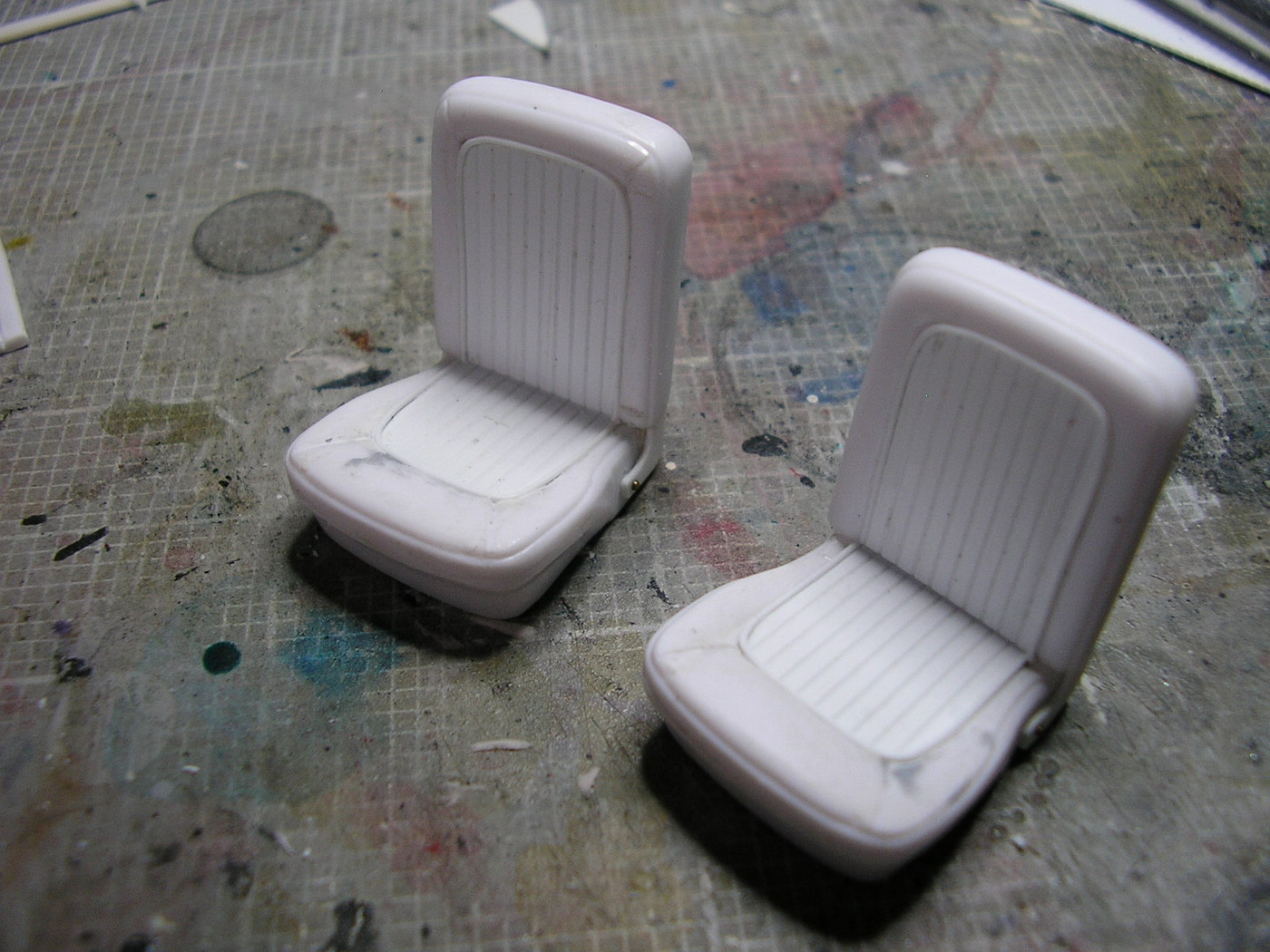

MrObsessive Posted May 13, 2018 Author Posted May 13, 2018 I did recently manage to get the chassis done, and now I'm working on the interior. Sorry I've been a bit AWOL on this build, but I'm in another modeling slump due to work, and soon I'll be switching shifts from daylight to overnights. One thing that switching will eliminate is there will be no more 10 hour days except if I want to work Saturday mornings for instance for OT. The interior of the Shelby is turning into a bit of a challenge as I have to pretty much redo the seats from the ground up. The froont seats in the AMT '68 Shelby kits IMO are trash, and I'm redoing the seat patterns from a Revell '68 Mustang interior set. I got these off eBay thinking they had the correct vertical patterns, but much to my chagrin-----no, they're the horizontal ones so I'm pretty much cutting everything apart and making new seat patterns. The rear seat will have to be built from scratch too as the fastback rear one is quite different and not the same at all as the rear seat in the two door hardtop coupes. I pretty much did the same thing over 20 years ago with the old Shelby build...........I just can't remember now how I did it. No digicam or internet back in those days! After the interior is done and it fits without much drama in the bodyshell, it'll be on the downside of this project as it's just getting the other body bits and pieces to go on, and then it's painting time! I've not much time during this week, and with the Mid Atlantic NNL coming up on Saturday, I hope to have some new pics to post up for you folks possibly Sunday.

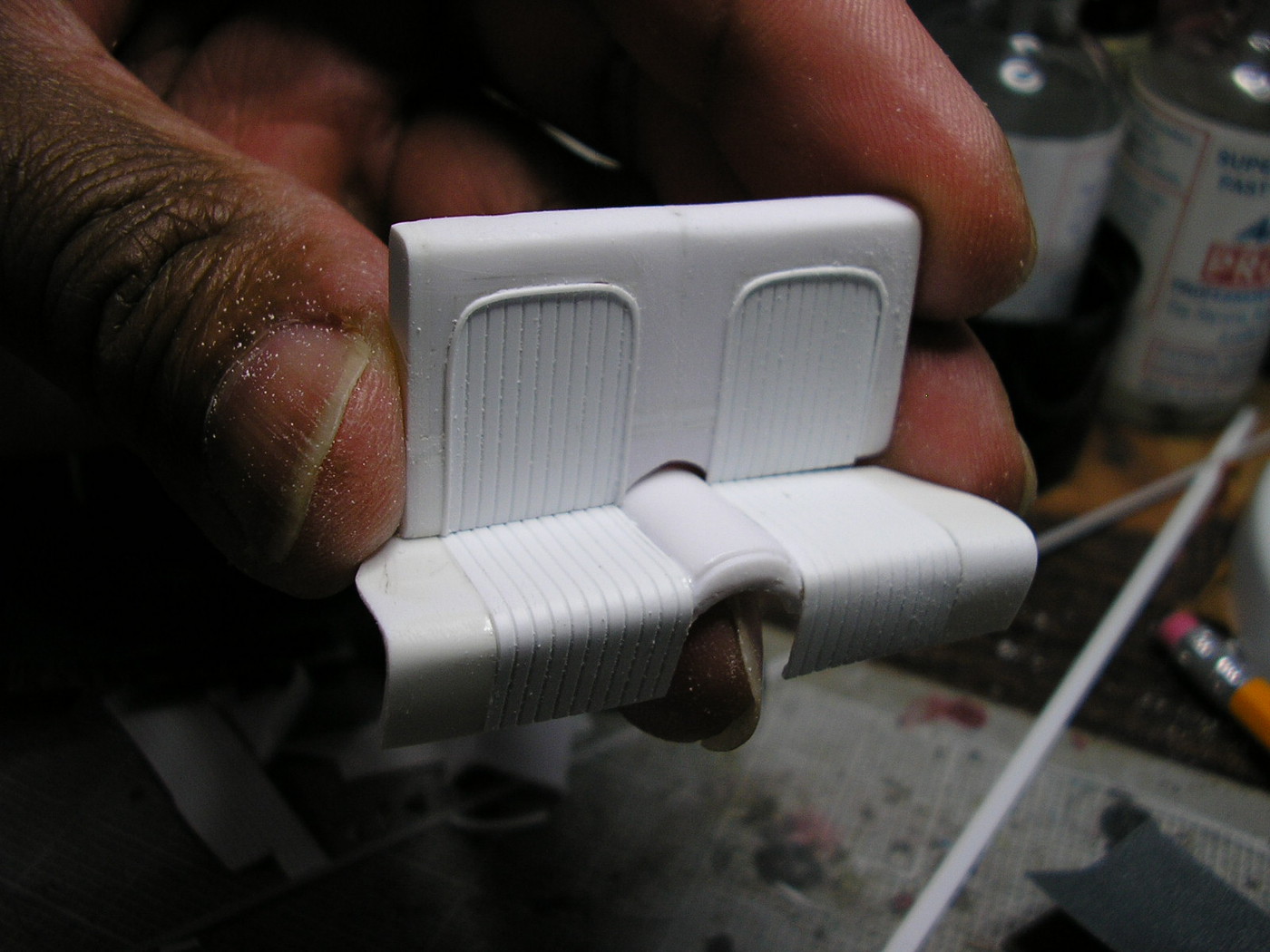

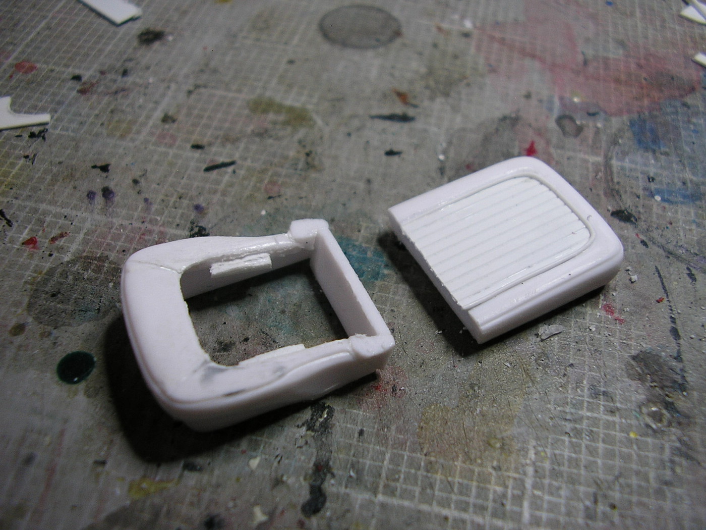

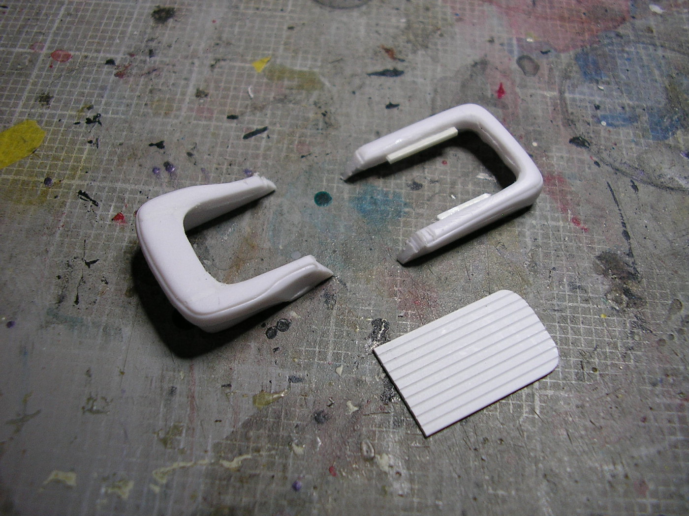

MrObsessive Posted August 4, 2018 Author Posted August 4, 2018 It's been a while since I've posted an update on this! Summertime is a bit tough to get any model time in------what with outside stuff to do, nice weather and of course working full time, modeling time can be at a real premium. Just the same, I've been whacking away at the interior, and I did have some of these pics posted on Fotki for a bit. Some of you that have the link for that may have seen these. For those that haven't I'll post them here, and hope there's no drama with the site's servers where I don't have to do this all in vain. Ok.........the interior proved to be a bit of a challenge, particularly the rear seat as it's very different from the Fastback. As you'll see, I very heavily modified the seat from the Fastback and all but scratchbuilt the seatback. One memory I have of this car (actually a '65 Fastback) as a kid is the Fastback's seat sat VERY low to the floor, where as the coupe sat up 'higher' and of course was not as cramped. Most of what's seen here came from the Revell '68 Mustang. I had bought interior parts off the 'Bay as I thought that this particular kit had the correct seat pattern. Much to my surprise however, that wasn't the case which gave me no choice but to replicate the pattern that's in the Green Hornet. Here's what we got............. To give the seats more of a realistic look and not appear so one piece, I essentially cut them in half and decided to hinge them. As you can see here, I cut not only the seat pattern away, but also the seat itself from the seat bottom and back. It will look more realistic when put back together, and makes it much easier to cut away the pattern. Hmmm.........the seat bottom kinda looks like a toilet seat huh?? The vertical pattern will be replaced using Evergreen's plastic stock with the .020" thickness, and .050 spacing in the grooves. Looks like it's in scale for what i need, so I went with it. OK, after some fussing and redoing things a couple times, this is the end result, I used some .015 piping to go around the patterns, and on the seat backs, I used .010 piping to simulate somewhat the seams as seen on the 1:1. OK.......I couldn't resist! The seats will fold forward and back! Stay tuned for more!
MrObsessive Posted August 4, 2018 Author Posted August 4, 2018 (edited) I just learned something new today about the board. When I tried to make my last post, I got the dreaded 404 Error page and was about to break the laptop! I got a hunch that perhaps the couple emoticons were not playing nice with the pics that I have linked from Fotki. I got rid of the emoticons, hit the submit button again, and everything posted. Thank goodness this board now autosaves! So, no more Emoticons for me when it comes to posting multiple pics, or when there's an issue with the 404 or 503 Error codes. I'm not sure that's the sole problem, but it's interesting that the issue did go away once I deleted them. Now on to the rest of the update............ As you Mustang guys know and as I mentioned in my post earlier, the rear seat in the two door hardtop is VERY different than the one in the fastback. The seat bottom of the fastback is lower, and more of a "bucket" type than the bench type that's in the hardtop. I originally was going to raid a kit for just its back seat with some mods, but I figured, it's six of one or half dozen of the other, so why not modify the seat out of the fastback just the same? So that's what you see going on here. Lots of cutting up, and replacing of the seat patterns just as the front seats. This is where I am so far, trying to get the seat back in order, then I'll work on getting the seat bottom widened out, and suited up to fit in the interior floor. Got the seatback pretty much as basically shaped as best I could, and made provisions to insert the new seat patterns. Here's the completed rear seat......I'll have to figure a way to 'anchor' or 'brace' the seat into the body once it's all painted and such. Just mocked up for now to see how it'll go into the chassis floor. Now things can get painted. It was hard to pin down the exact shade of gold that was used in the interior. I went with Tamiya's Titanium Gold for the lighter color, and regular Gold for the darker. Perhaps not the correct shade, but it'll do for what I need. I hit the submit button a couple times prematurely, but this is where I am for the moment. Finishing up the door panels, and then it's on to the dash which the gauge decals came in the mail today. I didn't take a pic of it yet, but I did very slightly change the rear seat pattern as it seemed too 'deep' to me. It probably won't be noticed much since this is a closed car, but it's just for my satisfaction. Thanks for tuning in and I don't know when the next update will be, but slowly and surely it's coming along. Edited August 4, 2018 by MrObsessive
