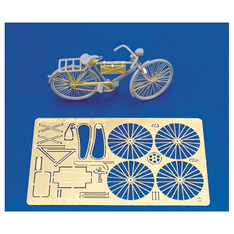

11 minutes ago, aurfalien said:
Hi,
Well in an effort to help, I've emailed a company named Royal Models regarding dimensions as they've a 1/35 WW2 era bicycle;
Good man. Worst they can say is "no".   :D

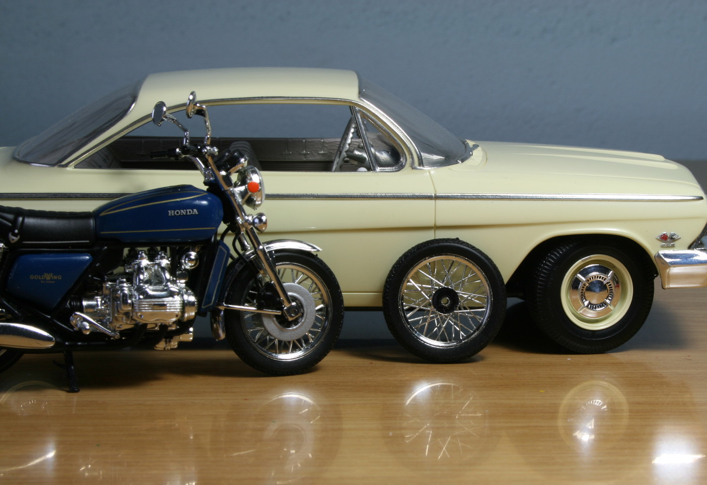

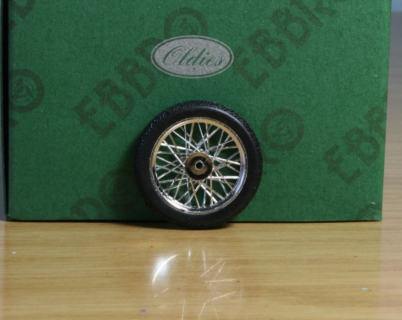

Last year I bought some very nice Ixo 1.24th motorbikes, including this Honda Gold Wing. I dropped the Honda on the floor (as you do) and it disassembled itself, freeing the front wheel. I'd only paid $14 with postage so I ordered another one, the bike in the 2nd pic.
It then occurred to me that these wheels would look better on my Revell Outlaw than the kit items. Unfortunately, the back wheel is different, as it is on the prototype. But if I ever get round to building the Outlaw I will drop the 2nd Honda on the floor and have a matching pair!
(The Ebbro box has nothing to do with this and the Chevy is there to show scale. And no, I'm not really suggesting this as a sensible solution.)
