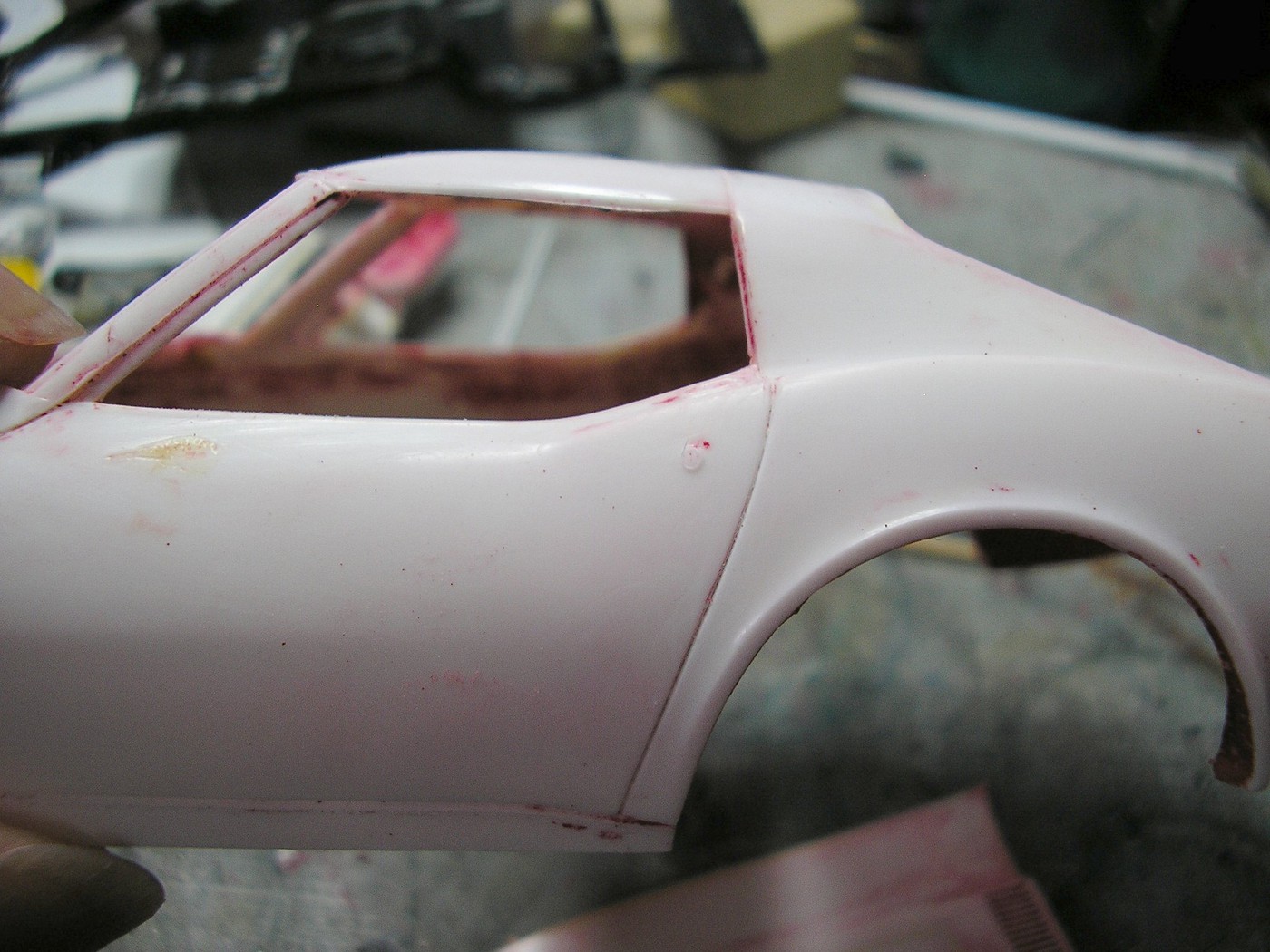

MrObsessive Posted November 11, 2018 Posted November 11, 2018 (edited) I've become a bit burnt out on building the Shelby, so for a diversion I ran across this rather forlorn MPC '74 'Vette I came across on the 'Bay. For $20 this wasn't a bad deal, but it's fought me along the way on certain details. Here's where I am so far with pics and descriptions............. Not a bad looking car at all for $20, but looks were a bit deceiving as I would find out. Not terribly put together and not a total glue bomb, but this would need to be totally taken apart and pretty much done over. Â Thread for spark plug wires! I chuckled when I saw that as this pretty much gives away when this model may have been built. I'm figuring at least when the 1:1 was new or just a bit later. Â Â Â OK, this is something I dread when I get a built up! Someone used a bit too much tube glue (the worst thing for windows) and over the years, the glue is still eating its way through the plastic, resulting in the sink marks you see here. The glass was of the 'runner' type and sure enough that's where this was mostly glued. Â Â I was able to pop the glass out, but not without leaving some of the runner stuck to the roof. I used my Dremel Moto Tool to grind out the rest. Â Â After the glass ordeal, I sprayed the body with Easy Off Oven Cleaner (yellow can) to get rid of the paint. I put the body and hood into a sealed container and let it sit for a day. After some scrubbing with a tooth brush, most of the paint came right off, but as usual there were some stubborn spots. As you can see the body is now pretty much cleaned up as far as the outside. Â Something that's always bugged me about MPC's 1968-77 Corvette coupes is how they shaped the sail panels. The leading edge of the sail panel should extend just a bit beyond the trailing edge of the doors, not meet the door line as you see here. Â Â I got out some .020 plastic sheet and corrected this area. When it was fully dried from the liquid cement, I sanded things down and tried to blend this into the sail panels as best I could. Â Â With the paint totally removed you can see those sink marks all the better-------they stick out like a sore thumb! Â Â Now to attack those sink marks......... I sprayed the roof with a light coat of Plastikote T-35 grey primer, let it dry and got out my trusty Dynatron Putty-Cote. Spread it over those sink marks and let it thoroughly dry. Â Sanded everything away and already this looks MUCH better! BTW, Dynatron is my putty of choice as there's some plastic in the mixture. If you ever need to glue trim or something over the putty, it'll stick right to it with no problem. Â Stay tuned................ Edited December 31, 2018 by MrObsessive

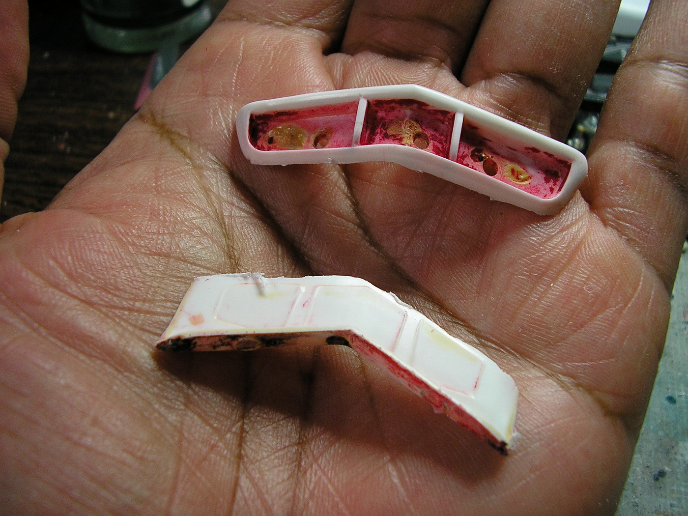

MrObsessive Posted November 11, 2018 Author Posted November 11, 2018 (edited) Â The front bumper cover was also a hot mess. VERY deep sink marks which I don't think are due to glue, but more how the part was molded. Â Â I cut away the lower fascia from the bumper cover as this simply didn't look right when attached to the body. Â Â I glued the lower fascia to the main body, and to me looks much better! It also gives the front bumper cover a more positive locating point. Â Â The windshield would be my next hangup. I simply did not like how the kit windshield was fitting inside the body. You all know how I can't stand ill fitting glass, so I decided that I'm going to try and make a windshield out of clear stencil sheet. Here you can see a pattern I made using a 3x5 card. Â Same for the rear....... I forgot to mention------take note of the scribed in 'split' in the rear bumper cover. This was a one year deal with the '74 and something that MPC forgot to do. For the '75's Chevy figured out how to make this all one piece eliminating that split. Â I thought I would try a technique which I haven't done before, but is certainly needed here in the case of the 'Vette. I want the glass to attach from the outside since the 1:1 has near flush fit glass. After MANY tries doing this however frustration began to set in........ Â Here's the pattern for the glass to fit from the outside. The trouble I've run into however is the glass does not have the same radii top or bottom. The made is terrifically frustrating to get the stencil sheet to cooperate as it likes to lay in one direction. Â Â Soooo...............I decided to try my hand once again at vacuforming the glass. I haven't done this in nearly three years since the '59 Chevy, so I figured I needed to brush up on putting this to use once more. Â Â Here's the buck I made using .020 sheet plastic, making a sort of Teepee shape and filling the inside with Plaster of Paris. Â Â Here's the result of the vacuforming and so far so good. This was not without trying five or six times till I got it right. I recommend if you ever want to get into making your own glass via vacuforming, make sure you have PLENTY of .020 Vivak (PETG) sheet on hand! Â But wait there's more! Stay tuned.................... Edited November 11, 2018 by MrObsessive

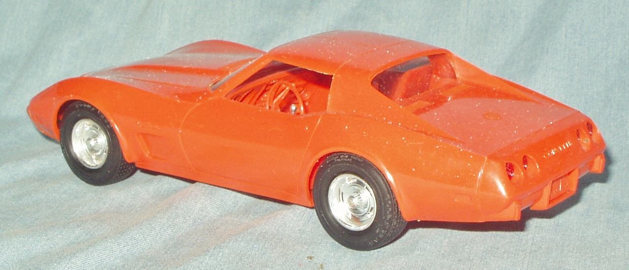

Snake45 Posted November 11, 2018 Posted November 11, 2018 VERY cool project, I am so digging it!  And your pics and your explanations of what you're doing are excellent--thanks so much! At the moment, I'm working on a '75 promo, molded in orange. Won't hijack your thread but here's a couple pics of what I started with. Looks like I bought this in 2016 at the local toy show and I don't remember the price but doubt I paid more than $20 for it. I am polishing the orange plastic, which of course brings problems of its own. The rear bumper on mine "fit" so badly it looked like a separate piece badly assembled, but it's all one piece (with the body) of course. I spent several evenings filing the deck lid and rear quarter sides so they matched the bumper perfectly without all the waviness and humps it came with . This had to be VERY carefully done because I'm polishing the bare plastic for the finish. As you mention, the fit of the (separate) front bumper is a nightmare. I have several evenings of careful filing and sanding just to get the top/front edge of the body and bumper to line up. I'm finally pretty close--almost there. The bottom edge of it, where it meets the fenders, is even worse. I'm not gonna cut it apart, as you have, but I will probably end up gluing it in place solid and then filing and sanding the lower edges of the front fenders and the pan to meet, mate, and flow smoothly together, as they should. I think there is just enough meat in the plastic in this area to get away with it, though I might have to grind away a little of the front of the chassis to get that in afterwards. I shaved (filed) down the rear part of the roof a little--maybe .010" or a bit more--which gave it a more accurate profile. (The "new" AMT '70 Corvette kit REALLY needs this done--the rear of the roof is visibly too high on that one.) I'm probably gonna paint the interior saddle/tan, because I'm afraid of black "ghosting" through the orange plastic on the roof. Had that happen with a red Revell '63 Vette I polished up. I can relate to you on having to grind/Dremel out glass. Not too long ago I had to do that on an original AMT '67 Vette glue bomb I picked up cheap. First time I've ever had to do that. I'm pretty darn good at either prying or cutting out glued glass, but this one was just WAY too bad and there was no other way. Thanks again for this thread, and do keep us posted! BTW, there's very little reason to put plug wires on a '60s-'70s street Vette. The big radio shield over the distributor pretty much hides the plug wires anyway. Â
