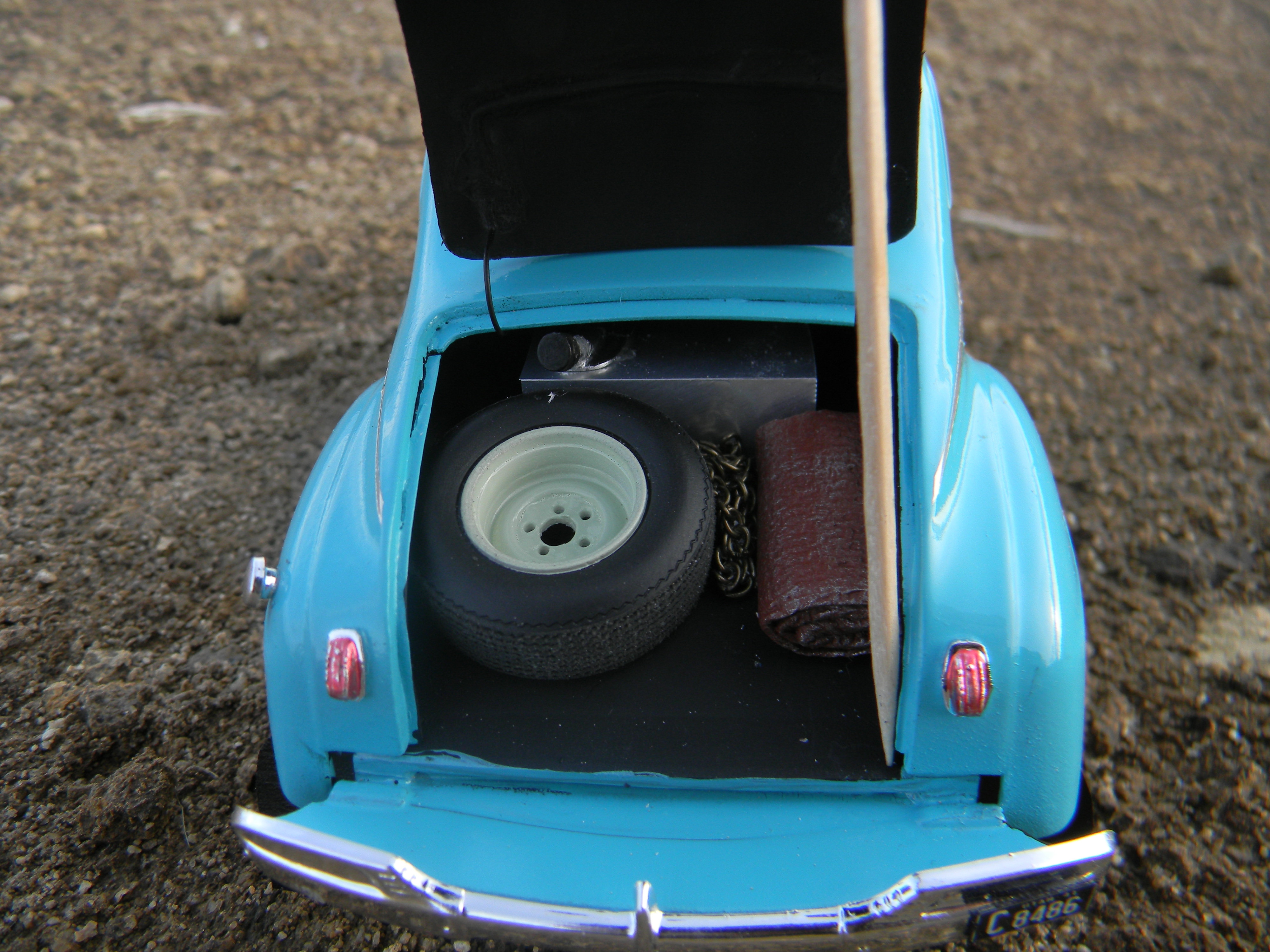

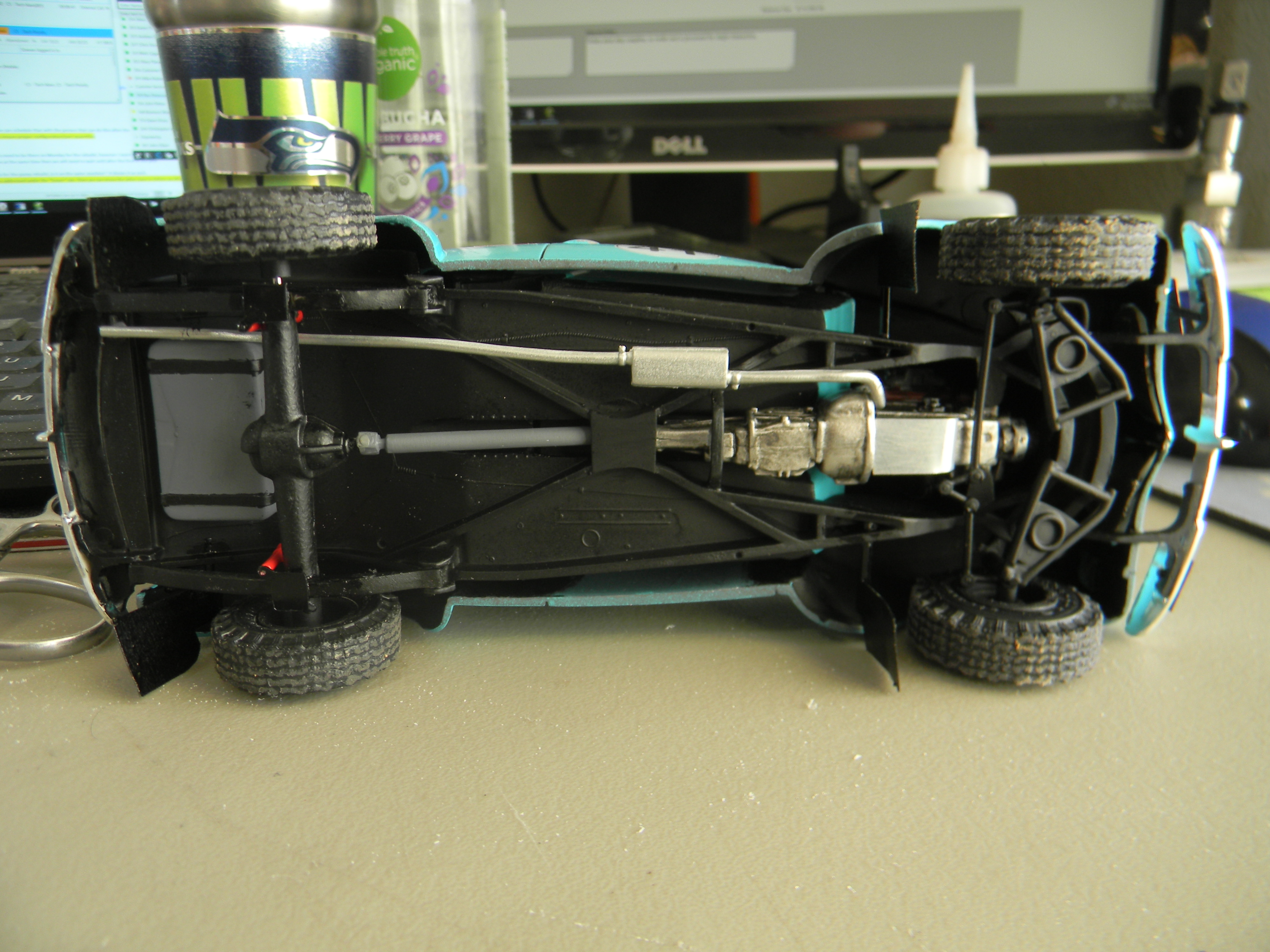

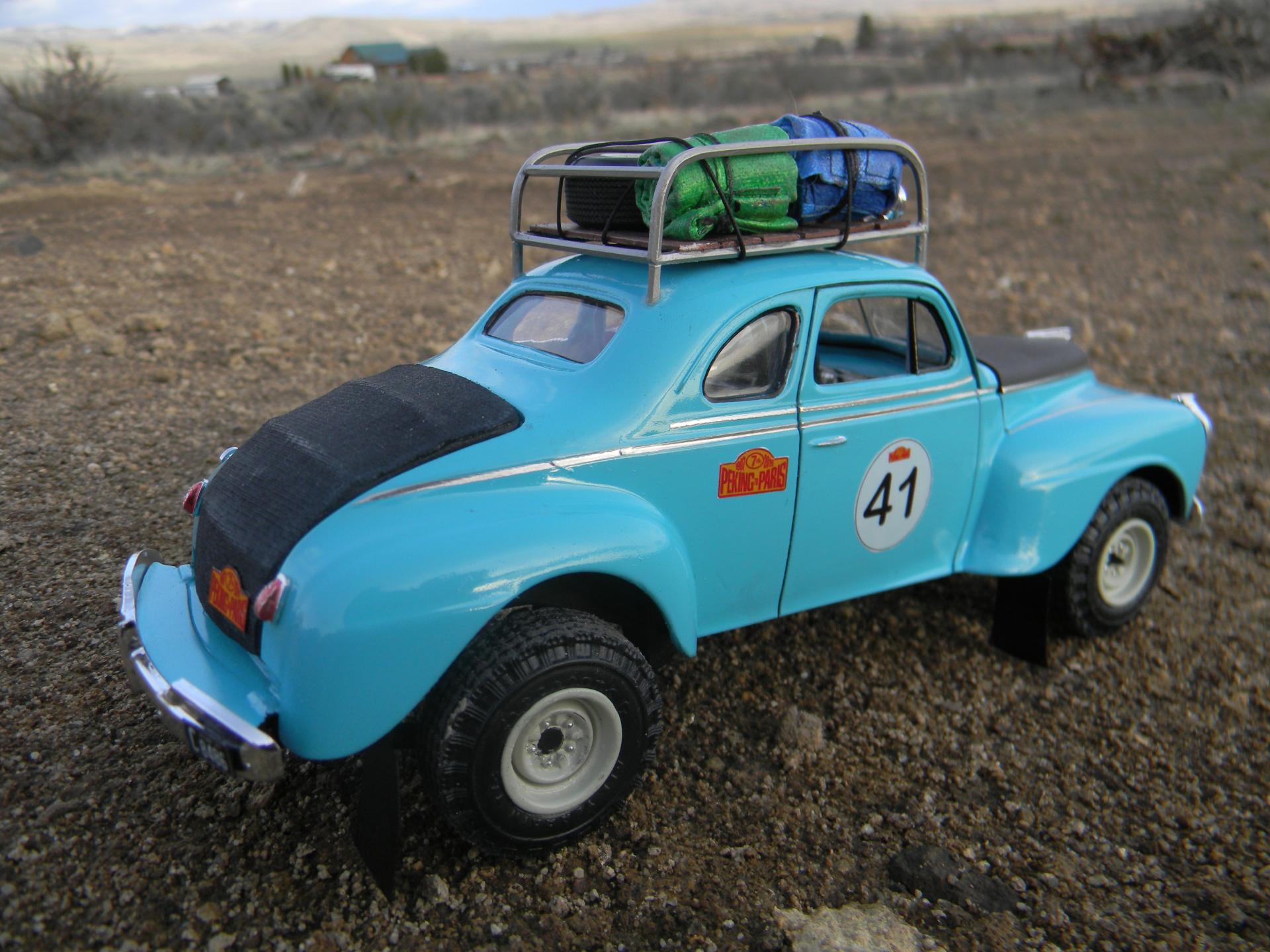

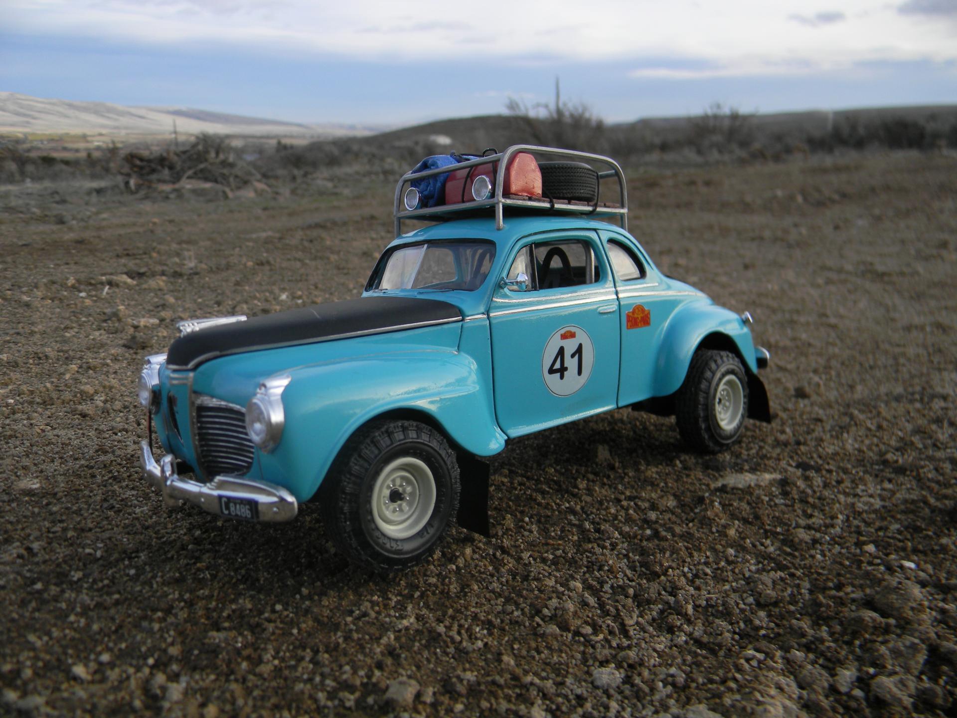

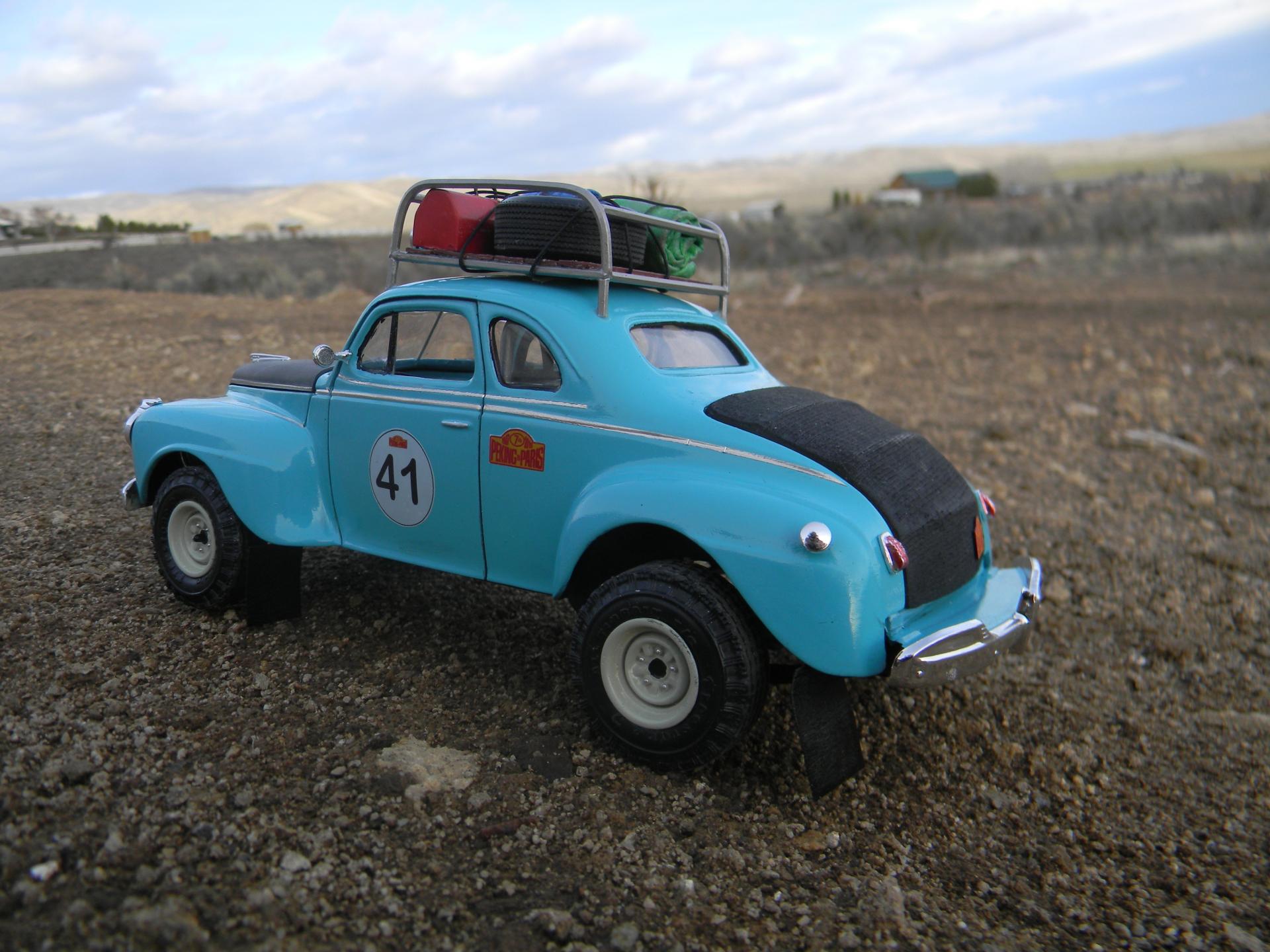

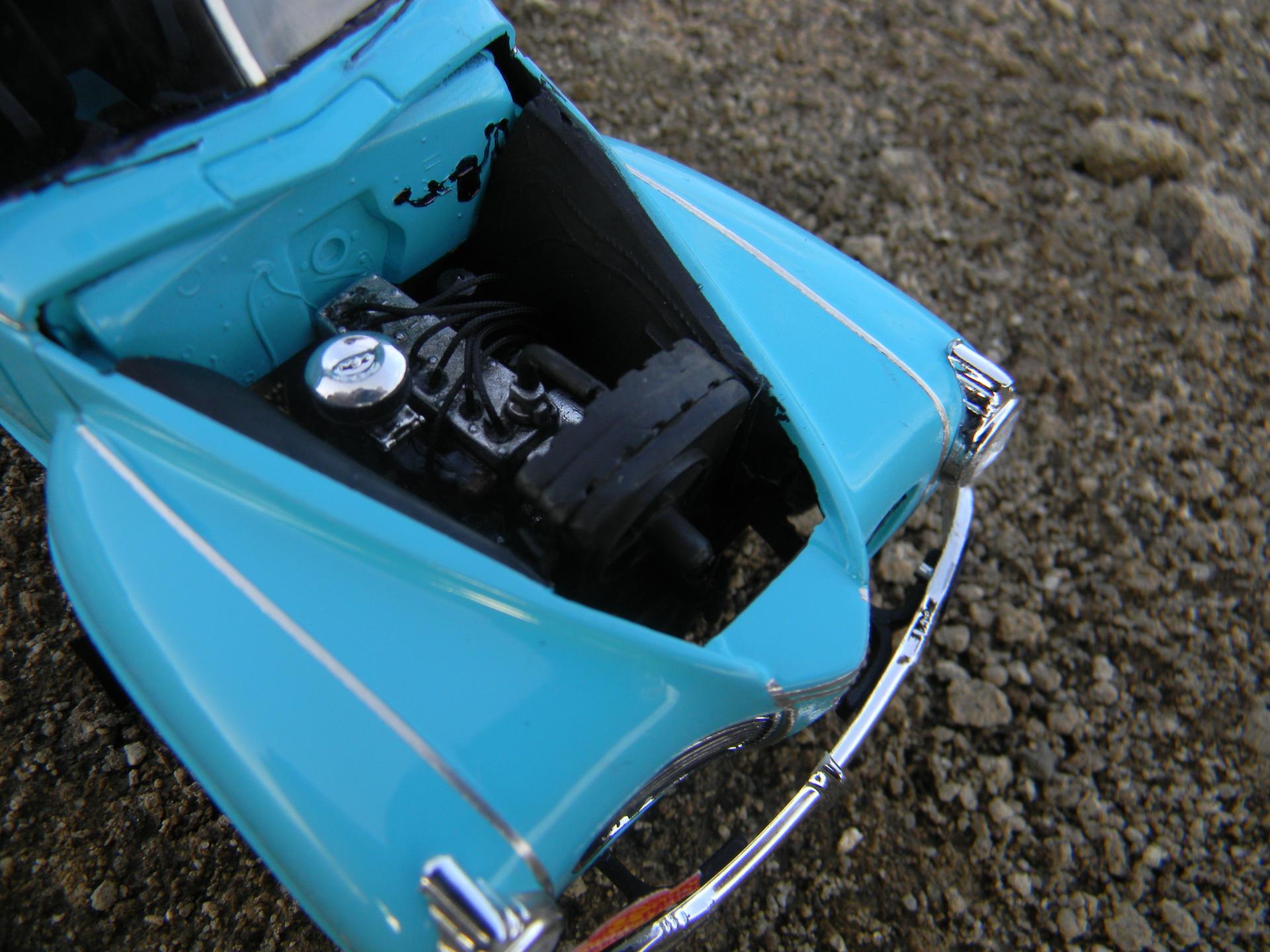

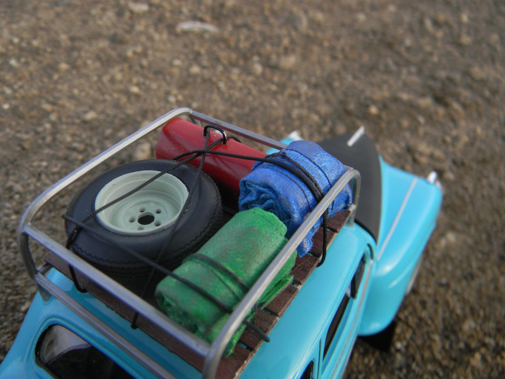

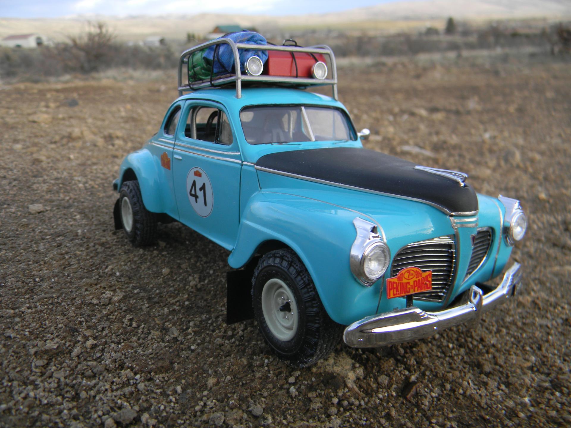

Oldmopars Posted December 12, 2018 Posted December 12, 2018 So, this is my entry into the P2P community build. If you don't know, the P2P is a race from Peking to Paris in Vintage cars, pre-76. I chose a 1941 Plymouth for this race. So, these are the things that I changed, added or modified to make it a race car. For the body, I opened up the fenders, removed the running boards and opened the trunk. Trunk lid was covered in fabric to simulate a skeleton frame with vinyl/fabric cover to save weight. Aluminum Fuel cell in the trunk as well as a second spare tire, chain and a tarp. Suspension was lifted2in front 3 rear for added clearance, custom rear shock mounts and shocks. Skid plate under engine. Stock engine modified with a 4 barrel carb and a open air cleaner, real world this would be a 242 Desoto engine with stroker crank and a low compression for the bad fuel they would encounter. 5 speed Tremic T5 from a Ford was swapped out, new custom mounts fabricated. Wheels and tires are from the AMT rescue van, off road AT tires front and rear. Mud flaps on all 4 wheels made from painters tape. Hood is flat black to reduce the glare, all stock chrome was left and BMF'ed. Scratch built roof rack. Scratch built tool box and 2 sleeping bags for camping. Driving lights for night driving. The interior has been fitted with seats from a Plymouth Prowler, Satellite Phone on the custom center console, CB radio, custom steering wheel, 4 point harness and roll bar, rear seat was removed and replaced with a flat cargo area. I am sure there were other things that I changed of modified, but that is all I can think of right now. I have to say that some of my favorite builds are the ones that I have done for a Community build or other build where I am building to replicate a vehicle that "could have been" like this car, my Cannonball Septic truck, 40 Ford Gasser, etc. Hope you enjoy. Also a big thank you to Pete J. for the awesome decals he supplied.

espo Posted December 13, 2018 Posted December 13, 2018 Looks almost to pretty to inter in such a Rally. I like all the extra details you crafted with the bungy hold downs on the roof rack and the spare and chain in the trunk. Well thought out Rally car.

Tom Geiger Posted February 4, 2019 Posted February 4, 2019 Very cool and in the spirit of the rally for sure! I like that you did the canvas trunk lid like in the photos I saw of the 1:1 cars.
