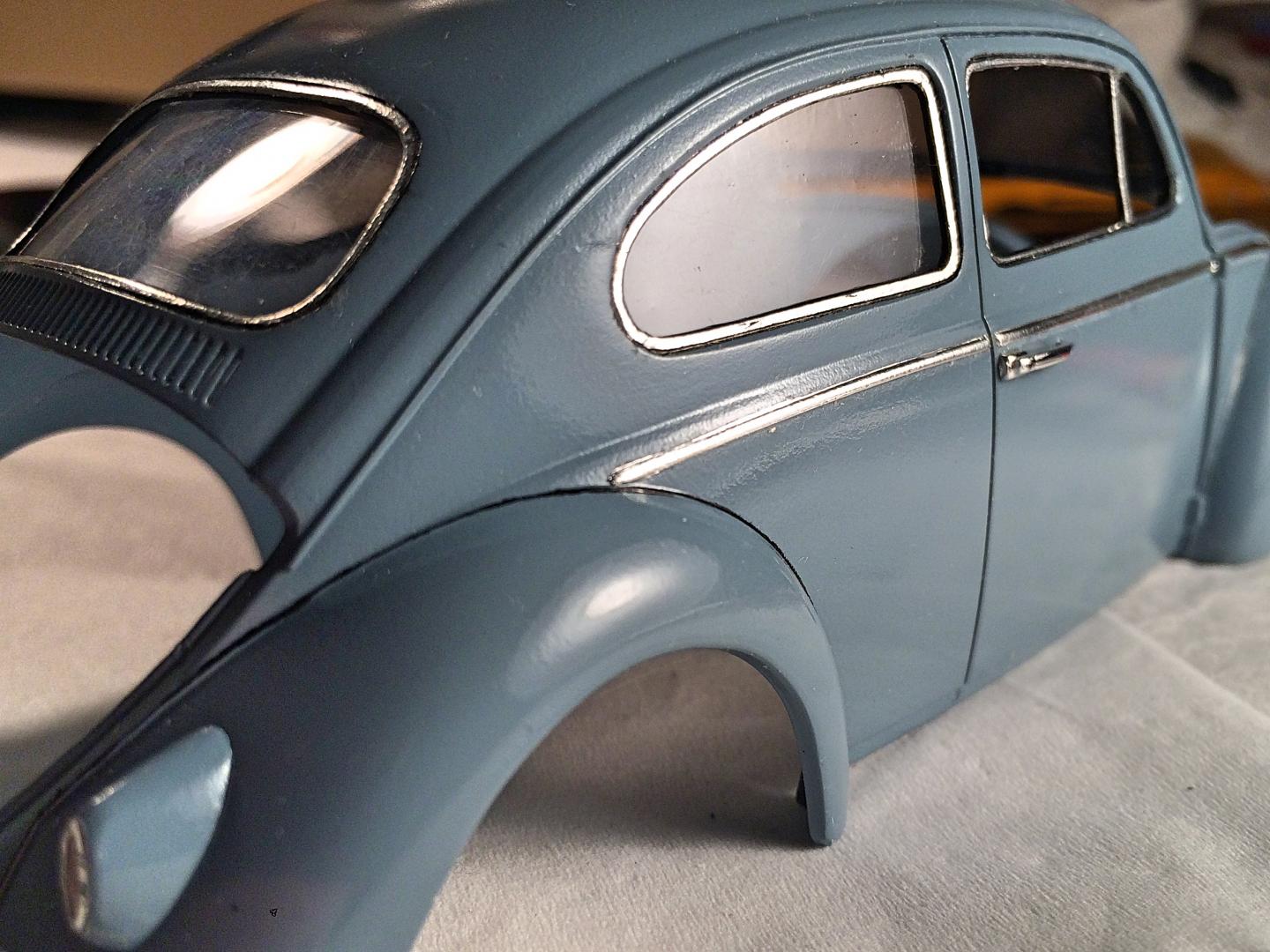

89AKurt Posted February 12, 2019 Author Posted February 12, 2019 13 hours ago, FabbricaP said: Wow, amazing attention to detail and even better execution! Love that body color and the wheels! Thank you! 12 hours ago, Italianhorses said: Wait - the body is done? I was hoping you'd polish the paint. As is, especially with all the other amazing detail you add to this build, it looks a bit "orange peely" - unless this is a desired effect, of course. If you look at factory paint, it's not Future shiny. I always tend to wet-sand through the high points and screw up such a job. Plus I am weathering it as the very first picture shows. So yea. 11 hours ago, cobraman said: I love your added detail. Thanks! I need to stop thinking of new things. LOL 8 hours ago, ATHU said: Wow! Fantastic work so far!! Appreciate it. 7 hours ago, PatW said: Well 89AKurt, this build as an ex 1:1 Beetle owner is superb, I love the wheels especially! Cool, another Bug owner, really appreciate your comment. I'm amused at all the comments about the wheels, thought putting giant Dub wheels and slamming a car was the thing to do.

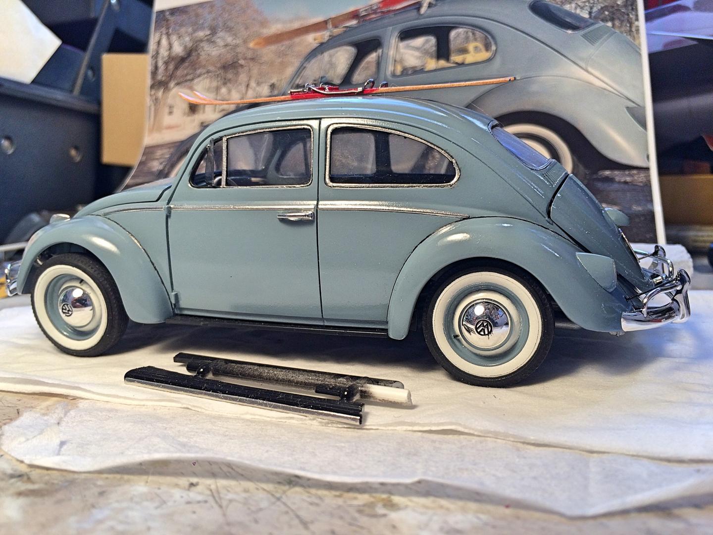

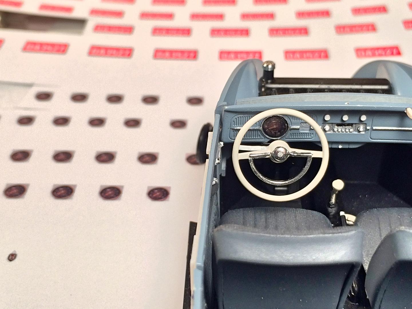

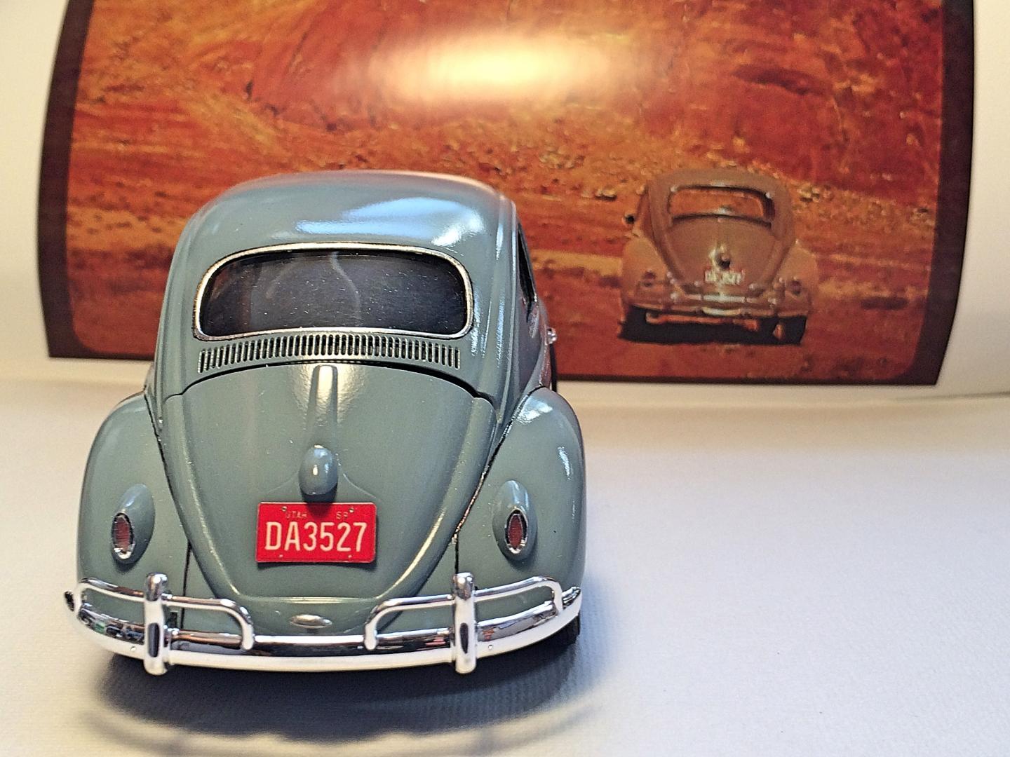

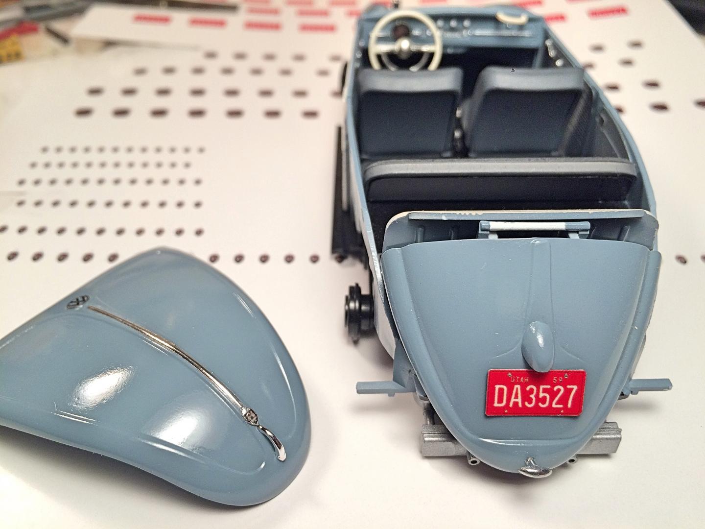

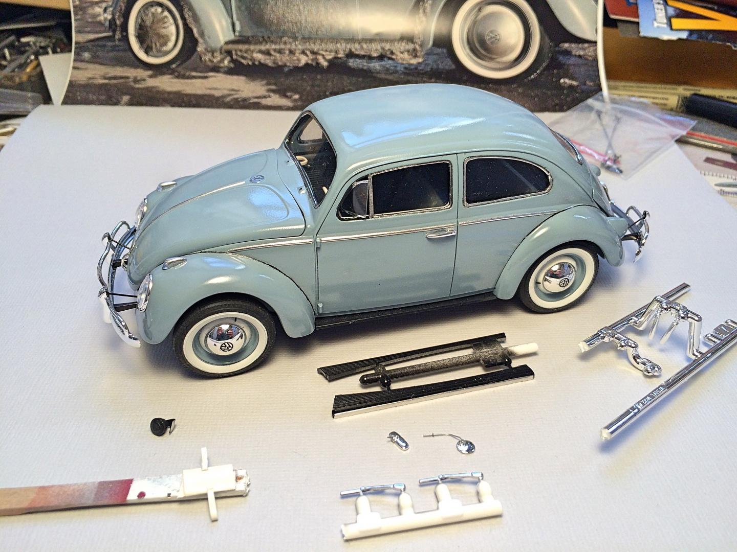

89AKurt Posted February 12, 2019 Author Posted February 12, 2019 Small things today. I got the license plate, speedometer, and Wolfsburg crest printed at Sir Speedy. That is the number, year and state, even added teeny tiny photo-etch screw heads. I took screenshots of pictures, of the Badge and speedometer, had them sized to scale, with extras at 5% larger and 5% smaller. I hated how I painted the speedometer, think this looks 100% better. Started on the door windows. No, it won't roll down. I did think about making the driver's vent operable, but I better not. Molotow pen used for trim, BMF left adhesive and when cleaning off, the foil came off.

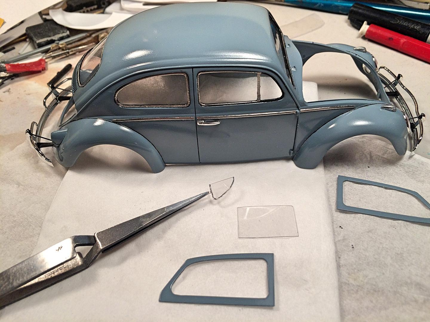

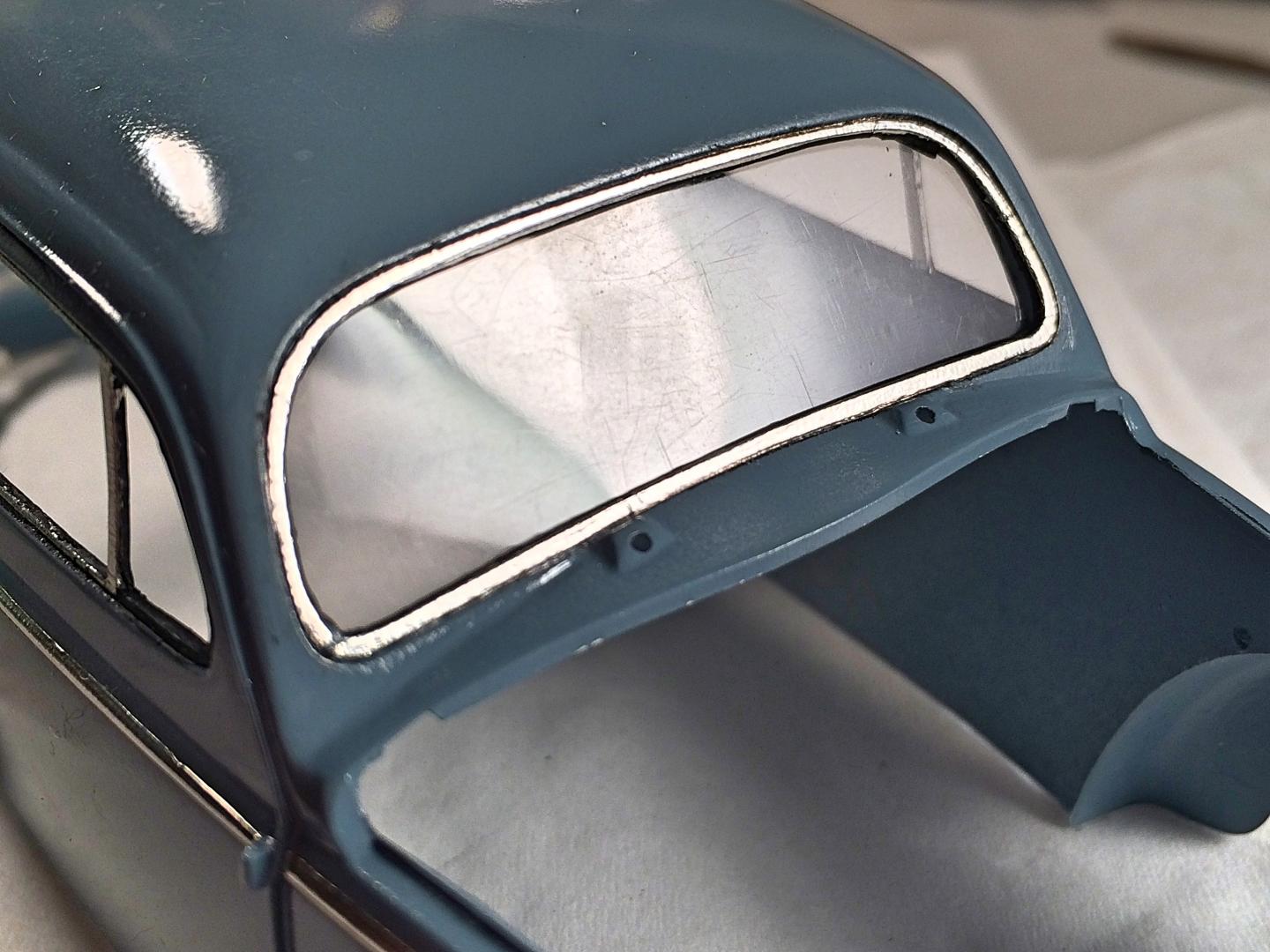

Dann Tier Posted February 12, 2019 Posted February 12, 2019 On 2/11/2019 at 11:04 AM, 89AKurt said: LOL I continued last night, to work out window installation. I wasn't going to glue in, have goober smears, and/or have them pop in by accident after buttoning up. I made little aluminum retainers (made from newspaper printing plate, it bends easy without breaking like roof flashing). For the back window, which was modified for the smaller opening, it worked best to have the tab the same dimension as the "glass", and beveling the edge to slope towards the center, made it almost a snap-in, just a little bending to keep it in. I'm planning to cover up with headliner paper. I can see faint scratches in the windshield, but it will be weathered with wiper tracks. I'm still pissed about the gouge when the knife went "whip it good!" The Tamiya glass has some distortion, not as bad as Revell or AMT kits, but some around the edges. Windows is ALWAYS nerve wrecking. Even if you weren't weathering the car, I think that fine scratches can actually add realism. Anybody who knows cars, knows how impossible it is to keep them klean, and perfect....only way is if you literally NEVER drive the car. I still think this is looking INCREDIBLE, bud!!! Clever idea with those metal retainers too!!

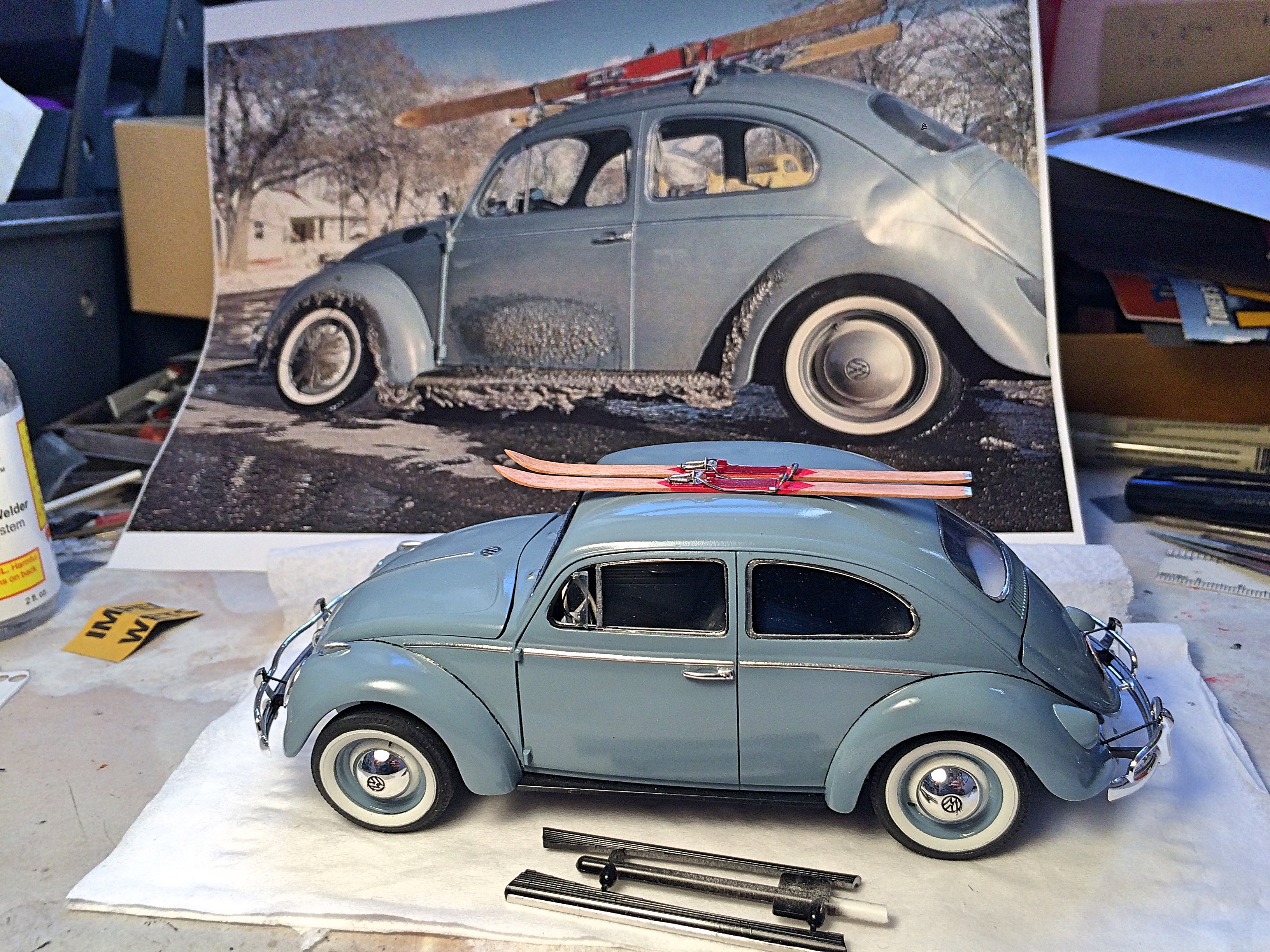

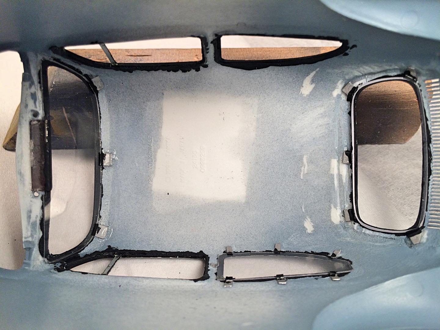

89AKurt Posted February 12, 2019 Author Posted February 12, 2019 Windows are done! Next major step is the headliner. When I made the interior door window frame, I could not measure how much I needed to go below the window, so I guessed, and found out I should have made the gap larger, grrrr. It's getting so close to looking finished. These pictures are the first time I have put the body on the chassis. Funny how the lighting angle, and perhaps editing of the pictures, looks like two different versions of the blue. I made the vent wing in the open position. Just a few kit parts left to glue on. Pet peeve, why didn't Tamiya include the wipers on the chrome tree? The paper I chose for the headliner, was hoping for a cream color, but this has a nice texture. I'm having an interference issue with the engine deck lid, might need to revise the parts I added to the engine. I also want to do something with the hinge, so the lid stays up when opened, thinking of a cam with flat steel spring, but it's at the laying awake when going to sleep stage.

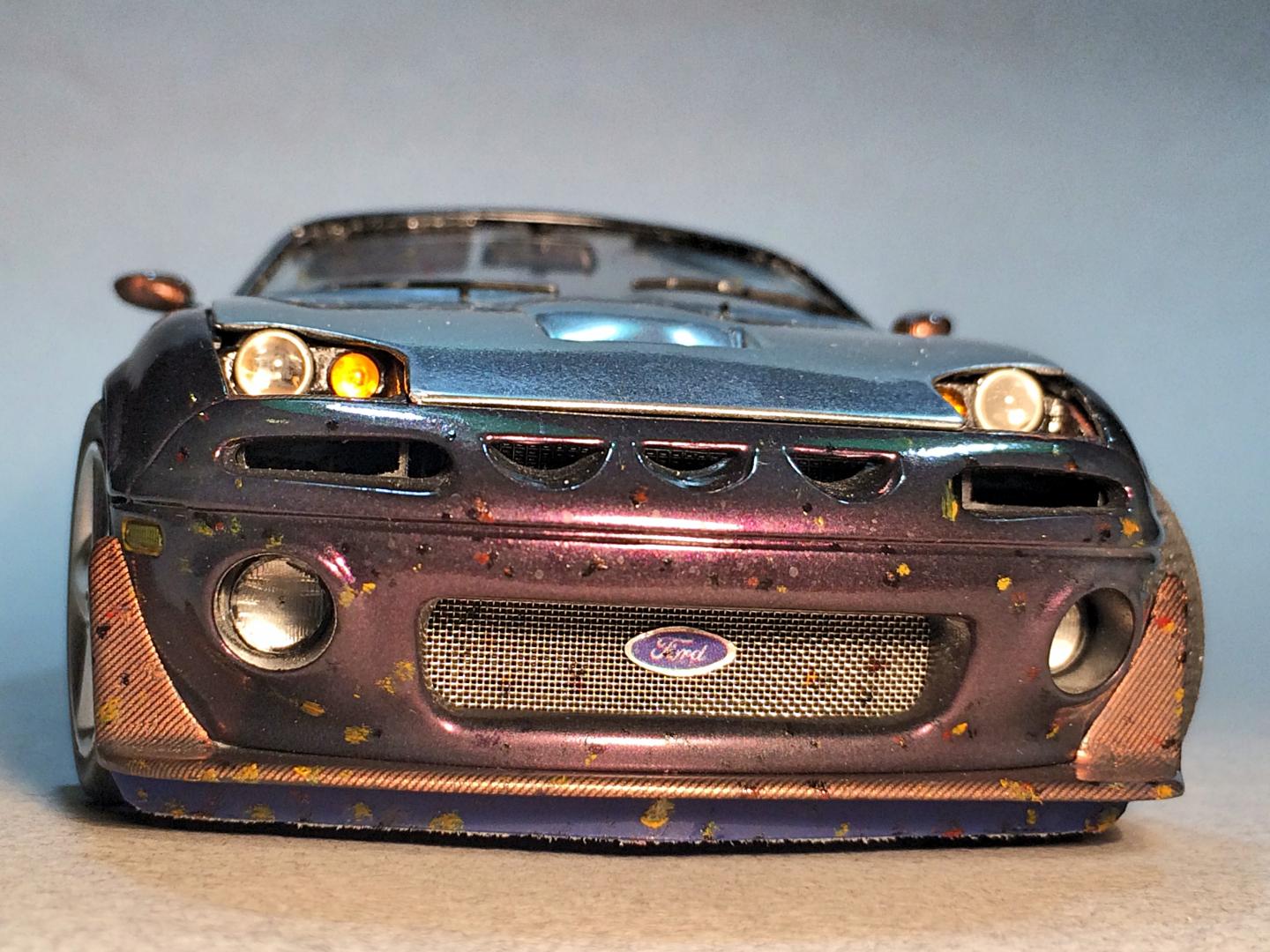

89AKurt Posted February 13, 2019 Author Posted February 13, 2019 6 hours ago, cobraman said: Maybe I missed it if you addressed it but....... your not going to do the snow and slush on that beauty are you ? That's the main reason I'm doing this project! I weather most of my projects, with a minimal dusting at the back and tire/wheels, bug splats, road grime, perhaps rubber specks if the car would ever drift, rally cars would really get dirty, and if a kit is bad I will make it a junker. I'm going to use the product that I used on this diorama, in that case mixed with tan acrylic paint. My evil plan is to mix grey paint, and some ground up charcoal. So stay tuned!

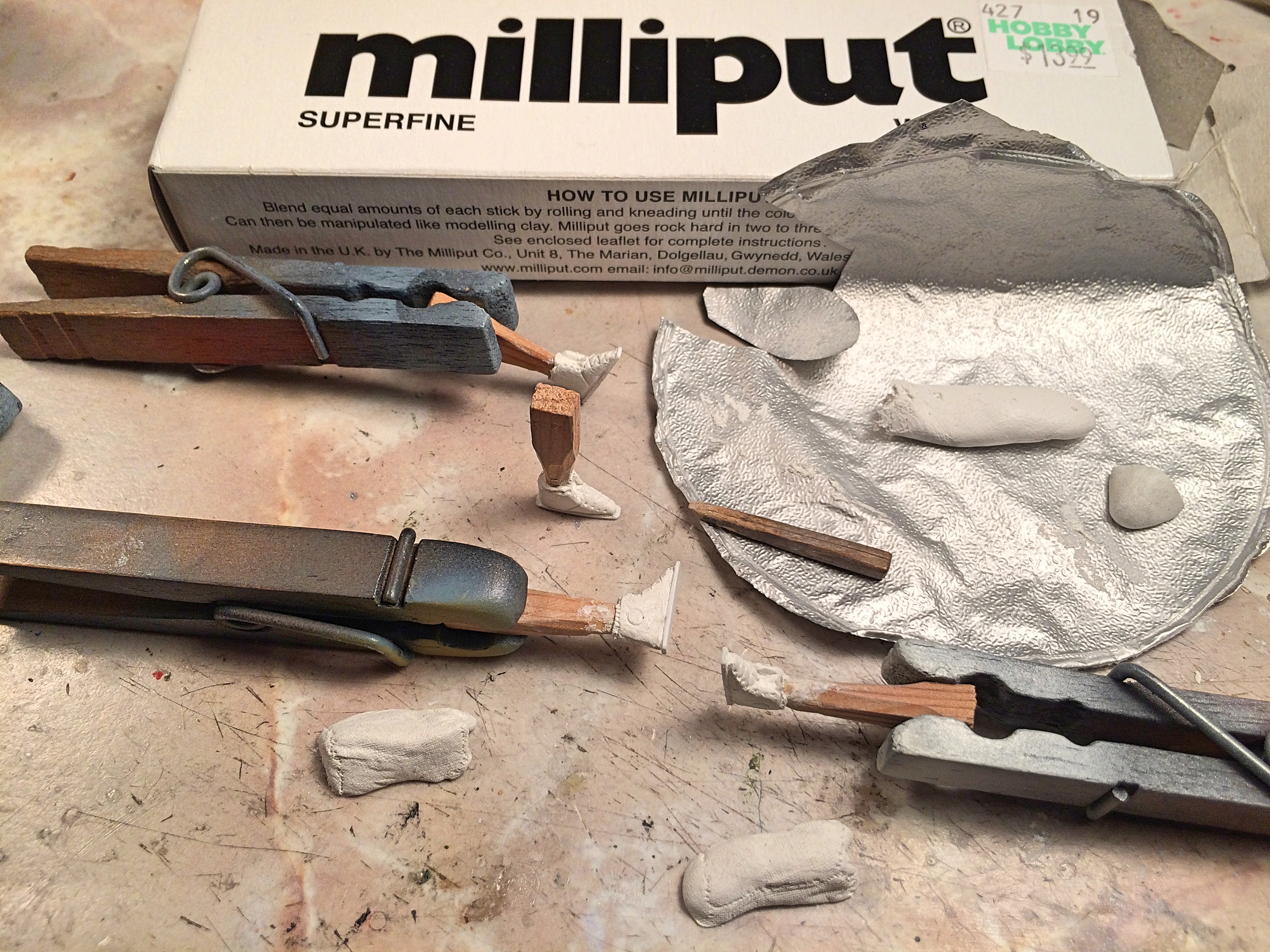

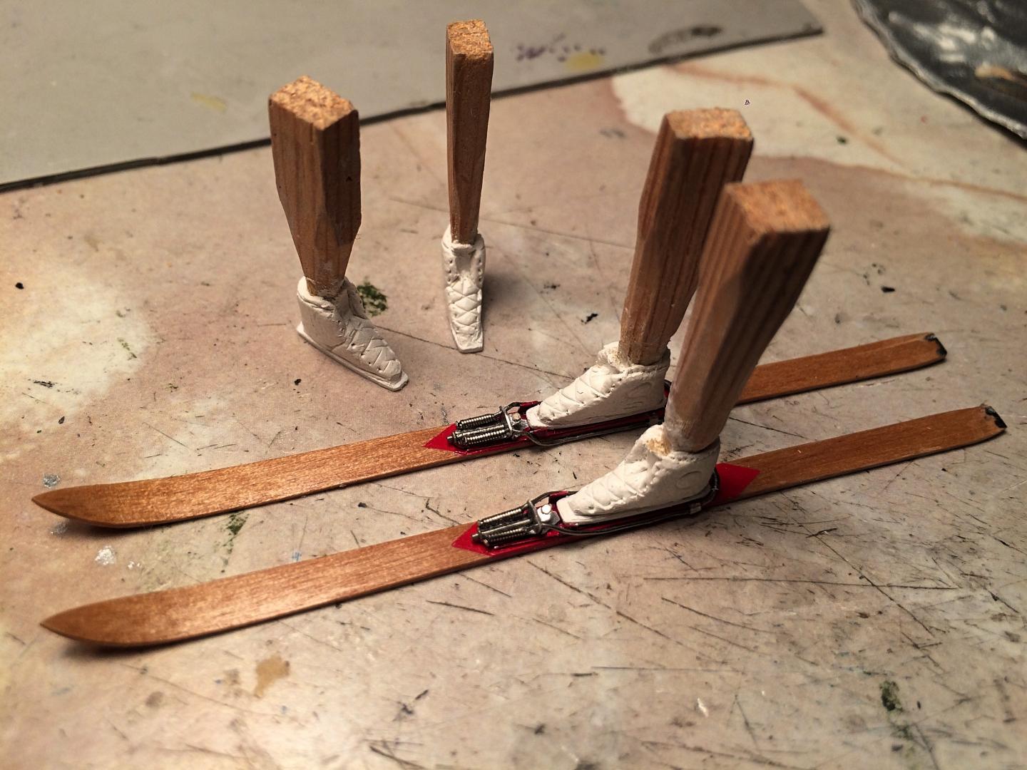

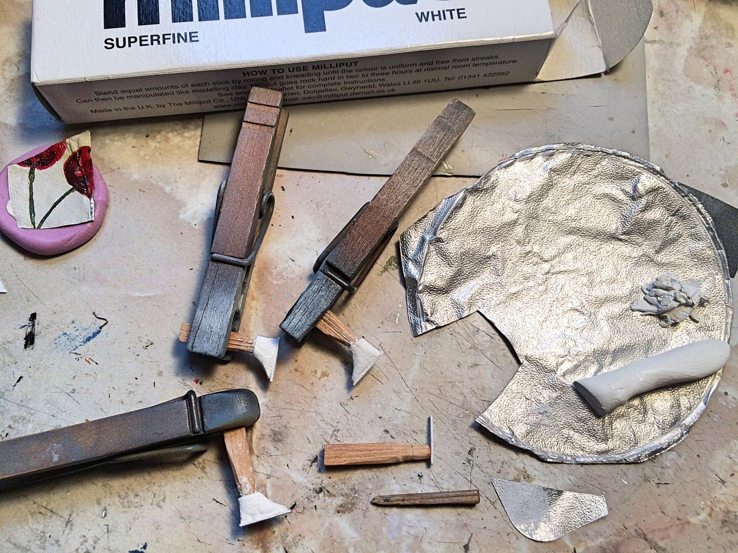

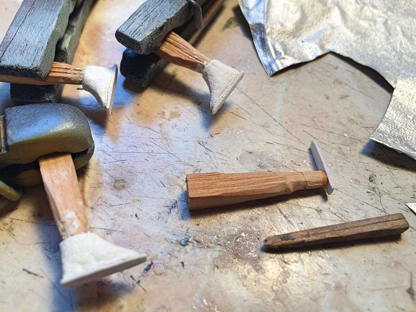

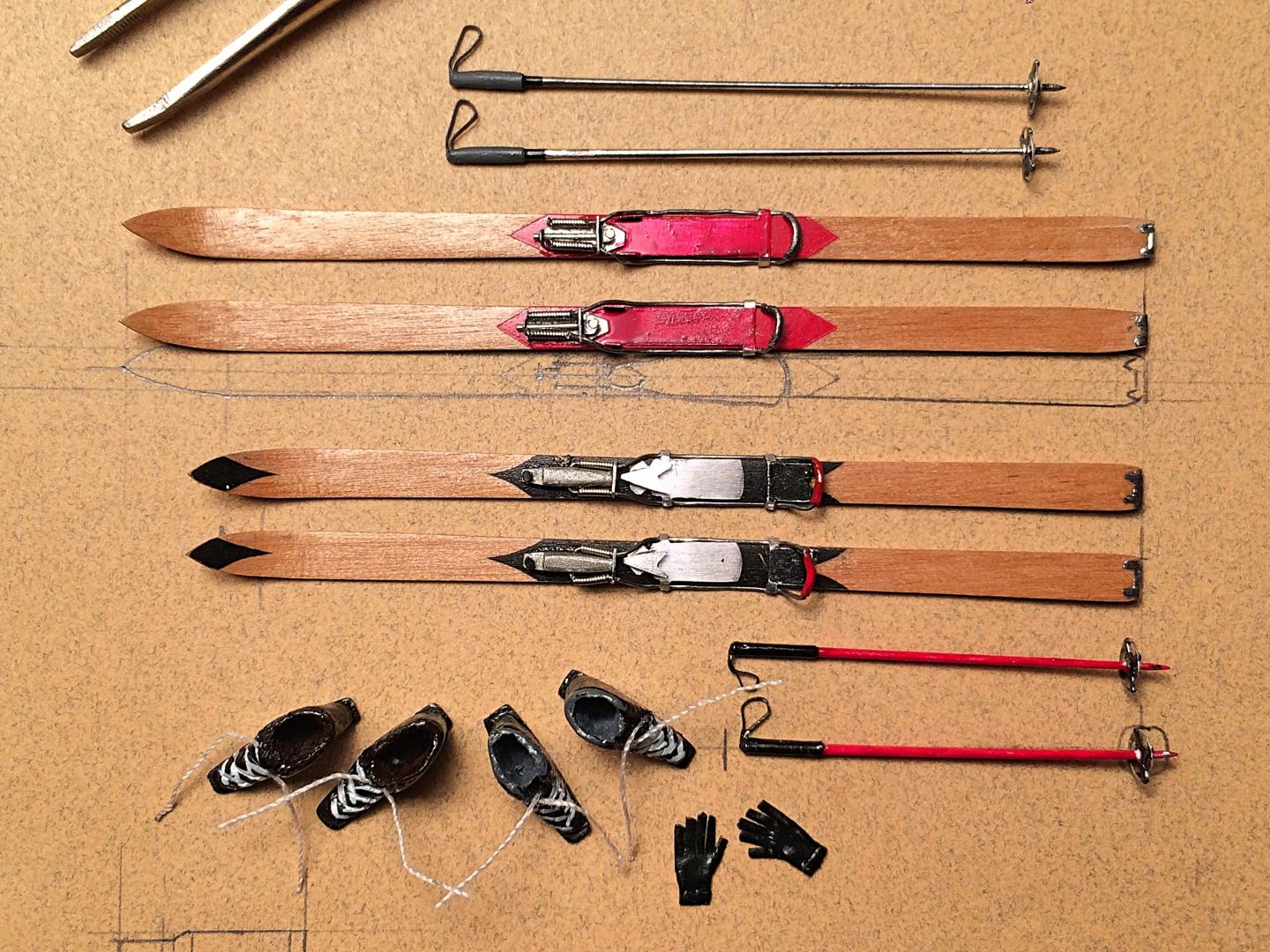

89AKurt Posted February 14, 2019 Author Posted February 14, 2019 Ski boots, first time using Milliput. Started with making cedar "legs", superglued plastic soles on. I liked using this, does not set up fast like an epoxy putty that I've used. Works with water soaked cedar stick, detailed with the Xacto knife, pressed down the yogurt foil for the leather texture. Look forward to routing out the cedar, then a little sanding and painting!

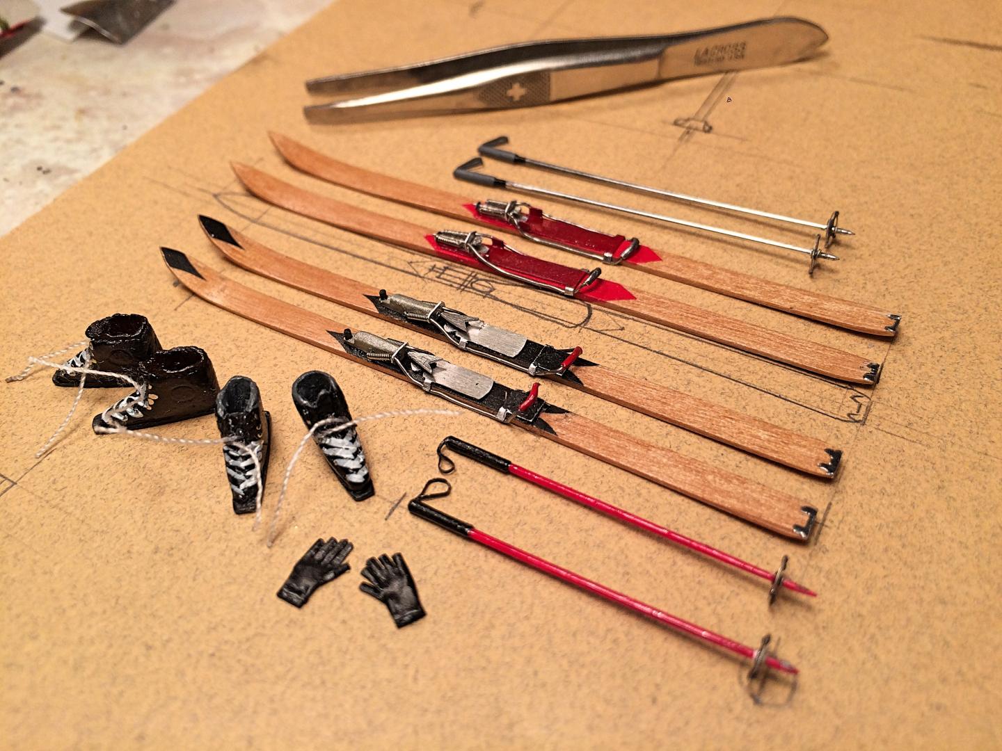

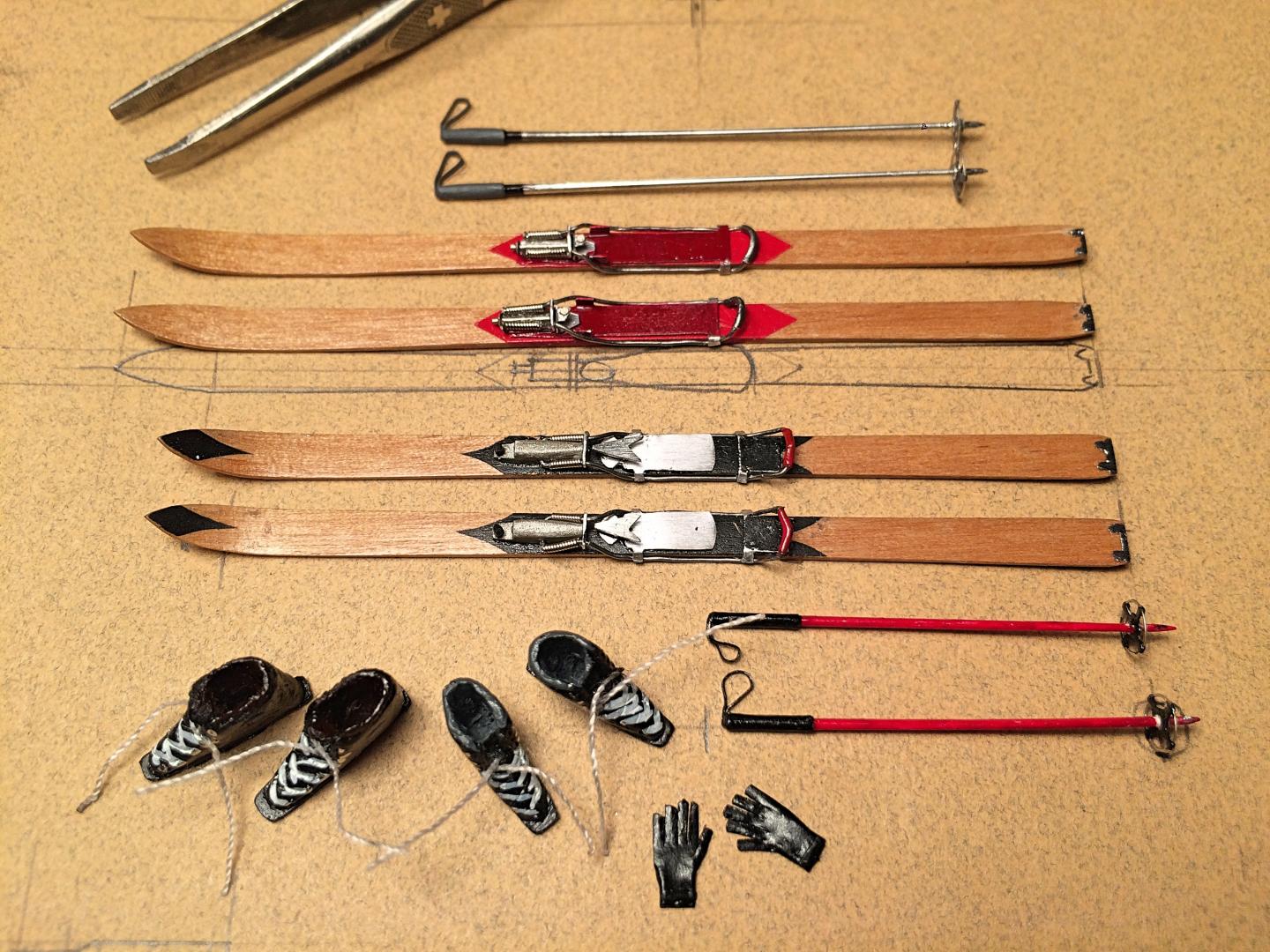

89AKurt Posted February 15, 2019 Author Posted February 15, 2019 Done with the other ski bindings, and boots! Since you can't see the other pair except for the tips, I chose to use these vintage bindings just because. I didn't go too crazy making them exact, but made basic shapes, using two different aluminum plate material, newspaper printing plate (bends without breaking) and roof flashing (thicker and shinier). The ski boots got painted, and thread added which will need to be wet with diluted white glue when placed in the car, so they lay the heck down. So cool having the internet for doing research. Next big thing is the rack.

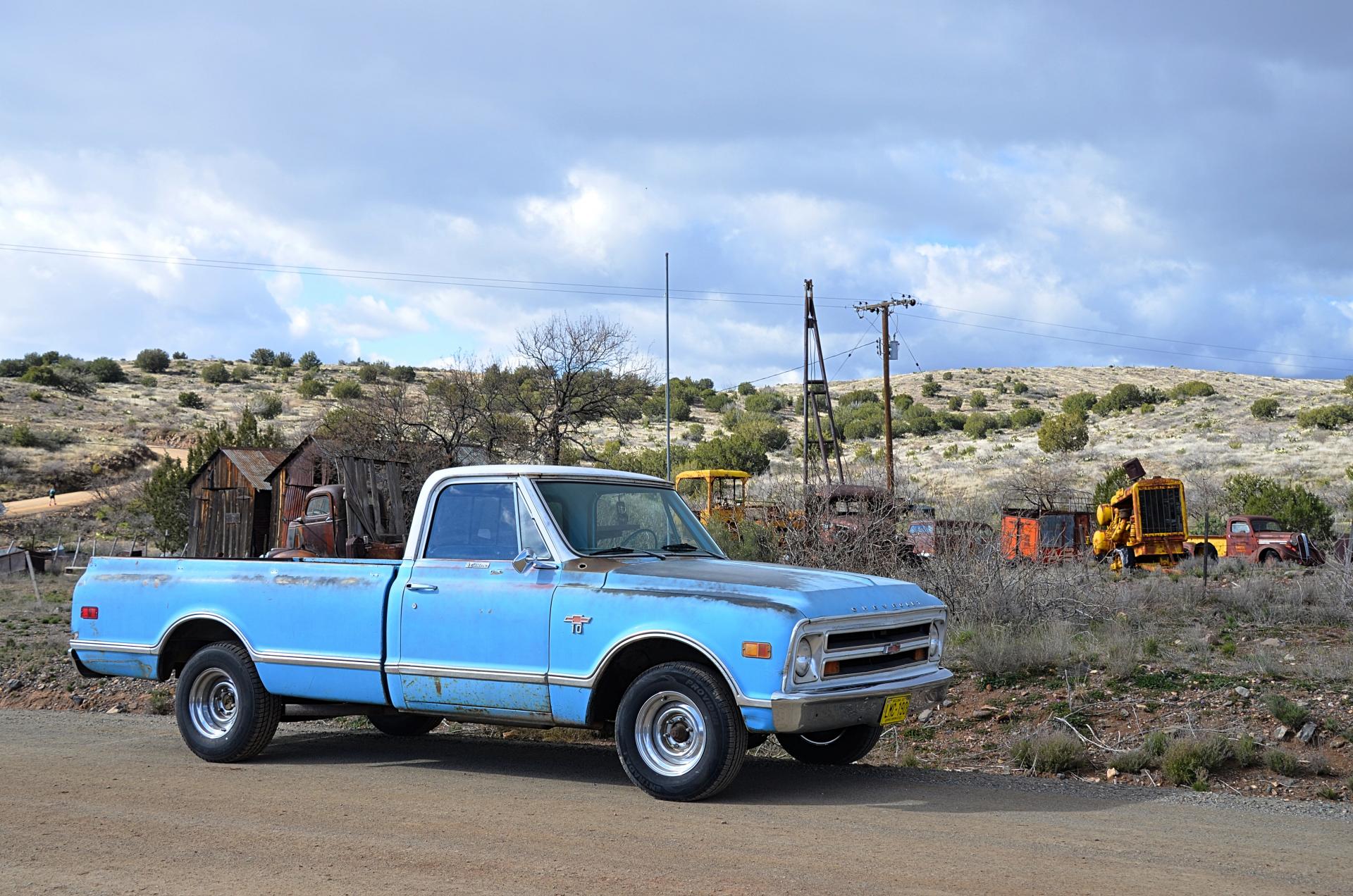

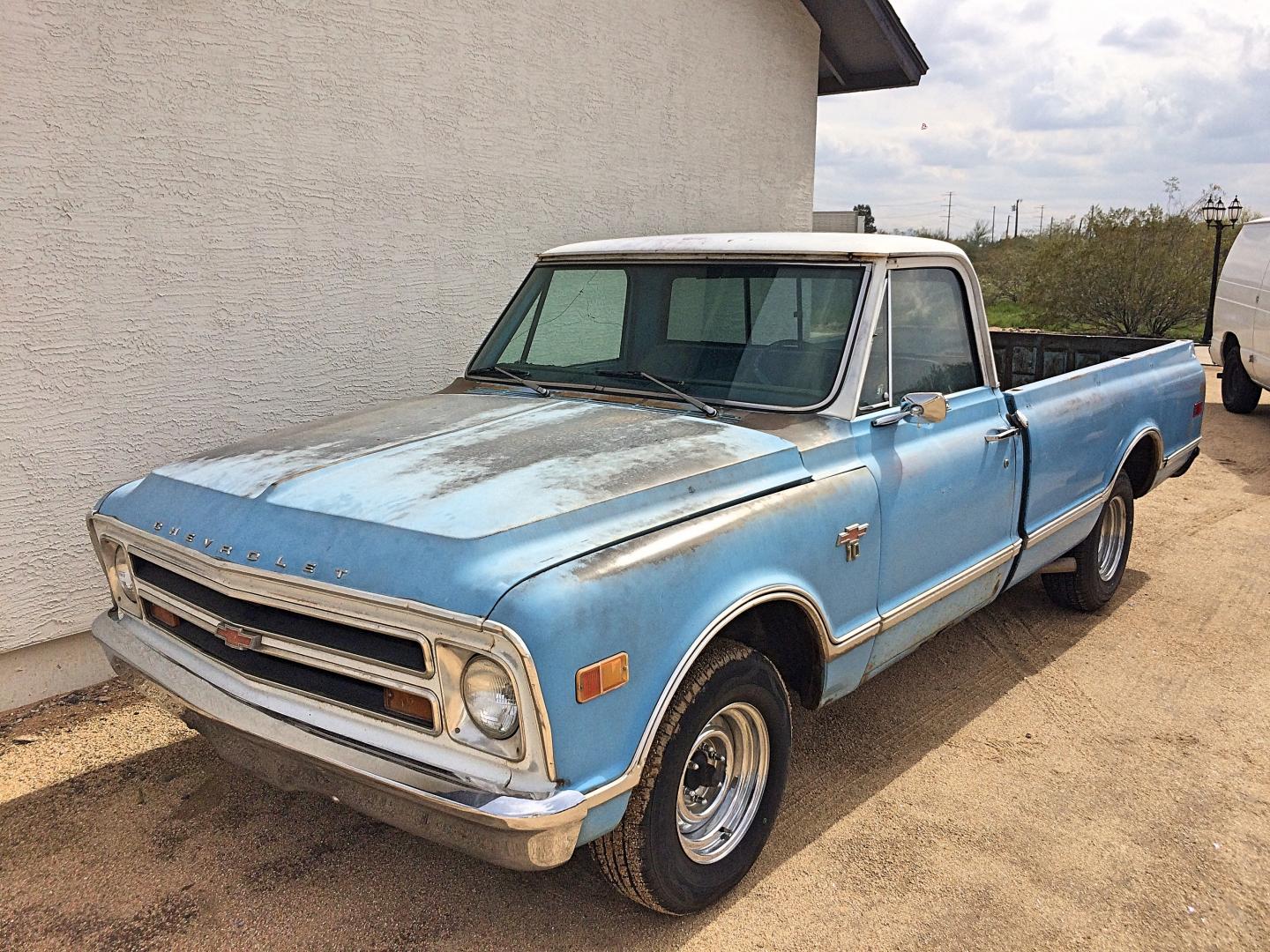

89AKurt Posted February 16, 2019 Author Posted February 16, 2019 Good thing I got this far, picked up another project today.

Deathgoblin Posted February 18, 2019 Posted February 18, 2019 Good looking truck! Looks like it'll make a nice "side project".
espo Posted February 18, 2019 Posted February 18, 2019 Cover it in flat clear and call the exterior done. Just about everything else you could possible need for the interior, chassis, and drive train is readily available. Think of it as a 1:1 scale model. Bonus is that the front end was one of the best designs that GM ever offered.
