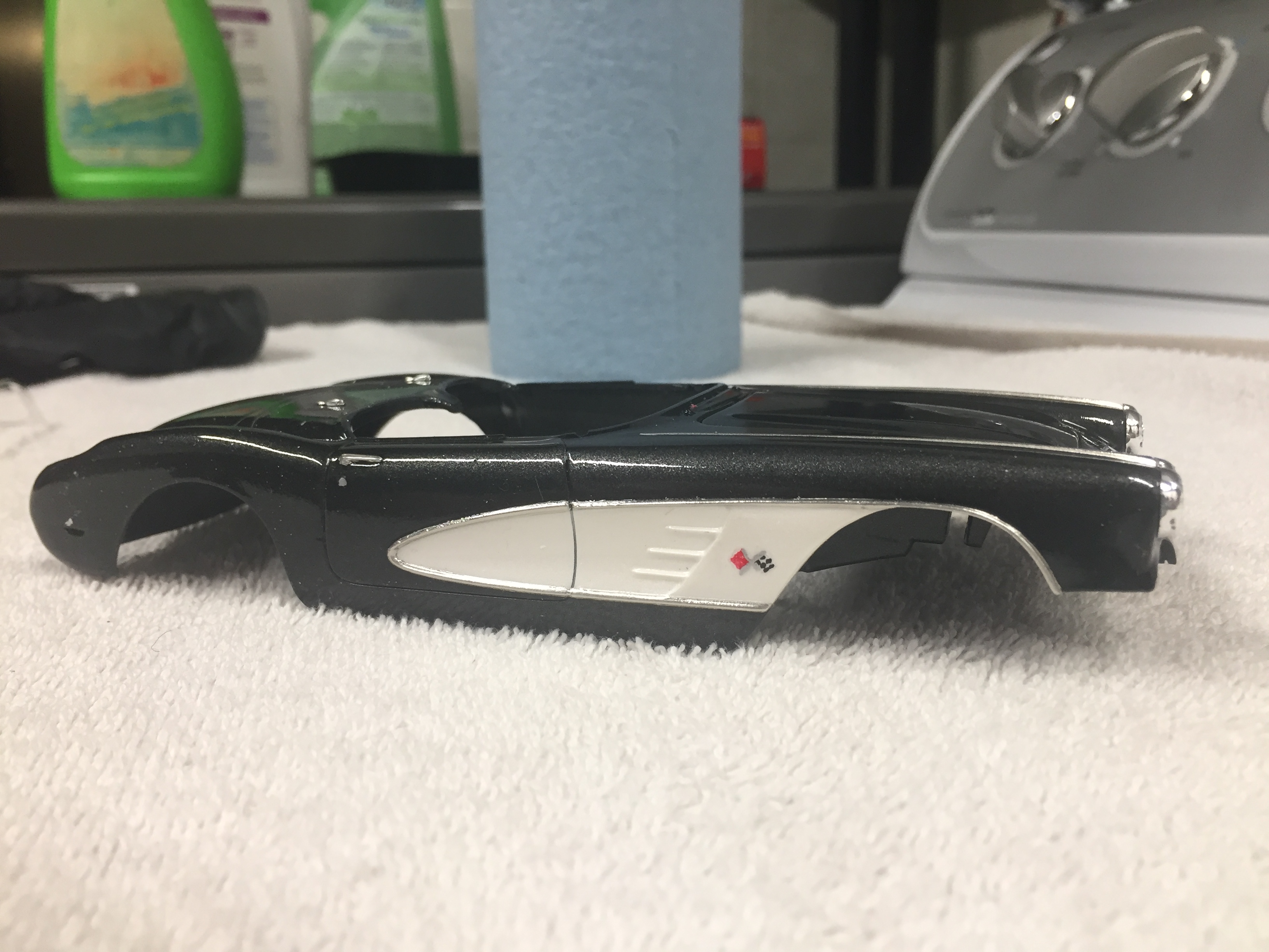

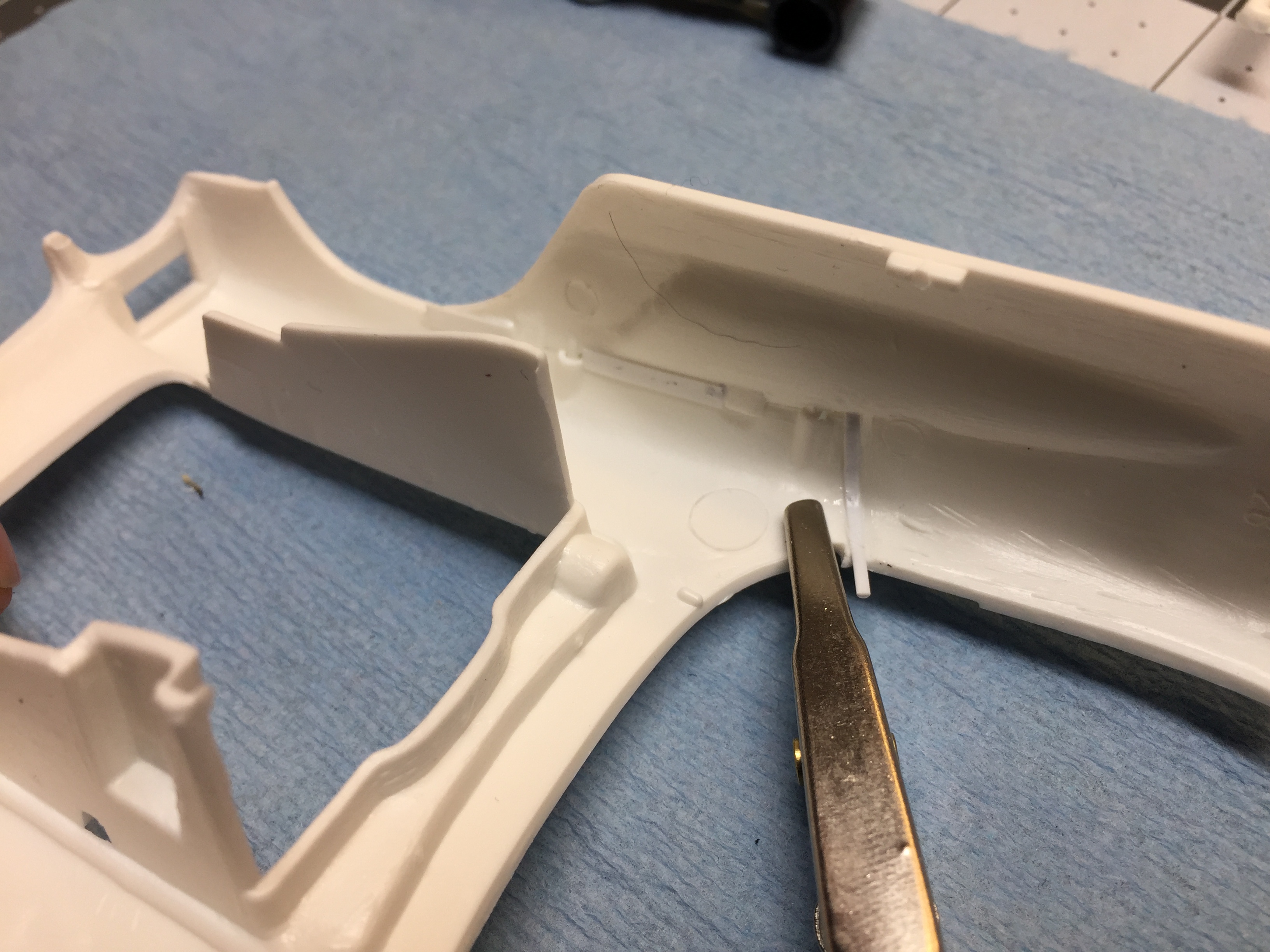

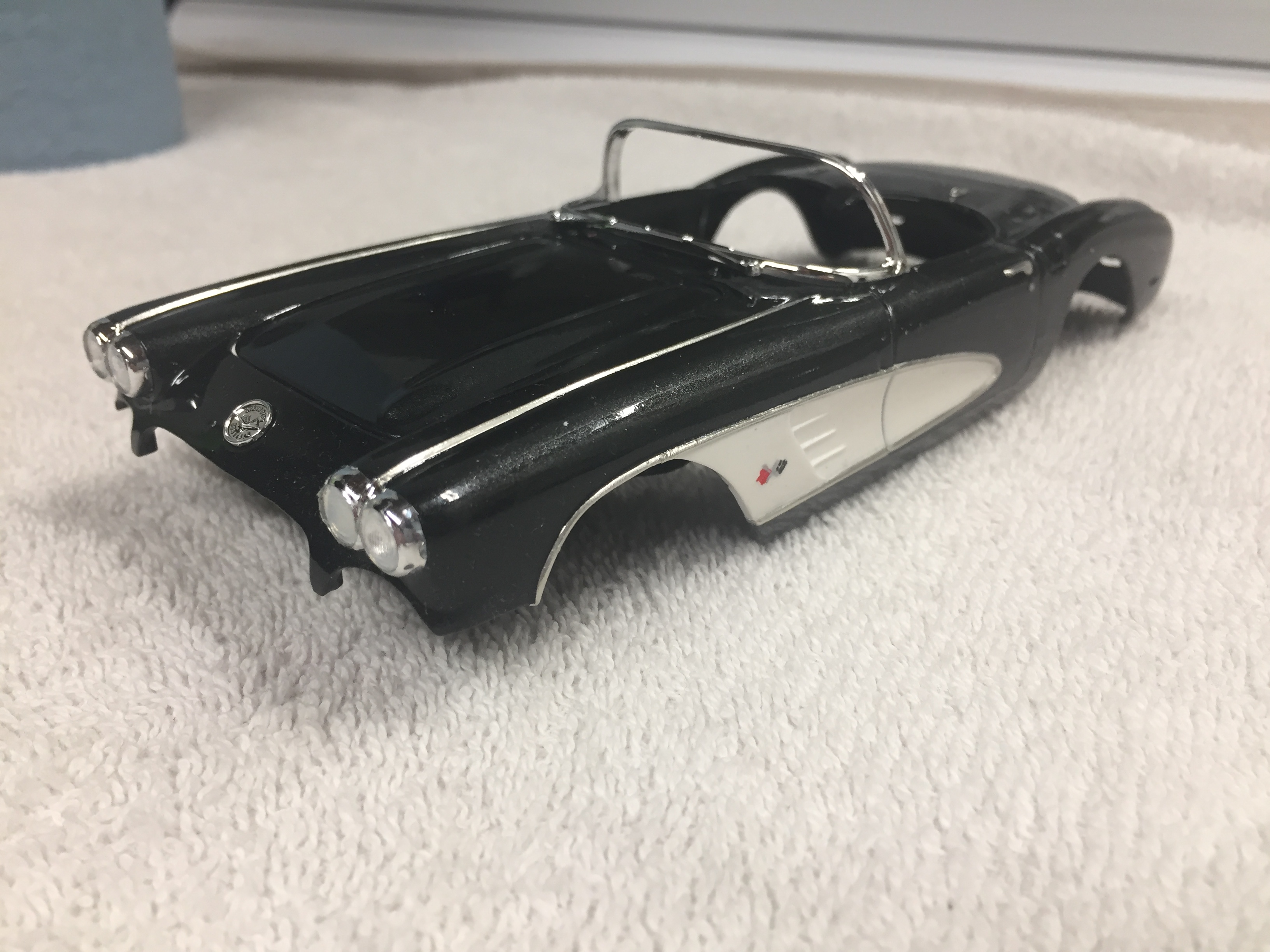

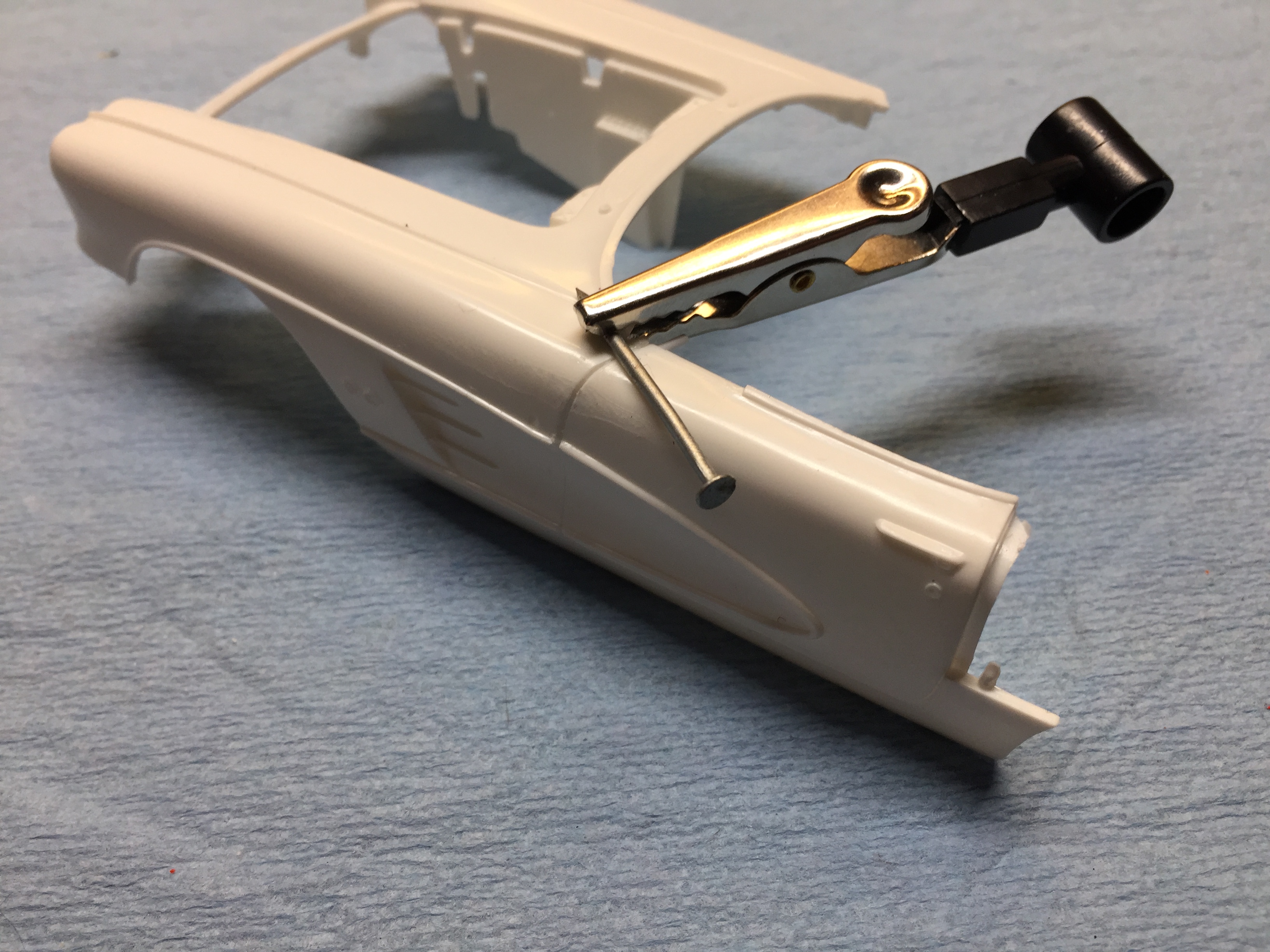

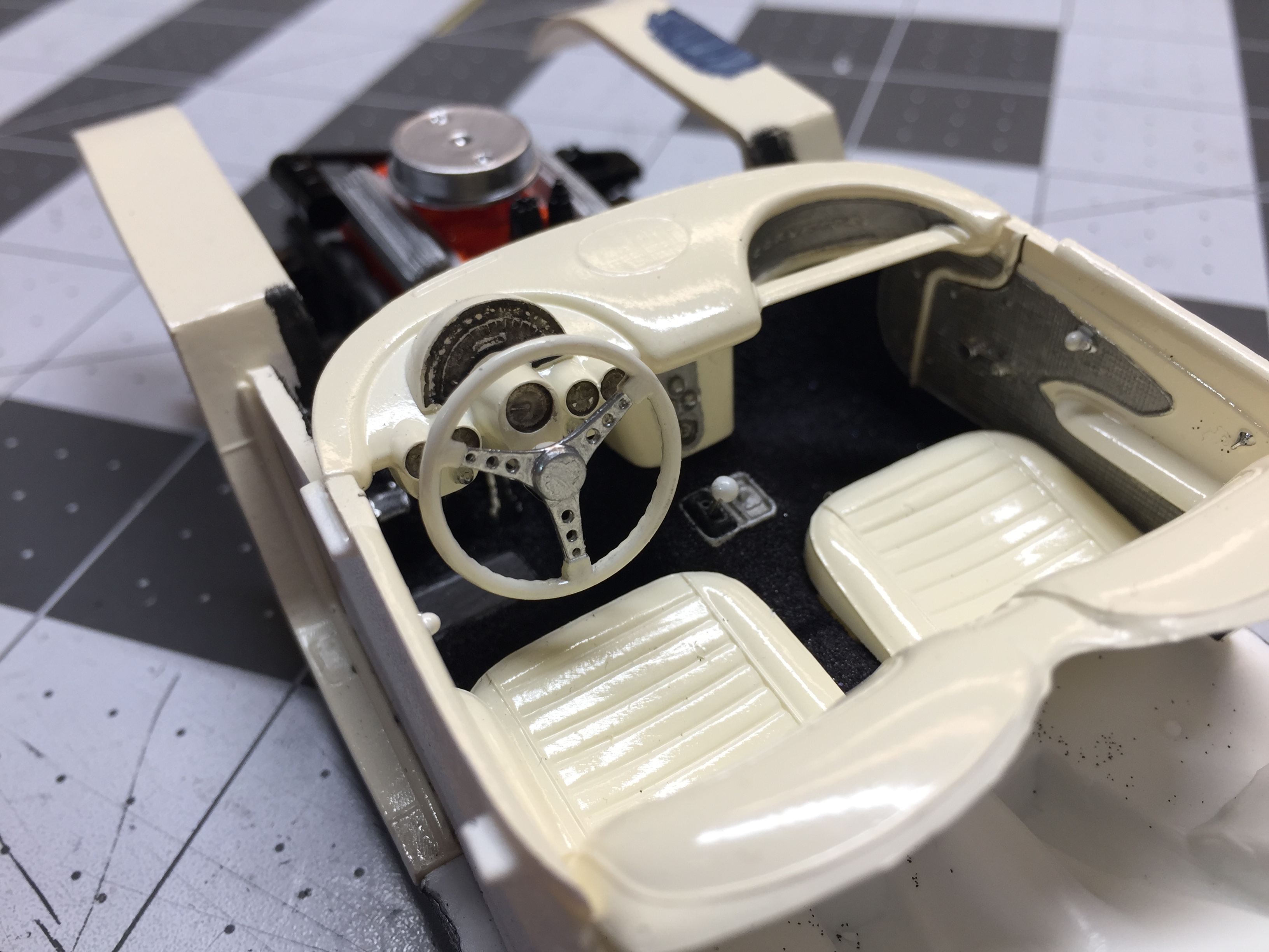

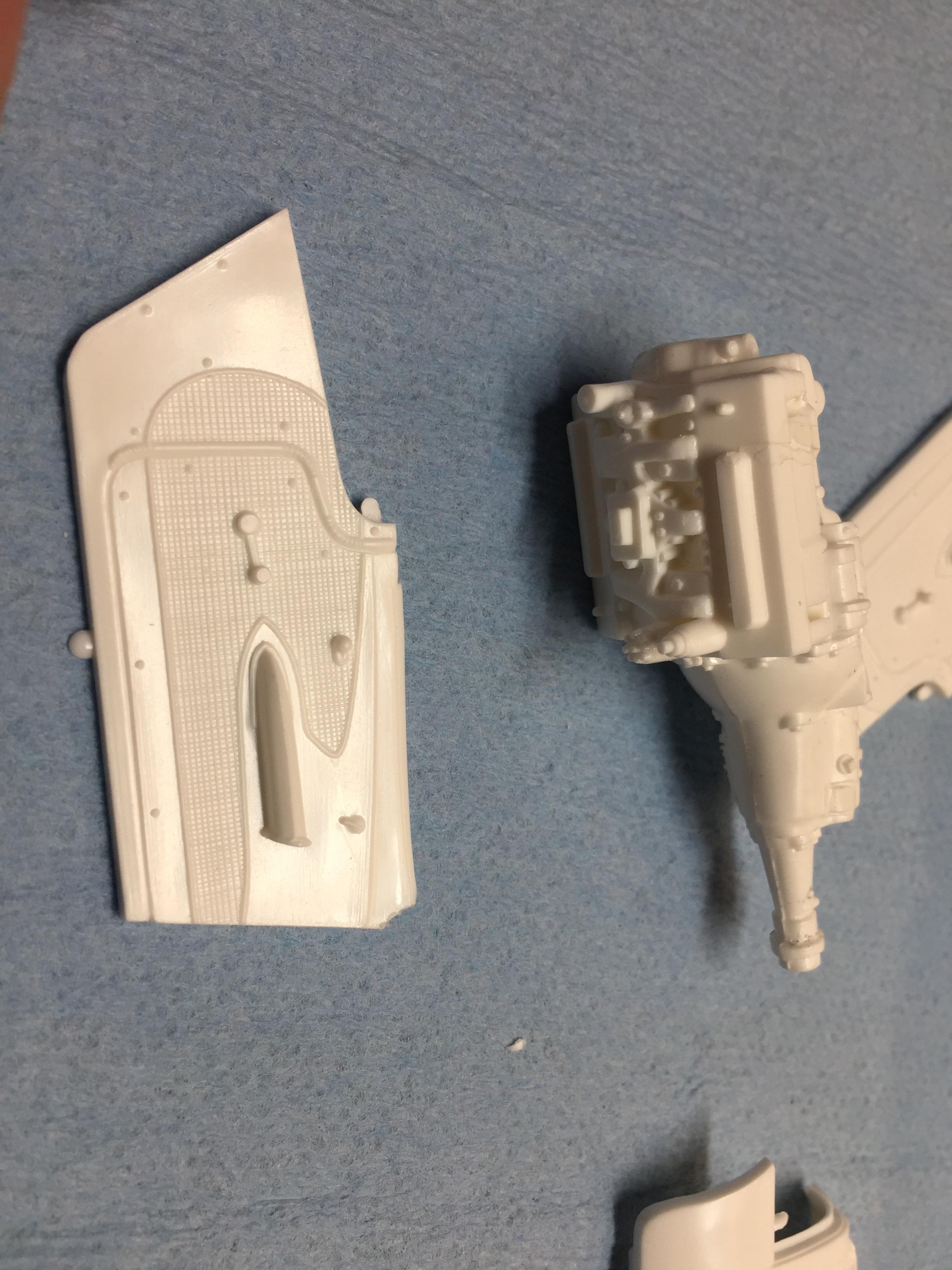

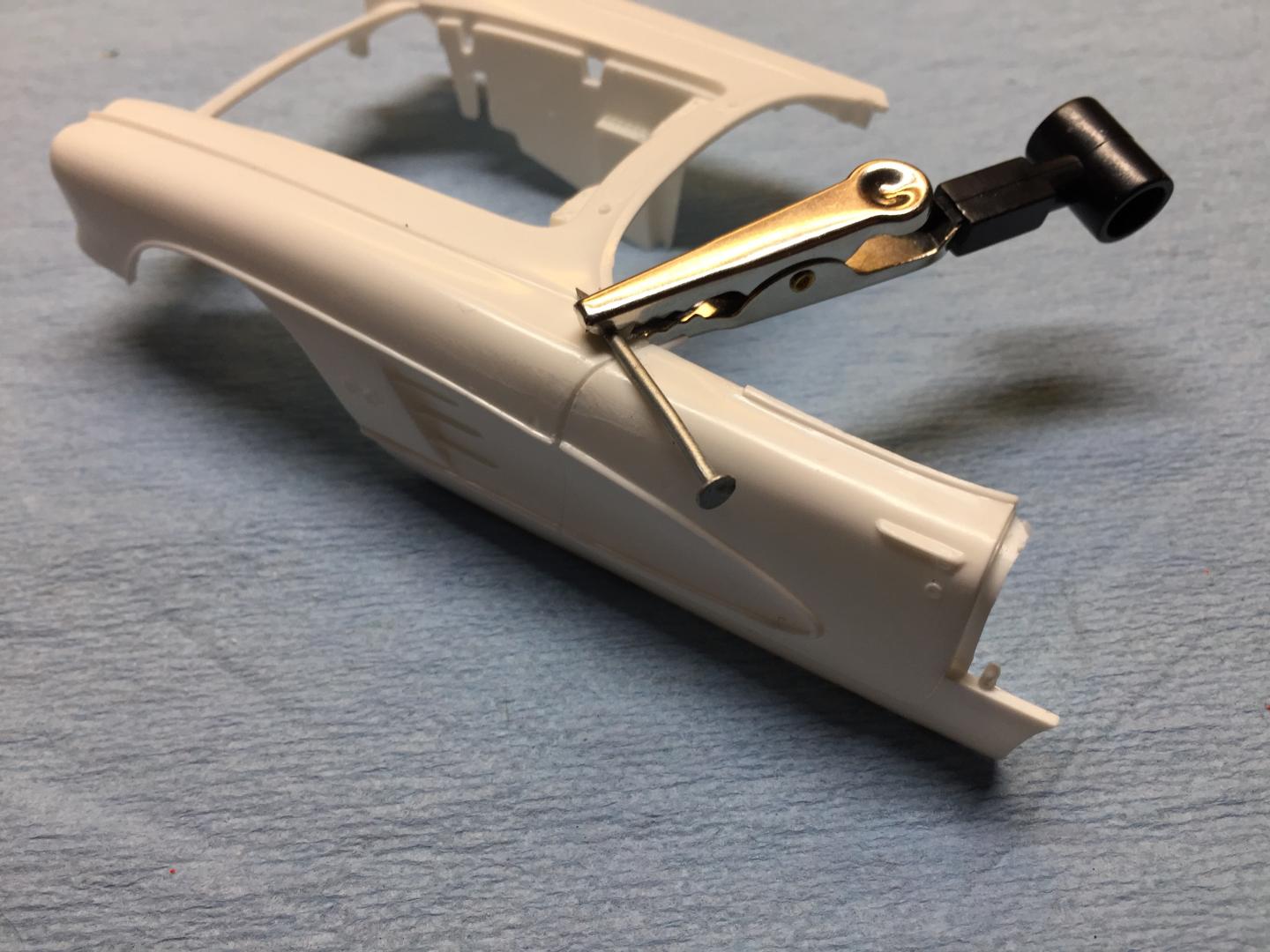

NOBLNG Posted March 25, 2019 Posted March 25, 2019 This is another one I started during my Corvette kick. Not much detail on the engine or chassis. Door panels are very nice though?? The body was fun to put together, the nail is to try to keep the panels at the same level. I added strip material behind all the seams to beef them up. The last thing I want is a body seam splitting after I've painted it. 3

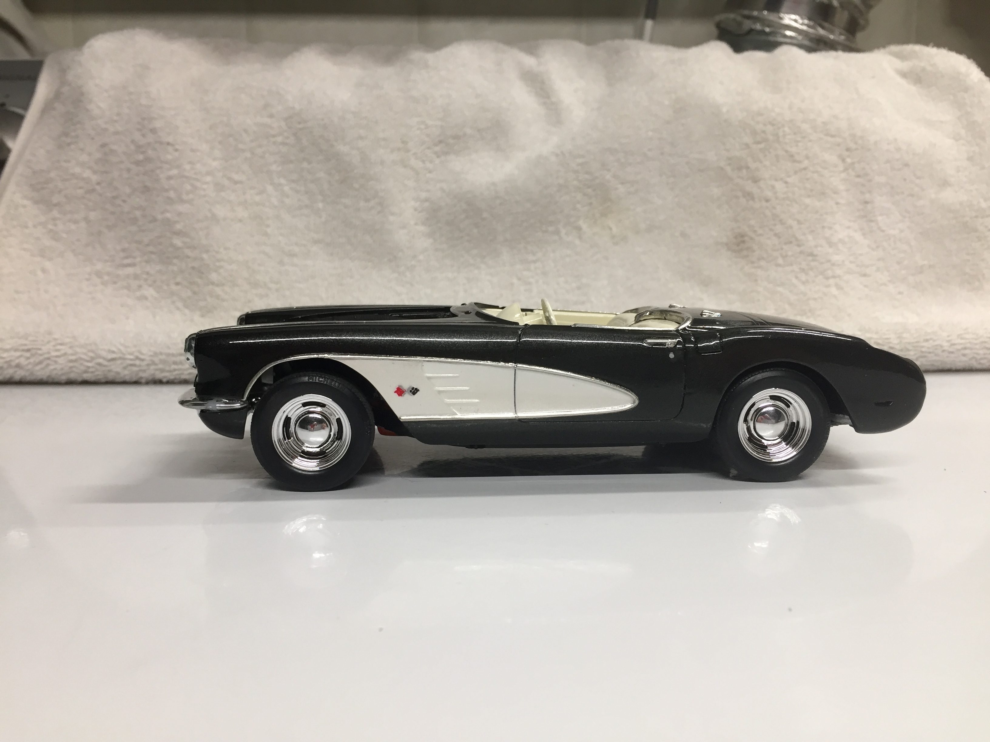

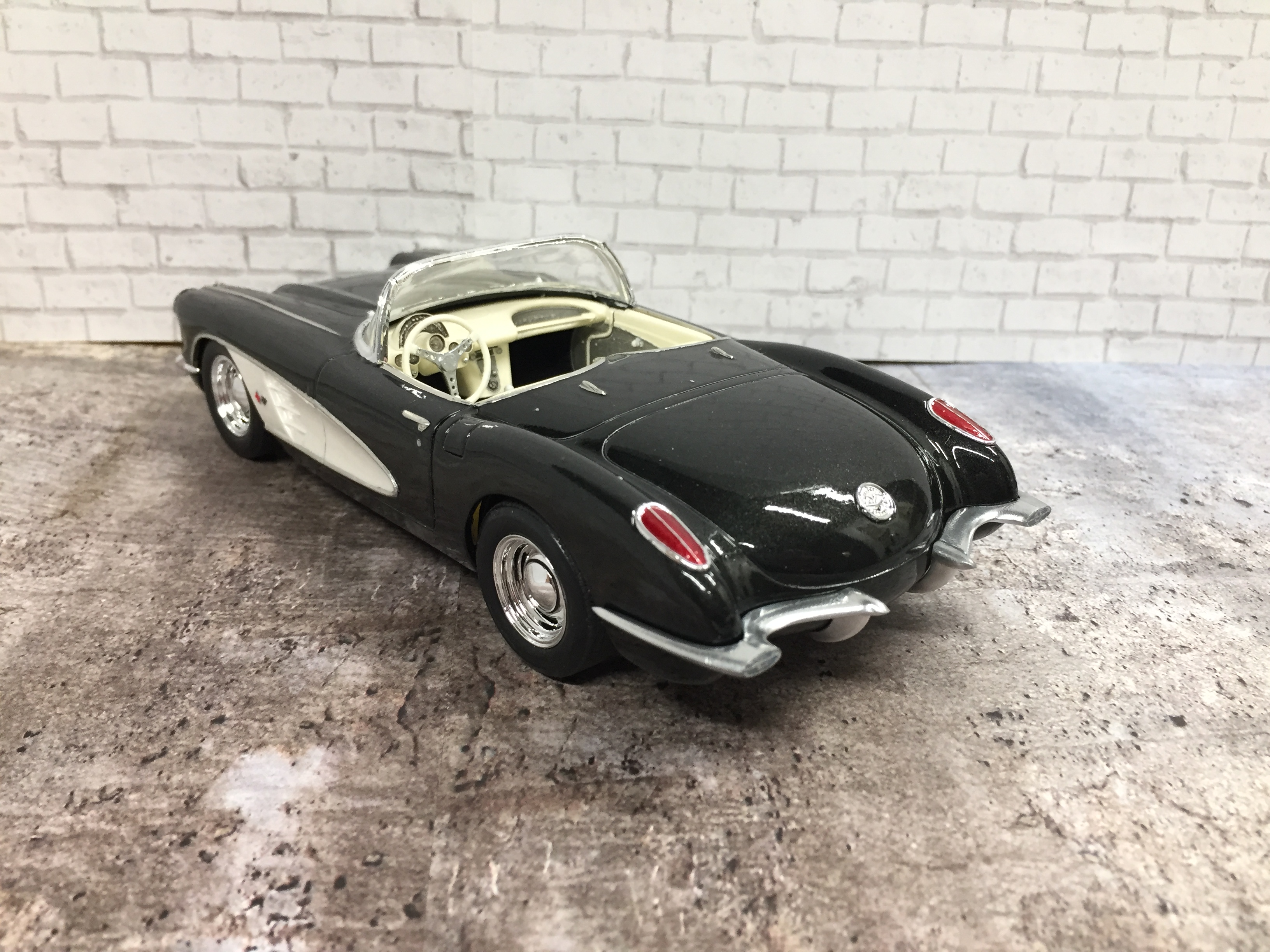

NOBLNG Posted March 25, 2019 Author Posted March 25, 2019 Fast forward to nearly done. I have had to strip the rear bumper chrome on this one also due to large sink marks! 5

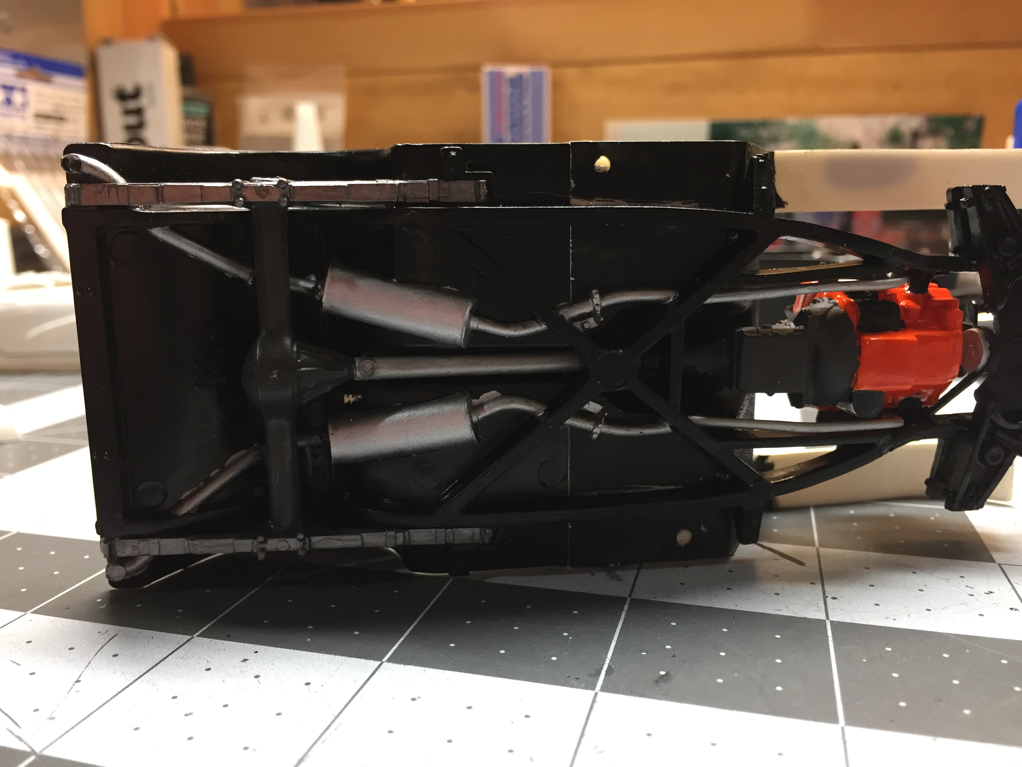

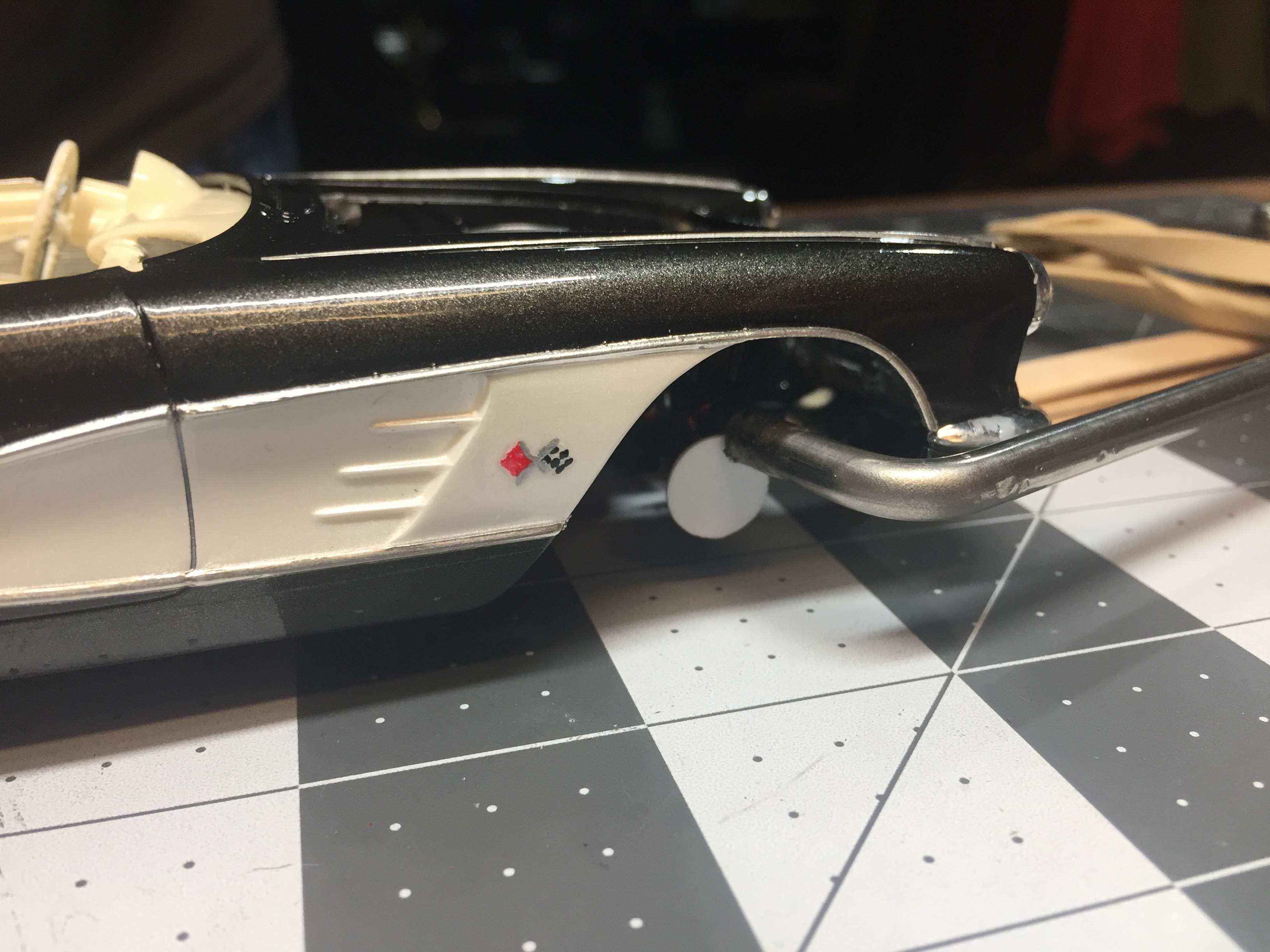

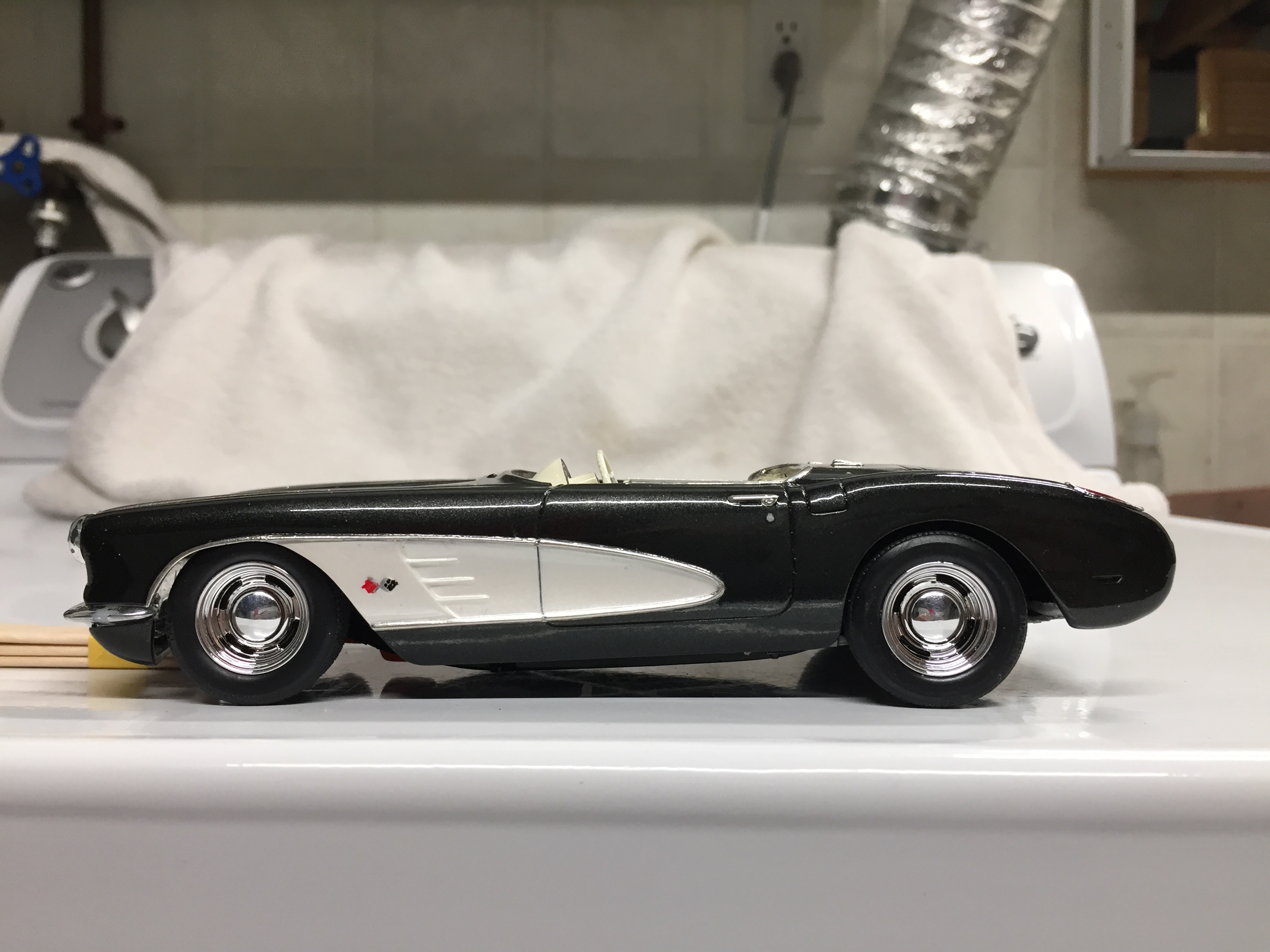

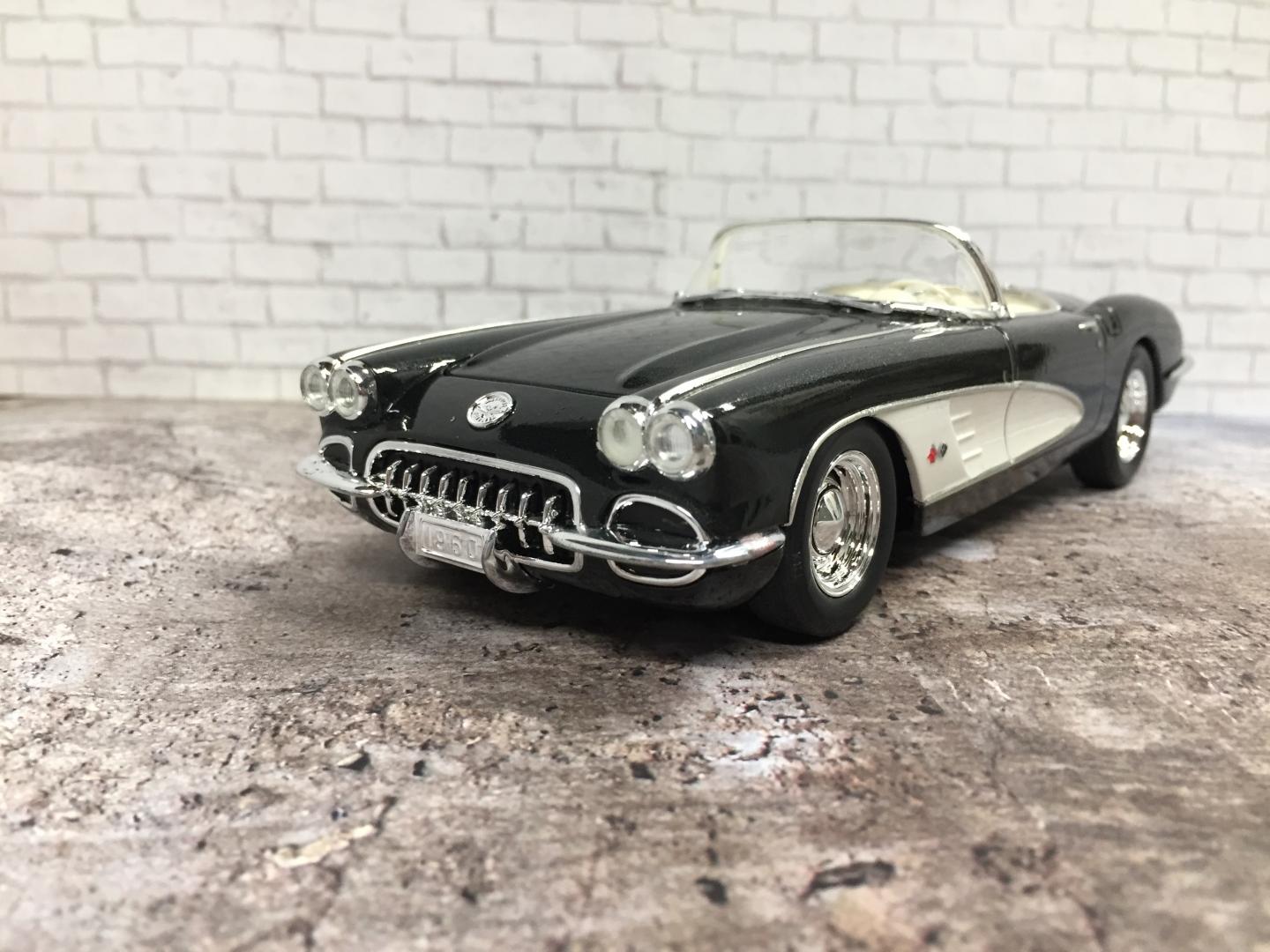

NOBLNG Posted March 27, 2019 Author Posted March 27, 2019 This kit comes with solid styrene rod that slides through the front A-frames and under the oil pan to connect the front wheels. This leaves the front of the car way too high I think! The front track width leaves the tires beneath the fenders also. To fix this, I trimmed the nub on the back of the wheels flush to bring the wheels inboard slightly. I ditched the solid axle and glued two .030 discs to the ends of the A-frames after filing them as plumb as possible. I then set the ride height with a stack of popsicle sticks and glued the front wheels to the discs. This also fixes the fact that it only sat on three wheels at a time with the original setup. 7

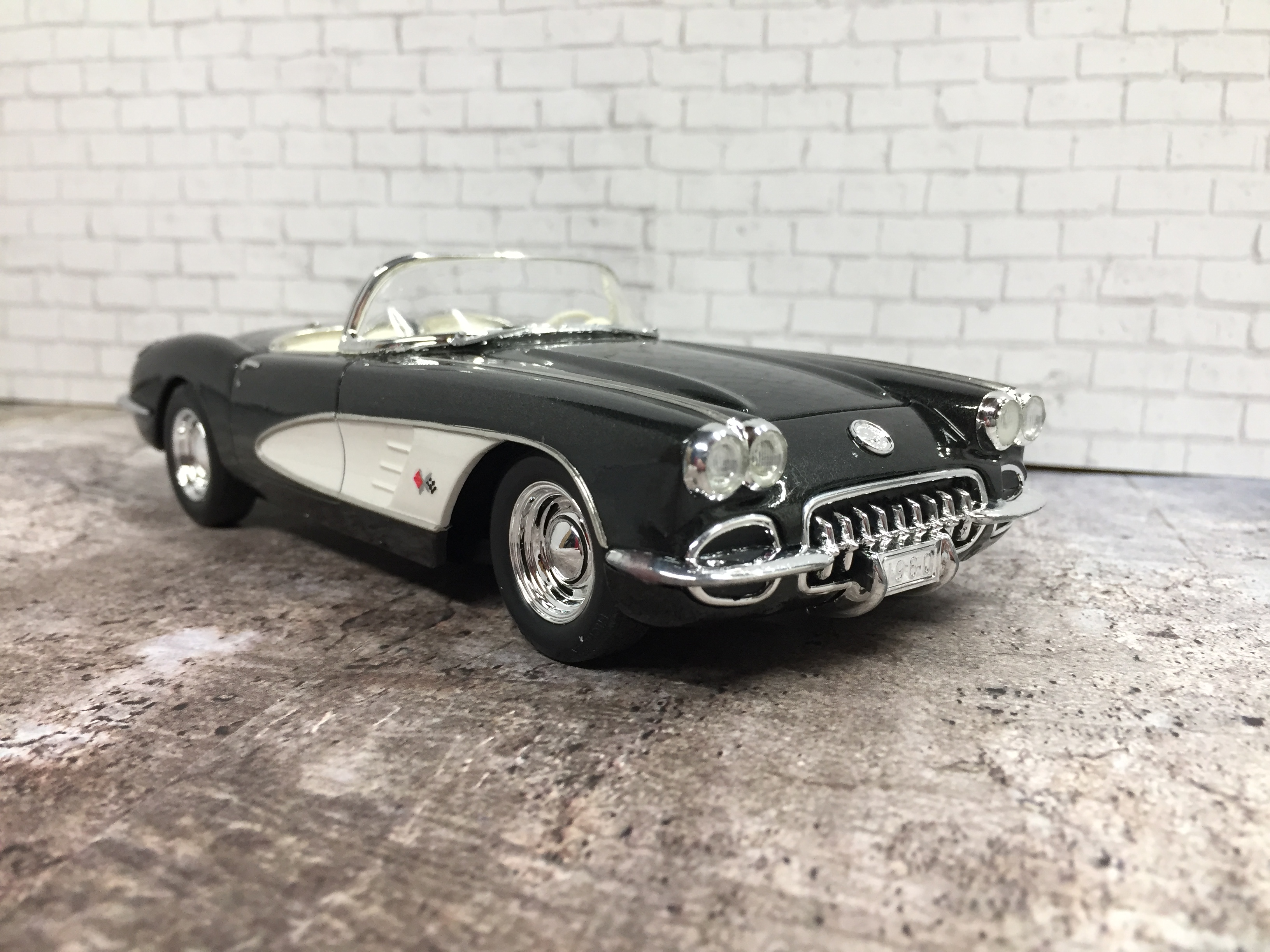

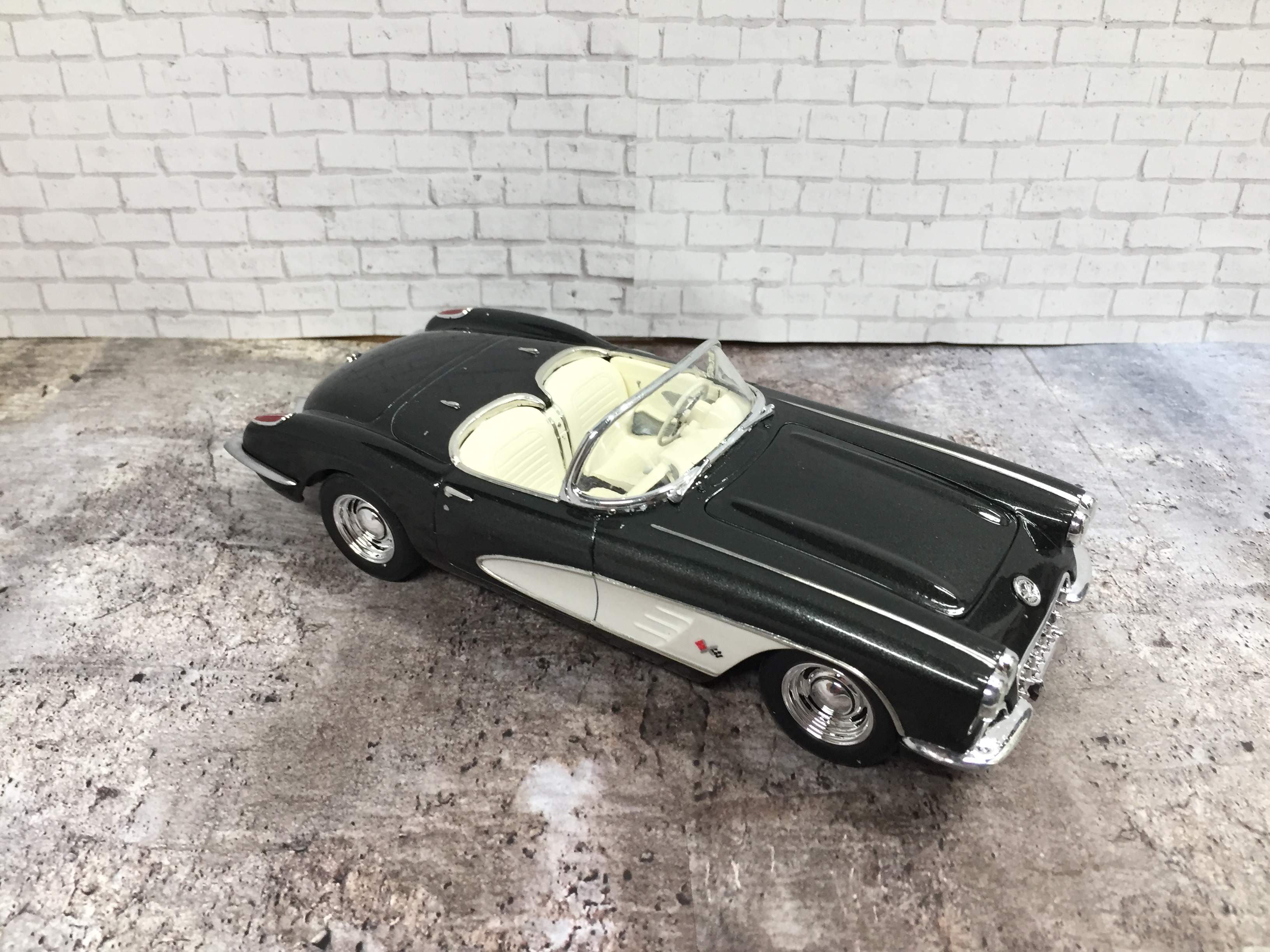

NOBLNG Posted March 28, 2019 Author Posted March 28, 2019 I am calling this one done. Sometimes it's hard to describe the effort one must go through to mount a simple windshield without the use of expletives, but let me say it challenged me greatly! Very little definition of any mounting surfaces or keys! Anyways, here it is, I am putting it on the shelf and never touching it again! 5
