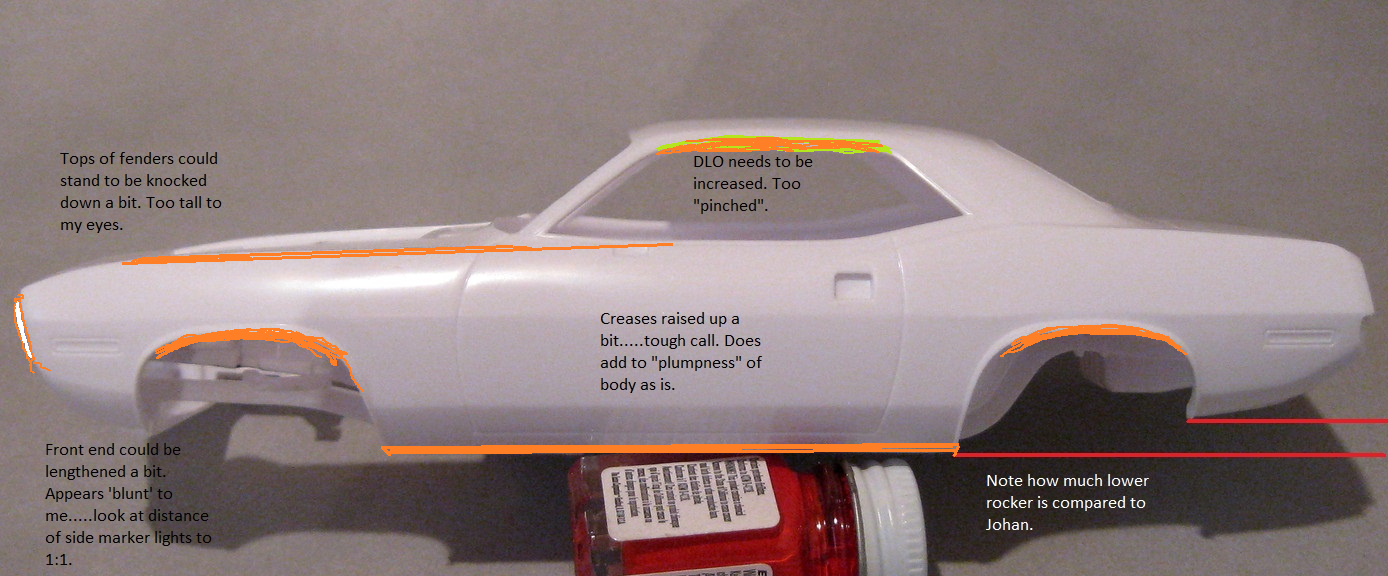

21 hours ago, Hawk312 said:
I thought it might be good to highlight the problem areas, so instead of sleeping last night, I spent the last 12 hours in paint brush doing this:
Thoughts?
One thing I noticed while sanding down the fender flares on mine. There is a lip along the bottom edge of the DLO on the Revell body that is not there on the Johan body I am comparing it with. I removed it (with an Xacto blade) and it seems to open up the DLO more as well as unplump the body some.
Edited by magicmustang
Gerald is exactly right on this point, and this is one of the corrections I have planned on my "accurization" project....TIM

Rocker panel needs a little trim down ,and the B pillar needs a little work at the very bottom !
