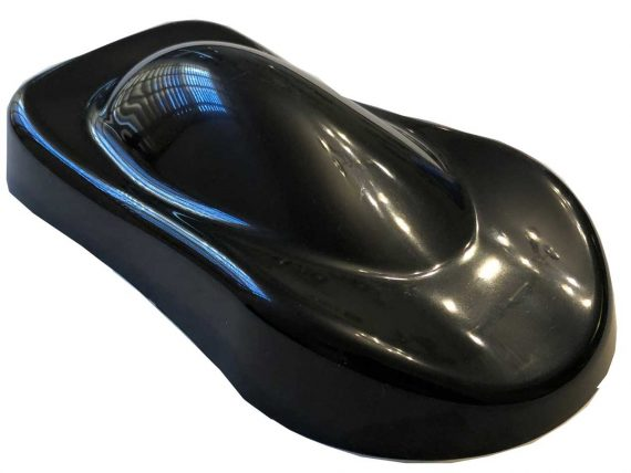

Number 1 has been covered.  For number 2 one can use plastic bottles (in all sorts of shapes and sizes). Yes, I know that has been mentioned, but I'm just reiterating it. Speaking of this, I wonder where Alclad got those fluid-looking shapes they use in photos demonstrating their paints (on their website). Those would be ideal for practicing airbrushing model car bodies.
15 minutes ago, SfanGoch said:
They are called speed shapes, car shape test panels or aeroforms. one source is Paint With Pearl.
Cool!  they are just about the right size for 1:24 model body, and at 3 bucks a pop are also affordable.  Perfect for practicing spray painting!
