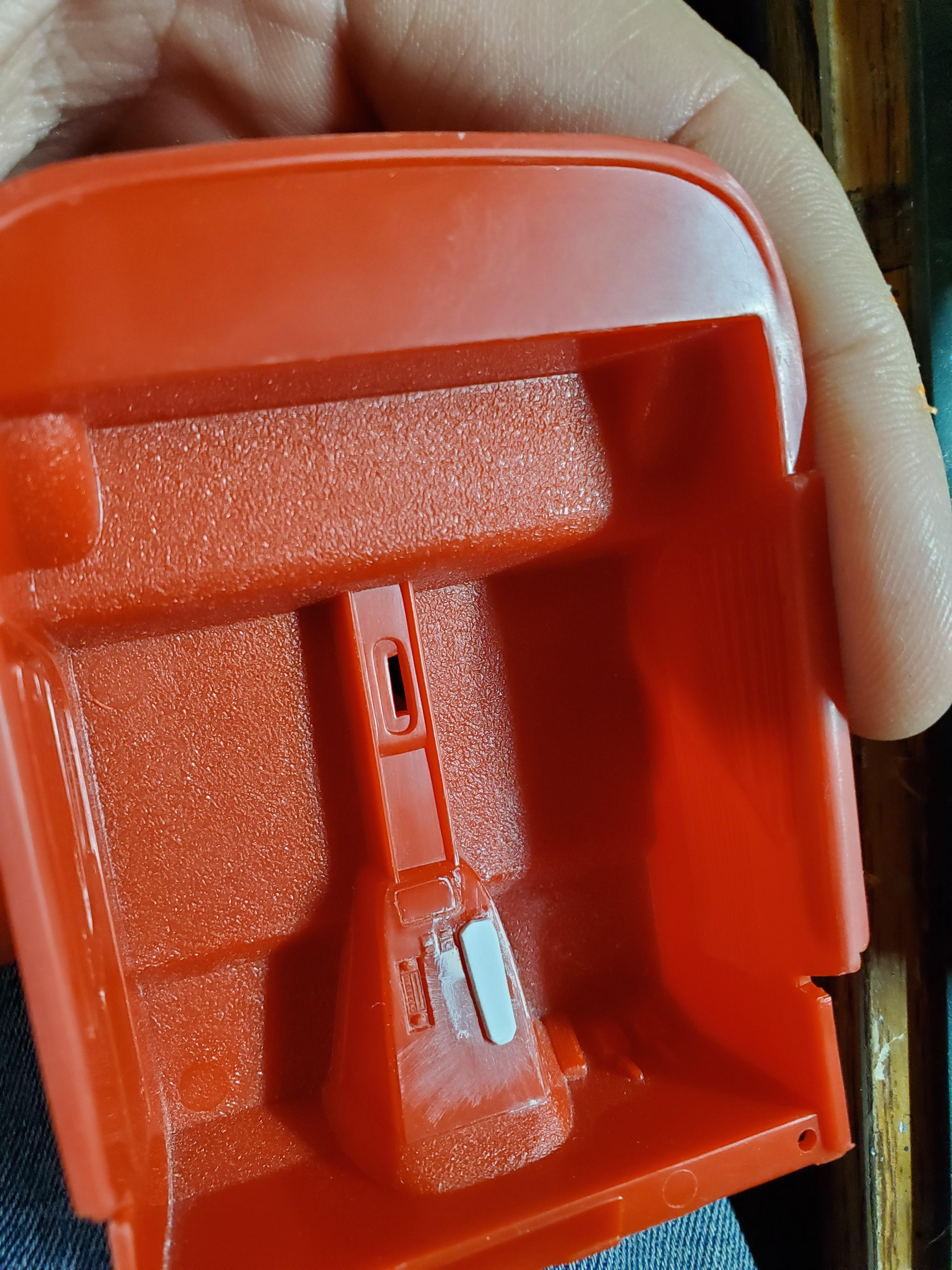

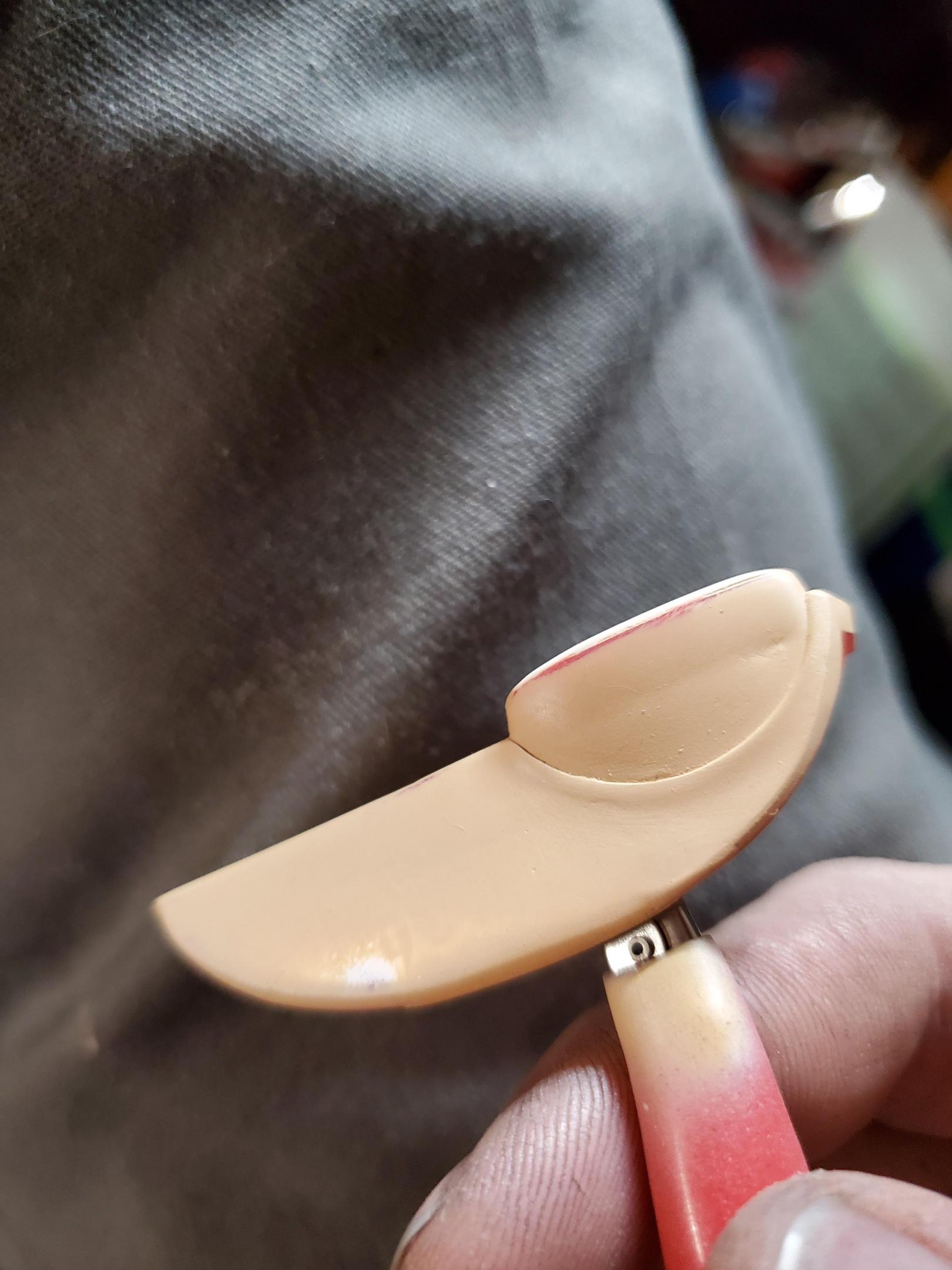

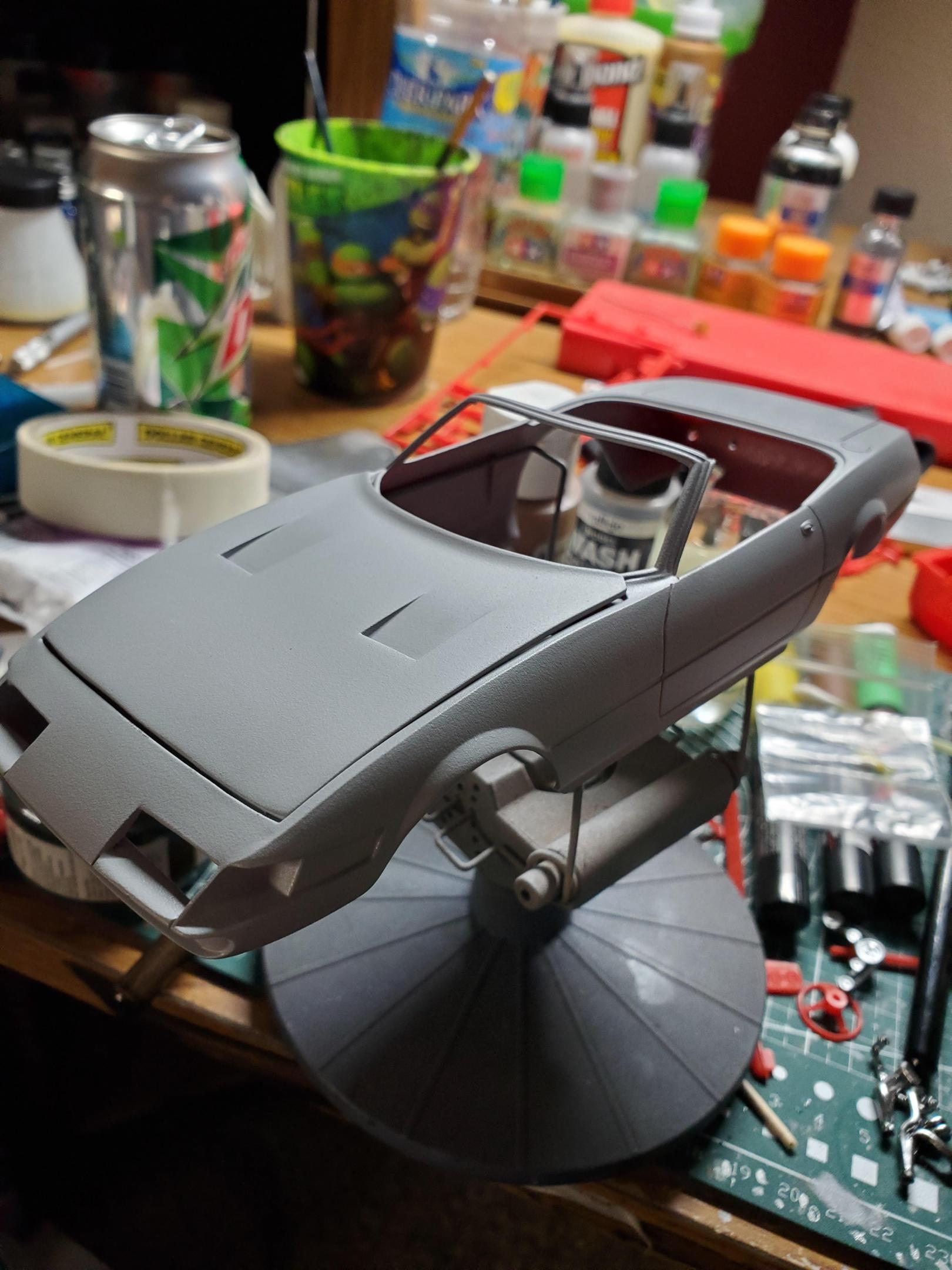

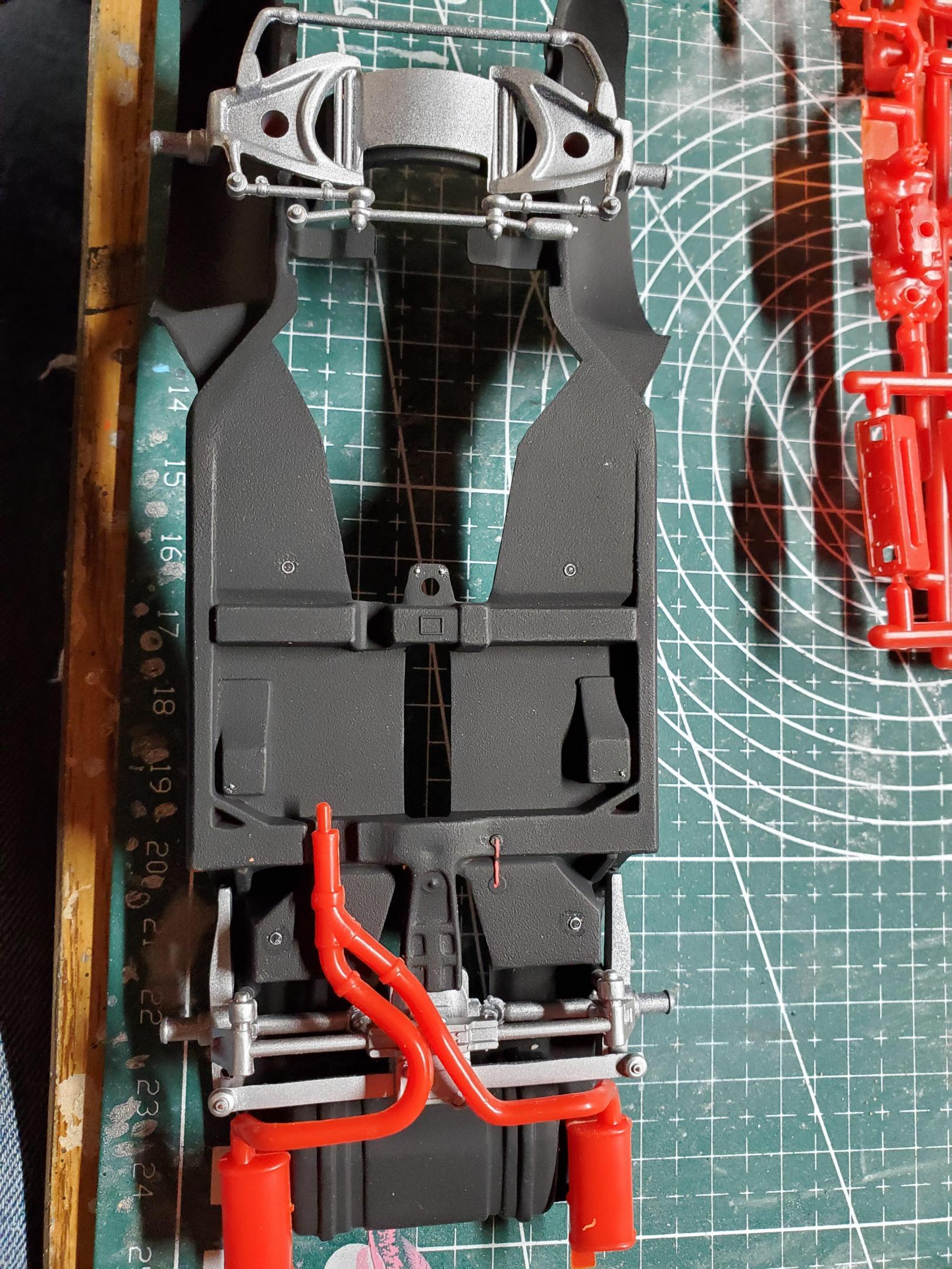

LL3 Model Worx Posted April 17, 2020 Posted April 17, 2020 Update time. I've made some progress on the Daytona. I shot it with primer paint and clear (all duplicolor) and had exactly what I wanted until i burned through in a couple spots... so now it's been sanded and put in primer again and is awaiting black. Had to clean up some areas where I cut out the front headlight covers. Here I had to graft a peice onto the front of the dash to make a shroud for the gauge cluster, and I removed the ac vents and smoothed the top of the dash. After initial color coat I noticed a few places where my putty had shrank. The crossmember here is only for single exhaust as is the kit supplied exhaust system... I'm currently modifying both the frame and exhaust for a true dual exhaust configuration. Here, I have filled in the manual shifter boot, and made a spot for an automatic shifter. In the photo it looks like a large blob of plastic, I have since smoothed it down to look more integrated. All in all its coming together, hoping to shoot paint here in the next hour or so. Loving everyone's work so far, all looking very cool!
Belugawrx Posted April 17, 2020 Posted April 17, 2020 On 4/17/2020 at 8:33 PM, LL3 Model Worx said: I've made some progress on the Daytona. had exactly what I wanted until i burned through in a couple spots... Expand Nice progress Leroy. just a hint.....next time when you burn thru..stop sanding. clean up the body, soap and water, let it dry, and shoot the panel with colour again.. yer sanding anyway... you just need colour down.. Cheers
LL3 Model Worx Posted April 17, 2020 Posted April 17, 2020 On 4/17/2020 at 10:27 PM, Belugawrx said: Nice progress Leroy. just a hint.....next time when you burn thru..stop sanding. clean up the body, soap and water, let it dry, and shoot the panel with colour again.. yer sanding anyway... you just need colour down.. Cheers Expand Thanks. And that is solid advice, and 99% of the time I would have done just that... though I believe the problem itself was a result of my primer not being as smooth as I needed to begin with it went on kinda dry and I was being impatient. I just went ahead and slicked it all down and started over... I just got the black resprayed a few minutes ago and it turned out MUCH better. Gonna move to clear here in the next half hour or so.

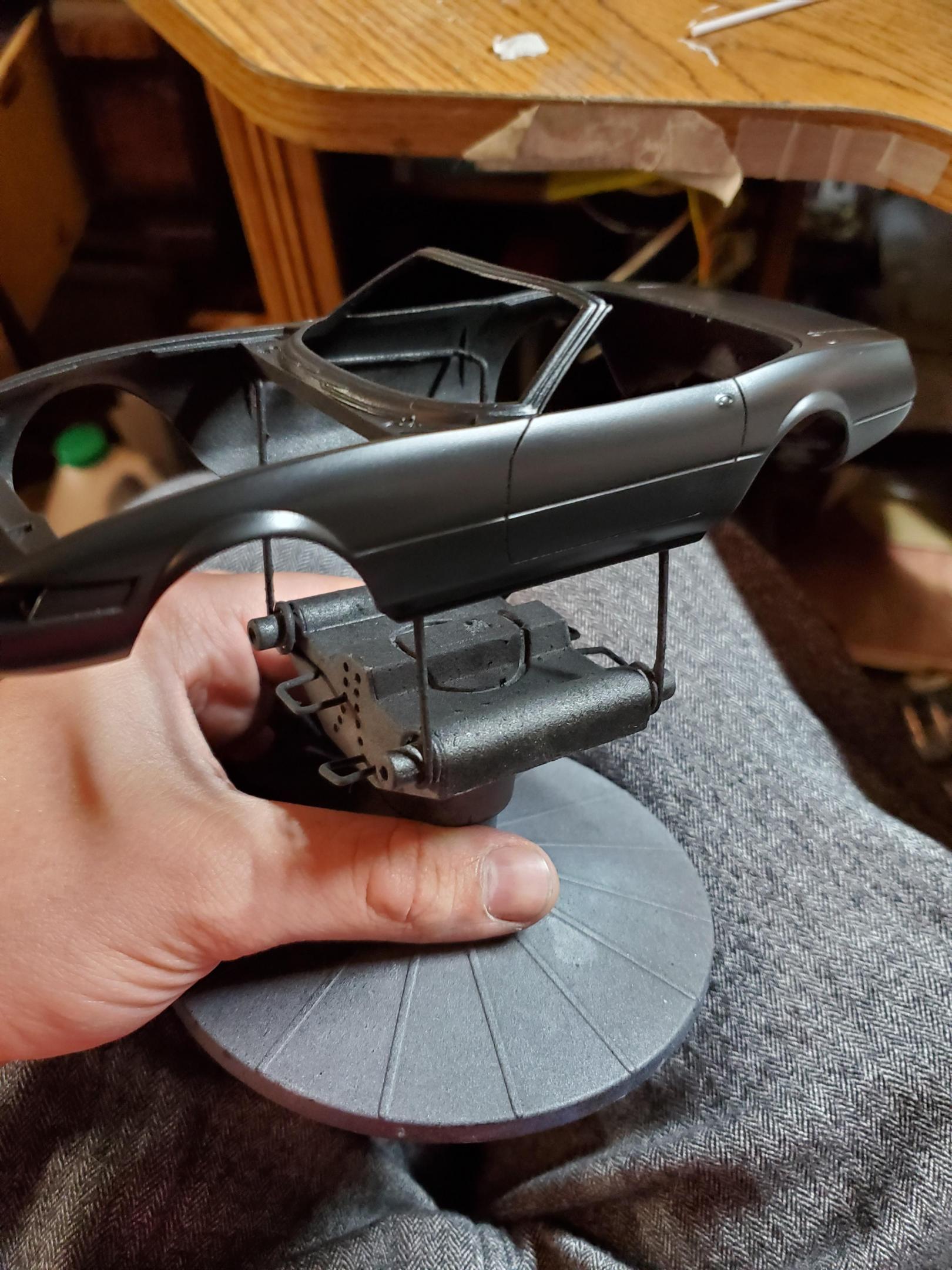

LL3 Model Worx Posted April 19, 2020 Posted April 19, 2020 I FINALLY got a decent basecoat that isn't going to cause me any more nightmares... only took 3 attempts, trying a new painting method and products can be a pita some times. Now, I'm debating on wether to just polish it out or clear it and polish... I dont really want the dripping wet look, I want it to appear a bit more realistic. So I'm thinking on just doing a polish out and be done.

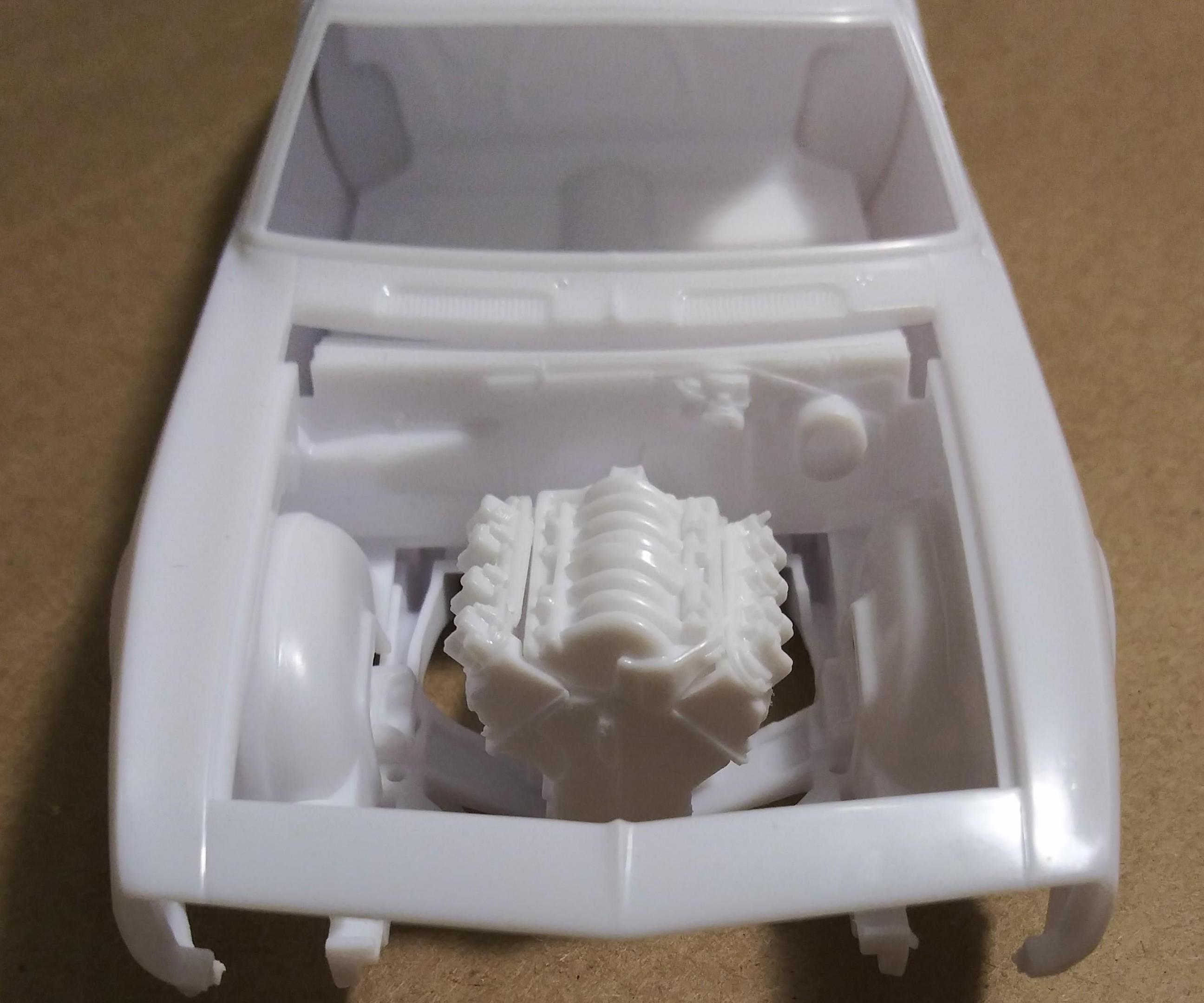

disconovaman Posted April 20, 2020 Author Posted April 20, 2020 Test fitting the big LS-1 into the Camaro... I'm about to get the body prepped for paint and then it's off to the races...

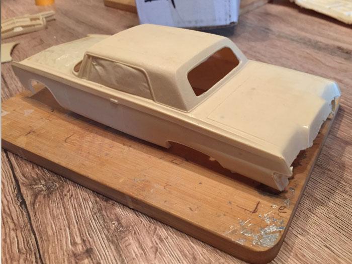

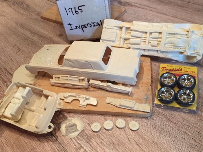

Koellefornia Kid Posted April 22, 2020 Posted April 22, 2020 I took some weeks off the work bench but now my fingers are itching, so I decided to enter the Cannonball Run with something I wanted to do for years (since I first saw the movie) and if I don't do it now, I probably never will... What I will try to do is this: The Black Beauty from the 2011 movie The Green Hornet. Starting point is this resin 1965 Chrysler Imperial I got from eBay a few years ago: A lot of flash will have to be removed and a lot of things will have to be scratch built but we will see where things are going... I want to start with the parts that will have to be chrome plated like the rear bumper: I shaved the deck lid and fitted the rear bumper/taillight section to the body: I also deleted the side mounted license plate for the Black Beauty has a center mounted plate, the first part that will have to be scratch built. __So long...

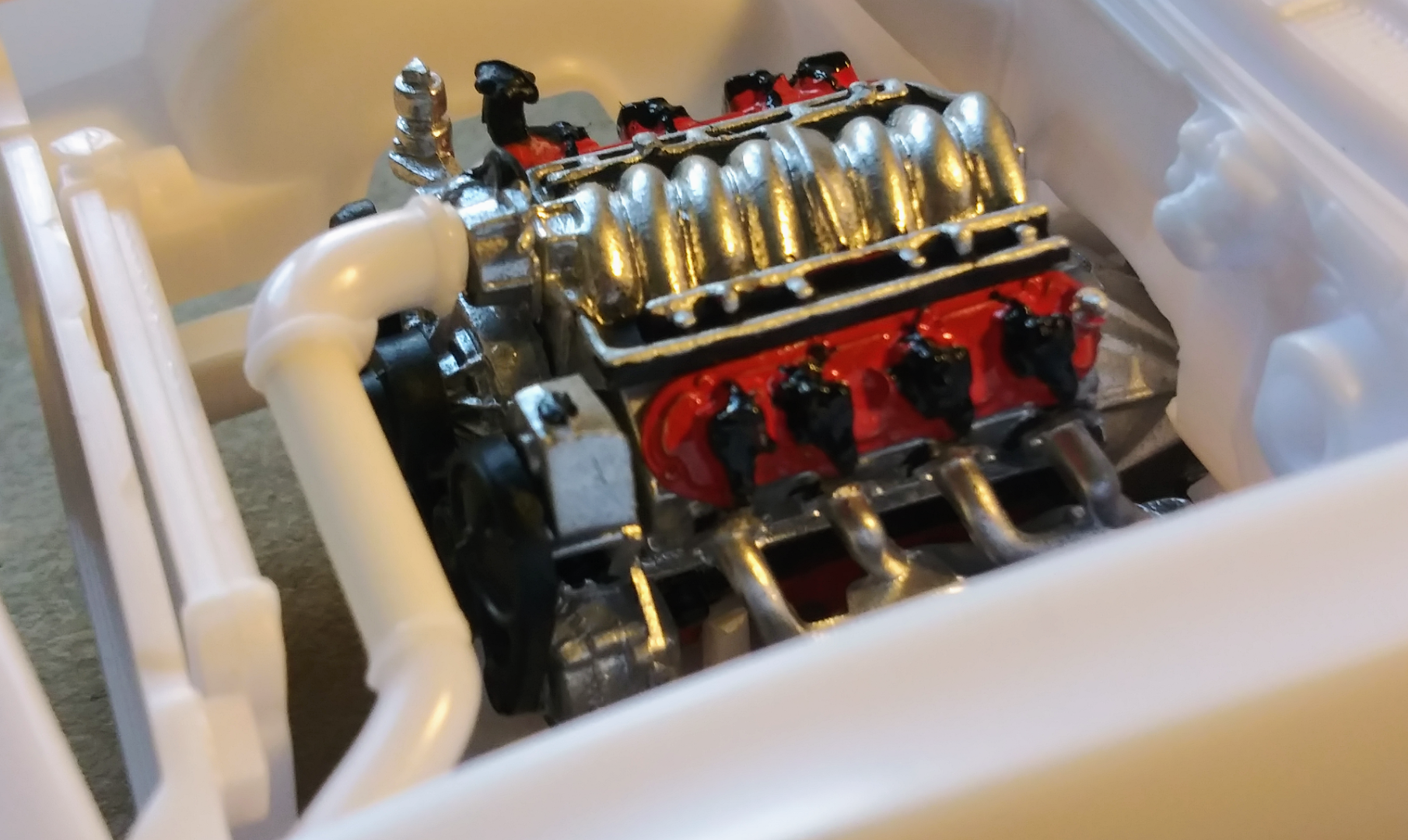

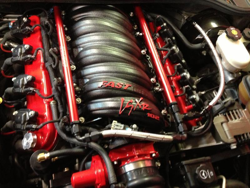

disconovaman Posted April 22, 2020 Author Posted April 22, 2020 I built the LS-1 for the Camaro today. I tried to detail it as well as I could. These engines are pretty much plastic and aluminum so black and silver is about it for colors. I googled LS swaps for some ideas how they're being personalized. There are some unique ways to make them less uniform. I painted the valve covers Red and picked out the coil packs, runners, and painted the molded plug wires. I'll be adding a light black wash to tone down the silver in the cast areas... I did add headers and an aluminum LS-6 FAST intake... for performance. I've seen some LS swaps from the Revell 02 Camaro but none are really detailed.

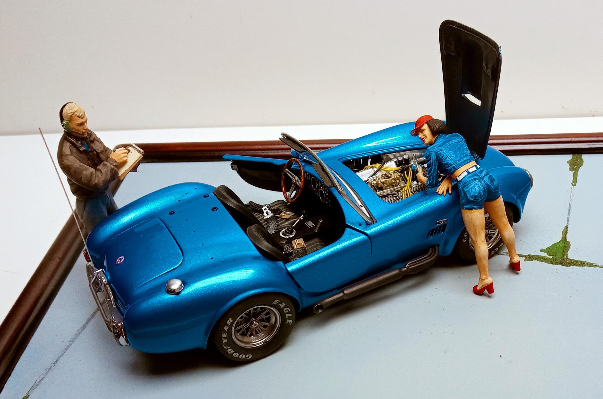

Belugawrx Posted April 29, 2020 Posted April 29, 2020 #13 Well Ali and Steve did a great job this year on the Cobra... With time to spare ...yeehaw Can't wait to see the rest of the field shape up and meet in New York, and a hefty 40 entrants...Wow!! Sometimes this build is all I get done in a year, thanks to Anthony (disconovaman) for keeping the Cannonball alive and well ? Cheers to all Cannonballers
gasser59 Posted April 29, 2020 Posted April 29, 2020 She's a real beauty Bruce. I'd be proud to display that one. Congrats on getting it done well before the deadline. I do believe you have time for another one.
LL3 Model Worx Posted April 29, 2020 Posted April 29, 2020 Fantastic job on the Cobra, it really turned out awsome!
Jantrix Posted April 29, 2020 Posted April 29, 2020 Wow. Bruce. You never disappoint, man. That looks terrific. With these stay at home rules, the turn out for this Run should be epic. I can't wait to see them.

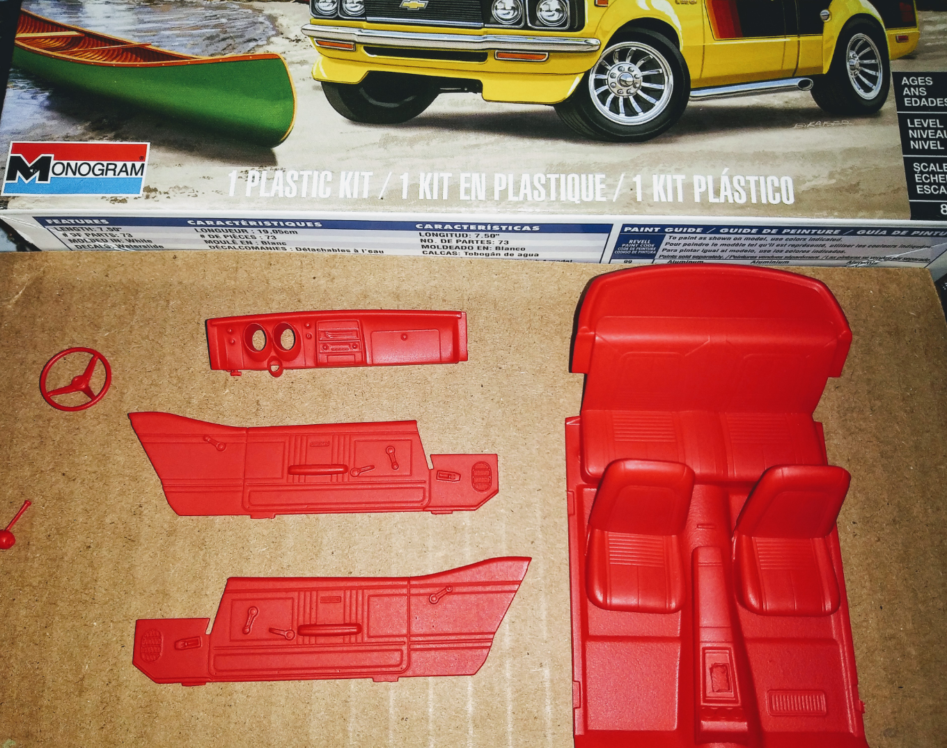

disconovaman Posted May 1, 2020 Author Posted May 1, 2020 "determination to suceed" the Gumball Cobra is Super! I'm making slow progress on the BOD Camaro. I sprayed my interior red like the movie car... The Camaro doesn't have alot of screen time... But you can see the red interior for sure. I think black reallly pops with red interior... "Monique? what are you doing to my Camaro?" ?
