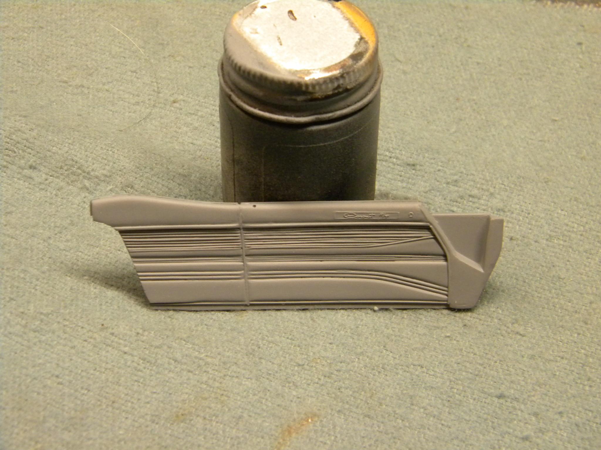

StevenGuthmiller Posted September 25, 2020 Posted September 25, 2020 5 hours ago, moparfarmer said: Go Home, just fantastic work..Hope you took a break, 8 hours straight is like going to work..Did you get any breaks? That was just an estimate of time spent over the past week Wayne. I rarely can spend more than an hour or so at the bench without getting up to do something else for a while. That's part of the reason why I post so many progress reports on my build threads. I work till I need a break, and then I'll snap a couple of pics and sit down at the computer for a while. Steve

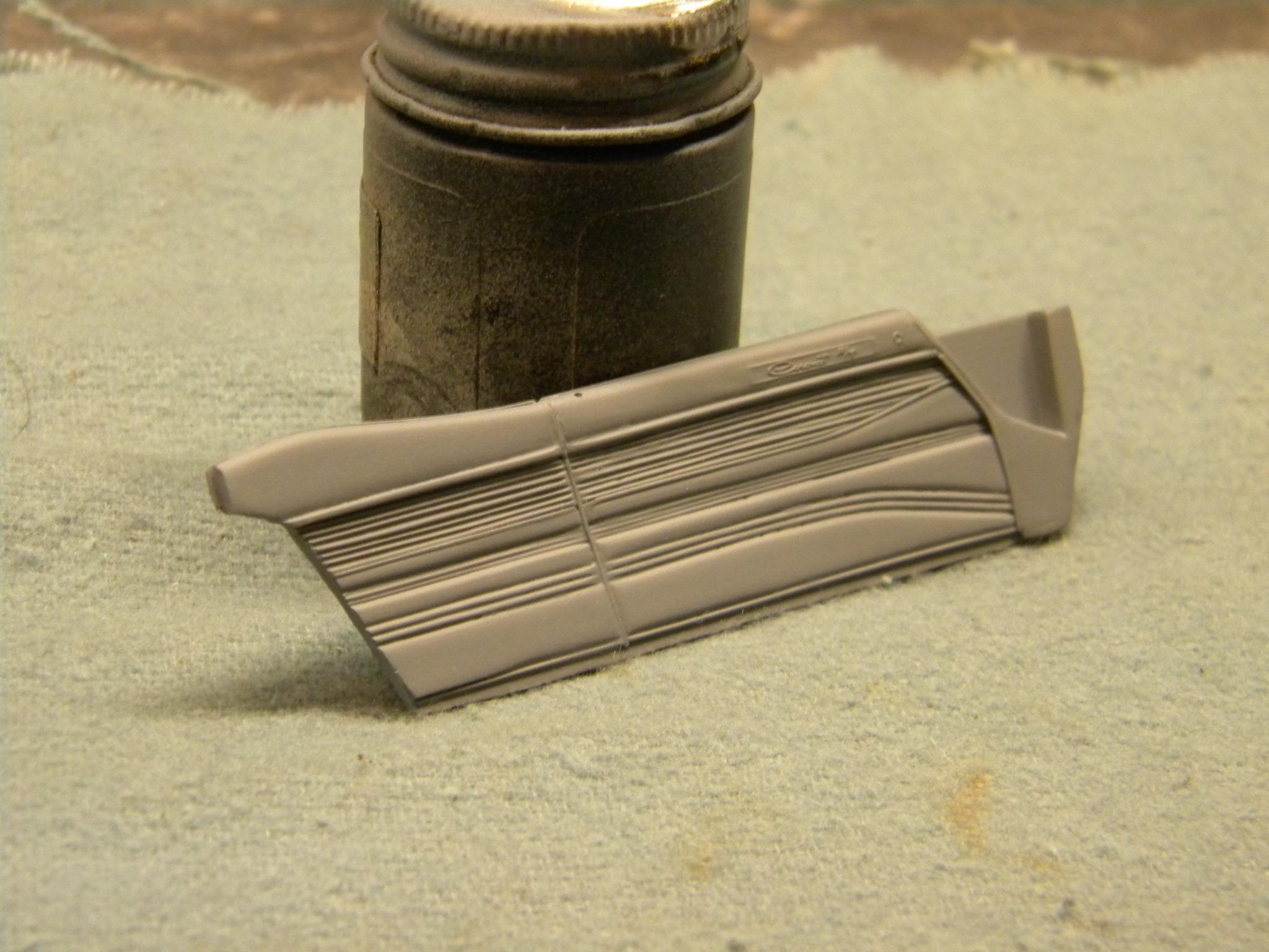

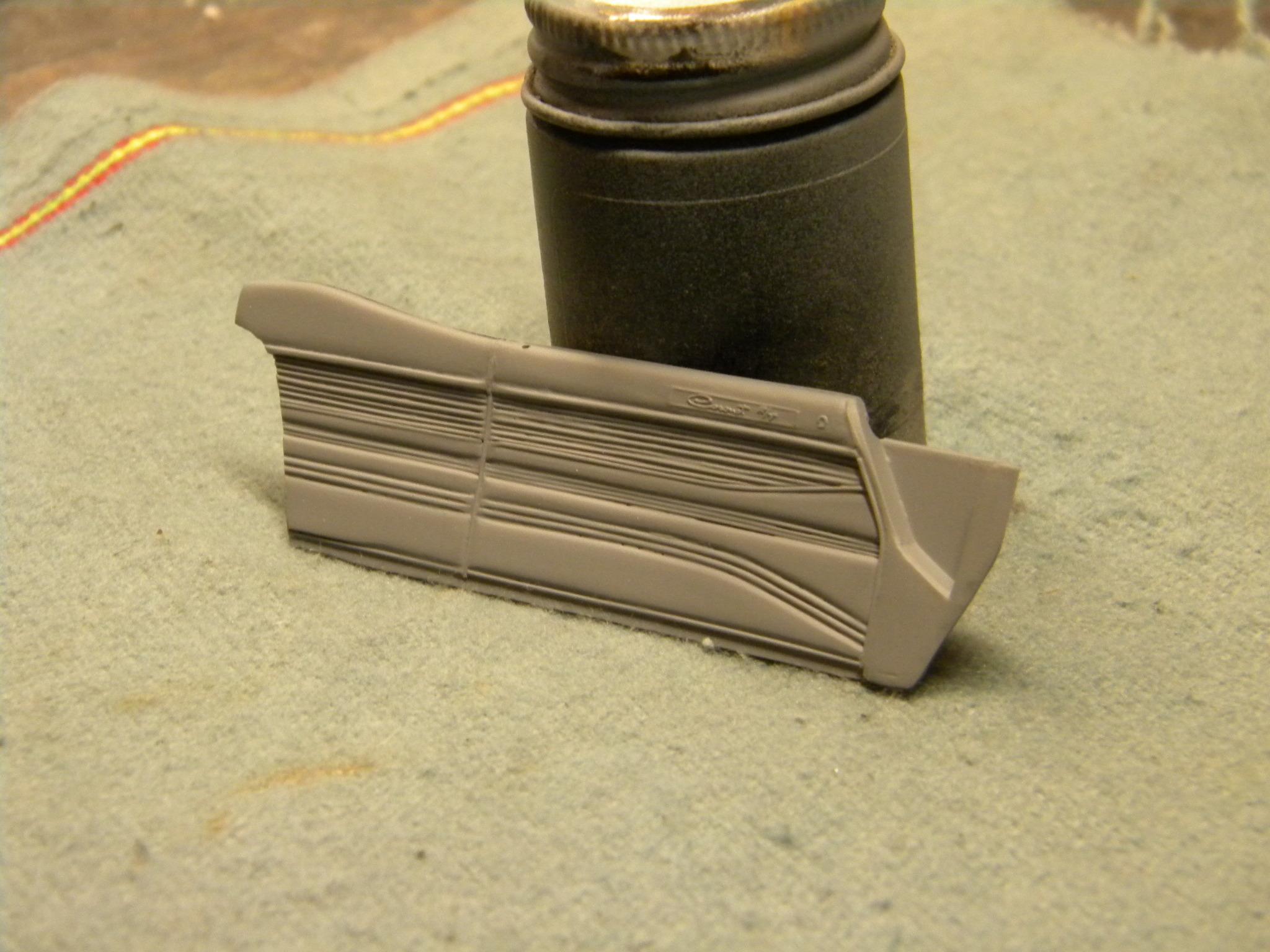

gtx6970 Posted September 25, 2020 Posted September 25, 2020 9 hours ago, StevenGuthmiller said: Today I finished up one scratch made door panel for my '68 Coronet R/T. Probably got a good 8-10 hours of solid bench time into this one. Hopefully the other side will go quicker. Less experimentation. Steve I wish you could some resin caster to copy these. I would take 2 sets pronto

StevenGuthmiller Posted September 25, 2020 Posted September 25, 2020 10 hours ago, gtx6970 said: I wish you could some resin caster to copy these. I would take 2 sets pronto Thanks Bill. I suppose that I would be willing to let someone cast them if they wanted to, but I don't really think that they're good enough to sell on the open market. They're good enough for me, and they might be good enough for someone who's just looking for a simpler alternative rather than making their own and is not too picky, but I wouldn't want to have anyone selling them for $40.00 a pop or anything like that. If I was a caster, I would make a couple of sets for someone that I consider a friend, such as yourself, for free. Steve

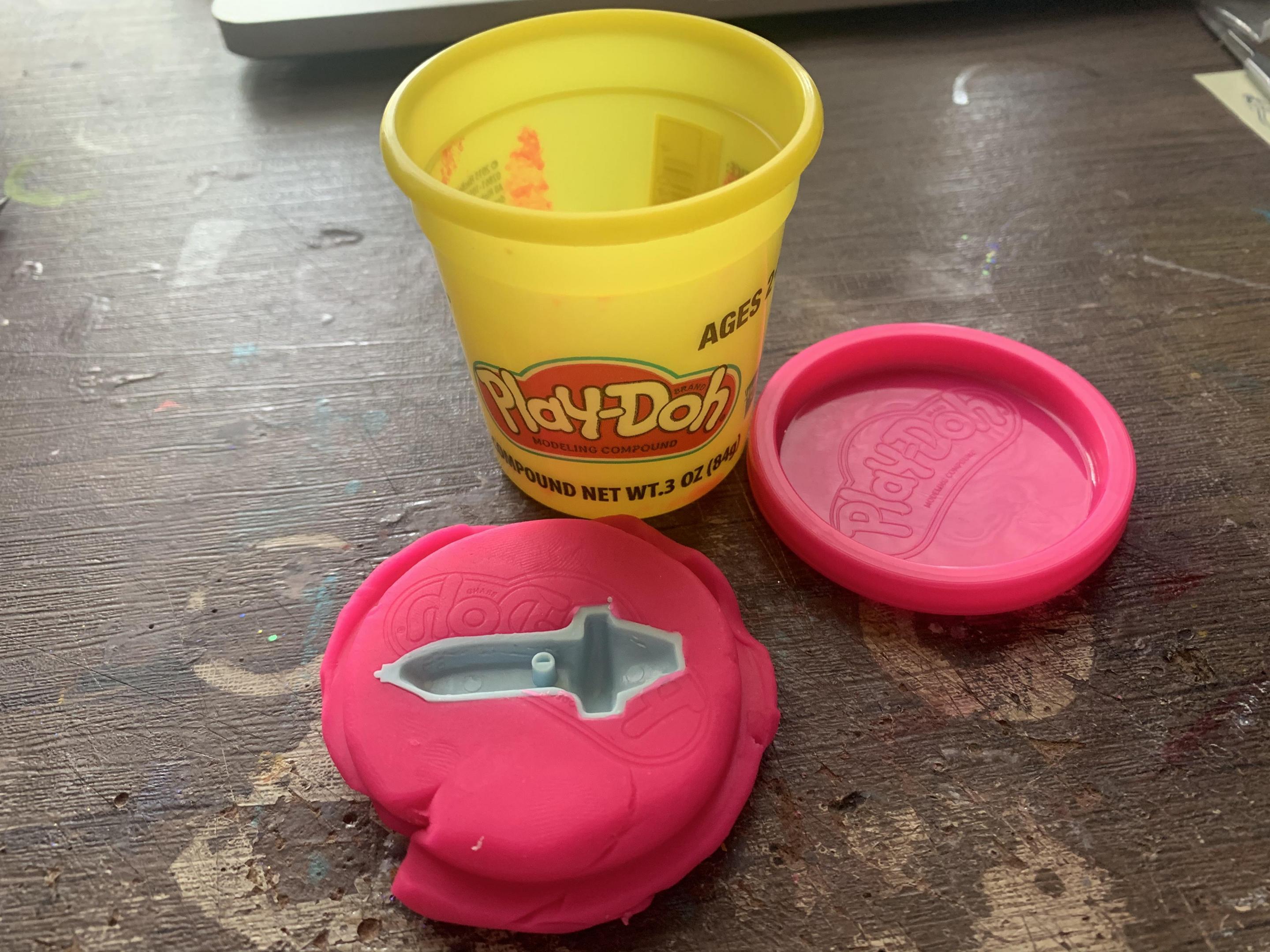

OldNYJim Posted September 26, 2020 Posted September 26, 2020 Speaking of resin casting - just having some fun experimenting today... Just curious if Play-Doh could be used as a simple mold for a part where you want a copy but don’t want to make a ‘real’ mold. Just poured some resin in there - I’ll check back tomorrow and see what kind of mess it has made ?
NOBLNG Posted September 26, 2020 Posted September 26, 2020 11 hours ago, CabDriver said: Speaking of resin casting - just having some fun experimenting today... Just curious if Play-Doh could be used as a simple mold for a part where you want a copy but don’t want to make a ‘real’ mold. Just poured some resin in there - I’ll check back tomorrow and see what kind of mess it has made ? As long as the playdoh doesn’t get eaten by the resin it should work. I did cast a couple headlight lens using Silly putty and bondic.

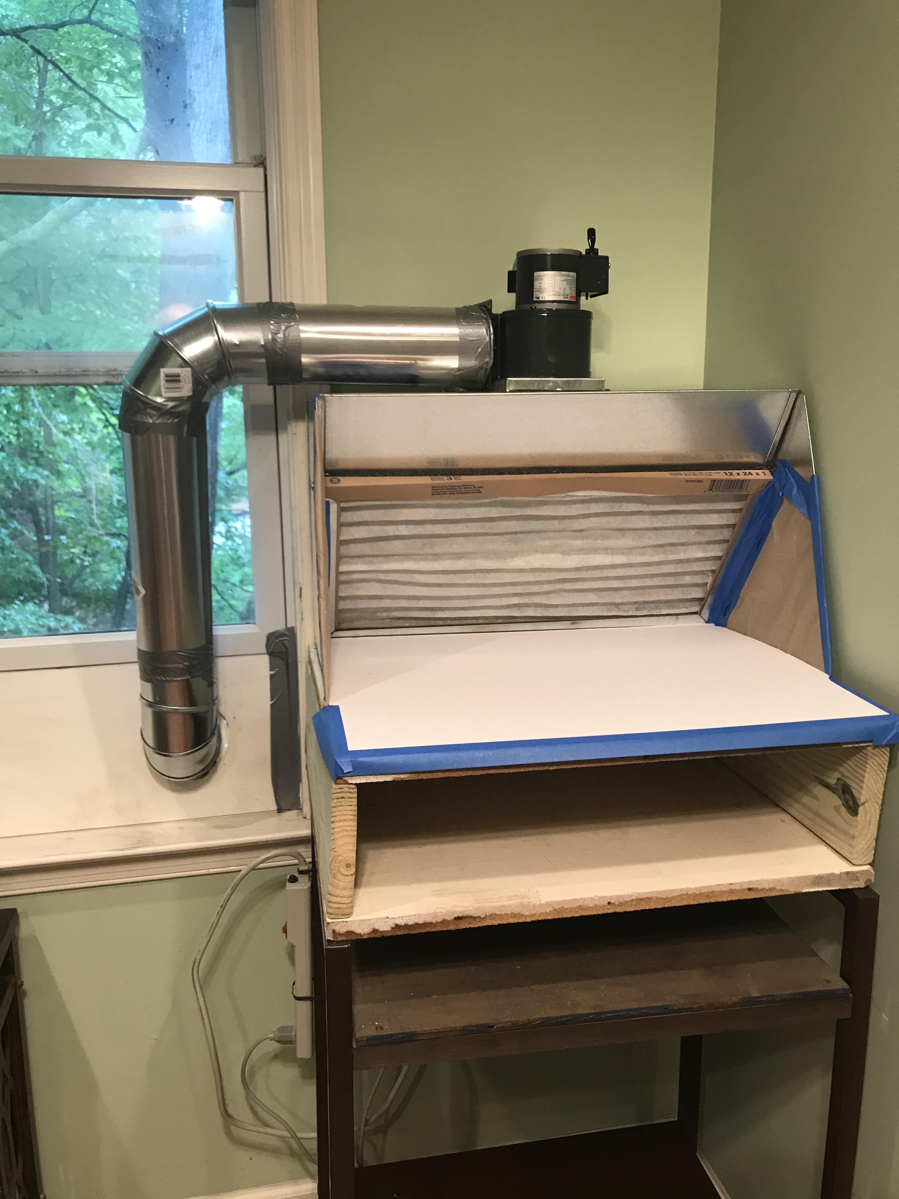

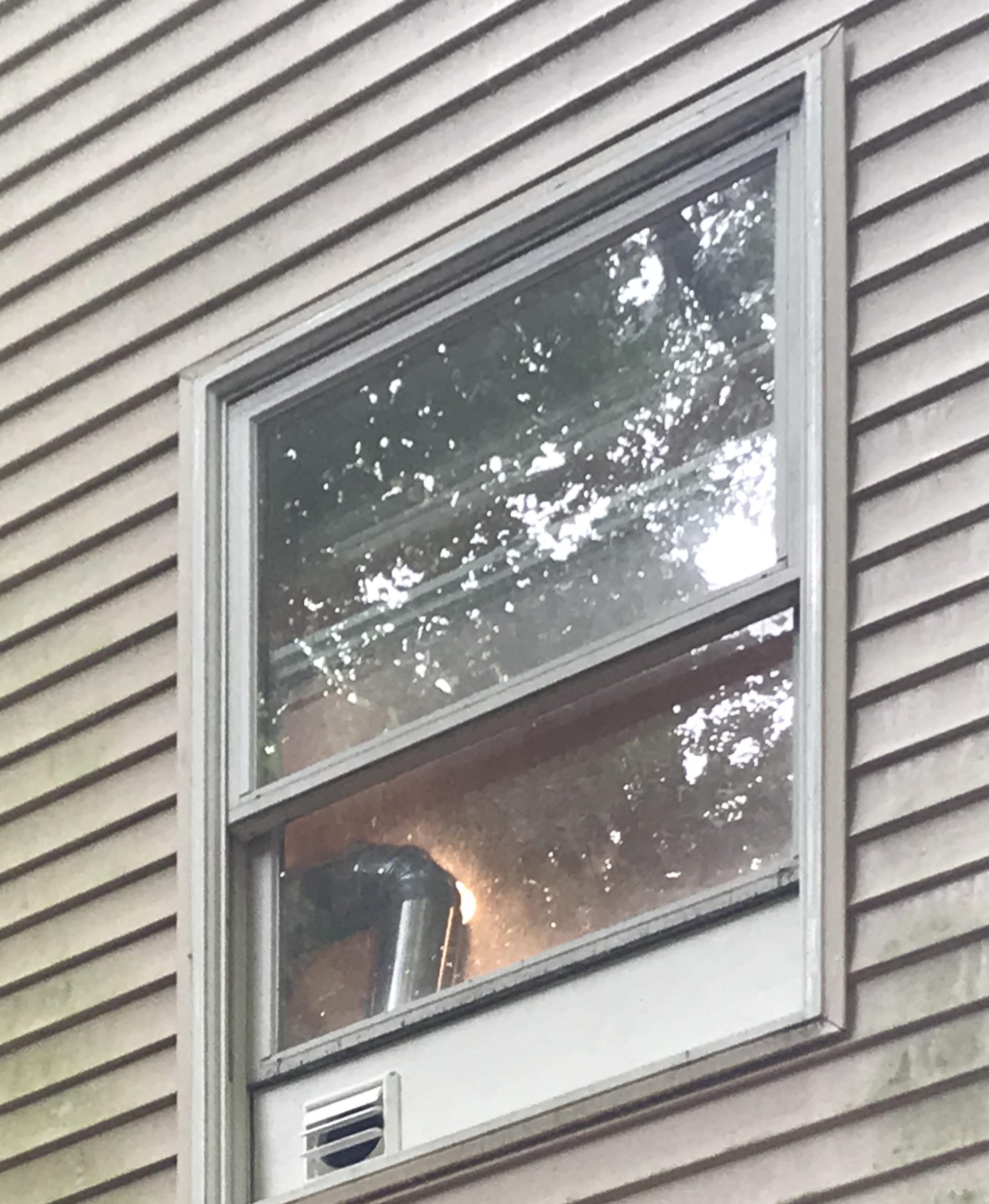

Tom Geiger Posted September 26, 2020 Posted September 26, 2020 It’s alive! Finished it today. I decided with this booth I would do real venting through a permanent vent! I got tired of opening the window and tossing flex duct out. It’s fit tight enough that there weren’t any leaks, then I taped the joints anyway. I’m happy! And the view outside. With the booth running. That’s a plastic board I had set aside for this purpose. Now onward to finishing some models!

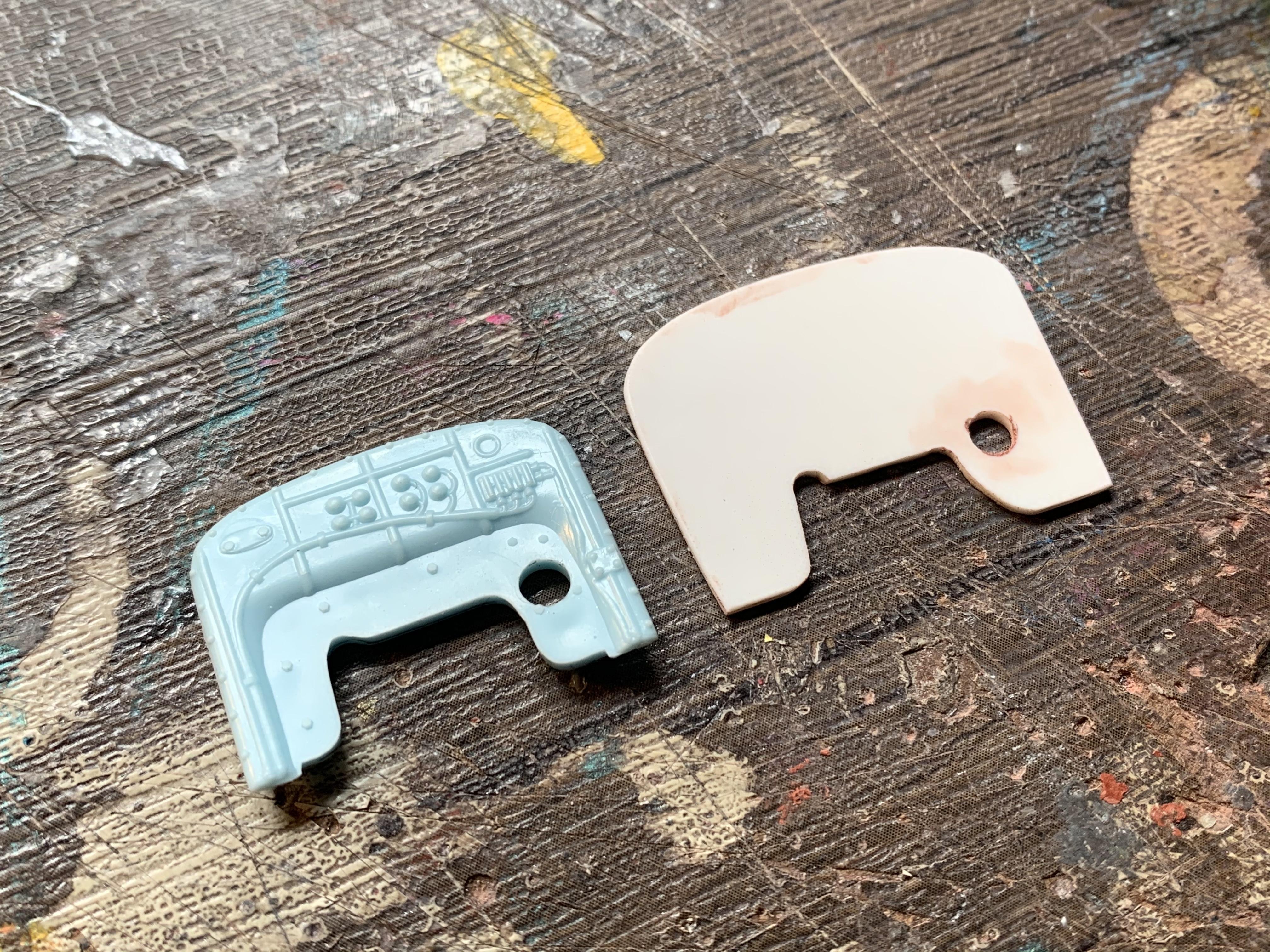

OldNYJim Posted October 3, 2020 Posted October 3, 2020 14 hours ago, Snake45 said: Might not feel like much, but it was all necessary before more significant progress could be made, so it was all important work! That's kind of why I started this thread, so we could all feel like we're making progress in some way, however small. Exactly!! Not every step of a build is post-worthy (although I guess shooting to make every little thing WORTH showing off isn’t a bad aim) - which is why this thread is cool! Tiny bit of progress on the T Touring I’m working on right now - shot the fourth, fifth and sixth coats of lacquer on the body - got it nice and smooth and shiny! Pity you can’t really tell, what with it being a white body - but I’m pretty happy with the finish so far! I’d usually use Testors enamel gloss, but I don’t want this thing turning yellow on me a little way down the line... And shot a bunch of other little bits and pieces for the same build, ready for further airbrushing or detailing...

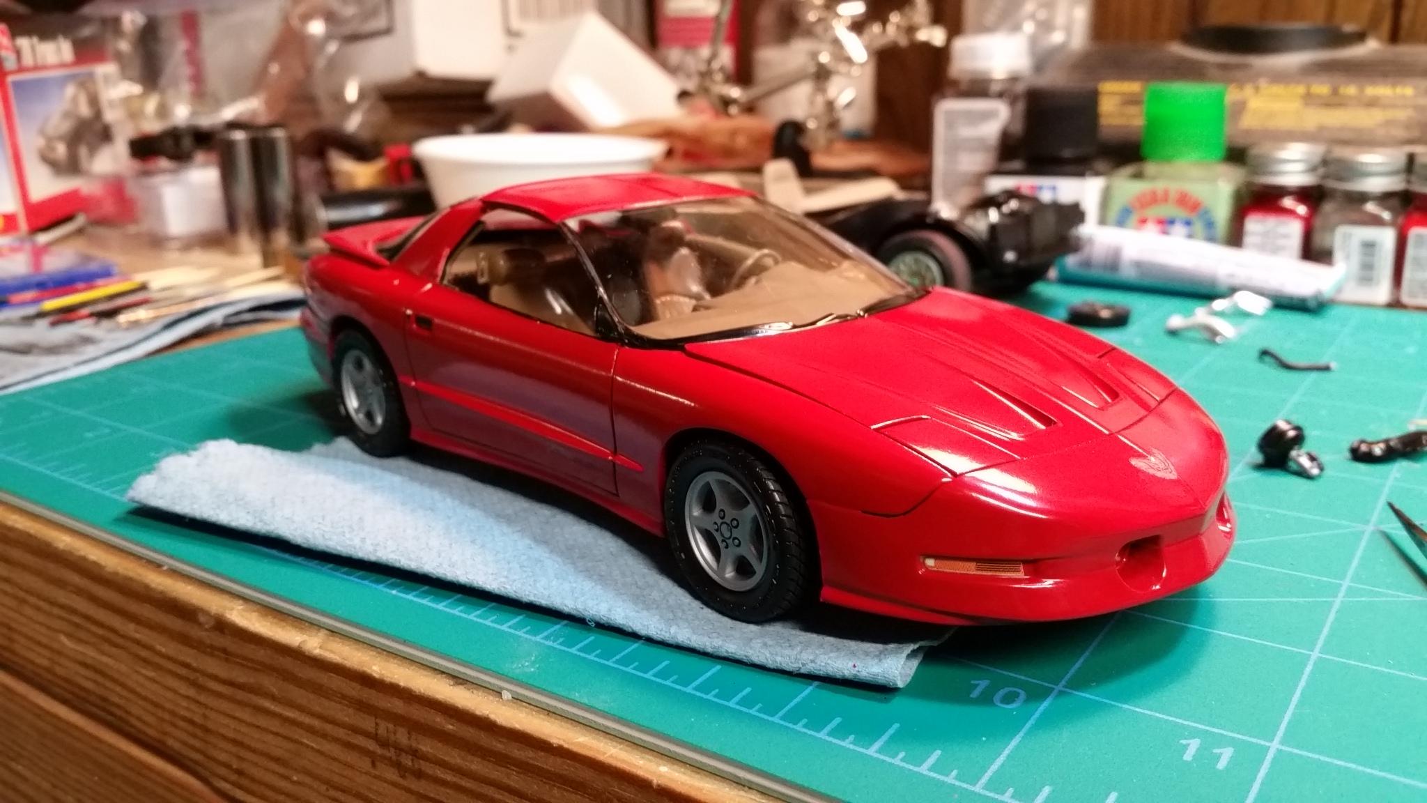

ksnow Posted October 7, 2020 Posted October 7, 2020 Got the 97 TA final assembly mocked up. Need to work on the roof to body fit a touch. Also need to finish a few underhood details and install the exhaust tips.

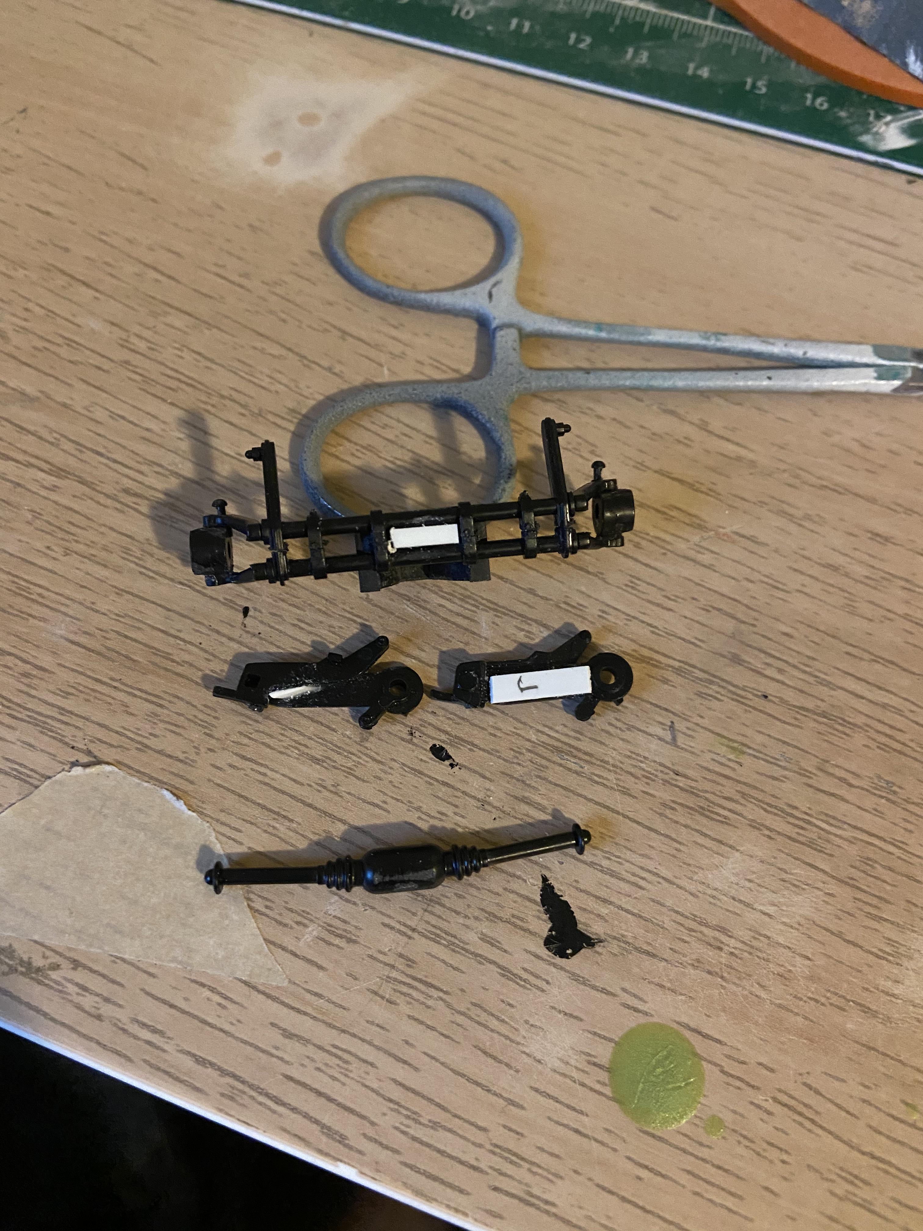

carnut Posted October 10, 2020 Posted October 10, 2020 it took me almost all week, but last night I finally figured out how to lower the Tamiya 1966 VW Beetle suspension. The rear was not too much of a problem but the front end was a major pain. Sorry no photos.
stitchdup Posted October 10, 2020 Posted October 10, 2020 21 minutes ago, carnut said: it took me almost all week, but last night I finally figured out how to lower the Tamiya 1966 VW Beetle suspension. The rear was not too much of a problem but the front end was a major pain. Sorry no photos. I do them by drilling through the arms, then cutting them off and using pins to hold them on. Then once you have it sitting at the height you want it just takes a drop of glue on the top arms to hold it in place

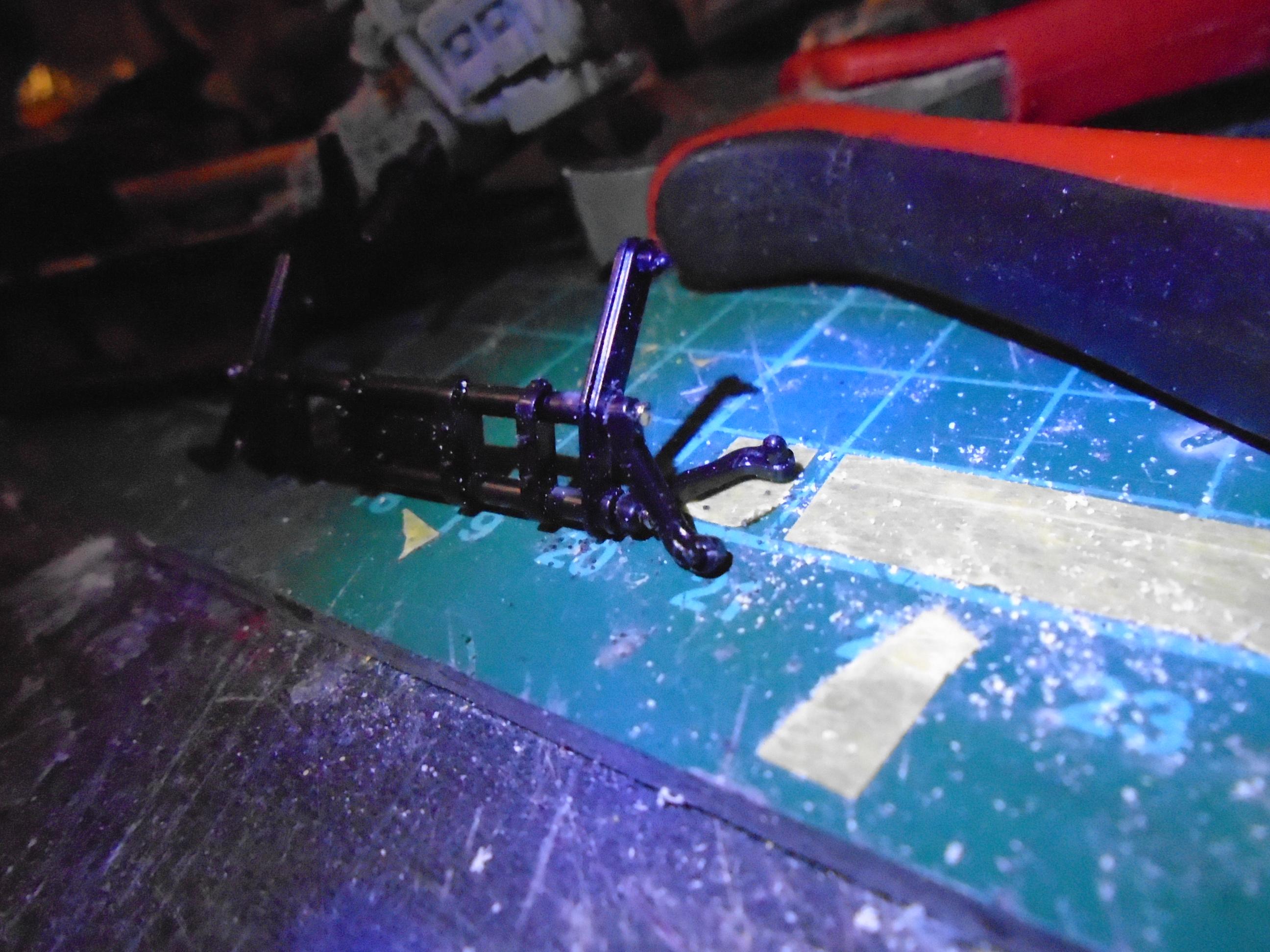

carnut Posted October 11, 2020 Posted October 11, 2020 Here is what I did on my Tamiya 66 VW. I wanted my VDub to stupid low, so on the front end I cut the front axle horizontally down the middle and then cut 1 mm from each piece and then glued it back together. Next I cut up in the mounting box so the axle is really moved up. The rear end I cut notches on the suspension arm and then pushed it up and glued it in place. Evergreen styrene was used to re-enforce the glue joints.

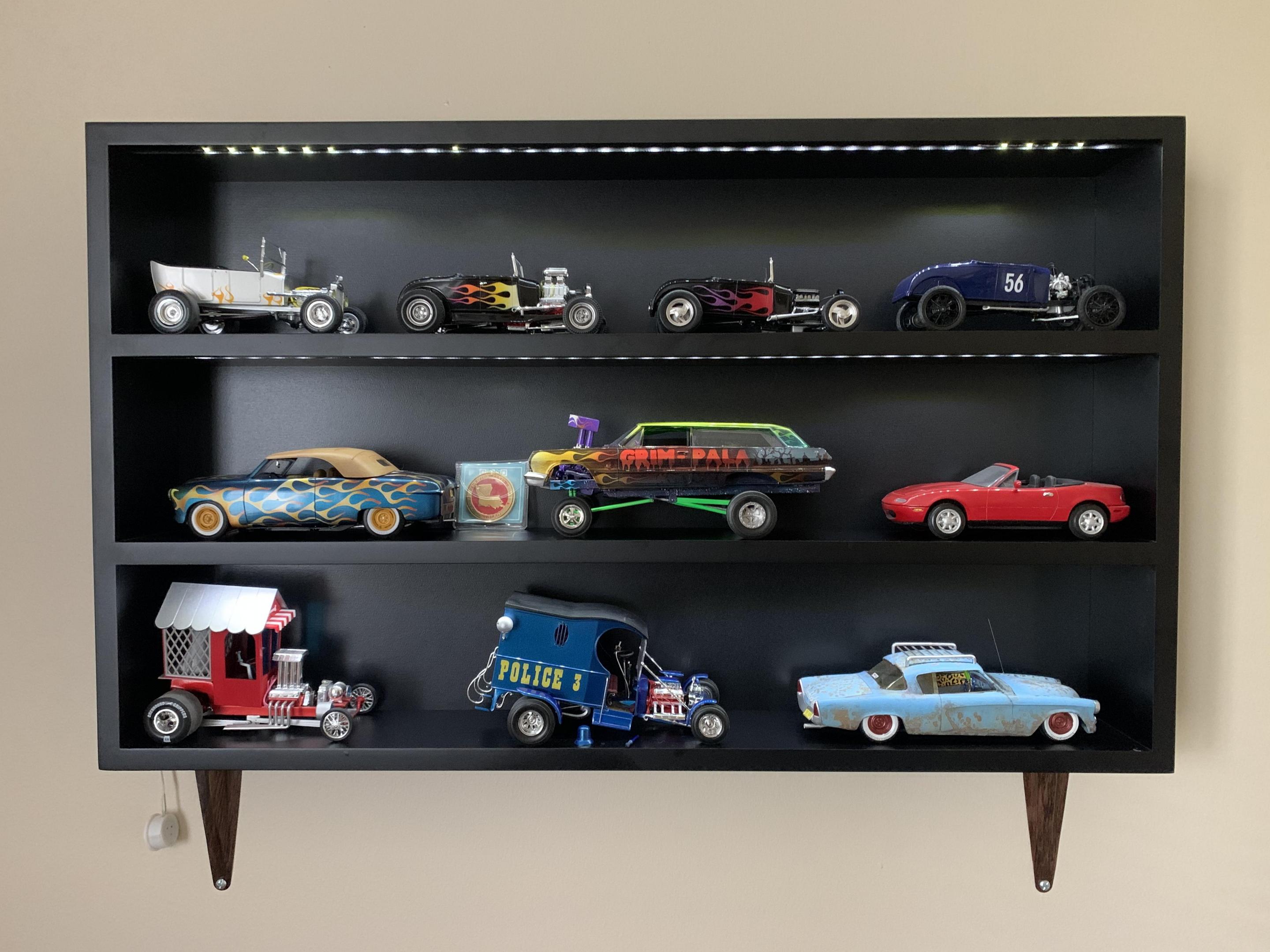

OldNYJim Posted October 11, 2020 Posted October 11, 2020 Already posted this in the “what did you get” thread but seeing as it was most of what I accomplished today that was Model related here it is again...got my new display case hung and mounted! Nice to have a spot to display some of my finished builds - already need a second though ?
