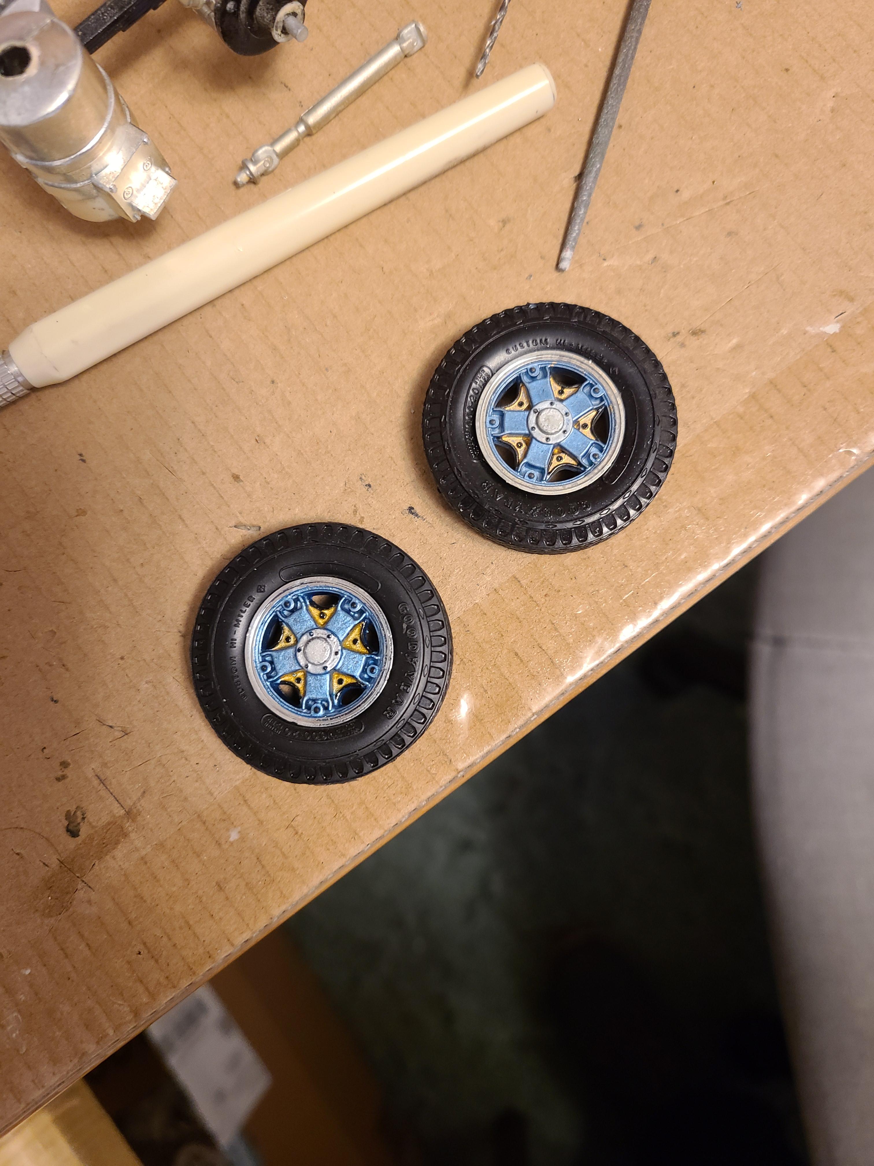

Sam I Am Posted December 17, 2020 Share Posted December 17, 2020 While thinking through things on the Elcamino, I had a squirrel moment while looking for something else. That led to a restoration of this Chevy Titan. I liked the looks of it and the ob definitely put some work into it. So I scrubbed it up, figured out what was missing, and started work. One front wheel was missing and I did not have the correct color, so I mixed it. Original is on the right. Quote Link to comment Share on other sites More sharing options...
Modlbldr Posted December 17, 2020 Share Posted December 17, 2020 That's looking really good Sam! Later- 14 hours ago, Sam I Am said: Quote Link to comment Share on other sites More sharing options...

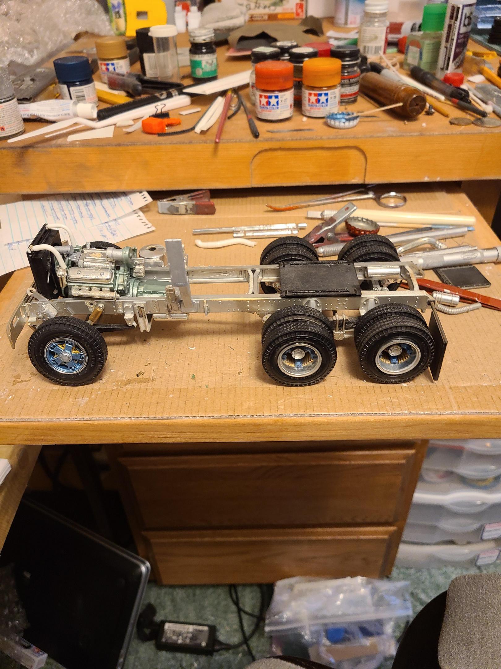

Sam I Am Posted December 20, 2020 Share Posted December 20, 2020 Chassis is pretty much buttoned up. Keeping it worn and dulling down any new parts I have to use to try and make it match. Quote Link to comment Share on other sites More sharing options...

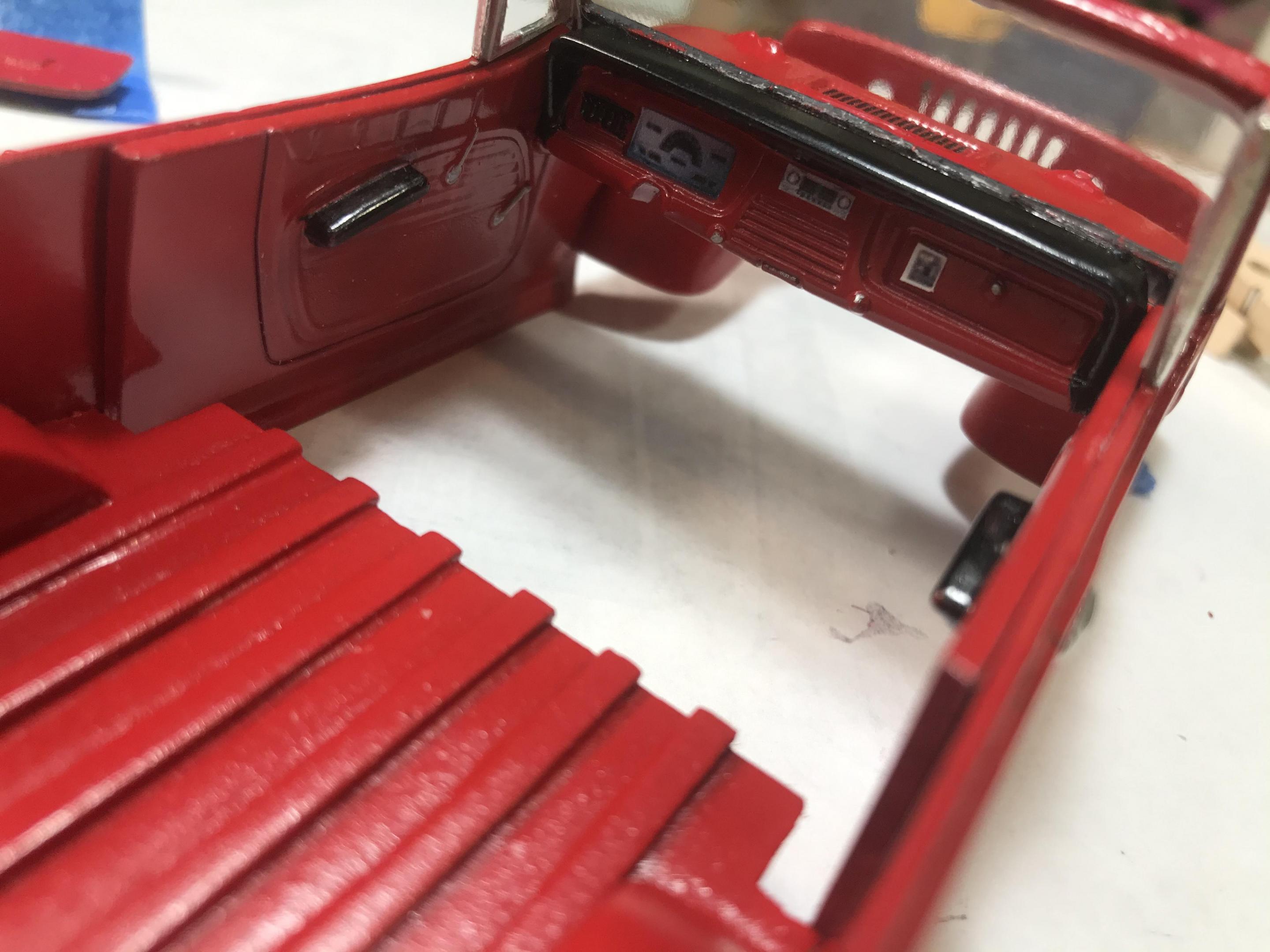

Tom Geiger Posted December 20, 2020 Share Posted December 20, 2020 (edited) Getting my Rubix Cube together! I had cut apart the Jeepster interior to mold in the pickup bed. Nobling is building the same kit and we’ve been comparing notes. He warned me the kit’s windshield interfered with the dash bottom. I was past that step, I cut mine from Evergreen clear sheet. I knew the remaining interior wouldn’t slide in as a unit. Here is the door cards that I glued inside the body, while capturing the dashboard between them. Next step was the back wall of the cab, which needs to key in between the door cards and the fixed pickup bed. To add to this, it also needs to match up with the pickup roof. Lots of temporary taping and that’s all drying now. Tomorrow I can glue in the floor and maybe get this all mounted onto the rolling chassis. Edited December 20, 2020 by Tom Geiger Quote Link to comment Share on other sites More sharing options...

Tim08 Posted December 20, 2020 Share Posted December 20, 2020 Very nice! Quote Link to comment Share on other sites More sharing options...

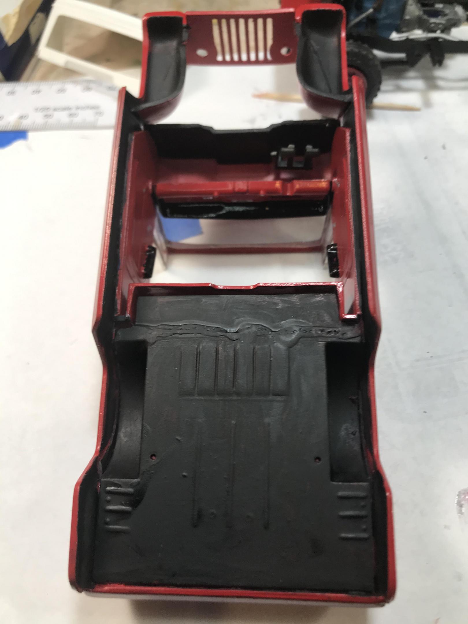

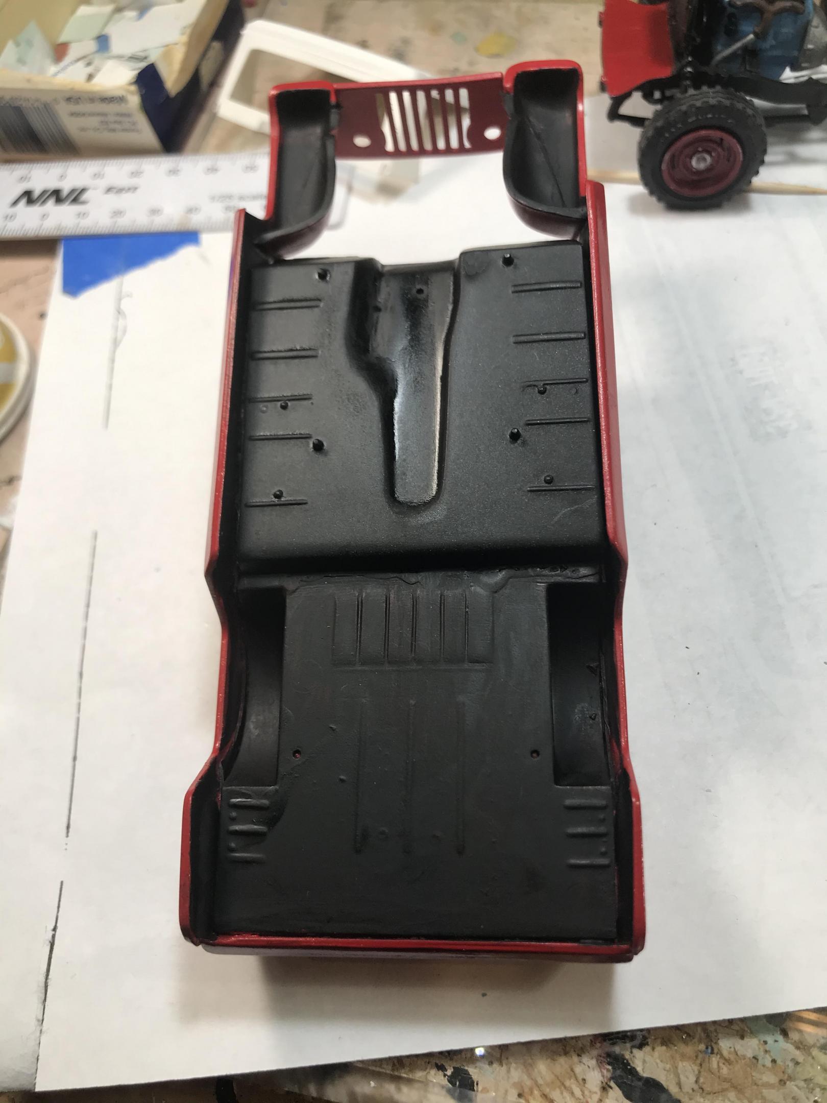

Tom Geiger Posted December 20, 2020 Share Posted December 20, 2020 I’m back... Here’s the underside. Looks like little progress but is quite tedious since everything needs to key together... And with the floor glued in place. If you know this kit, note that the trans hump is a completely different shape to accommodate the transfer case and transmission from the Jeepster straight four. The floor also covered up the glue showing in the first photo. Anything still showing is under the chassis rails when done. Tomorrow I’m hoping to mate this with the finished chassis. Then it’s all little details beyond that! Quote Link to comment Share on other sites More sharing options...

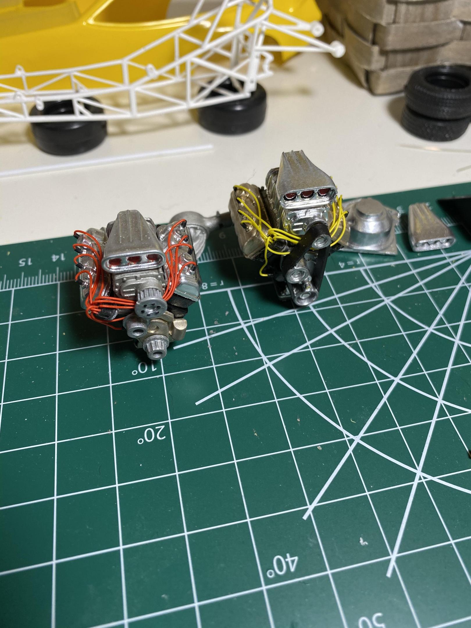

Brandon17 Posted December 20, 2020 Share Posted December 20, 2020 First time wiring up an engine. Definitely learned a lot from doing the first one to apply to the second. I know there not perfect but they will get better with practice. Quote Link to comment Share on other sites More sharing options...
Sam I Am Posted December 20, 2020 Share Posted December 20, 2020 1 hour ago, Brandon17 said: First time wiring up an engine. Definitely learned a lot from doing the first one to apply to the second. I know there not perfect but they will get better with practice. Looks great! Quote Link to comment Share on other sites More sharing options...
Brandon17 Posted December 20, 2020 Share Posted December 20, 2020 Thank you Sam!! Quote Link to comment Share on other sites More sharing options...

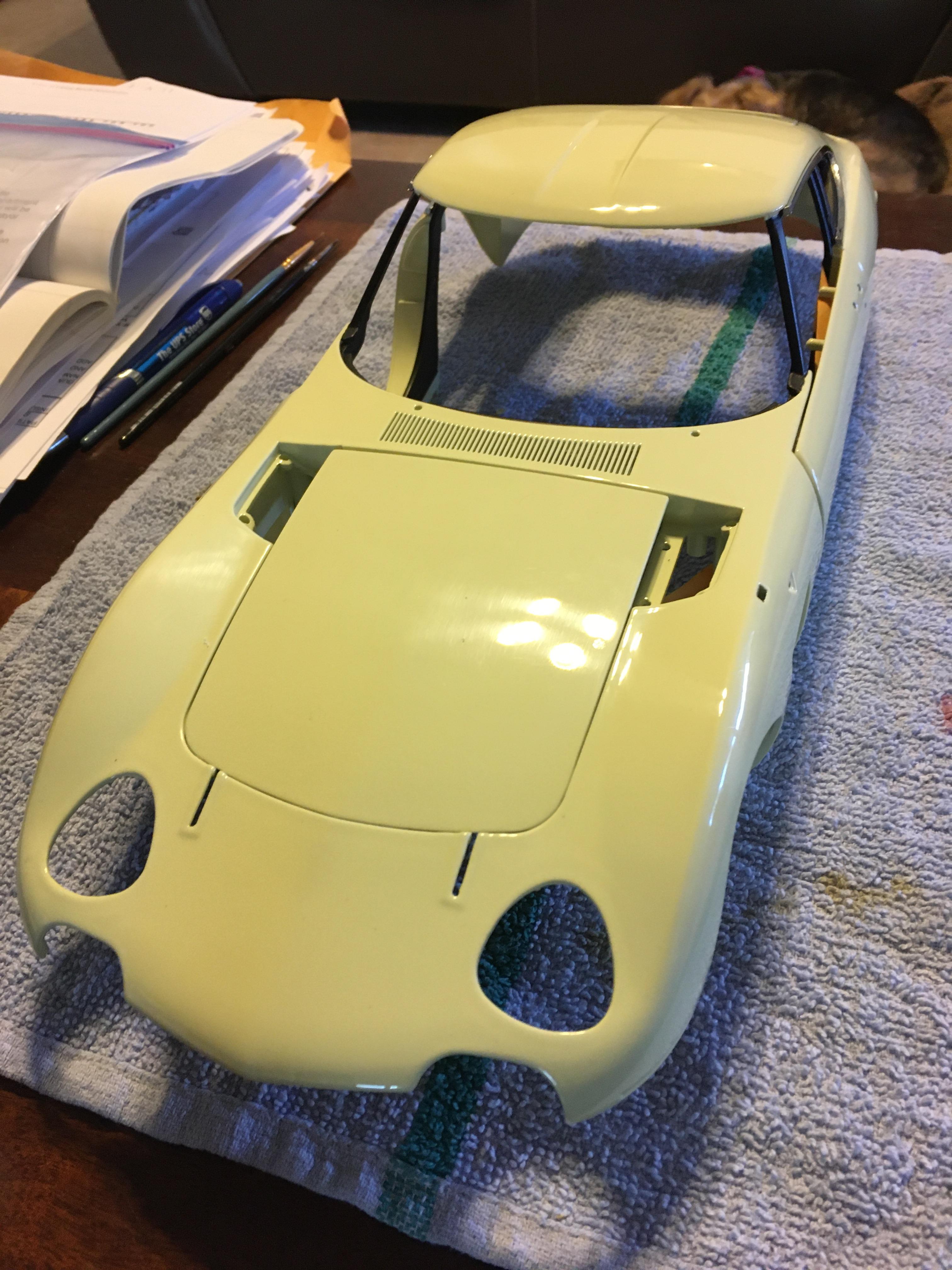

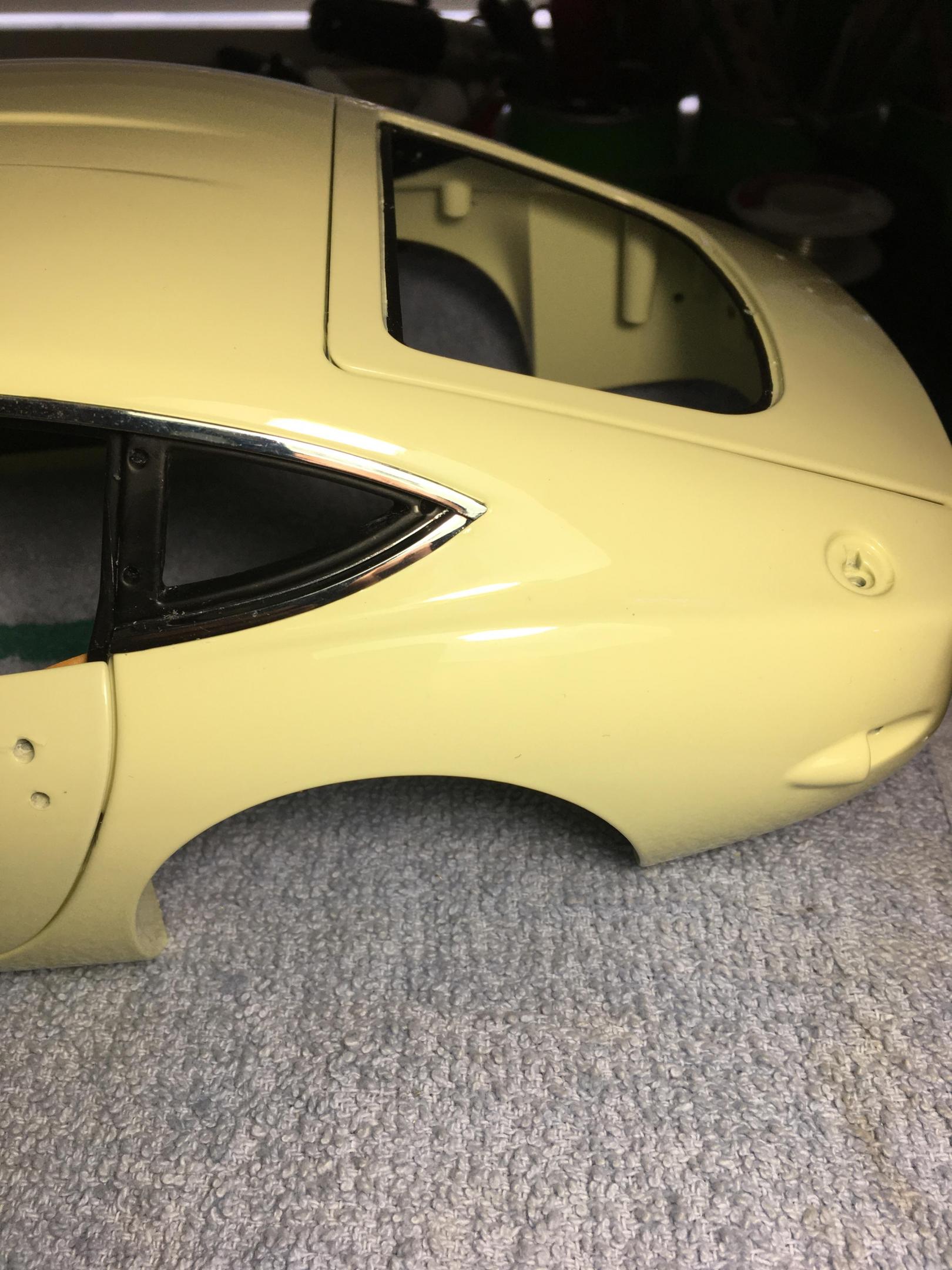

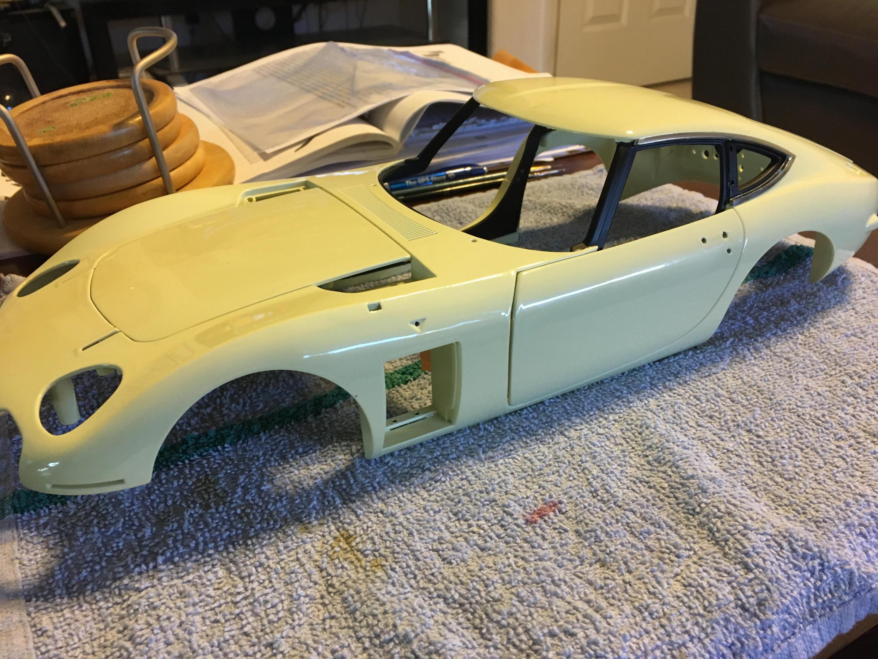

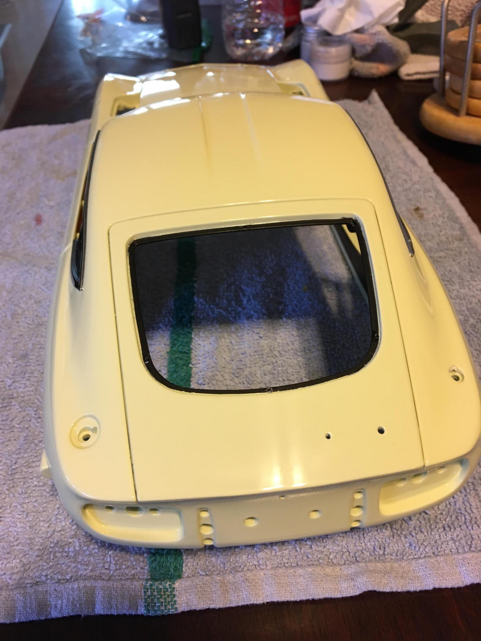

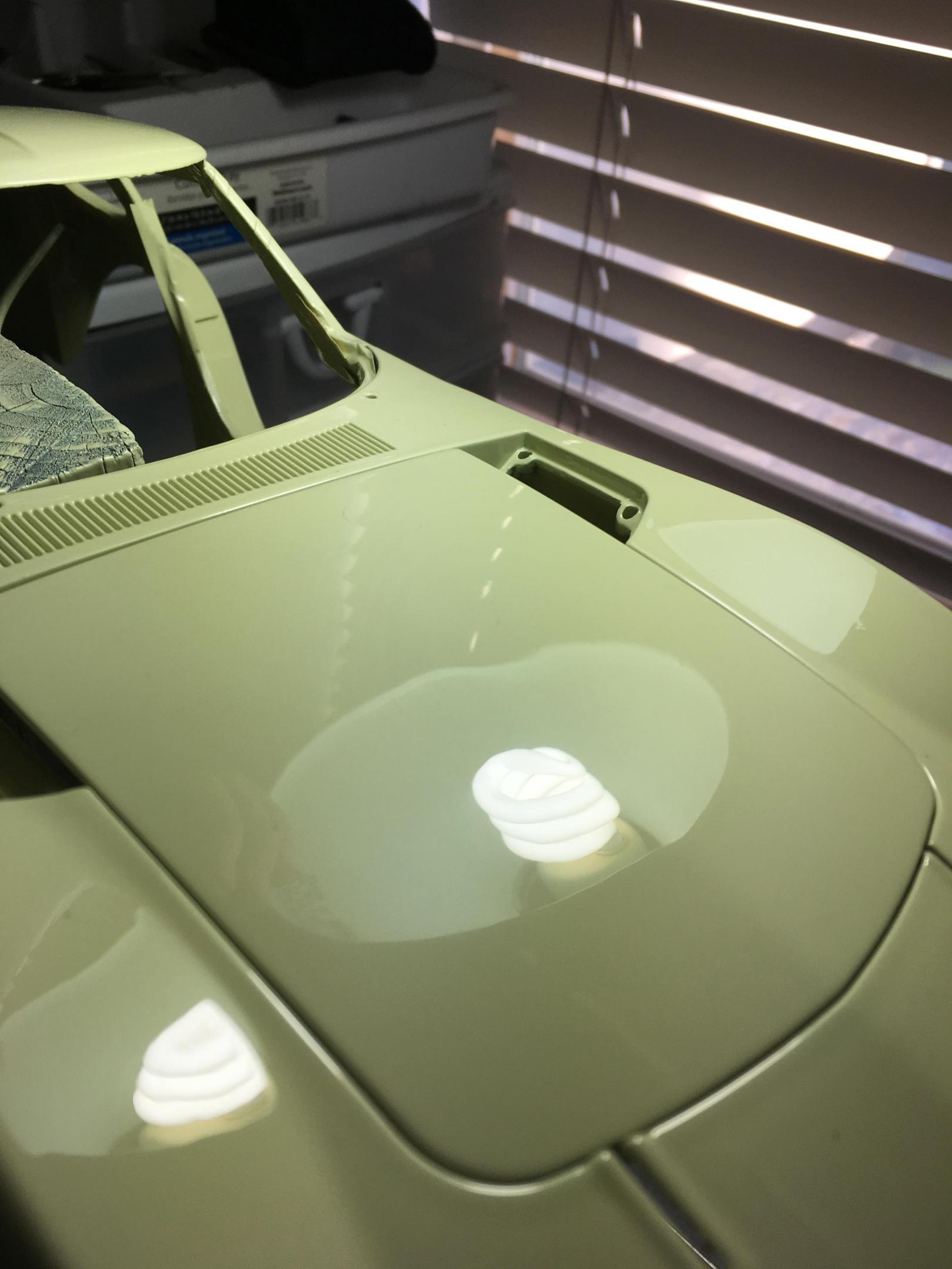

Brudda Posted December 21, 2020 Share Posted December 21, 2020 Painted a DeAgostini Toyota 2000 GT bendix yellow. Quote Link to comment Share on other sites More sharing options...
TransAmMike Posted December 21, 2020 Share Posted December 21, 2020 Goodness Bruce, looks like glass. I'm sure at least some of us here would like to know what paint and your process on the Toyota. I know I do. ? Quote Link to comment Share on other sites More sharing options...

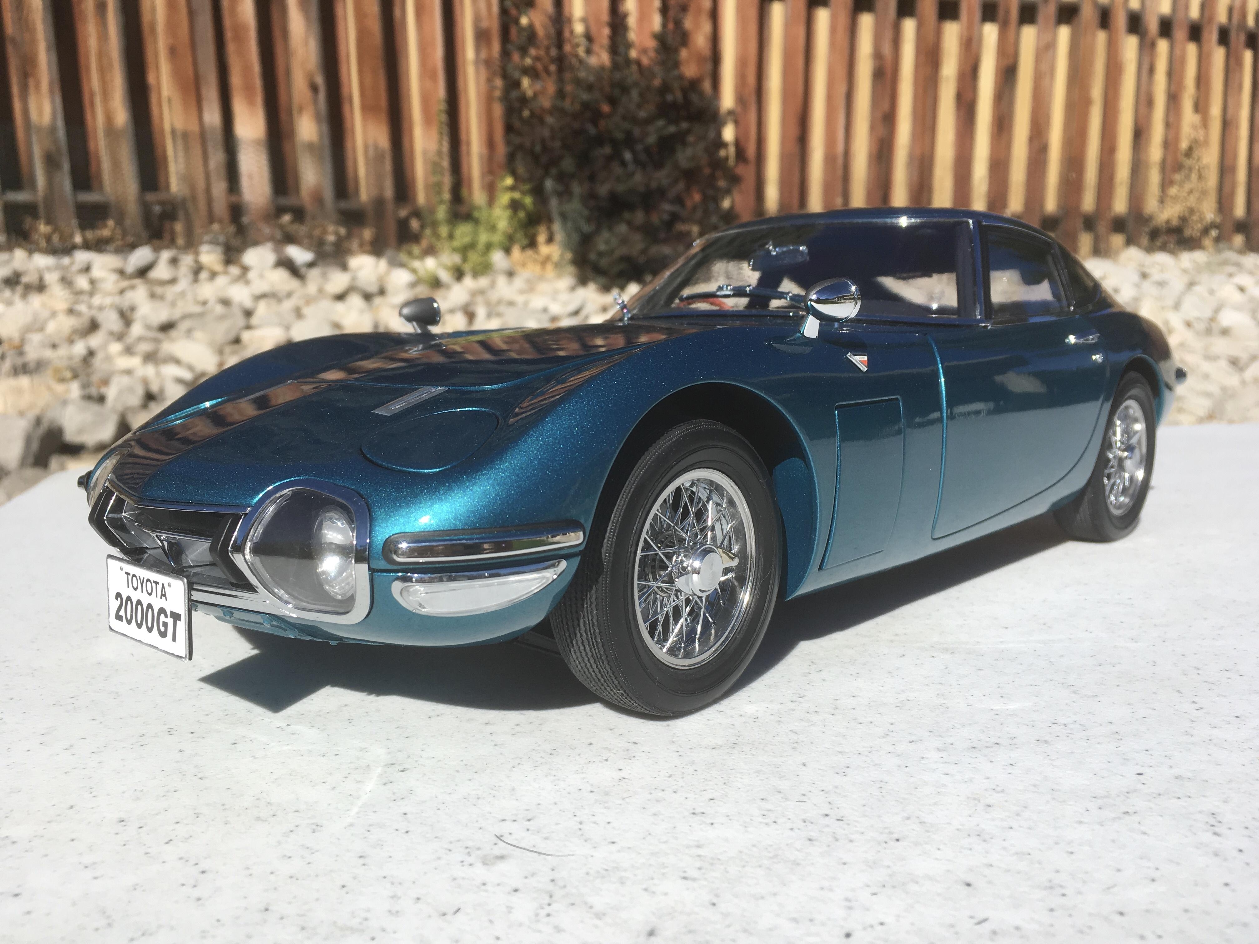

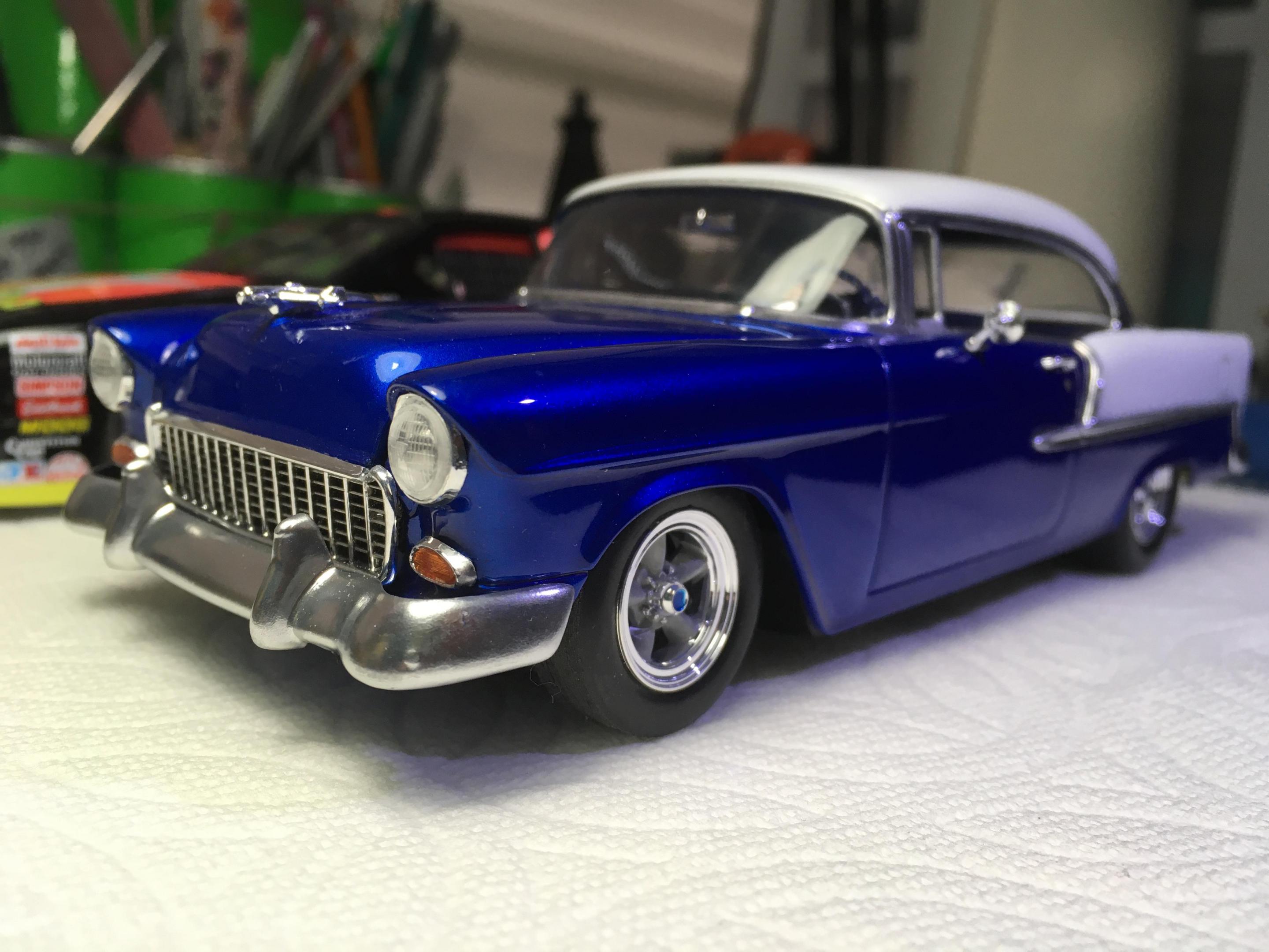

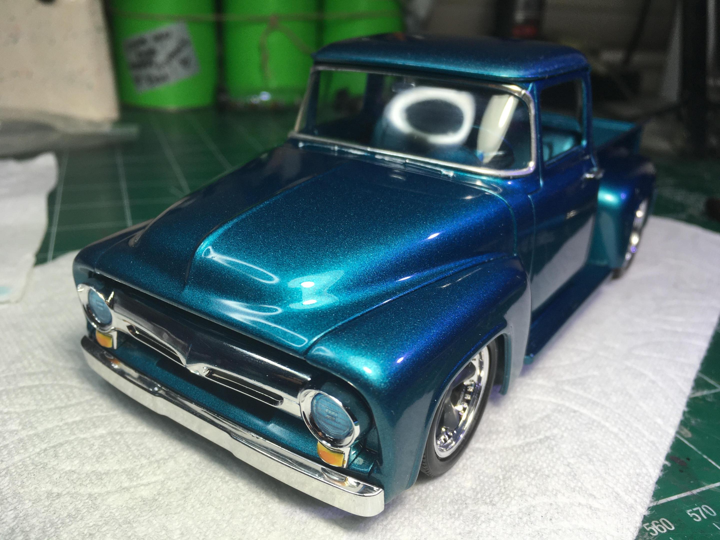

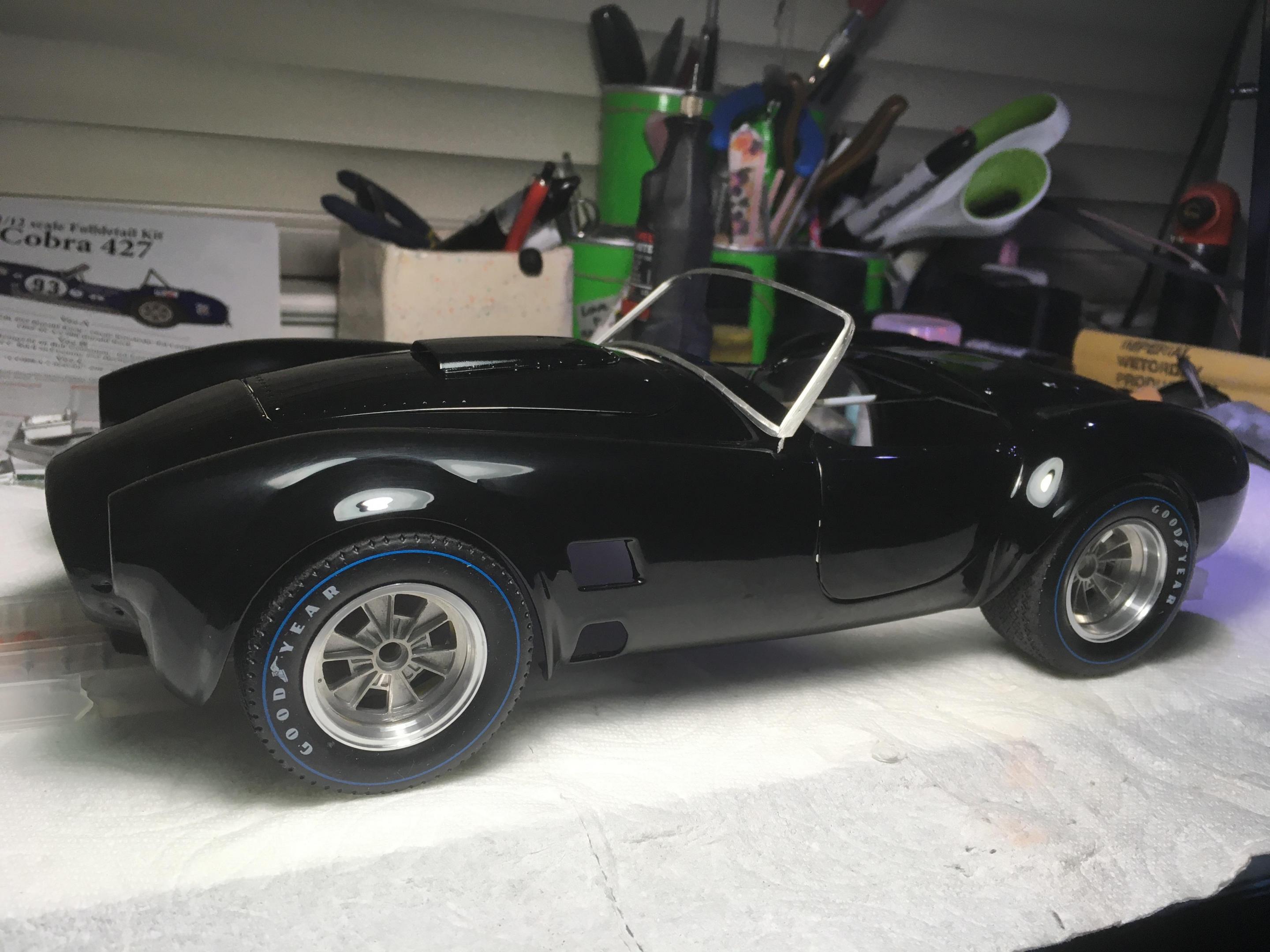

Brudda Posted December 23, 2020 Share Posted December 23, 2020 On 12/21/2020 at 9:09 AM, TransAmMike said: Goodness Bruce, looks like glass. I'm sure at least some of us here would like to know what paint and your process on the Toyota. I know I do. ? Hello TransAmMike. This is going to be a little long winded. I’m going to humble myself and say most of you guys are better modelers than myself. With that being said I have been in the body shop business since 1969. Going to retire very soon. I do have most certifications on most automotive paint systems. So I do know paint just a little. I CANNOT paint a model car body with model paint. I have tried several times with very poor results. I do not know how you guys paint with that stuff. I do know how to weld( mig, tig etc with all certifications on those as well) ( computer frame equipment certs also) . I’m currently working on a 2020 corvette. Just a little history on myself. So I am very lucky to be in model car building. I have a lot of money in paint guns. A new paint gun costs $1000 today. Gone are the $100 spray guns for automotive refinishing. ( although you can do a backyard paint job on the cheap) but not on a 2020 corvette. Now to get to the point. I use a sata minijet for most models. It’s a small detail spray gun. But it’s expensive. This is what I use for the base paint. I use a iwata lph 400 for the clear. I am painting this for DeAgostini model space company. The body is going to England. The base I use is a water based automotive paint with a urethane clear. DeAgostini gave me some zero paints for the color match, but I could not use it. In the real automotive world we call it BLAH_BLAH_BLAH_BLAH. I sent the zero paint to my paint company and they hated it for a spray out. They also called it BLAH_BLAH_BLAH_BLAH. I repeat, how do you guys use this stuff? So my paint company called Toyota archives for the actual paint code. Soo I painted the Toyota 2000 GT with real automotive paint. If you want , I can give you the actual stuff I used but most guys find it too complicated and it is expensive. I’m very lucky in that respect, that I get the paint and clear for free. Since our dealership spends a lot of money a month for paint, I get my stuff for free. Here is some examples of the models I have painted. . If you decide to jump into the world of automotive paints, I can direct you in the proper and least expensive path. Just give me a PM. Quote Link to comment Share on other sites More sharing options...
TransAmMike Posted December 23, 2020 Share Posted December 23, 2020 Wow....and WOW again?. Those paint jobs are awesome Bruce and so are those model builds!! Your skills being a professional auto body painter certainly reflect (no pun intended there) in the quality. I'd say, the majority here use model paints (air brushed or rattle canned) with some use of craft acrylic even and more of a hobby grade air brush. And there are some here that do great paint jobs with it. My painting skills leave a lot to be desired and my modeling skills in general are far from that of a lot of the guys' on this forum but heck, I just keep plugging away. Quote Link to comment Share on other sites More sharing options...

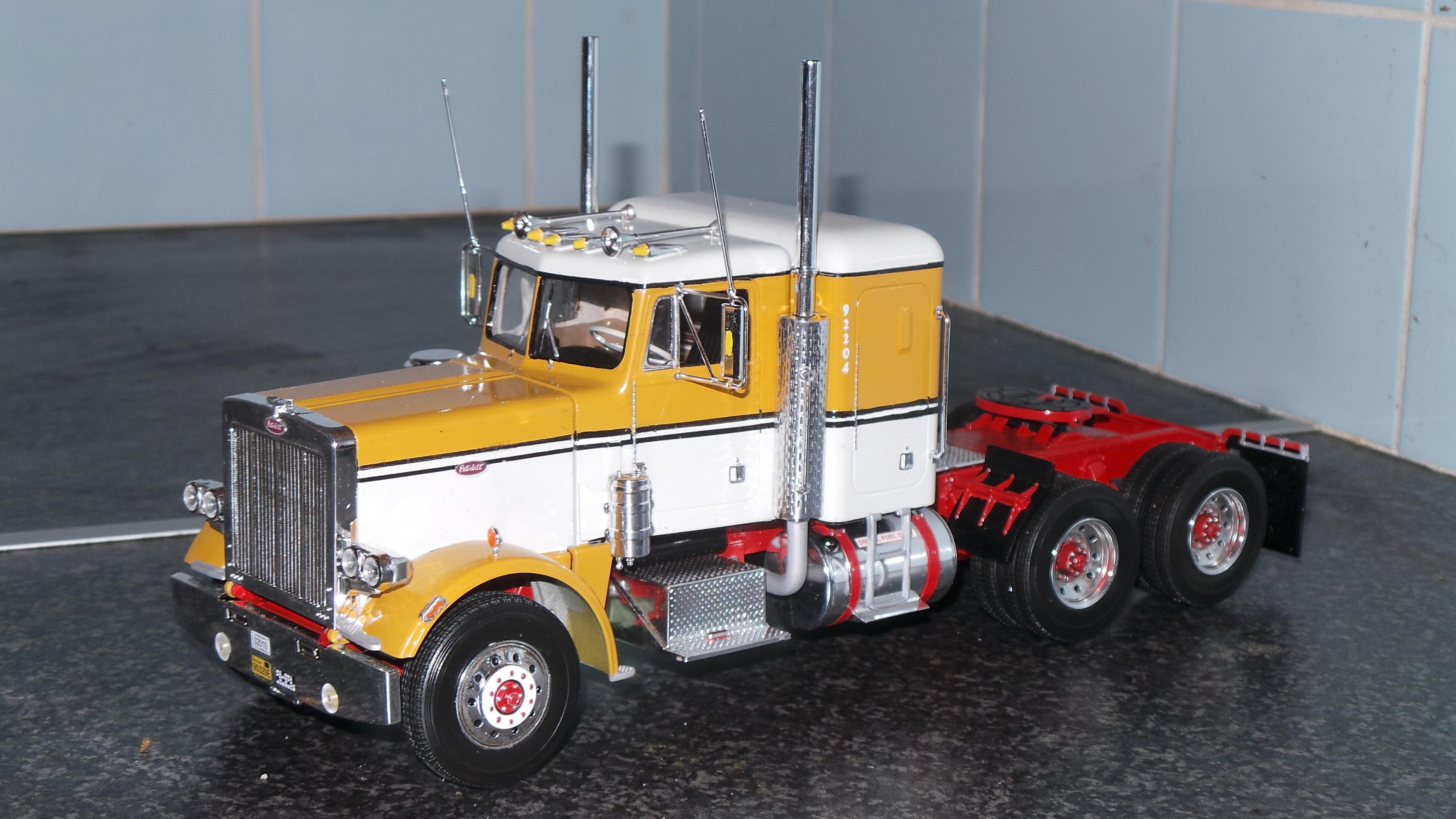

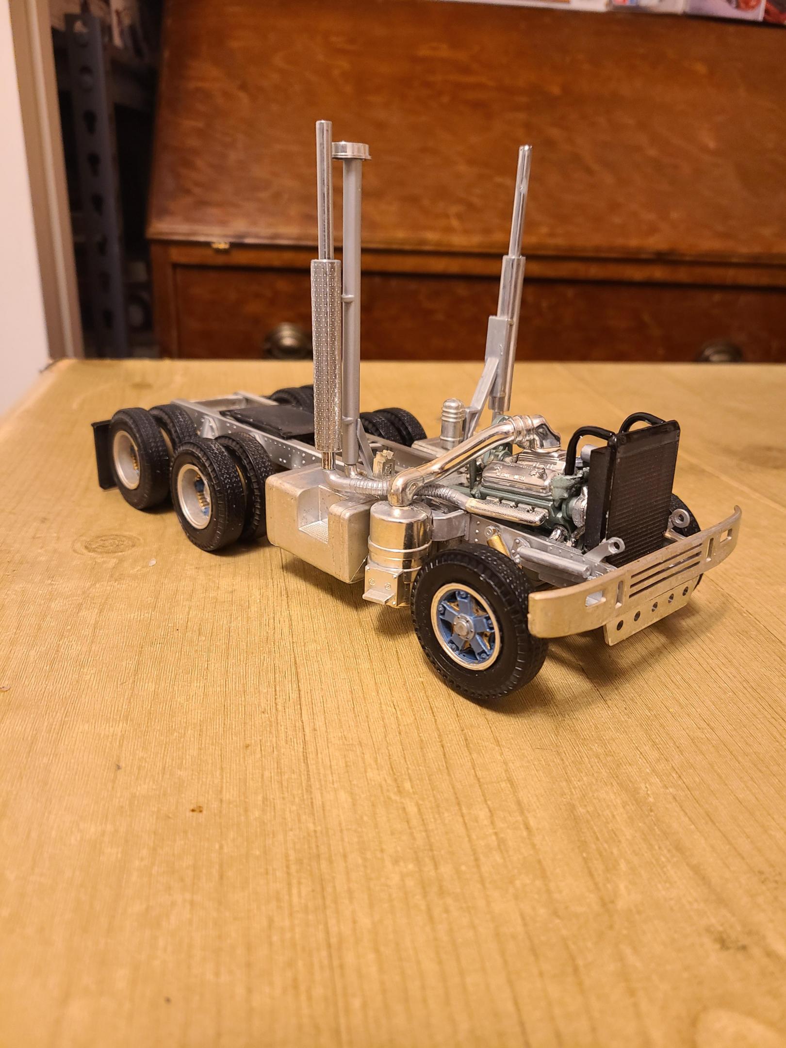

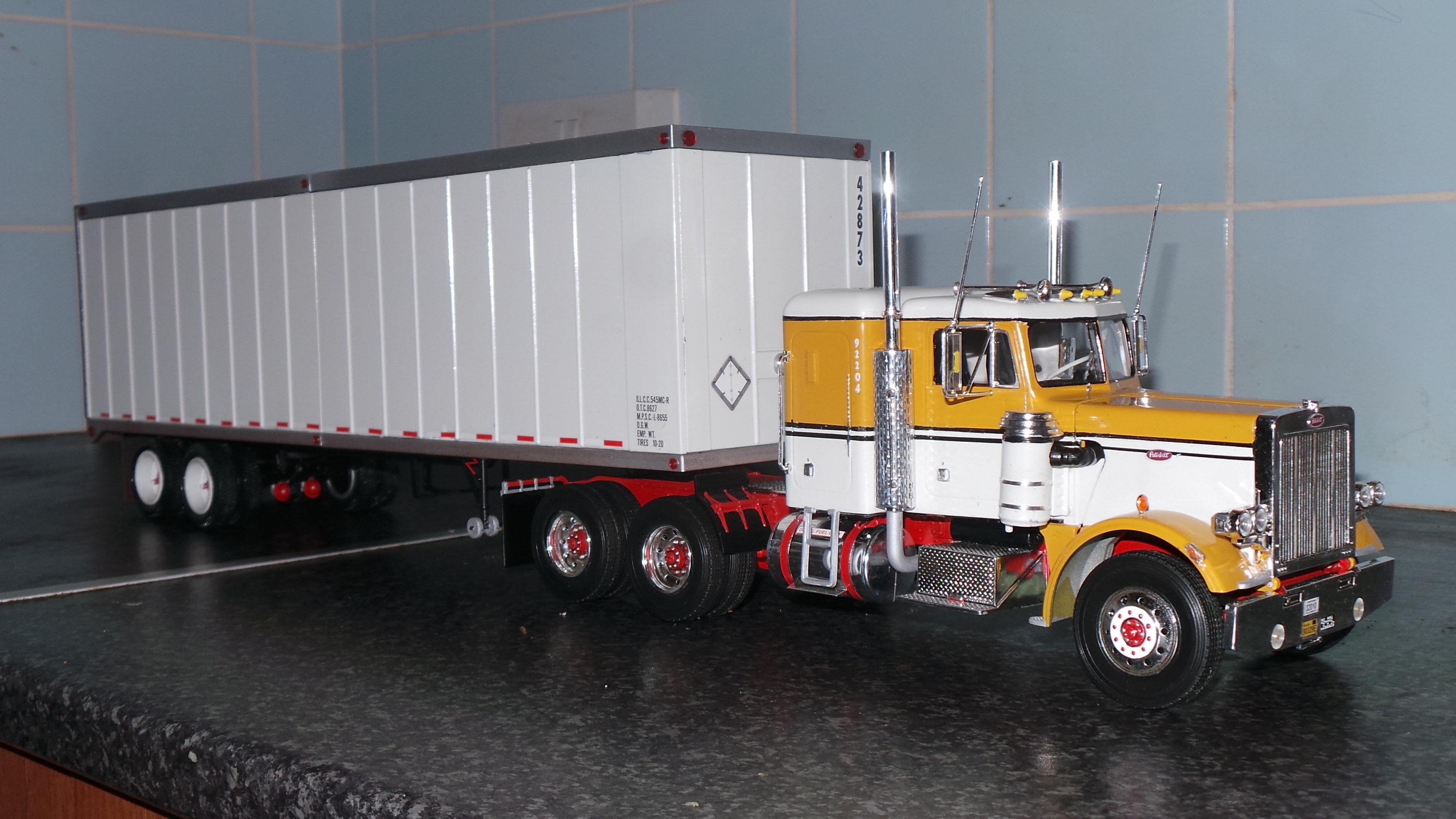

doorsovdoon Posted December 23, 2020 Share Posted December 23, 2020 Well, it wasn't today, it was over the course of about five, but I built my first big rig and trailer! It's the AMT semi box trailer and the Revell Peterbilt 359 Conventional. As I do every year I struggle to find what to get the family for Christmas. I thought since I've got the model building bug it would be a great idea to build a big rig and trailer for my dad who was a truck driver for nearly 50 years. I put it in a box and dropped it off to him yesterday, he's very anxious to know what's in it! It's been a long time since I've looked forward to Christmas day, his reaction is going to be priceless! haha, Quote Link to comment Share on other sites More sharing options...

Bob Warfield Posted December 24, 2020 Share Posted December 24, 2020 Bruce, after seeing your builds I think I may throw all my junk away and take up knitting! Thanks...Bob Quote Link to comment Share on other sites More sharing options...

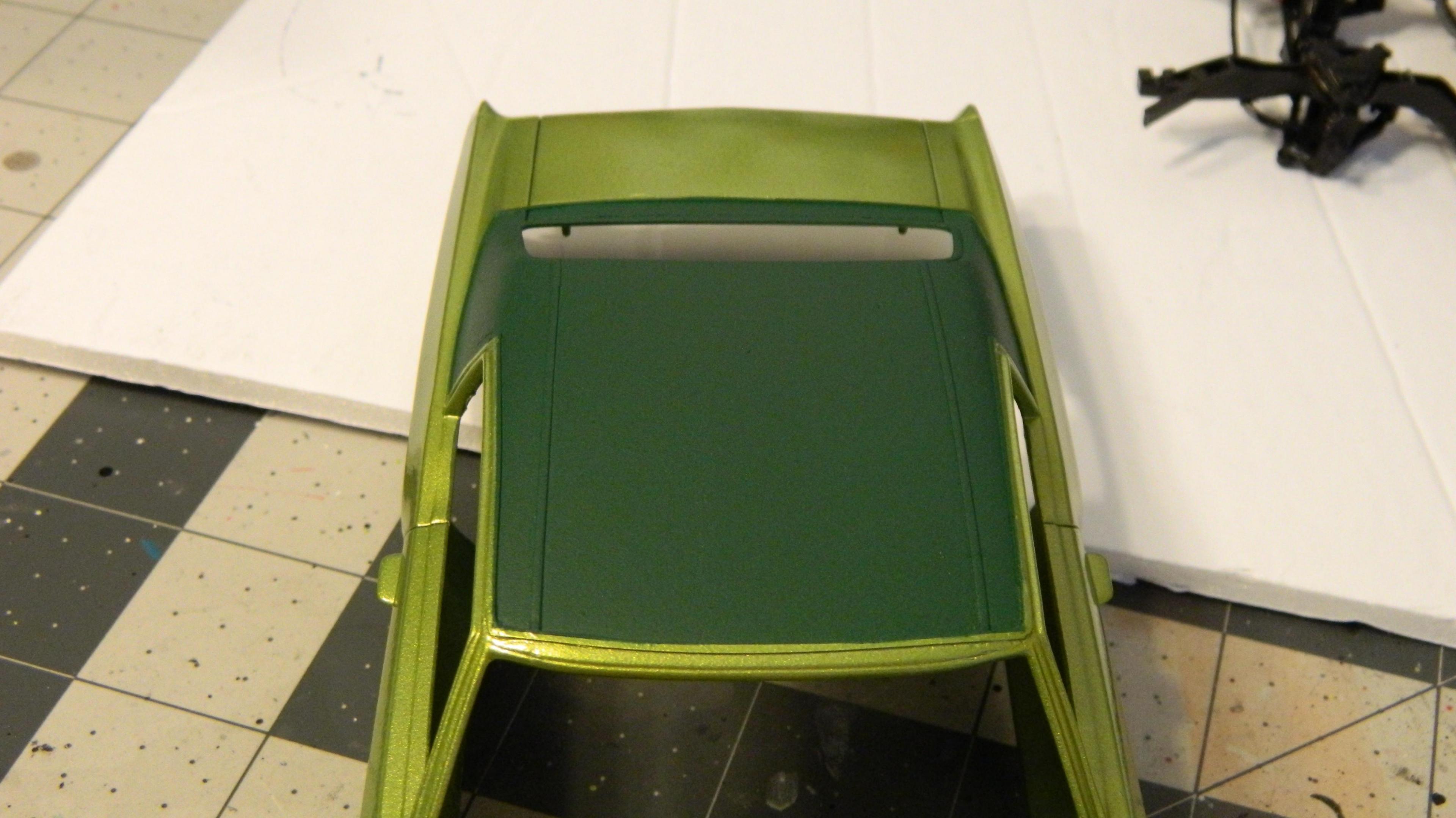

Dragonhawk1066 Posted December 24, 2020 Share Posted December 24, 2020 A couple of days ago, I managed to finally put the paint down on my first vinyl top job on a model kit. I used .010" x .030 " styrene strip for the trim and seams. I then sprayed some Folkart craft paint mixed thicker than for a normal color coat, and sprayed through my Paasche H at about 30psi and at a distance of about 12 inches or so to try to get a texture to it. Not perfect, but I'm very happy with my first attempt at this. BMF for the trim after Christmas, and then final assembly hopefully before the New Year, if my back cooperates?☹️. Quote Link to comment Share on other sites More sharing options...
espo Posted December 24, 2020 Share Posted December 24, 2020 Very accurate looking moldings. Quote Link to comment Share on other sites More sharing options...
