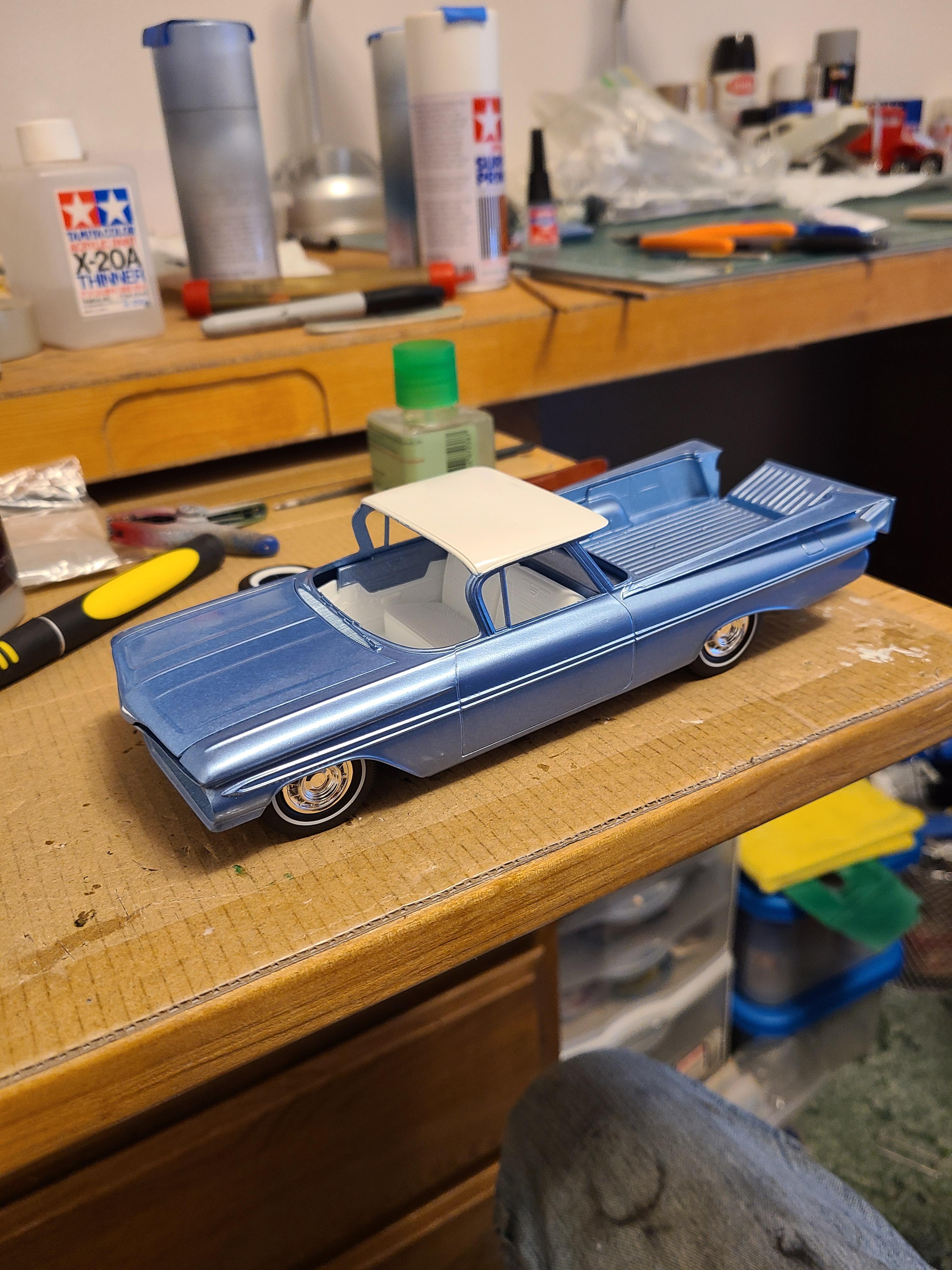

Just poured two new molds and got them into the pressure pot - '62 Newport front seat and headlight lenses, Buick nailhead stock valve covers (for the '63 Riviera) corrected with flanges added, and original issue '65 GTO steelies. Also got axle pins ready for the Newports - countersunk the lowered car's set to clear the engine, and remade the stock version's pins after I had to drill out the old ones. Bit by bit...

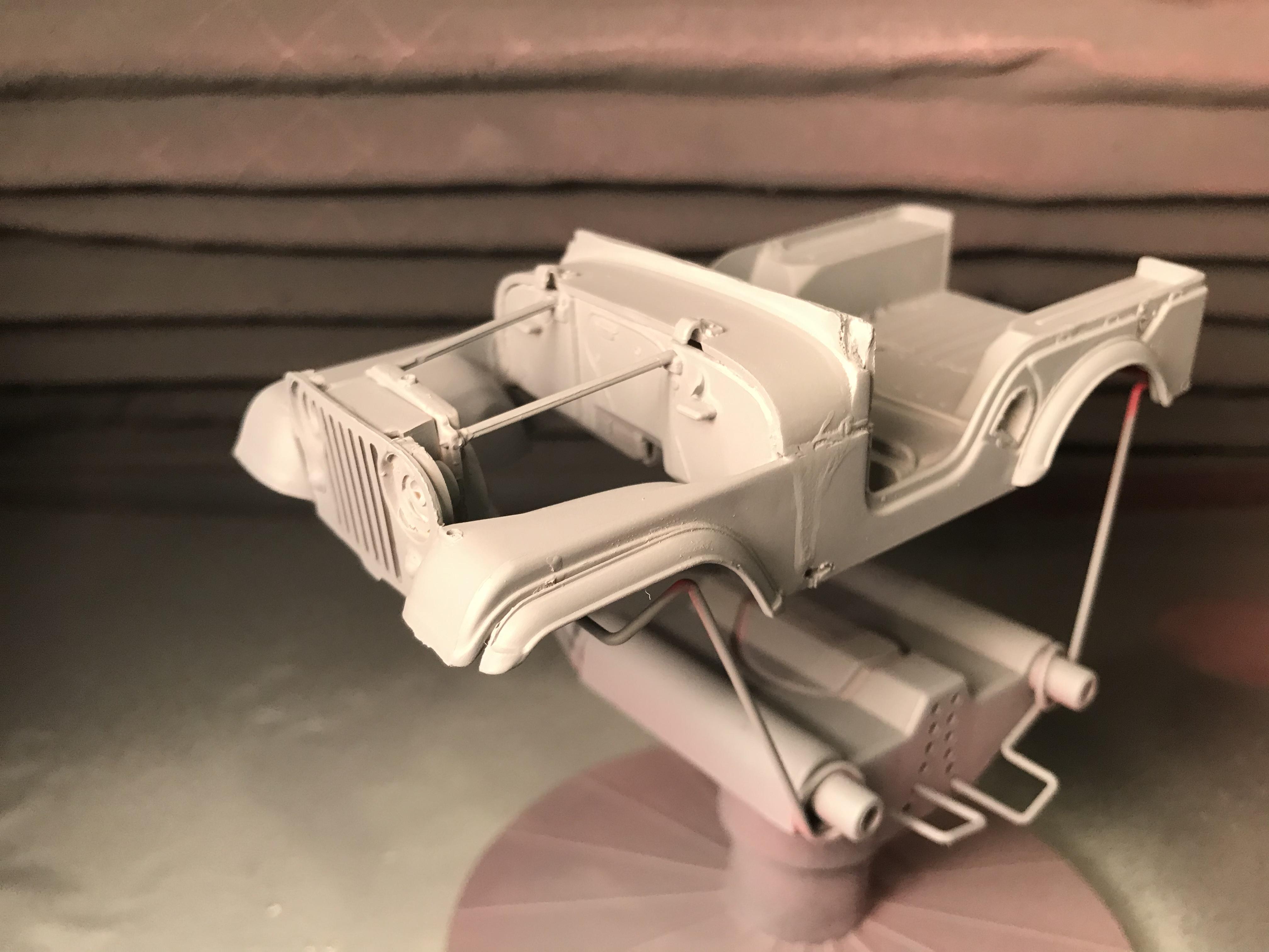

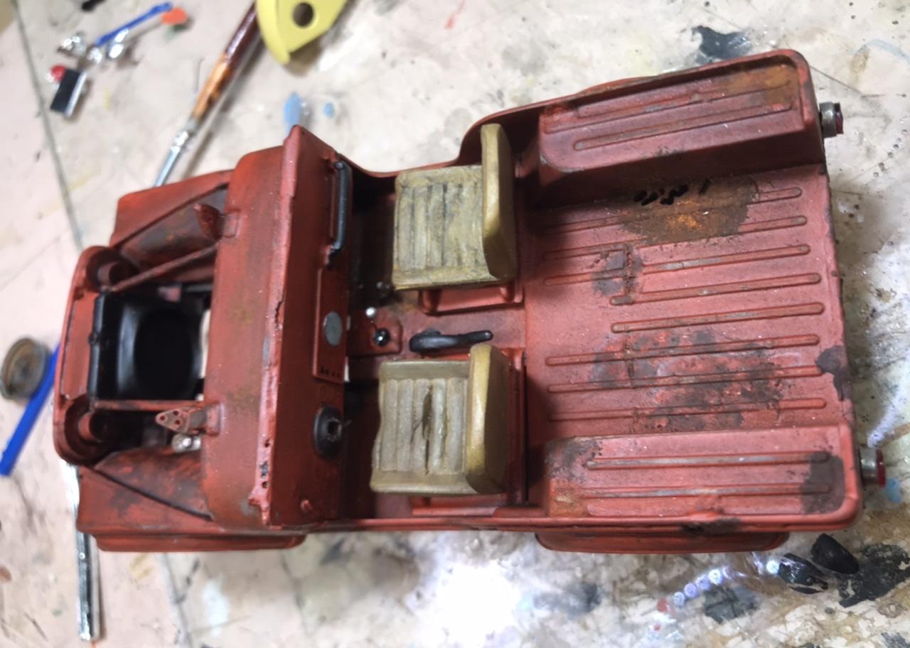

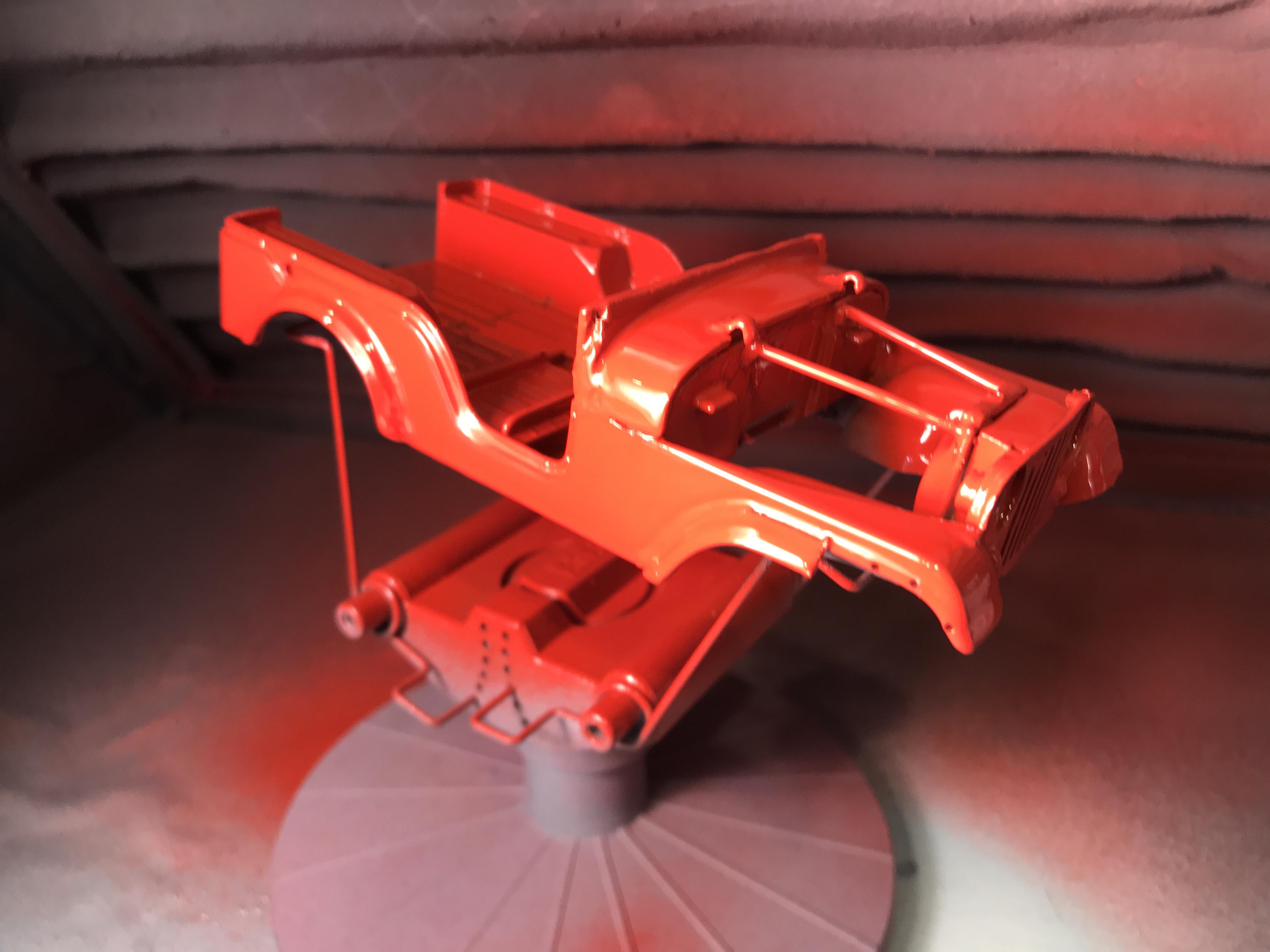

I have been working at completing the Jeepster, which is at that “glue a part and wait” stage. I had my Jeep parts box nearby. Years ago I bought a bag of broken old Jeeps at a show. This one happened to be the worst in the bag.. an old white plastic version (Matches my Mork & Mindy version), but not sure if it’s an even older release.
Some kid has built it without any paint but an over abundance of glue. The axle ends were all broken off. It just got my attention, so I pulled it apart and started sanding. The above photo is the body with gray primer.
I had no idea what color to paint it so I decided to go random.. as I went out yesterday to buy beer, I would paint it to match the first Jeep I saw.. as I was turning out of my development I had to wait as an orange Jeep drove by.. so be it! Above photo is the body painted with Chevy engine orange.
And here we are right now. I cut the broken axles off their centers and cut new ones from Evergreen rod. I glued them back into the chassis and then sprayed that whole mess flat black.
I painted the engine Jeep blue and drilled it for wiring. I made a distributor and glued it on. I will complete the wiring tomorrow.
Body was sprayed with Testors Dullcote and it’s all ready for some weathering and rusting. This puppy was missing the hood and tailgate. No worries, she’s going to be a non running project car.

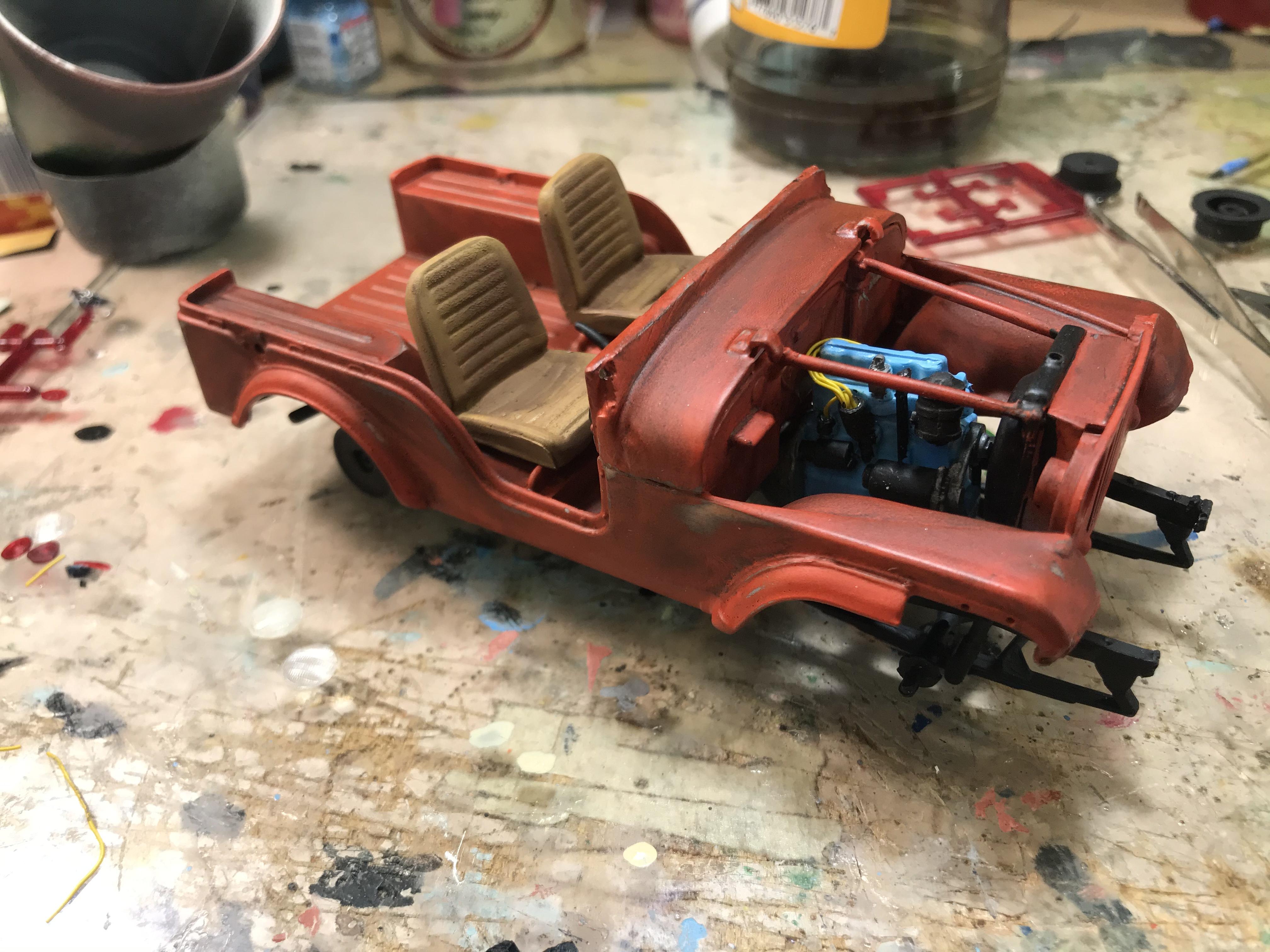

A bit more progress on my second Jeep.  But last night right before bed I wanted to retire with the image of this up on wheels in my head.
As i carefully pressed the last wheel onto it, the spindly front axle exploded into pieces! Broke the end off, tore the leaf spring with it! Argh! Back to my “one step forward, two back” theme of lately!
This morning I pulled out a fresh axle and realized the broken one was larger (no doubt why the engine wouldn’t sit on its pins), and I see that the original builder used the rear axle up front!  So at least now I have it correct.
Link to comment
Here we are right now.. recovered from the front axle debacle and we are now up on wheels. The body isn’t glued down, still have to drop engine unit into chassis first.
Rear view.. tail lights from parts cabinet. I have a drawer marked “Round Things” that I found two suitable bezels. Lenses came from the “Red Clear Parts” drawer.
Top view - interior just needs steering wheel and some details. Should be able to push this one up on a trailer this week.

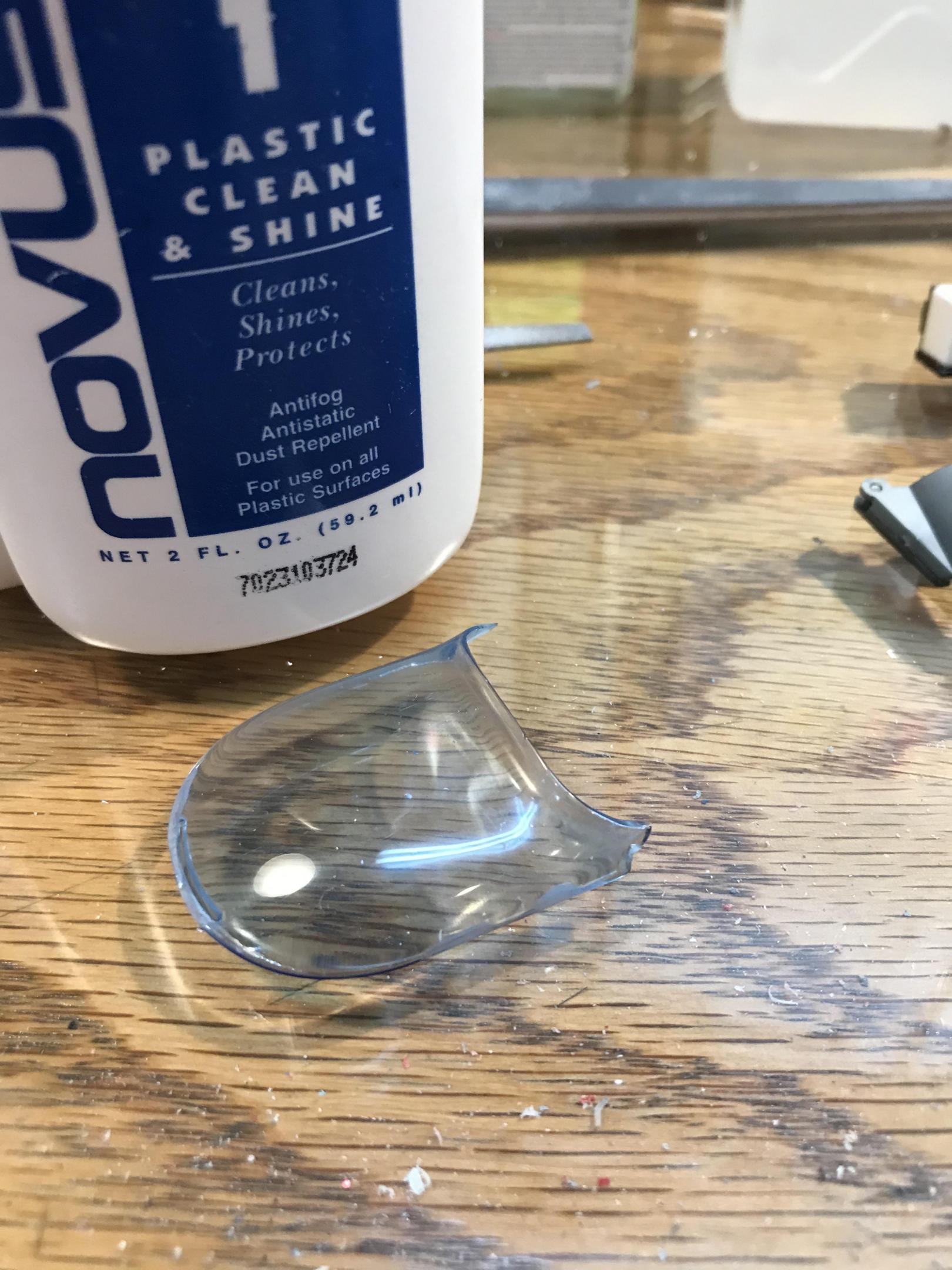

Among other details, today I polished a windshield for a rehab I am working on.  There were glue slobs on it, so I started with an x-acto and lightly took the glue down, then sanded with 600 to start....   I was not expecting exact results, and didn't get them as the glue from 30 plus years was etched into the clear plastic.  So I started with the 2400, 3200, then the 3600 and all the way to finish.  It is good enough for what I am doing.
