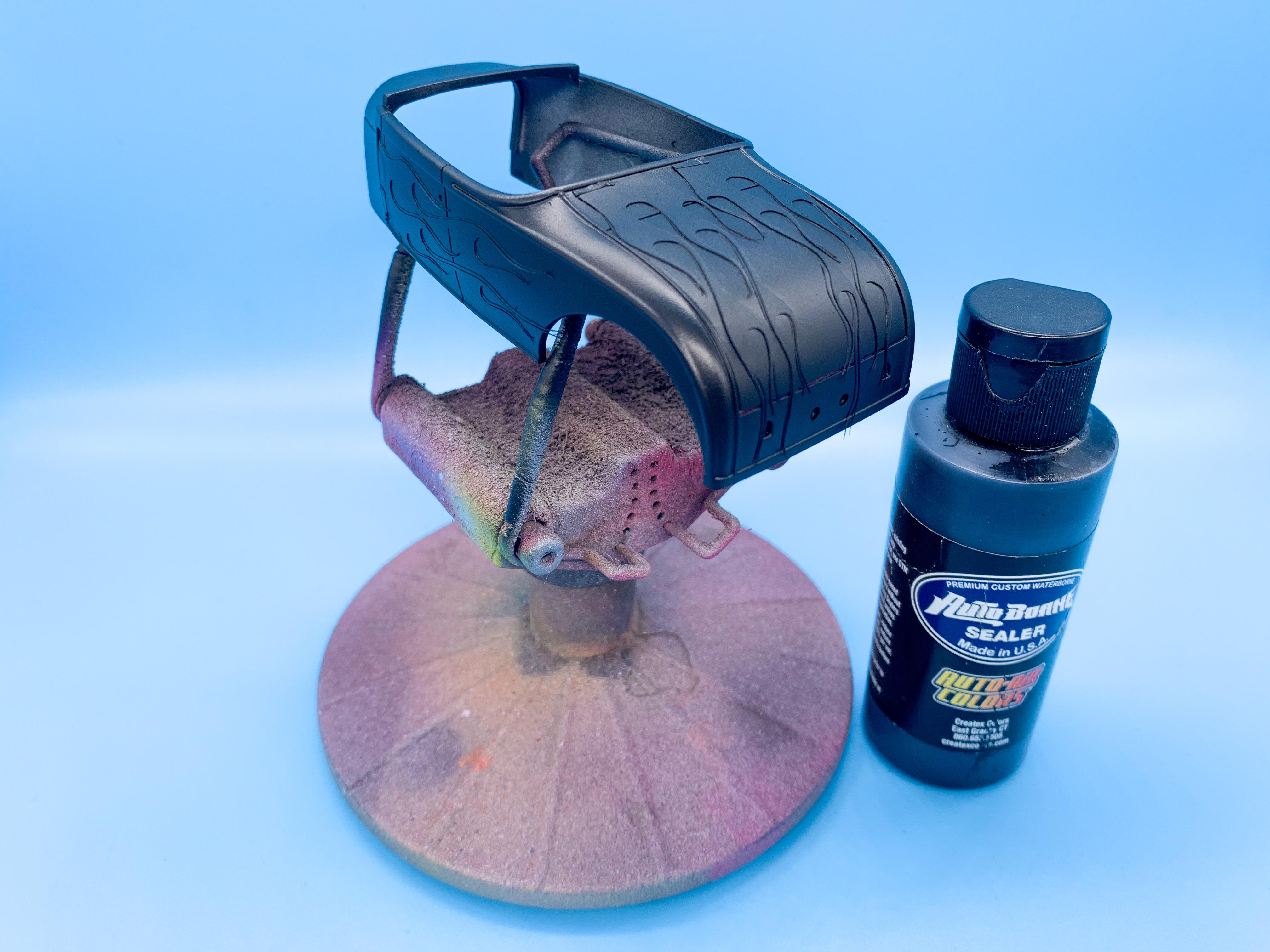

I wanted to build a classic black’n’flamed 29 from the new Revell Model A kit, and after I screwed up the paint on one of the others I was building this seemed like a good chance.
Here goes with Jim’s backwards-flame-painting method™️...

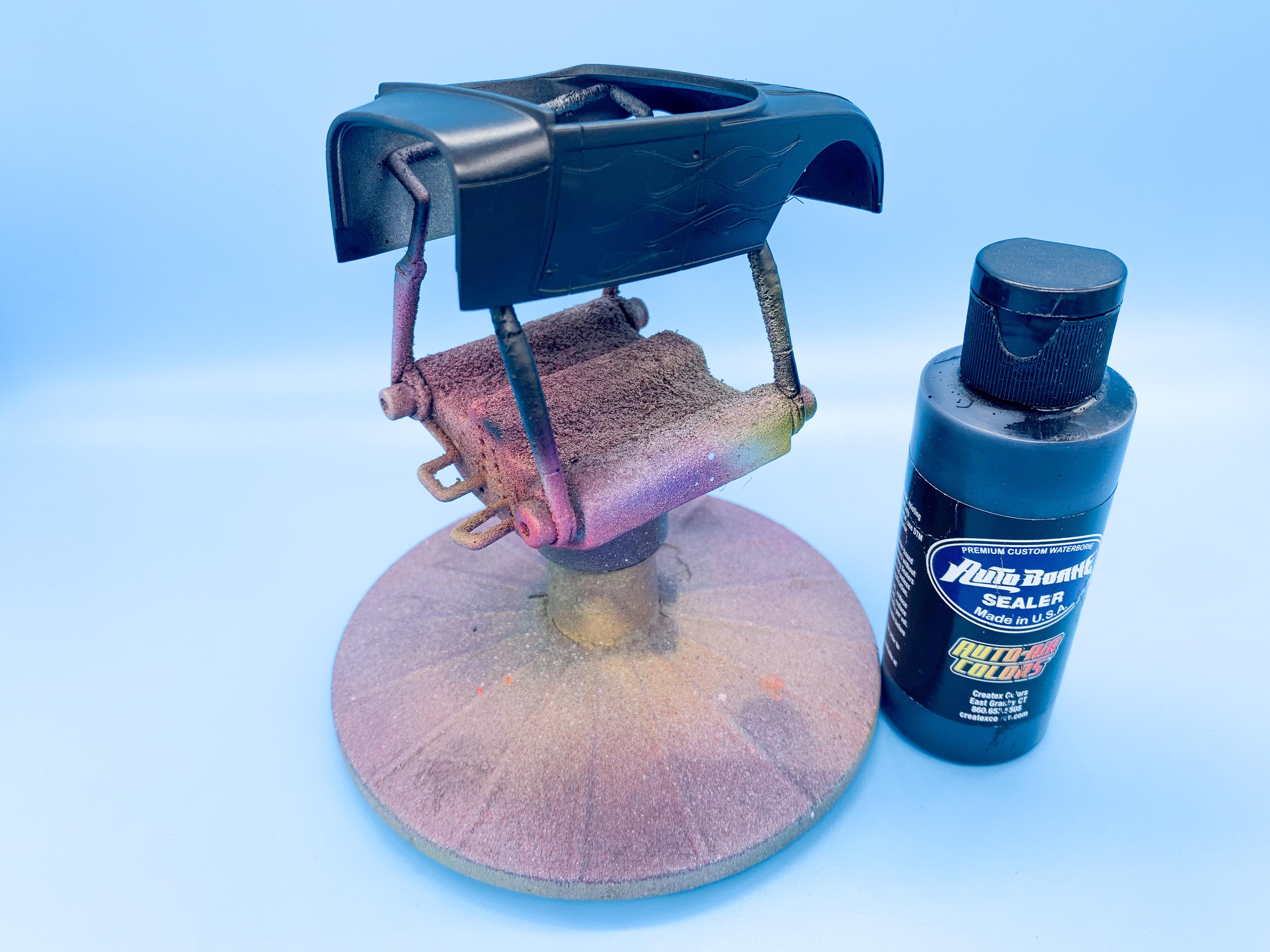

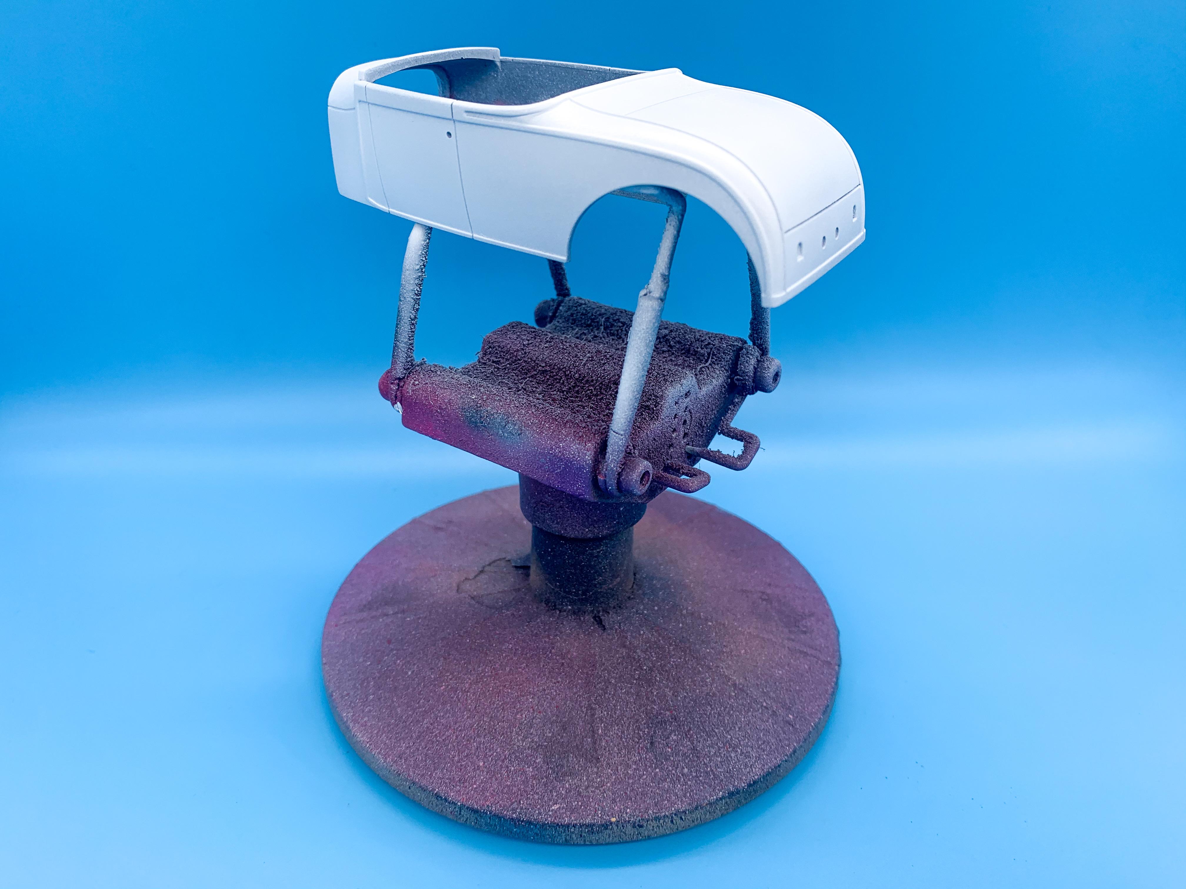

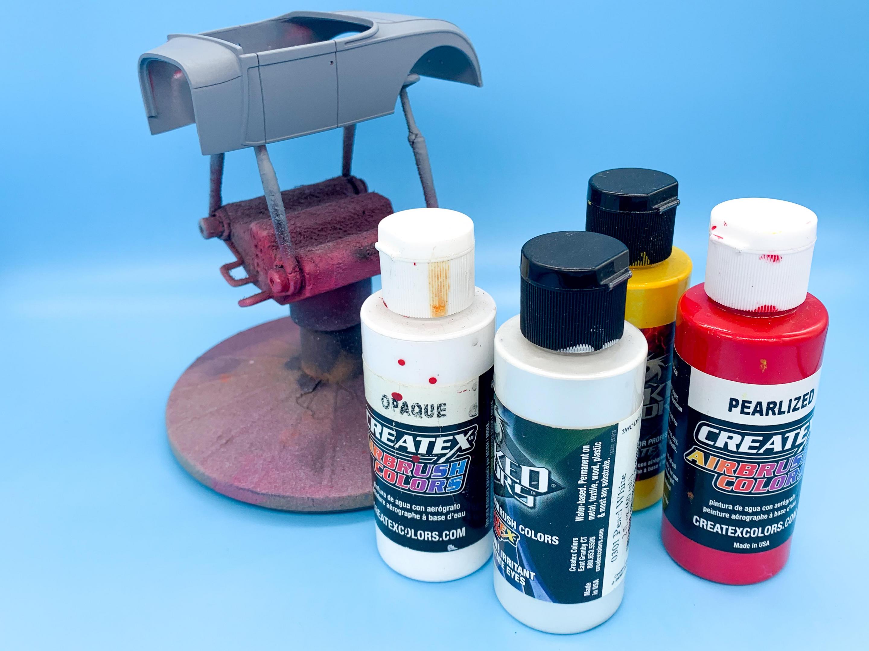

Primered body and the colors I’ll be using...I would’ve done white primer to save a step here but this thing had already been red once so I went with a darker color to make sure there wouldn’t be any bleed-through:

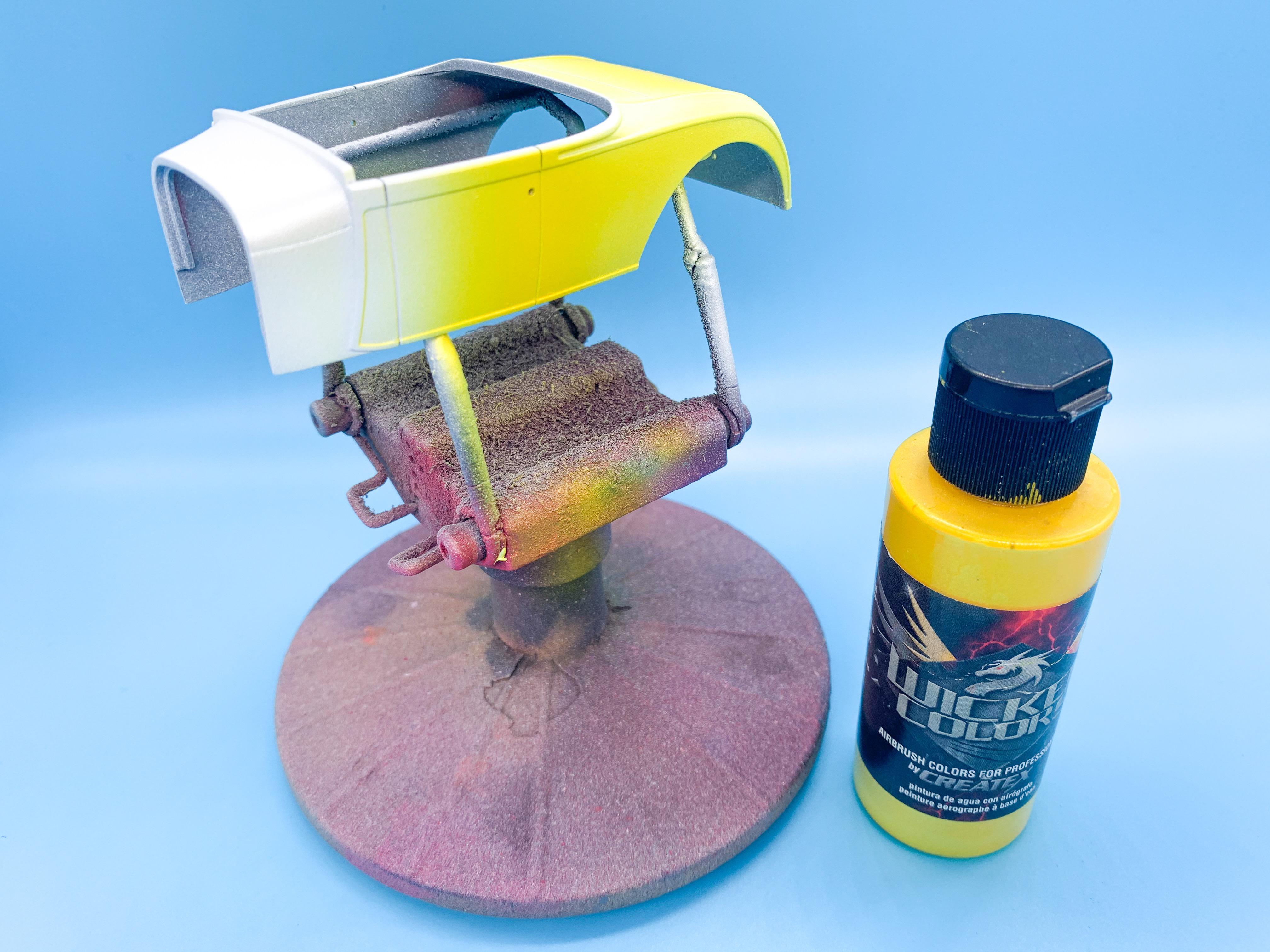

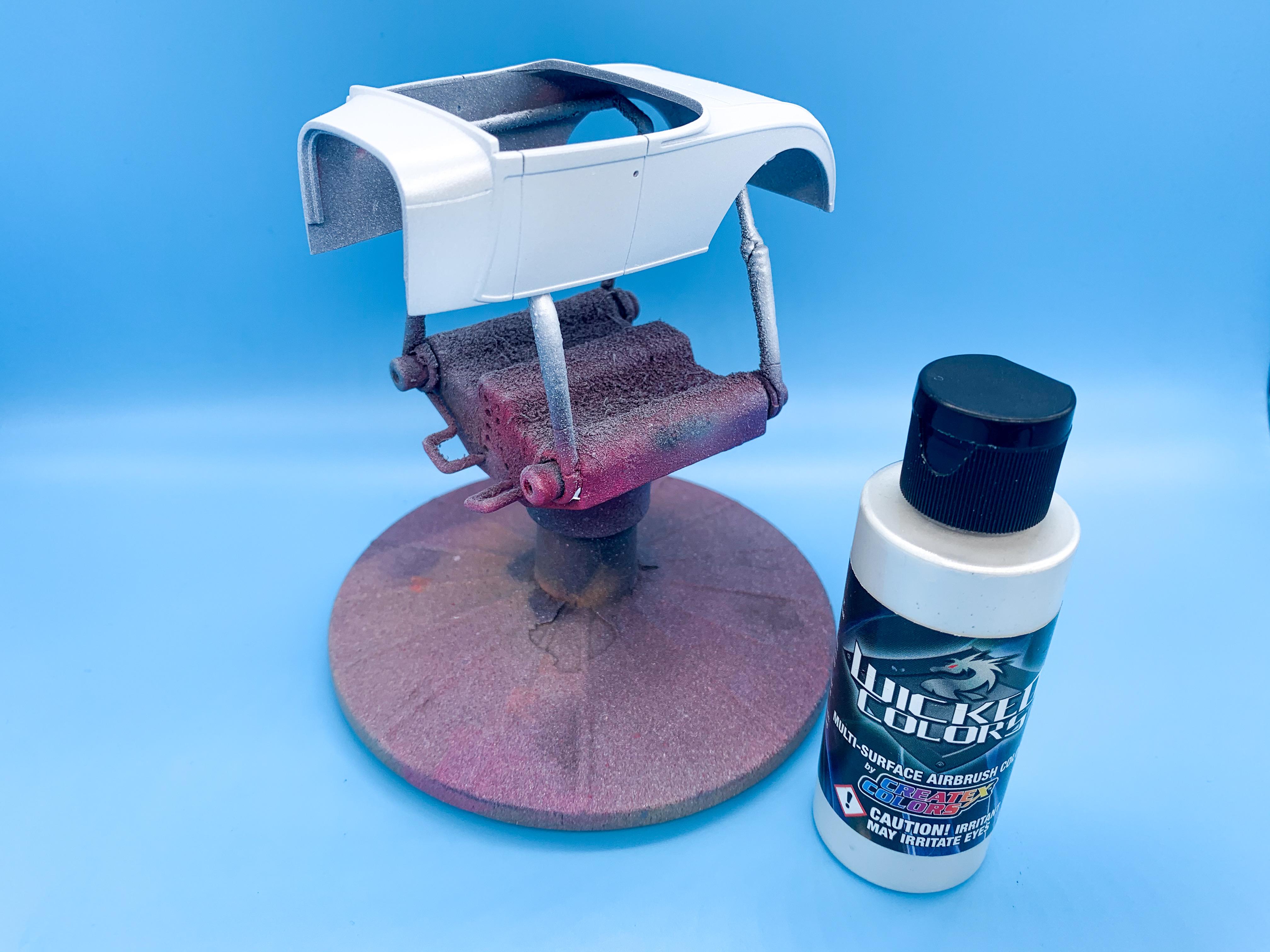

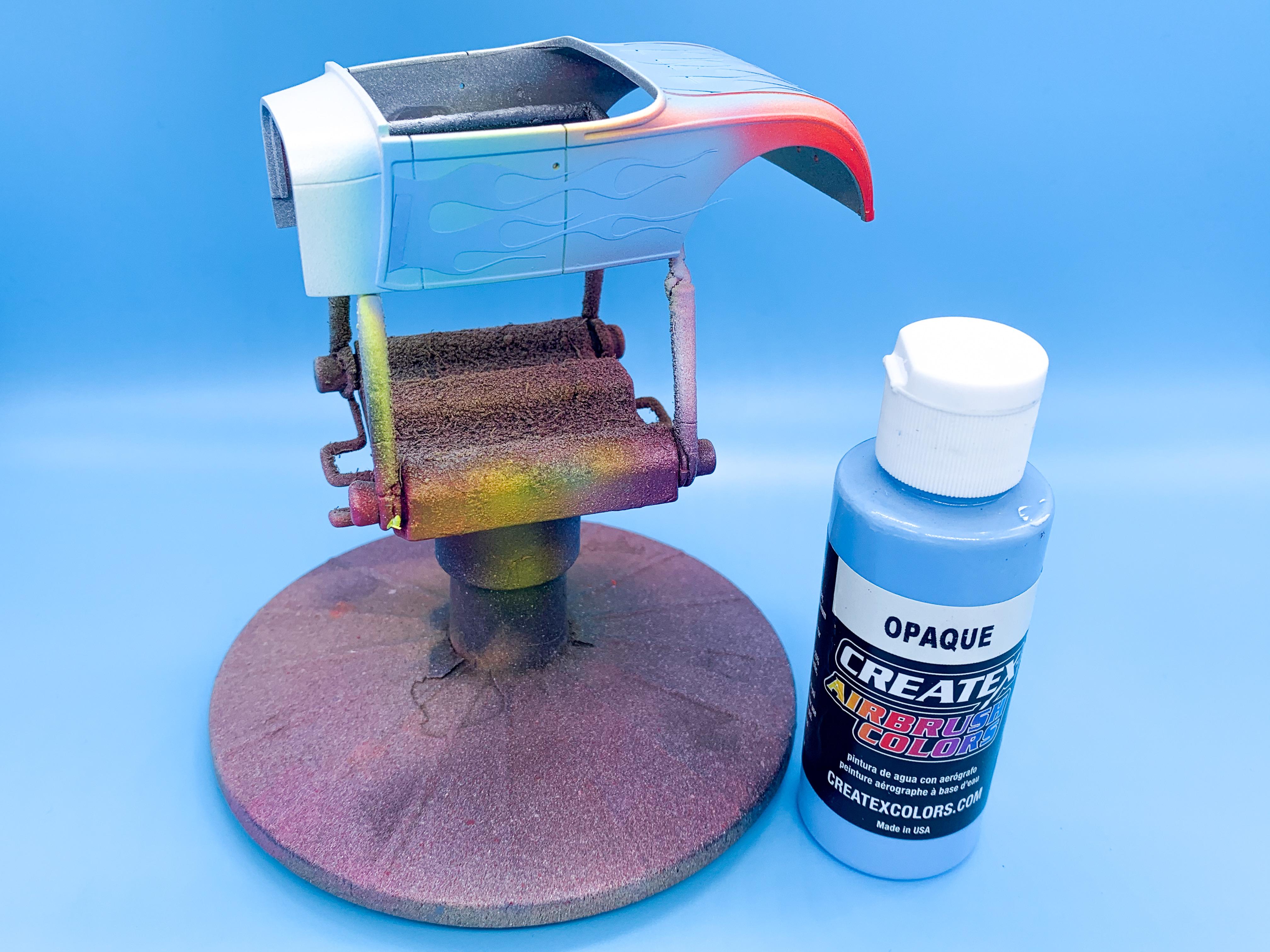

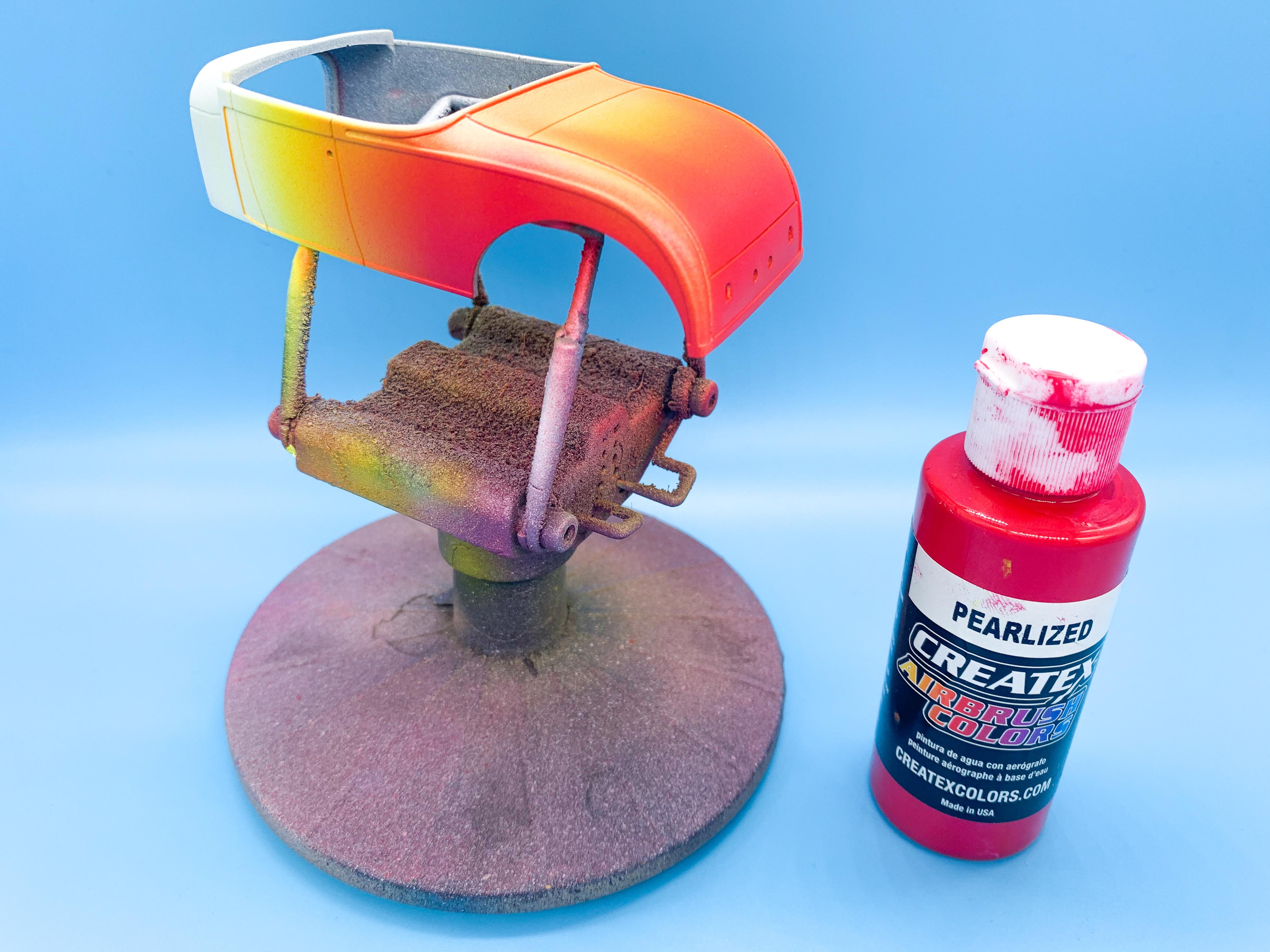

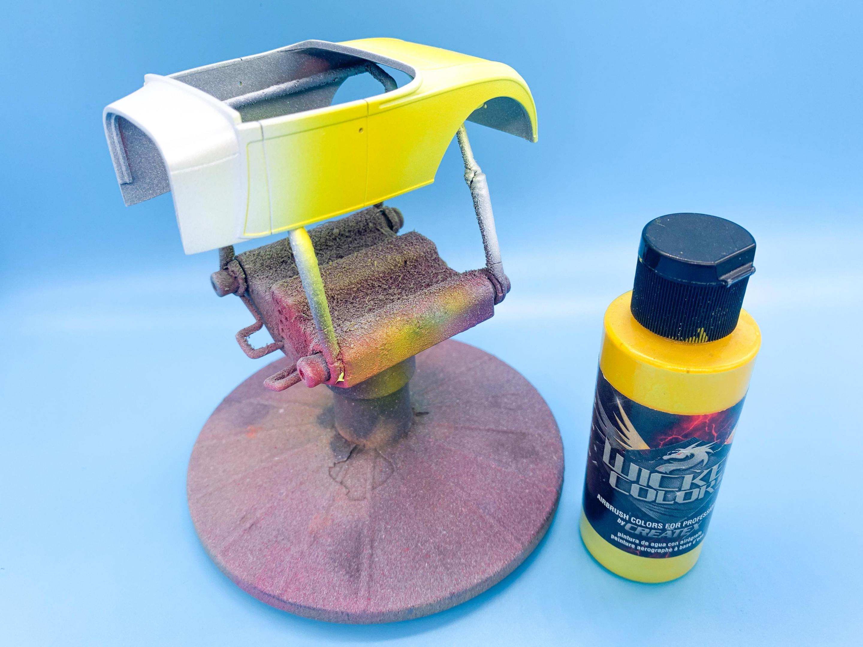

First up, Createx white sealer and a light coat of Opaque white just to get it as bright as possible:
Then, pearl white - it’s hard to spot the difference between the regular white and the pearl but I wanted a little flake and flip-flop to the flames without them looking too wild and modern:

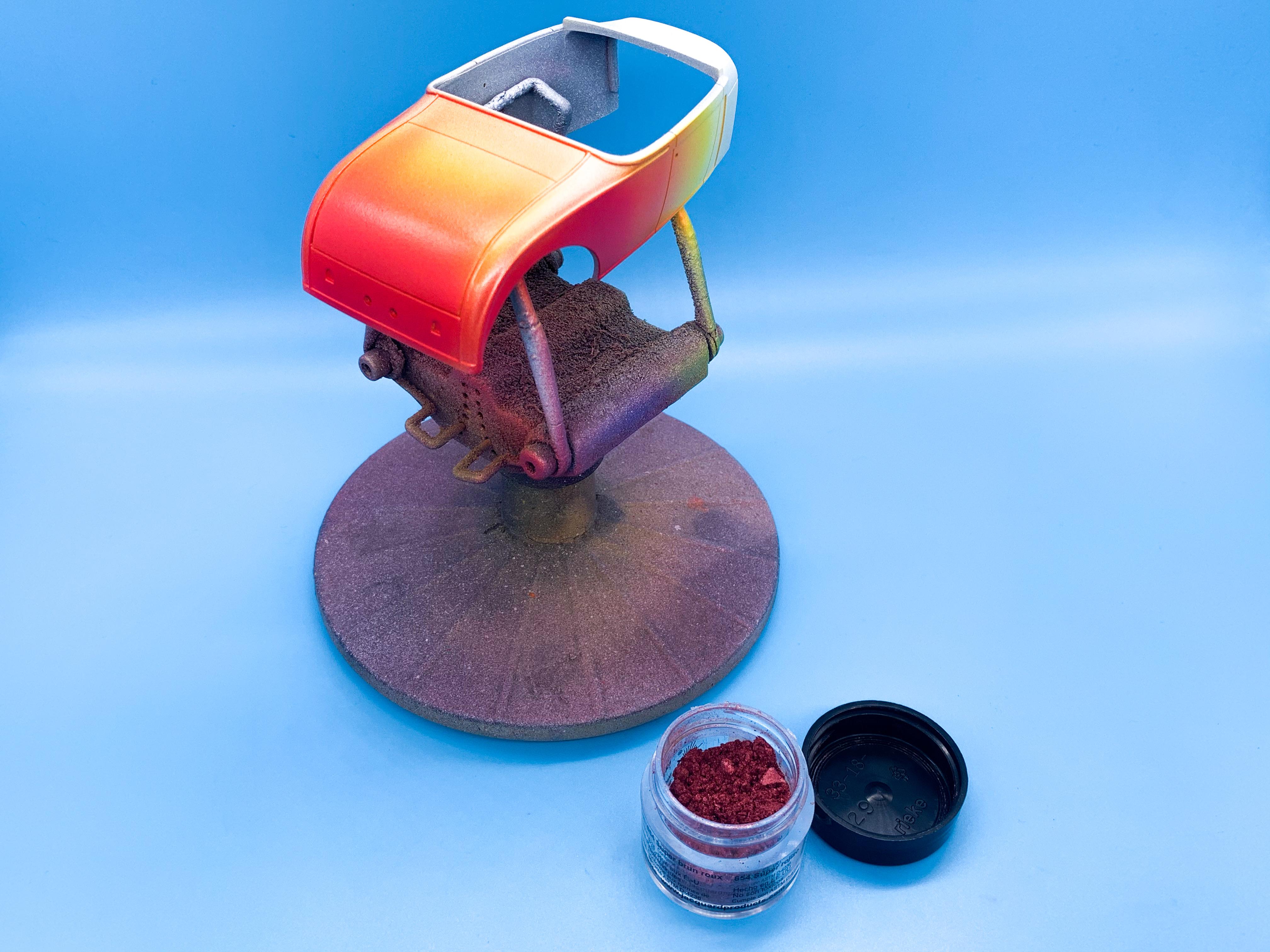

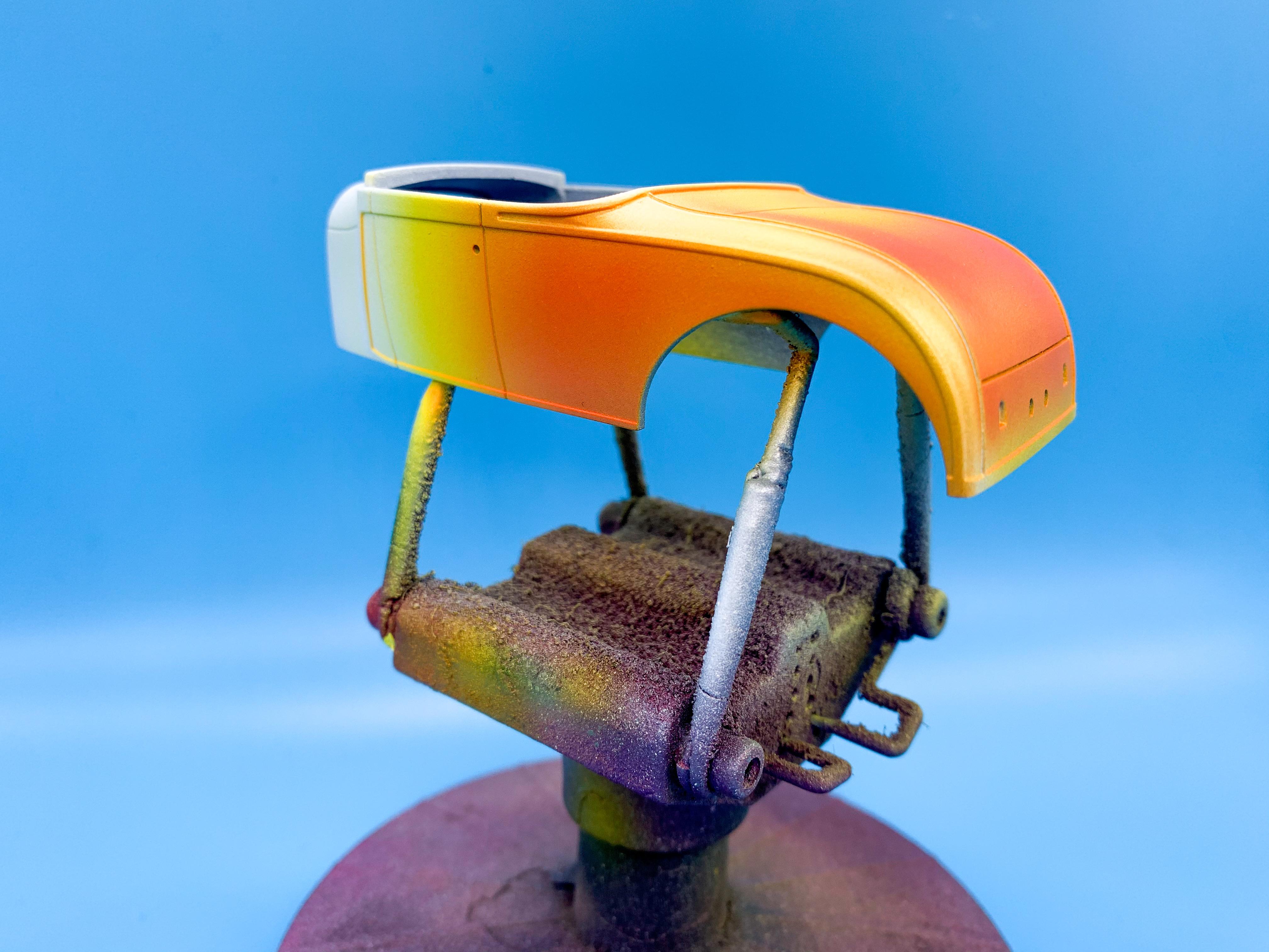

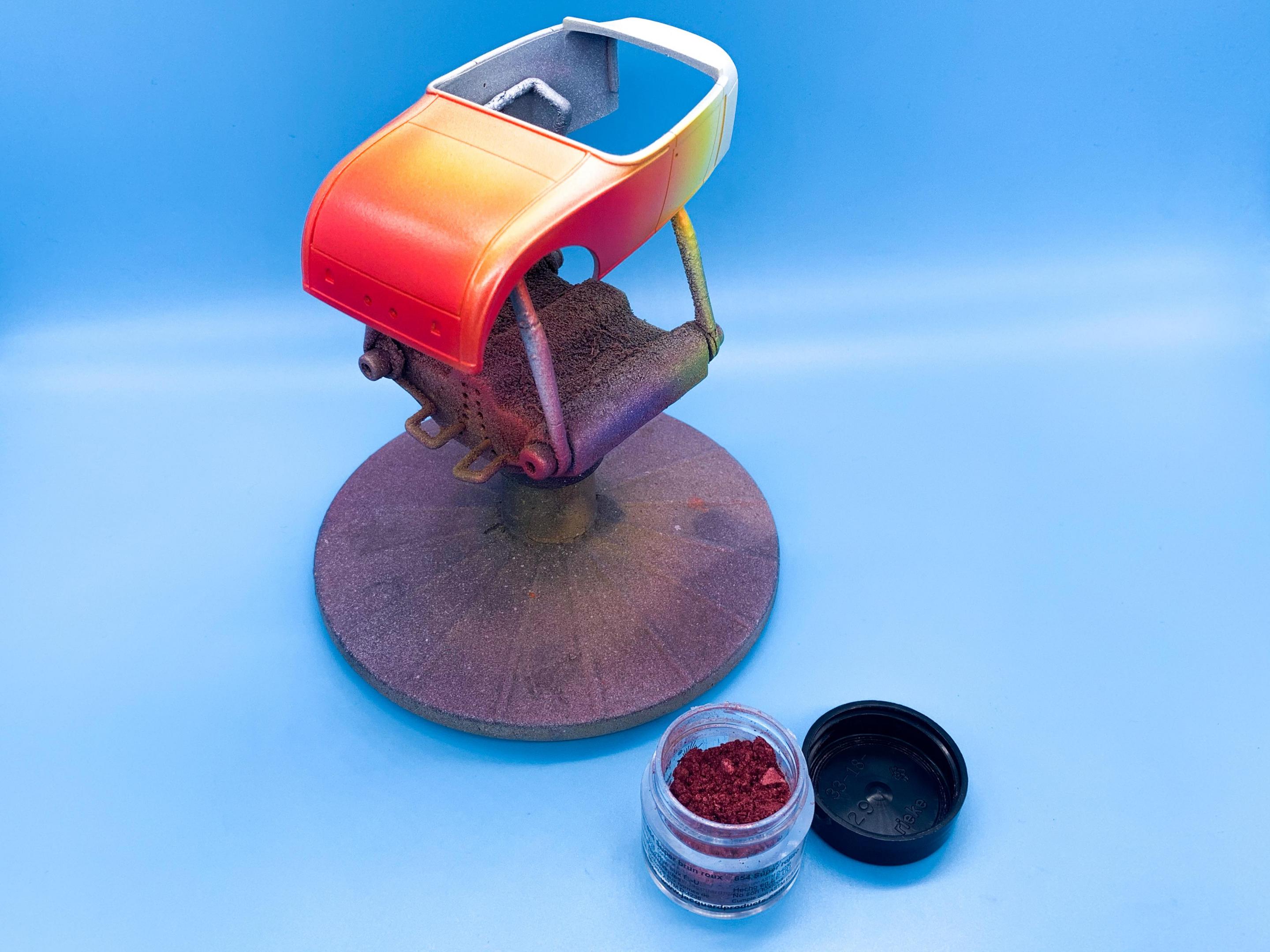

So, my flames will fade from white to yellow to orange to red, so I laid down a gradient along the sides and trunk-lid which I’ll mask over later with flame-shaped masks:

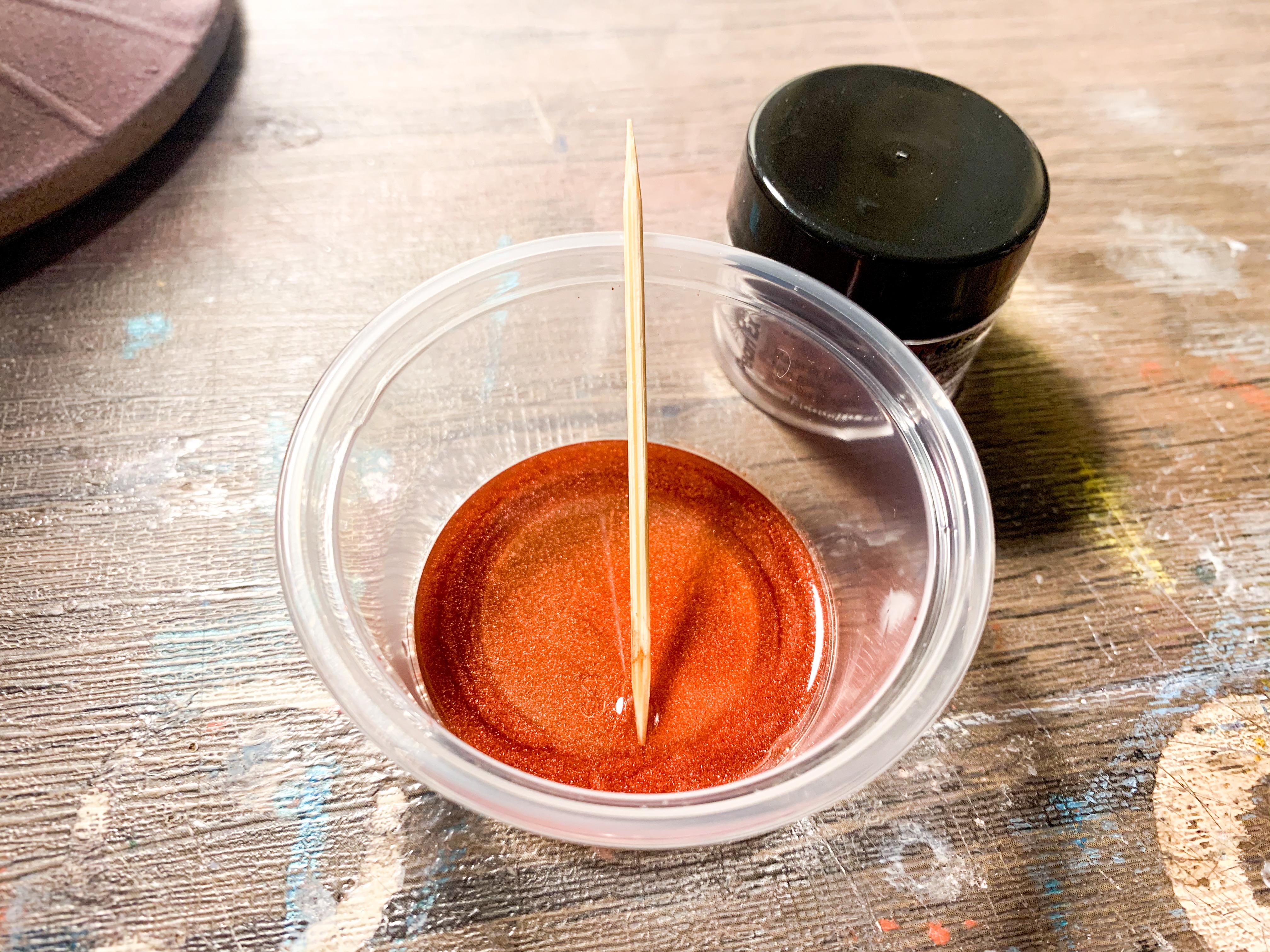

Next up, because I can’t leave well enough alone, a little copper pearl flake over the darker parts to give a little extra flip-and-flop as the light hits the panels:
With that done I shot a coat of clear and let it dry overnight - the next stage will involve masking and I don’t want to risk pulling up any of that paint.

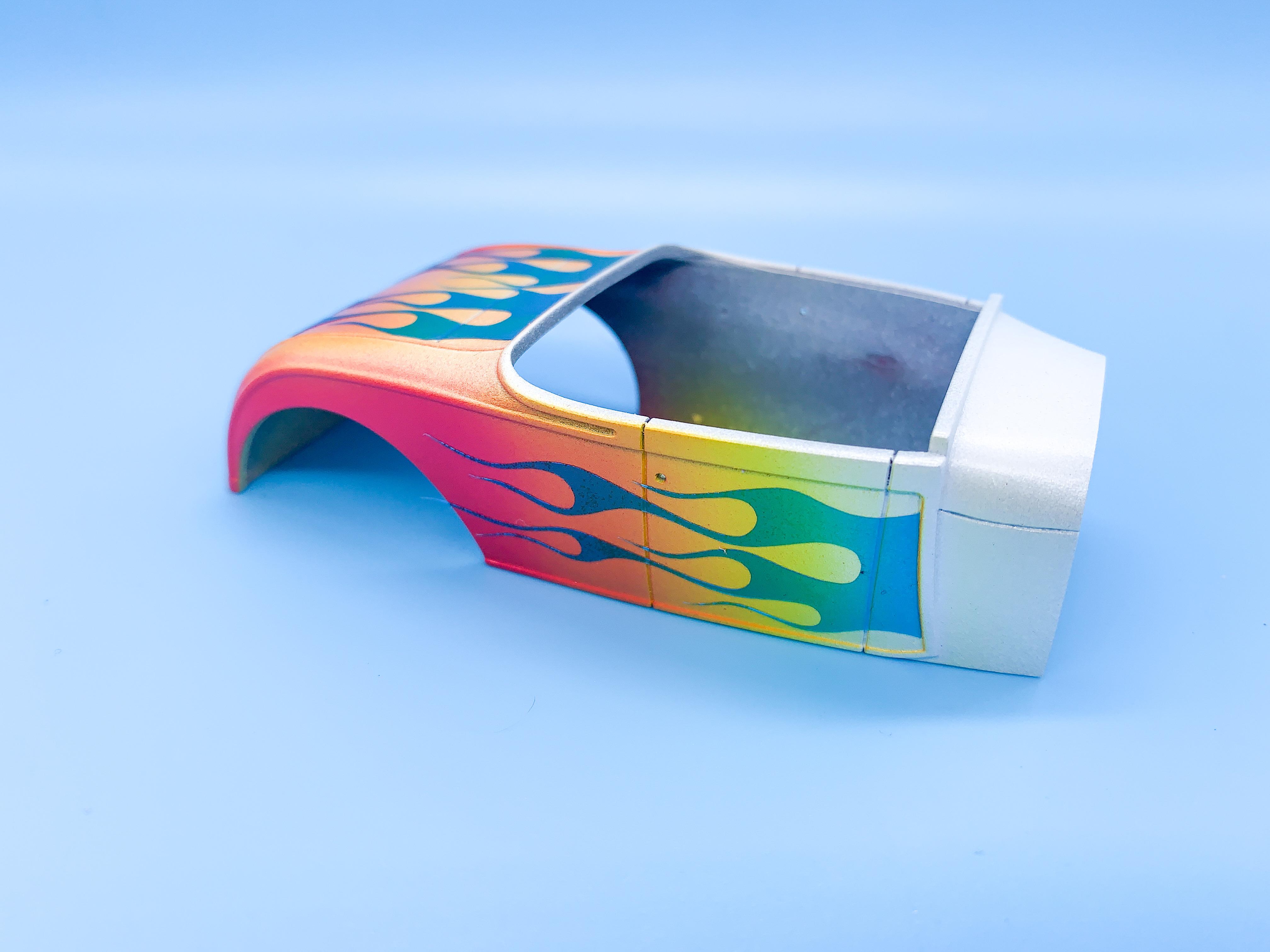

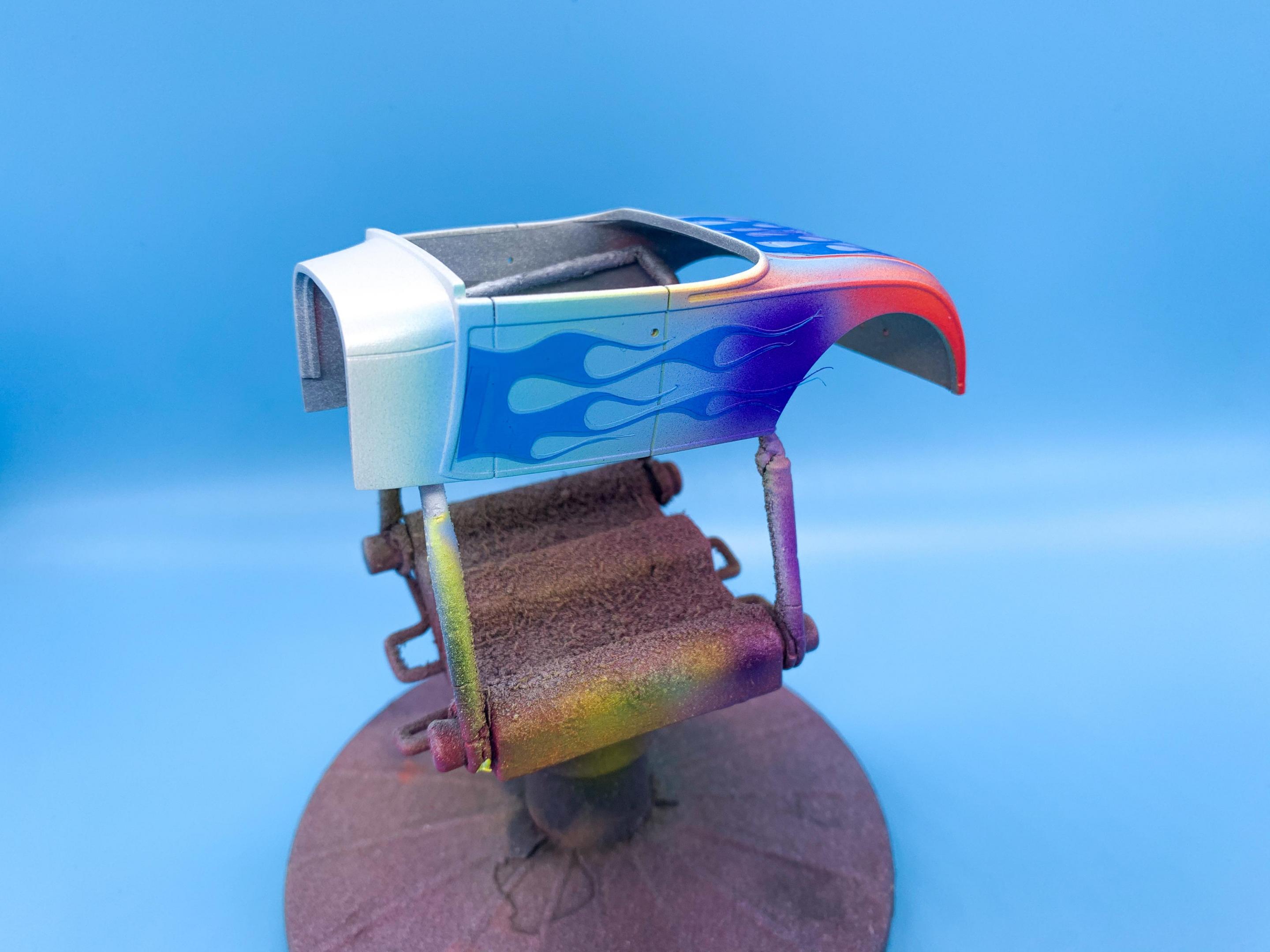

Masks cut and applied:

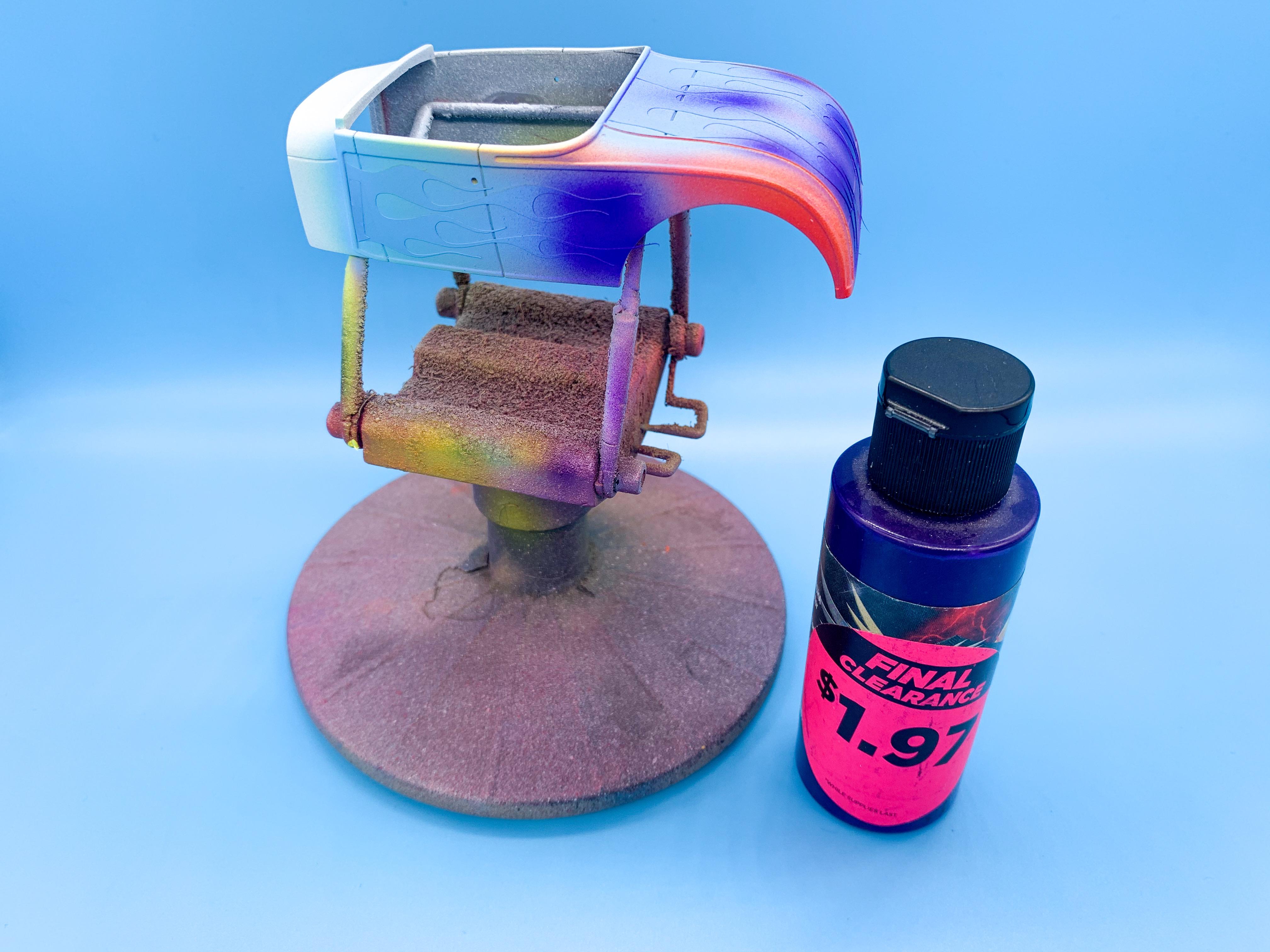

I wanted to add baby blue pinstriping around bottom edges of the flames to give them a little less of a flat look, and because I’d never done it before.  So, next step is a coat of blue around the edge of those masks:
And again, because I can’t leave well enough alone I wanted the tips of the flames to fade from blue to purple so I added a little of that too
Now, I get why no one paints flames this way for the most part, because it looks like a mess basically the entire process, right up until the last step.  But, stick with it and it works ok...

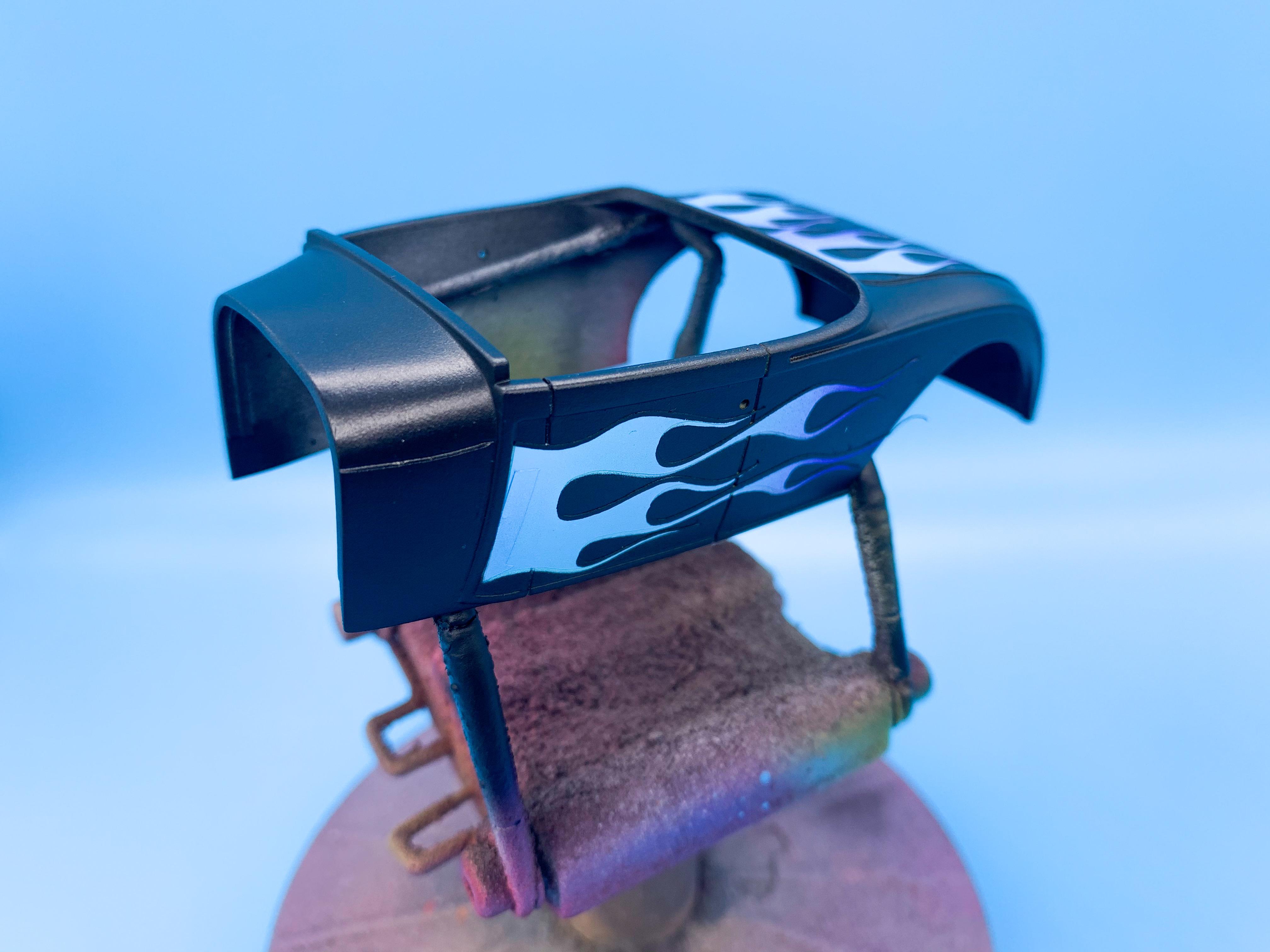

Now that I’ve got the pinstripe color laid down I used a second set of the same flame masks and overlaid them over the existing ones...but down a fraction of an inch.  I wanted a relatively narrow pinstripe that looked like it COULD be in scale so I didn’t need to misalign it too much...
And now, finally, the ‘real’ color coats...
Now, when I remove the first layer of masks it’ll just reveal a little strip of blue and the first mask, and when I remove the first mask I SHOULD have flames that look decent...or a hot mess ?‍♂️?.

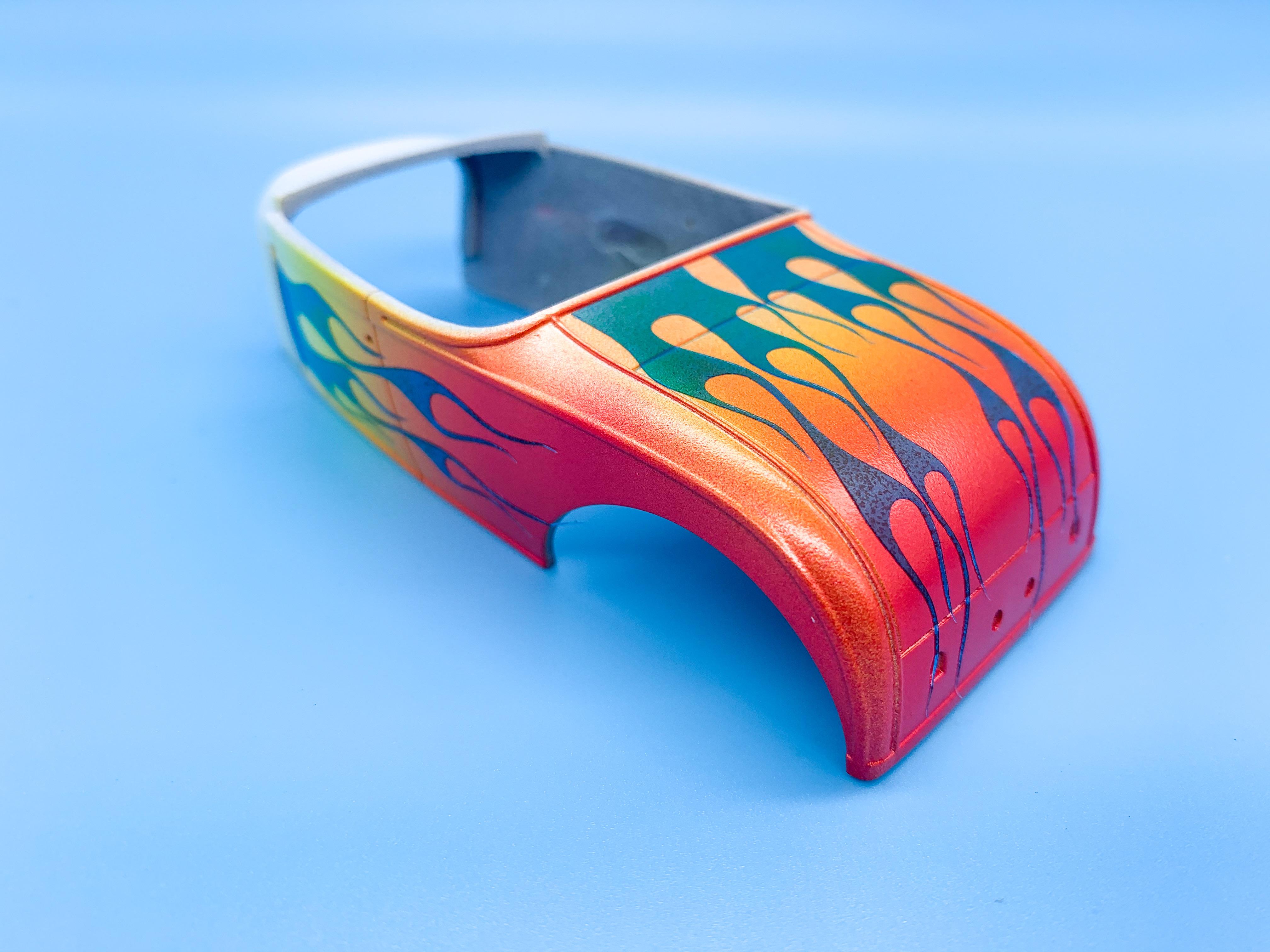

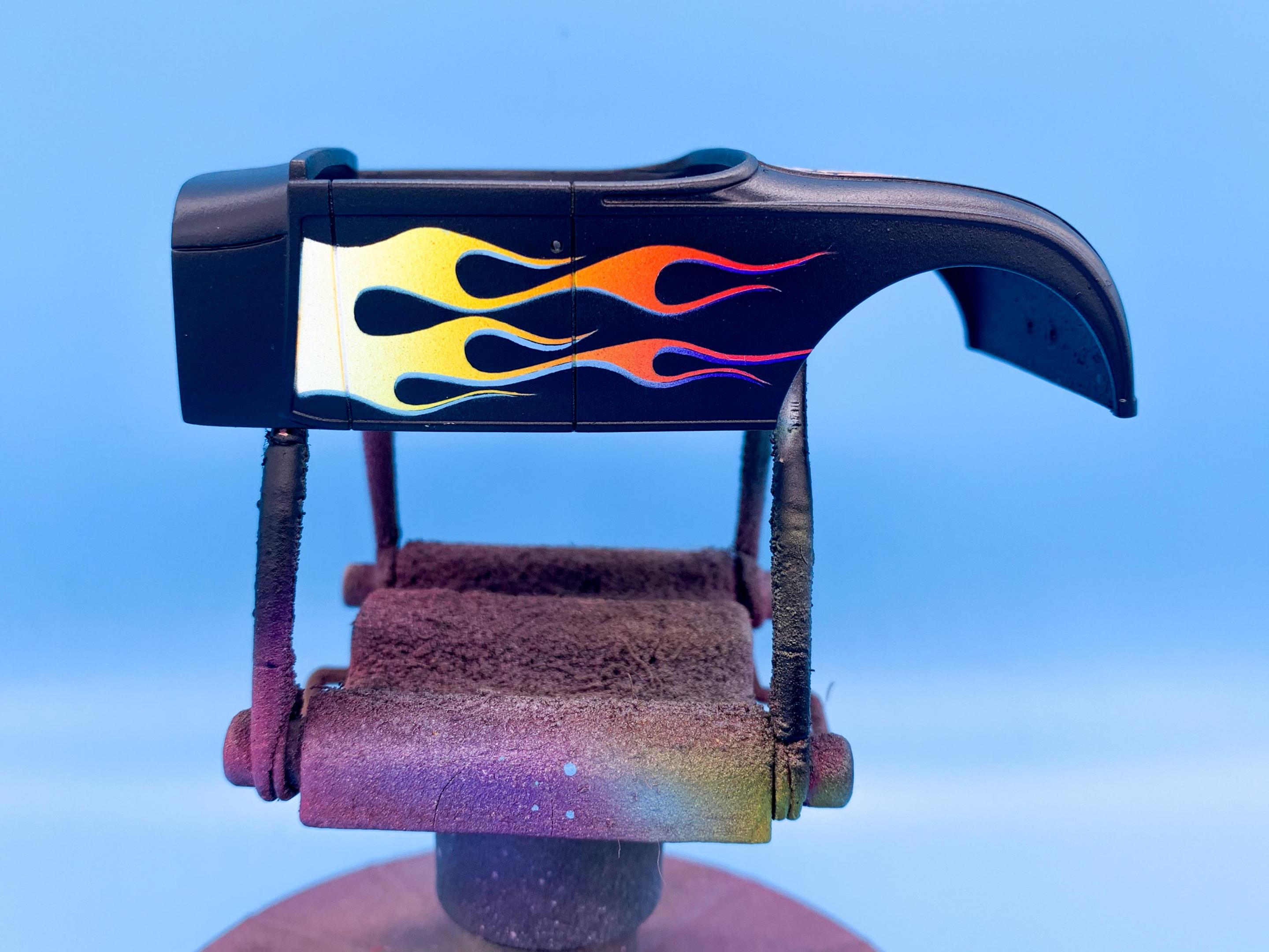

First layer of masks off...

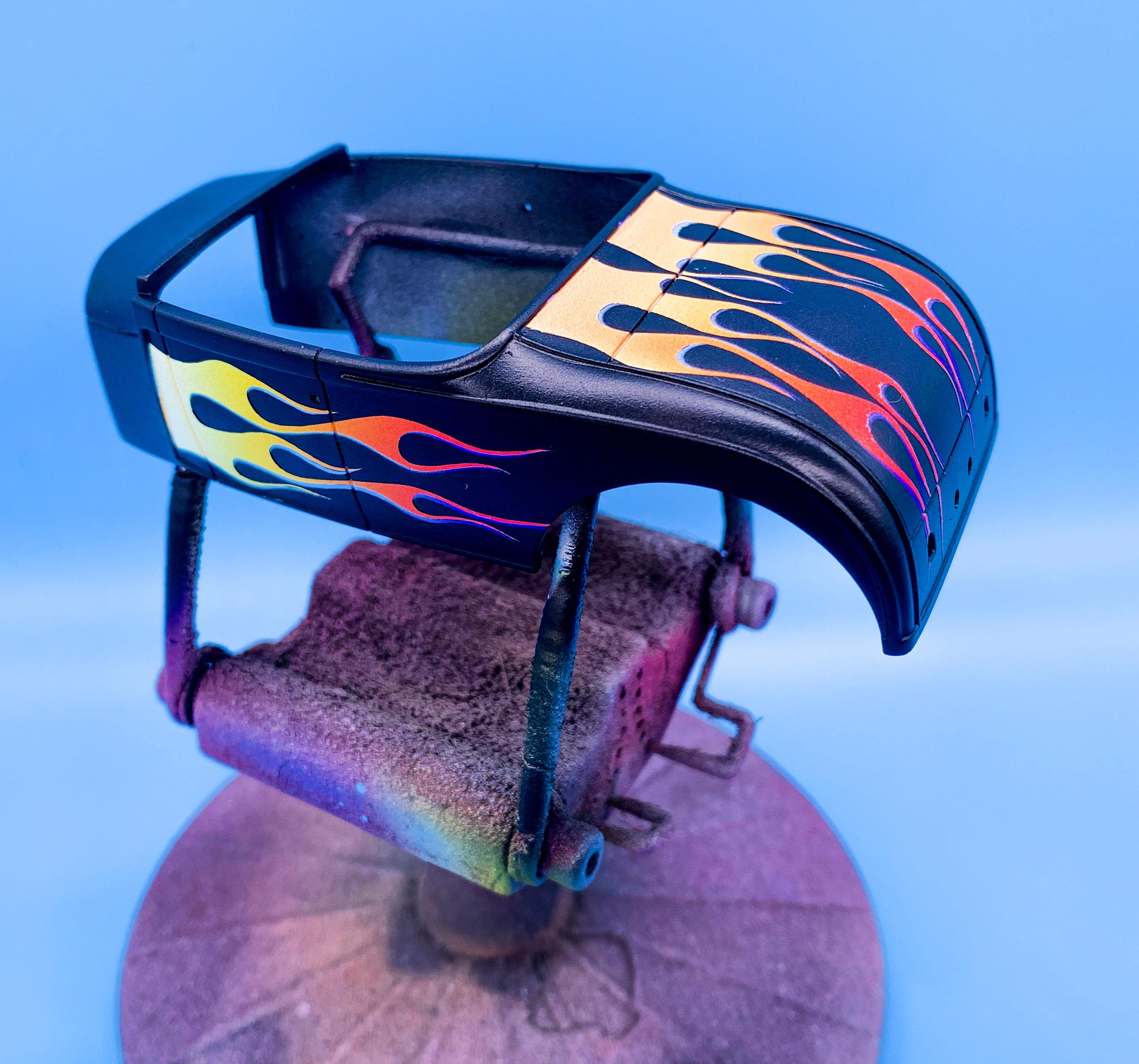

And, some careful and nerve-wracking unmasking later...

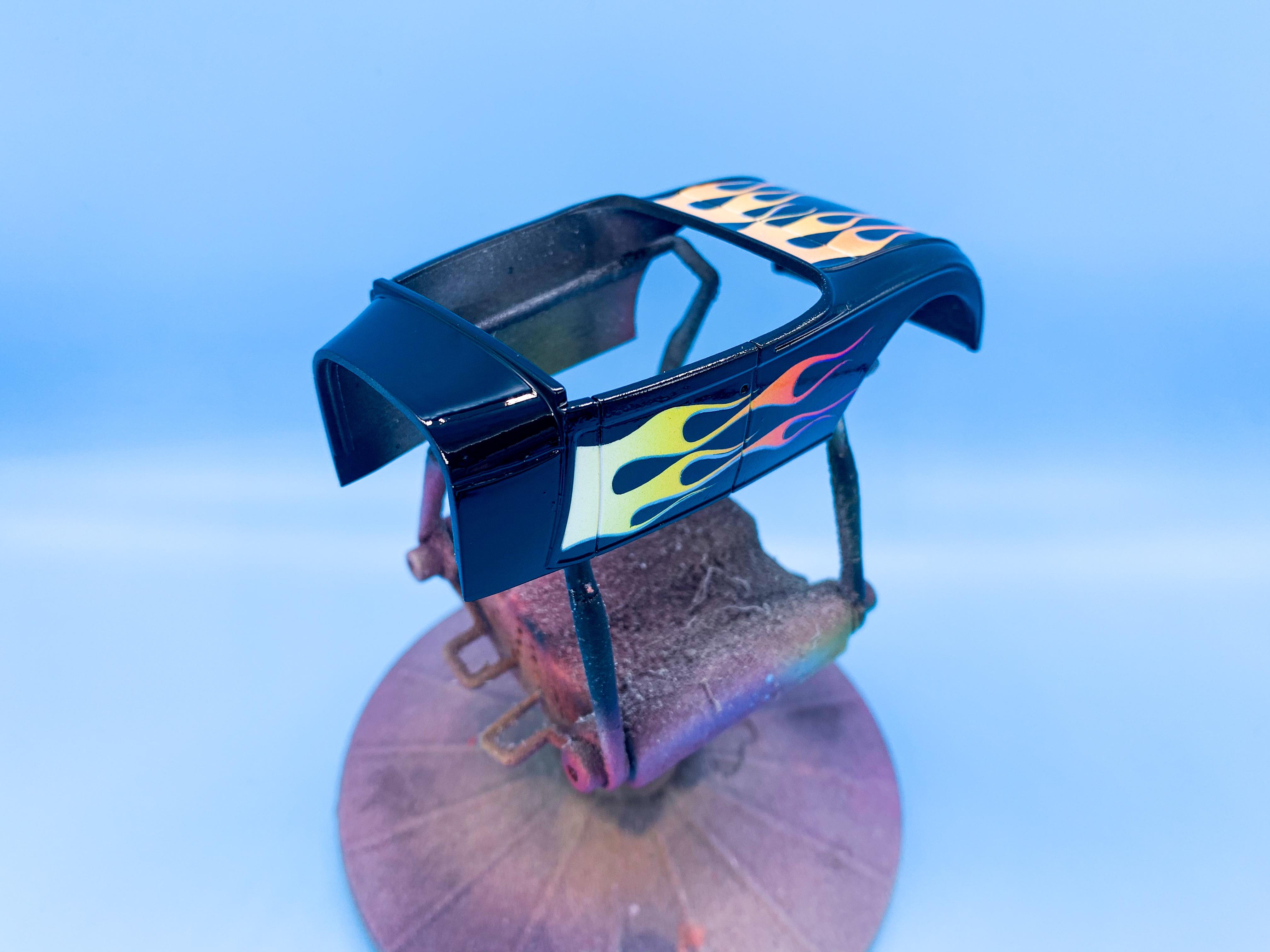

Came out ok I think!  Couple of tiny touch ups to do with the black paint but nothing too major...the trick with this airbrush paint is to peel the mask off as soon as you can so the edges don’t crack...but also the sooner you handle it the more chance of nicking it so you need to be careful - but got away with it on this one for the most part!
I’m going full-glossy for the finish on this one so it’ll get some Testor’s enamel clear when the humidity isn’t sky-high here but hope y’all found the process useful, or interesting at least!  More soon!

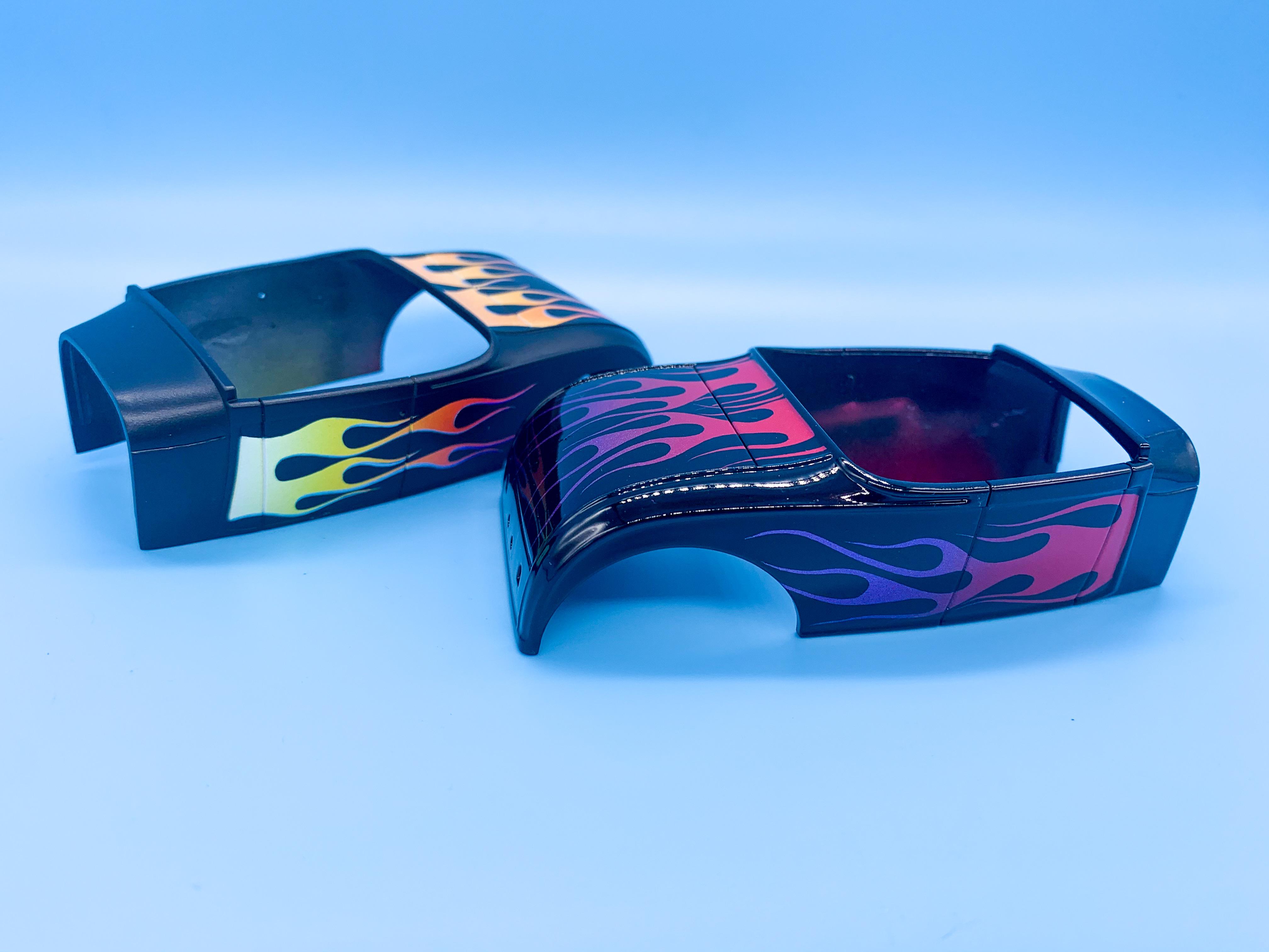

Haha!  No, luckily!  It was a simple two tone one that I’d had an idea for:
It polished out pretty nicely but there was a little rough patch on the body that I didn’t notice until basically when I was going to polish it.
I primed it, couldn’t see it, did the red, couldn’t see it, did the black, couldn’t see it, did the clear, couldn’t see it - went to polish it three weeks later and I could see some texture under the black paint.  Not in the paint or the clear; but under all the layers.  One of the problems of using a lot of Createx paint, which I do, is that it dries matt you have to make sure the surface is perfect because you’ll likely never spot a little flaw until you’ve sprayed the clear (and in this case, not until I was ready to polish it).
Turns out these bodies ALL have two little rough circles on each side behind the door...I thought I’d maybe crazed it with primer or something but nope, they all have it.  No biggie if you bury it or know to look for it...but I screwed up and didn’t ?.
So, no reason to build it with a pair of annoying flaws on each side - giving the whole thing a do-over ?
These two will look cool together anyhow, so I’m not too bummed....

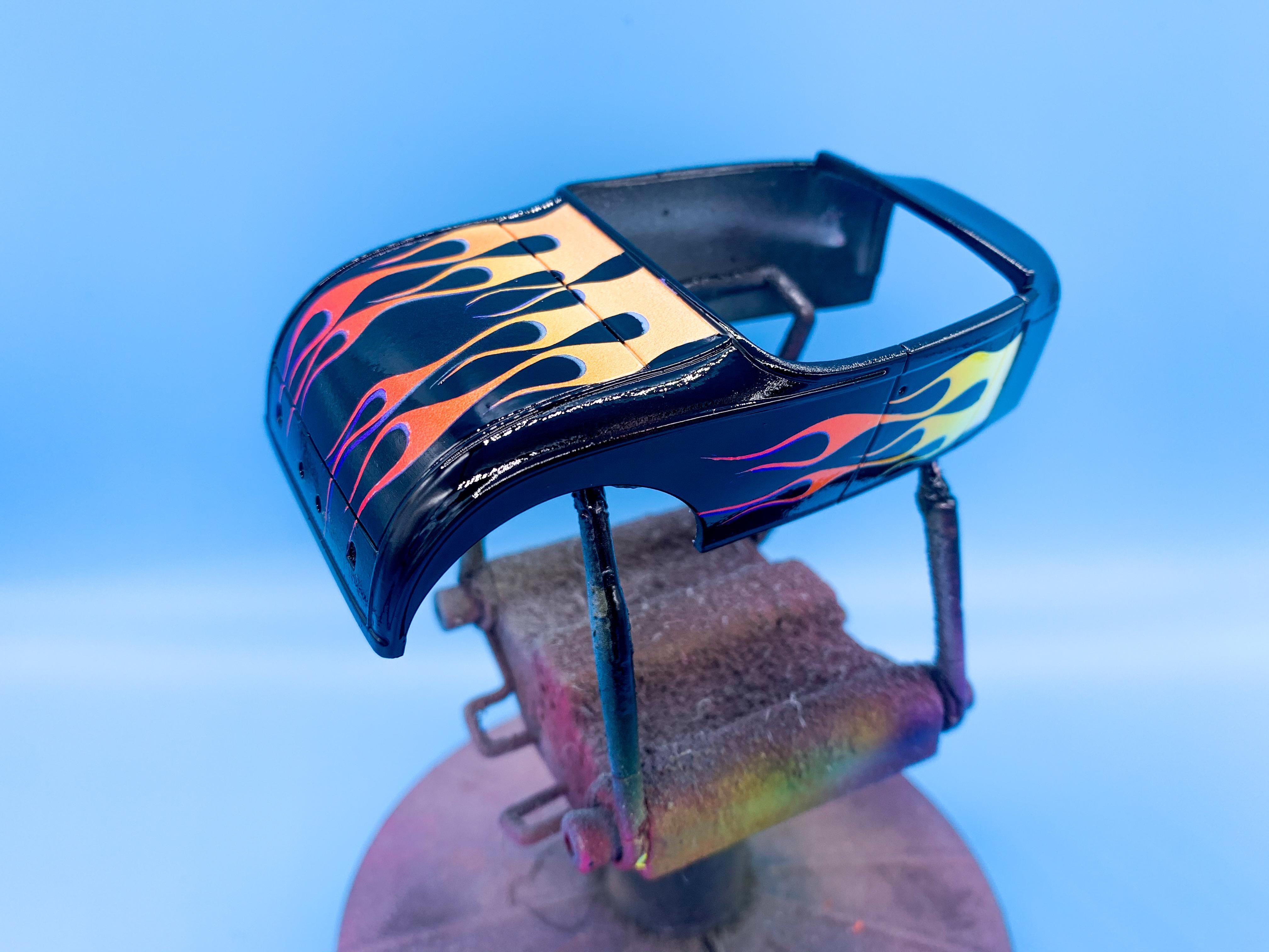

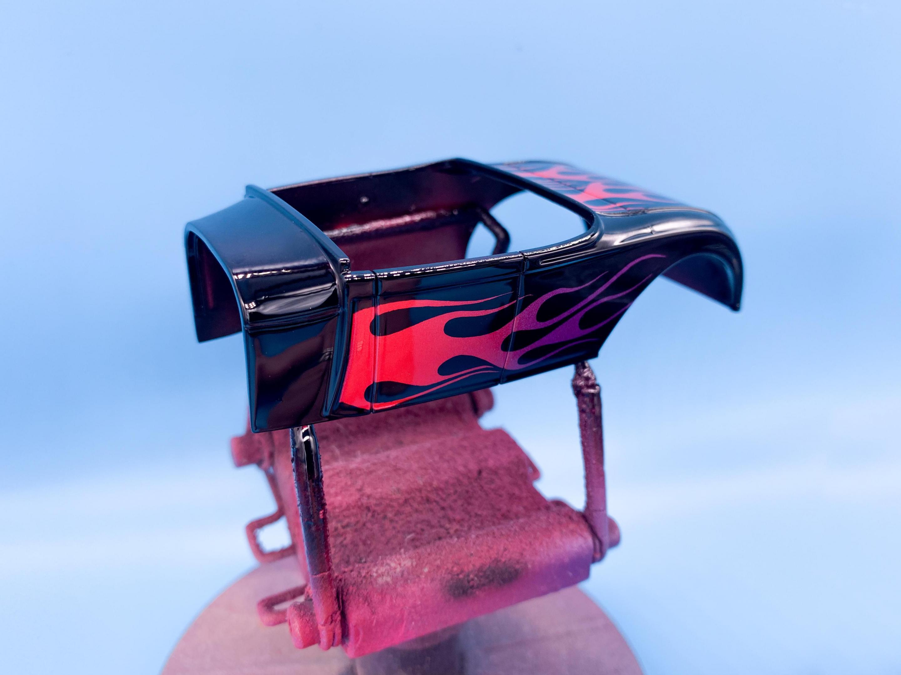

Got lucky with a low-humidity day yesterday and shot a little clear:
Got a couple of specks of dust in it that I can see, but nothing that won’t buff out...need to start making the rest of this thing now while the body does a couple or three weeks of drying...

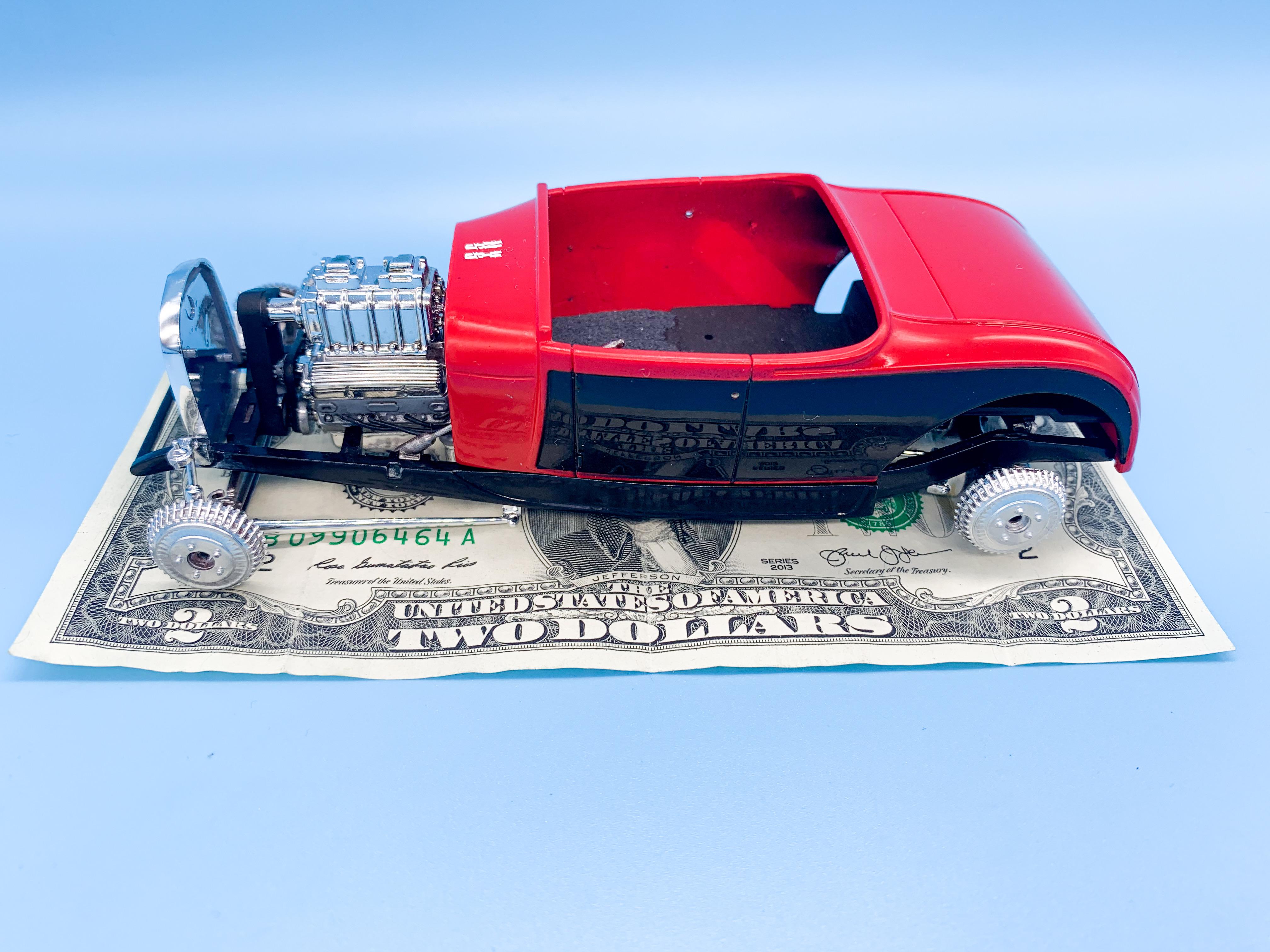

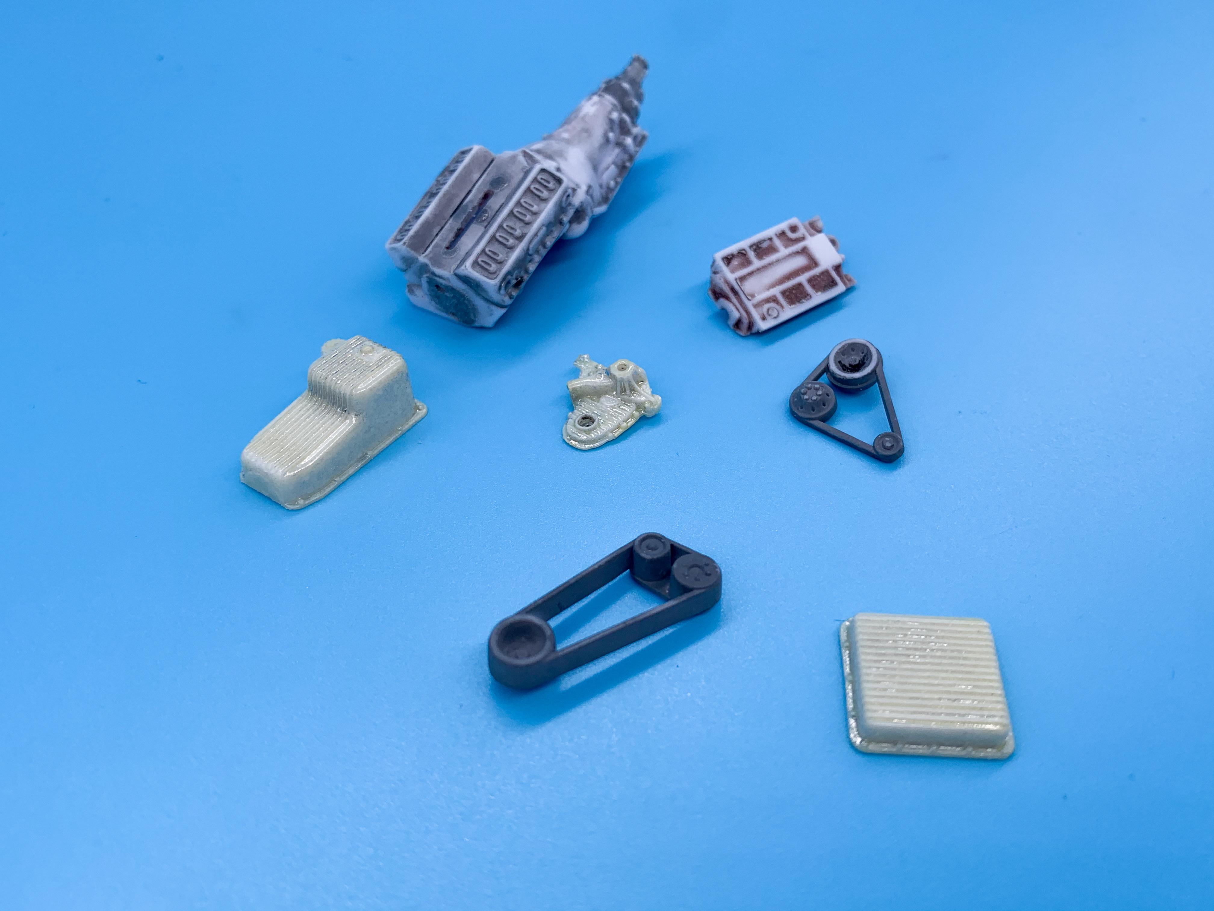

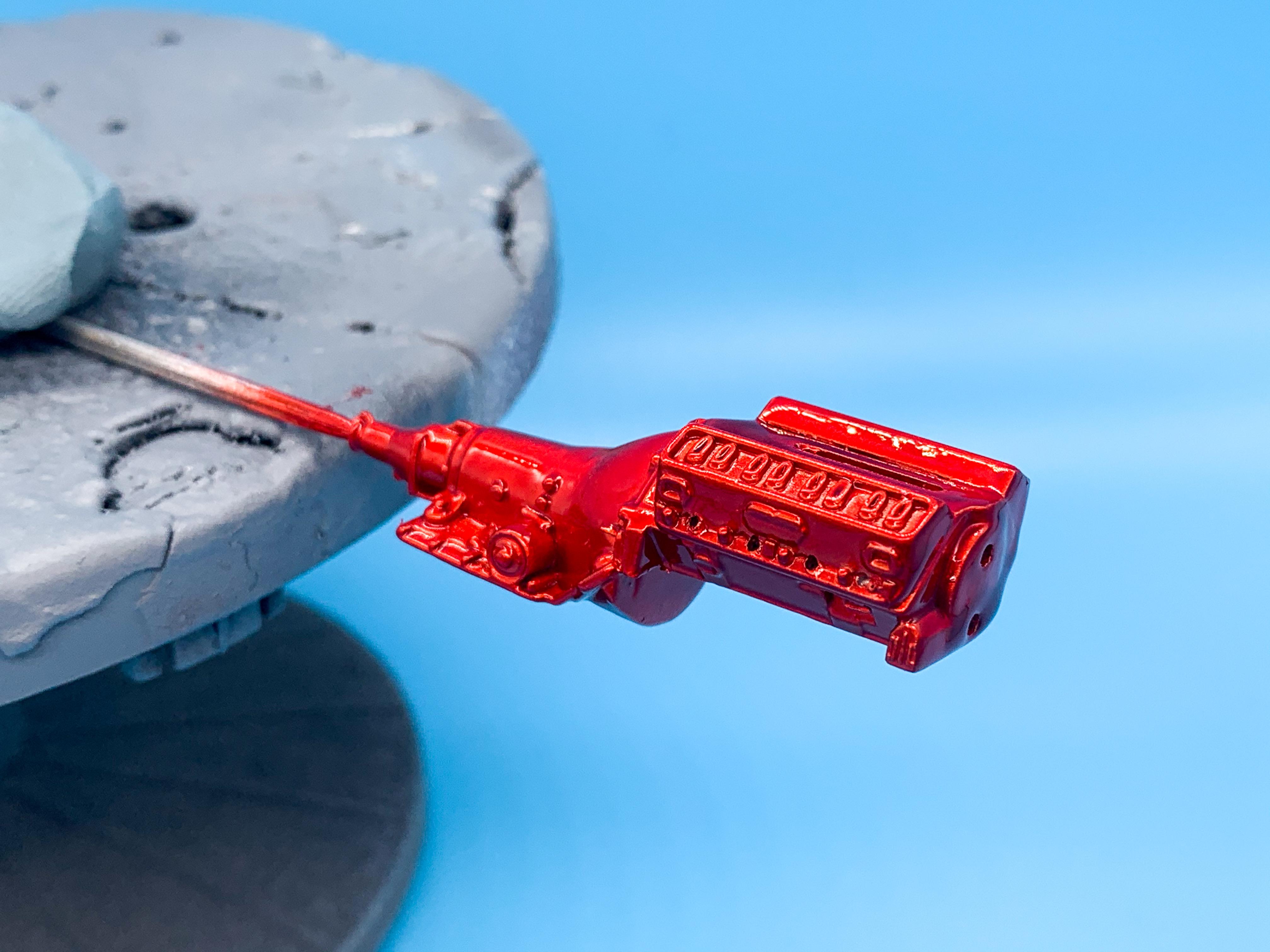

Whilst the body’s drying and waiting to be polished did a few little bits.  I actually had an engine completed but I shot it with metalizers and it looked OK...but kinda dull.  Realistic, but not really eye catching or very interesting, so it spent a couple of days in the LA Totally Awesome to think about what it had done:

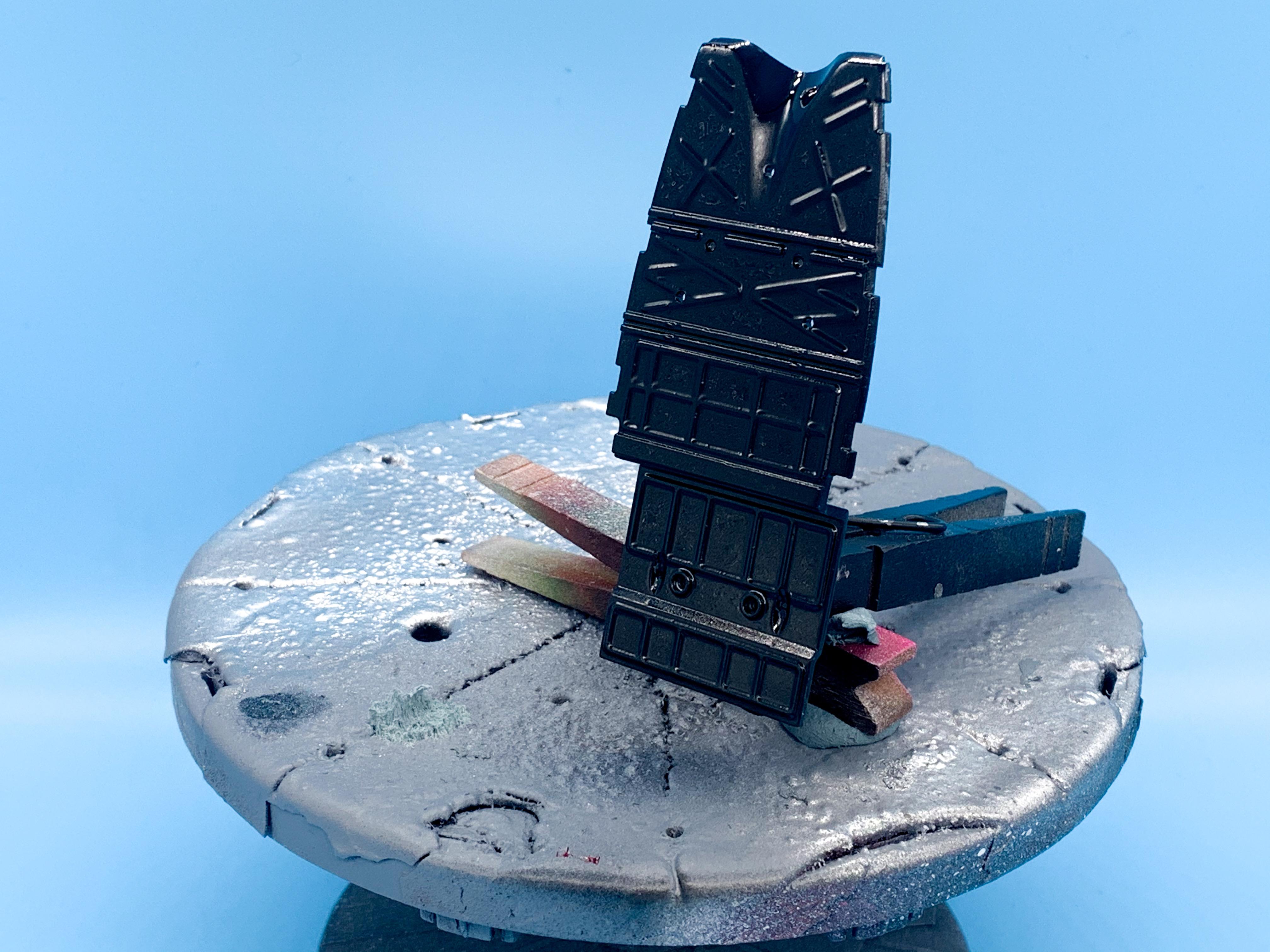

Whilst I’m rechroming parts anyway I stripped a load of the suspension pieces and cleaned them all up too, along with the steelie wheels, and got them in black enamel.  I haven’t used Alclad’s black enamel (which they recommend as a base) for a while, but this can of stuff that the hardware stores around me sell seems to gloss up nicely and Alclad takes to it just fine so I’ve been using that lately:
Shot the block with some Rustoleum silver, (which has a barely detectable flake, which I like) and then shot some candy red - much more interesting!
And I wanted a polished bare-metal look to the underside of the floorpan so that got some black enamel too - I’ll let these bits set overnight and then give them all a polish and some Alclad tomorrow.  Not totally sure how to achieve the effect I want on this part - kinda polished but not chrome - reflective but not too bright either.  Might have to do some experimenting to achieve what’s in my head...
Cant believe I spent ALL day on this and all I’ve got to show is some black parts and a red part - more interesting stuff tomorrow, hopefully! ??
